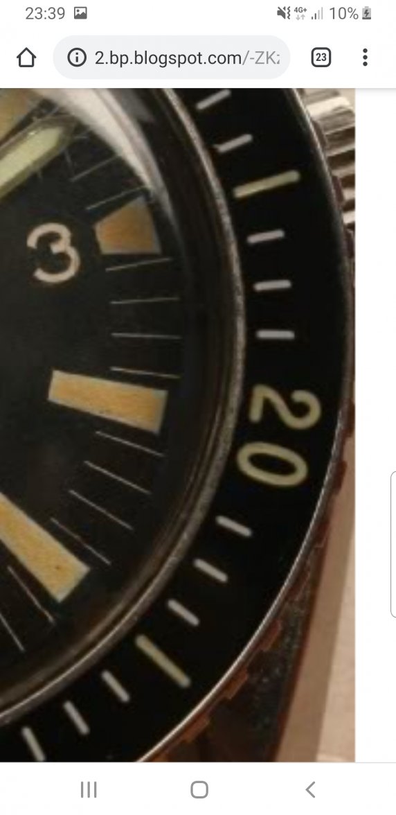

  1. Shabbaz Jun 11, 2019
    4,880
    17,830

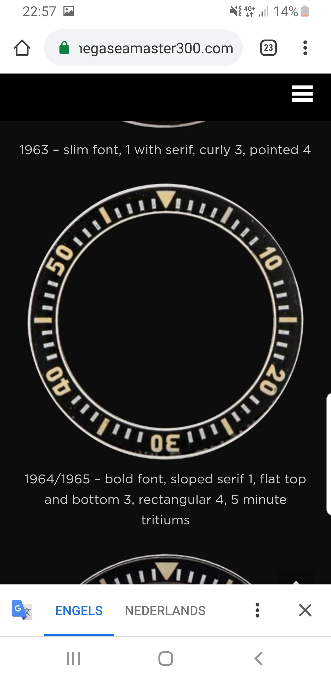

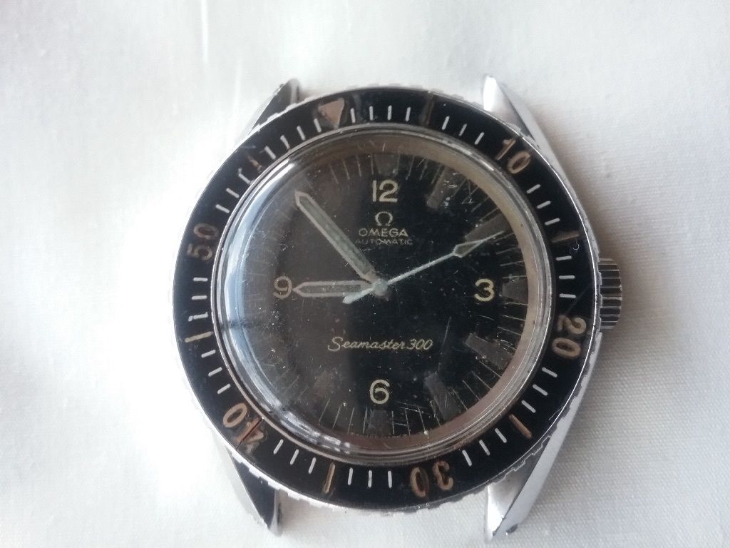

    Is this bezel legit with the round triangle edges, round 3, etc.? The watch is from 1965... thnx guys!
  2. Shabbaz Jun 11, 2019
    4,880
    17,830
    I have the feeling it's a fake bezel. Cant seem to find a similar on the web...

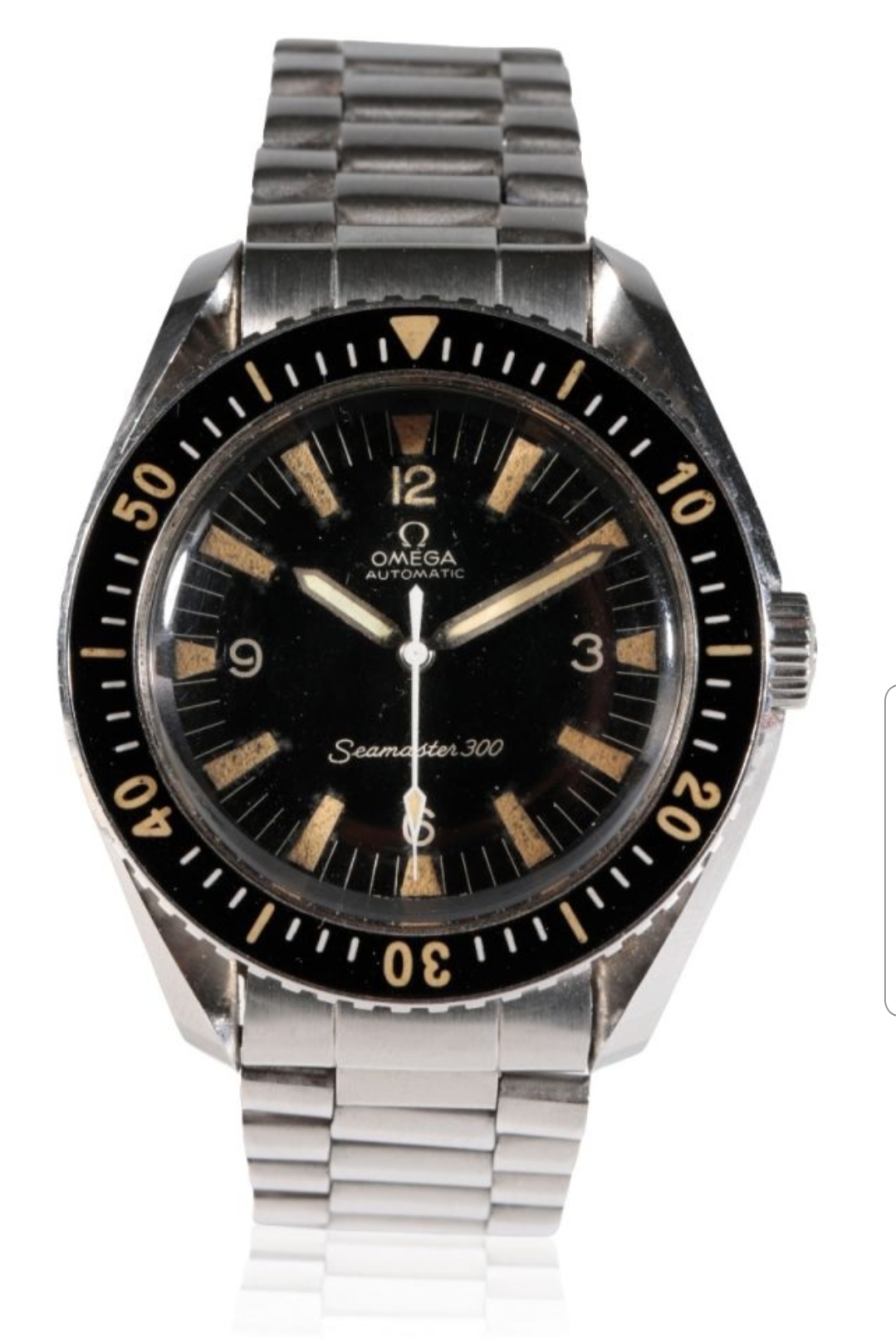

    Need the reference number to answer if the bezel is correct. To,me, the OP bezel does appear to be a “B” shown below.

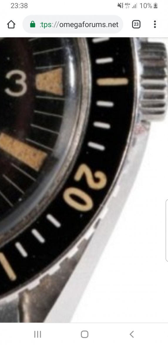

    Text on B is a lot thinner right? Or is it my imagination?
  6. Shabbaz Jun 11, 2019
    4,880
    17,830
    Or am I getting paranoid...:D

    Here’s another example of the same bezel type.......I think.

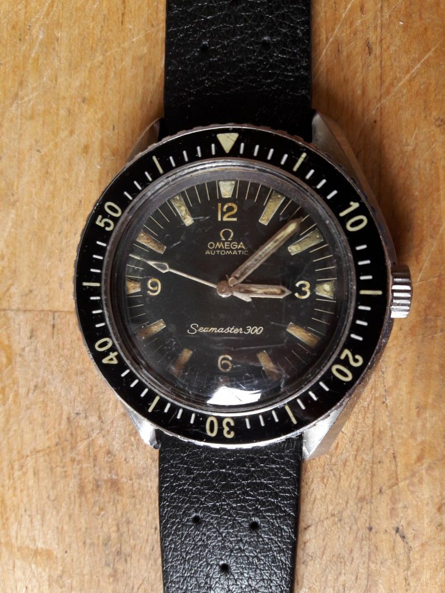

    A beat up one as well

  14. Dgercp Jun 11, 2019
    1,072
    1,454

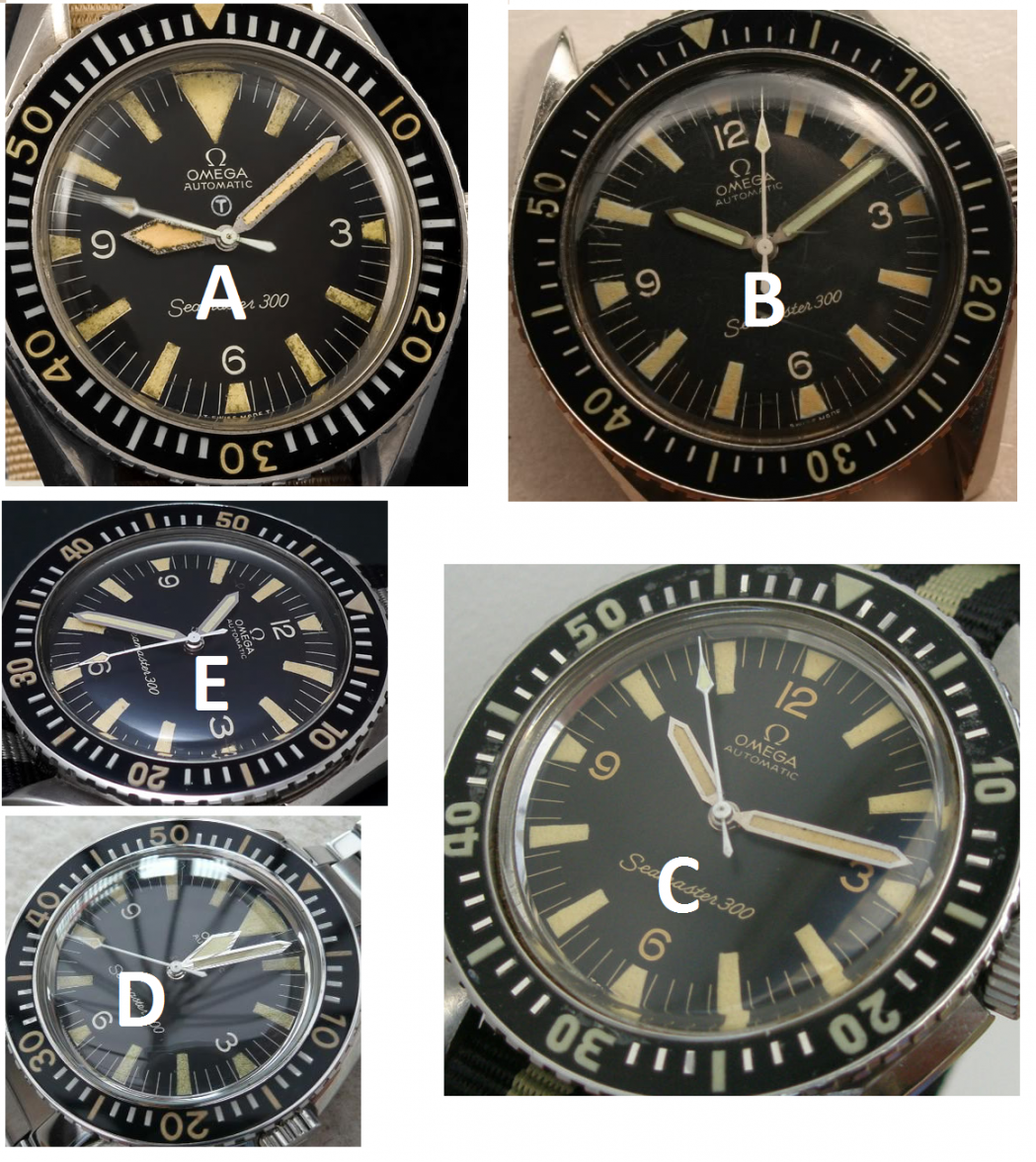

    Am I confused or isn't OP bezel a type A? which should have -63HF caseback, serial 20,xxxx.

    According to these charts you are correct. Here it’s labeled a type A but I have seen this “type” on both 63 and 64 references., one of each shown above. Perhaps when @Dash1 and @kox finish their upcoming book, we will have all the answers:). They can also have the honor of assigning THE letters to the various TYPES

  16. td69 Jun 11, 2019
    440
    433
    Looks to me a legit Type A bezel seen mostly on 165.024-63 HF. I have observed two serial range on the -63 being 20,3xx, 20,6xx and 22,49x. The 22,49x I have seen the dial with the asymmetry "T" added.
    It is true that the "20" on the OP's looks just a tad thicker although I never heard of a repo type A.

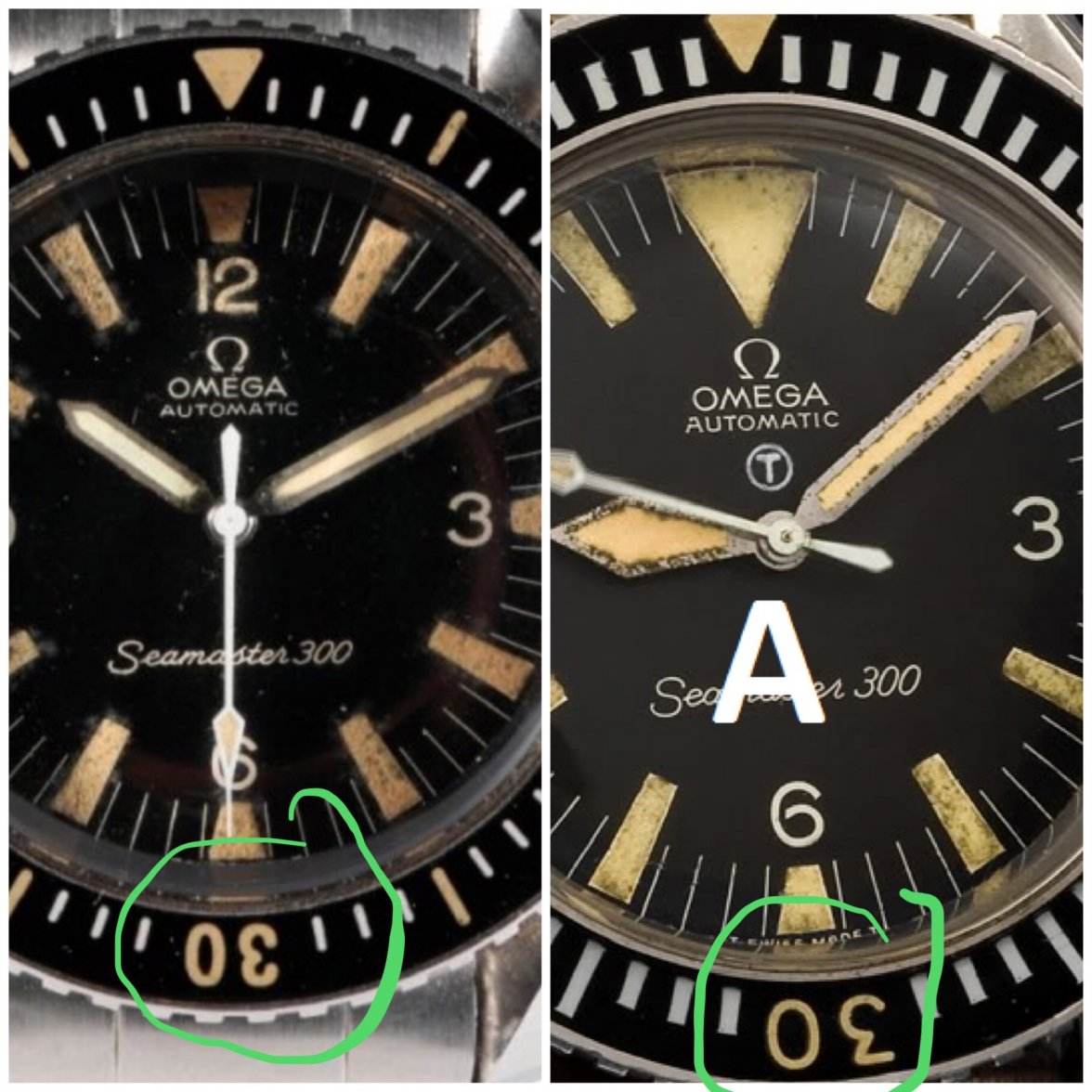

  17. Baz9614 Jun 11, 2019
    2,070
    23,159
    Compare the 3s. It does appear to be a B. Left is the OP, right is the A with a flat top 3

    I am using the chart @gemini4 just posted. Didn't know about another chart :). But A or B we are all saying the same thing.

  19. Baz9614 Jun 11, 2019
    2,070
    23,159
    And when I look at these charts, I agree it appears to be an A! ::confused2::
