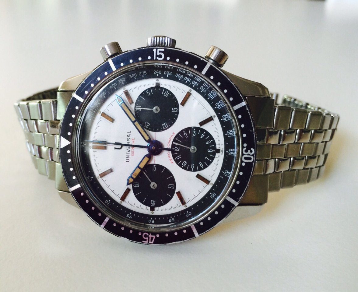

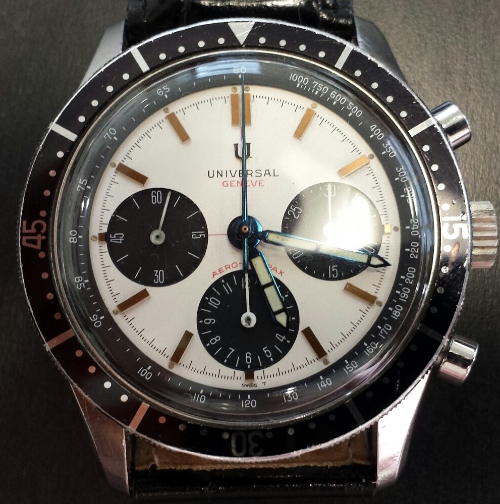

Type A 12HR (photo credit m neuman I think)

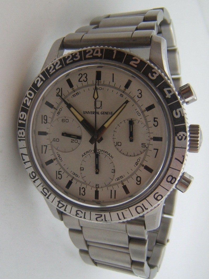

Type B 12HR (photo credit unknown)

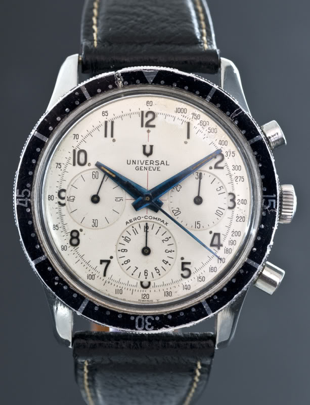

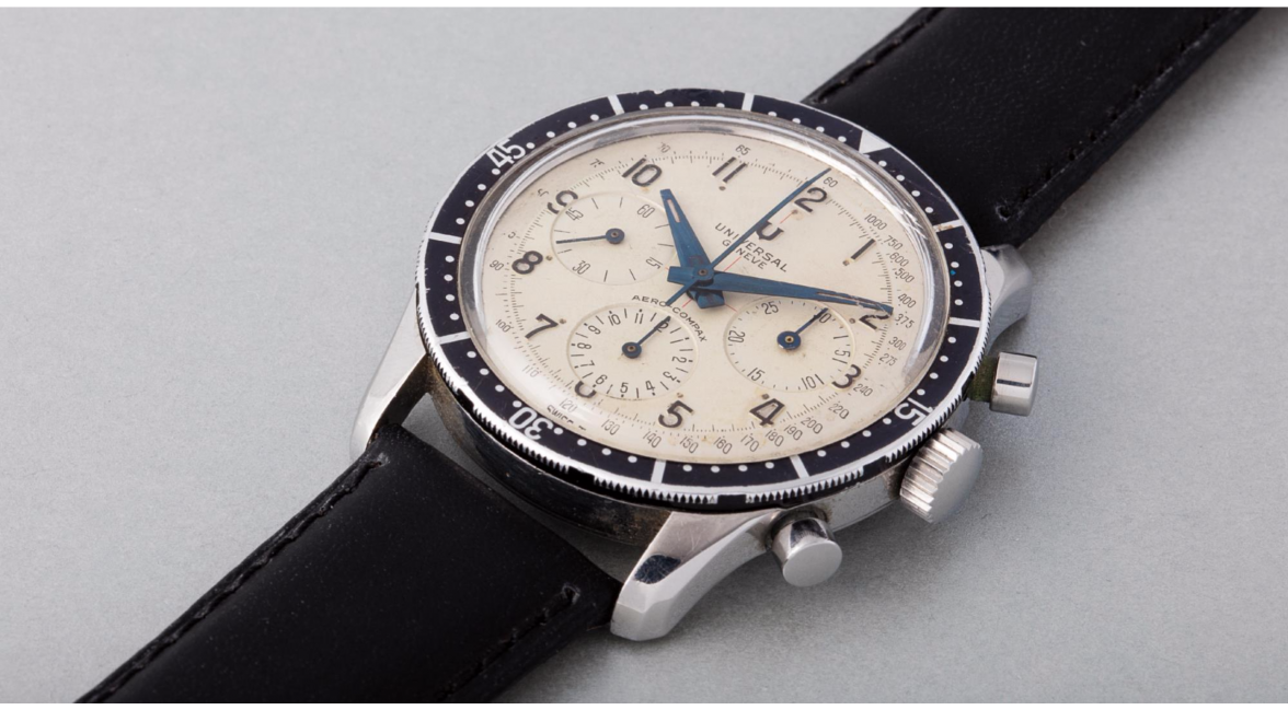

Type C 12Hr (photo credit Paul Gavin)

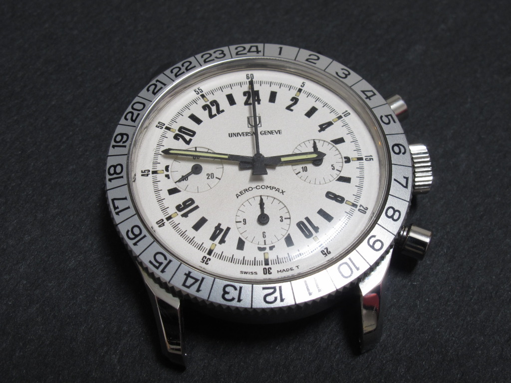

Type D 24HR (photo credit j-luc)

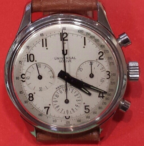

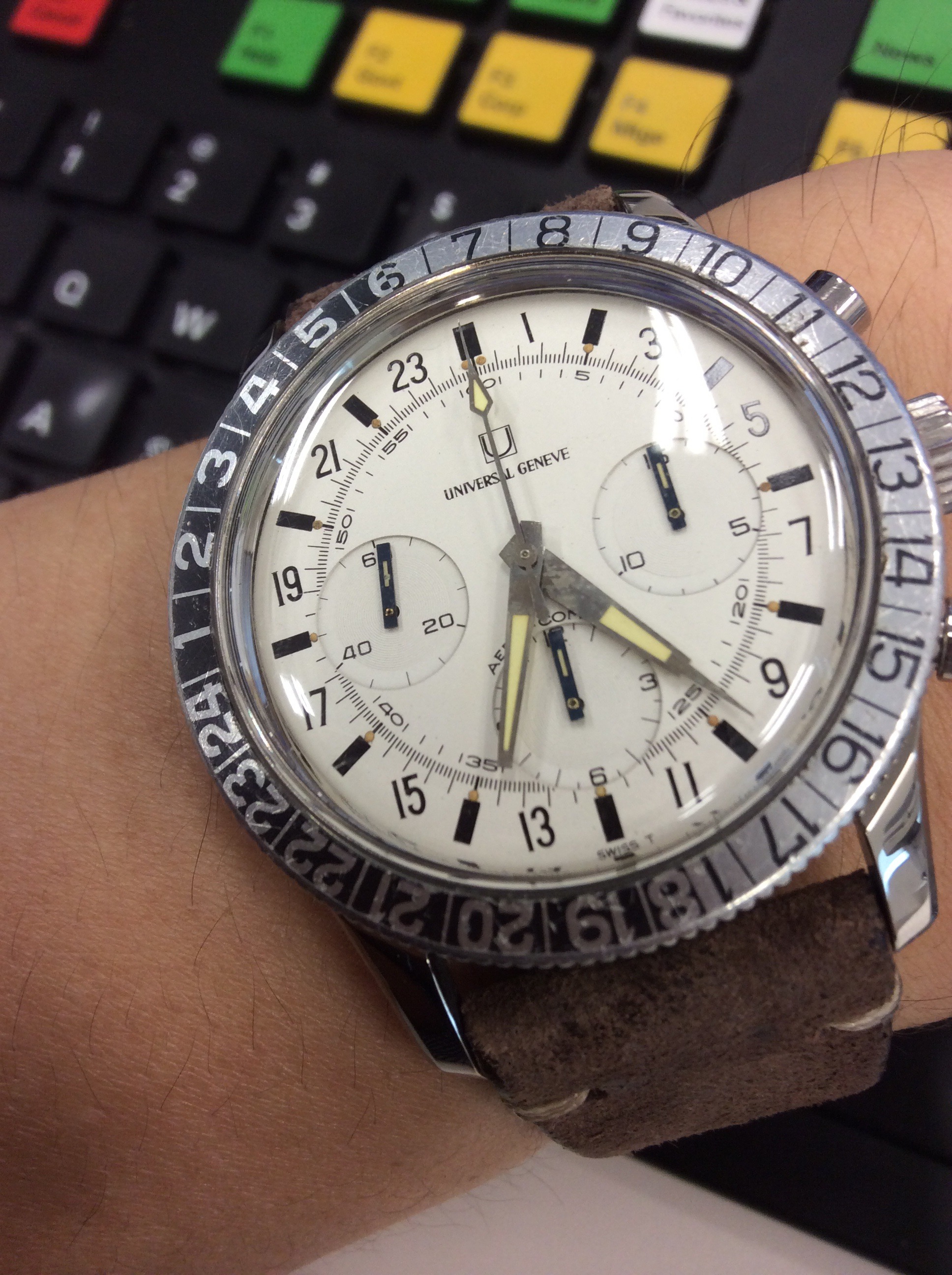

Type F 24Hr Ref 890100/01 per woodwkr
anyone got anything else?
1,366
865
Type F is ref. 890100/01
Dimensions: 48 x 41mm w/o crown, 43mm w/crown
Crown: Shield "U"
Crystal: ?Unsigned
Movement: UG 90, a re-badged/co-badged Venus 178
Serial Dating: 1963-1965 (per 100 ans)

My own physical exam.
Pics to come when she's presentable.

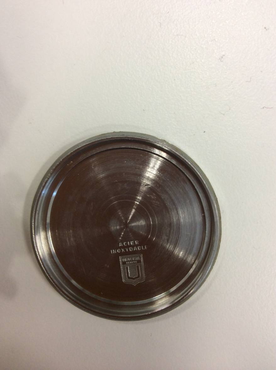

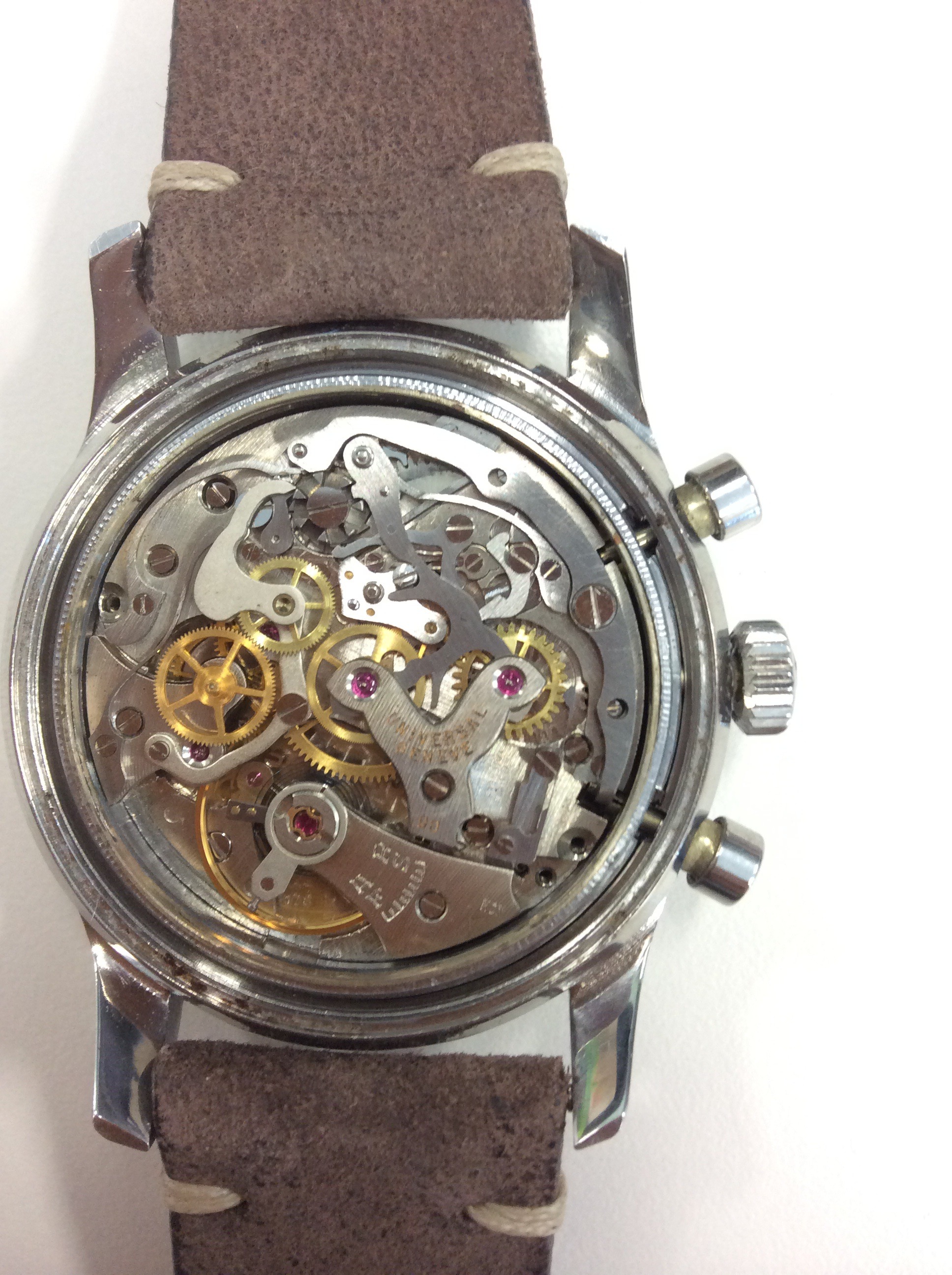

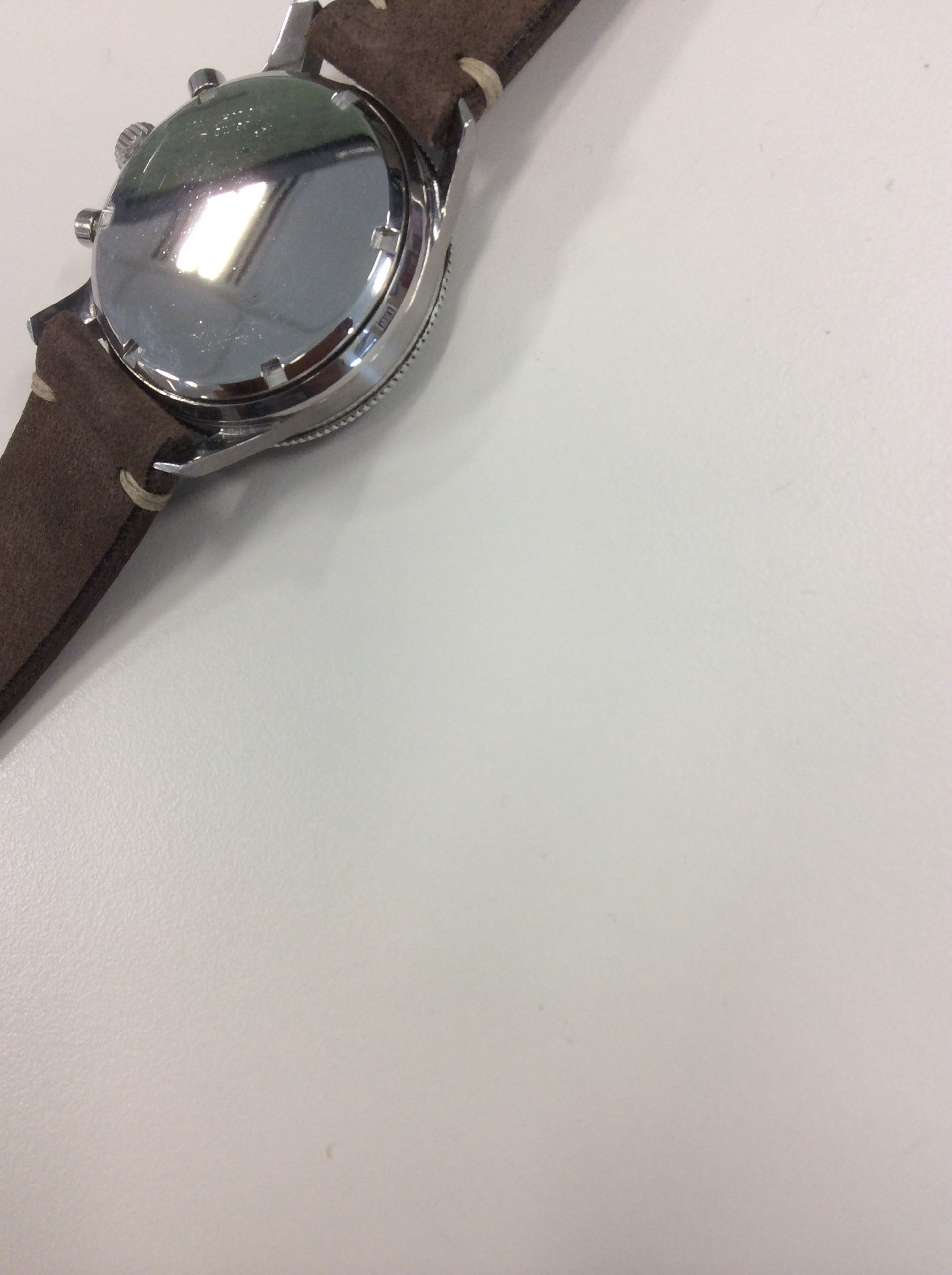

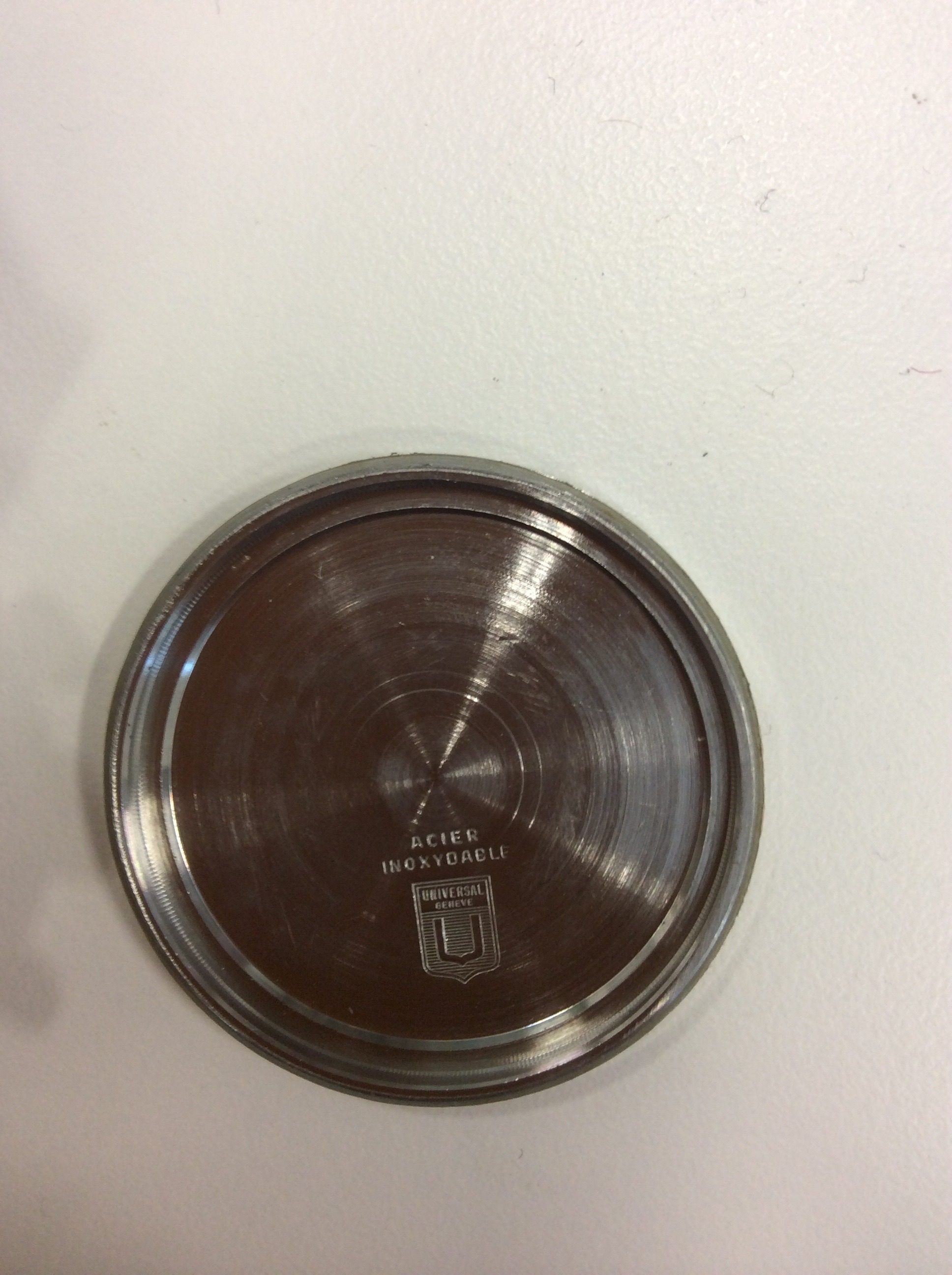

Just thought about adding some movement pic as received mine today, the engraving in case back has faded but still viewable (sorry for the iPad pic, I am really no good at taking pictures). And I am not lucky enough to have the original crystal 😜

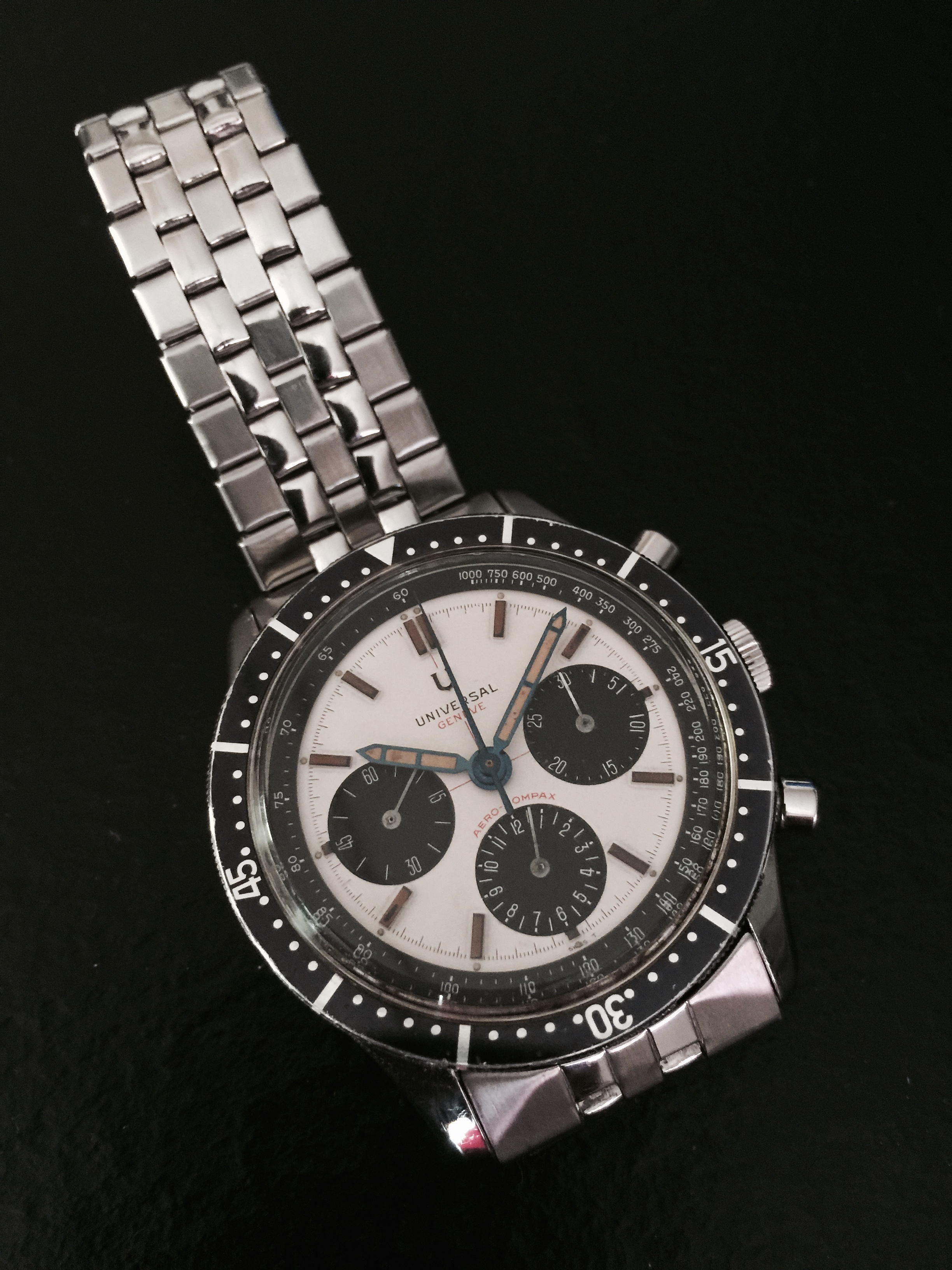

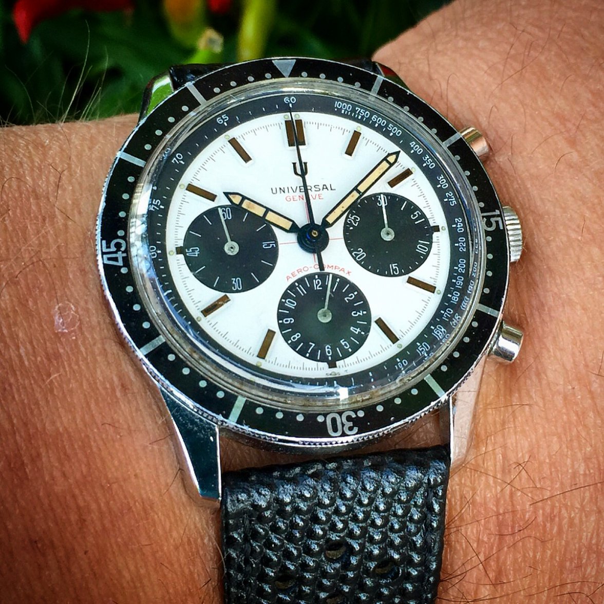

this is mine
(Type B) 12-hour two-tone dial - ref. 22704/3 sn 2358253

this is mine
Great! Thanks MoS, now we have reference number and case number for one of the types - that'll help us establish a temporal order. Can anyone else fill in additional information?

Let's add in the Type C from the Phillips auction yesterday.That one turns out to be a Ref 22703-3, case number 2357944, so it actually precedes our type B.

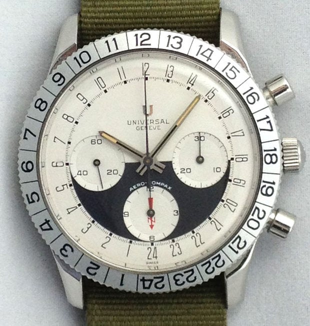

The first one of the family... with band and correct bracelet
I mean that's the UG V72 most rare today
GIGI
6,713
18,566
GIGI
GIGI,
what is the reference number for this watch?
