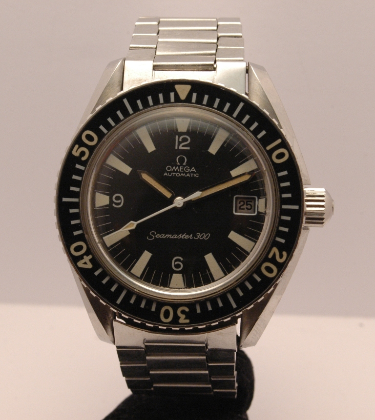

Very nice example 😀
I am however wondering how the color difference between the hands and dial can be explained?
Dial and hands is not lumed together. They may not even come from the same factory.
Over the years the color, even if perfectly matched when new, will age differently.
Thanks and the others as well!
Did not know this and thought they should always match perfectly.. This makes collecting vintage watches even harder 😉

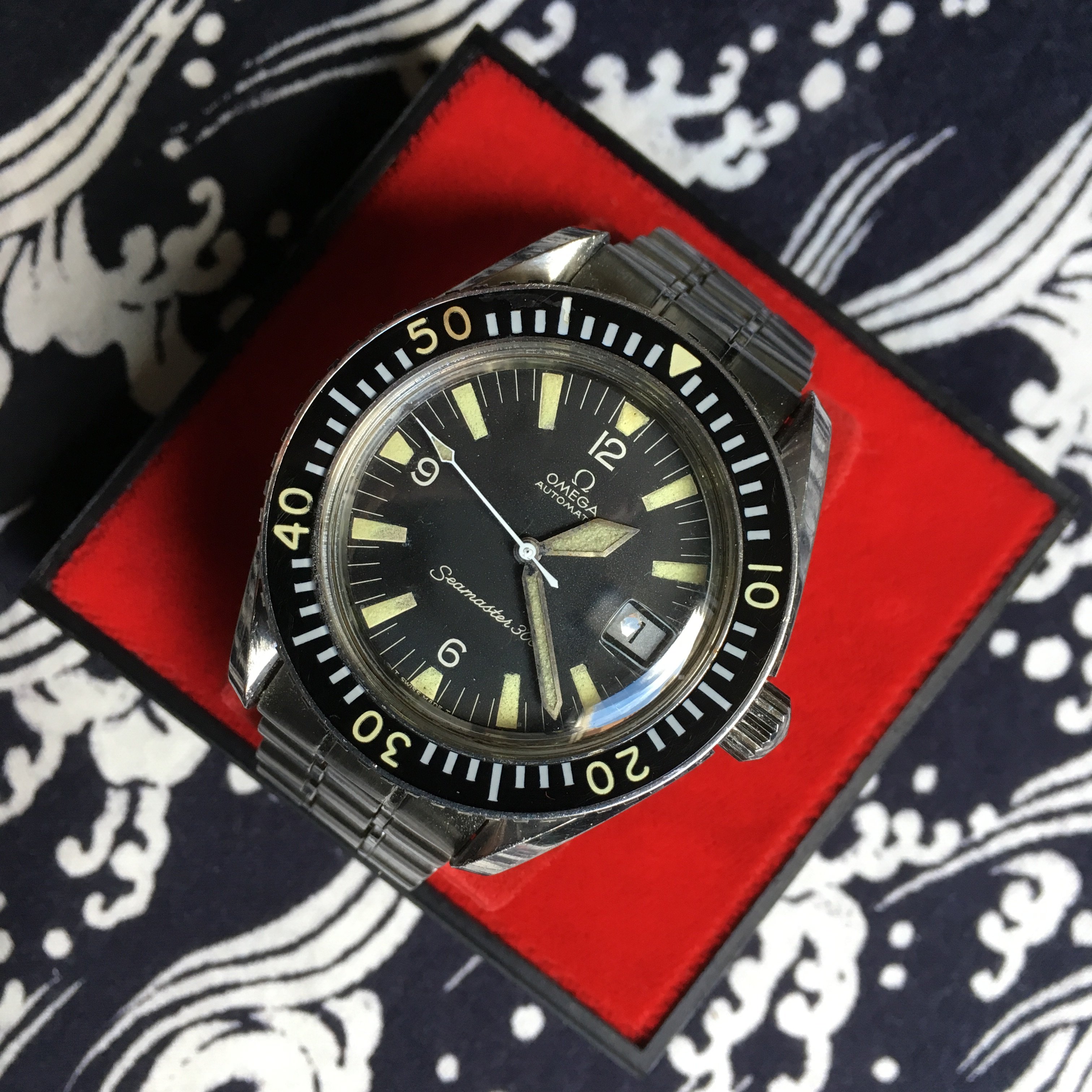

Another 166.024 with cyclops, 1116 bracelet, white disk and matching patina
1,818
2,579
What a lovely BT, looks like I could (not for the first time), be wrong about the cyclops crystal.
Is the bubble inside or outside?
FYI my "mismatched" BT SM300 looks matched in some light, but you really notice in natural light.

Very nice example 😀
different surfaces and materials. quite normal appearance . very nice watch. kind regards. achim
