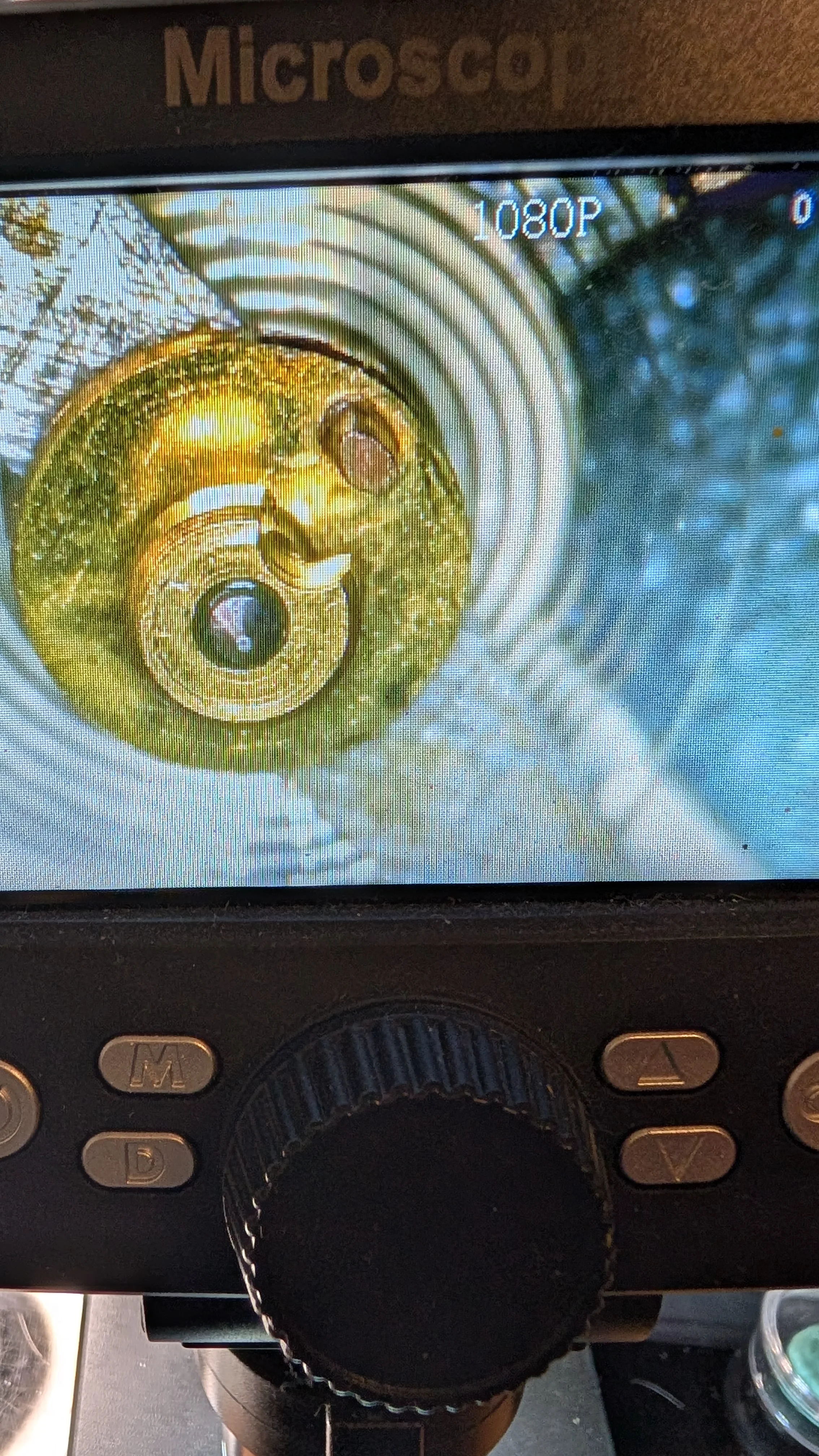

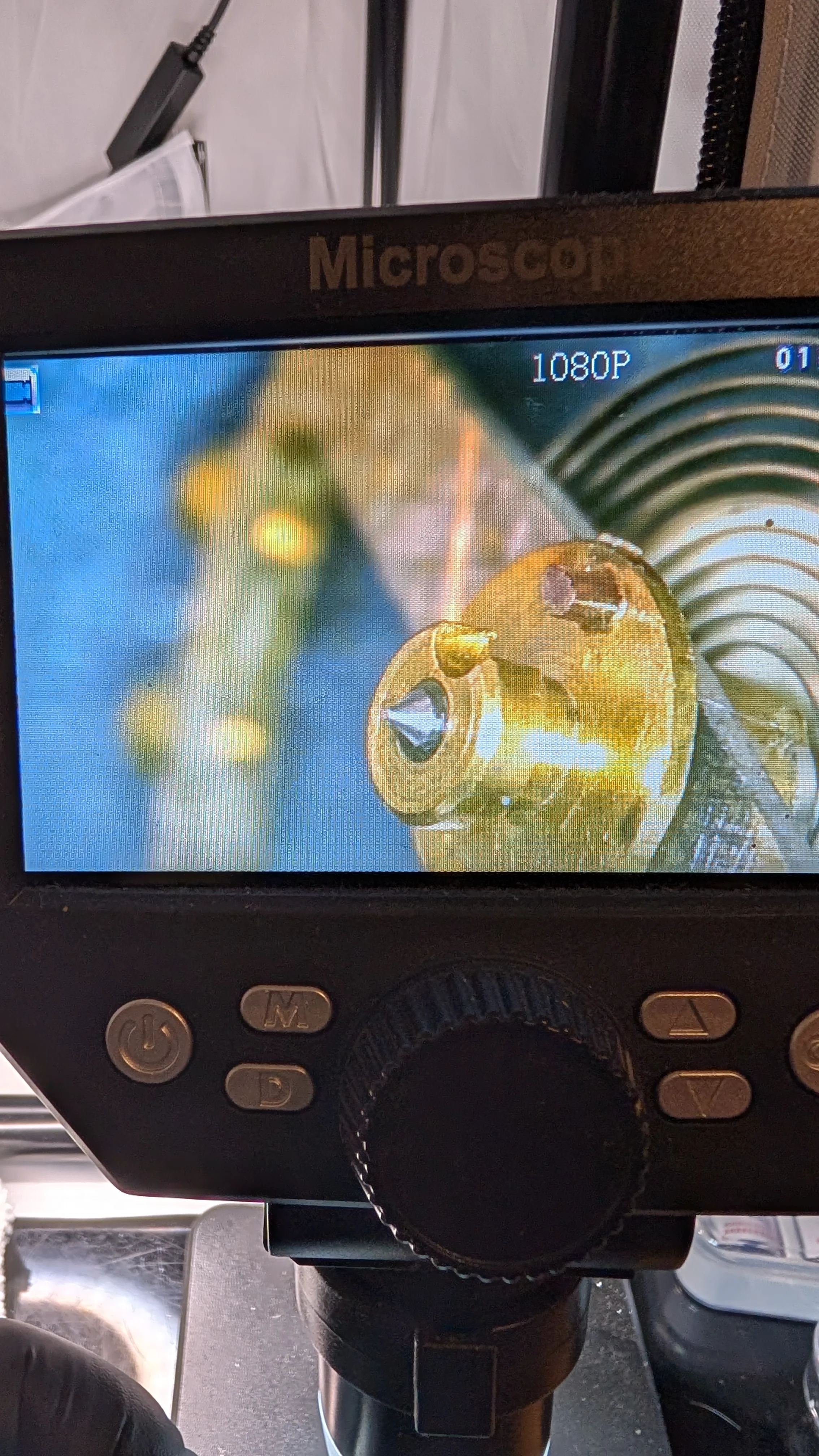

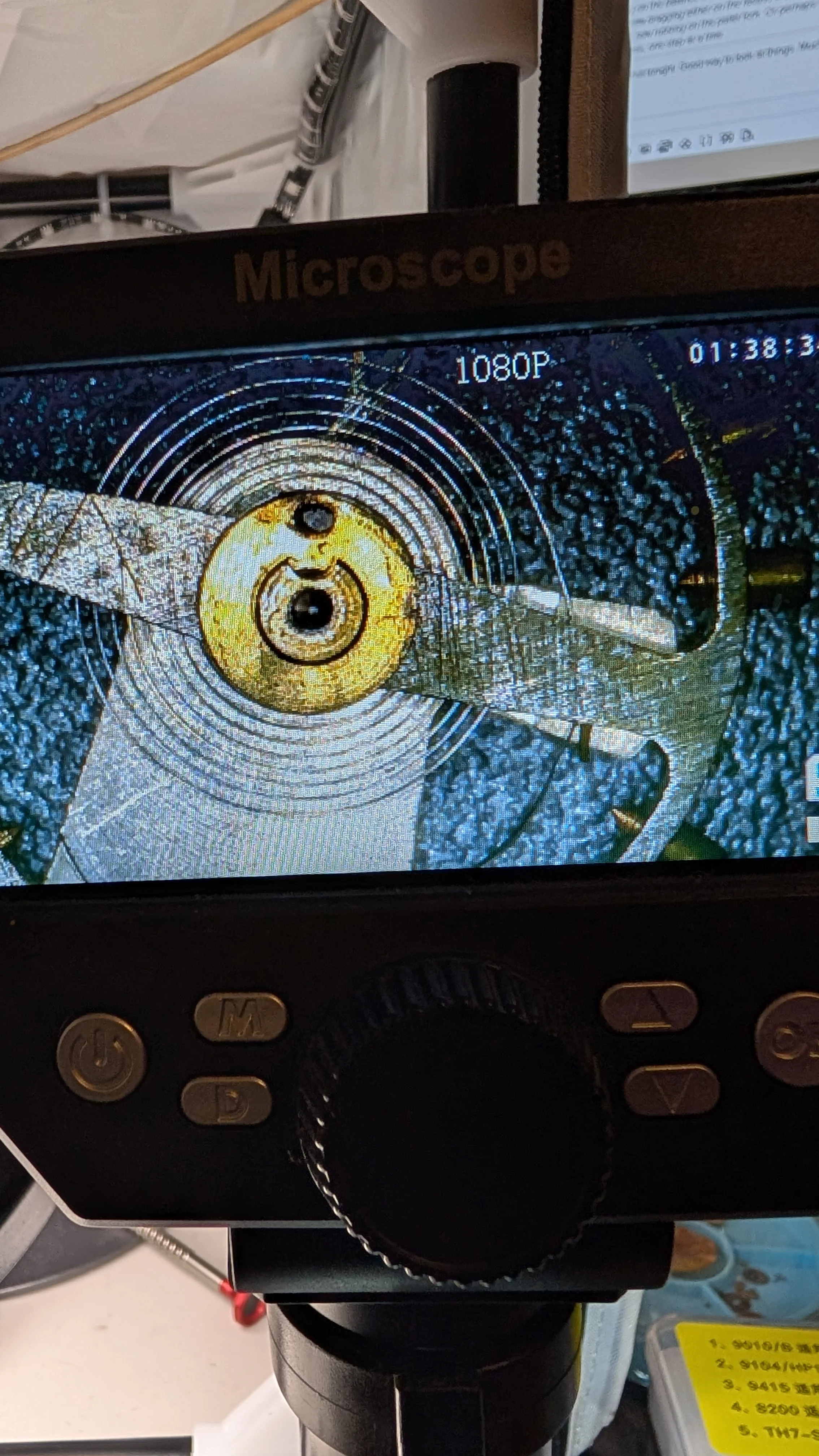

Ok. De-magnetized it. Installed balance by itself and I realized there is a lot of play and it's not as free spinning as I'd like. I think I'm going to take it all apart and give it a much more in depth cleaning. Like I said, this thing was dripping old lubricant. Pictures and videos for reference. If anyone sees anything I'm missing lemme know or any other ideas. I did not see any shims of paper.
