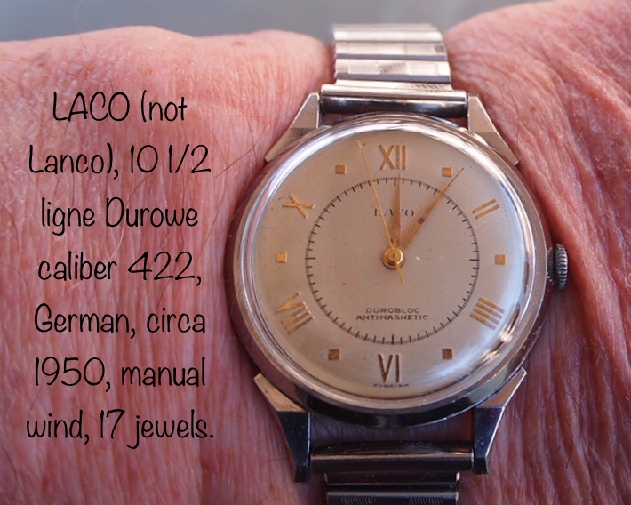

I’ll have a better idea once I see inside the case back. But I’ll go out on a limb (again), and offer the opinion that the crown with the Bulova name was put on at a time the watch was serviced. As to the LONDON, and the word FOREIGN? I have a Durowe movement behind a dial that is marked TOURNEAU (an American firm), but with a dial marked FOREIGN! Until I’m proven wrong, I’ll say the movement (if not Durowe) could be Laco, or another German firm. Private label watches are often an assortment of off the shelf components, and can give rise to some peculiar combination.
I have a Laco which is German, and also affiliated with Durowe, which is marked Foreign below the 6.

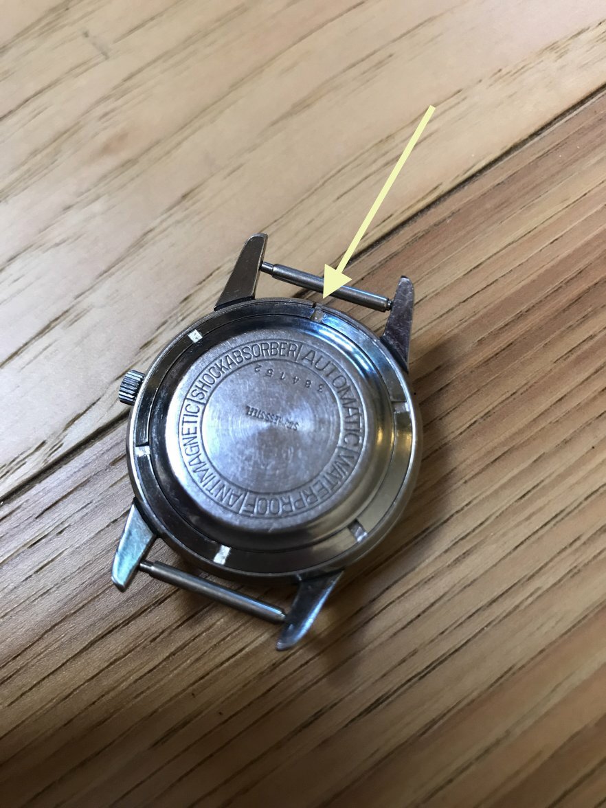

You need a watch caseback ball remover.
With this type of back, the ball is unlikely to work. If you will notice, the case back is keyed to the case as indicated by the tip of the arrow in the attached photo. It is a two-piece back, with an external threaded outer case ring. The back does not turn on the watch case.
2,623
7,336
Damn you are absolutely right.
A ball is good to have, but will not help you here.
