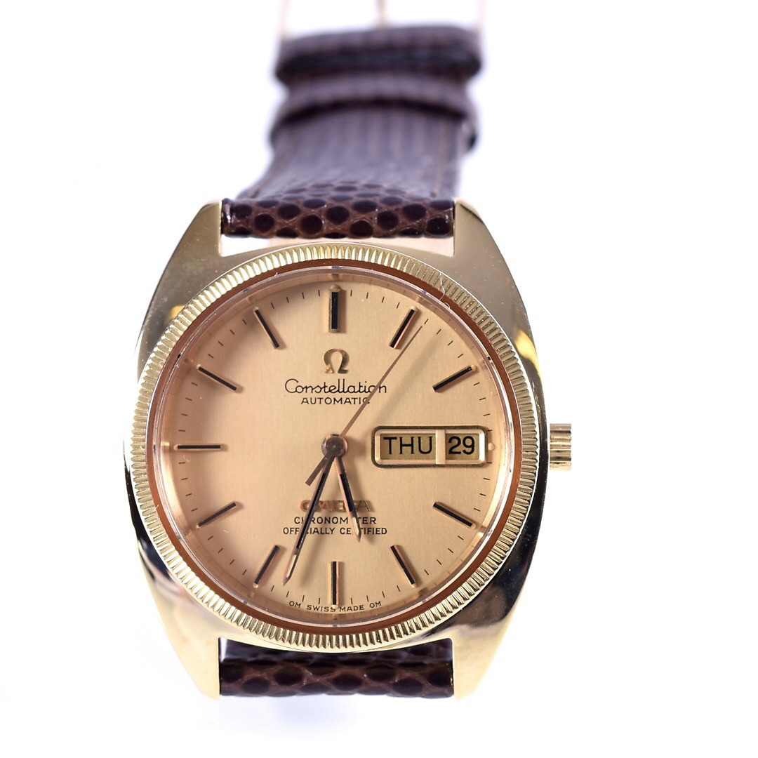

Hey there ...Just wondering...
I’ve recently acquired an 1969-70 Constellation Day /Date Chronometer. The one thing that I noticed was how different the markings are on the face. The graphics seem a bit different compared to most Connie’s
I have seen from around that time period. Note that the “Constellation “ graphic is centered right below the
Omega symbol. The Omega graphic is on the lower part of the face. Anybody know how common or not that is? Most that I have seen- have that reversed. Is that limited to the day/date version and that particular
Year of production. Hmmm...Opinions Please.

This one is a cal. 751, though. I believe the latest versions of those came with this set-up too.

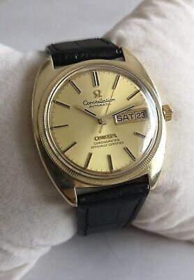

This reference (Ref. 168.029) used both dials. Here is another example:
https://www.mywatchmart.com/listing...onstellation-c-shape-168029-625/#&gid=1&pid=8
Hope this helps,
gatorcpa

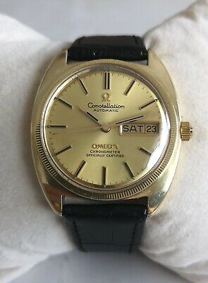

I can just second this! If it would have been a 1021 there should be a separator between day and date. Like on my 168.057 here:
