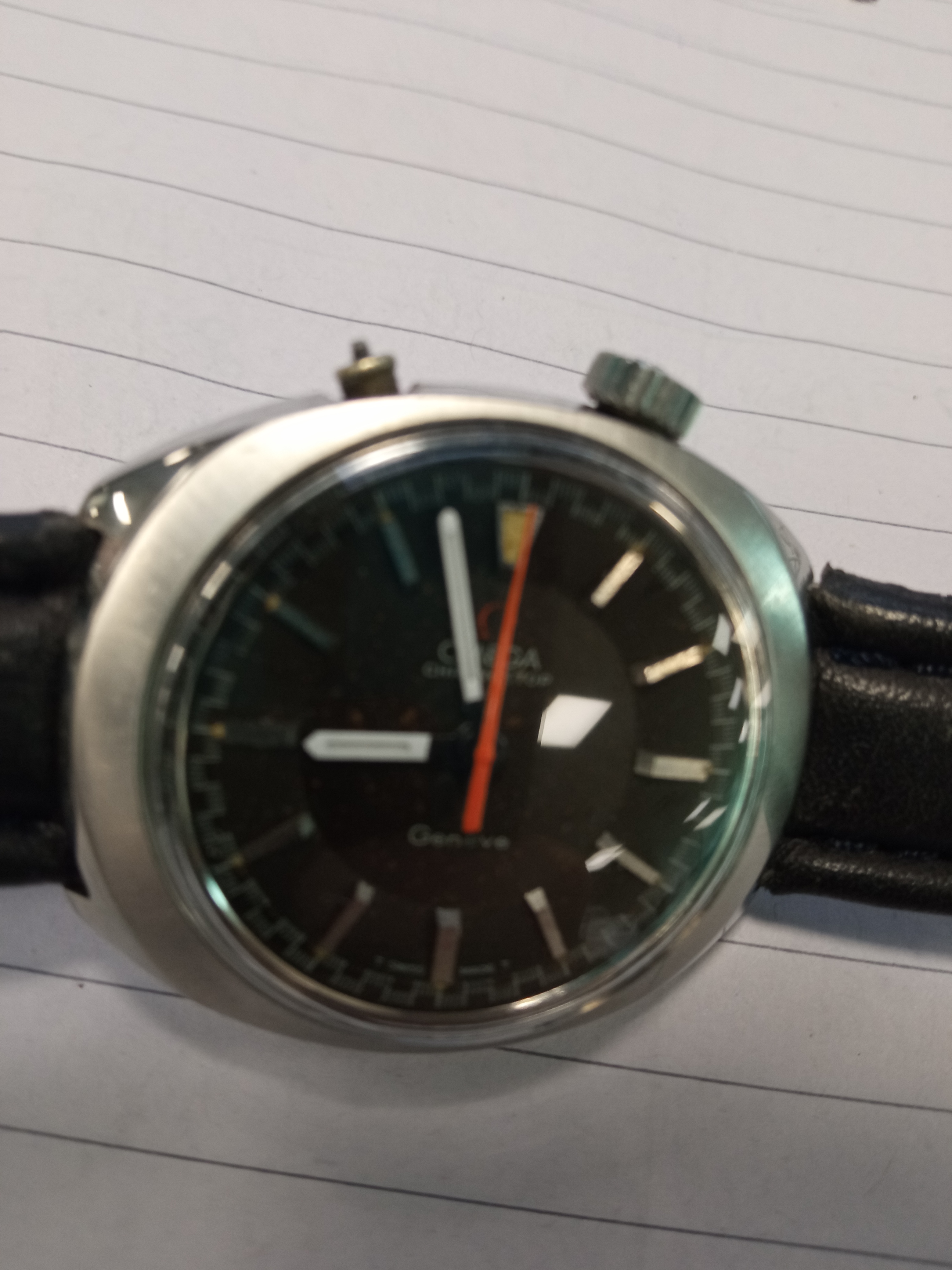

Just bought a project Chronostop
969
3,978
Good news for you, friend. I bought a Chronostop last year where the pusher had been replaced by a soldered on crown. It was a mess. The rest of the watch was fine.
I was able to get the part number and my watchmaker sourced a new replacement pusher with no trouble at all.
I believe the pusher cost about $60 ($CDN) and it was installed along with a service.

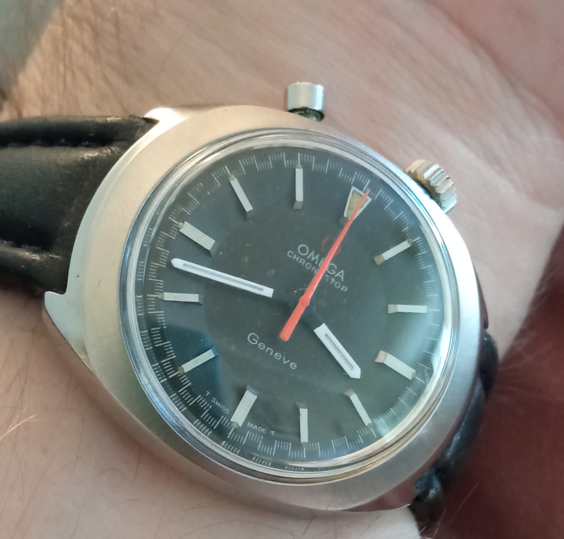

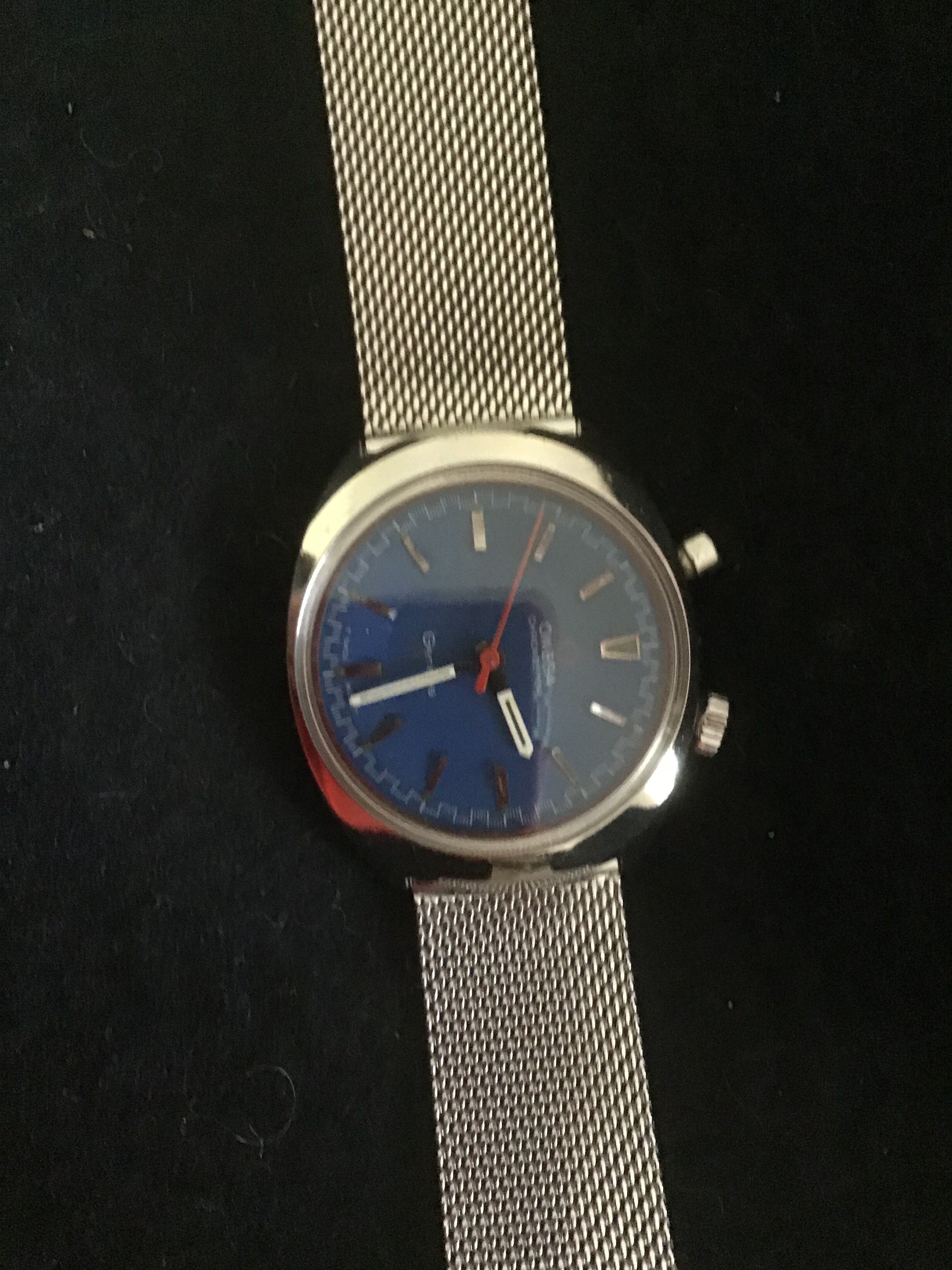

Nice to see someone else joining the Driver club. Mine was also my first vintage watch purchase.
I can’t help with sourcing parts but of all the guys here who would know or advise I’d ask @Archer. He’s a professional and has access to Omega parts lists.
In the meantime, here’s mine, for reference. (Which reminds me, must take a better shot of it)

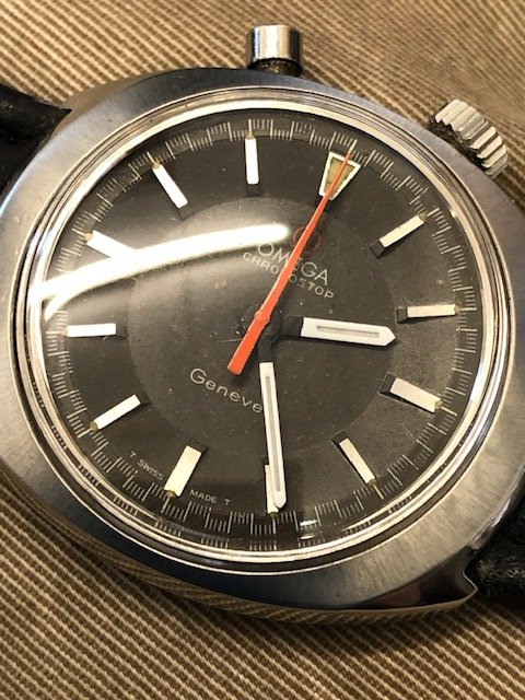

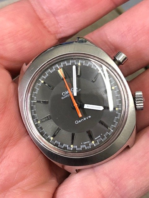

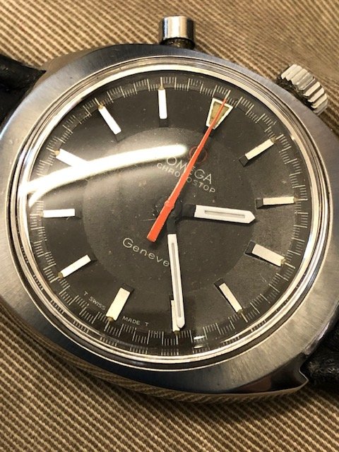

The new dial arrived and my watchmaker sent me some photos. My initial impression was what a transformation but something was off. Then I realized the dial is rotated 90 degrees anti clockwise. The watchmaker is going to check but is pretty sure he had fitted correctly. Something about pins. Now I'm thinking that maybe I was sold a 146.009 with the dial rotated 90 degrees and glued in place?
What are the differences between the 009 and 010?
Is the case a different shape? Have different markings? Help @Claven2 @Archer pls

The dial sets the orientation relative to the crown.
There are two pins on the back of the dial and they fit into two holes in the movement. The holes in the movement are always in the same place relative to the crown (for this calibre, as other calibres have the holes in different locations - there is no standard).
You've fitted a 009 dial to the movement so the crown appears at 4 O'clock (approx). If you fitted an 010 dial then the crown would appear at 1 O'clock (approx).
I suspect you are right and were sold a 145.009 with the dial feet removed and the dial glued on so it looks like a 145.010. I couldn't say if there are case differences between the two.
Good luck, Chris

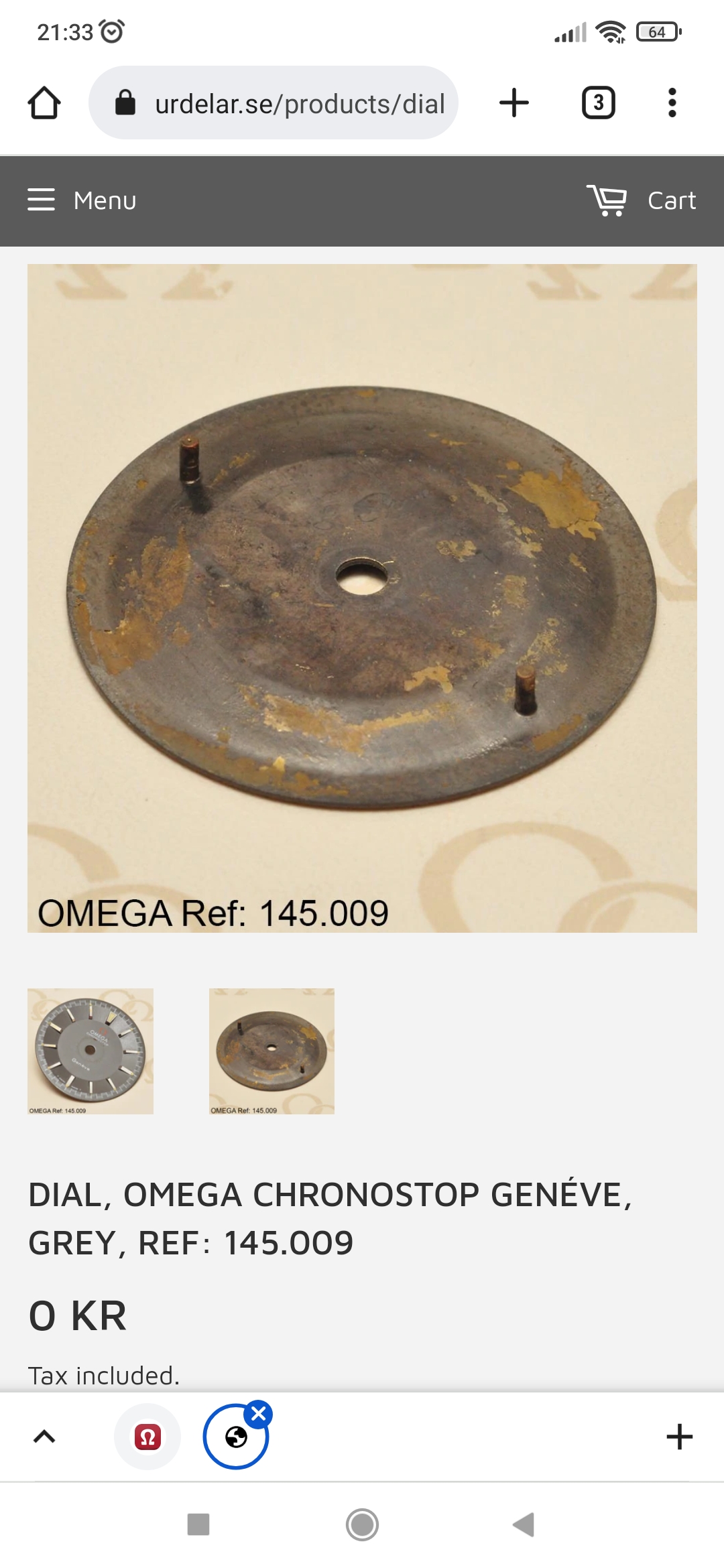

Thank you. That is a lot clearer. I guess extra holes where drilled in these movements to rotate the dial. Which was easier/cheaper than making another batch of dial with pins in a different location. The advert claims the dial is good for 009 and 010

I think you've misunderstood me - they didn't drill extra holes in the mainplate for the rotated dial feet - the 865 mainplate is the same wherever this calibre is used. As I said, the dial sets the orientation relative to the crown.

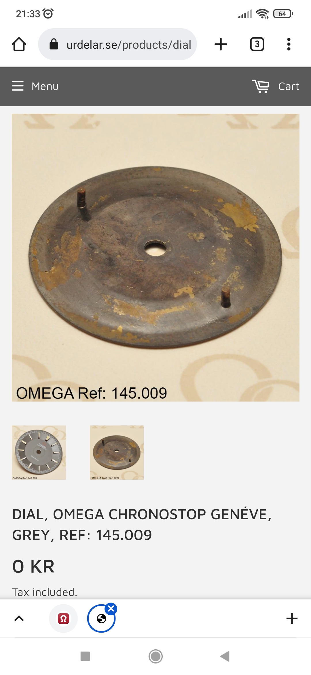

Urdelar sold you a 145.009 dial and that shows in your picture. I take your point that reading the advert, it says:
DIAL, OMEGA CHRONOSTOP GENÉVE, GREY, REF: 145.009
But, underneath it says that it fits 145.009 and 145.010 - which it does, although it isn't correct for the driver version as the dial feet orientation is wrong. It is correct for the 145.009 which is how they advertised it.
Cheers, Chris

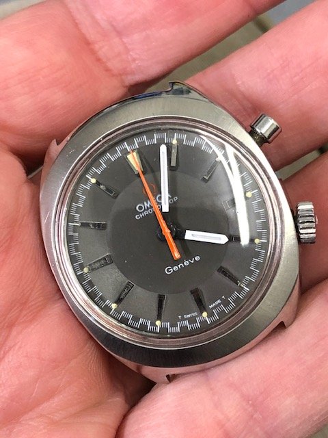

The case and hands look so much better
384
2,906

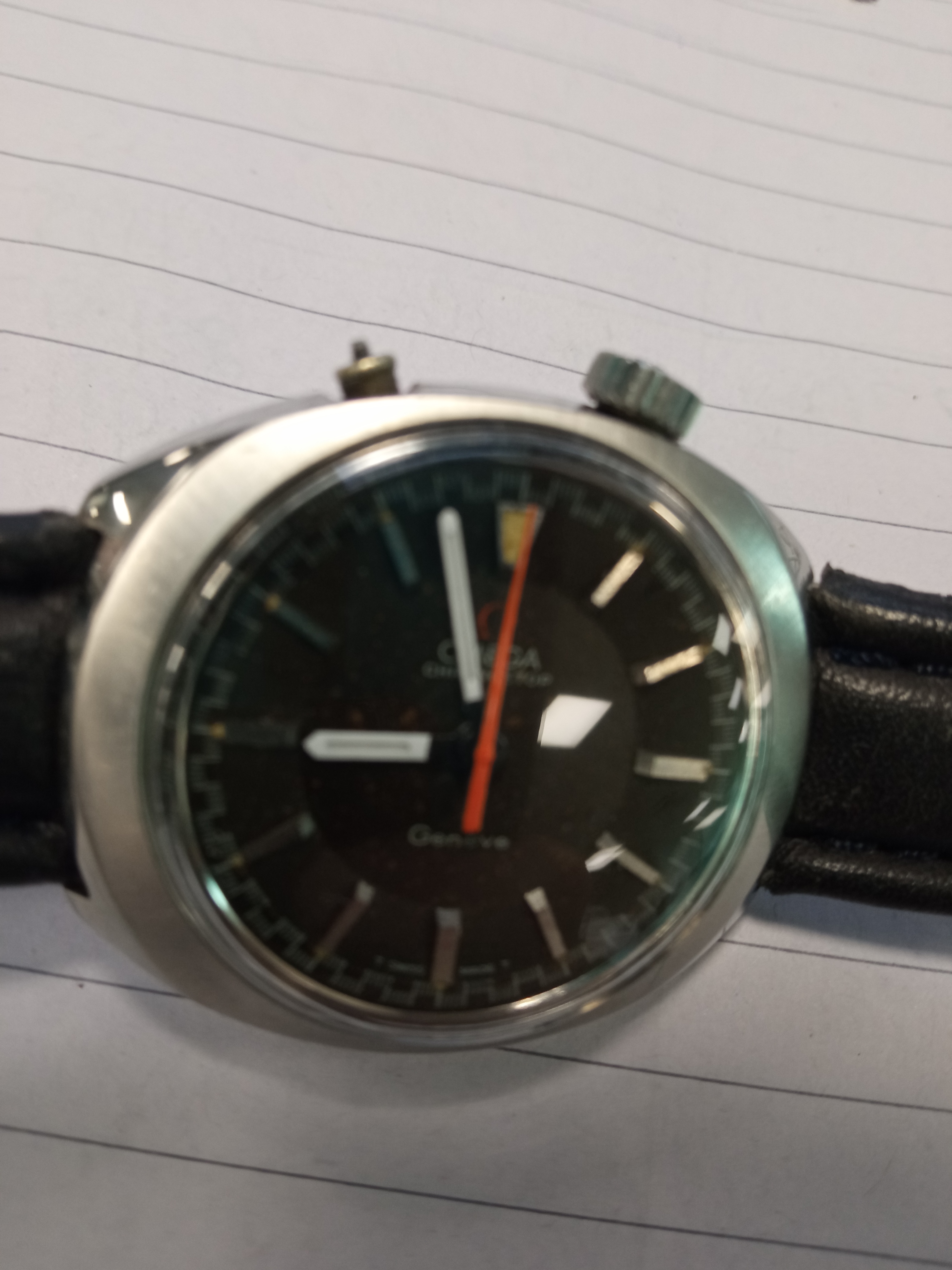

It has arrived. The seller was great and the watch is as described. Given what has been happening in Turkey recently I hope the seller choose the right day to exchange his EUR to TRY. I've put a leather strap on it and will wear for a day before sending to be serviced and cleaned. I need to do some research on the hands
JFC that watch looks horrific. Thing is with vintage Omega, be patient and don't just buy anything. I went through the same situation. Bought a bumper with a gorgeous dial only for it to rattle in the case. Something with a broken pin and the movement was so dirty in person. I even sent it to a self-taught watchmaker who was not competent and put a poorly fitted crystal on it. That watch was a nightmare... things got worse and worse... just like what's happening to you. Listen to your gut feeling and sell the watch as is. You will lose more and more money kicking the dead horse.

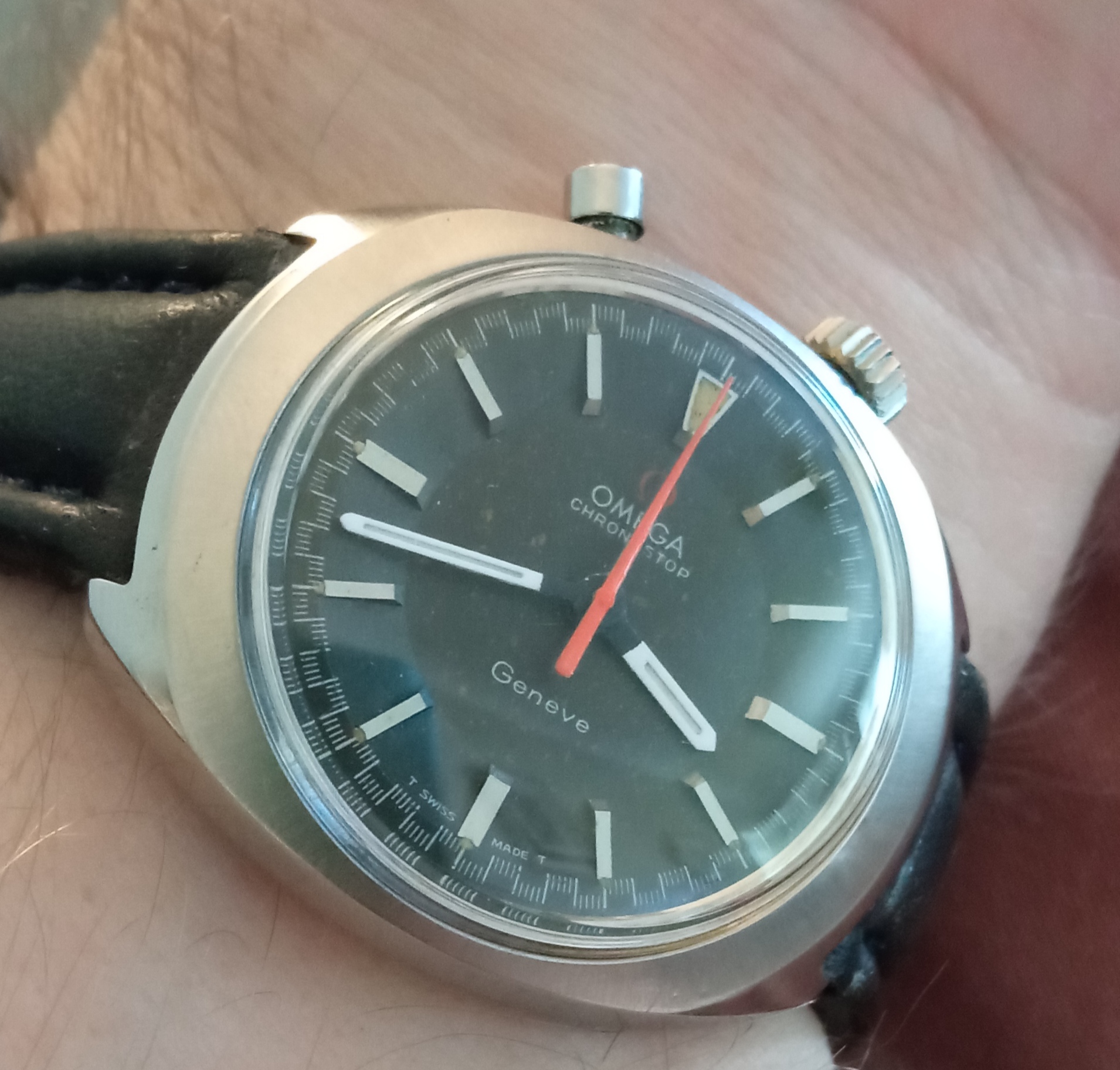

Got the watch back about 2 weeks ago. Despite what the previous poster says I'm happy. The watch is in much better condition than when I bought it. It's running nicely and I will continue to search for a 010 dial. I will try to sell the 009 dial I bought. I would be happy to advise on here but Ive not hit the 200 posts yet.
The only negative bit is the 90 degree rotation of the dial takes a bit to get used too
