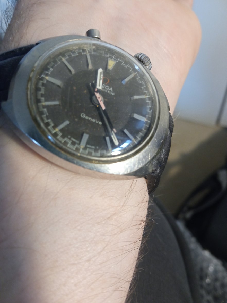

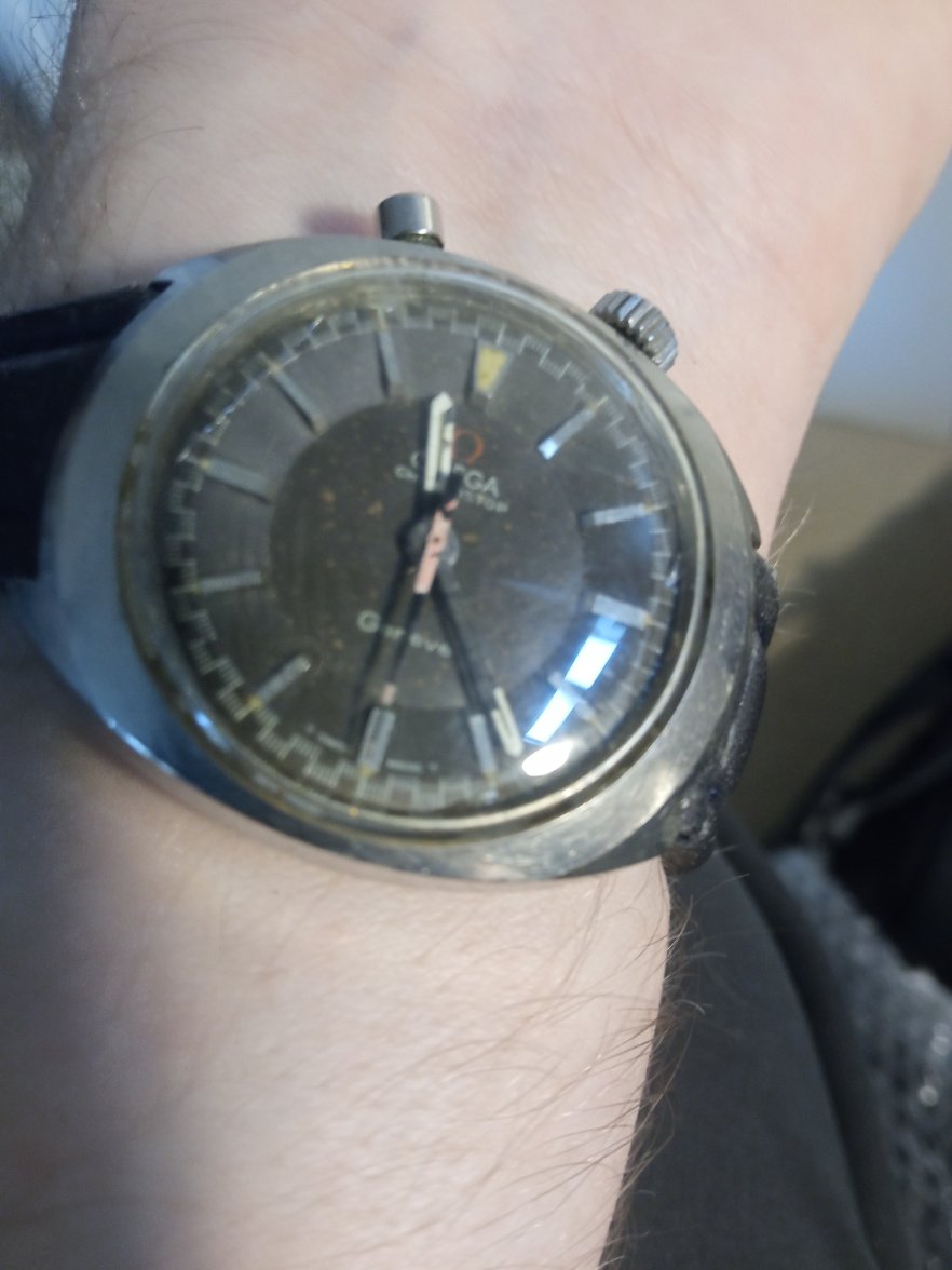

It has arrived. The seller was great and the watch is as described. Given what has been happening in Turkey recently I hope the seller choose the right day to exchange his EUR to TRY. I've put a leather strap on it and will wear for a day before sending to be serviced and cleaned. I need to do some research on the hands

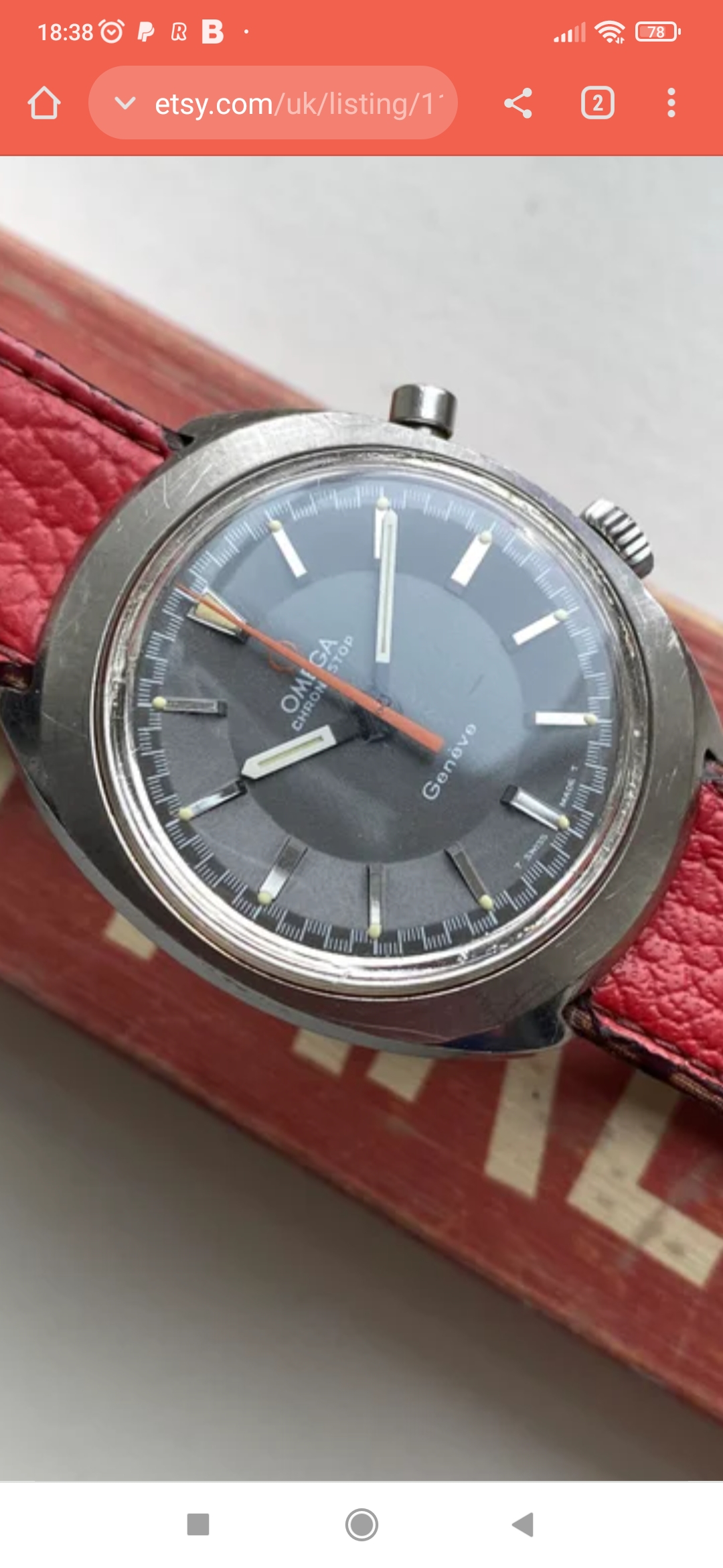

This is what it should look like. I wonder about getting the second hand recoloured
Not exactly. The OP's watch is the driver model. The non-driver is a different reference number. I forget which, but one is an 009 and the other is a 010. Case back is the same part number either way, and the case back reference number doesn't always match the dial variant.
Omega still sells NOS seconds hands, so I'd just put a new one on it.

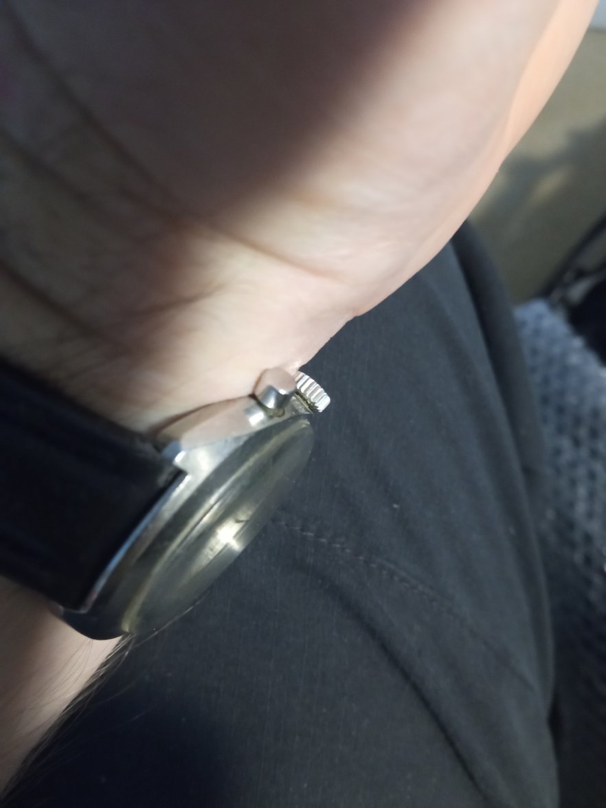

This is mine..i think i do not have the correct crown..
Great looking "jumbo" Chronostop. The angle of your photo isn't great but that does not seem like the correct crown. The crown should have knurled edges. Sourcing a new crown shouldn't be difficult.

Bad news. The dial has been glued to glass and movement. The watchmaker doesn't think it can be removed without damaging the dial. Therefore, no why to work on it. 3 options. Leave it as it is, find a dial or have the dial repaired.
I couldn't find any dials on eBay. Does anyone know where to find one?
792
845
In my experience, Chronostop dials and hands rarely come up. You might want to consider sending the watch to Omega to see if they can sort it out. If anyone has a dial, it would probably be them.

Bad news. The dial has been glued to glass and movement. The watchmaker doesn't think it can be removed without damaging the dial. .......................
Can't return it?

Let's see what the seller says about returning it. I think I might end up leaving it as it is and wearing it as a lesson!

Ok the seller gave me a partial refund. Im thinking now that either I get the watchmaker to cleanup the best he can now or risk him taking it apart. He is busy until the New Year so we will make the decision then
