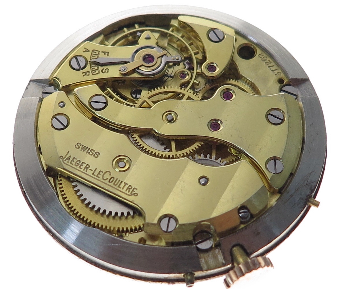

Dial looks very sharp for its age, but JLC retailed a few of these as late as the 1980's so the dial may be newer than the original production date. Not an issue. I have a JLC triple date with the same dial design, but without the moon. All hands look original, but crown looks like a later replacement. Most of these movements were gilt, this example is rhodium plated, just an interesting diversion.
Sorry - do you mind clarifying? My understanding is this is 18k gold, what do you mean by gilt and rhodium plating?
He is talking about the finish on the movement.
Movement finishing, not the case material. The movement is rhodium plated (silvery finish) versus the normal gilt (yellow gold finish). But since this was a gift to a long time JLC employee upon retirement they may have added a better finish to the movement than normal.
Here is how they typically finished these movements.
