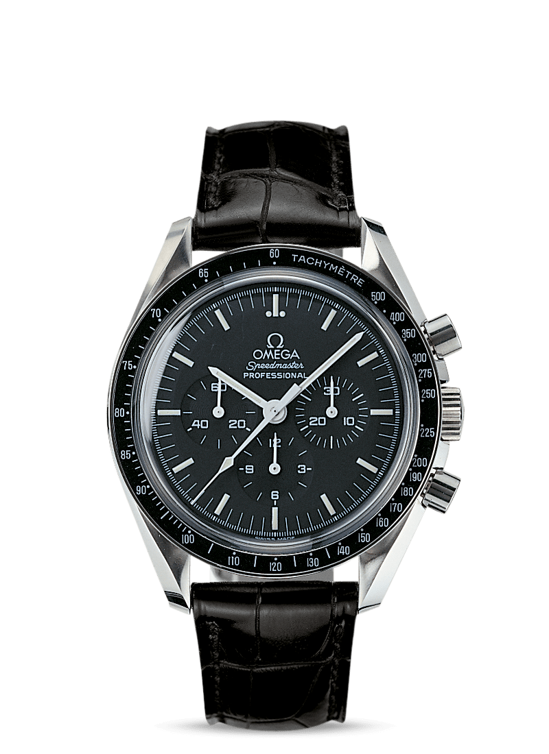

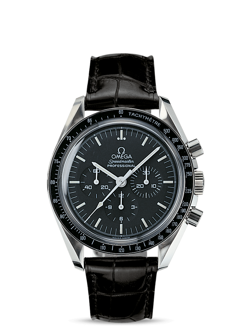

The reference on the cards is incorrect, should be 3570.4000. 3870.50 is for a standard Speedmaster on leather strap. Is the warranty card stamped by a Japan retailer? Although the serial looks OK someone could have looked for a standard Speedy in serial range and gone and done a dial swap.

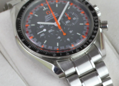

The paperwork suggests it鈥檚 a modded watch.

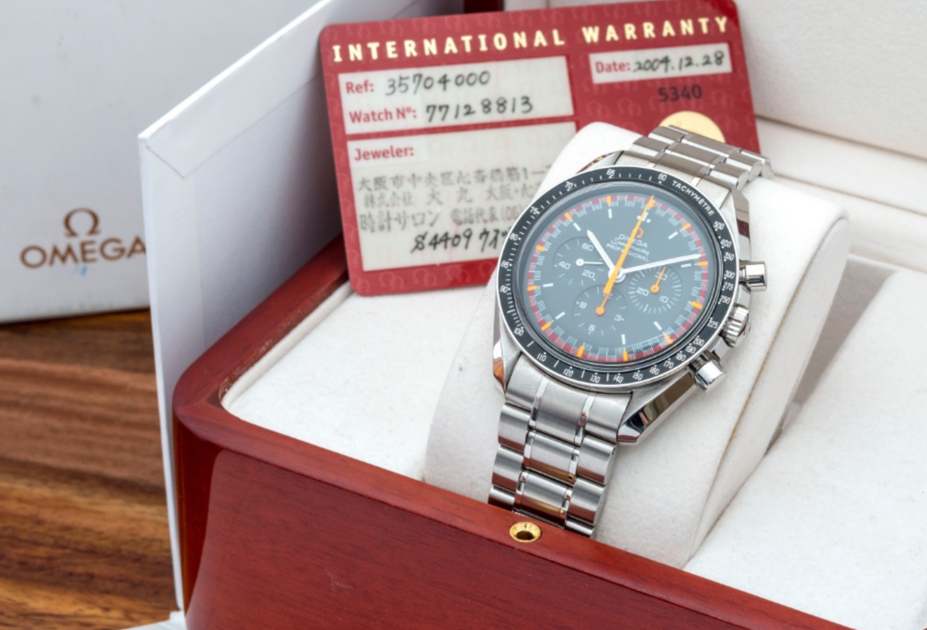

Other than your own watch, what other information do you rely on to state that 77133 is too high because I've seen a JR from a very reputable dealer with a higher serial?

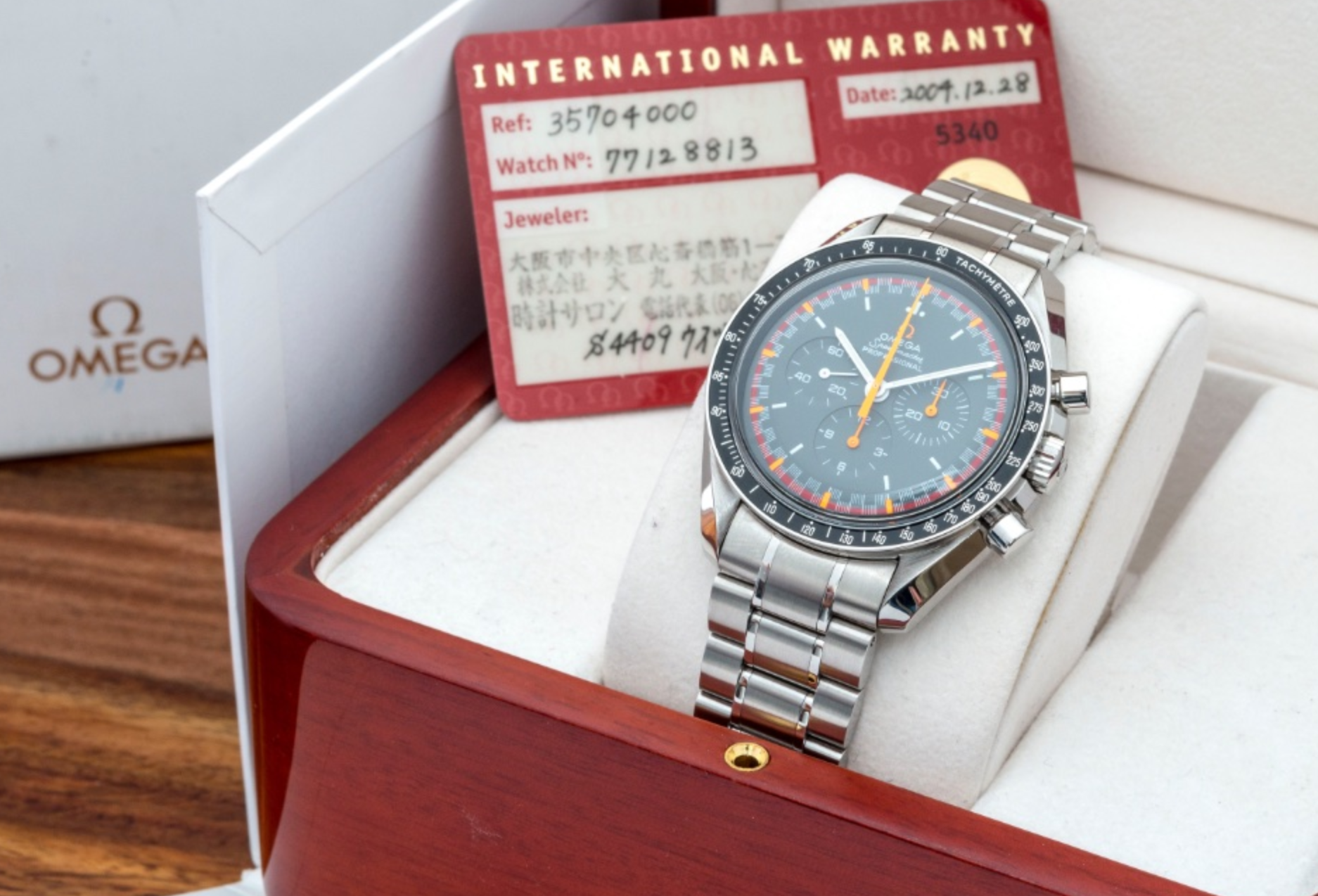

I've seen confirmed Japan from 77109xxx to 77134xxx
12,148
40,476
@ewand is correct, the 3870.50 was the standard sapphire Moonwatch on a black leather strap. A true Japan Racing is a 3570.40, and should come with a warranty card from a Japanese retailer.
