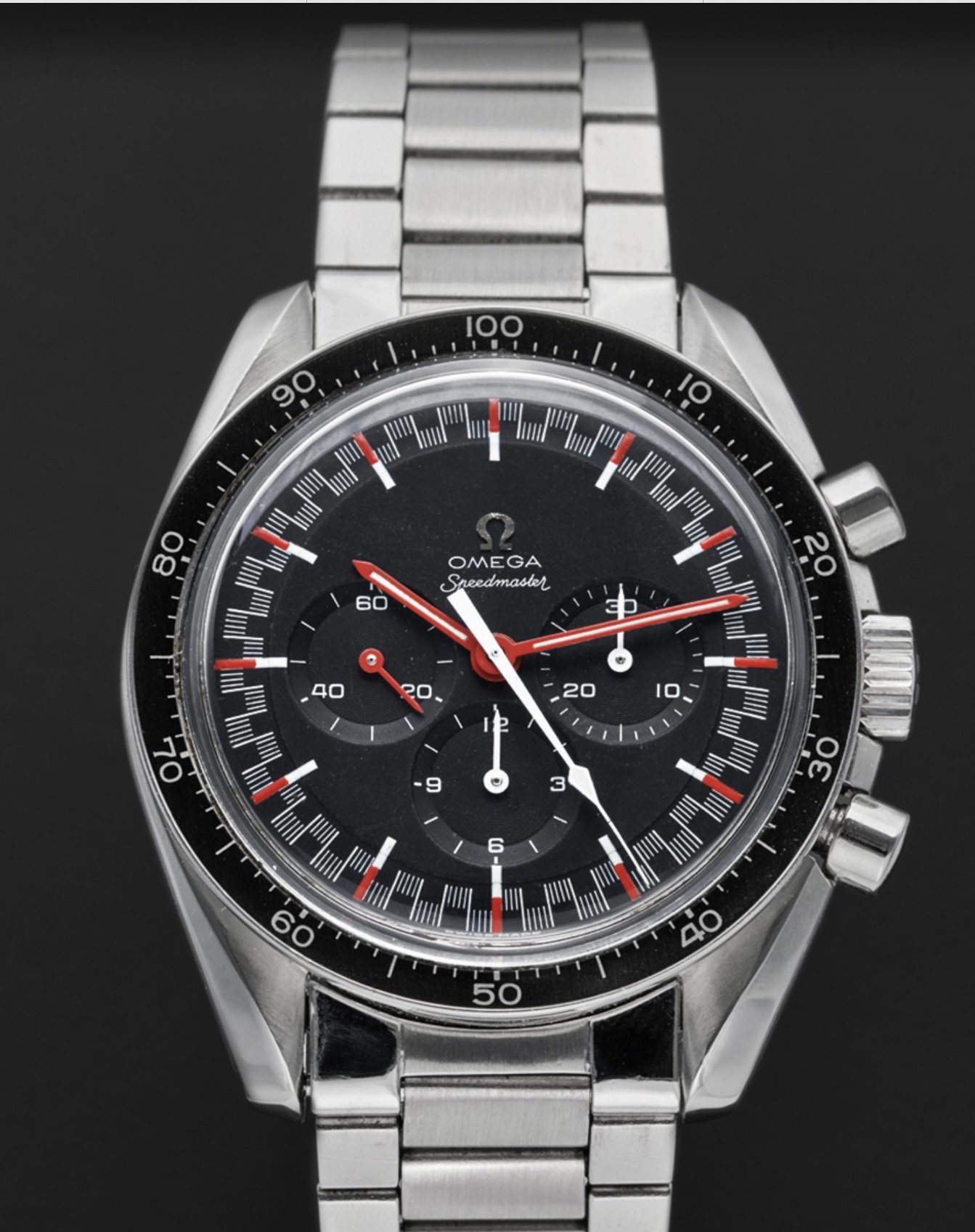

Offered here at an auction house I haven’t seen before.
Interesting they have no buyers premium - so the bid you make is what you pay. I suspect that this results in lower overall results, as I have always found I can over bid, not quite calculating properly in the heat of the auction.
Before delving into it I was struck by three things.
The bezel is a service bezel. These have all been seen with DO90’s and so any valuation will have to be lowered to take into account that a correct bezel is $2000-5000.
The chrono hand is square end. These are seen on BR’s but I prefer to see a long needle, Ultraman style hand.
Lastly, the lume is white, and I prefer to see a little patina.
The estimate is CHF 40,000 - 80,000. While that’s a huge amount of money, it’s not for a correct and attractive Black Racing.
This one is struggling to be attractive from my point of view, a point of view that is formed from handling over 12 of the suggested 20 in factory released black racing dial 145.012’s in existence. As an aside, I think there are more than 20 factory issued black racings, but I wonder how many survive. There are also several watches assembled from loose dials which are not factory watches.

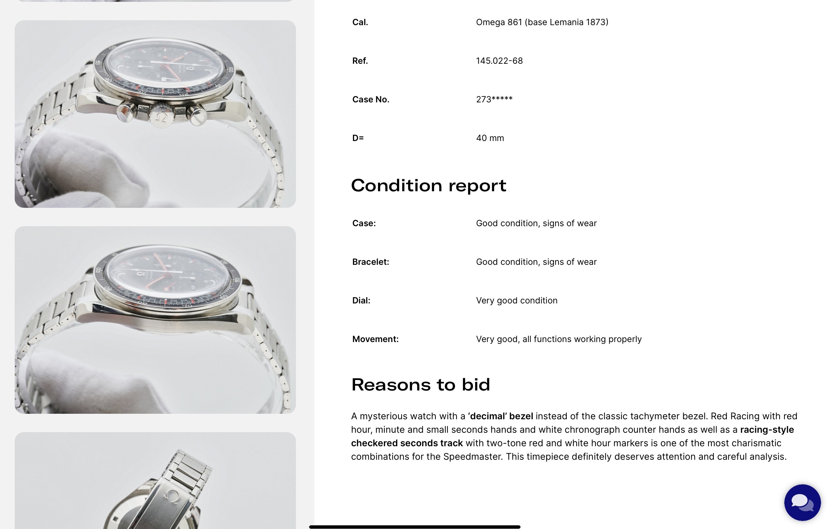

Reading on, we have a much bigger issue:
Note the Reference is given as calibre 861 145.022-68. All the watches I have seen with BR dials are 145.012-67 with two being -68. So obviously calibre 321, and serials are 26xx,xxxx. I don’t think there is any speedmaster collector who feels this might be a long lost prototype.
We don’t have a movement shot, nor a full serial. So perhaps the house made an error, and it’s a calibre 321 145.012, or it is as described an 861 145.022.
I have never seen a black racing dial in a calibre 861, and obviously all the other BR dials re for calibre 321 with feet to fit. I expect all the loose BR dials are also for cal 321.
I assume it is as described in the catalog, and my conclusion is this is not a factory watch - and has been assembled.
The value is all in the dial. However this dial will have feet for an 861, so it will not fit properly to a 321 without work that is slightly risky. Now that the archives are closed, allegedly temporarily, someone with a 2607xxxx serial might be tempted to buy the watch, break out the dial and fit it and wing it, perhaps returning it to auction.
Black racings are very rare, and taught over when in good condition at auction. The highest price achieved was at AQ, a non pro for $212,000. The lowest at auction was a dubious example at Phillips that failed to find a home at $40,000.
so just how much is this watch worth, and are the buyers aware of what they are buying?
Even the catalog description calls it “mysterious”

It’s smells of a highly prepared watch. The case and bracelet all appear to have been refinished, not well enough to remove all the marks, yet recently enough that it appears very few scratches have been added since the refinishing.
Coupled with the concerns re the dial, bezel, and movement, this seems like a chancer who stumbled across a dial and has built this up, or a dealer who’s either careless or ignorant to the minutiae.
5,375
24,545
If I were in the market I’d be buying the dial and bidding accordingly.
And here is my wonder - what is a solo Racing Dial worth? There are a couple on the market (in watches) circulating right now, and I cant see the value in them - they will never be factory watches, and so they have to be about 10 to 20% of a real one in my reckoning.
Its like a natural diamond and a man made one. As long as we can tell, there will be a value differential, and quite different types of customers.
Three years ago I could see this being fought over, as relatively new over exited buyers with money to burn, er sorry, "invest", bid against each other for shiny, but ultimately not very valuable things.
Still there is already CHF 27,000 on this.
My advice would be save for a real one.

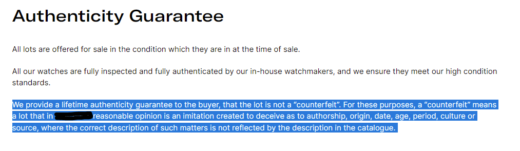

Welcome to the post Phillips world of rare Speedmaster varieties.
it’s CYA as they know things don’t add up and are not claiming it’s factory.

The question is what a reasonable opinion might be.
They also have a Speedmaster which according to their description is a 2998 and according to the EOA (june 1st 2023 signed by Loic Voumard) it is a 2915.
The seem to be a bit shoddy with their descriptions
18,326
27,695
How do you know that’s the caseback it left the factory with? Does the rest of the watch support it being a 2915?
That’s not an error that would show in the current archive process.
