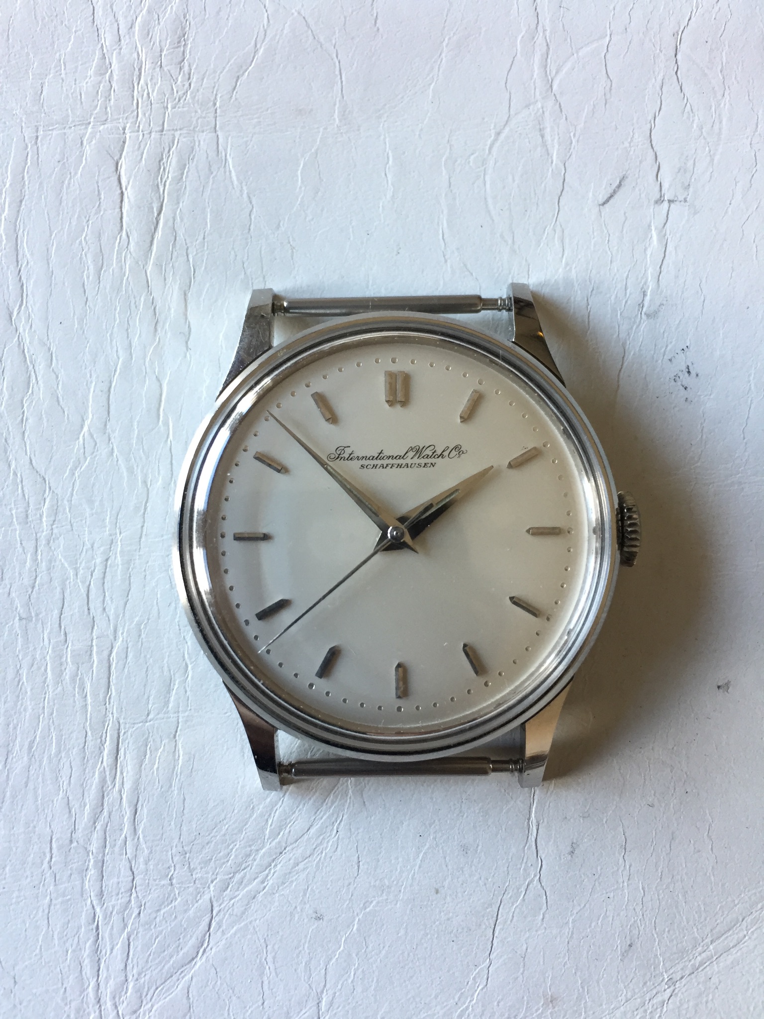

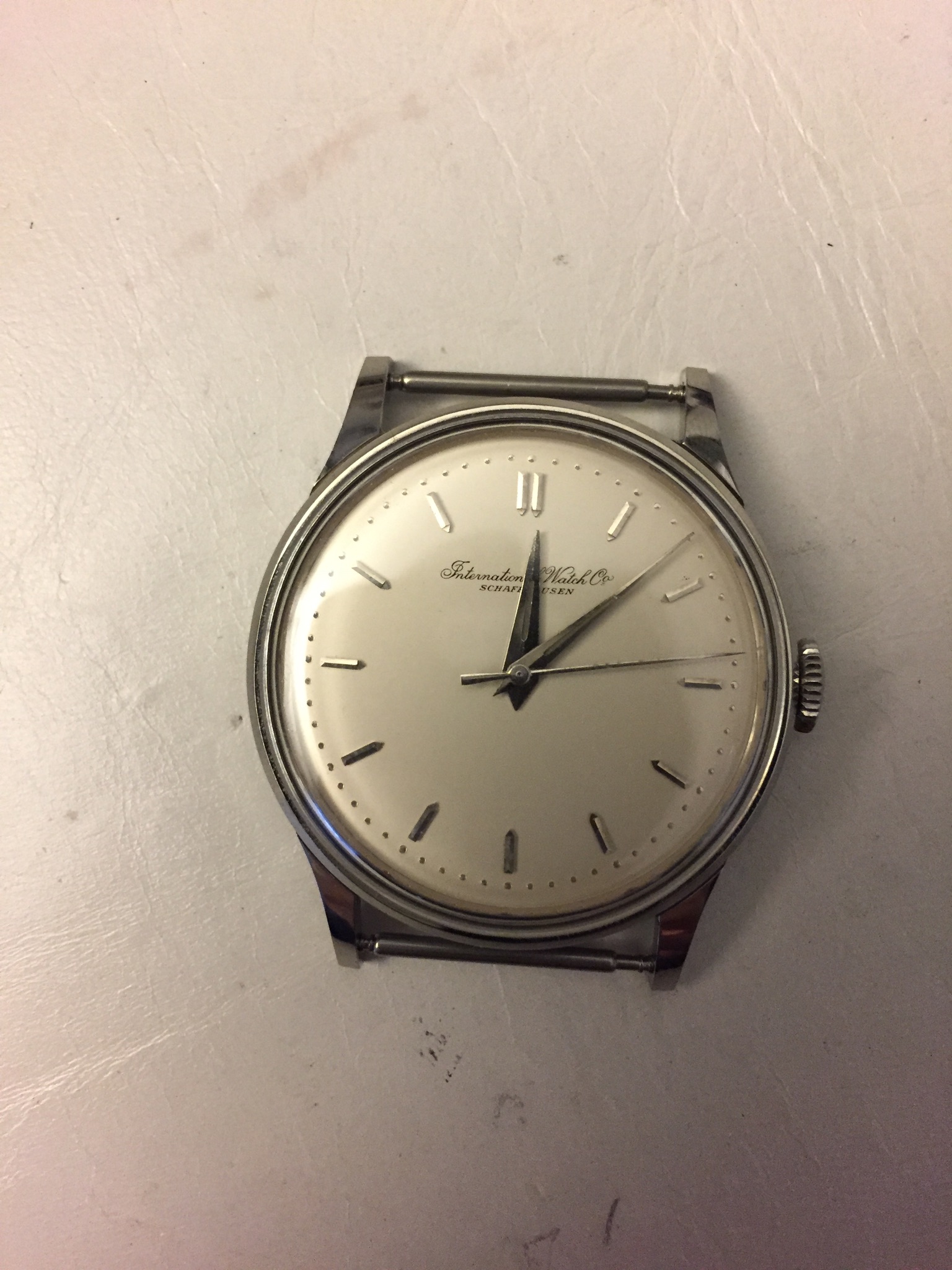

IWC Dial Check (Originality)

Great finds but I don't think they answer the question.
@vintagecaliber said they're all re-dials. I would think to believe him since he deals in these vintage IWC's.
So again, what are the signs?
2,959
6,317
We all deal in these vintage IWC's. And some members have even tried to pull up evidence.
Vintagecaliber might be right. I wish he'd elaborated with his response. But many of the people who are agnostic about the originality of the dial are vintage IWC collectors, too. This has been an open question to me for a long time. I've seen this script type many times in the past years and I'm curious one way or the other.
If vintagecaliber could elucidate, it would be helpful.

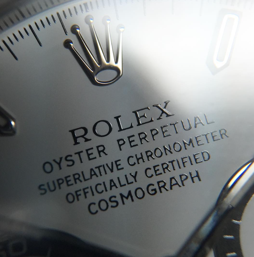

@MPWATCH recently posted an excellent example of what I mean by the ink being rounded. You can see the depth it has due to the reflections on the sides:
Sorry for a stupid question, but if I don't ask, I remain stupid. Does the rounded ink indicate a redial, or an original?
Usually original, or at least a very high quality redial.

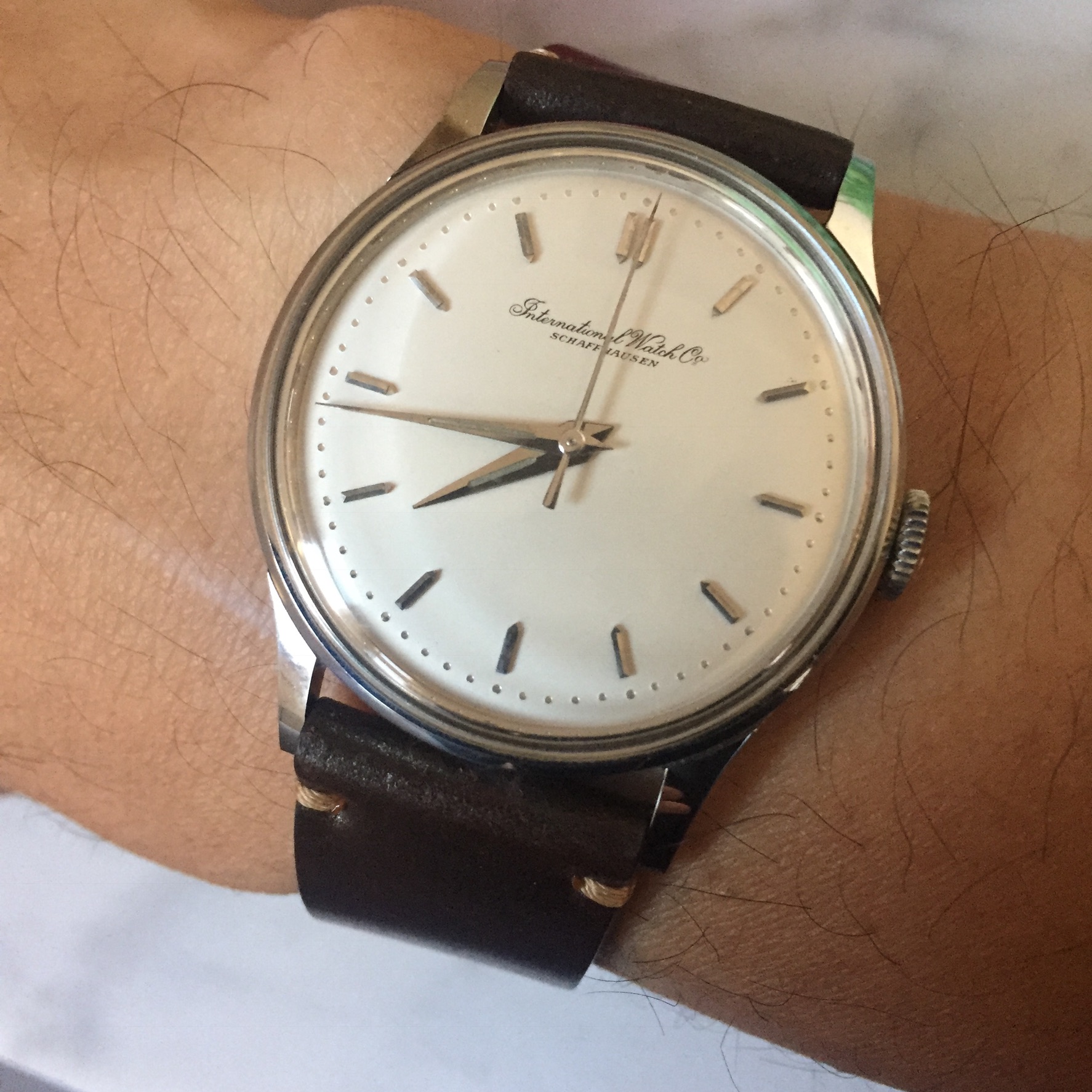

1,306
2,929
Here is one of mine @Modest_Proposal i have been trying to figure out whether it is redial or not on this one as the L and the W also are very close. I noticed that some of the dots don't really align with the dial furniture plus that the Swiss or Swiss made is missing. I did read somewhere someone stated that Swiss is not always on the dial, I started looking at other dials and found quite a few examples that their minute dots don't really line up but most of them has Swiss or swiss made on it. In any case, don't mean to hijack the thread but I am leaning that my dial could be a re-dial. In any case, I still love it as it is with all its imperfections. I guess my point is that yours look pretty awesome, provided you didn't over paid, just enjoy it!
930
3,729
Great looking IWC! The hands have slots for lume but the dial has no lume. Does that suggest a redial or replaced hands? I also am gathering info on these dials.
