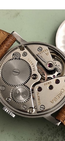

Hi everybody!
I’ve always kind of been under the impression that (sorry I don’t know the right terms) but the regulator adjustment for the balance should be somewhat in the middle when serviced and running properly. The pic included here is from the omega enthusiast so I fully trust that it is serviced very well and professionally.
However, said lever is buried to one side...
Does this mean there is an inherent problem with the watch or it’s at the end of its life in any way?...
thanks so much for any responses, I love this resource for questions 😀
And yes I will ask him as well I just like a large breadth of opinions

I've never seen that on a serviced watch. I'm not a watchmaker, but I would assume there has to be a balance or mainspring issue. I'm also curious to see what the more seasoned folks think.

Ideally, yes, but with a vintage watch you really don't know who screwed with it (literally) in the past. A teeny-tiny piece of the balance spring might have broken off, for example, and if that means the regulator arm be off a bit, that might well be the best compromise that can be made. Would you want to try to source a new spring or balance complete? Perhaps not!

In the past, many UK watchmakers ( maybe other countries as well....) did shortcuts during service and did not attend to all quirks properly. Put in stronger mainsprings, that pushed the movement over little problems.... Many were sold as fully serviced and the regulator was set like in the OP s sample....

Indeed - Roger Smith admitted doing this very thing when he was servicing watches in a presentation I saw a video of...::facepalm1::

So to answer this initial question, when there is a one piece regulator as in the example you show, there is some work involved to center the regulator. On a modern watch as has been pointed out, you can move the pins and the pointer separately, but there that's not possible.
So how do you "fix" this? You have to add or remove mass from the balance. In this case the regulator is way over to the slow side, indicating that when centered it would run very fast. First, for it to be out this far is very unusual, so I suspect some kind of underlying issue is behind this state. The best thing would be to fix whatever that issue might be.
But say the watch has been gone over in detail, and you still end up with a regulator way off to one side. In this case it's an easy fix - add timing washers under the balance screws, and if the positional variation is good as it stands, you just add them in pairs opposite each other. Timing washers come in assortments like this:
The are designed for a specific size range of movements, and each vial contains washers of different thicknesses, that will change the timing a different amount. So on the far left are the thinnest washers, and adding a pair of those will slow the timing by 20 seconds per day. On the far right, the other extreme is a pair that would slow the watch by 4 minutes per day.
This is what the washers in the vial look like:
You have to be a little careful not to breathe on them when they are out of the vial, or they will be gone. These are very small, and to put it into perspective, here's a photo:
There is a 20 mm Omega spring bar there, and in front of it two larger screws on the right, and the small one one the left is from the balance of a watch - the screw I've added one of those washers too, but you can't really see the washer very well.
So why didn't whoever worked on this do these steps? Good question for them actually...

Just to put my mind at ease, is there any reason to not buy the watch because of this? I guess in the future I could always have the fix you outlined performed correct? thank you Archer!!
