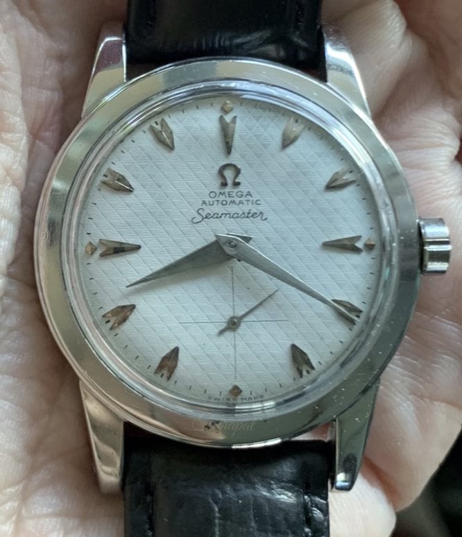

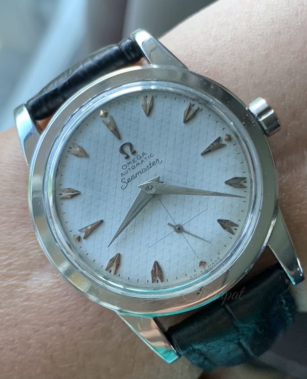

Hello all omegaforums’ members.

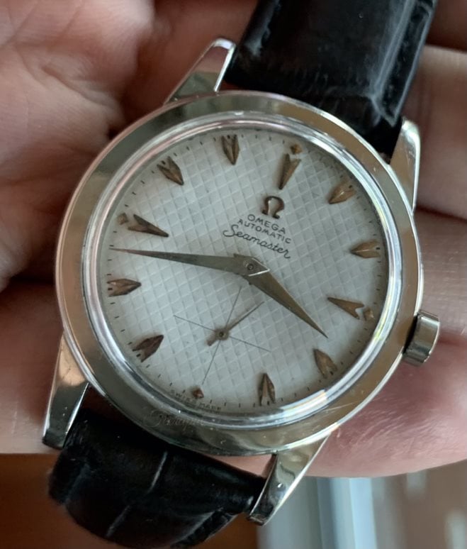

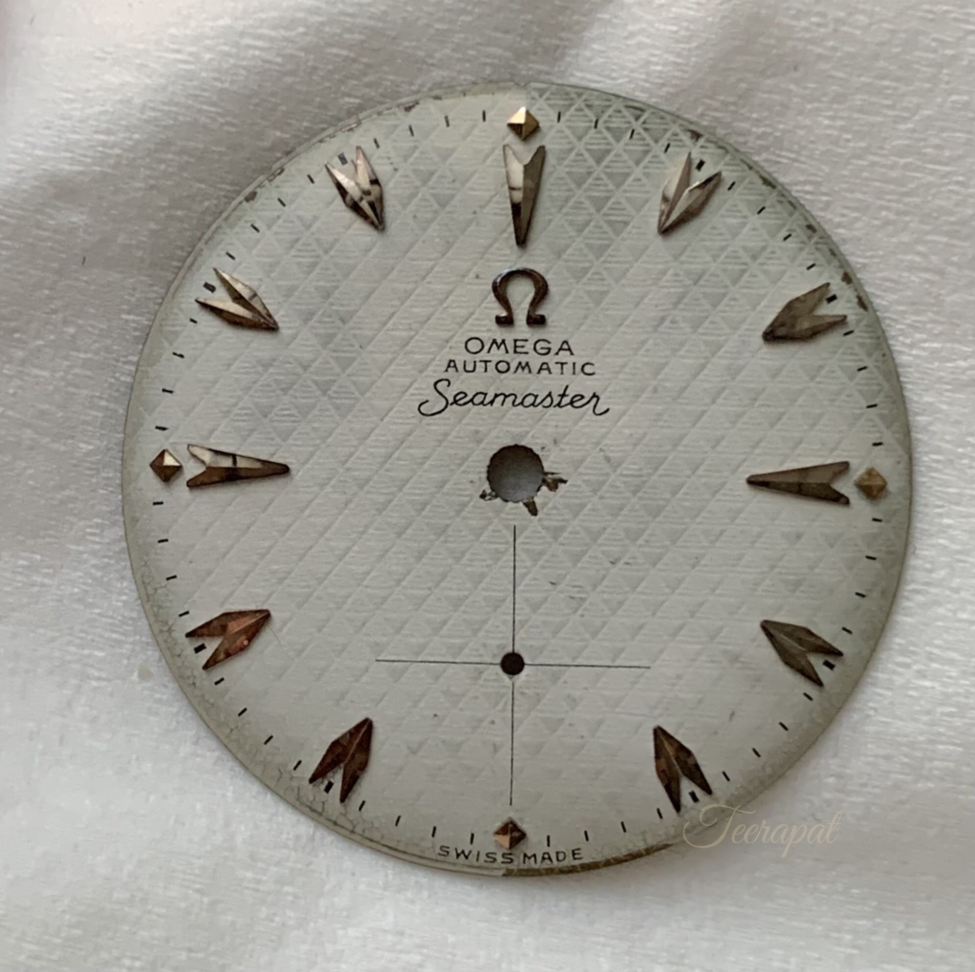

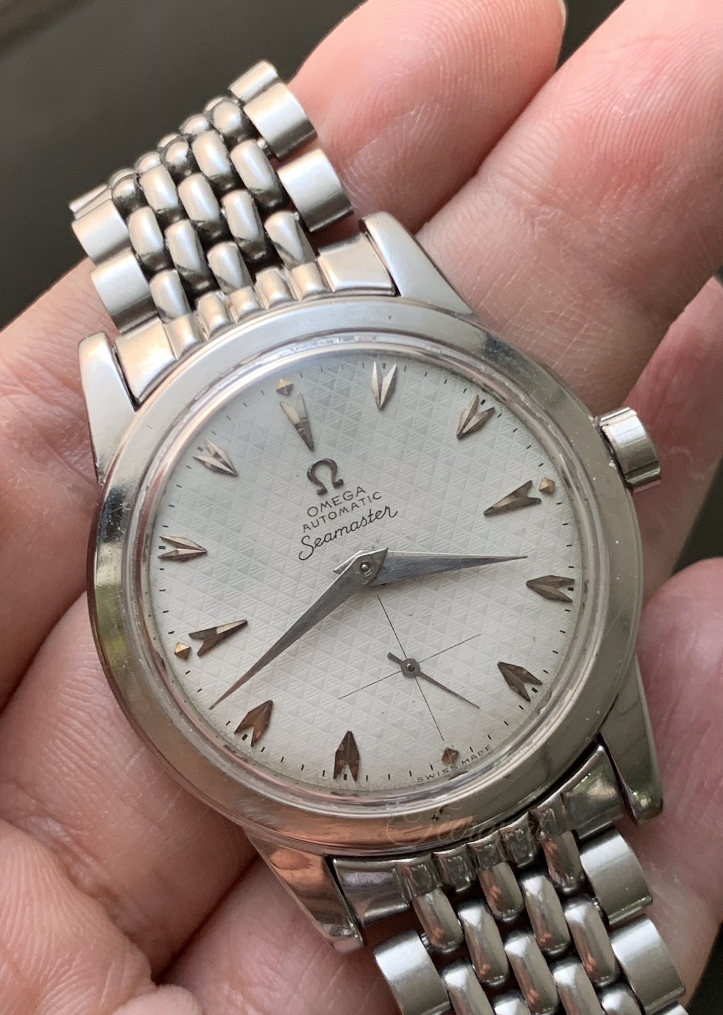

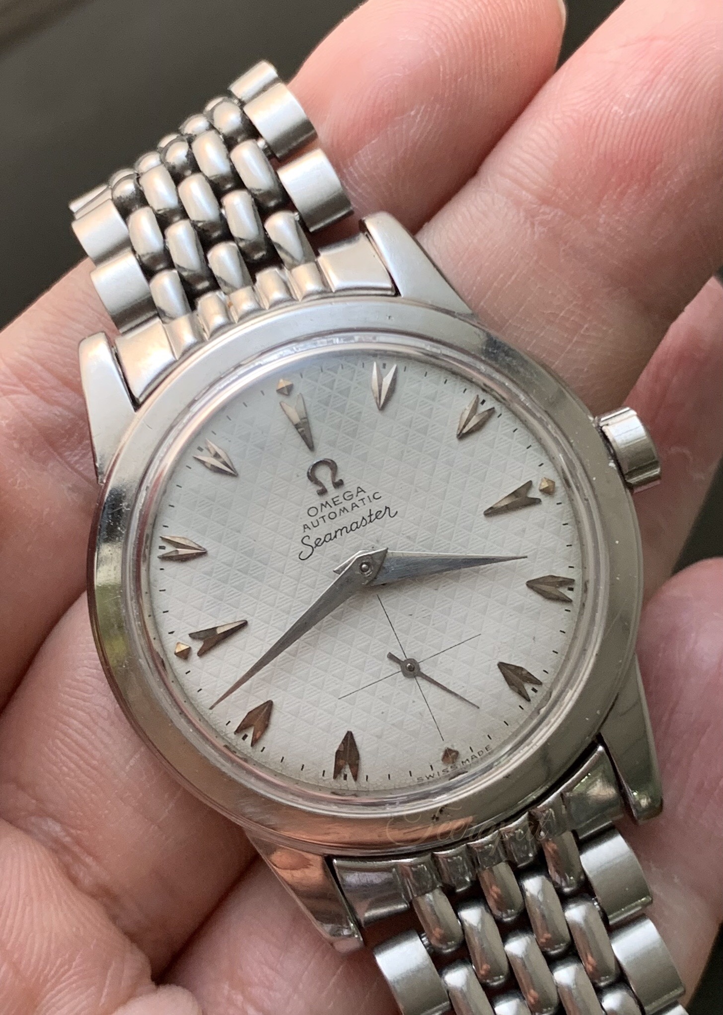

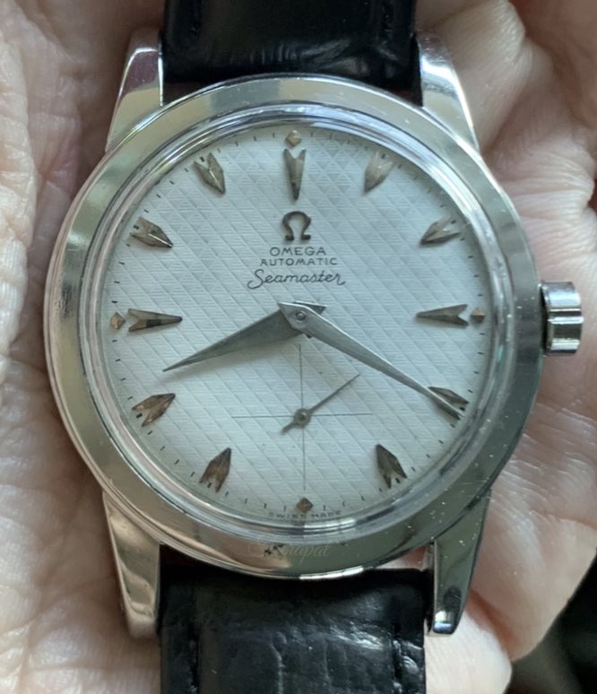

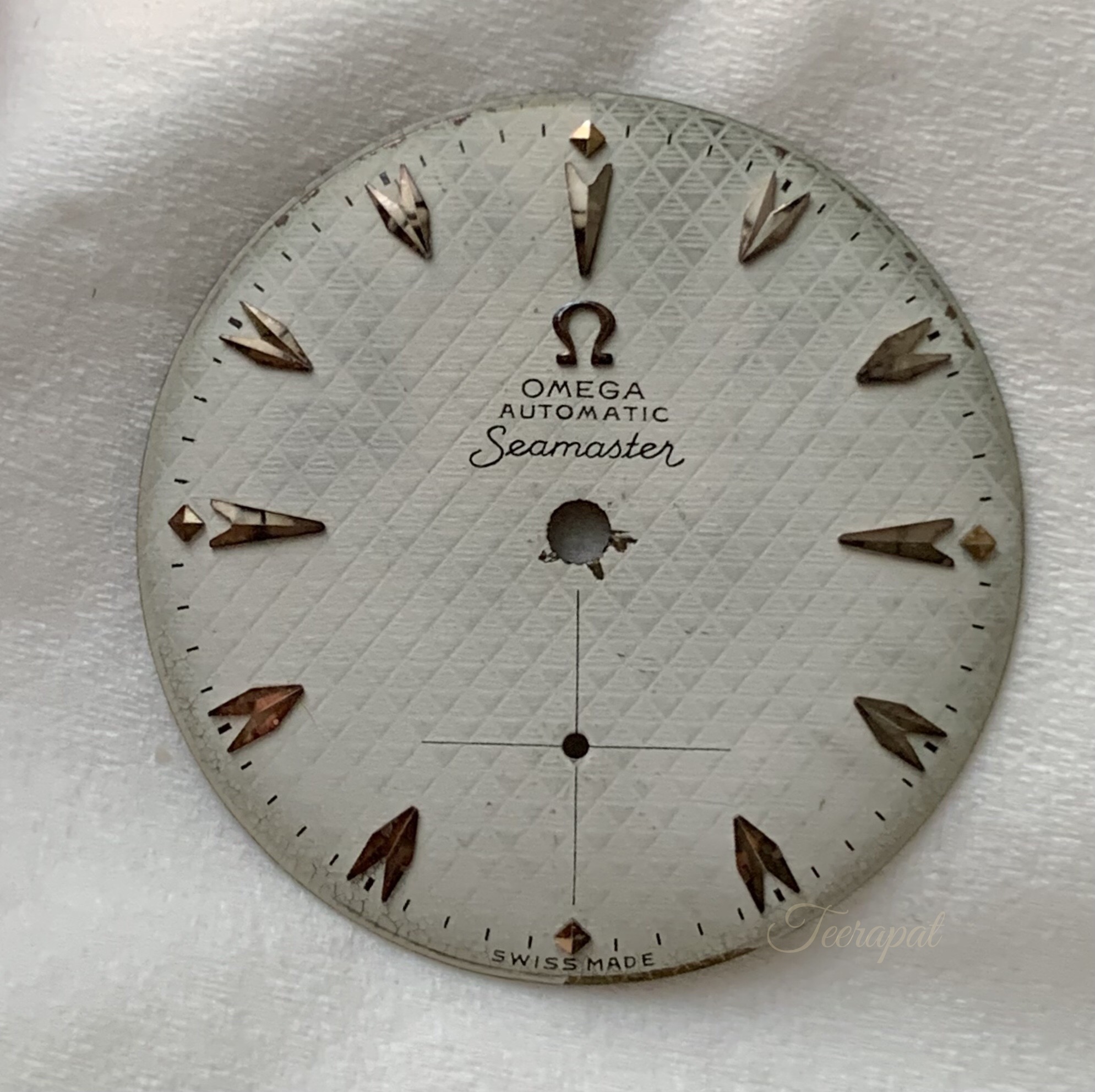

I want to share another one in my collection, just received it today!!

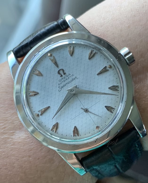

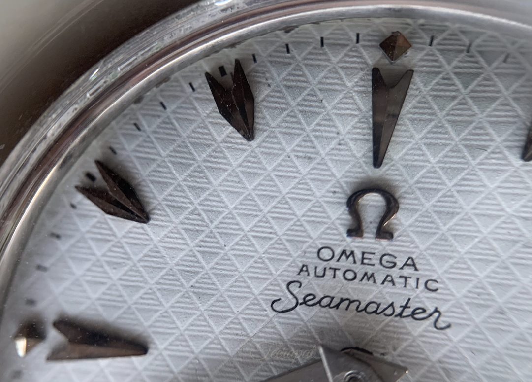

It was Omega seamaster ref.2576-16 with the uncommon dial pattern.
From my research, someone called it as “textured dial” or “diamond dial” but I will name it as “rhombus dial”.
The serial number was 13,004,xxx (around 1951-52) and powered by caliber 342.
In my opinion,
- The dial was a white factory original with beautiful and very unique pattern
- The font of “OMEGA , AUTOMATIC and Seamaster” look legit and original

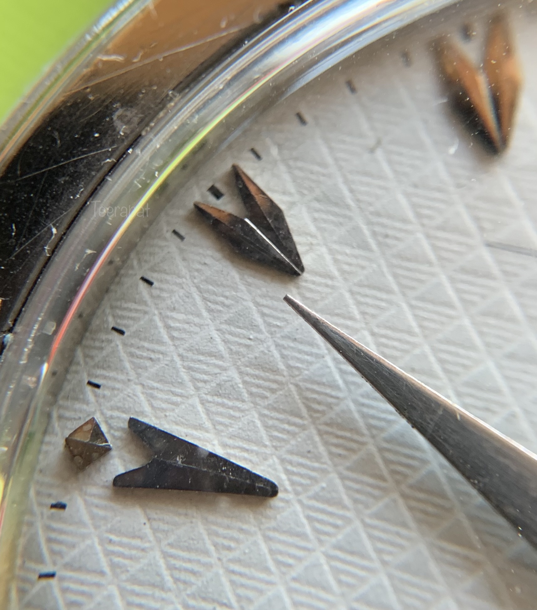

- The nonluminous hour-markers were original which I have never seen them before, but some expert mentioned that he has seen before but on a plain dial or another expert found in the constellation model. I've tried my best for searching in google, plus in this forums but I couldn't find any example.
- The minute-tracks were original with some of the hour-markers covered the minute-tracks (at 1,2,4,5,7,8,10 and 11 o’clock).

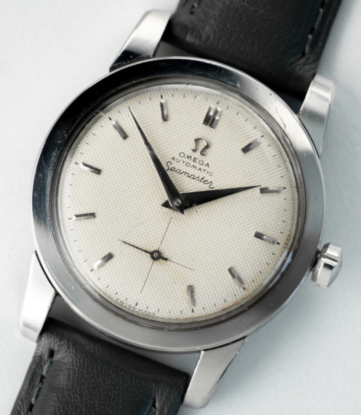

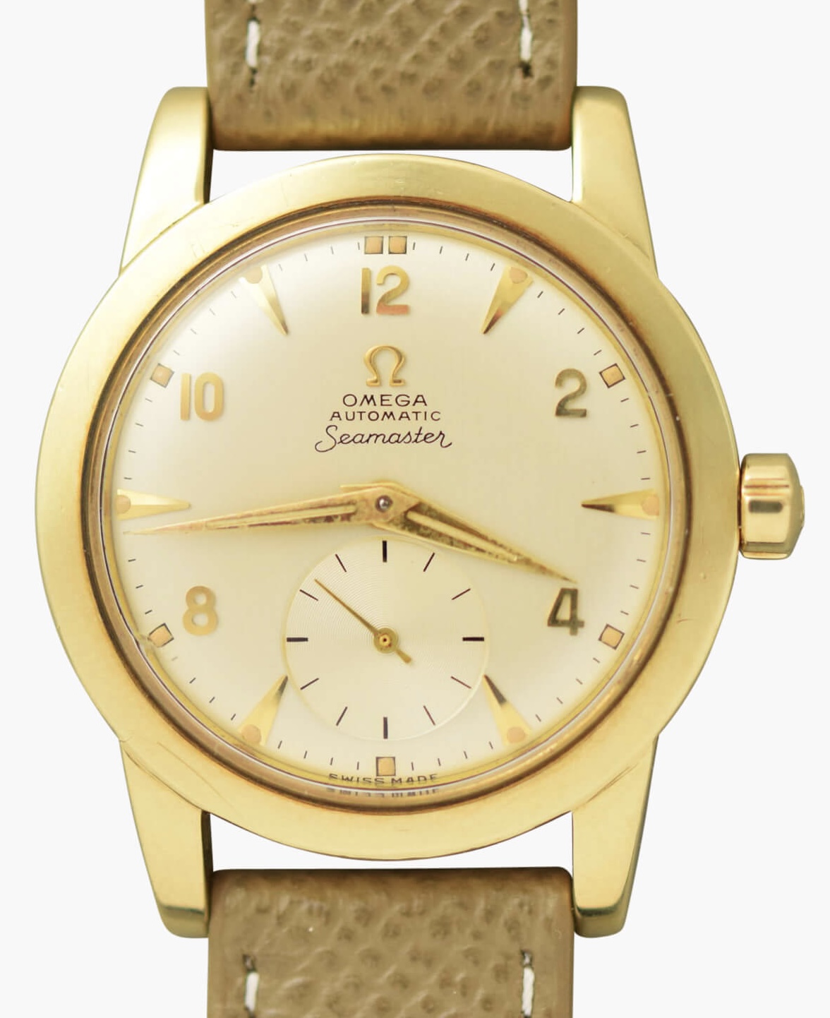

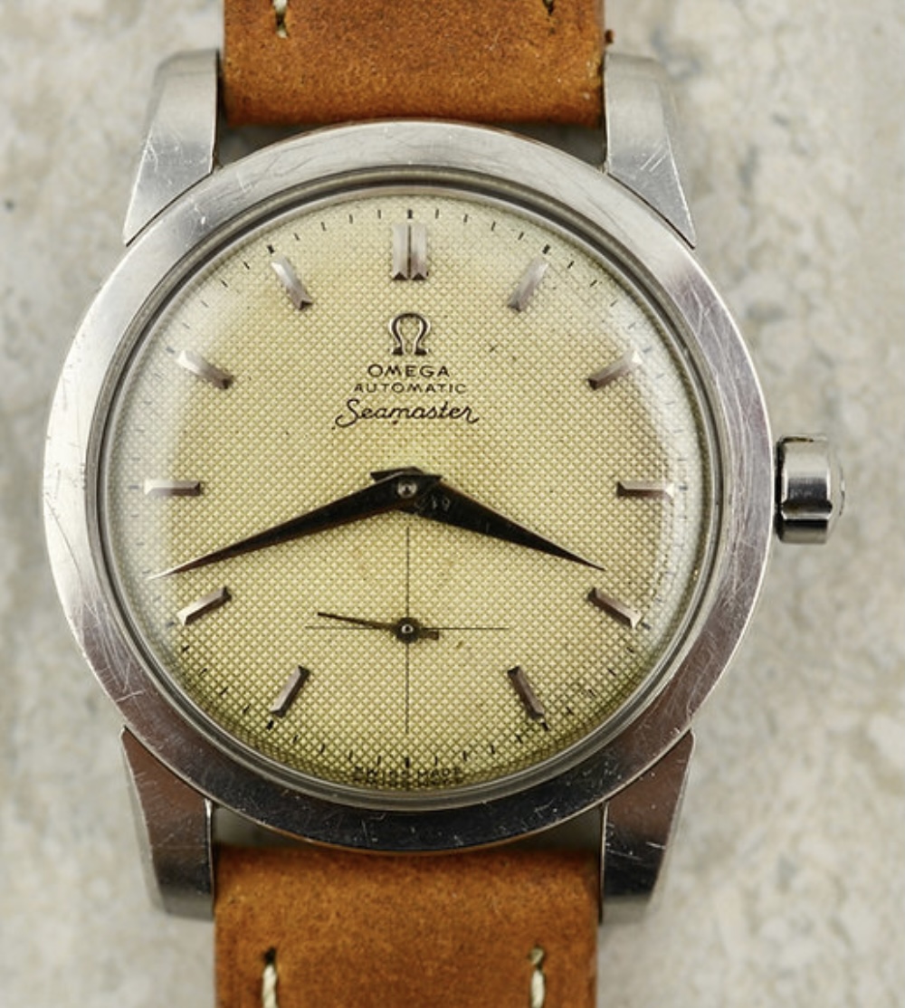

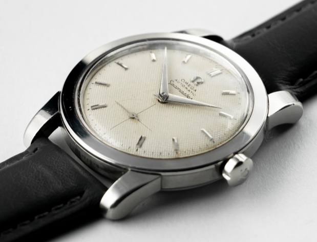

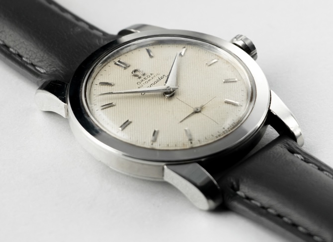

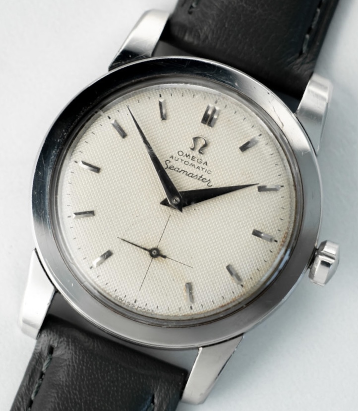

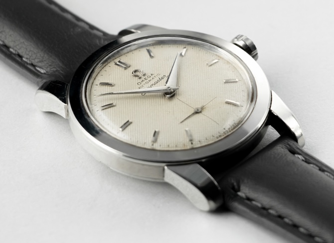

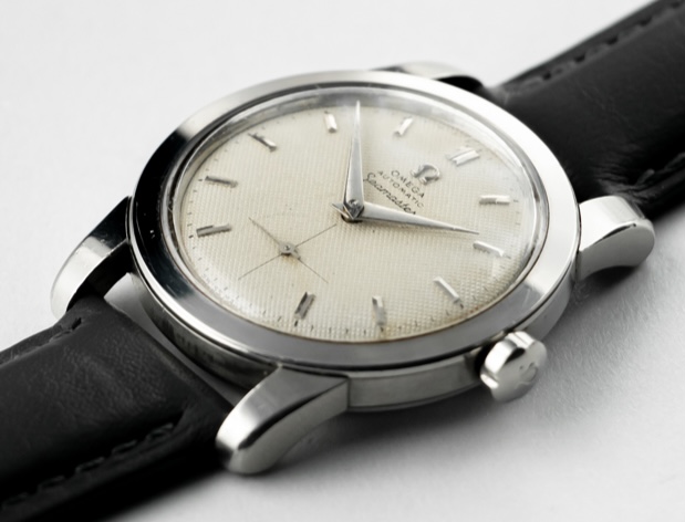

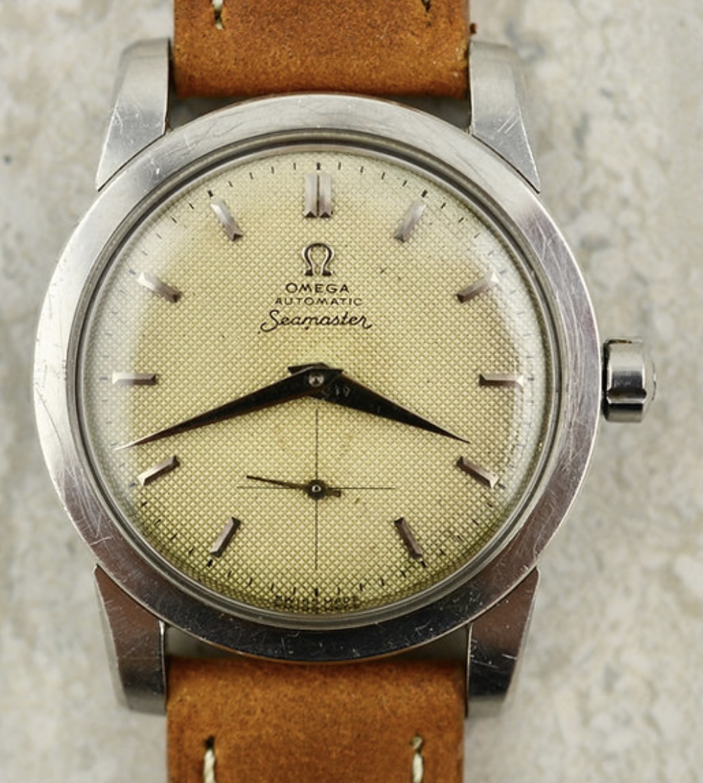

- The silver “dauphine hands” were original (not the facetted version). I found at least one example with the same type of hands, please note that this watch also come without luminous hands and hour-markers.
(https://www.stetzcowatches.com/product/1952-omega-seamaster-2576-4-waffle-dial-ss-35mm/)

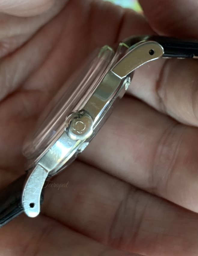

- The case and lug condition was acceptable with some scratches

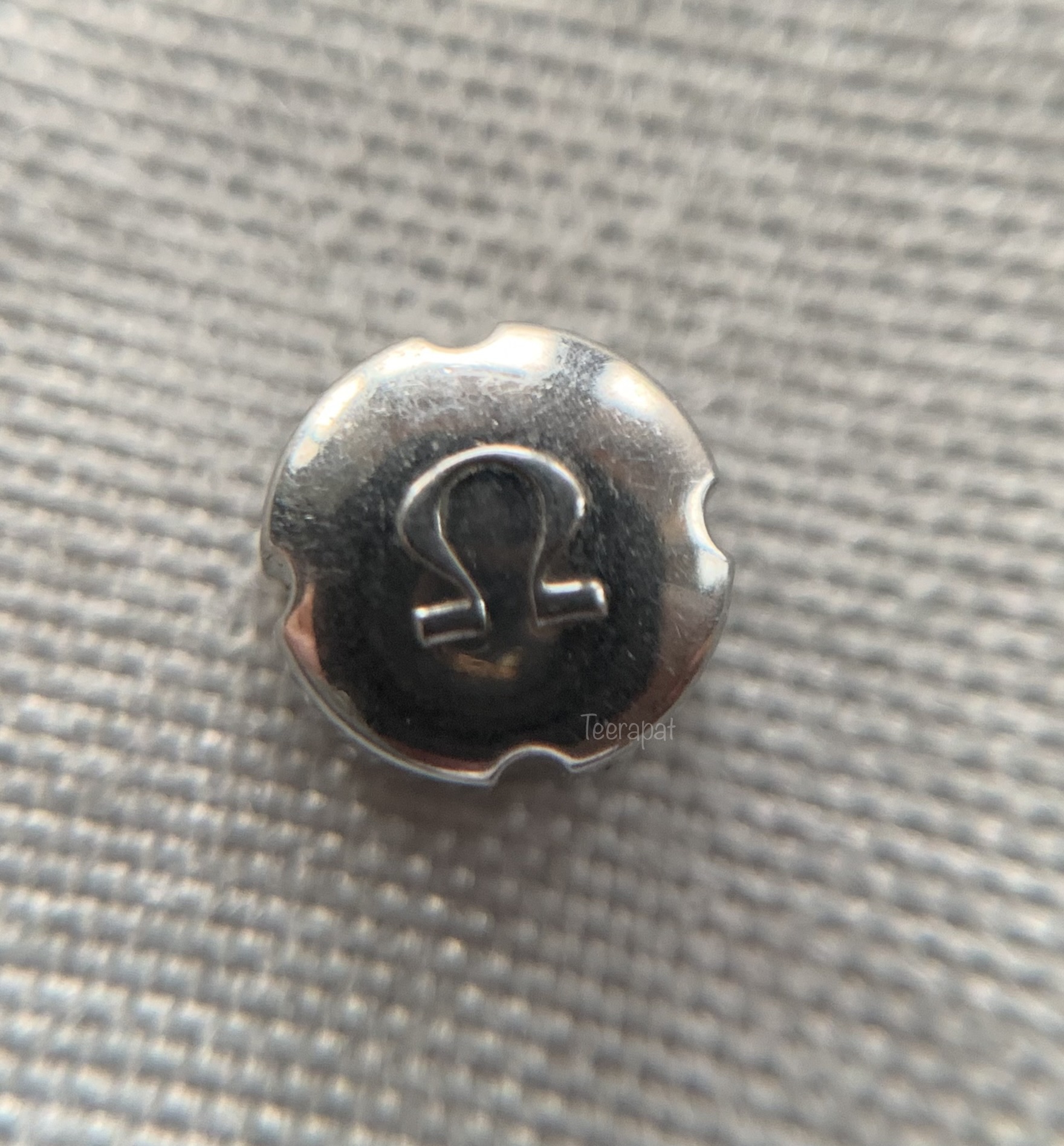

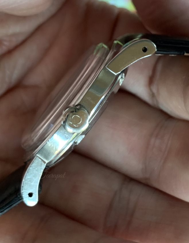

- The crown maybe was not an original omega crown (I am not sure, please share your idea)

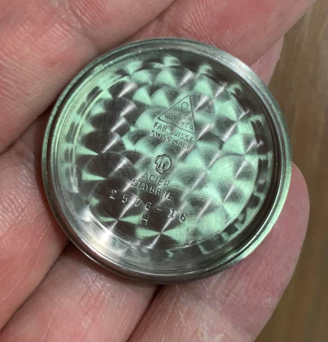

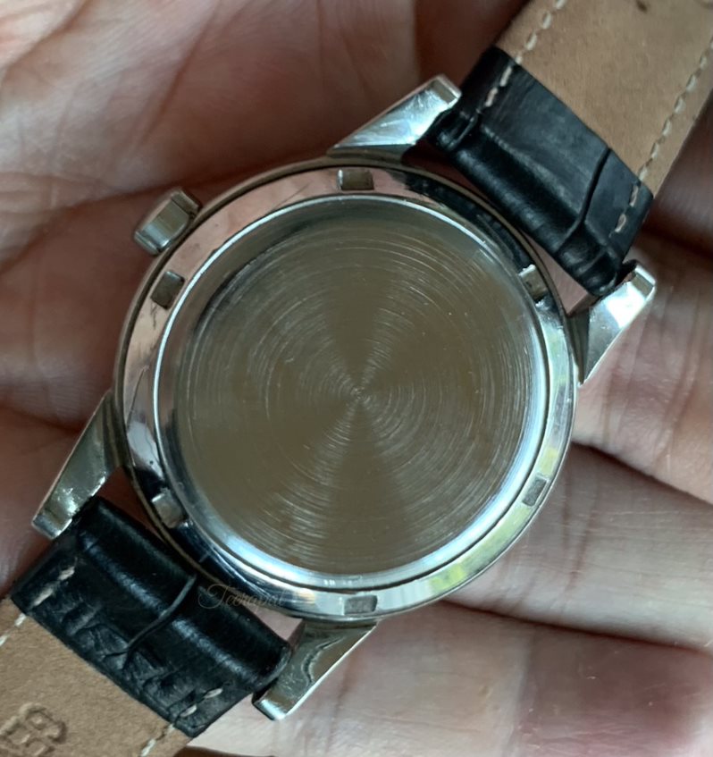

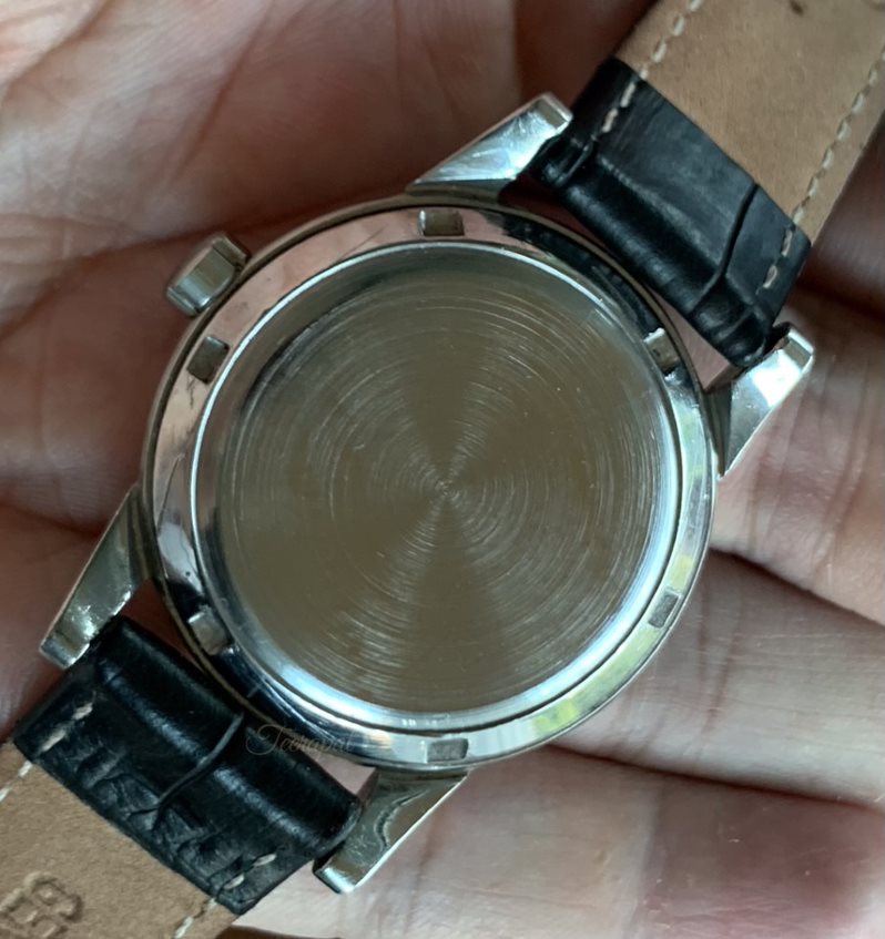

- The caseback was original too

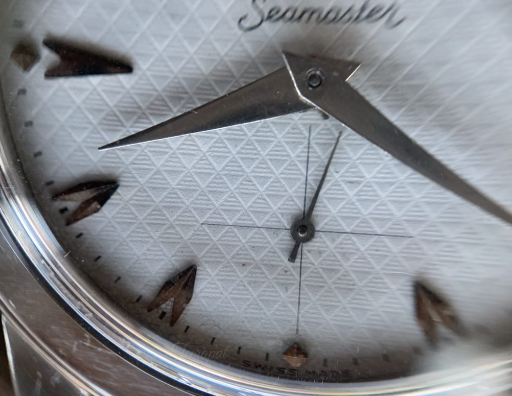

From my research, I’ve never seen combination of these dial pattern and hour-markers together. Also, the first one of ref.2576 using this “rhombus dial”. Moreover, most of ref.2576 will come with luminous hands and markers. I noticed that the horizontal parallel straight lines in each rhombus are very difficult to capture, especially in the white dial.

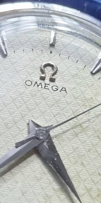

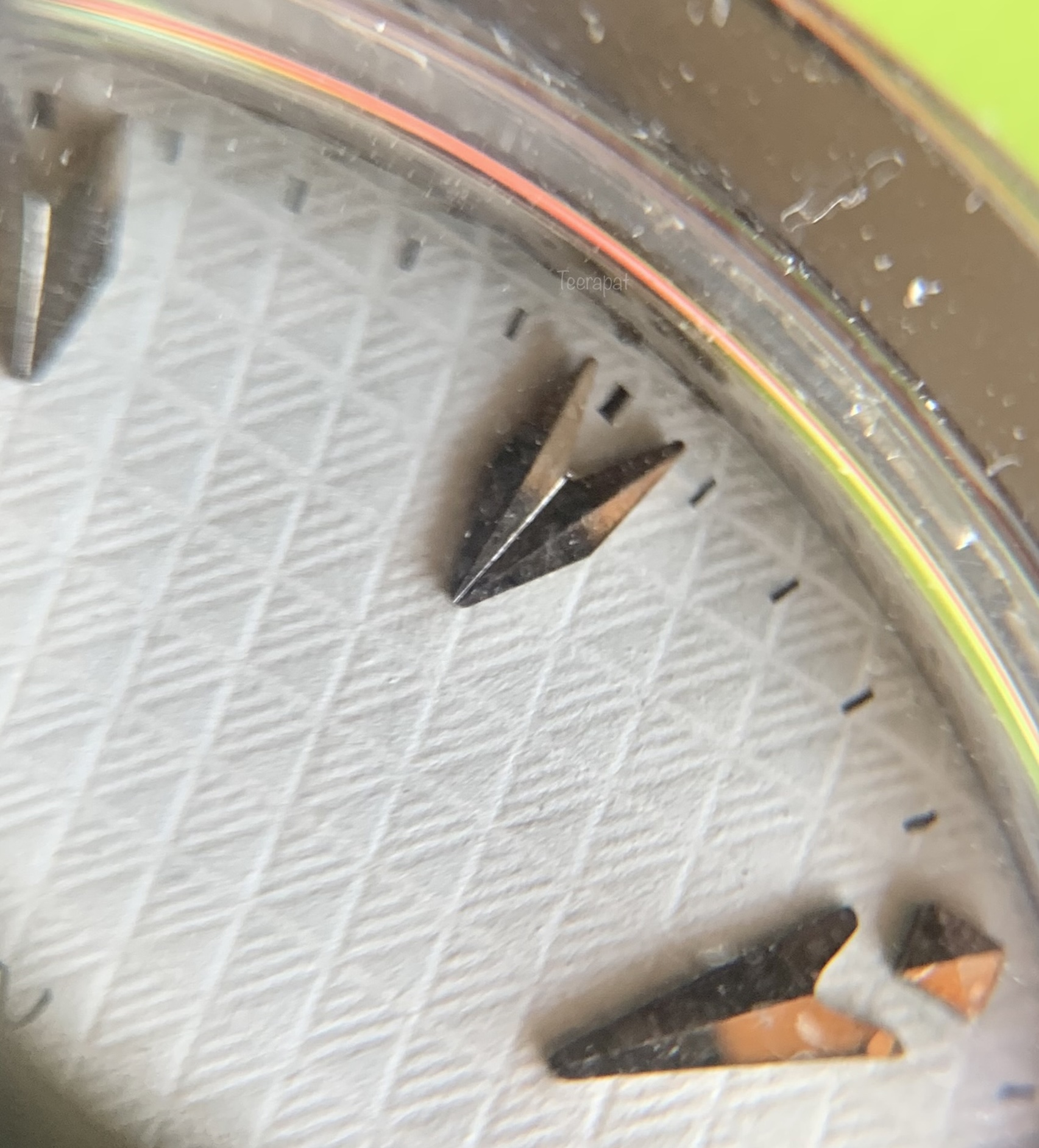

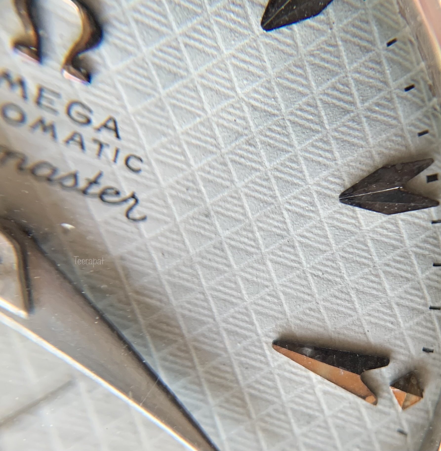

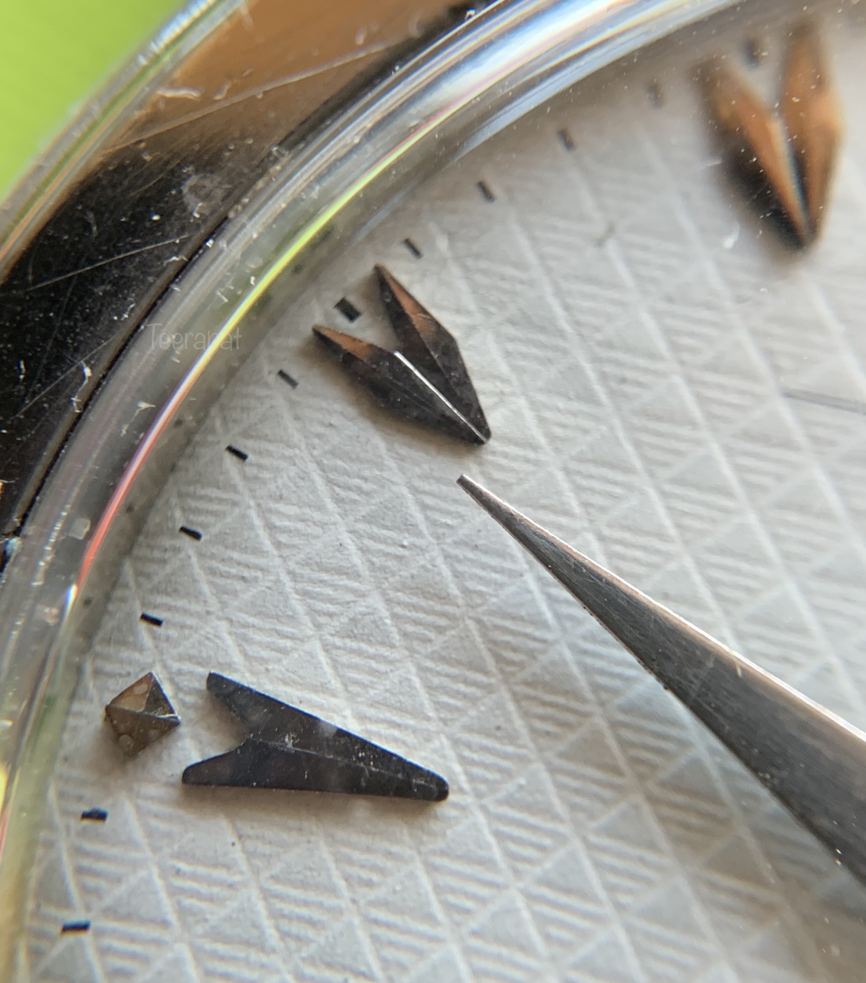

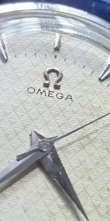

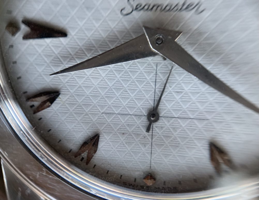

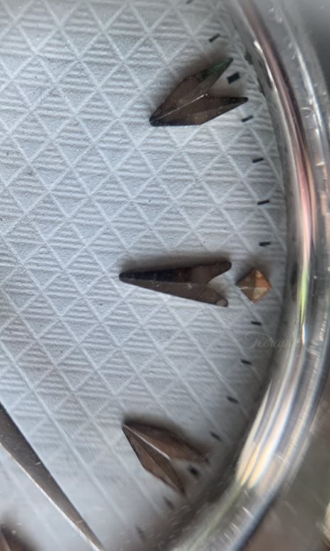

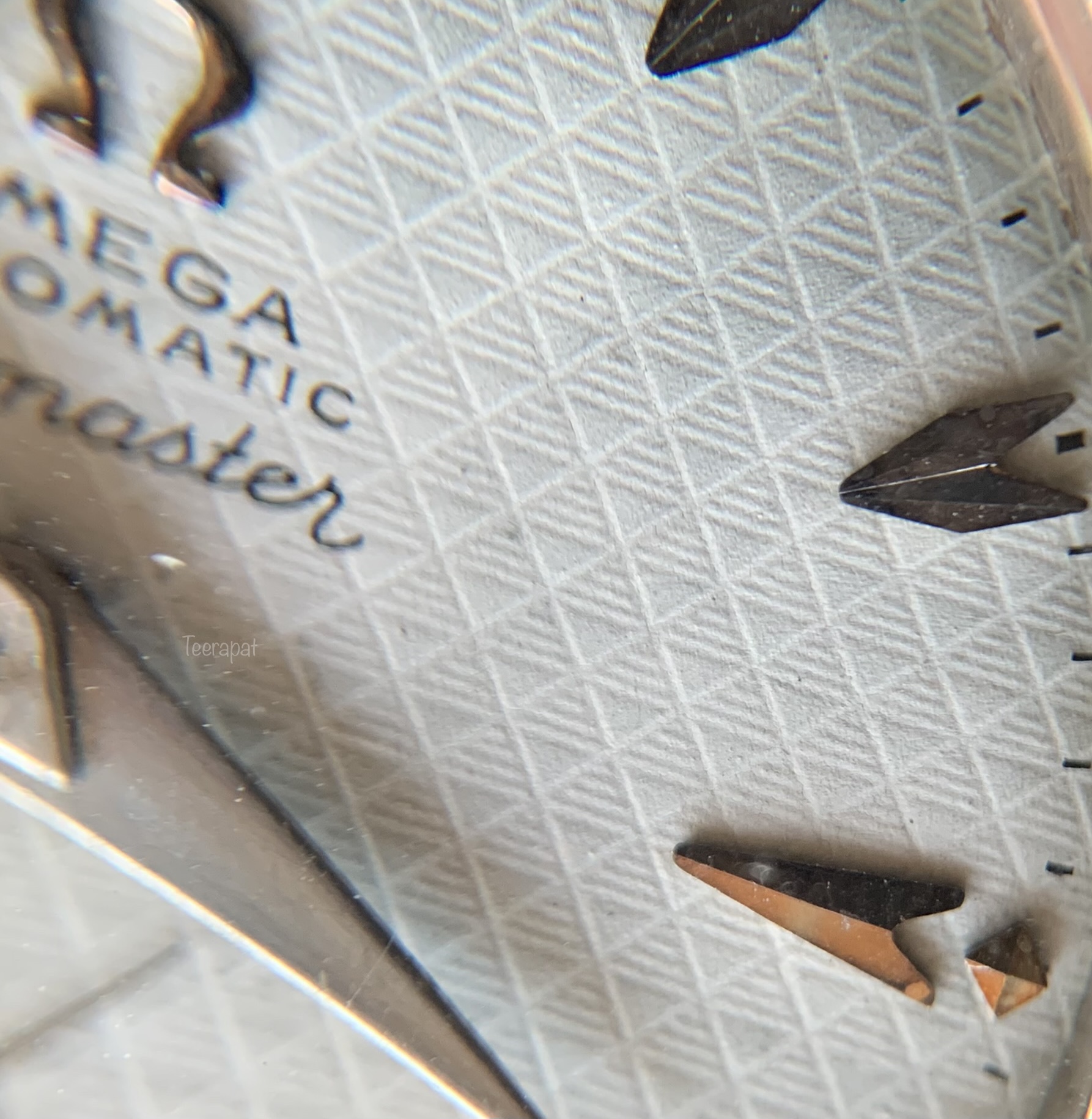

More close-up photos:

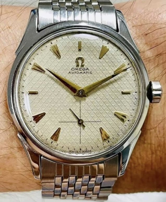

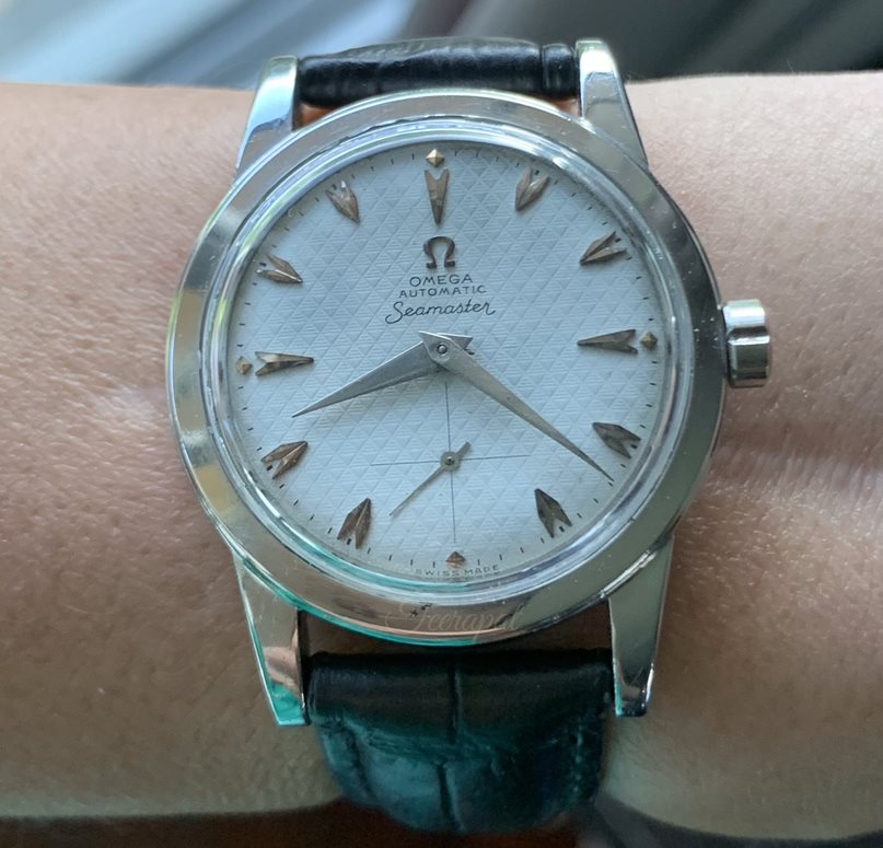

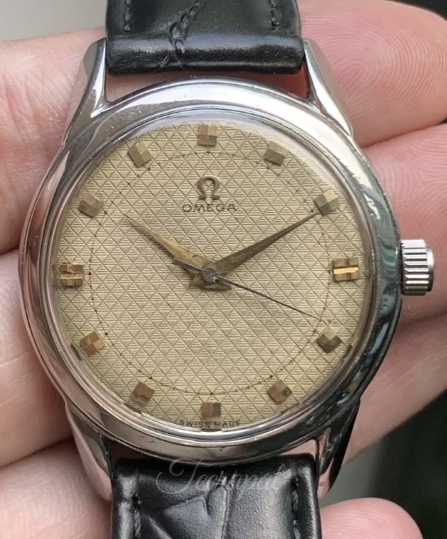

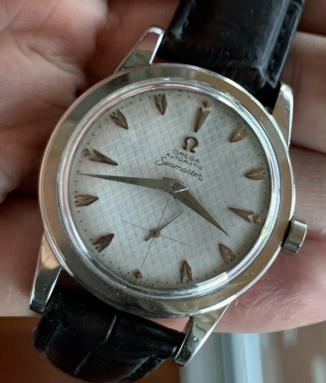

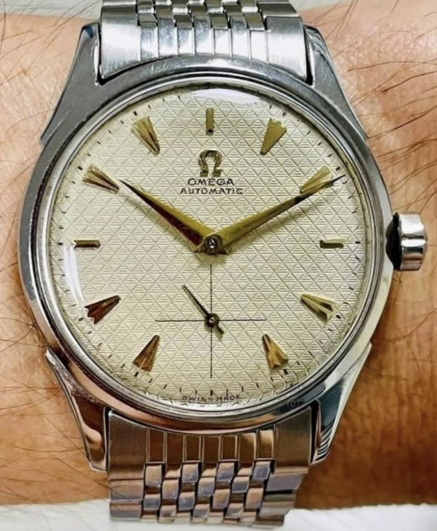

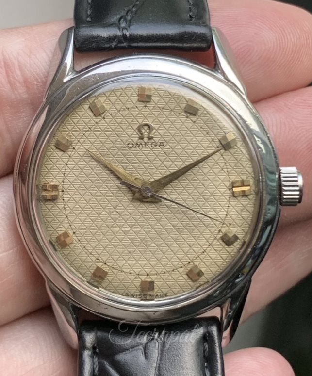

By the way, I found these pattern from the collector in my country, however, I don’t know both of reference and caliber (one expert guess that it maybe the ref. 2638). Please note that the hour-markers are all uncommon shape and all of the minute-tracks stay outside of the hour-markers.
My ref.2715 with caliber 420 used the same dial pattern configuration.

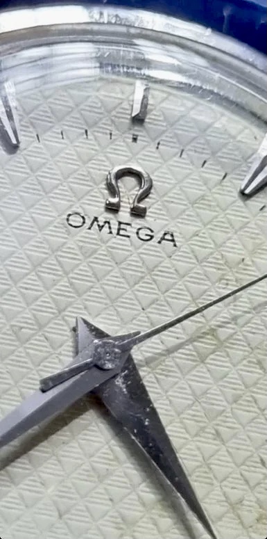

Also, another watch from this forums (unknown ref. and caliber too).
https://omegaforums.net/threads/trying-to-identify-late-dads-omega-model.133115

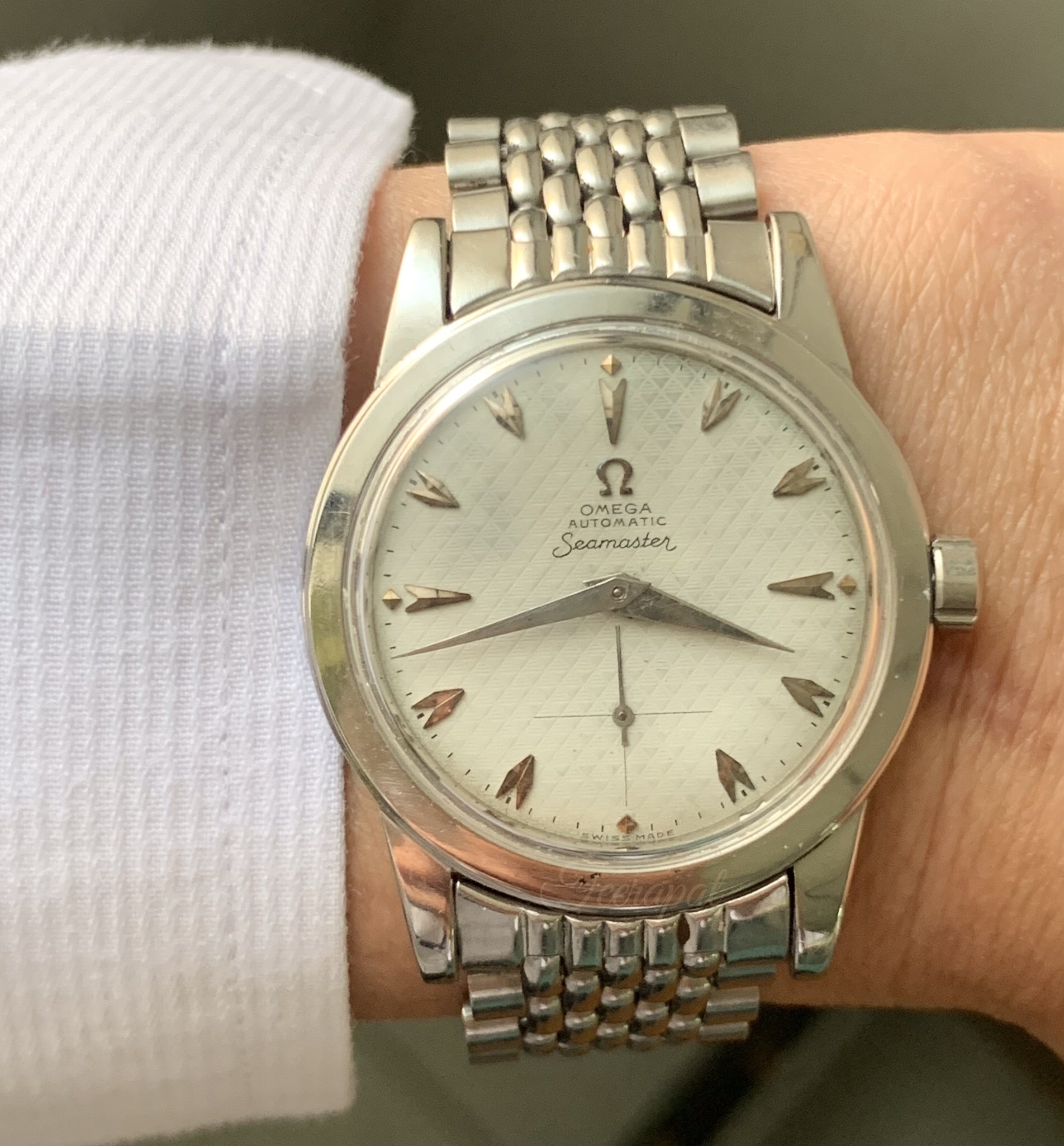

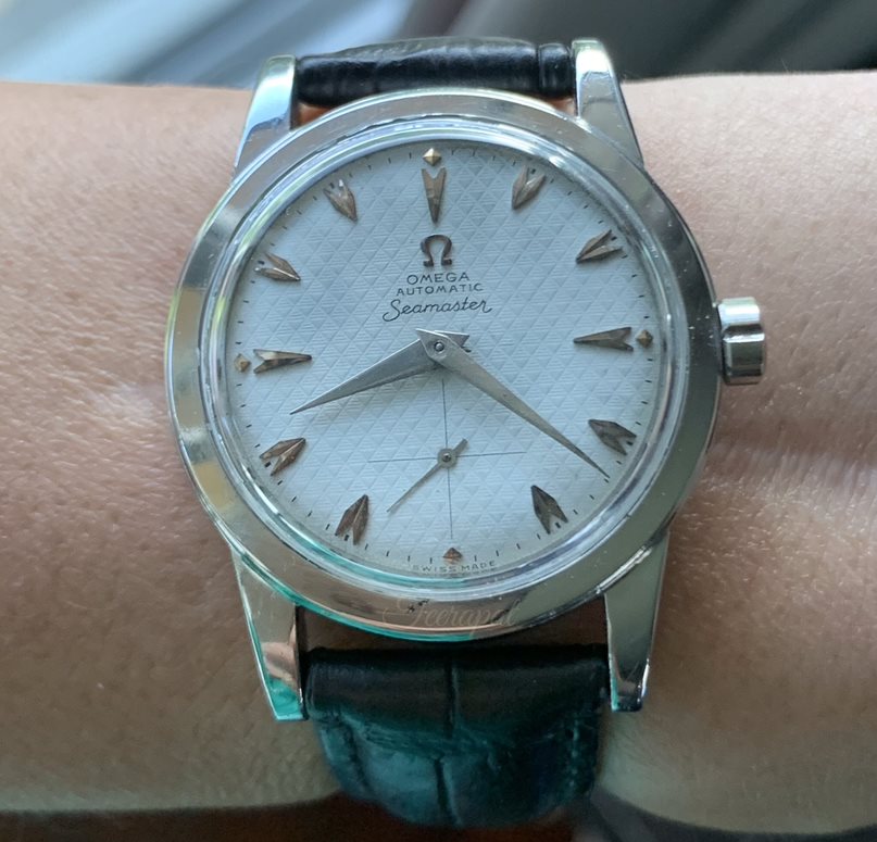

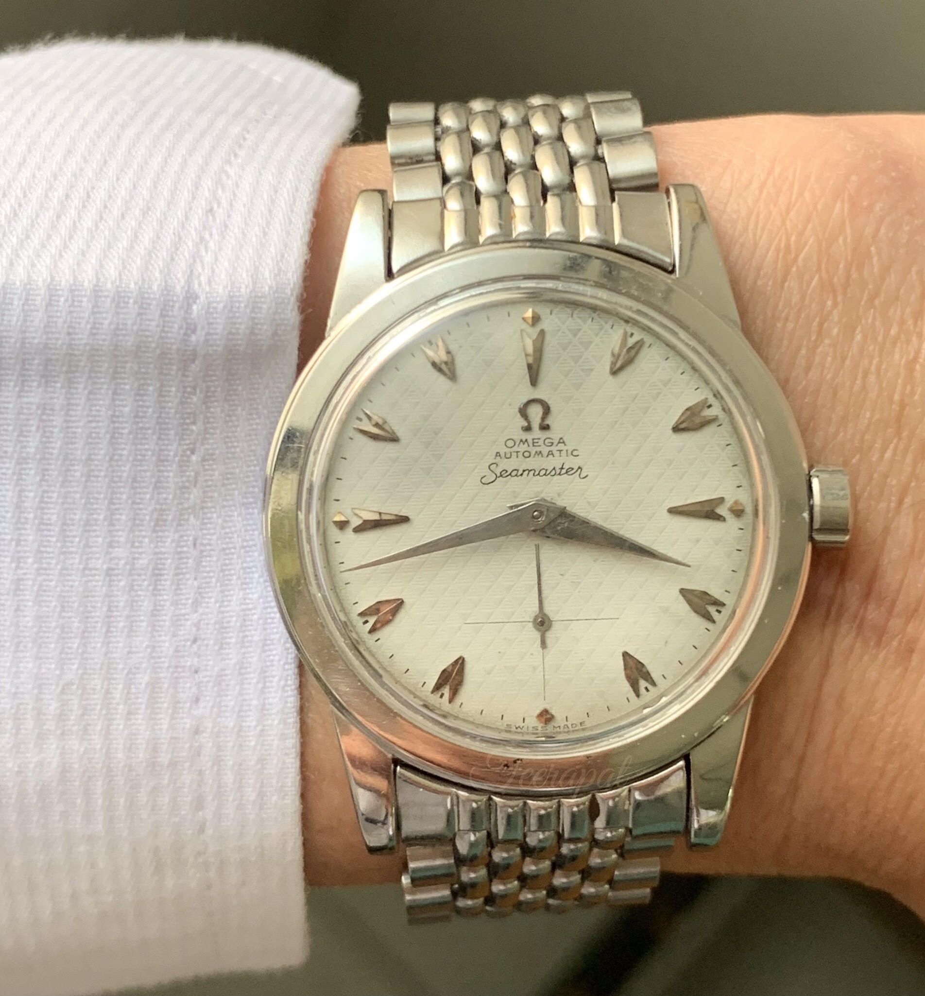

Finally, my wrist shot:
Could you please provide your comments and please share yours with these markers or these dial pattern.

I add more pictures of the hands which I believe that it was the same type with mine.😉

I am not anything like an expert on the model, but the dial appears to be far too clean and white for me to believe that it is original.

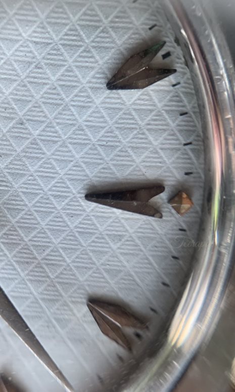

Regarding the hour-marker in some pictures that I posted, perhaps it’s look like the “Pinkgold”.
I believe that these markers were “all steel”, even the “Pinkgold” markers would be fine in the steel case.

I also think the OP's watch dial is original but in incredible shape for it's age. The second watch pictured on the bracelet I would suspect is a redial.
16,901
48,109

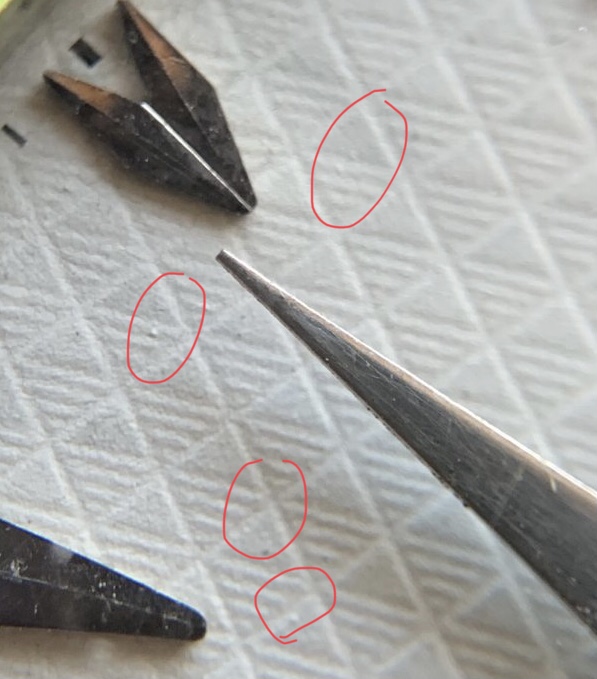

My bet is a redial as the white paint has painted over too many blemishes if you look close enough

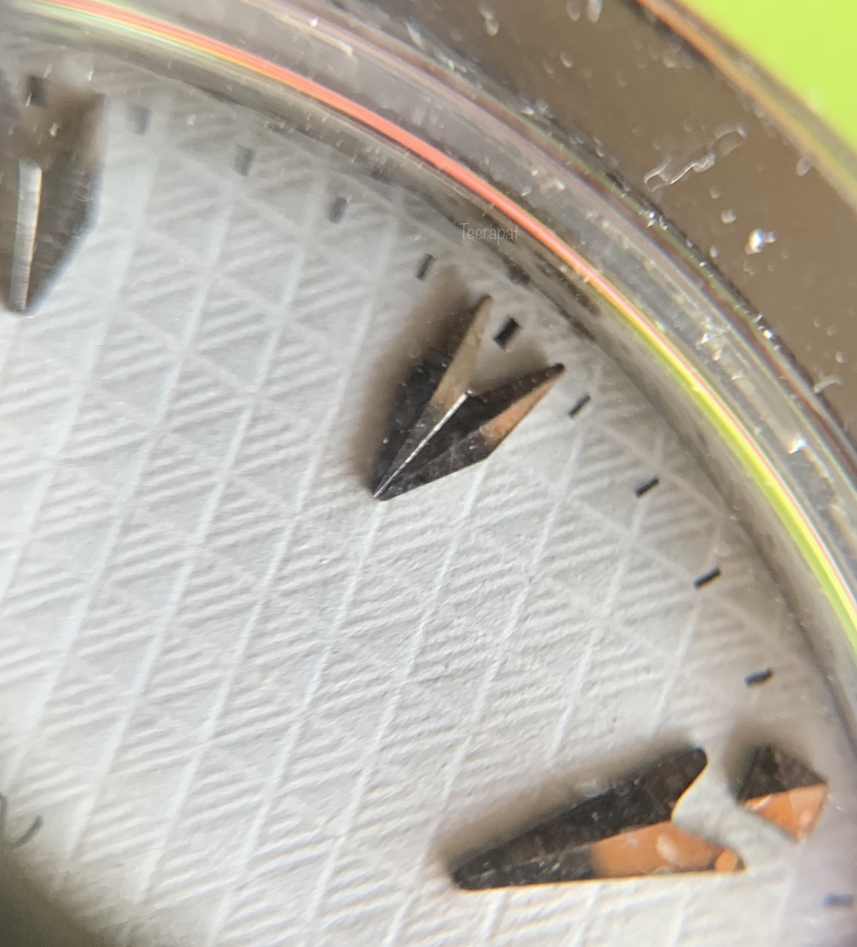

Below is only a section of the dial
and the ridges aren’t as deep as a untouched dial
16,901
48,109
Bubbles appear with moisture too though
As known….. but not as common on a waffle or textured dial 😉 , but the valleys of the texture filled in is enough for me.
But I have been wrong a few times before…..😗

Looks like white dial furniture to me, perhaps just some patina that gives it a different hue

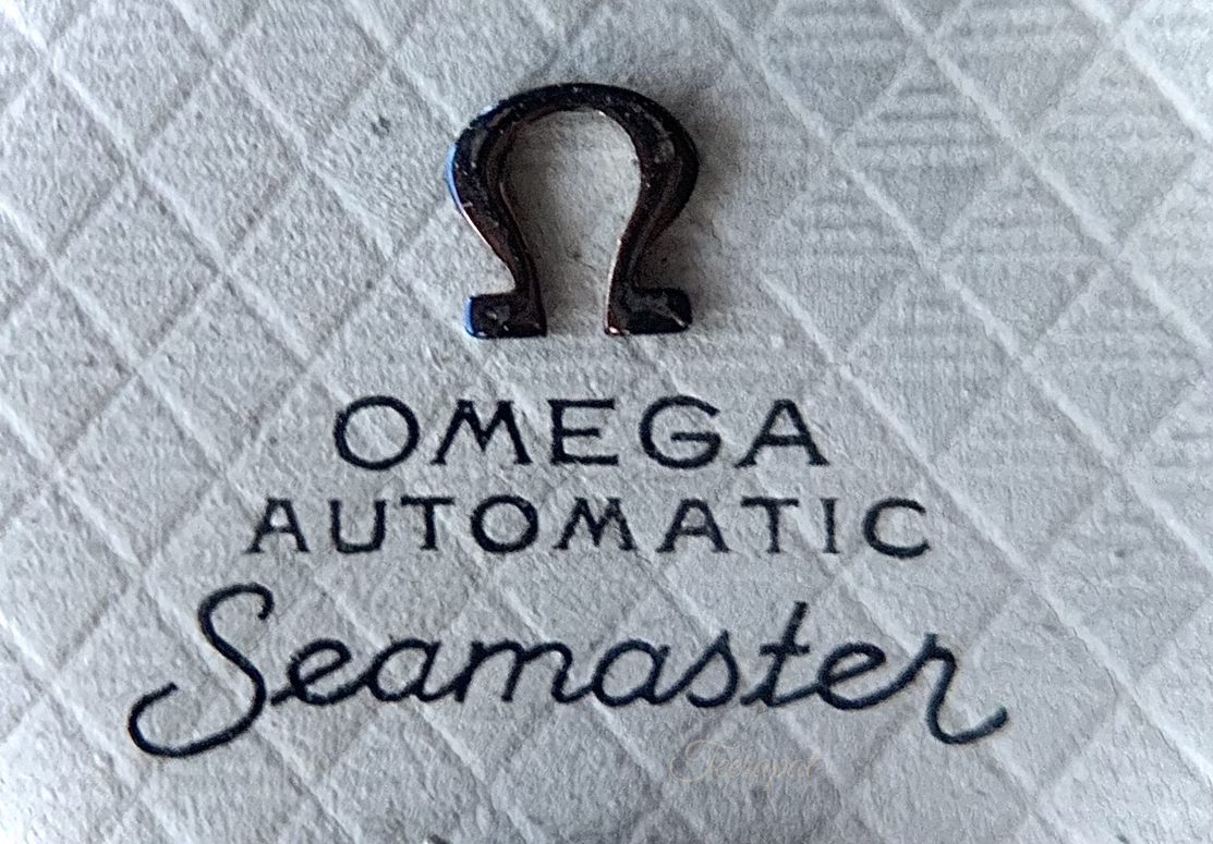

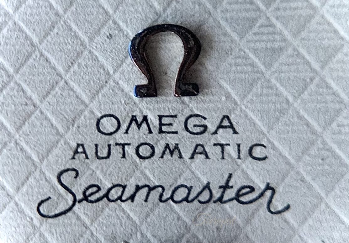

I would expect "coat hanger" S on these 1950s Omegas. Am I wrong please enlighten me.
Edit for misspelling.
1,022
4,123
@river9 , I think font types overlapped a lot and it isn't simply just a matter of font type when evaluating the originality of a watch.
My quick search found at least 3 examples with the same “S” shaped with mine in the omega 2576.
2,677
3,151

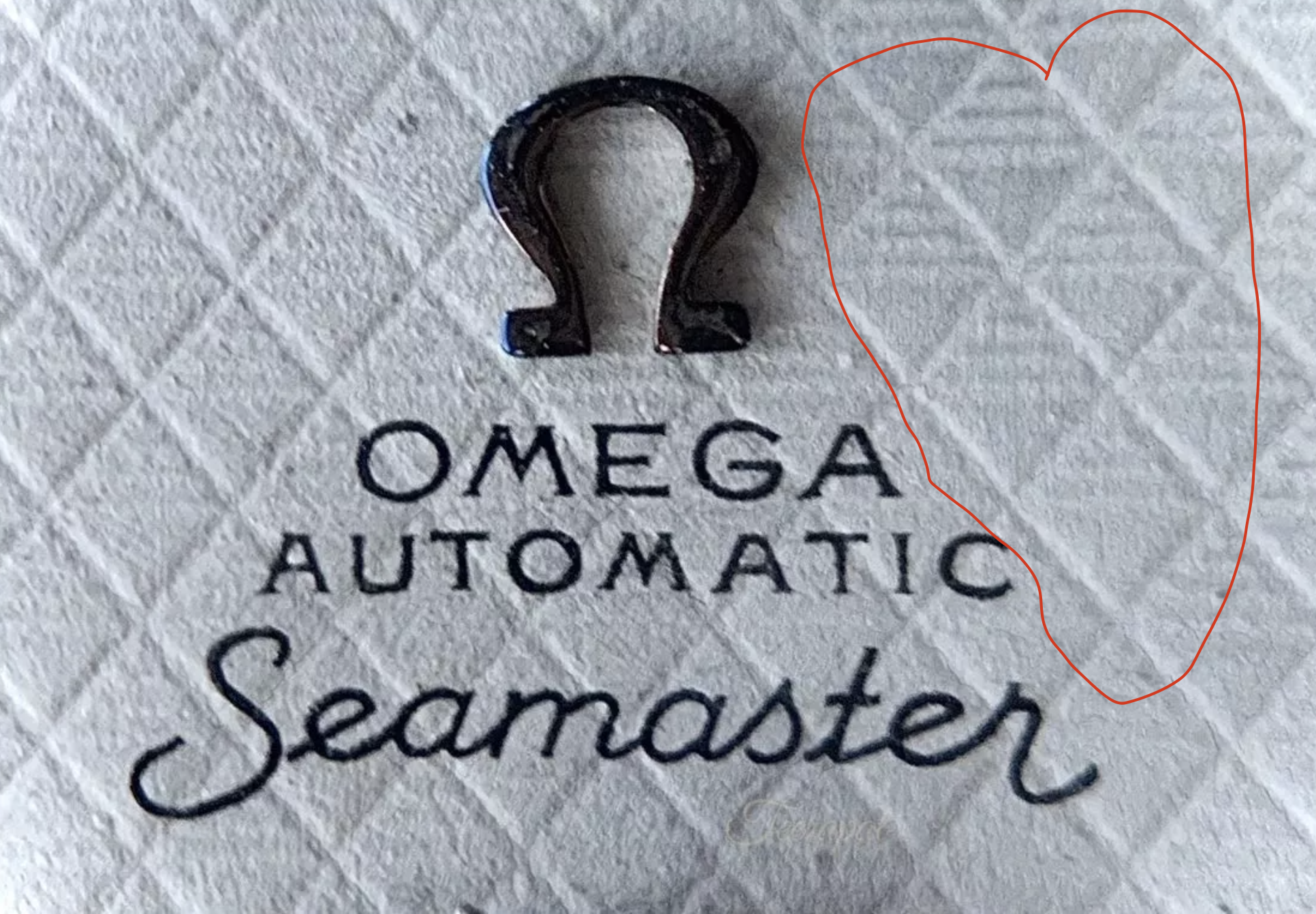

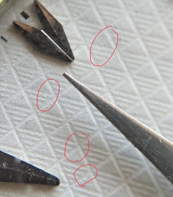

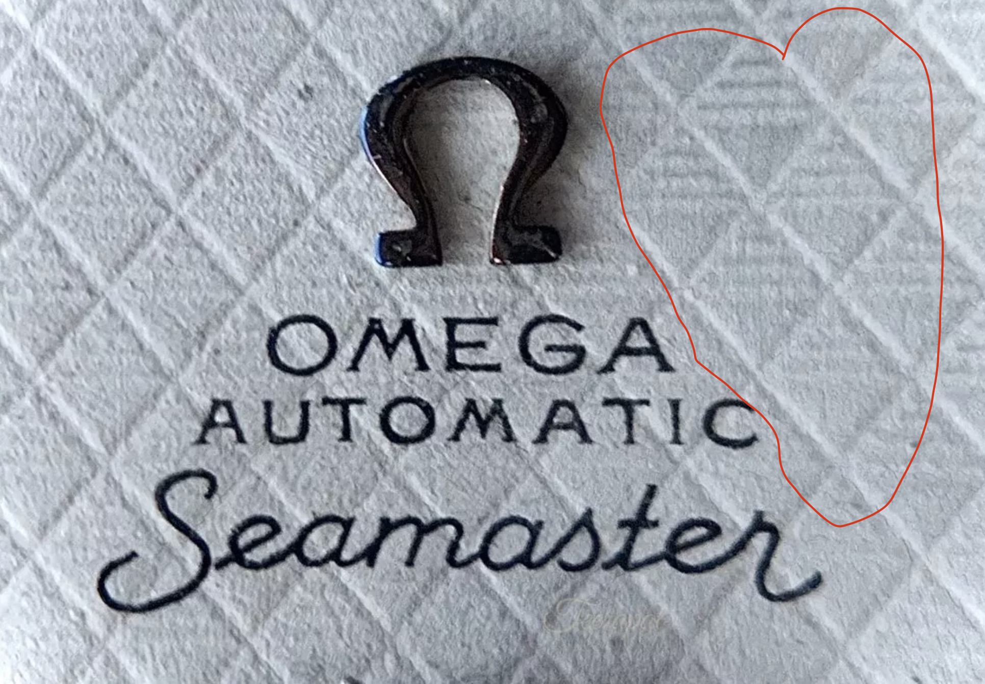

On your logo close up there are many paint imperfections, something like a brush stroke appears too

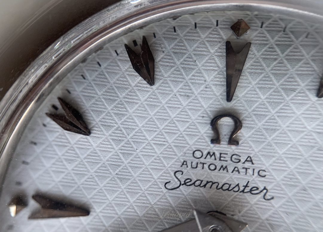

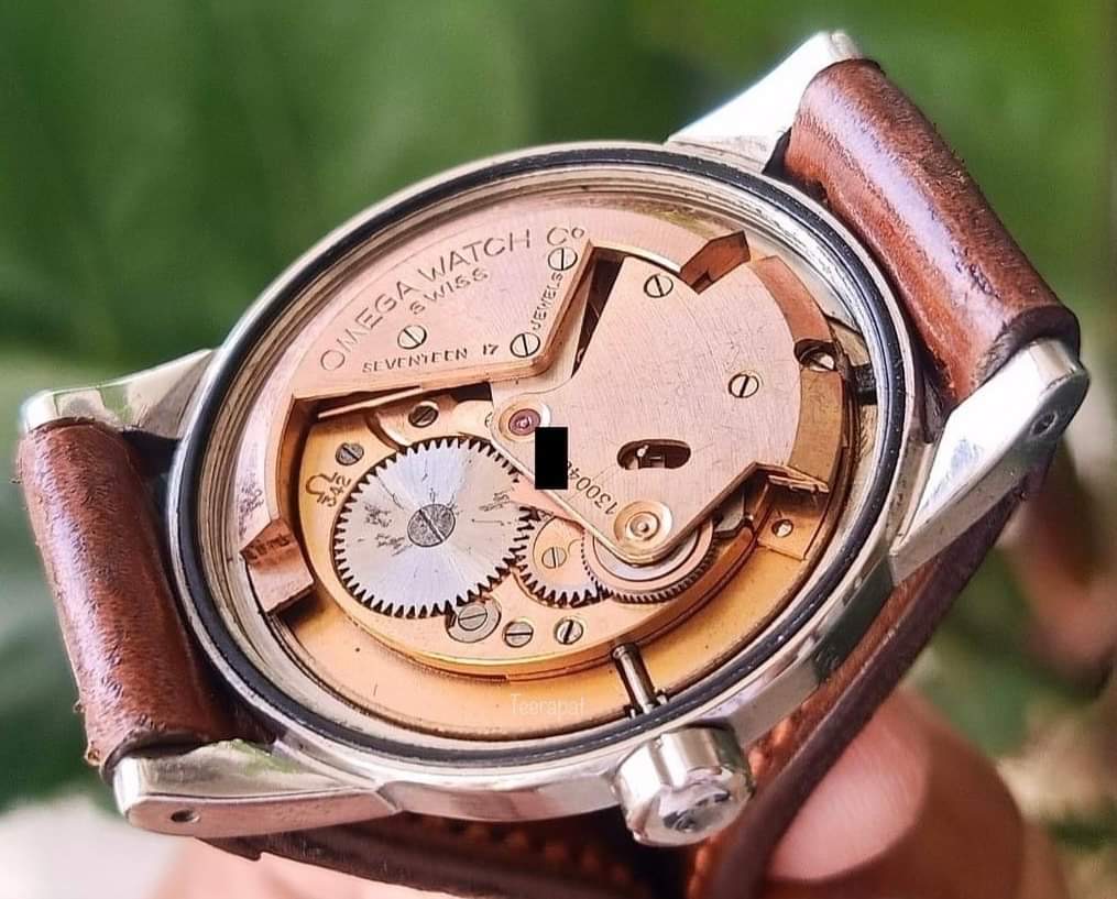

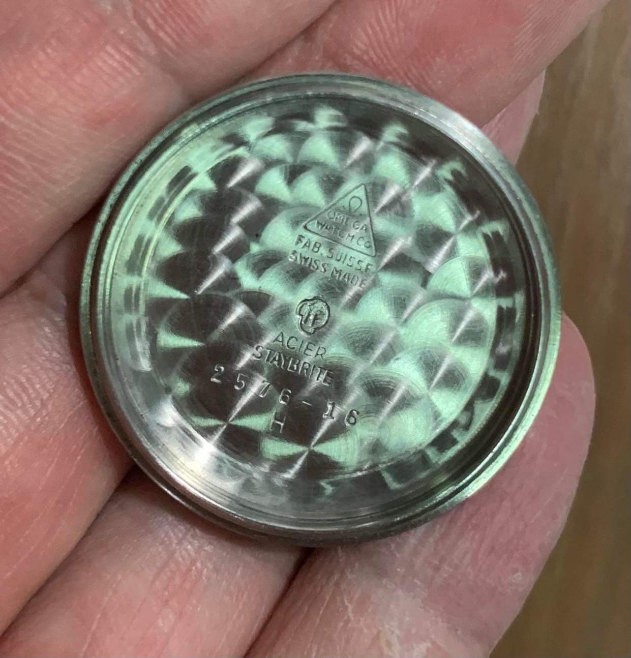

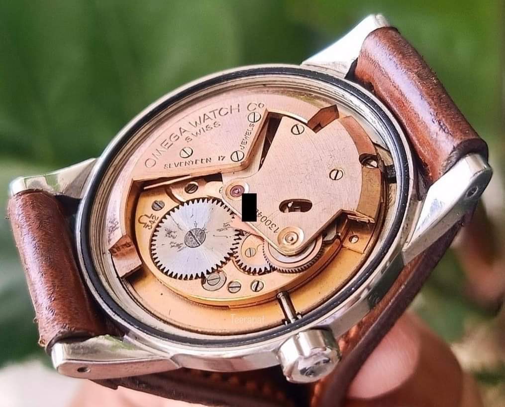

Hi All,
May I add more pictures of the movement and inside the caseback.
Now, I change the bracelet into the BOR type. It’s reference 1036 with end links number 11.
More pictures in natural light.

I think the watch is fine, maybe dial has been cleaned? Still a cool pattern on the dial and unusual markers.
631
788
I was going to suggest that could be streaks on the crystal, but then I saw similar "strokes" around the 2 o'clock marker in multiple photos. Perhaps it could be from cleaning? Would someone who could repaint a dial with a result this nice use a brush? Maybe to remove a piece of debris that fell into the wet paint? I'm just thinking out loud...

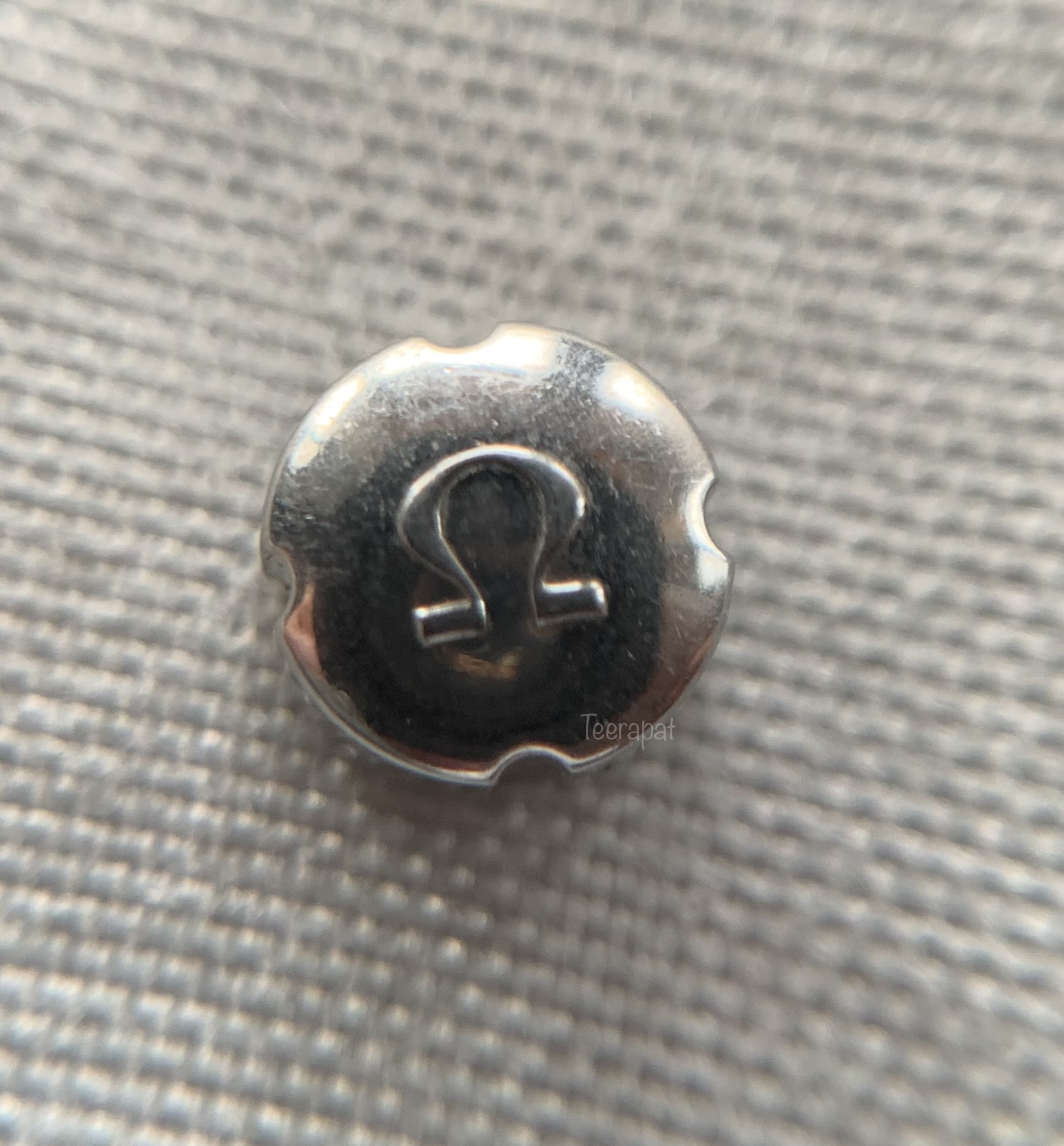

Finally, I will change the crown to be this “flat feet” clover leaf type which is the correct and original type.

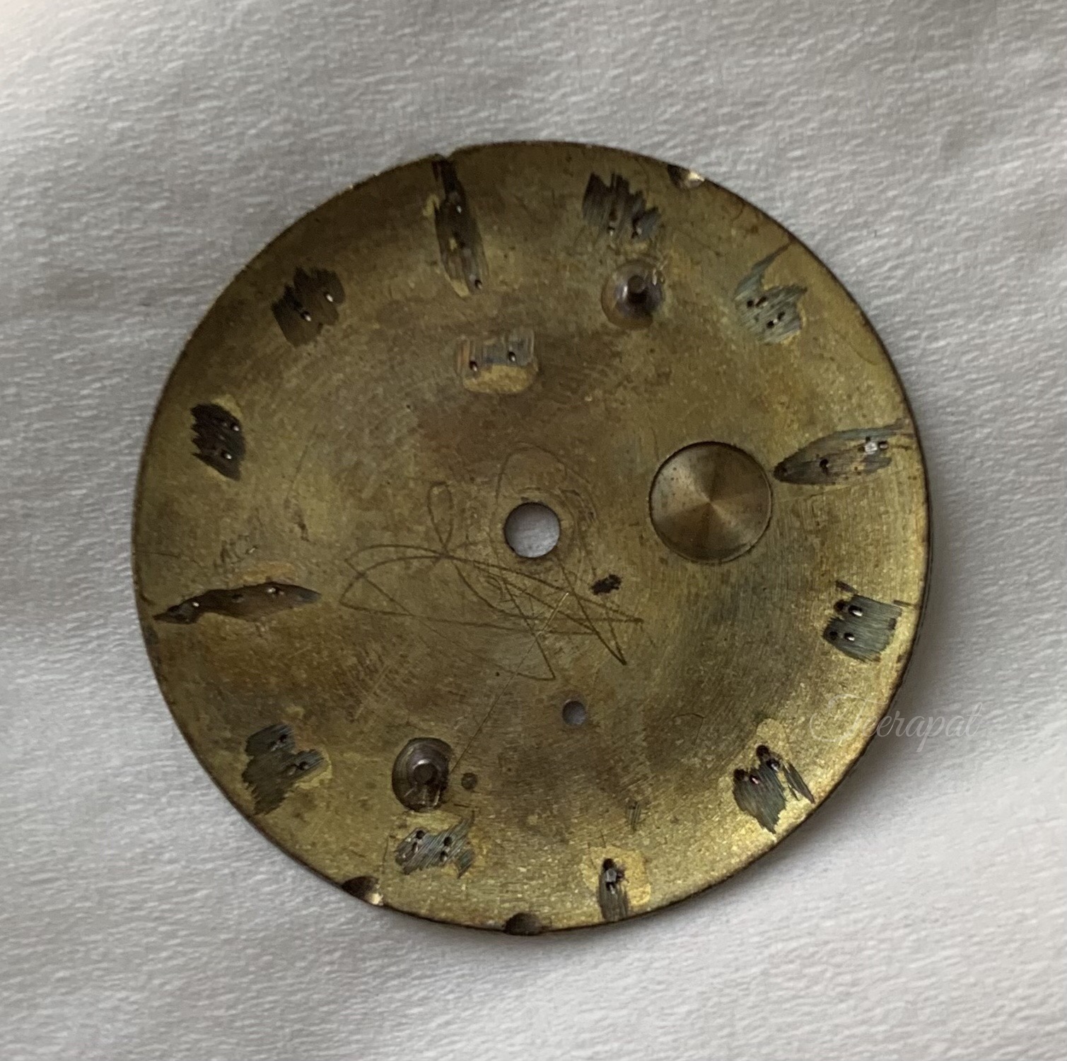

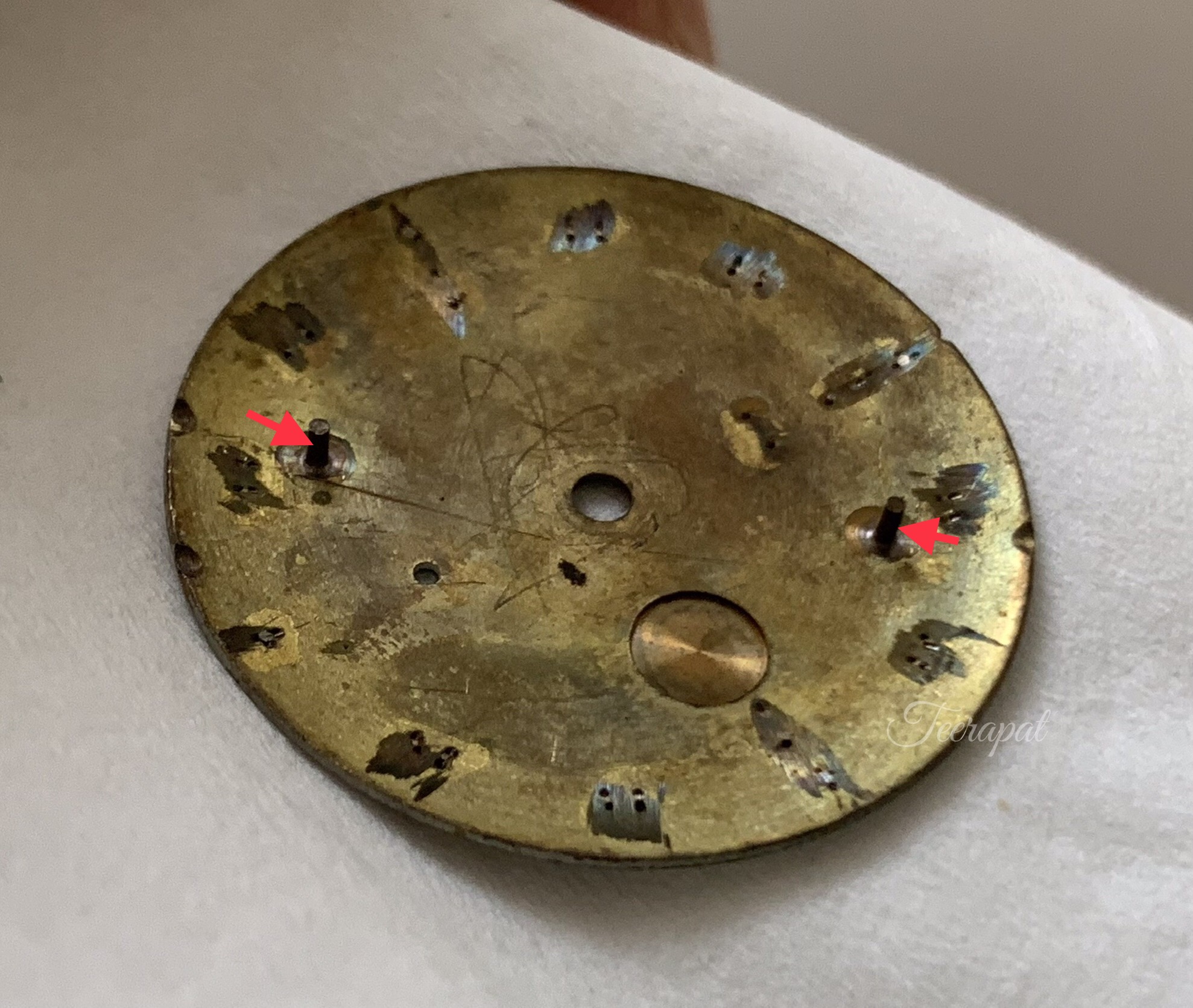

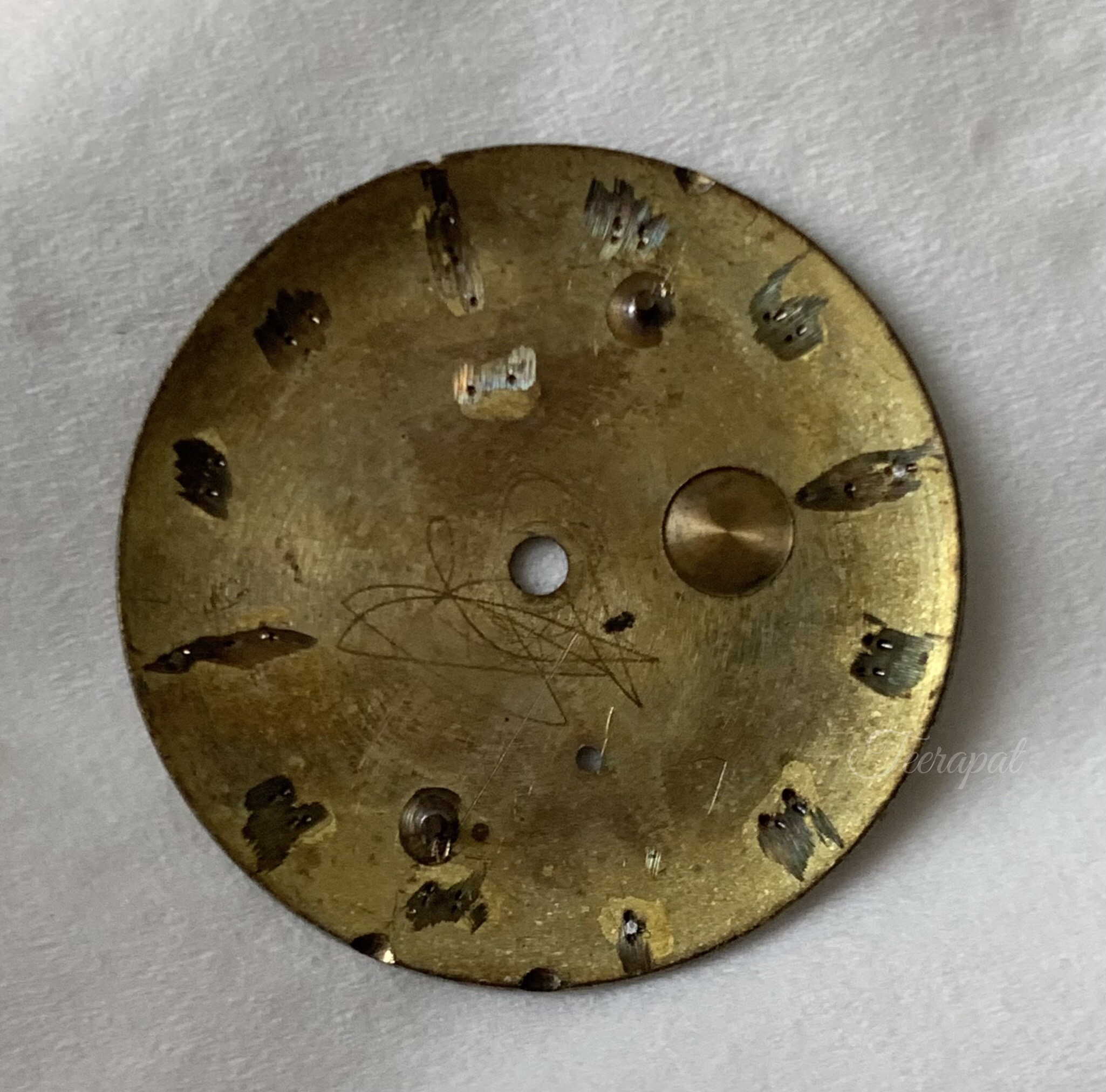

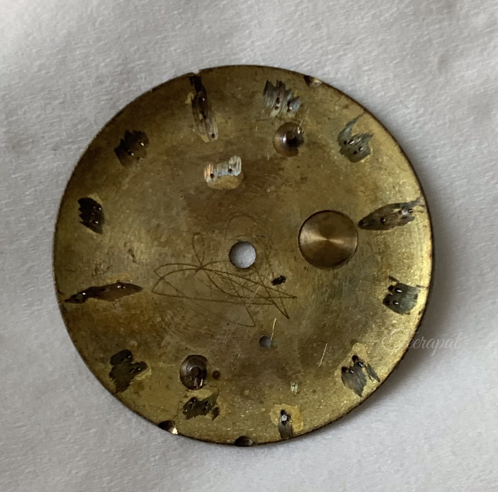

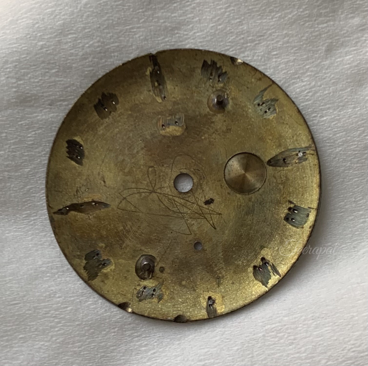

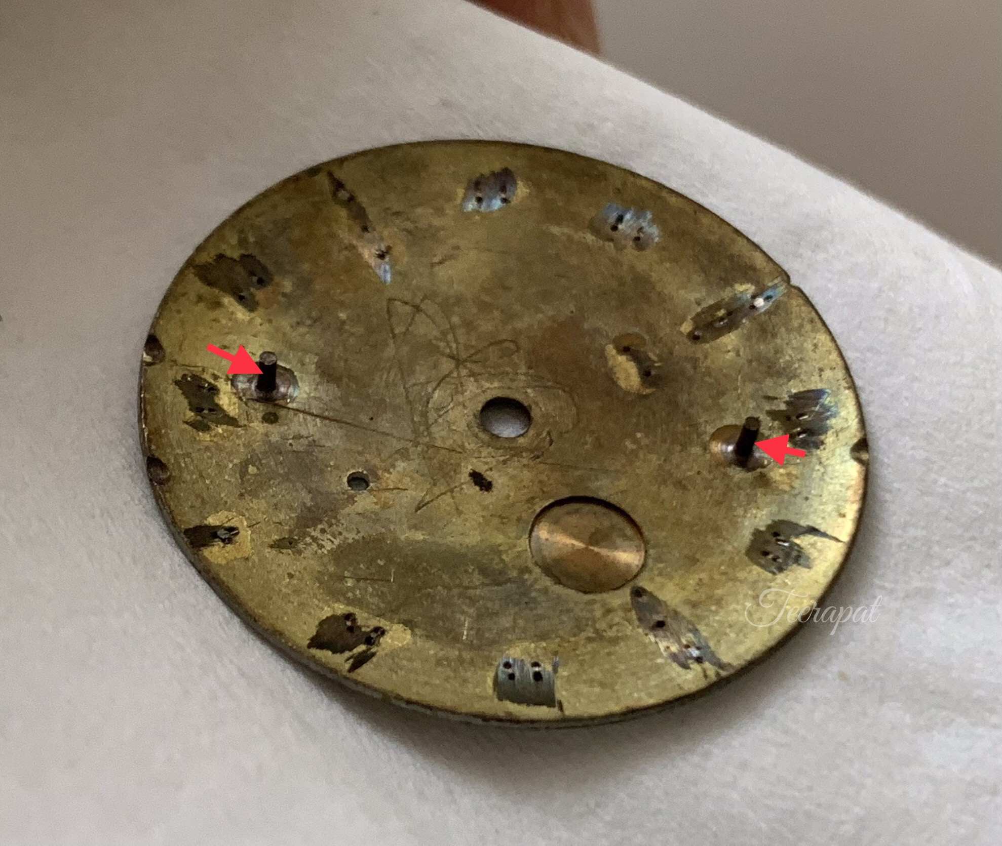

Hello all members,
Today I just visited my watch maker, I add more pictures from the backside of the dial.
Please note that two dial’s legs still intact (as marked by two red arrows).
Please let me know, what’s your thoughts?
