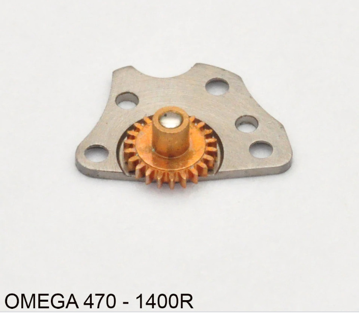

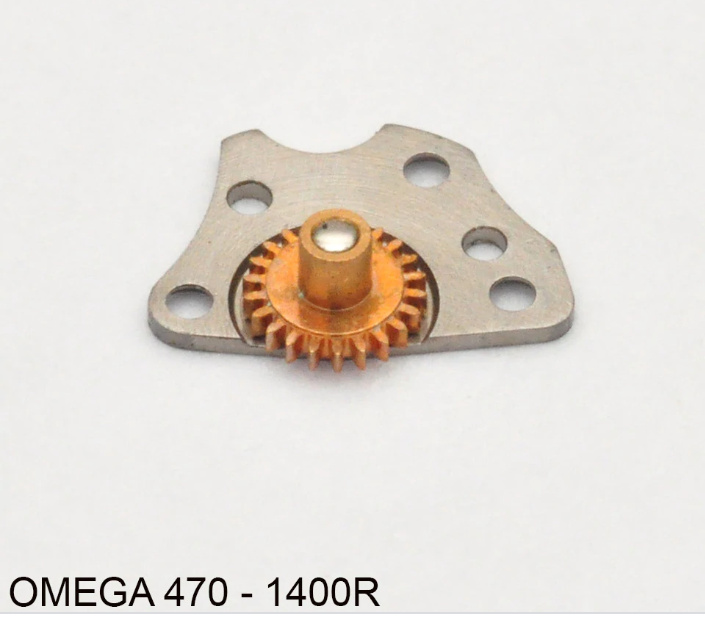

First of all the oscillating weight has been left running while worn out (the bored hole that fits on the supporting stem is worn and enlarged), so the rotor wasn't oscillating true and it rubbed on the movement itself, chewing the pinion teeth that engage on the reverser.
In the rotor that you've bought is the bush that has failed in your original rotor. It also has the teeth on that bush that were damaged, if I understand you correctly. The axle is also in your new packet as the bush and axle are a matched pair - it's not quite that complex but that's the easiest way to think of it.
Unless your original rotor is damaged elsewhere, your watchmaker could switch the bush and axle from the new rotor to your old one and this is the typical repair which keeps the original rotor. In fact, the repair kit (bush plus axle) used to be available as 470-1400R (I'm not at my PC to check the number). The "R" is very important as part 470-1400 is just the axle.
Good luck, Chris

Another slightly pedantic point is that the later versions of the 501 like yours have 20j (see your original rotor), the earlier versions and this replacement rotor are marked 19j. It would annoy my watch OCD to fit that but it would not affect it functionally I assume. Another reason to fix the old rotor rather than swapping it out. Maybe that is why Chris is suggesting fixing it above in fact, but he is too tactful to point out your new rotor isn't quite right.

Yeah exactly! I found that part number too, but was unable to source it at any reasonable price, most of the stock I found came from the US, thus making the shipping fees often as pricey as the part itself. So I decided for a new complete rotor. I’ll talk to the watchmaker about swapping only the axle and bush. As I pointed out I was aware of the difference in jewel number marking (there’s no difference except for the engraving afaik) for the 503 calibers, but a new rotor for the 20j version was impossible to source or way too pricey (I’ve found some for 160$+shipping from the US to IT, so the total would have come to quite more than 200$ for just the rotor). It would definitely annoy me had it been a “collection” watch, this time it will be given to my dad as a gift for his 60th birthday, he’ll probably never even see the rotor… anyway your point is right and savvy and I’ll ask the watchmaker.

What I learned is that you can actually remove the bush from the new weight and transfer it to the old one: I thought that once removed it might ave become unusable to be put in another weight, and you could only install a new replacement bushing, that I’ve been unable to source.
2,219
4,955
Yes, it's normal to just replace the bush and not the steel axle. However, you have to open the bush out with a reamer or smoothing broach after fitting it to the rotor so that it suits the axle. I wasn't sure of the knowledge of your watchmaker so the simplest is to fit the pair. The bush should be 470-1429. Anyway, you've already got that.
I have one here to fit at the moment, just the bush, on a customer watch - a cal 491 which is the same series as your watch. I am very short of these bushes now ...
