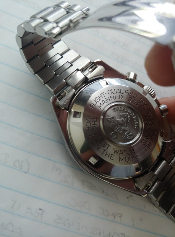

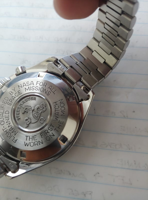

I'm trying to remove the bracelet on my 3590.50, but the spring bars seem to have been worn down and won't compress. Anyone ever have a similar issue / have an idea on how to get them out?? Sorry for the poor photos!

Just a generic one, but that's not the issue - the donut on the spring bars are all but gone on all 4 sides. Seems as if the last owner tried to remove them as well and just wore the donuts down, so that the spring bar tool has nothing to catch on.
