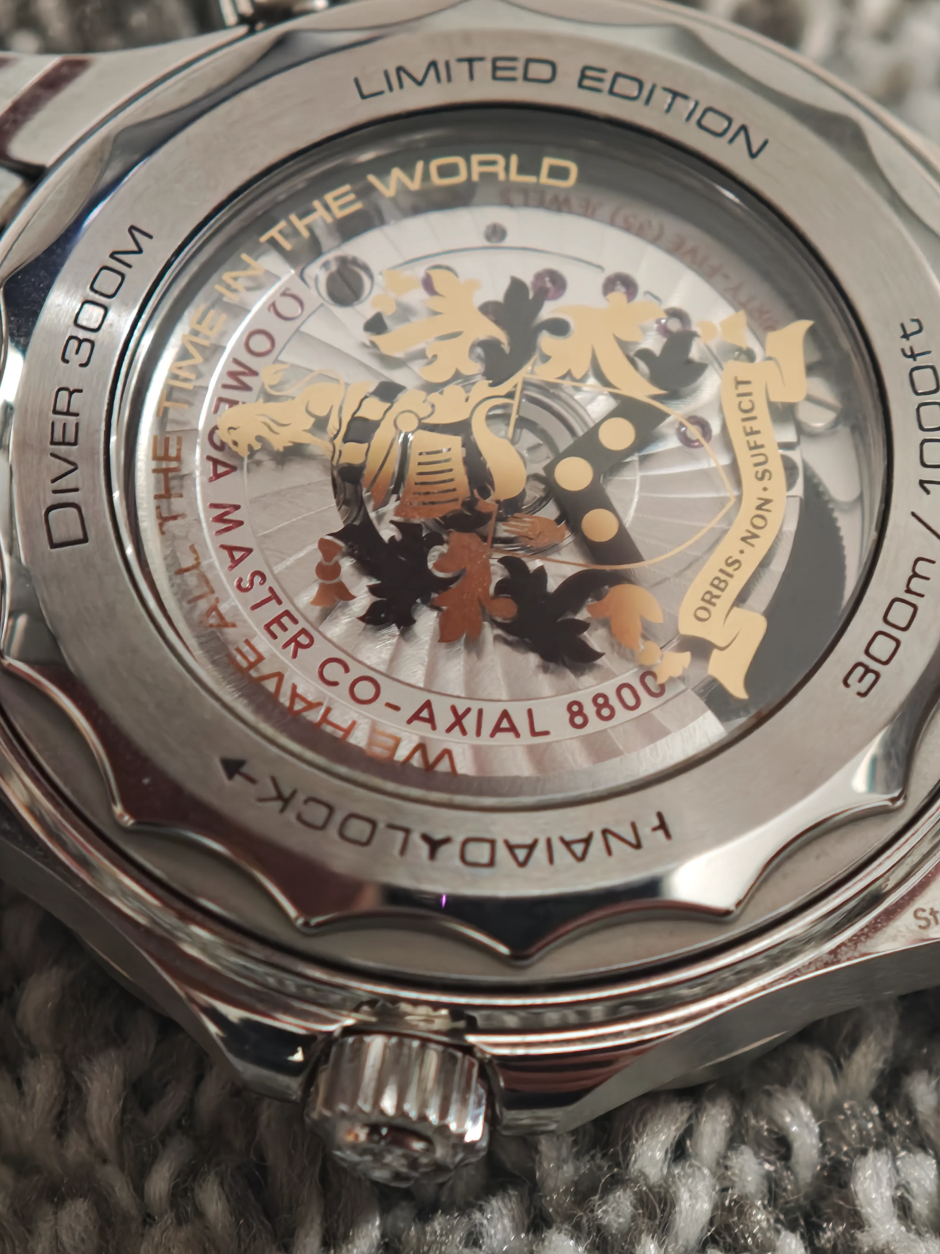

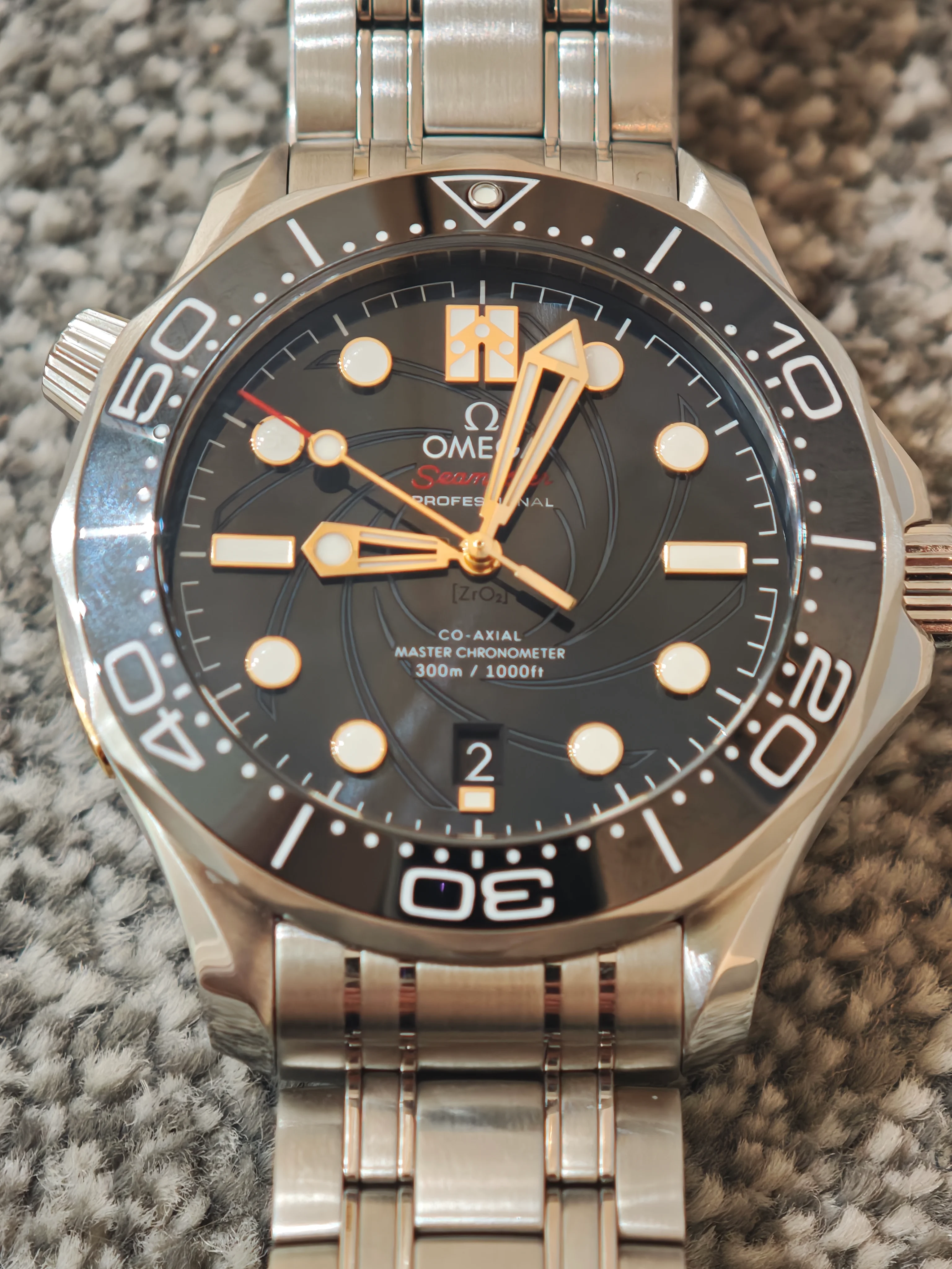

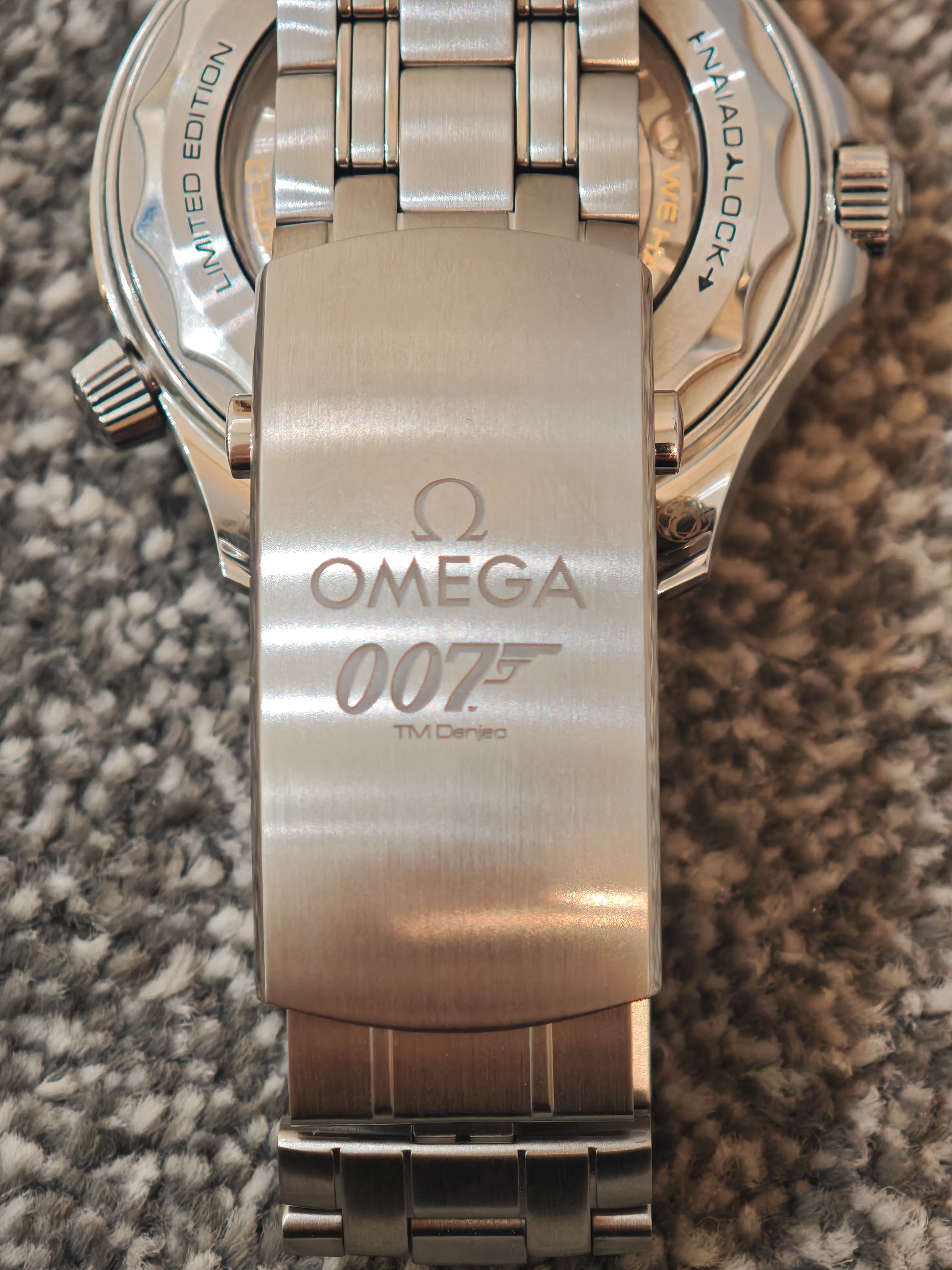

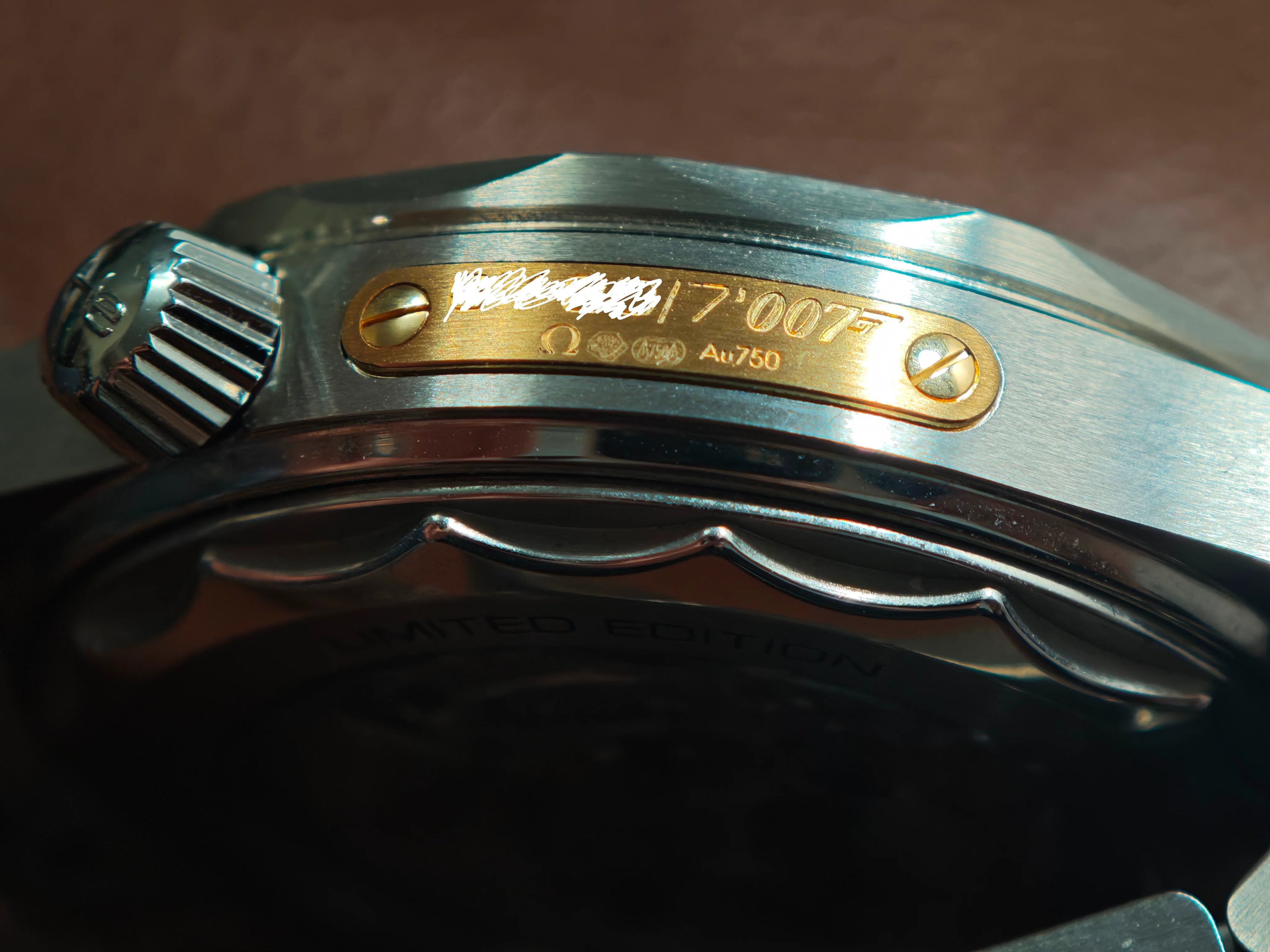

Hello, me again! Posted a few days ago about a 007 early 2000s model I had (sent back for a refund now). I picked up a more modern 007 James Bond Limited Edition model (same seller...I know! Ha), and just wondering if people can authenticate this...It comes with box, papers etc. TBH, when it arrived, I thought it was brand new! It's mint and looks unworn. I very much doubt its a fake but I'd like to check for good measure! The only thing throwing me off is the little gold plaque on the side, images online show the little hallmark symbols quite clearly, but mine seem hard to see (to the right of the Omega logo), what do people think?
Thanks

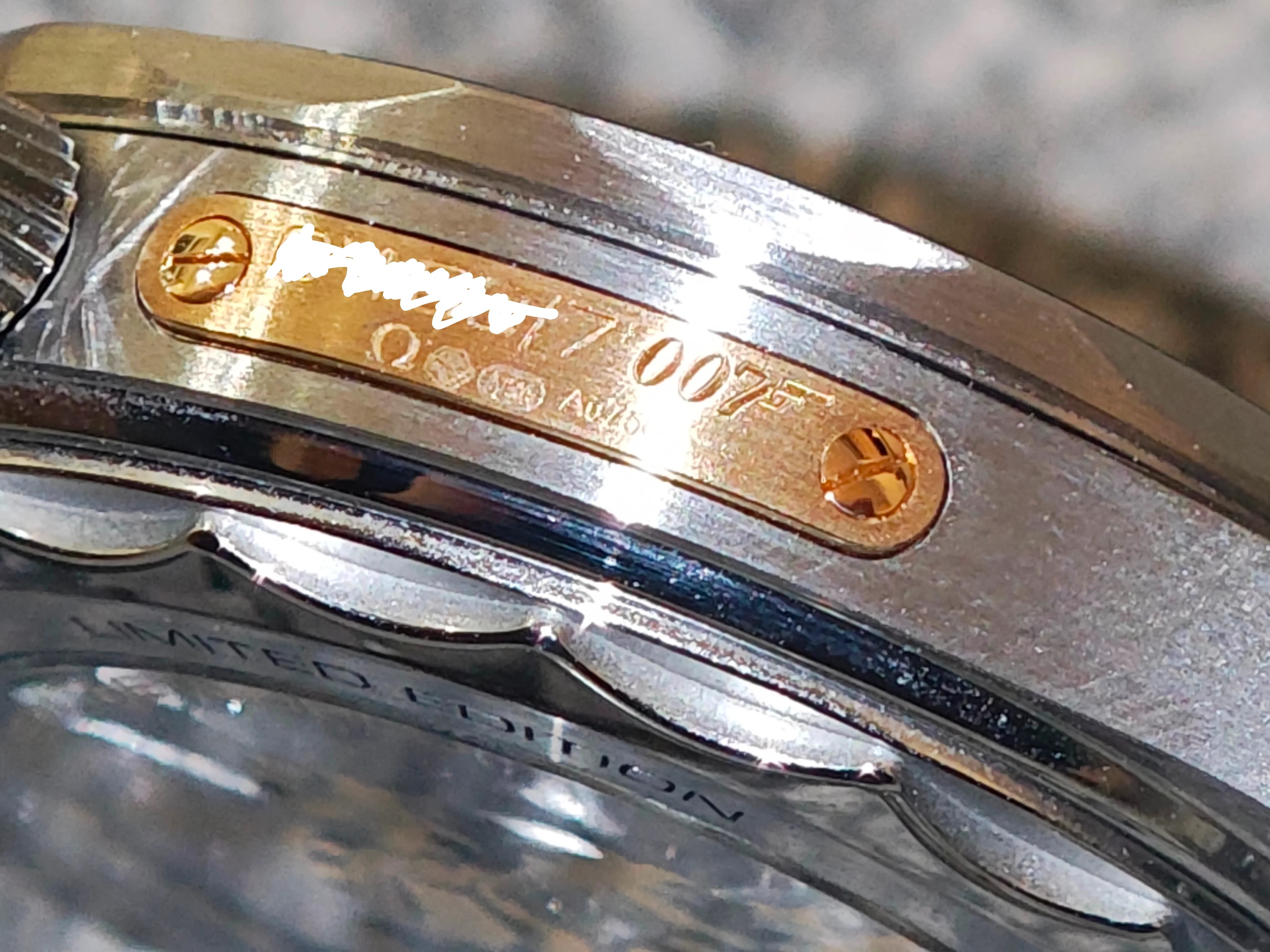

Think I may be being paranoid due to my previous experience but here's a better photo of the plaque, looks a lot clearer there 😀

Could you show multiple angles of the movement as well?
Here's the best I can do due to the motif on the glass and without showing the serial.
Also, while getting that shot for you, I noticed that one of the metal movement parts under the glass, behind the rotary weight, actually has a matching serial number on it, which matches that of the serial on the body and in my papers, surely this would have to be an insanely good fake if it were...?

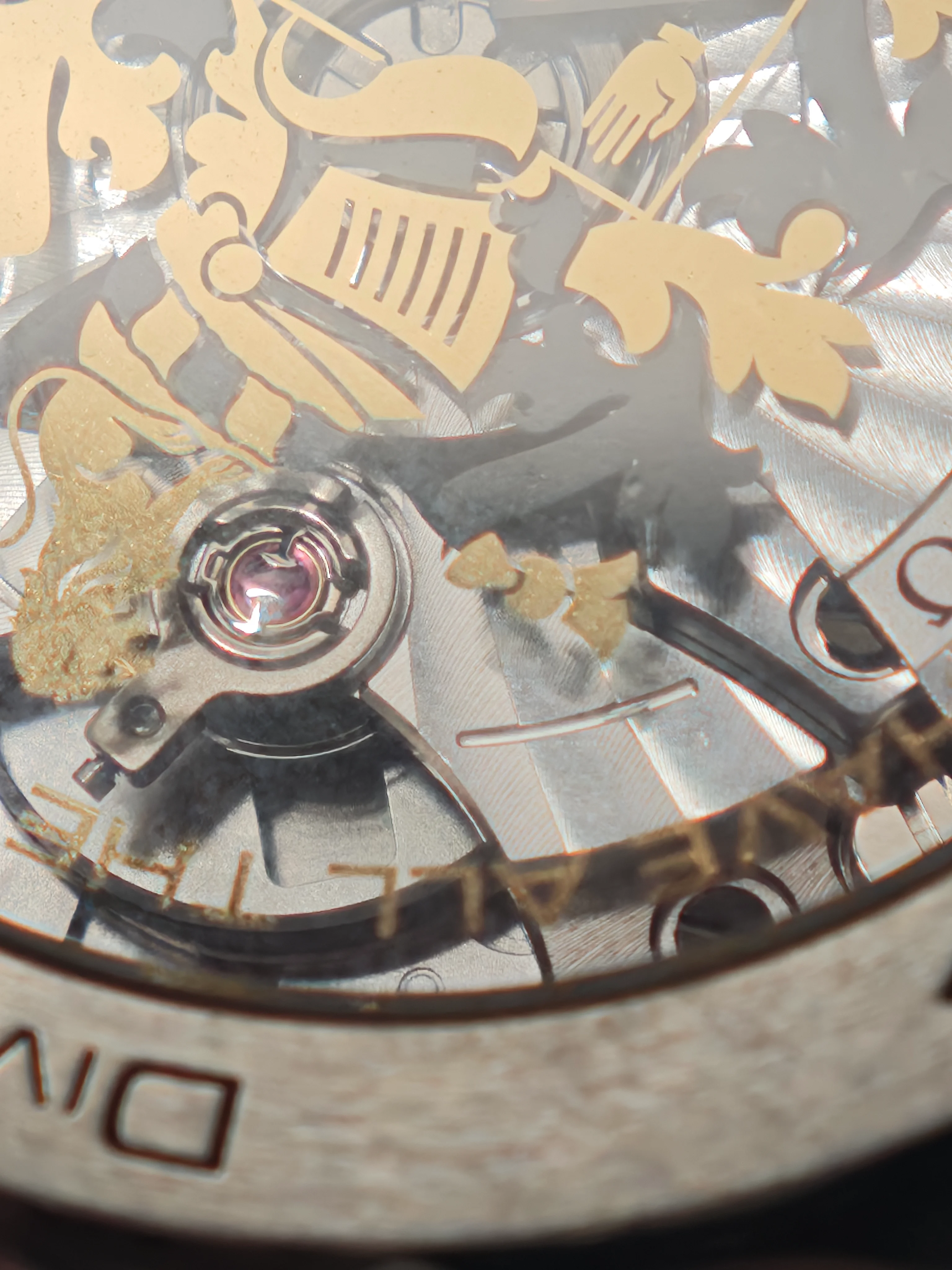

How about a pic with the rotor to the other side, you could obscure the movementno before posting?
Does this help? Sorry, it's a real pain to photograph this due to the design on the glass

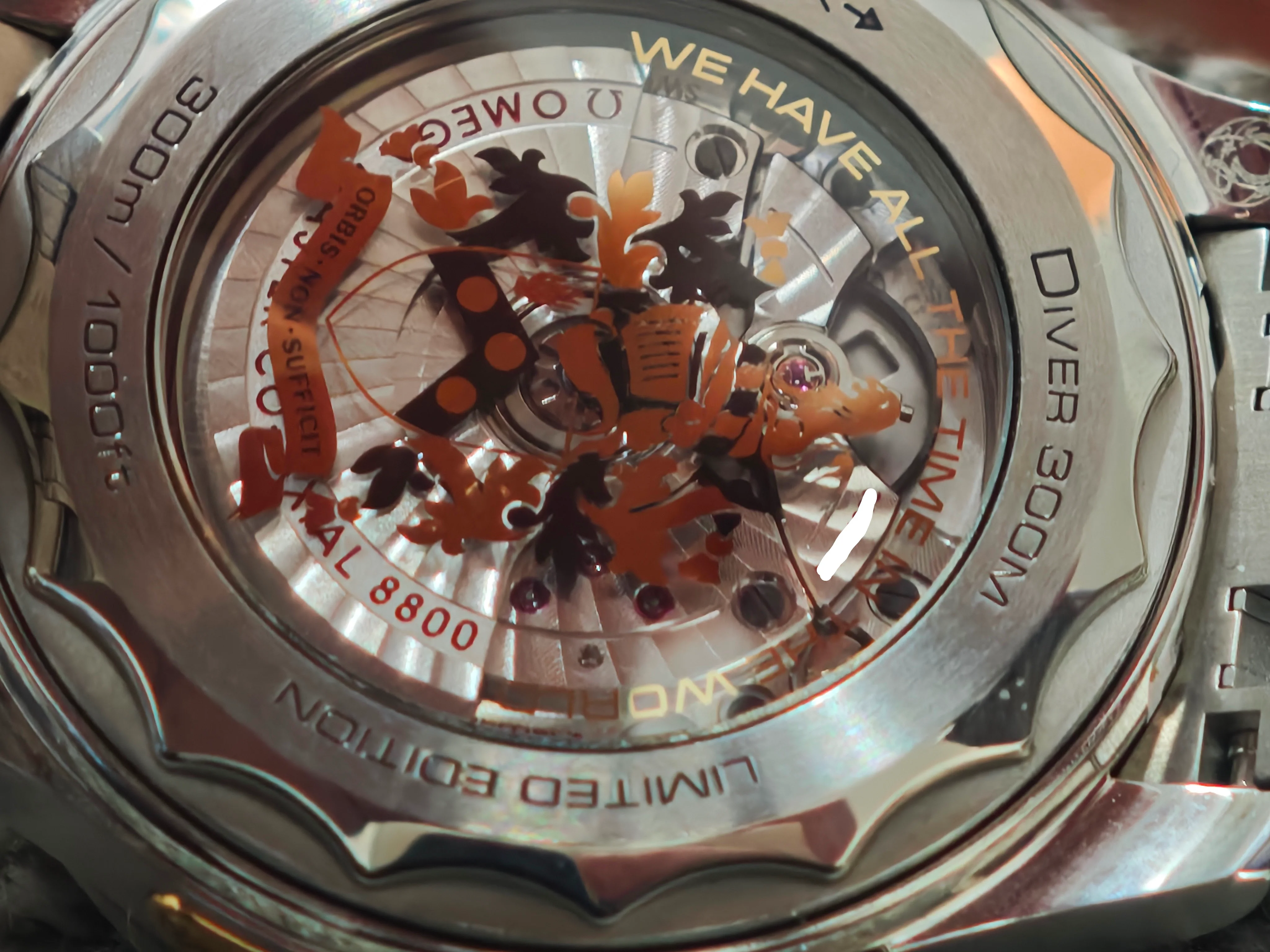

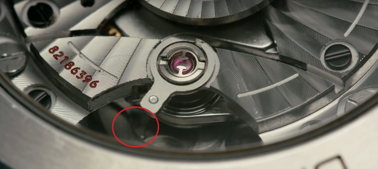

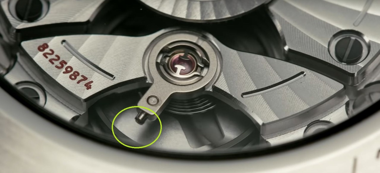

Could you get a pic from the other side for a better view on this part, this would be very telling if it's a fake or not:
13
3
Yeah sure! Here you go 😊
6,483
31,901
Looks real to me, also check this thread;
13
3
Thank you! That's a relief and that's a good post! I see the quality difference there between the one that's suspected to be a fake and the real deal. And mine looks identical to the real deal one. I can go back to enjoying the watch now and not worrying about it's authenticity 😊 really appreciate your insight

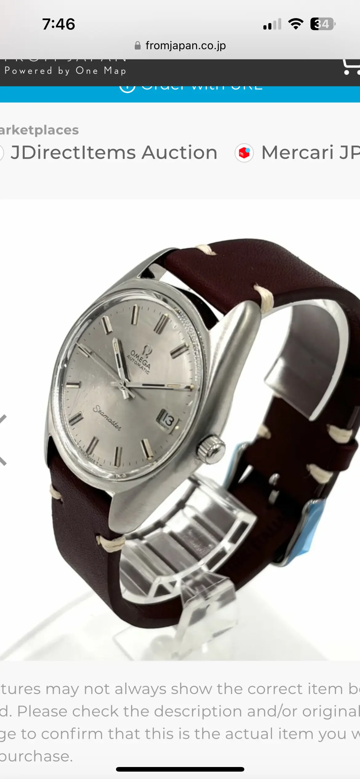

Looking to buy my first omega this off fromjapan curious if it’s legit and worth the price of $780 CAD
