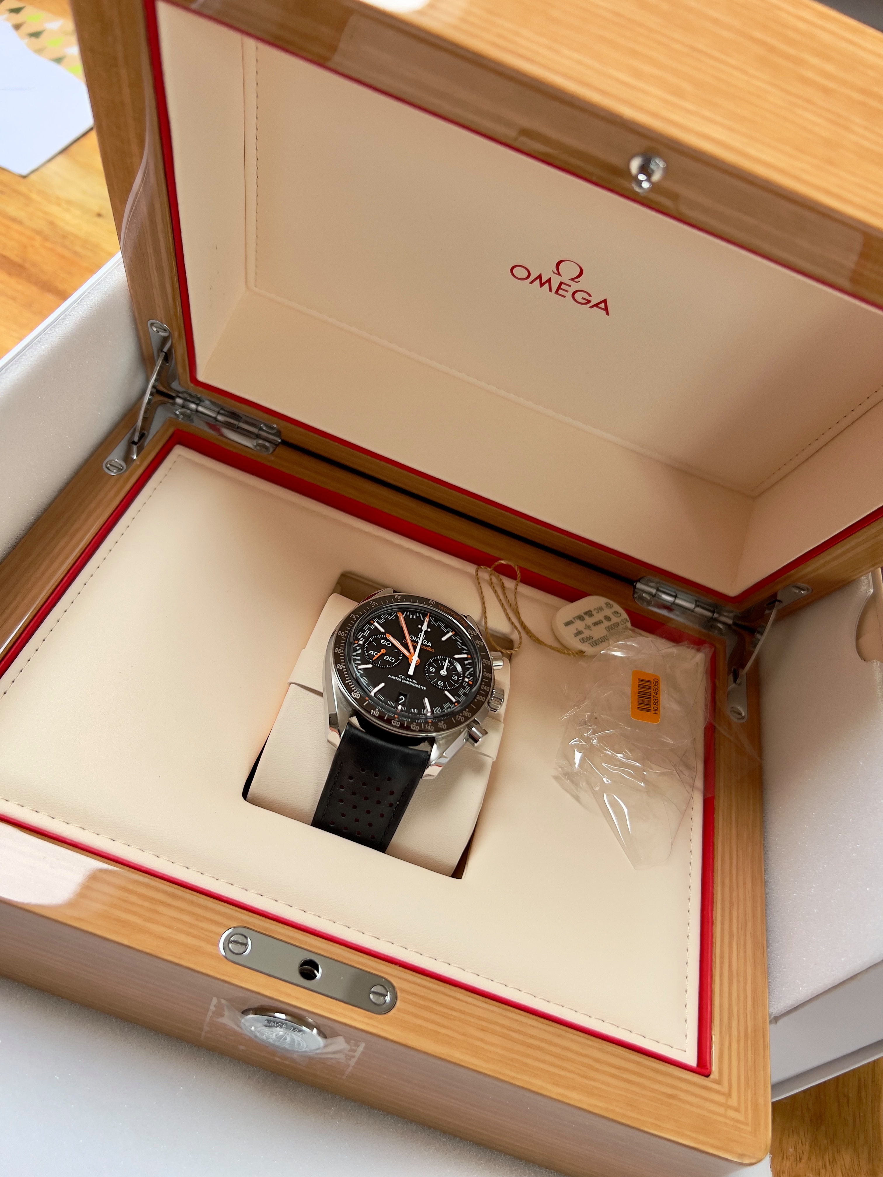

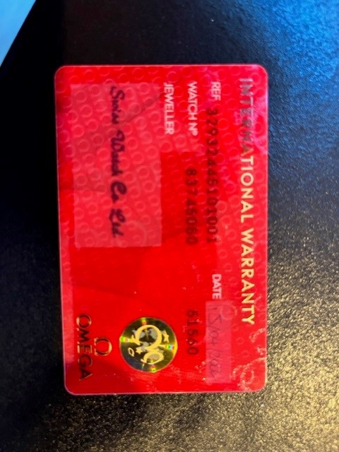

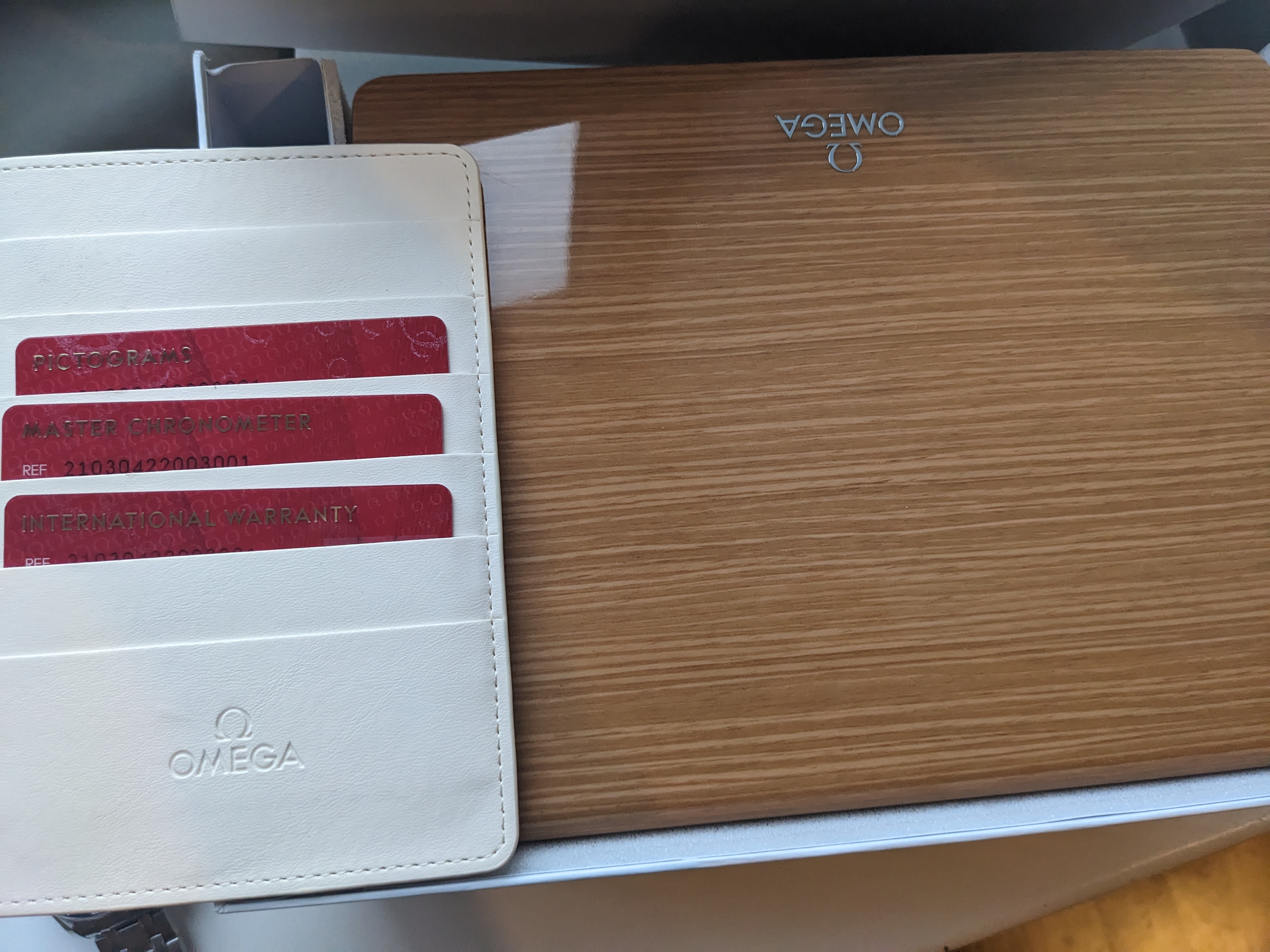

Great! I'm was tossing the box anyways. What cards are supposed to come with the watch? I did not receive the int'l warranty card, is that normal since JS is not an AD?
Joma is a grey dealer and one way they are able to offer these at such a discount is they do not come with a factory warranty, meaning you do not get any cards. They are sold with a Joma warranty instead. This is also likely why you didn’t receive the correct watch box. Joma likely received this watch in a “watch coffin” which is a see thru plastic case and then paired it with a box they had on hand.
Edit to add- Congrats on your marriage and marrying a partner with obviously good taste and savvy for watches 😀 wear it in good health and have fun! It’s a great piece.

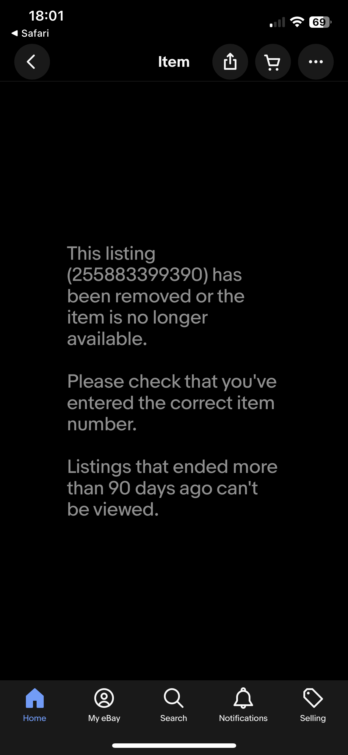

Can't speak to the watch---to my untrained eyes looks real enough. But note that the seller is using an account whose latest feedback is over a year old, and is linked to a company that appears to have been dissolved several years ago. So I'd agree: scam---using real images and a hijacked account with good feedback. You buy the watch and they send you a fake one (that doesn't match the images) or perhaps nothing at all.
Always do your diligence. And when it seems too good to be true, it probably is.

The price just seemed way too low.
Yeah it's an interesting strategy. You'd think this trap might catch more quarry if the listing-price were actually higher, and thus more believable. But maybe they're after the truly gullible---and are also banking on the fact that a smaller crime will make it more likely that the victim just cuts his losses rather than battling all the eBay red tape required to get the money back-?

I suppose at that price it wouldn’t go through the eBay verification process either.
Never bought off eBay, it seems too risky as a novice.
13
6
Reported the listing to ebay and it has gone already, although the closed listing is visible in my watched item list with a completely different seller username. Thanks guys you were spot on.

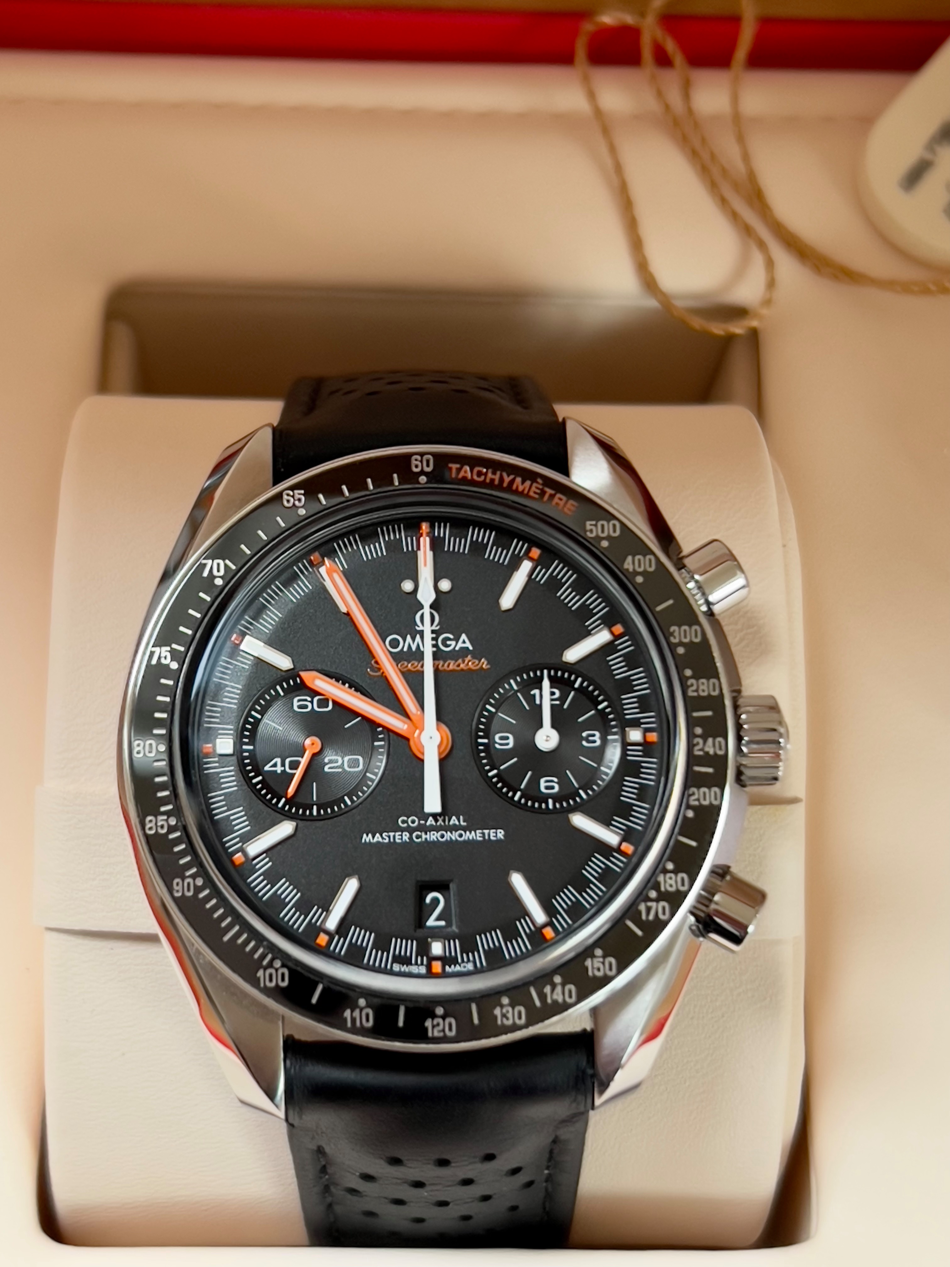

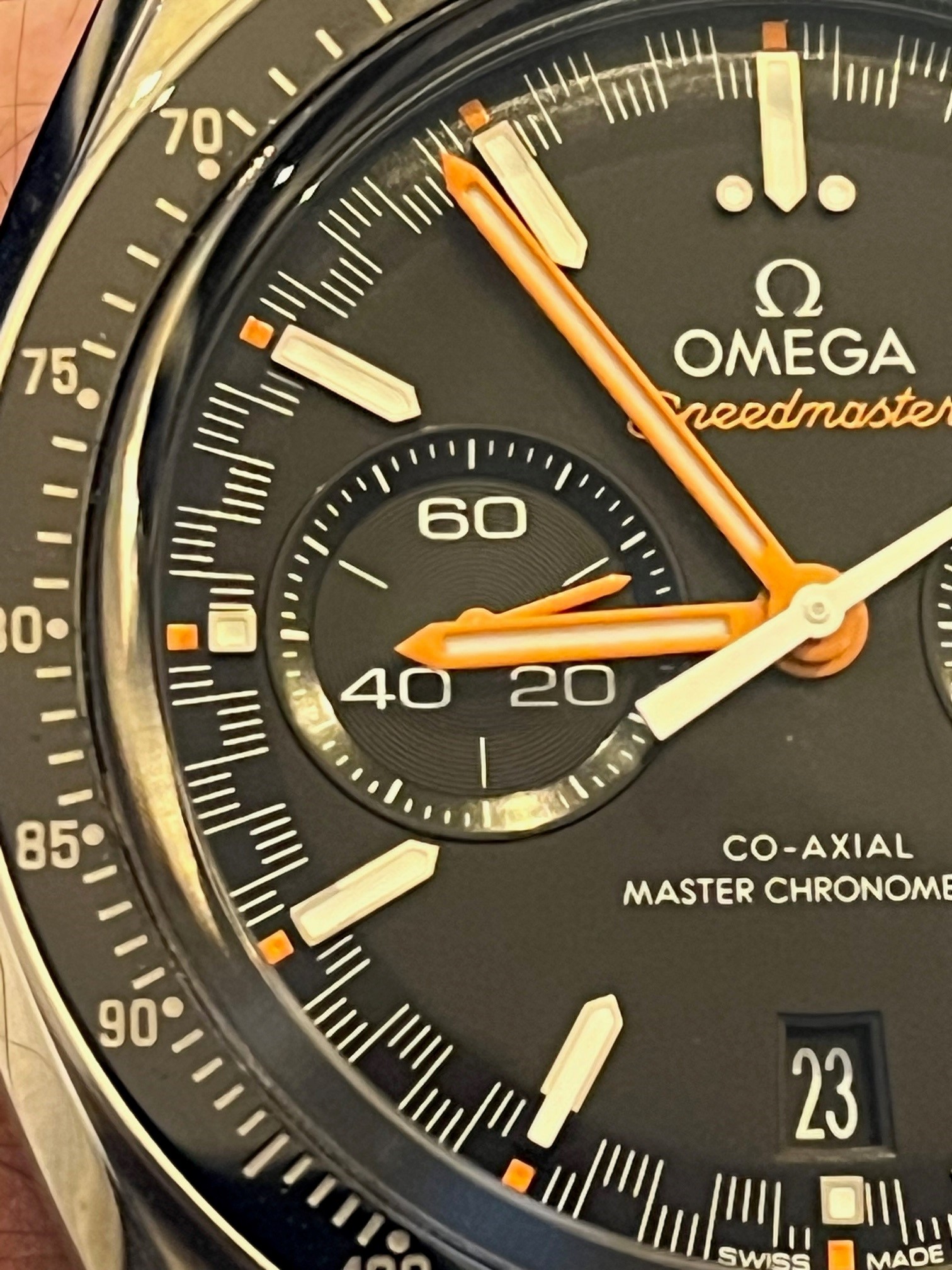

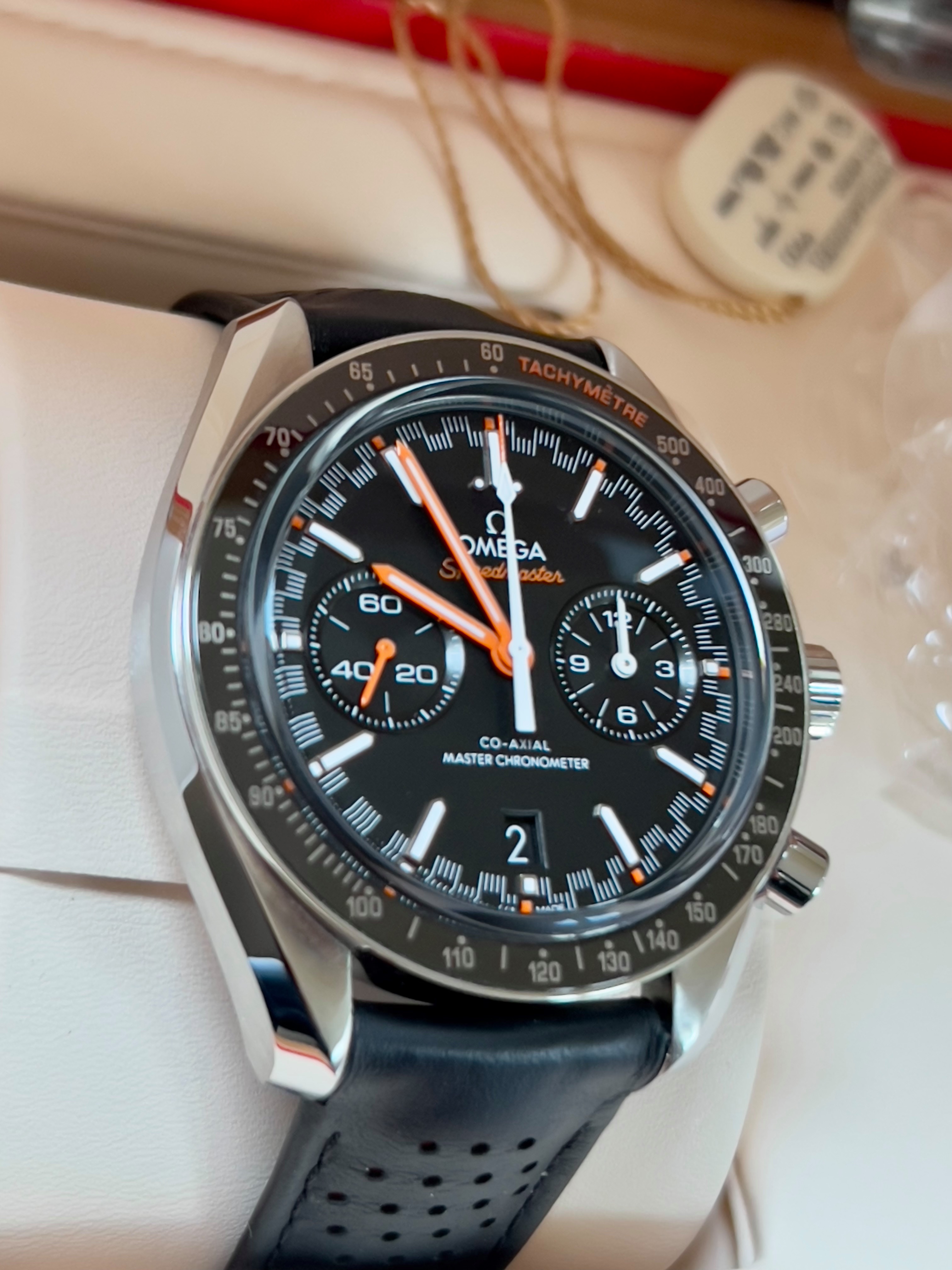

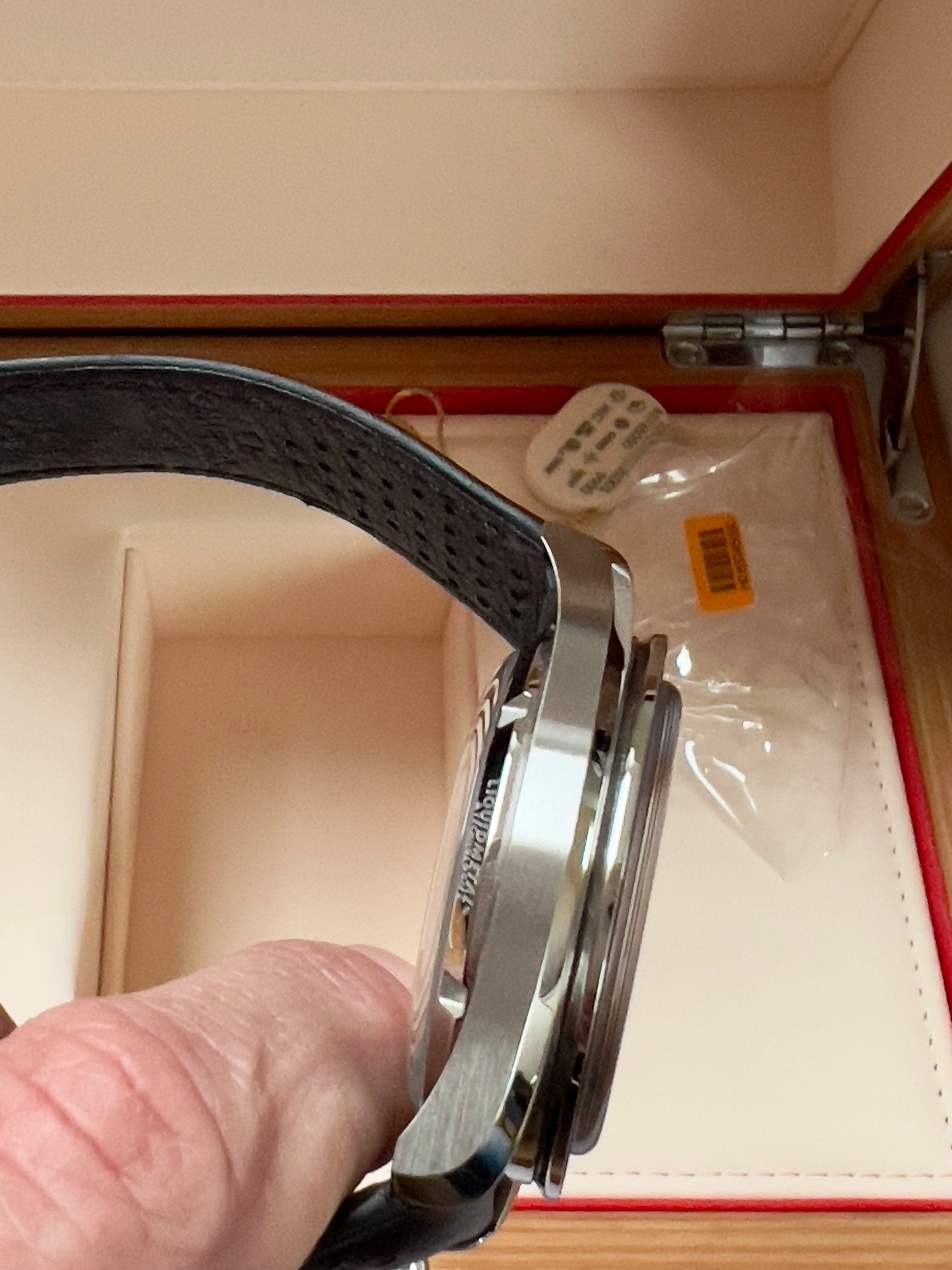

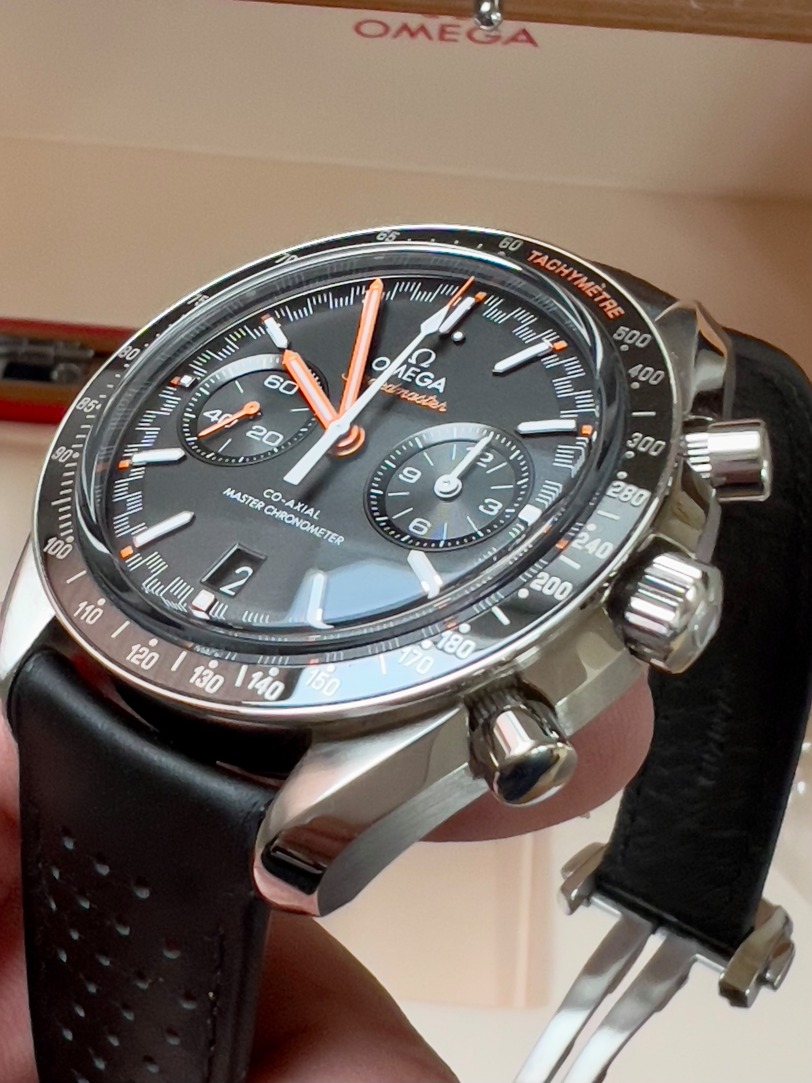

Omega Speedmaster Racing 329.32.44.51.01.001
I've been offered this watch, it looks and feels correct and all the paperwork is ligit. Any thoughts?

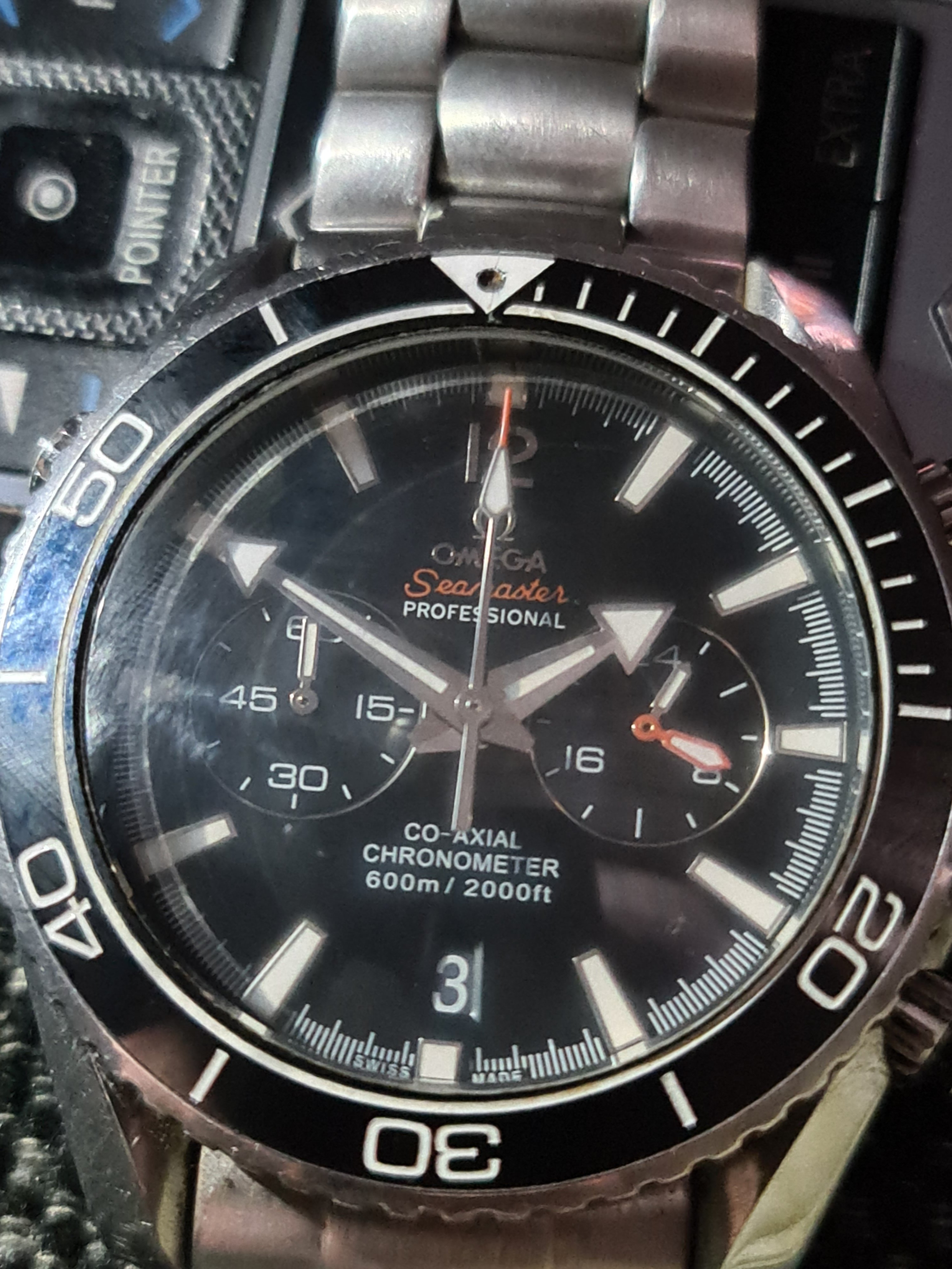

Got an non working watch yesterday and would want to know if it is fake. Tryed to wind it up but does not work. Crown in 2 possition change datum in 3 possition is time set both minute and hour hands moves. Dont see any serial
4

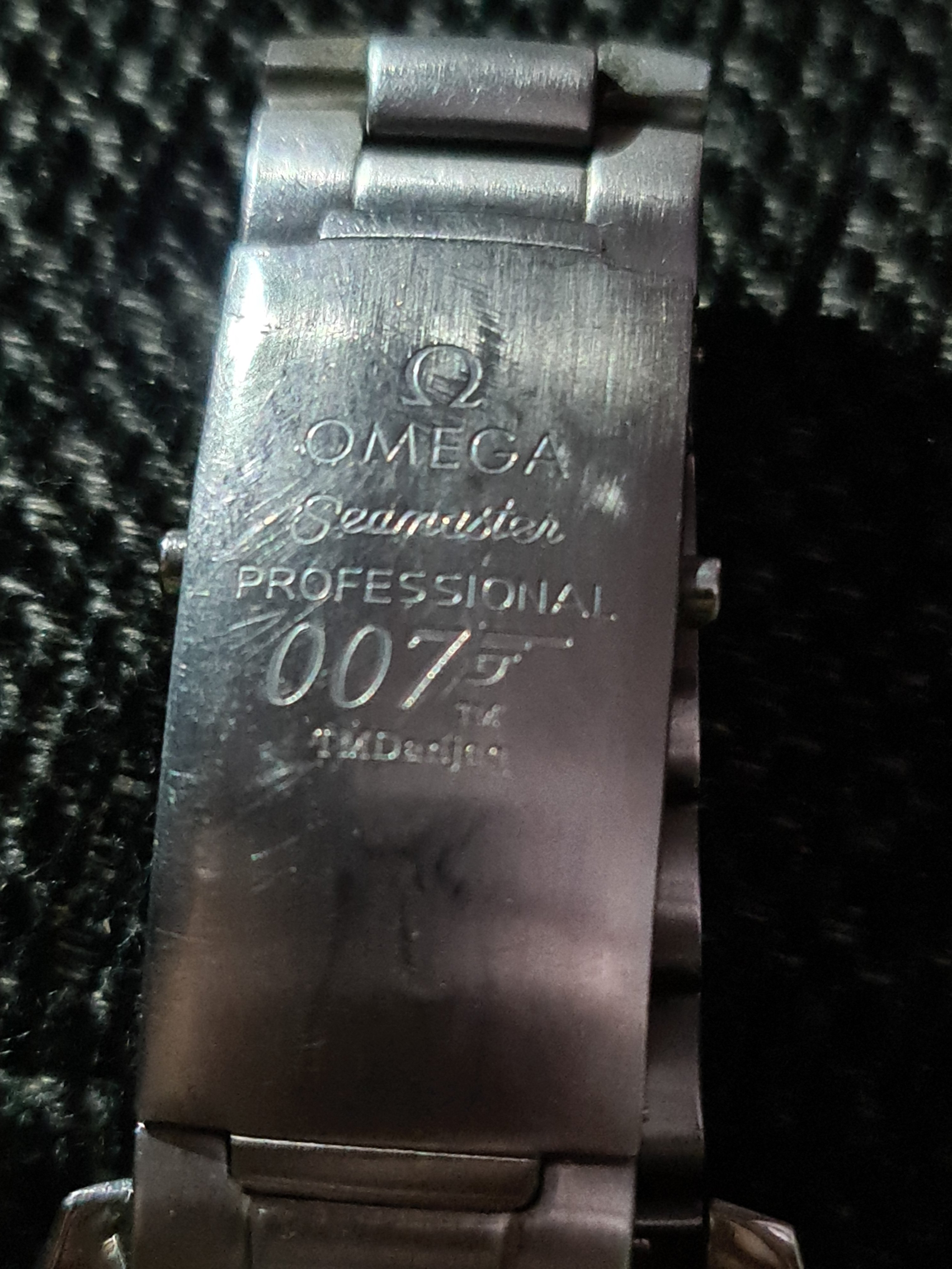

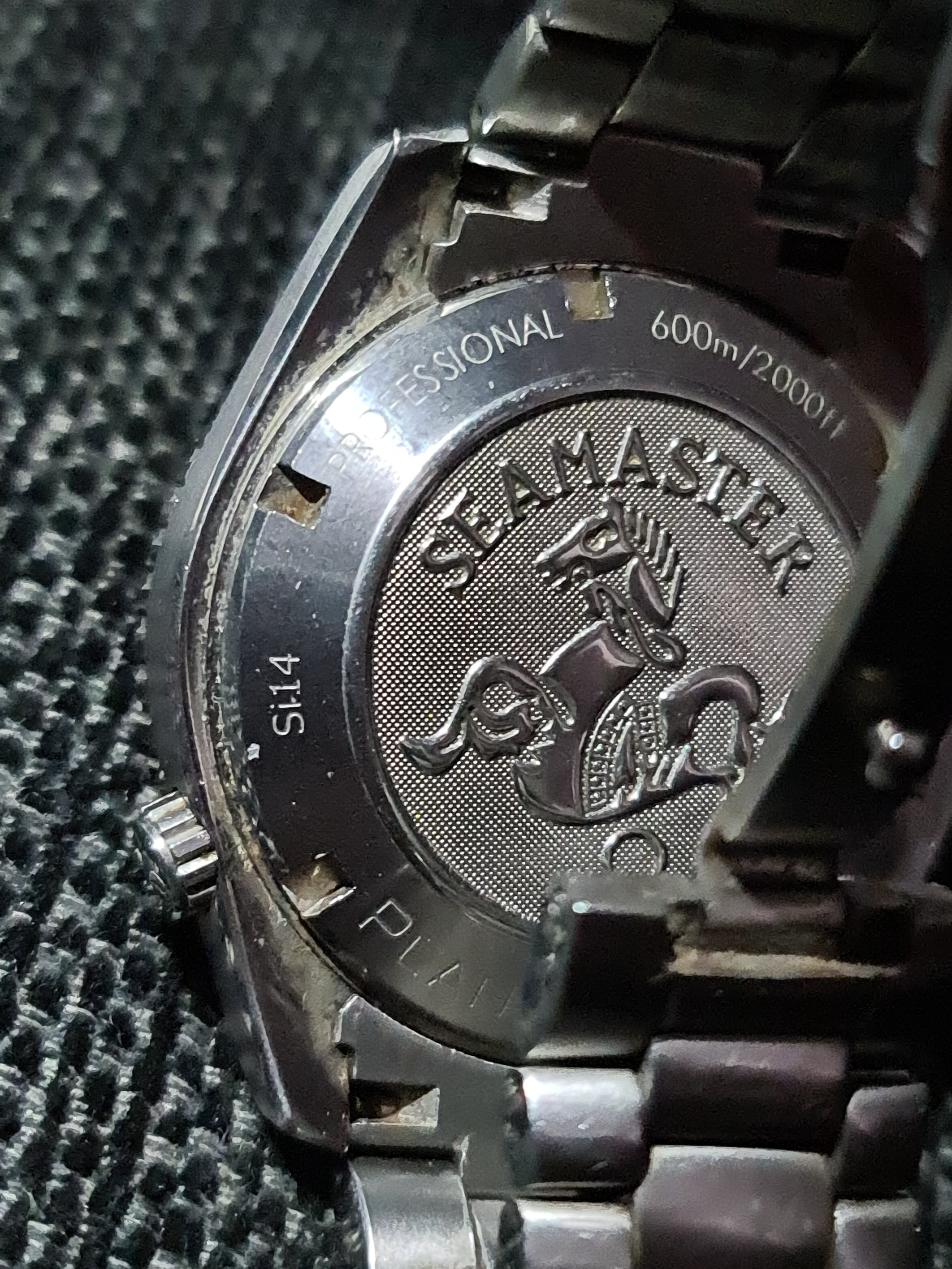

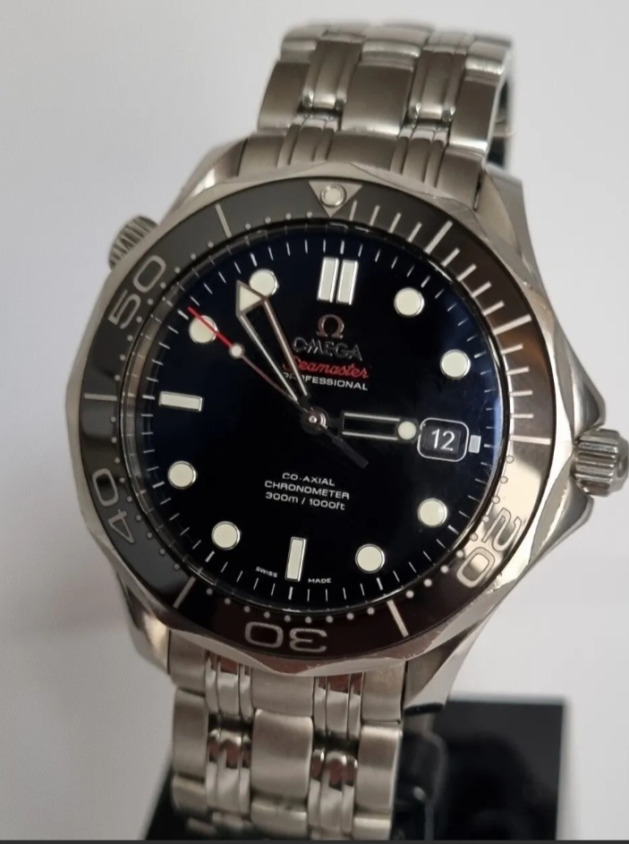

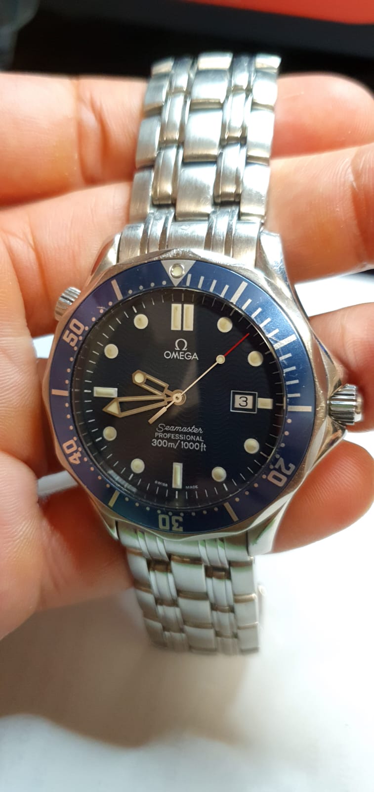

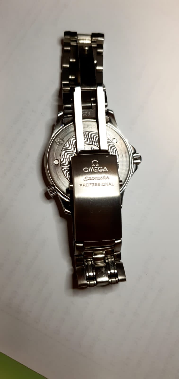

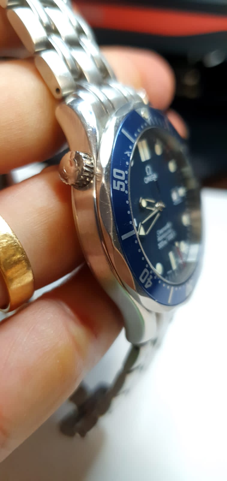

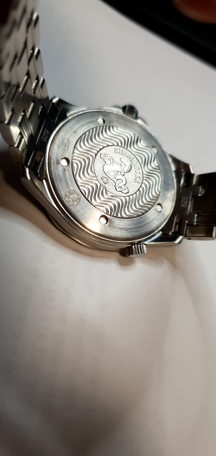

I need some help. Im buying this Seamaster,
I'm in doubt because of this other omega symbol on the caseback. IS this legit? REF 25.41.80

1) the 329.32.44.51.01.001 Speedmaster Racing: looks good to me.

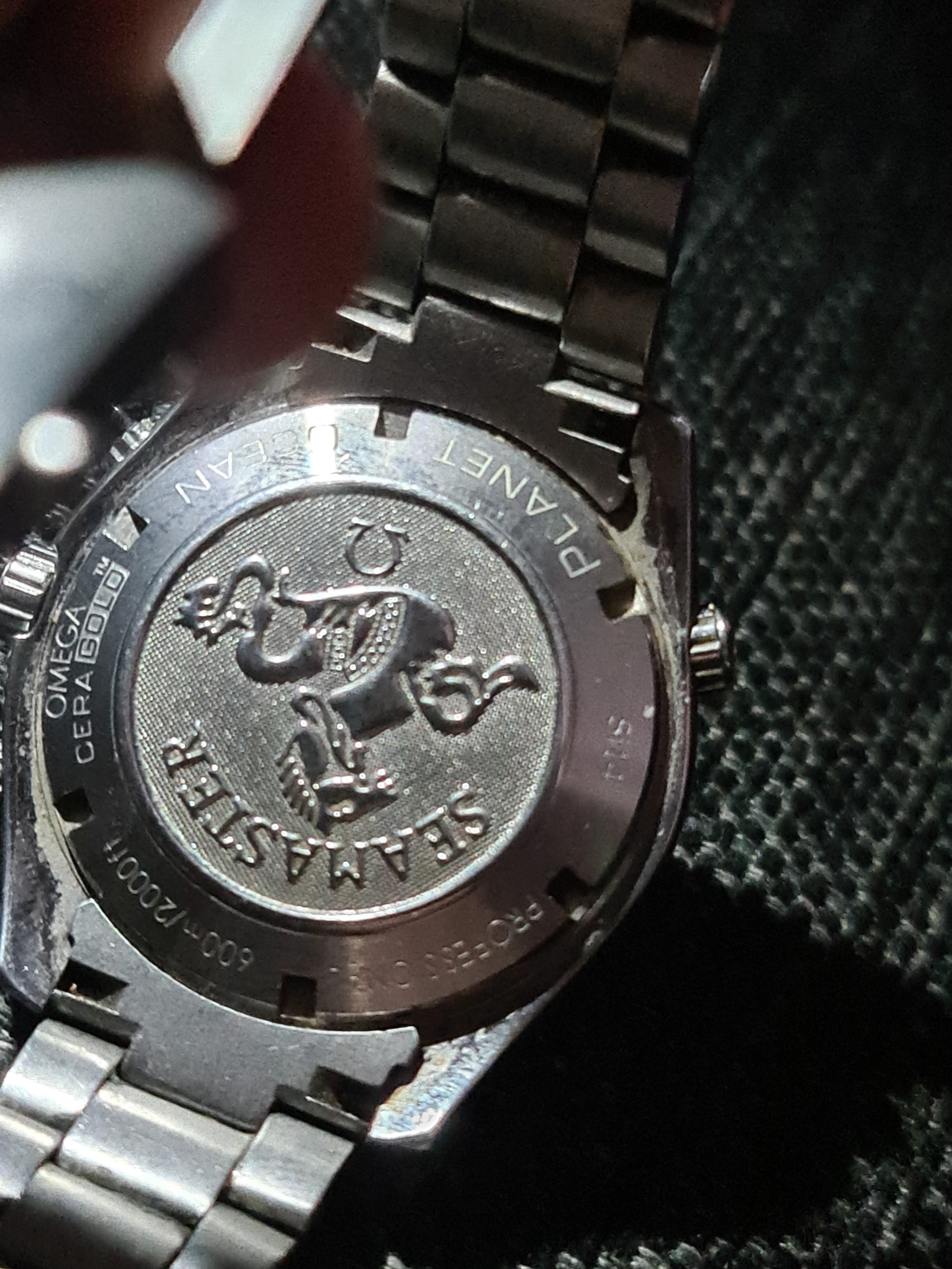

3) Re: the Planet Ocean chrono… fake as a $3 bill.
4) Re: the 2541.80 Bond watch, I’m not seeing any obvious tells, but this was a commonly faked watch. Since it’s also such an easy reference to find, I’d urge you to buy one from a seller you can have supremely high confidence in. A place that checks for and guarantees authenticity. (Joma, Crown & Caliber, etc.) Just to be sure you know: this is a quartz watch, not an automatic. (That too makes it somewhat easier to fake.)

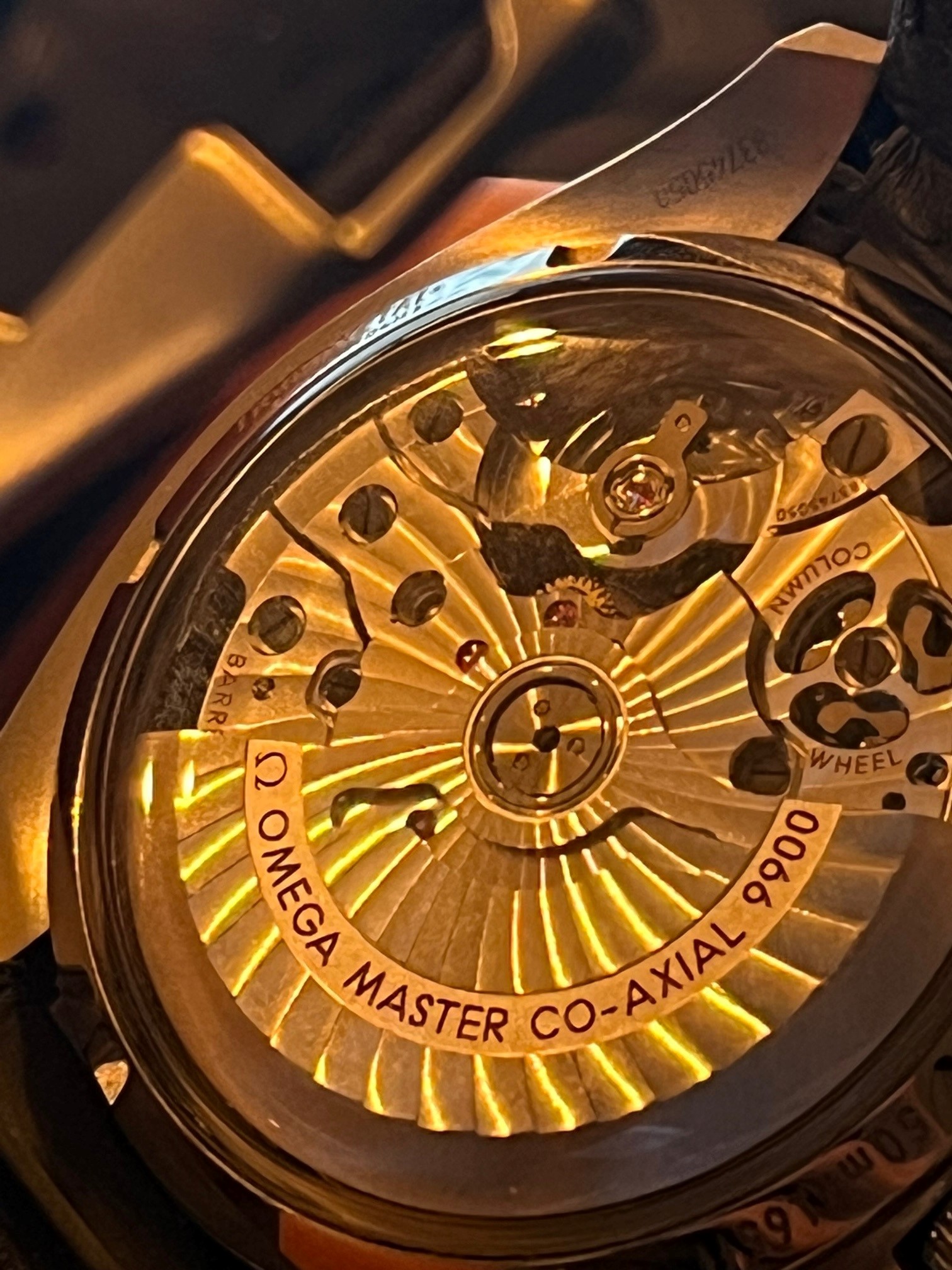

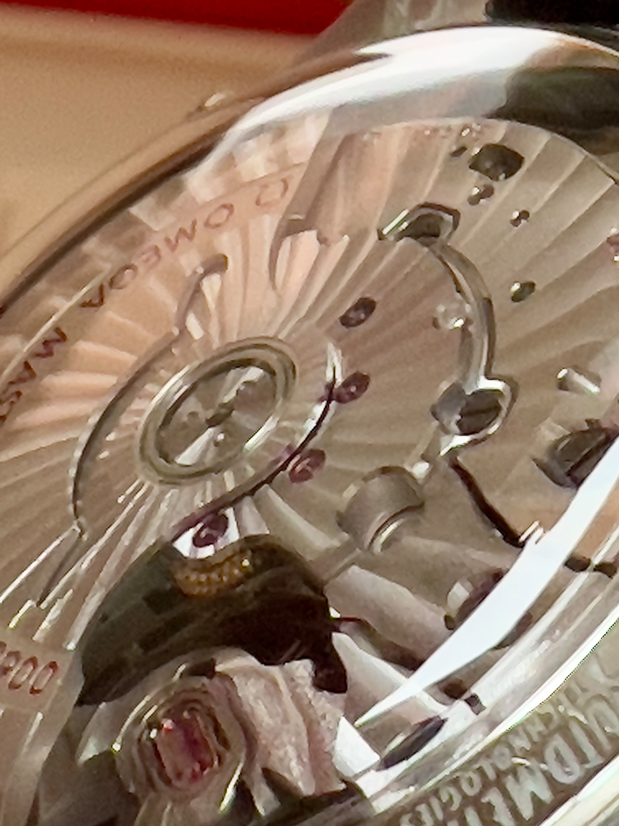

Hi I purchased this on Chrono 24. I just wanted to see if the consensus is it's genuine. It was from a trustee UK seller
