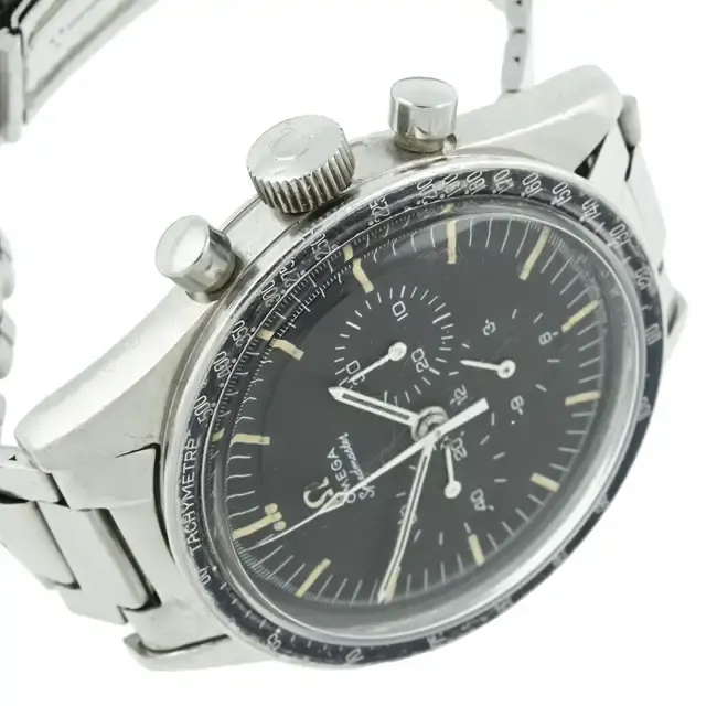

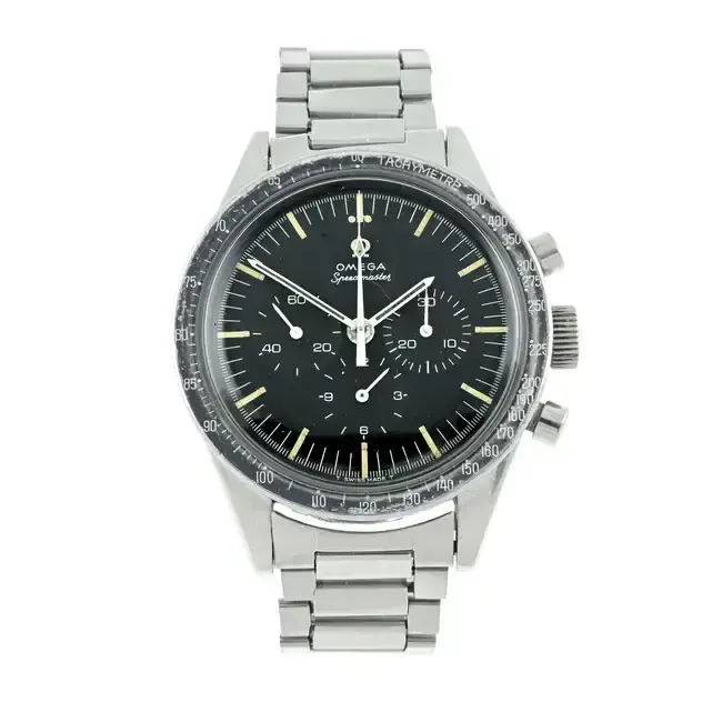

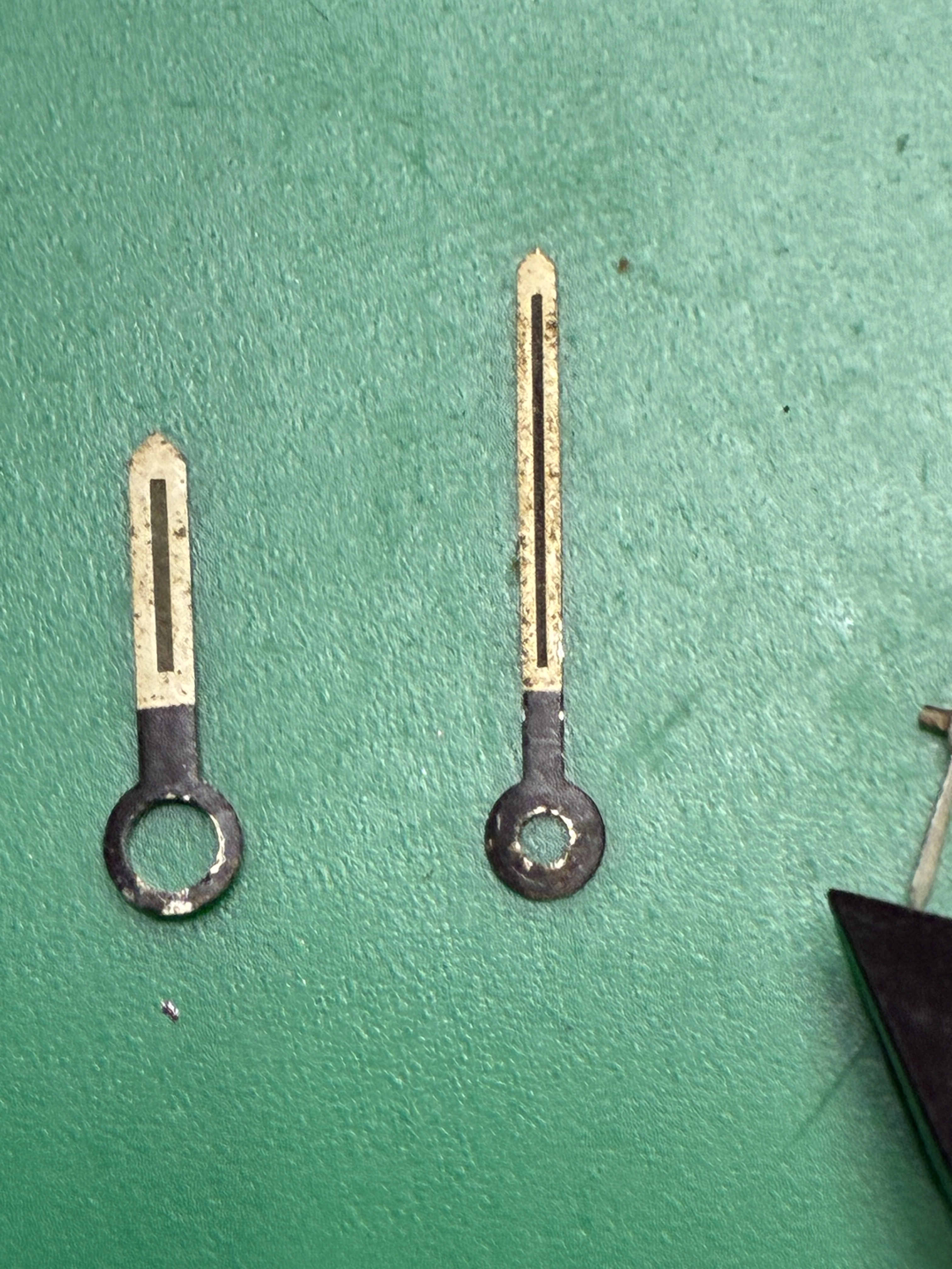

Hi,
I'm inadvertently becoming a speedy collector. I will post some more pics first, I was thrilled to get 3693.50 broad arrow gold recently, need to take some good pics. I've also just bought this. Bracelt is short but is 7619 marked 1 65 and serial number is 22088xxx, case marked S105.003.64. Auctioneer says chrono second hand is C2 should be C1, googlign my self I am getting mixed results, that the wedge hand, aopposed to teardrop was on the rare, 150.002 and they used left overs on 125.003 (wouldn't that be the 63?), also read that often tear drop was swapped during service. I have a tear drop hand coming but I don't want to restore watch but I want it to be authentic. There is tons of epxertise on here so I thought I'd reach out, thank you in advance of any helpful comments.

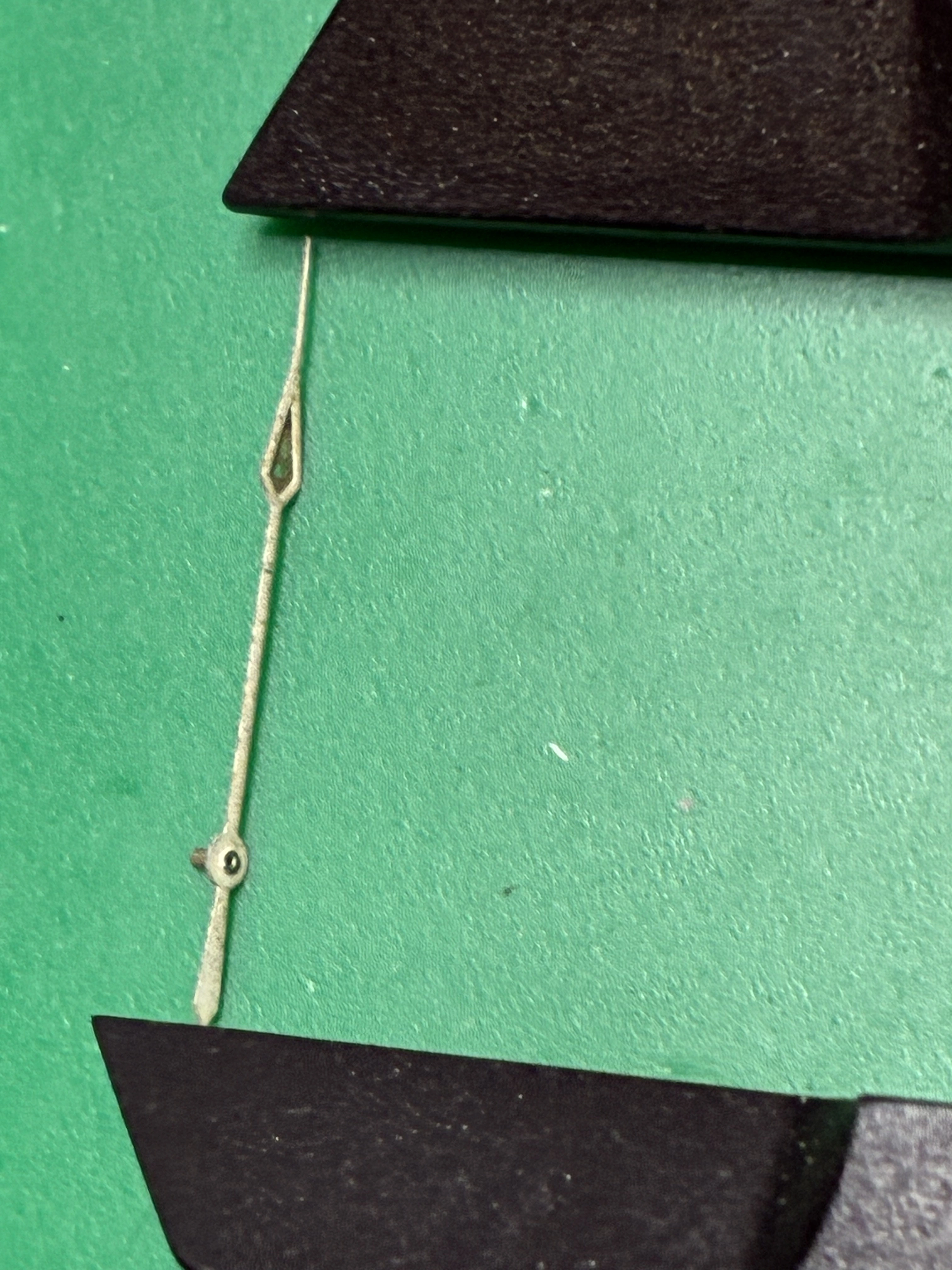

Assuming the second hand I have coming is the correct drop end and length I am going to have that installed when watch is serviced, any views on the watch? I've got it now, although it is with watchmaker, so not requesting advice to buy. Outside of the second hand I am hoping it is original, came with a 1501 red box which I think is correct, no papers.

It'll look nice with a decent set of hands. Once you get the spear end hand, get all of them sympathetically relumed. As it is, they look a bit grotty. No Ed White had a flat end chrono hand and certainly not a -64 since that was made about 3 years before they started fitting them to the Pro.

You might want your watchmaker to have a look at the bracelet?
And not a biggy, but the crown is a servicecrown and maybe the pushers also.

Lovely watch, but definitely not the correct Chrono seconds hand as previously stated by many.
I agree, have a good watchmaker go through it.
These are getting harder and harder to come by and it appears to be quite a nice example with some very minor issues.

Thank you for your comments. I agree it is a service crown, my understanding is the gasket that makes the crown waterproof (I like my watches waterproof) is an integral part of the crown, to change the gasket you need a new crown, hence all the service crowns on 105.003's. I think I got that off speedmaster101 - so unless I'm incredibly lucky with NOS I have to choose between orignal crown or waterproof service crown?
