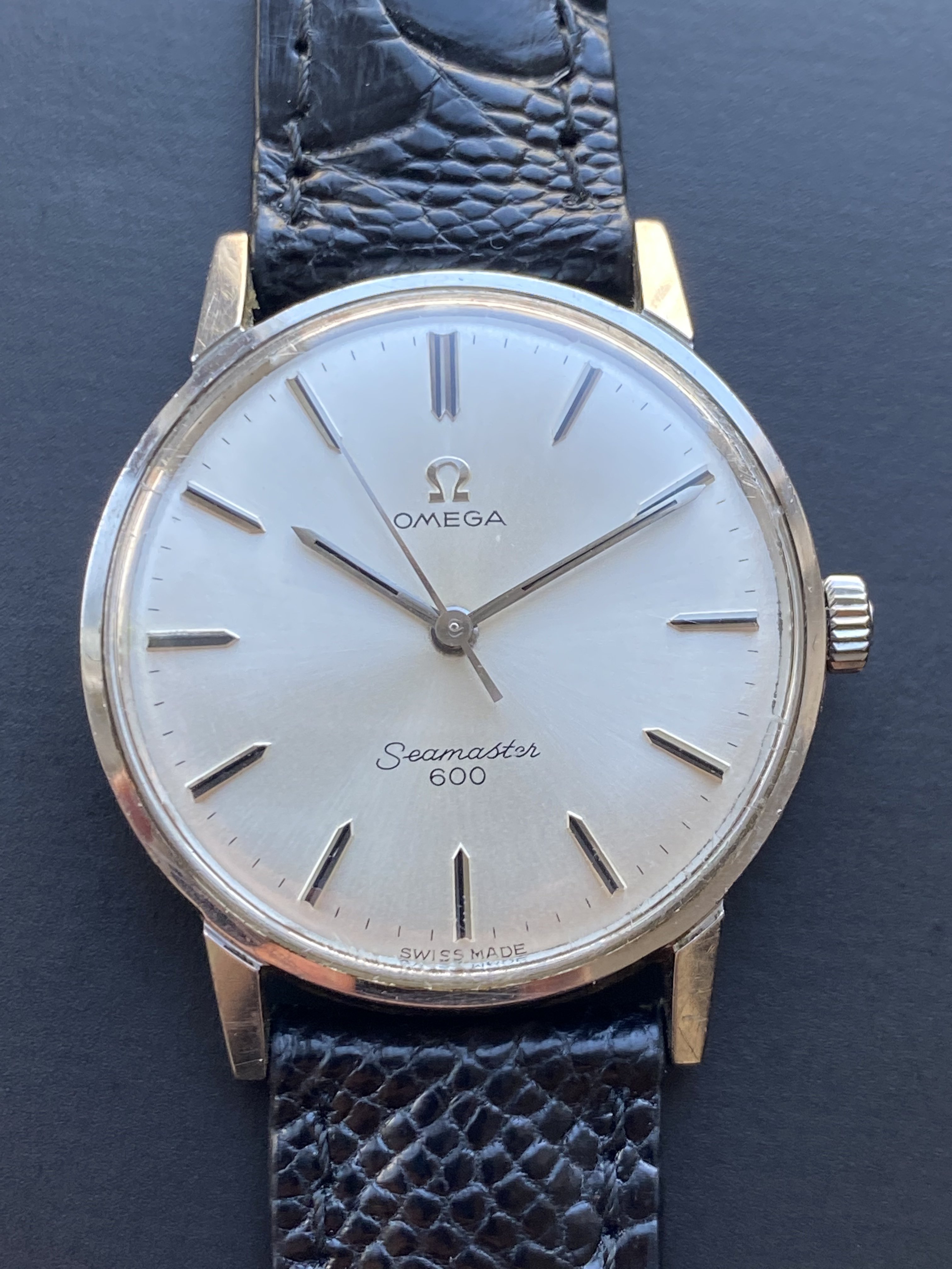

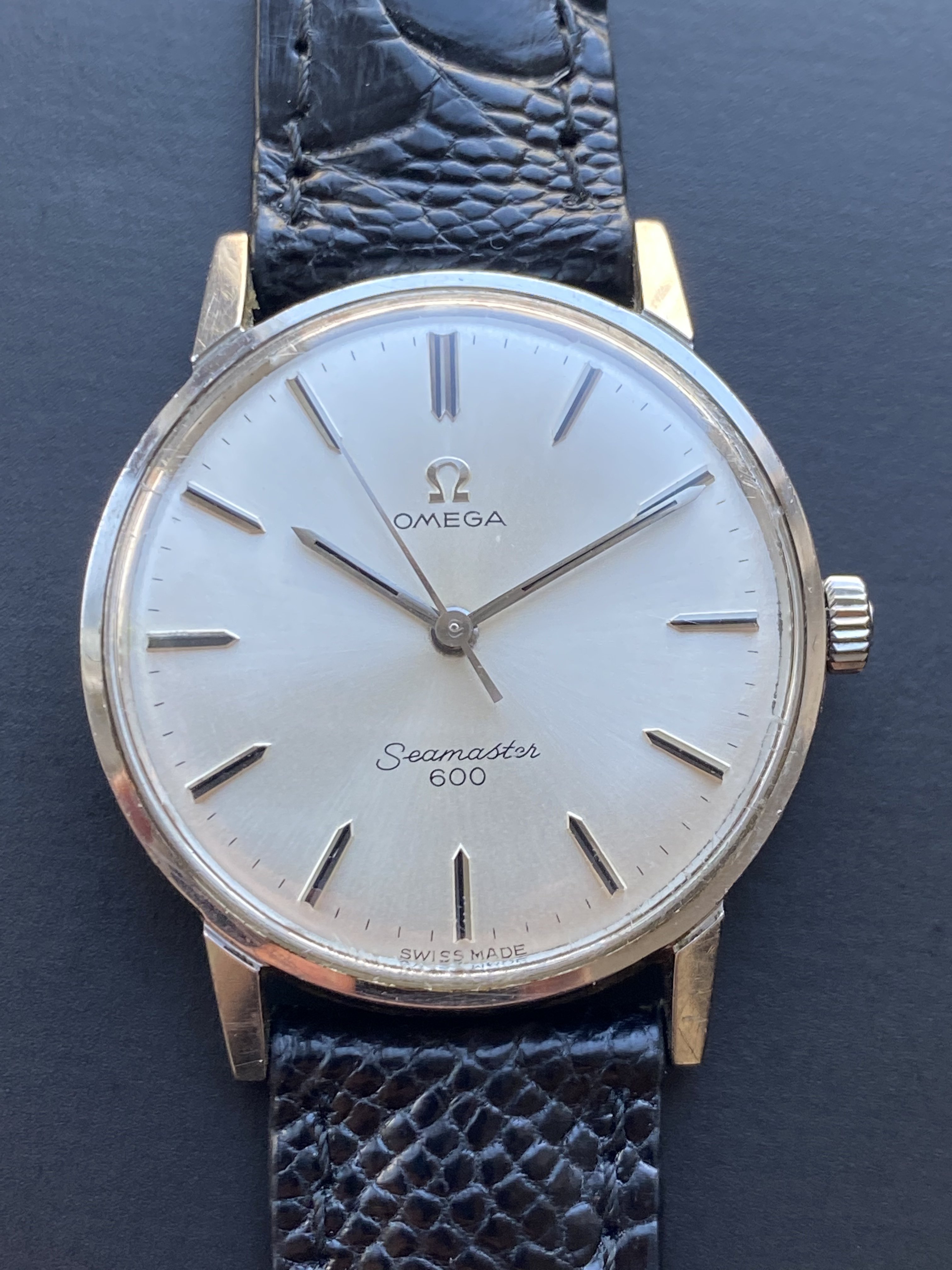

Is this the best redial Seamaster 600?

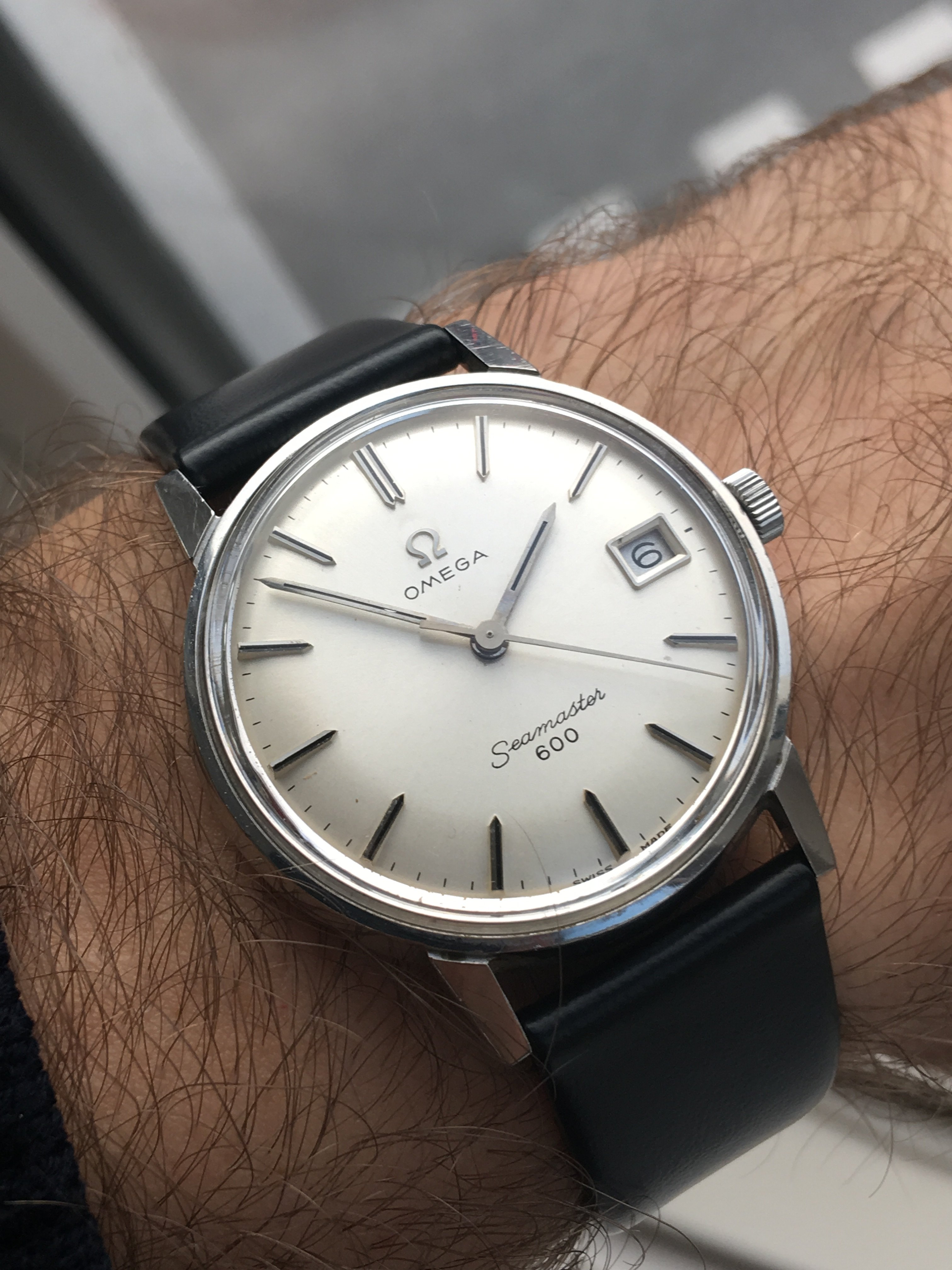

I have owned several SM 600鈥檚 with this exact configuration and I will be very surprised if OP鈥檚 example is a redial.
It definitely looks correct.

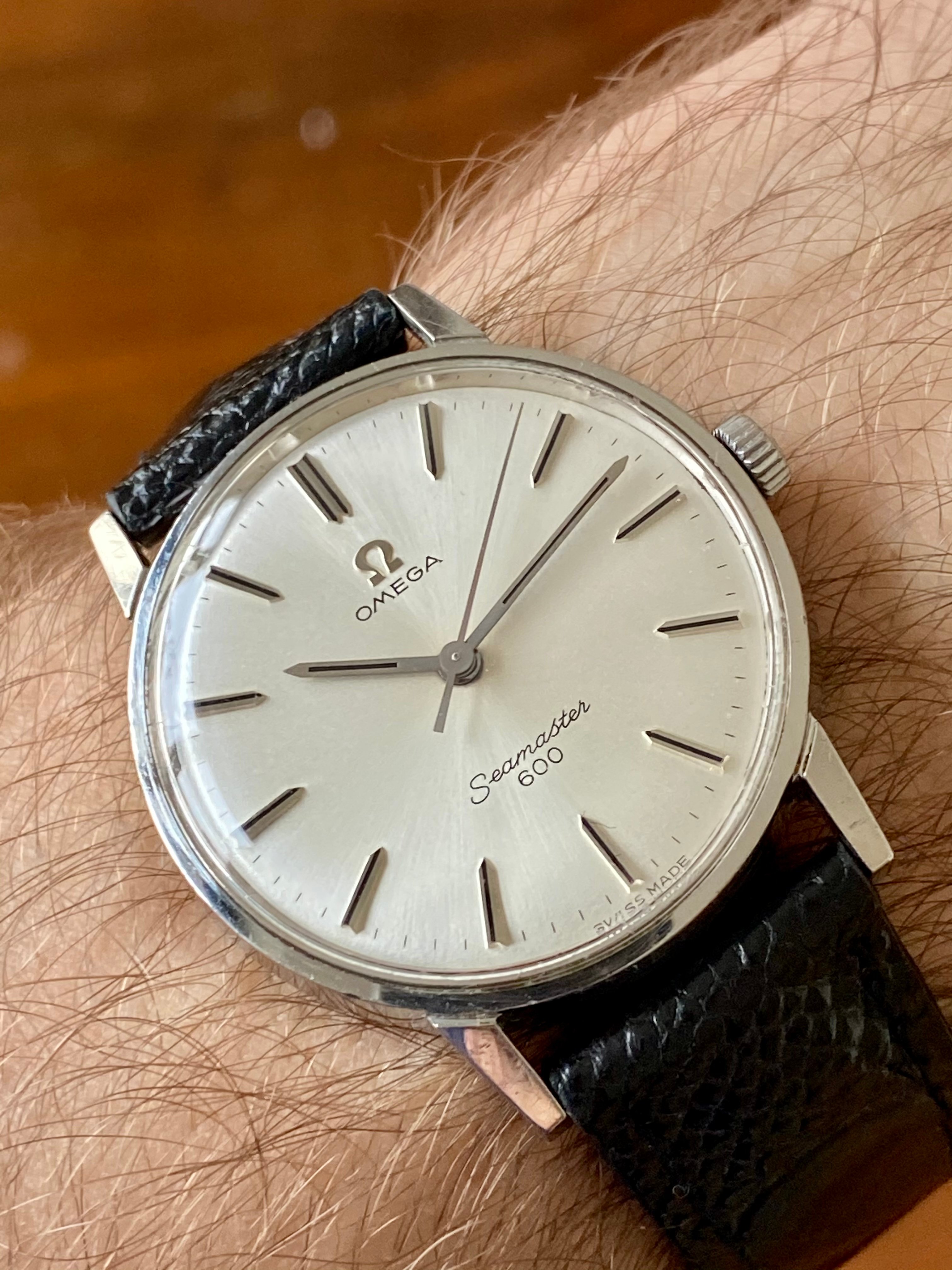

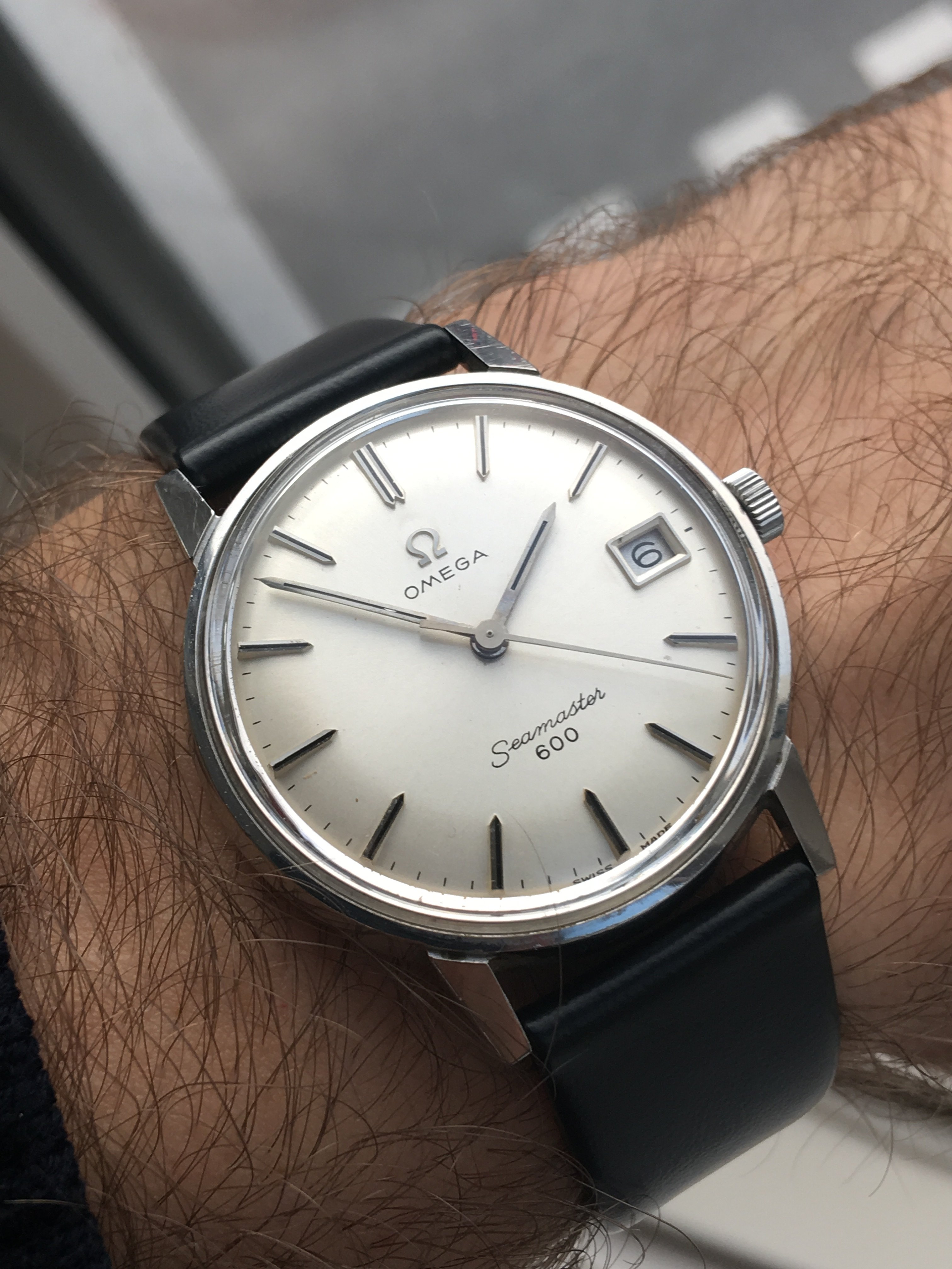

The configuration is the same, yes, but the fonts are very different.
As @Davidt said small variation in the fonts are quite common. Based on the provided pictures, my vote is on original.

These markers should not feature black stripes. Also, lume is missing from the little emplacements on the outside of the markers. Lume missing from the hands too, and the bottom of the dial should read " T SWISS MADE T".
All of these things are consistent with a non lume variant. I too think it鈥檚 straight.

The first "e" in "Seamaster" is the only thing that looks a bit off to me, as an amateur. The font is thick, like you said, and the line across the e is more slanted than other examples I can find easily. But if I hadn't been told it's a redial I wouldn't have thought it was.

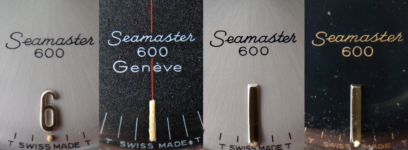

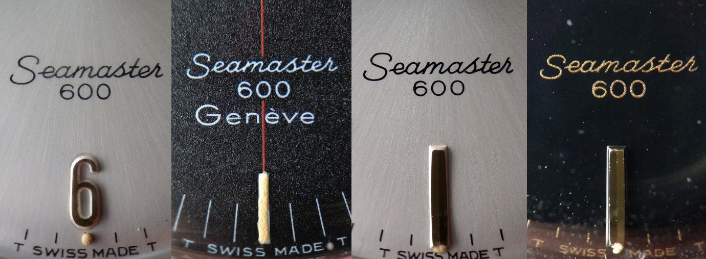

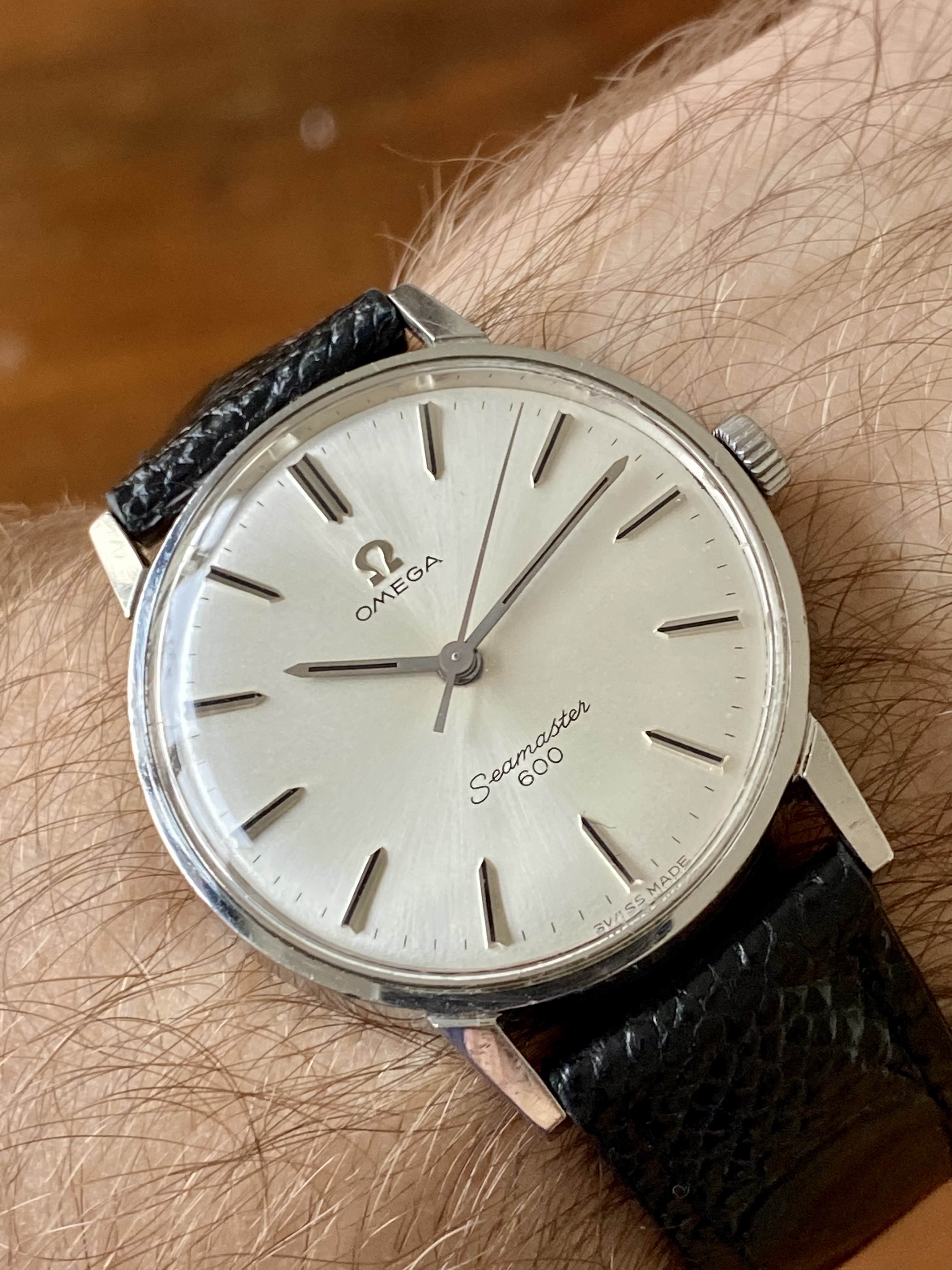

I agree, slanted line across the e is a somewhat unusual; I have only seen that style with Seamaster 600 Gen猫ve dial variants. Below is a composite I made of my Seamaster 600 collection to highlight the variation in fonts and dial styles.

The auction has closed for this Seamaster. Final bid was $760 so apparently the "refurbished" dial did not deter buyers.

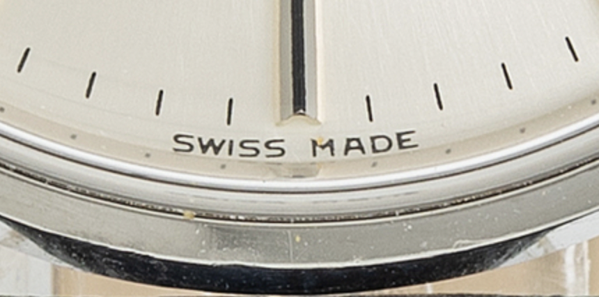

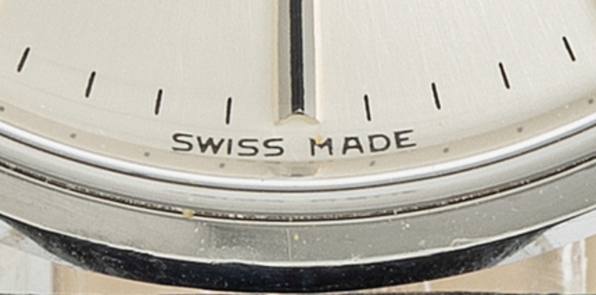

I say it's a very good re-dial. Swiss Made is incorrectly positioned for this reference.
As well as other points raised, the last S in Swiss should be almost under the centre of the 6 marker.
