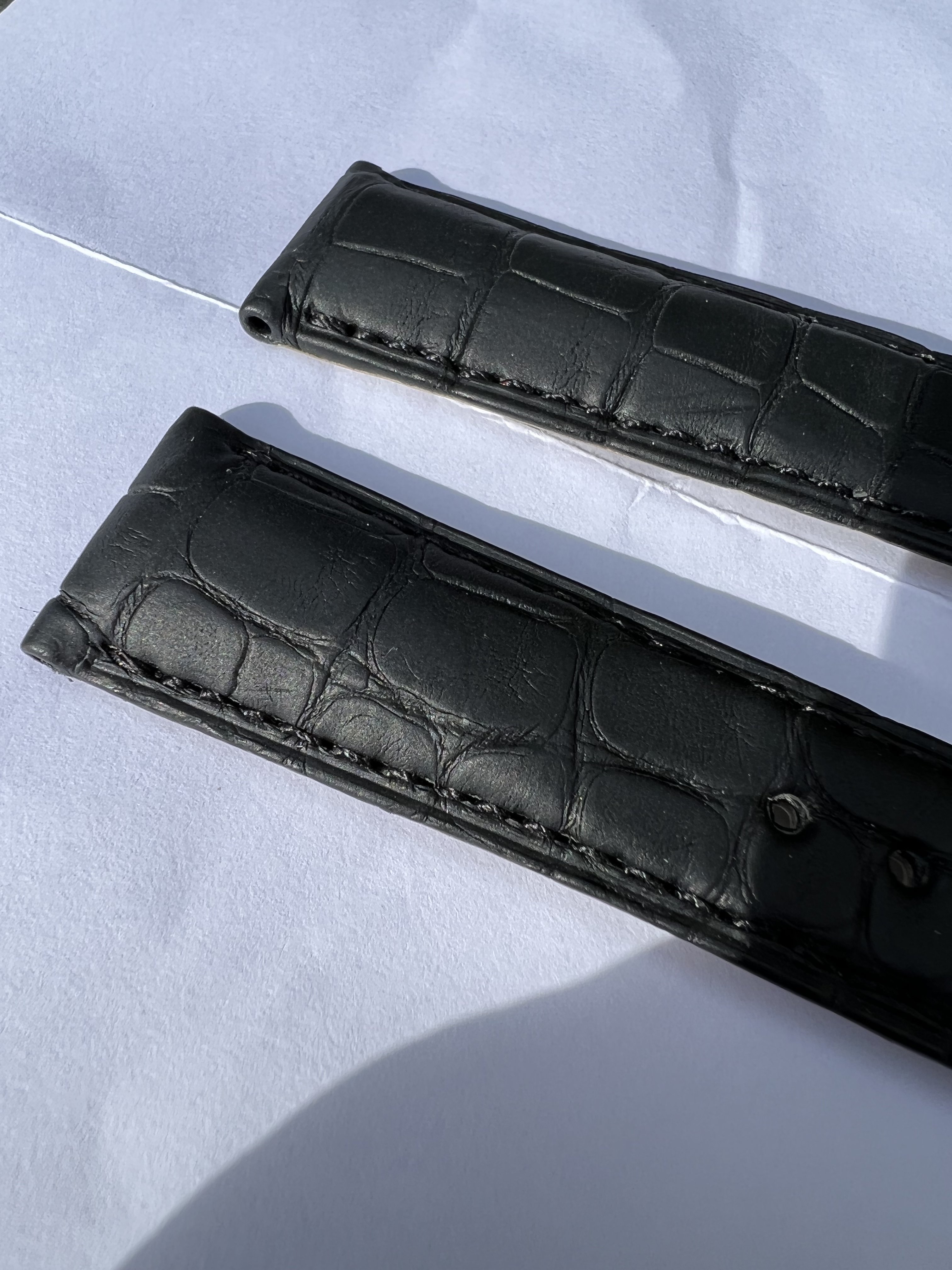

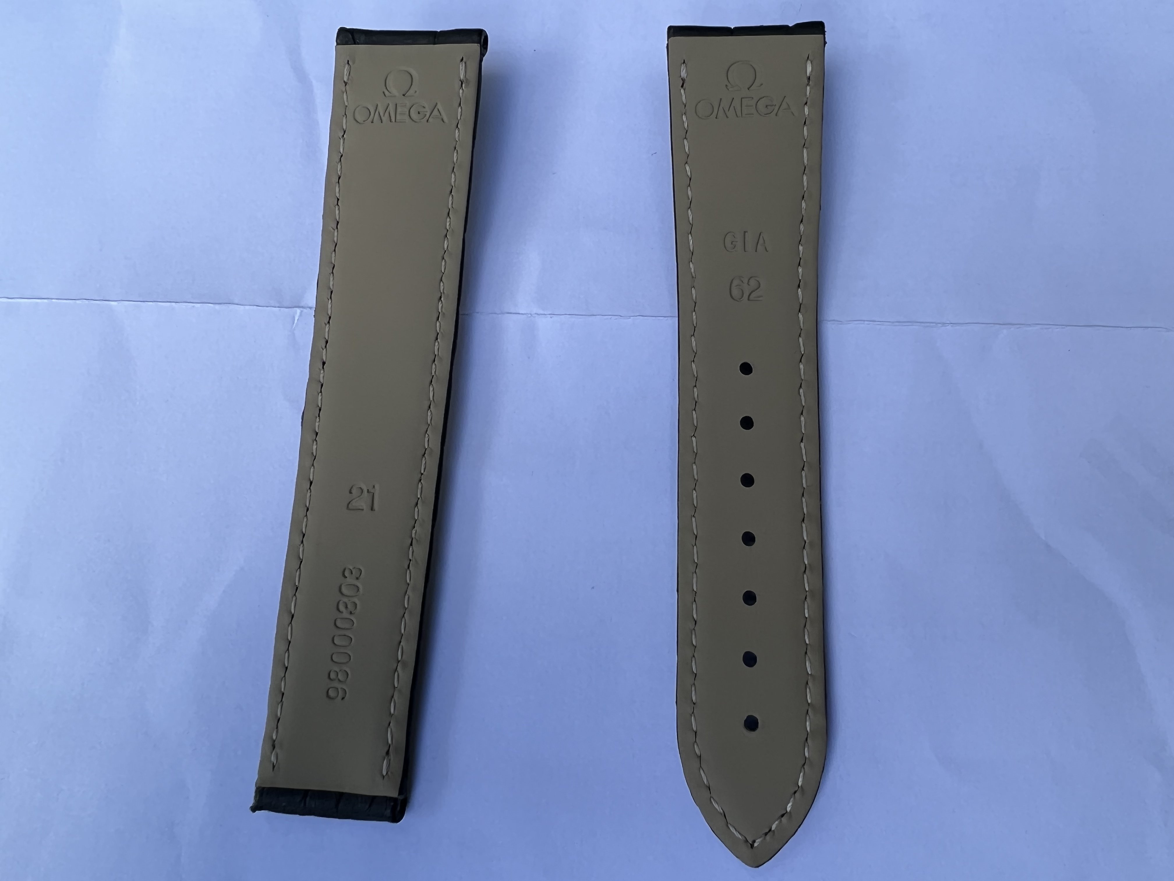

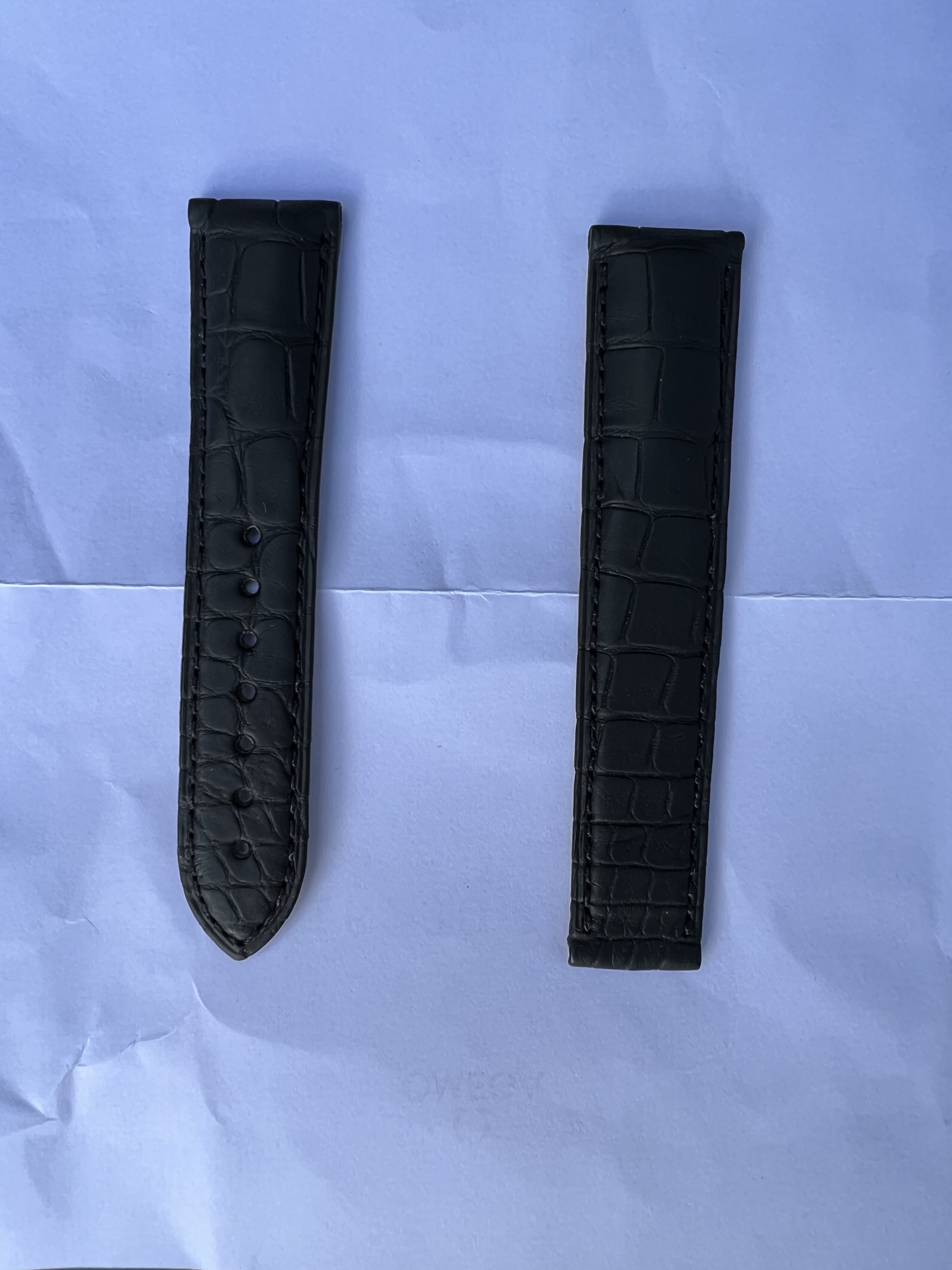

Is this Omega strap real?
403
357
Omega does outsource their straps and buckles to various makers. I know that some of their steel fold-over clasps are made in Asia.
It is difficult for an AD or OB to authenticate this strap. There are several models and variations within each model through the years. Some "new" straps sold on eBay and Chrono24 are very old stock when they used different stitching machines/techniques and edge painting. Newer straps have a tighter stitch and have folded/turned edges (full remborde). From the shape of that English point, I feel like it is not a current design. Overall, the strap looks ok to me.
If you are not comfortable with that seller, I am sure Omega boutiques can order locate/order the correct 20/16 for you and mail it to you. Newer straps are well made, but not all of them are perfect. There are straps with uneven stitching and you may get unlucky.
782
1,387

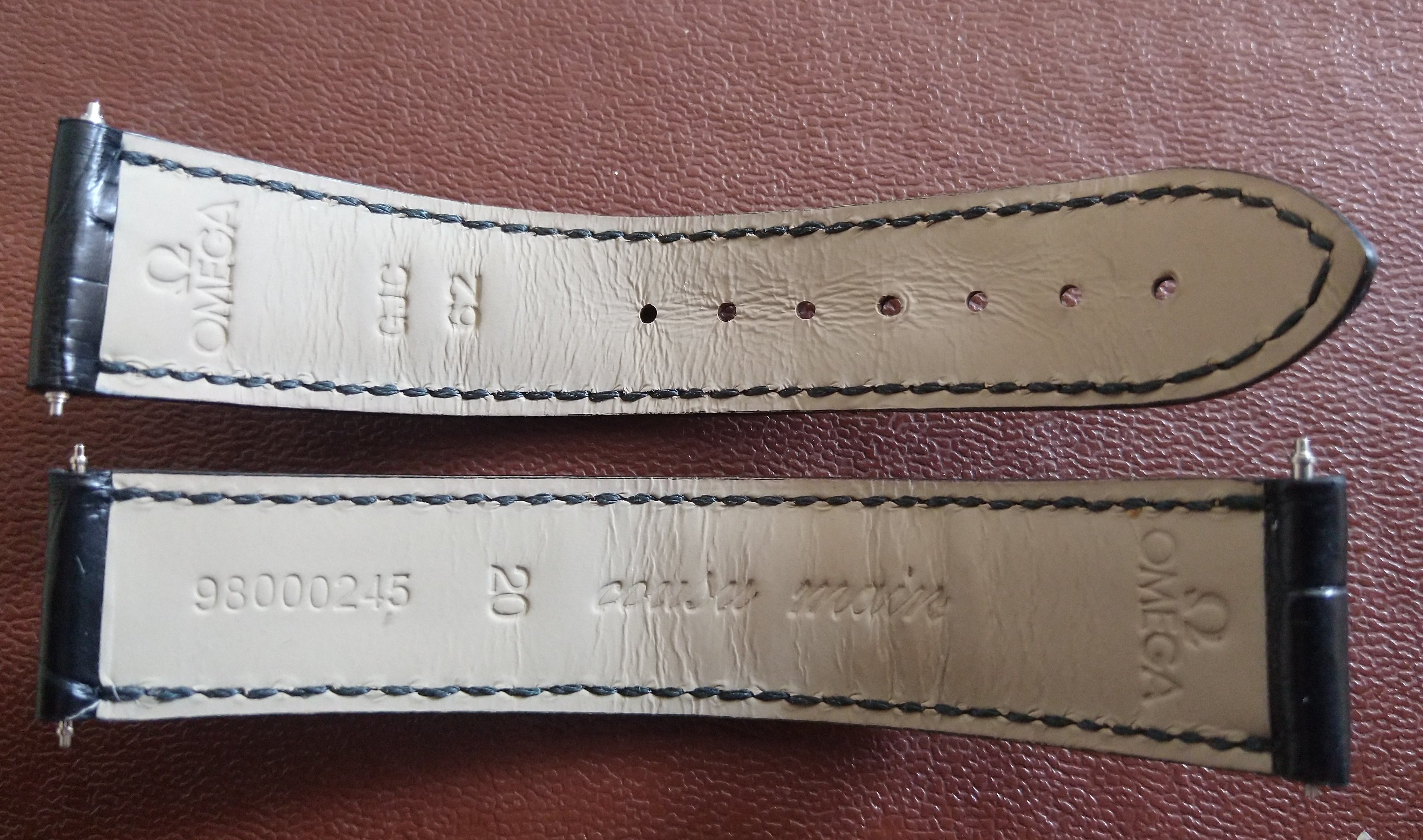

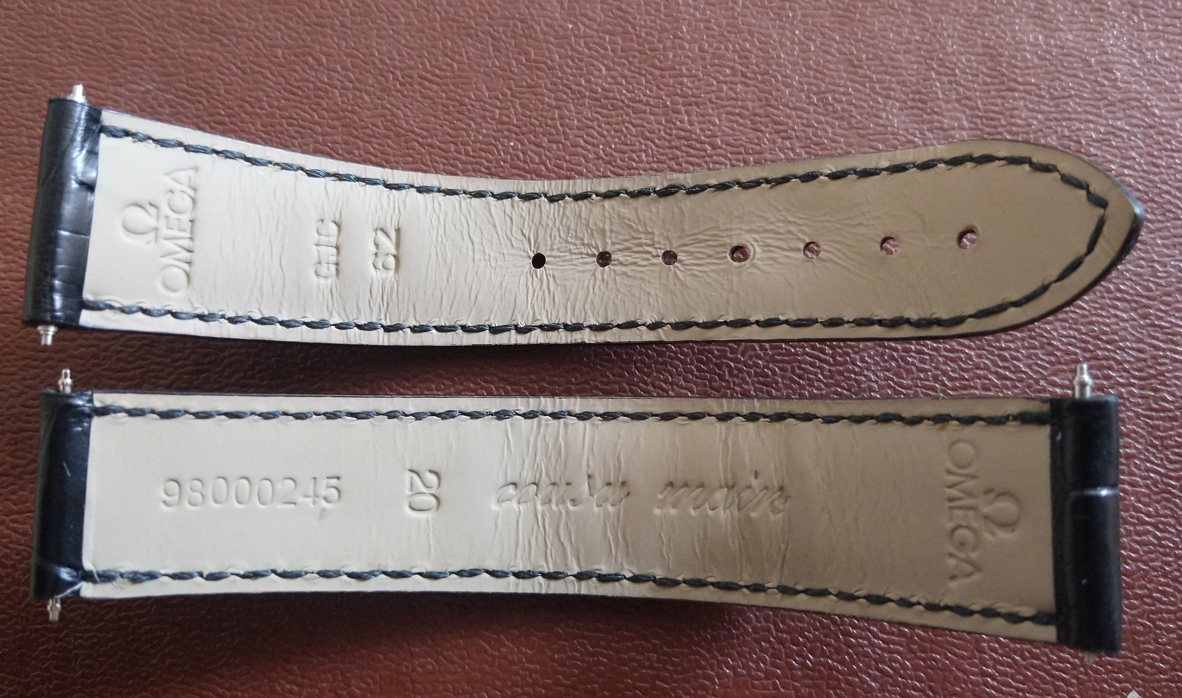

out of interest, this is my strap. 20/18. The stitching is very close together on this. I still can't work out what the cursive writing says! Can anyone enlighten me?
6,484
31,920
Cousu main = hand stitched.

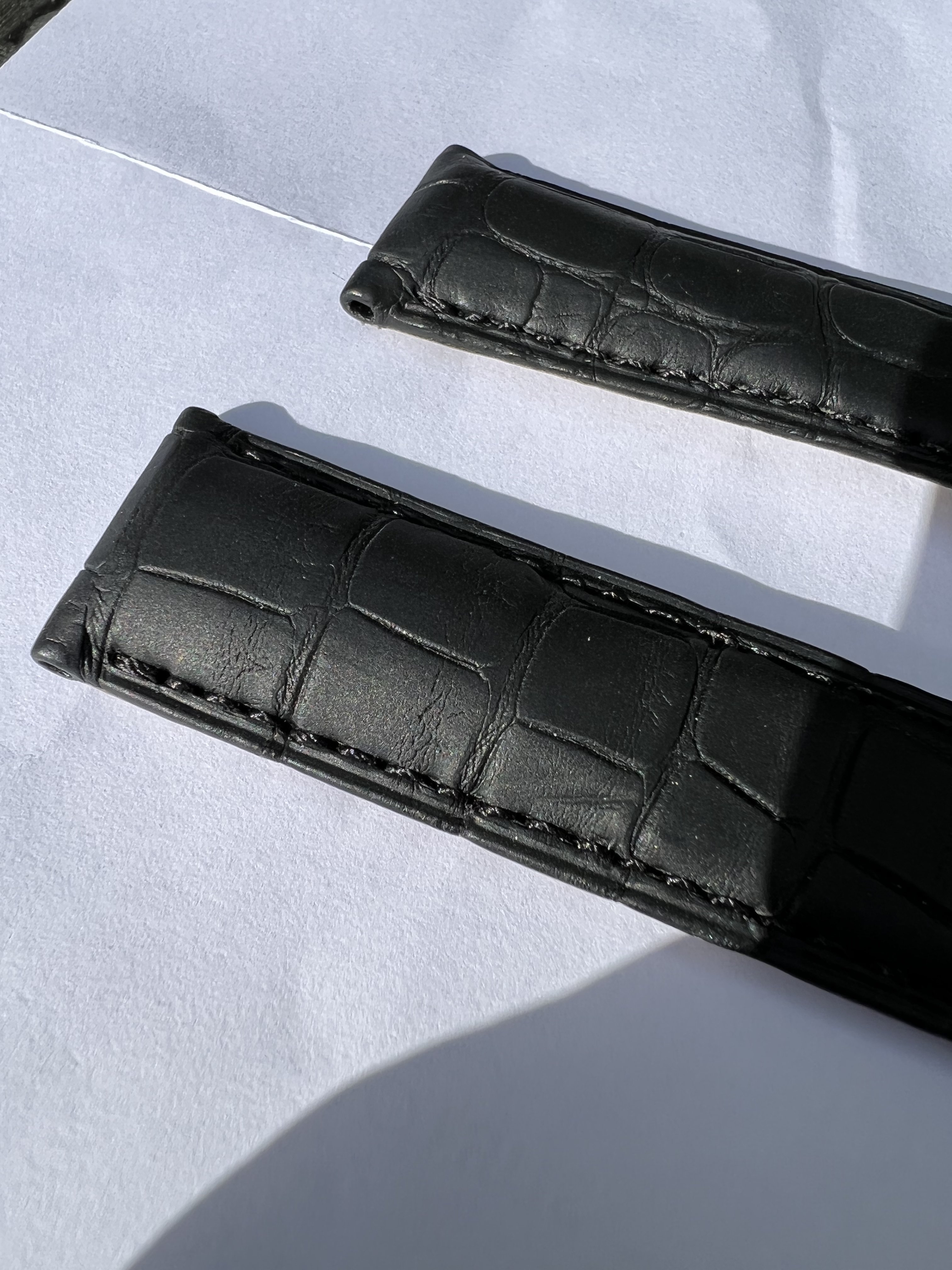

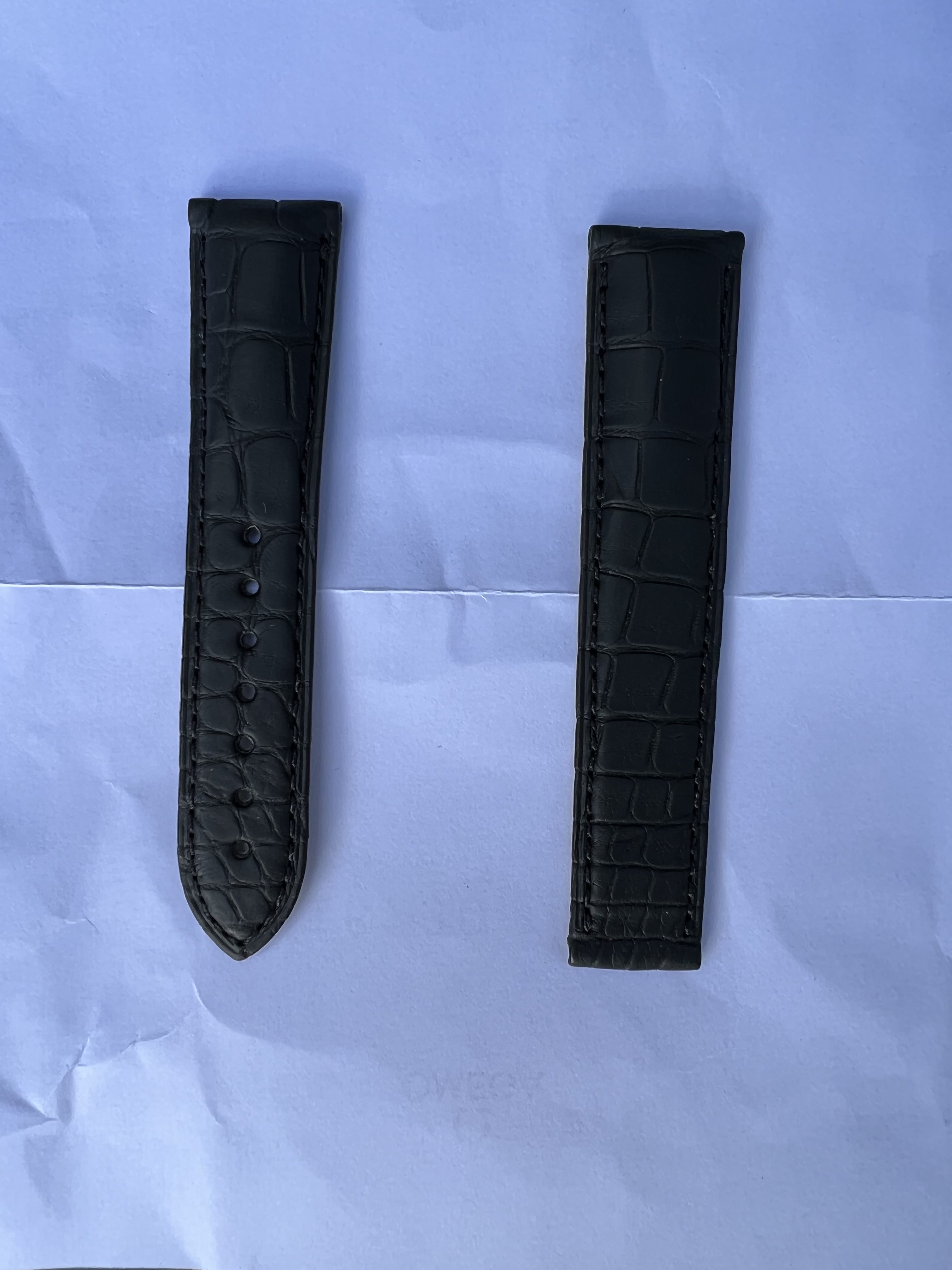

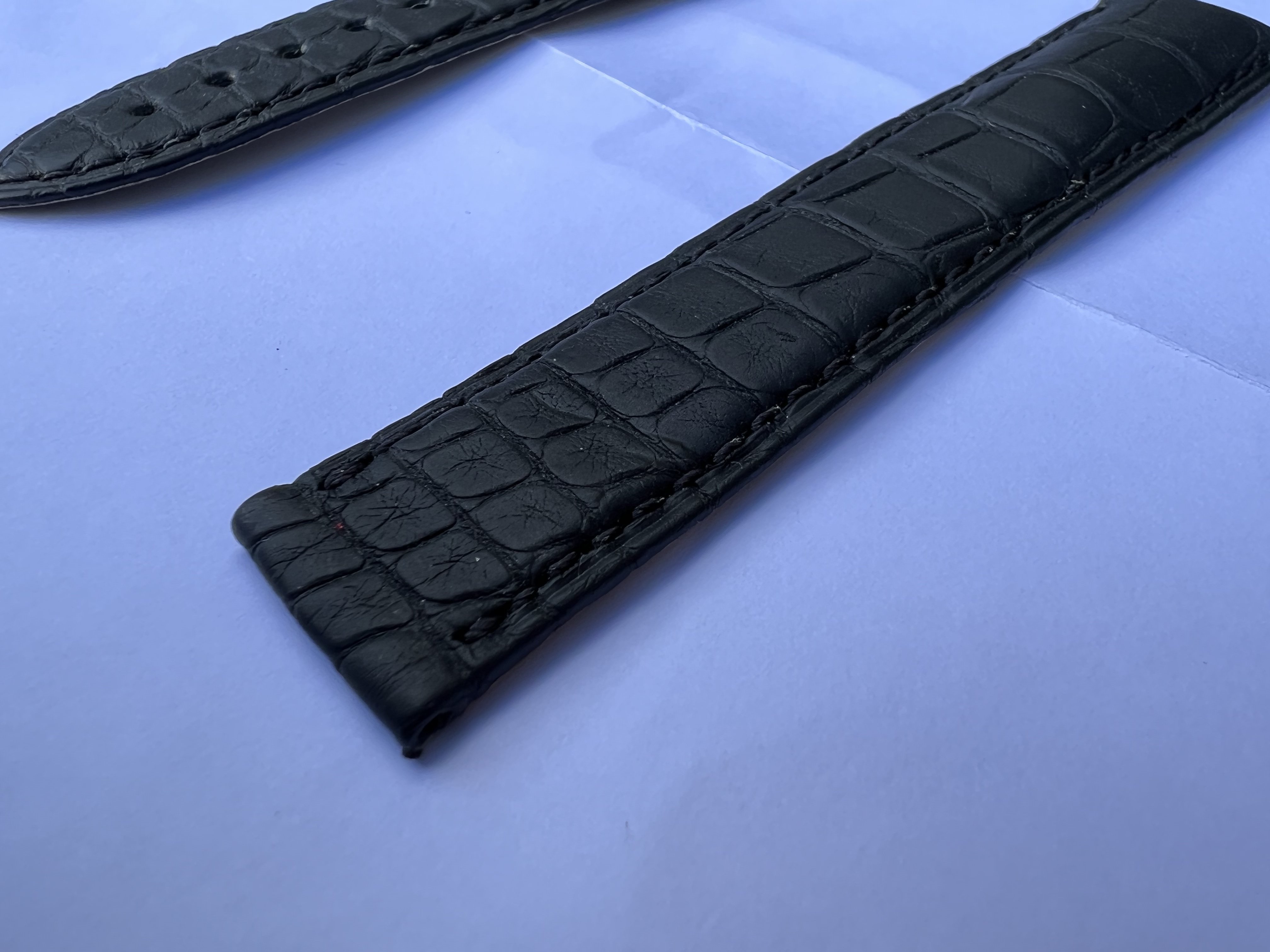

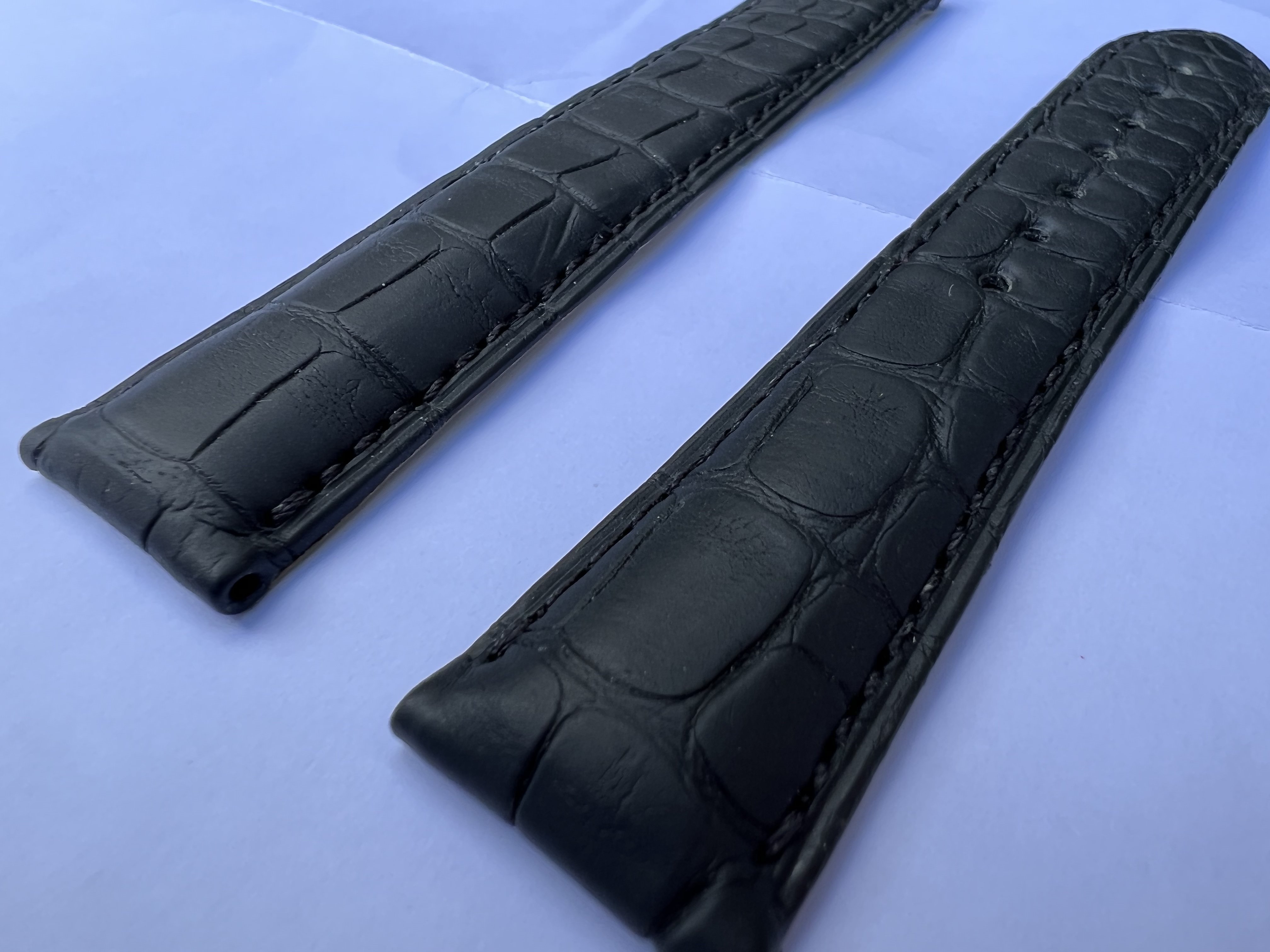

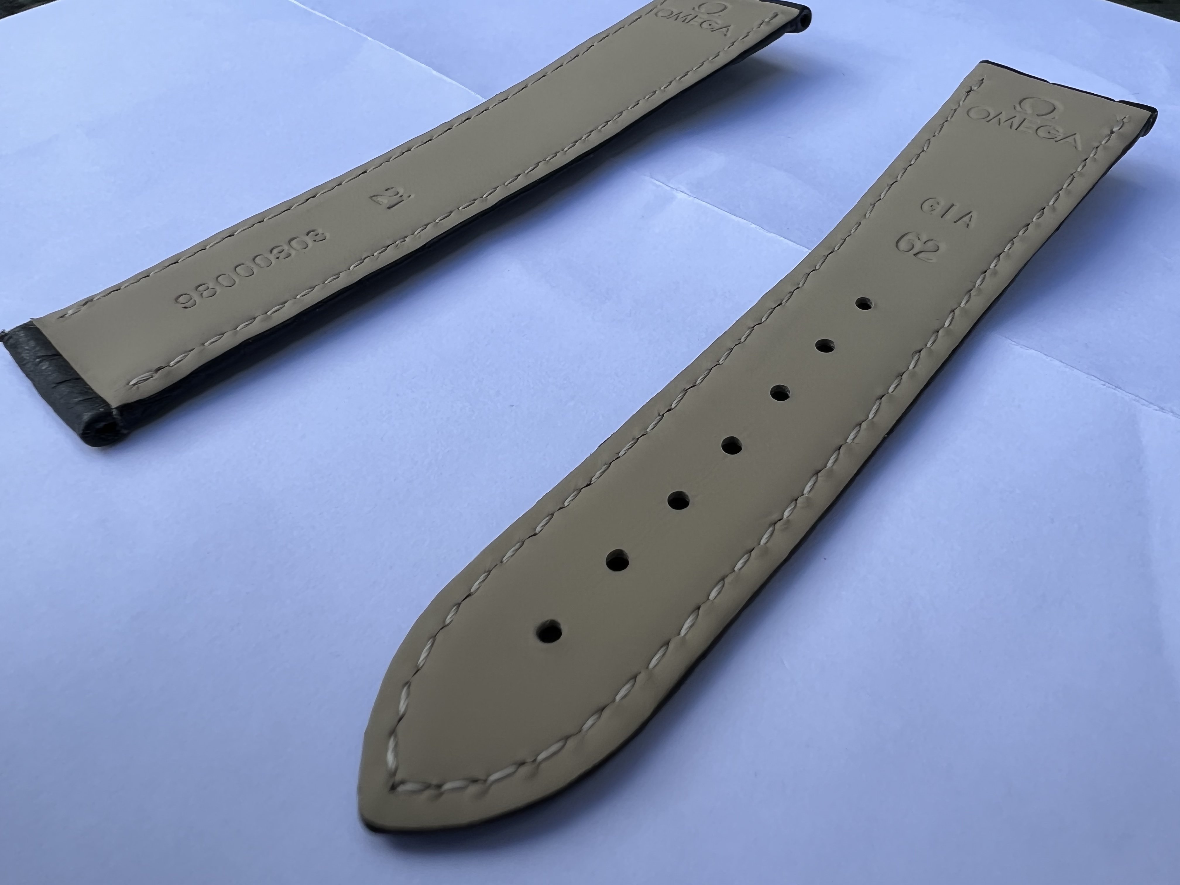

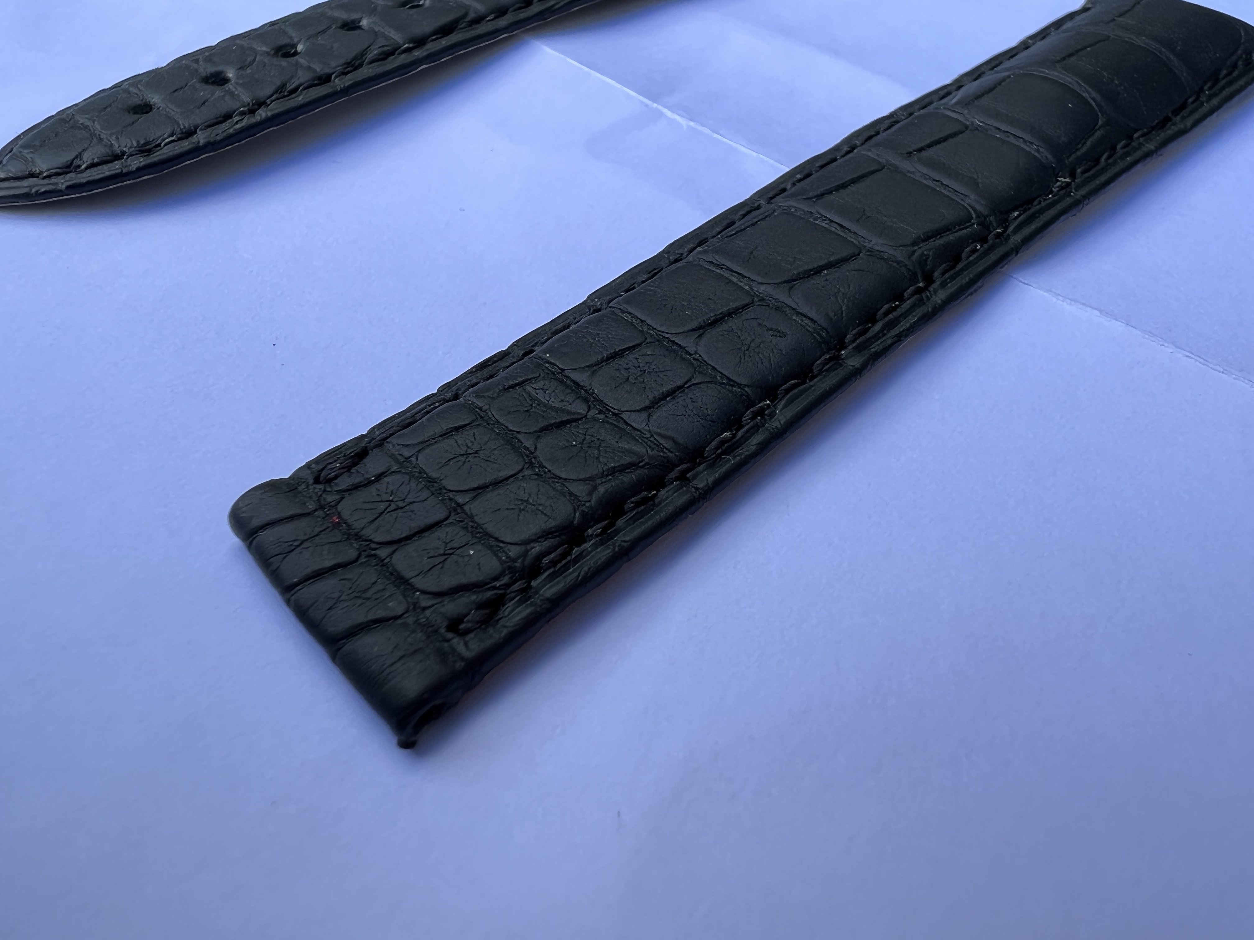

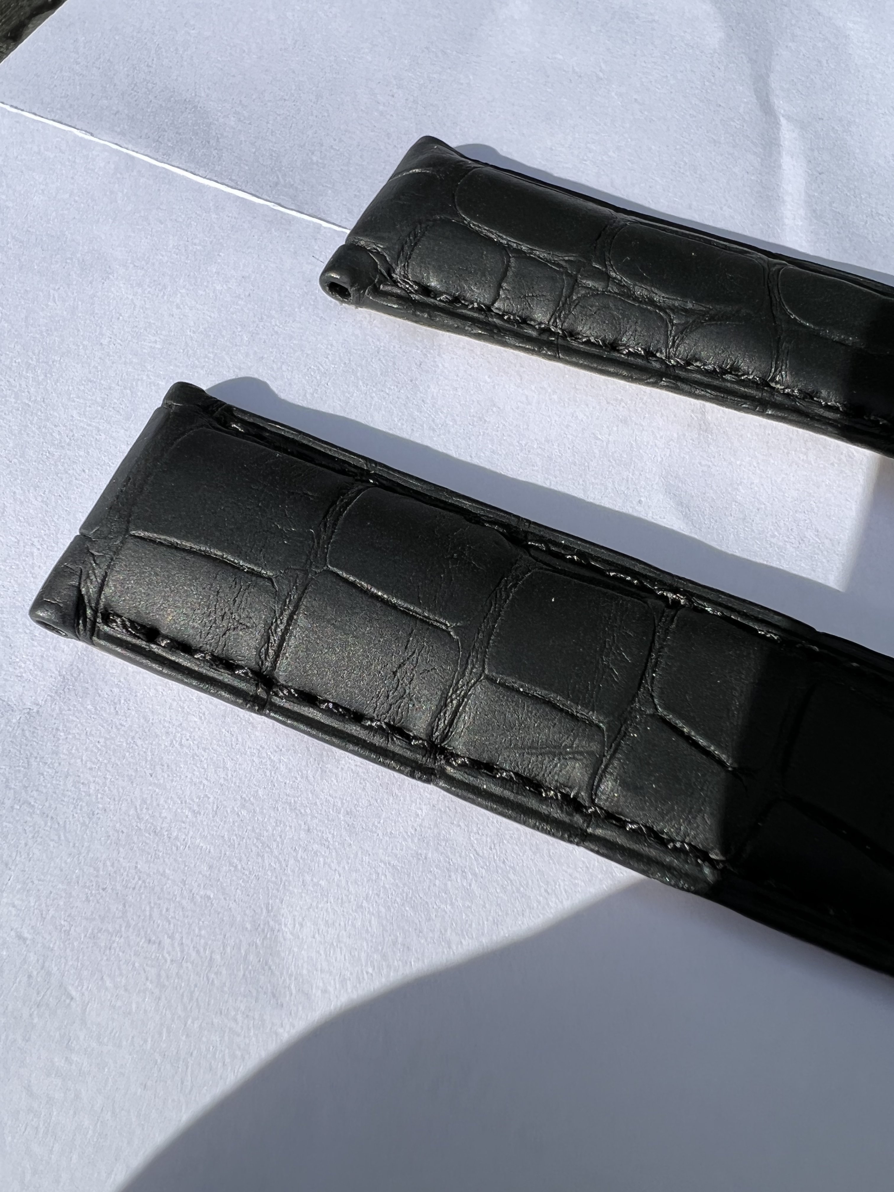

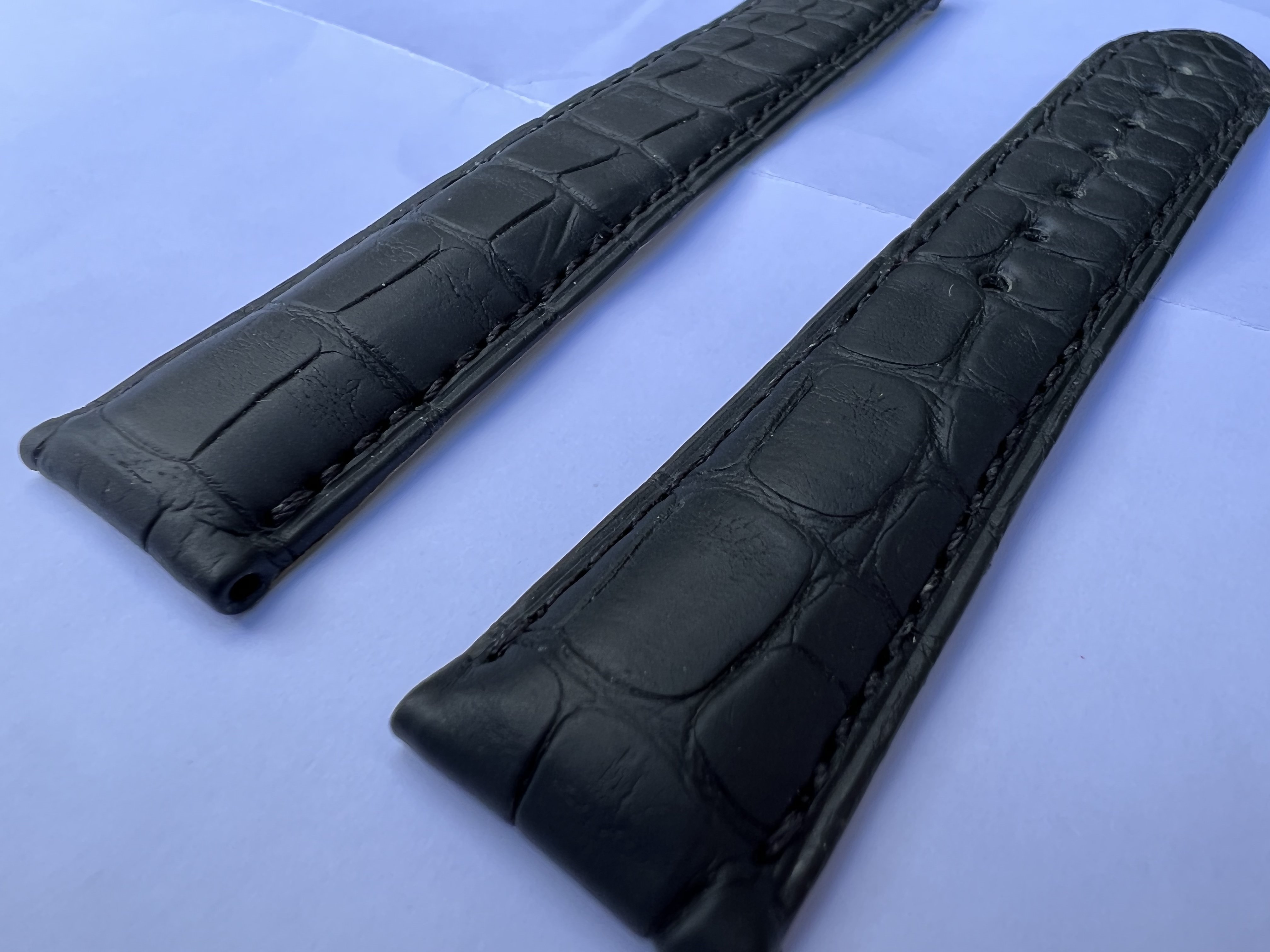

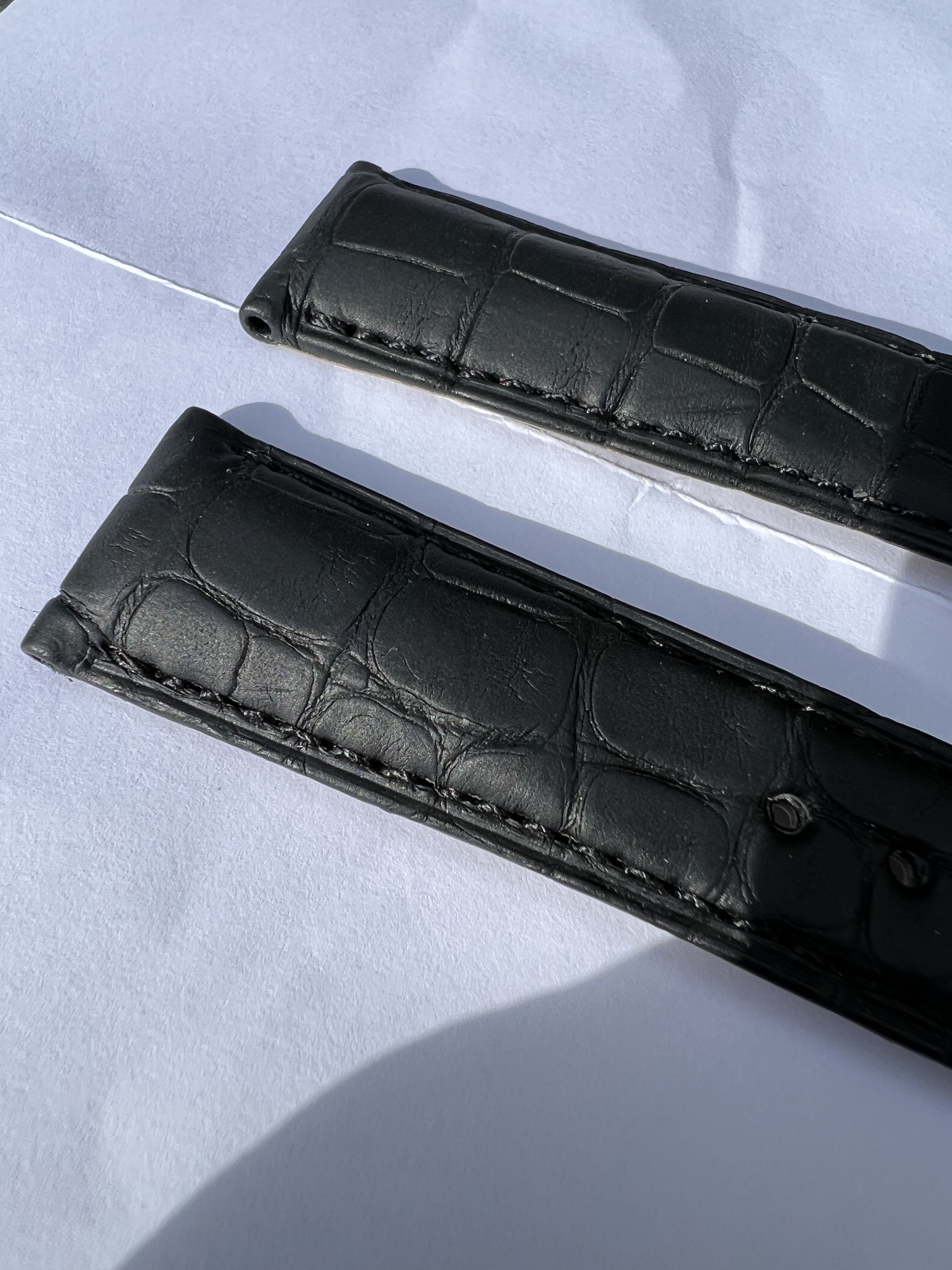

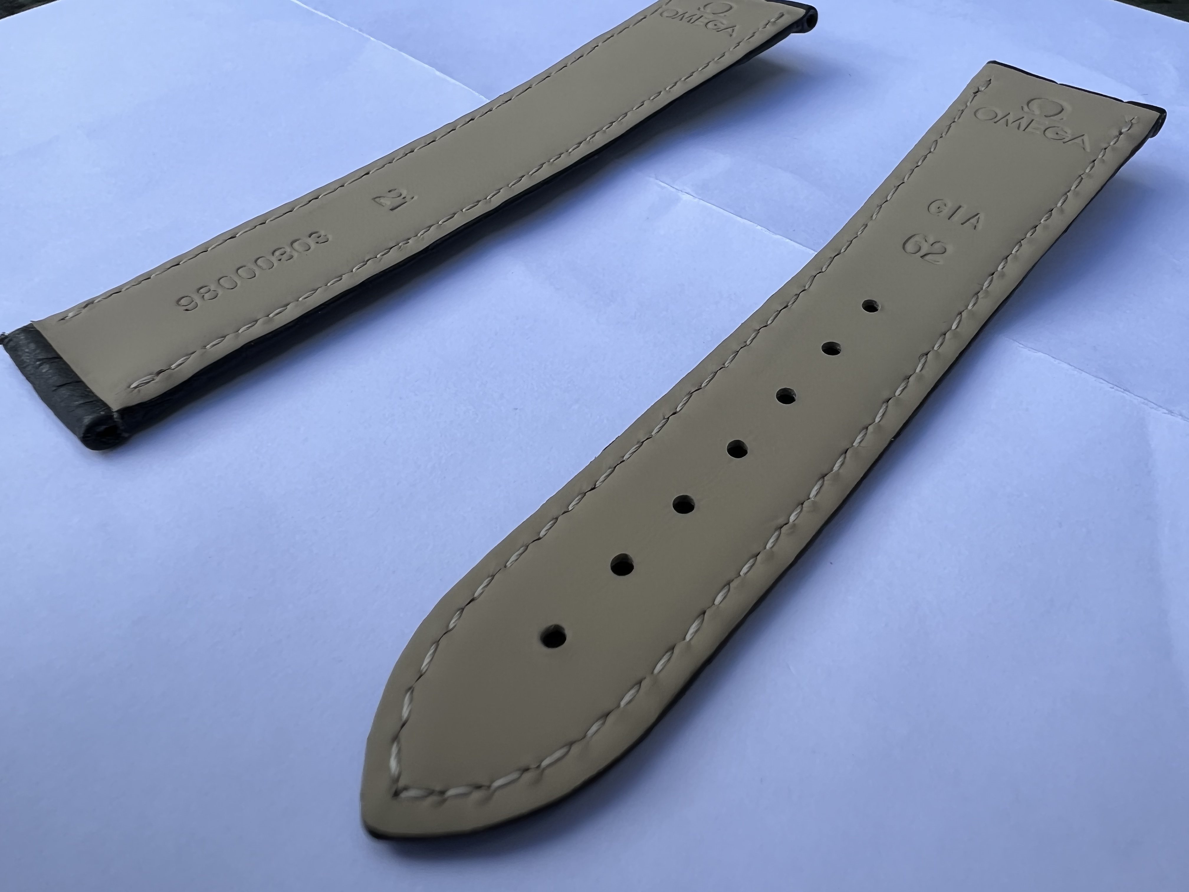

Hi All, apologies for dragging up an old post. I’ve received my first alligator strap strap today and have doubts about the authenticity. I was surprised as it has a dull finish, looking at other photos I expected more shine and the leather looks pitted in places. I was also surprised that the strap is not that flexible, incredibly stiff from the wider half, although I’ve not really applied any pressure, if this is normal does it become more supple over time? However, the stitching looks reasonable.
Appreciate no two will be the same so I might be worried over nothing, any opinions/comments would be greatly received.
Thanks

looks fine to me. Most leathers develop a shine as they age. Omega mostly uses matte finished alligators for their dark colored straps. They are stiff to begin with and will mold to your wrist over time. This helps with stabilizing the watch on your wrist. If a strap is too soft, the watch will move around a lot more. I wouldn’t be too worried about the authenticity of that strap.
30,284
78,150
This is a matte finished strap when it comes from Omega, so that's not an indication of anything being wrong.
