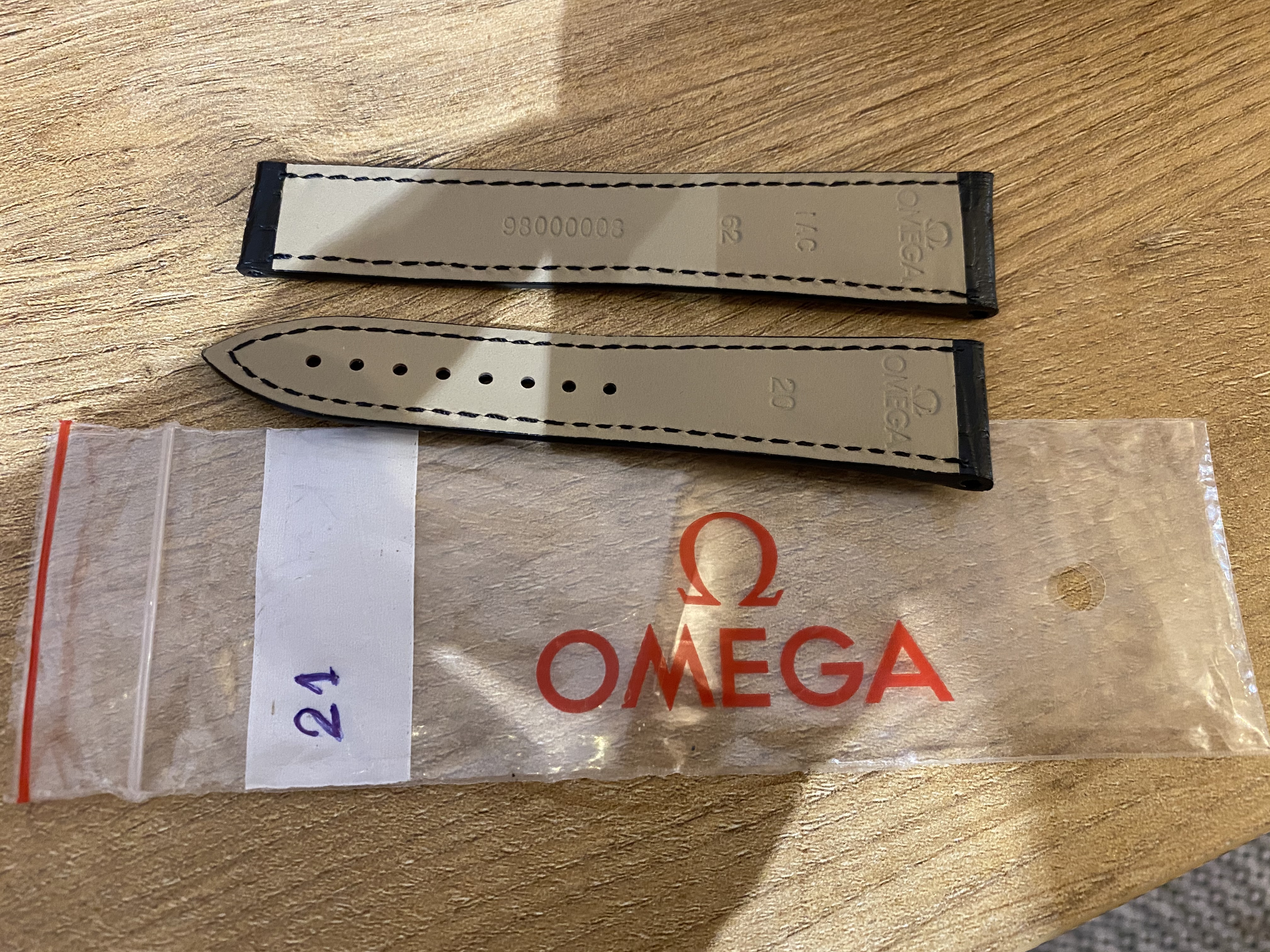

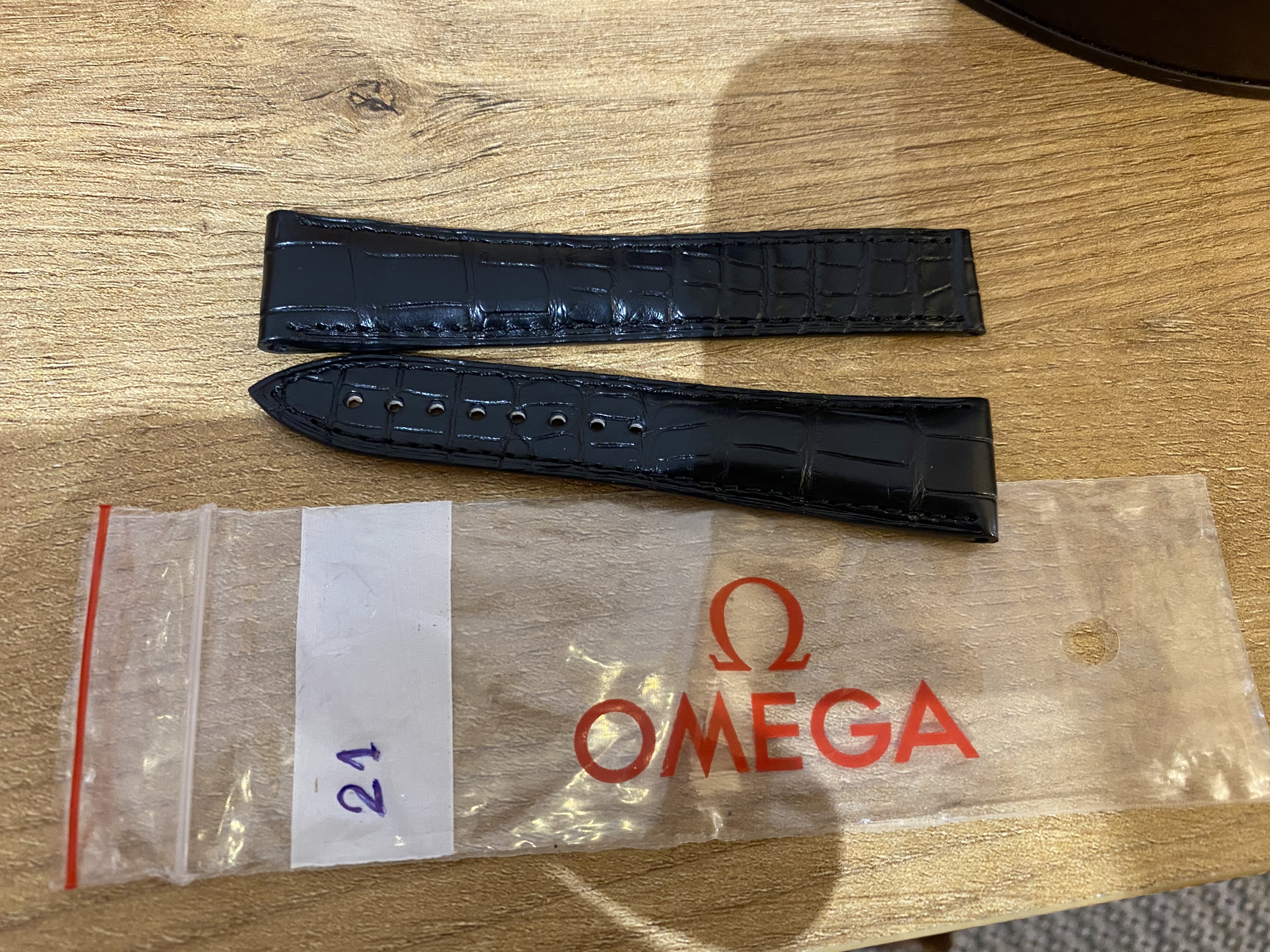

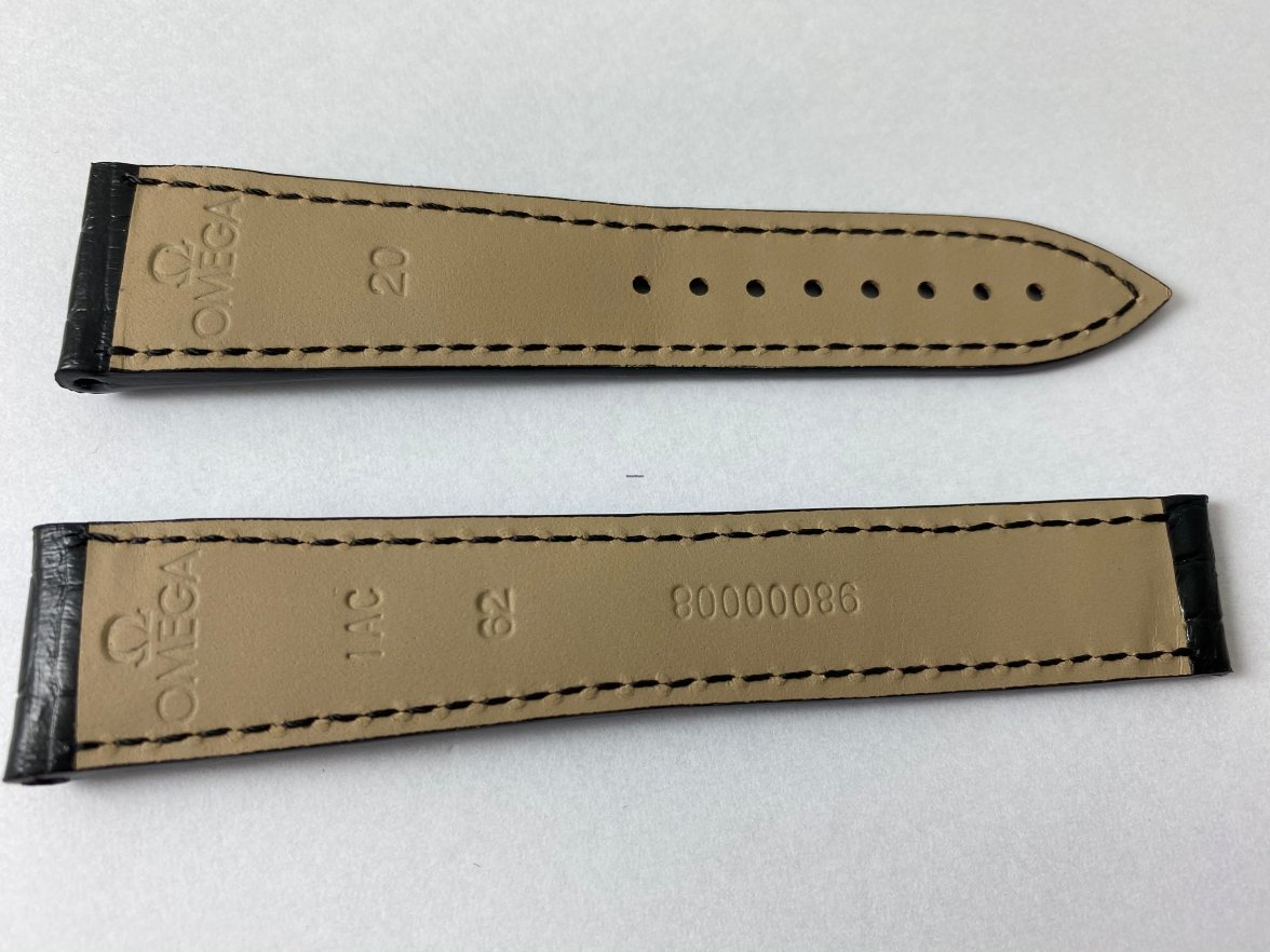

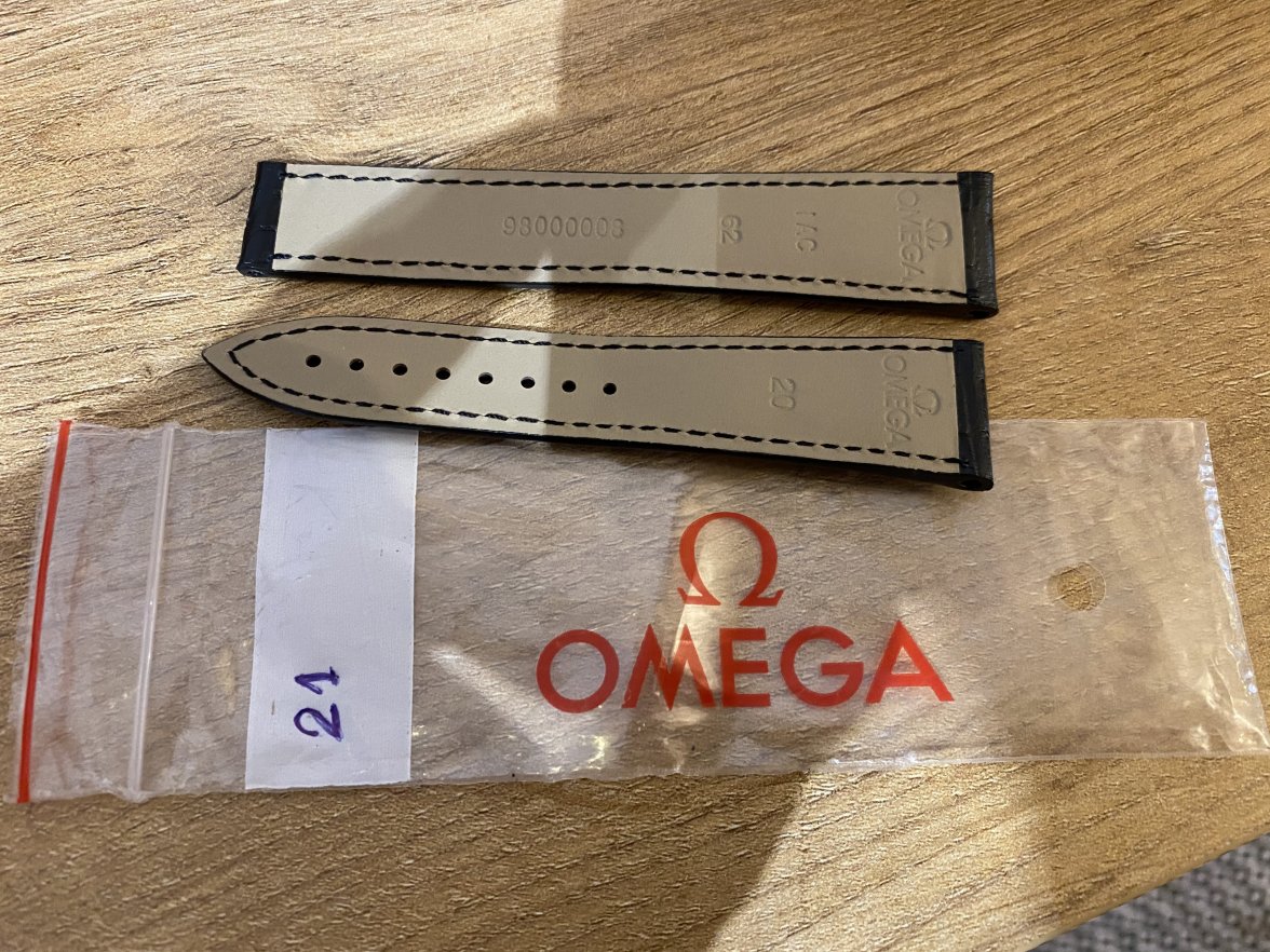

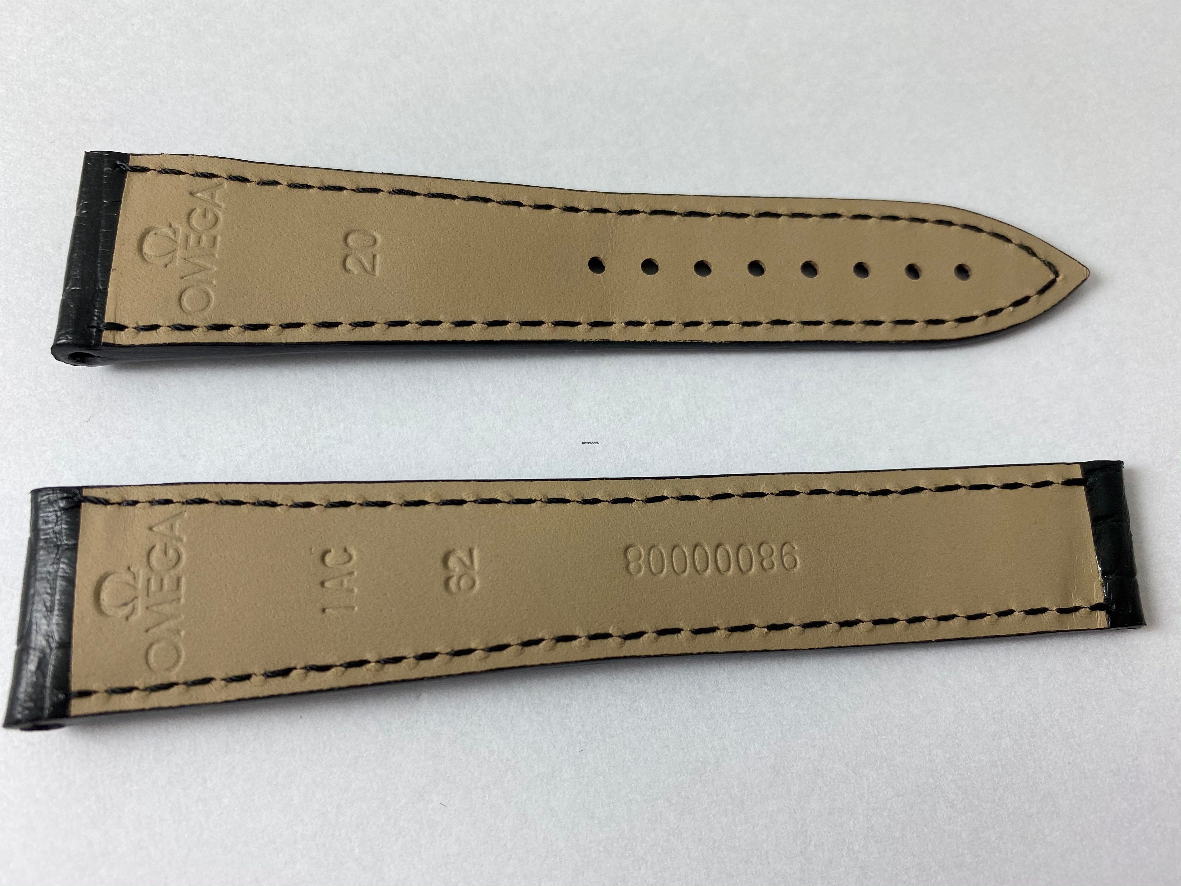

Hello, I have been lurking for a little bit but finally got the motive to join the forum. I am looking to buy a OEM alligator strap as a replacement for my speedmaster moonwatch original strap that came with the hesalite version back in 2018. The 20mm/16mm. I already have the 16mm clasp however I am not sure what to look for to distinguish between real or fake omega straps?
I found this one chrono24. I compared this to mine (damaged one), it's a lot shinier, mine looks matte-ish and the 3 letters don't match (IAC). What do you guys think? Is this genuine?
I am aware of the whole buy the buyer thing.
They are a trusted seller with 297 reviews
414 watches sold with buyer protection
Omega Aligator Strap 20 mm/16 mm New for sale from a Trusted Seller on Chrono24
They also have a store in Poland and website.
Koleckja zegarków - Eleganckie zegarki (eleganckie-zegarki.com)
however I am based in uk so will have to take delivery
Any tell signs of a fake/genuine?
Anyone used this seller before?
Thank you for help in advance

I wouldn't bother. I believe it to be correct, and that should be enough.
Seriously, it's right. Worry not.

I sold an OEM Omega gator earlier. I know mine was 100% legit, due to the source.
With your pics, the only thing that stands out is the stitching. Oh man, it's all over the place.

I'm no expert. But, for OEM Omega, the stitching is pretty wonky. Omega produces quality stuff.
Rather than ask a Boutique to authenticate (which they won't and can't, as others have said), why don't you go to an AD and look at an Omega watch with the same strap and look at the stitching?
I suspect you'll find your answer that way.

Can't thank you enough for a response and excellent idea. Are you specifically referring the wonky stitching on the underside of the strap?
782
1,387
Absolutely. Uncharacteristic of OEM.
$30 custom straps from Vietnam have better stitching than that.
5,631
5,815
I looked online and saw others with this part number with goofy stitching.
Maybe not buy any of this strap and instead get the 980000245, which is 20/18, so new buckle. Erm, never mind.
5,631
5,815
You just have to get used to the various markings used over the years. For what it's worth, I still think the one you originally posted is real; it just wasn't made as well as some.
