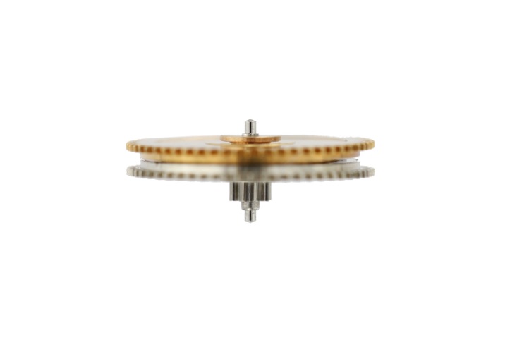

Of course people can believe whatever they wish, but with vintage watches in particular, even the parts that are still available from Omega are getting very expensive. I'm all for letting modern watches run until they stop, use the service center, and you won't pay a penalty in costs, but the same simply isn't true for vintage watches.
It used to be rare that the value of parts in a service job equaled or was more than what I charge for labour, but now this happens often. Here's an example - this is a winding gear for the Cal. 1010 series of movements...
This part is over $300 itself...and like any reversing wheel is one of the hardest working parts inside the automatic winding system, so they frequently need replacing if worn. I don't think vintage collectors have any idea of what it's going to be like in the not too distant future regarding parts prices - these increases are happening at an alarming rate. Replacement crystals just recently went up to a crazy price - what you used to be an easy decision to replace a crystal is now something that can really impact the bottom line. A third wheel from a Cal. 321 that I used to get for $38 as recently as February of this year, is now $180.
More than ever failing to service in a way that preserves the parts inside these vintage watches is going to cost people a lot of money in parts. If you choose to not service your own vintage watches regularly that's fine, but say that the parts are inexpensive, is not really the case anymore.
