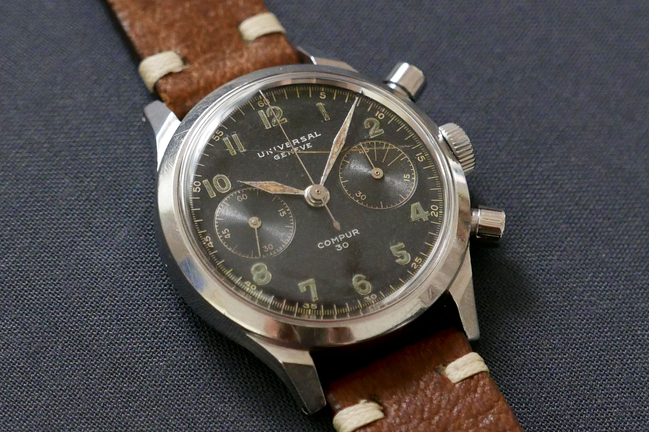

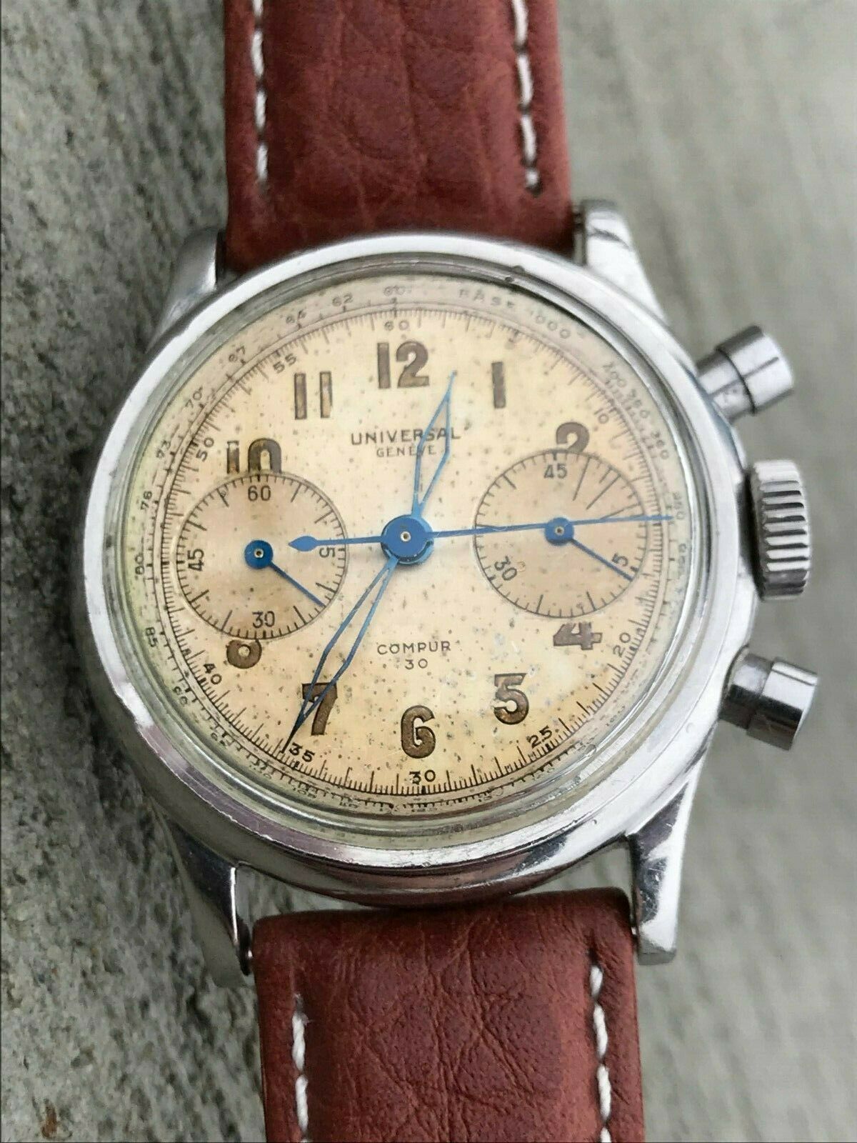

    I know the classic Spillman case with the angled lugs, drilled through, and the particular caseback. But I see lots of other types of cases referred to as Spillman. I assume they made other cases in addition to the one style I am talking about? Or is a Spillman case ONLY that classic angled lugs design?
    I started a thread about this a while back, asking if anyone had any data for all the different types of Spillman UG references, but no response, so not sure if this has been studied/documented?
    For example, is this a Spillman case?

    Yes, but what about the first watch?
  5. Diabolik Feb 26, 2019
    1,374
    2,664
    The first one "No", not a spillman
  6. vujen Feb 26, 2019
    866
    3,359
    Of course not a Spillman one.

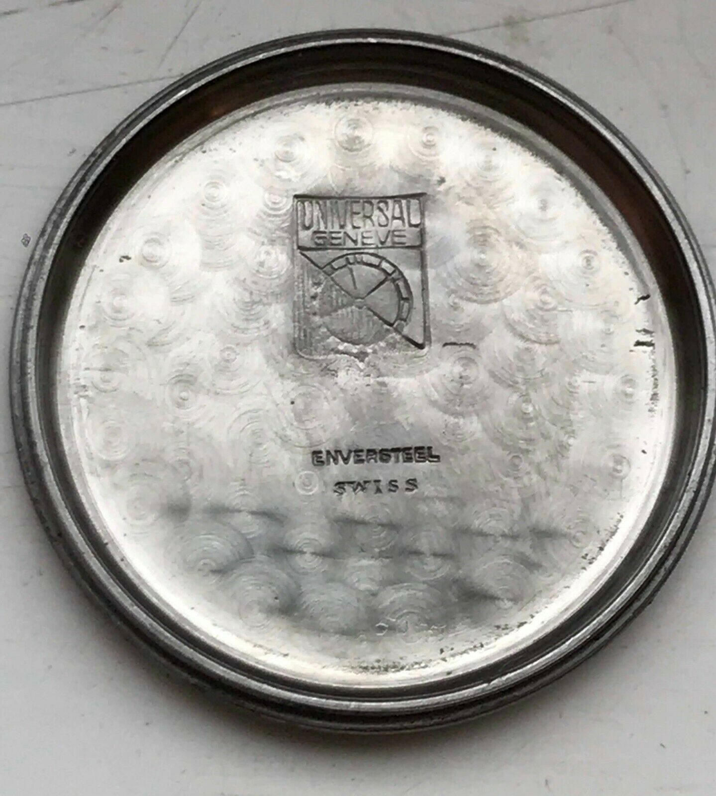

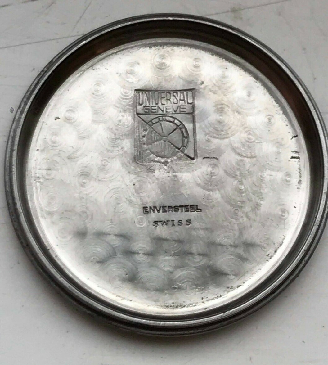

    I'm sure you know this, but not all cases with those angled lugs are made by Spillman. There are some generic lookalikes. This case-back indicates a Spillman case.

    You can also look for a hammerhead with "136" on gold cases, and case reference codes starting with "SP".
    bgrisso likes this.
