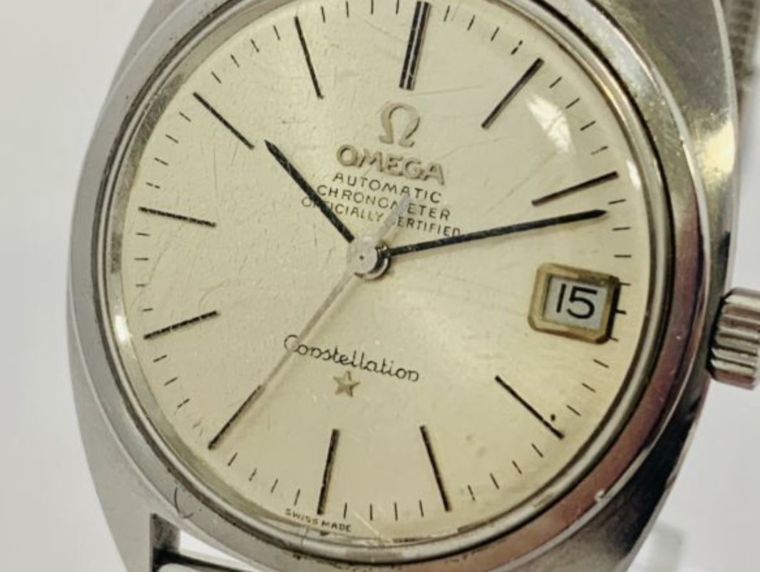

Is this a re-dial? Tiny SWISS MADE
2,677
3,151
Honestly at this point I wish I originally made an "Is this re-dial?" thread that I could keep posting every dial I see into 😀

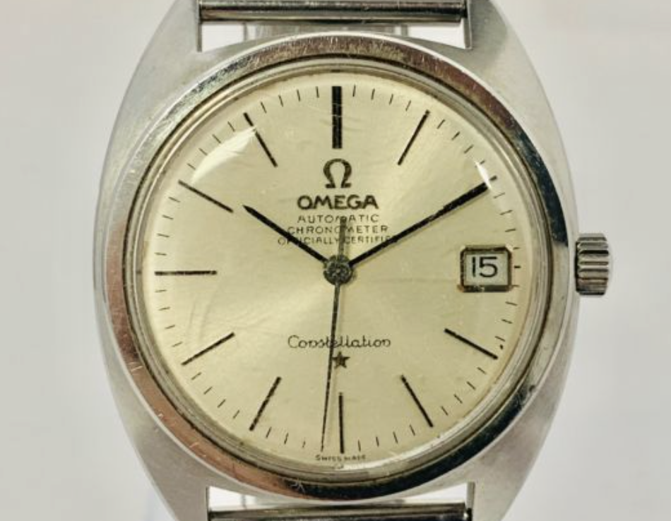

For this dial, usually the SWISS MADE spans around 3 minutes in width - so it's between minutes 28 and 32
But with this dial, it spans only 2 minutes in width, it's mainly between minutes 29 and 31
This triggered me, but I've seen 1 other example that was like this, it could be that these 2 watches a re-dials from the same source, or maybe this is a rare oddity and the dial is original?
2,677
3,151
By the way I stumbled onto an 18K gold 168.017 that had a tiny SWISS MADE like this one, so probably the dial is original
I don't know why some SWISS MADE's are tiny while same are larger tho ...
