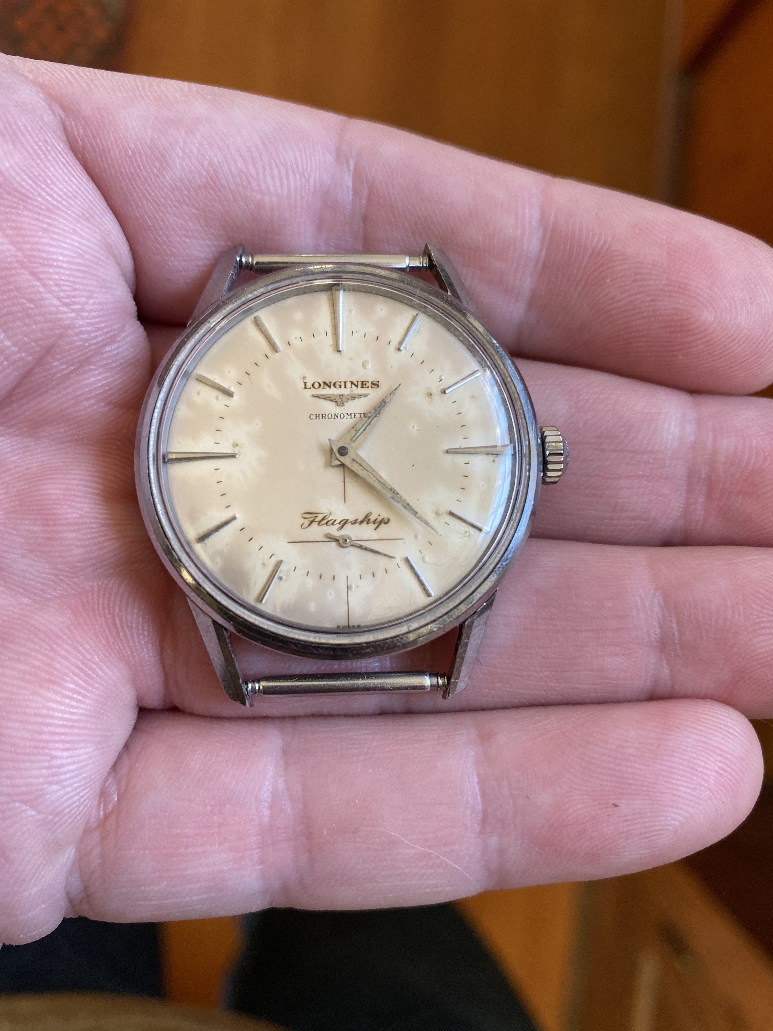

Is this a legit Flagship chronometre?

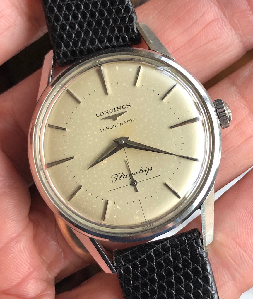

Yes, the dial is not correct, but the movement does appear to have the correct chronometer balance. Here is mine as a reference, and it has been confirmed by extract.
810
1,654

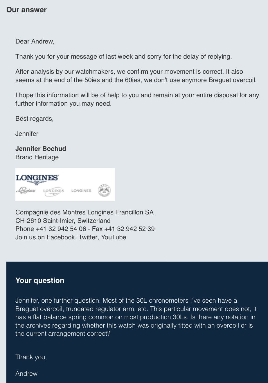

Actually, as Longines has confirmed with my example, there are 2 variations of 30L chronometer movements. Examples before the late 50鈥檚 should have a Breguet overcoil. Examples after this time, however, may be outfitted with the standard balance spring.
