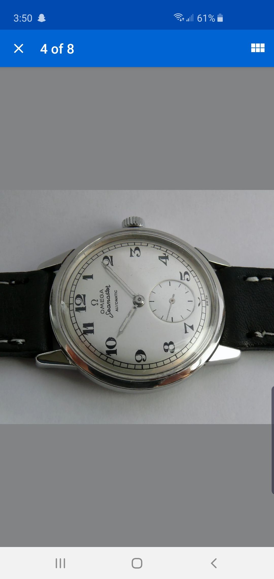

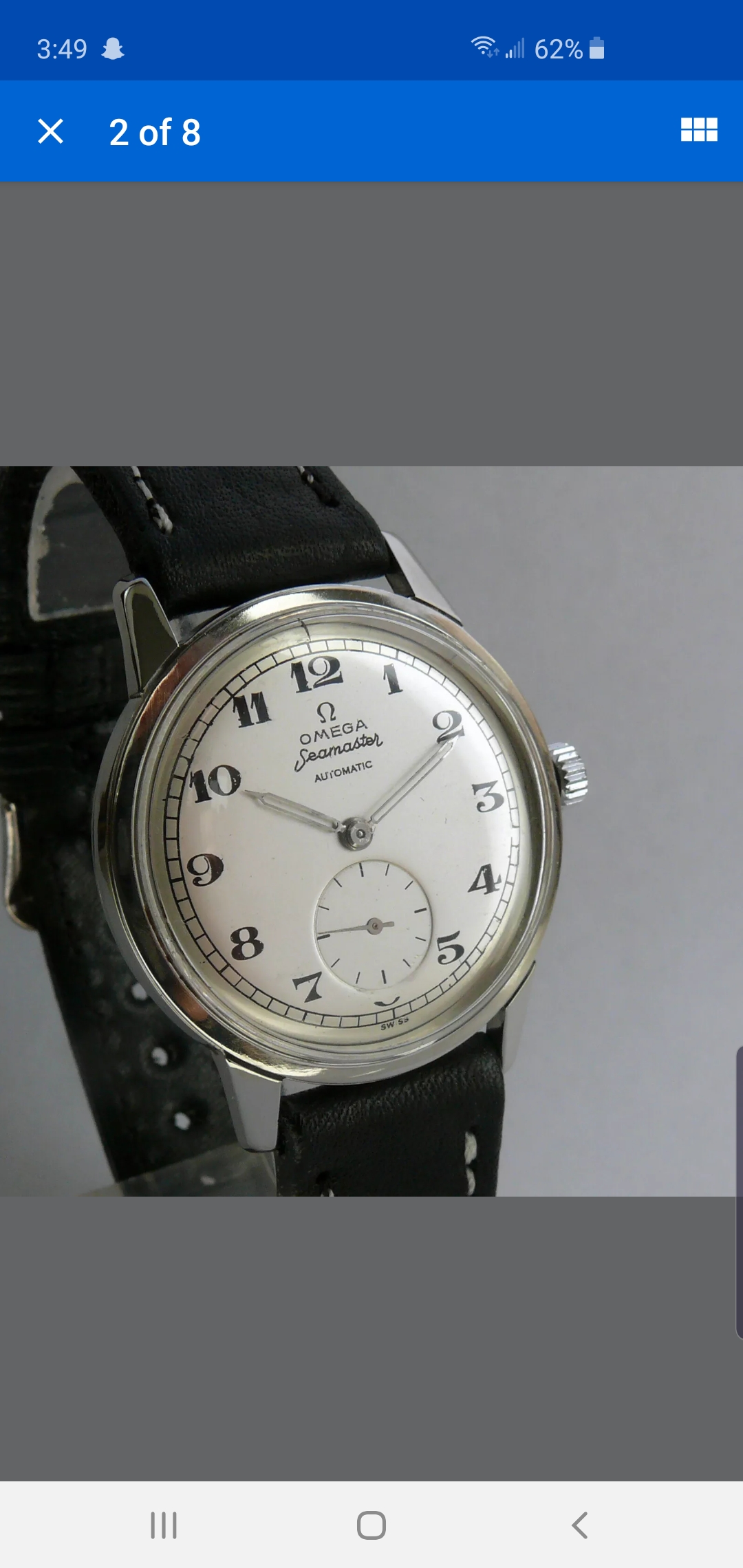

Is this a genuine omega bumpwr or completely frankened?

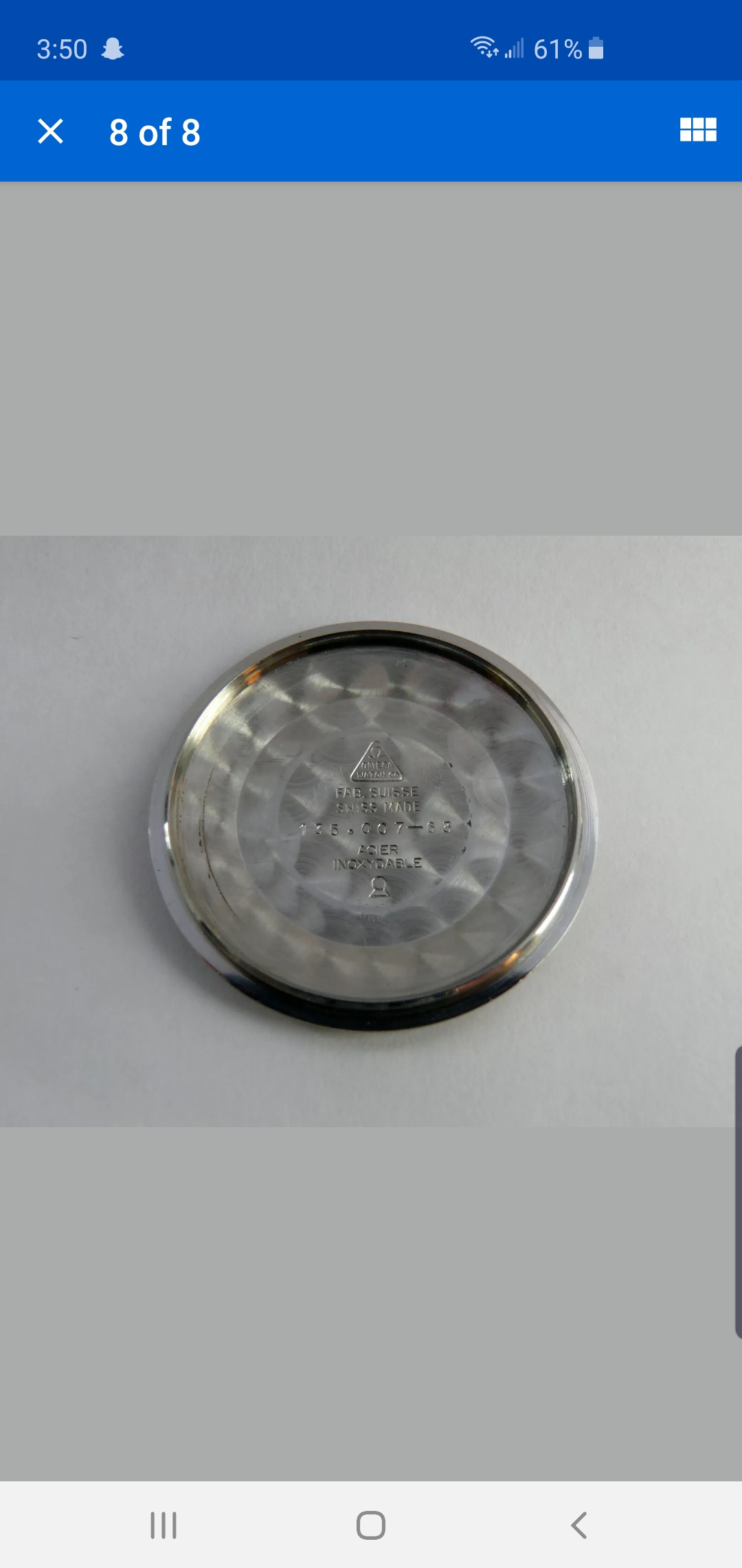

I am looking at this piece, I like the style of it. The ref on the caseback belongs to a seamaster 300. Was there ever a bumper model that had a dial like this or is this completly invented?

That one's a f蠀cking mess! 馃槻
18,840
39,182

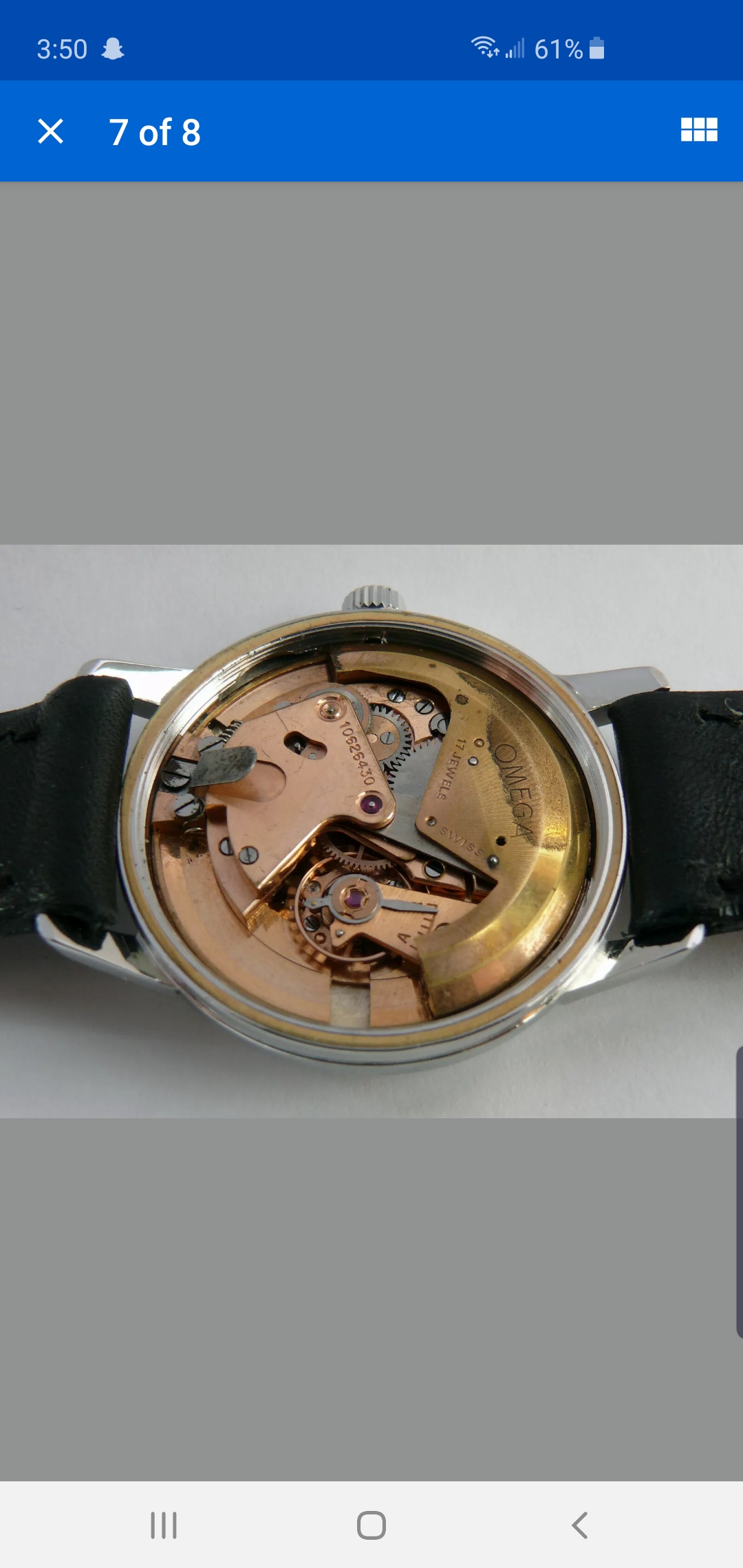

I've seen worse. Can't remember when, it was too long ago, but this one has them all.
Polished to death, franken parts, movement colours and to top it off, an amazing dial.
356
581
Sharpie numbers...Kato Pen is more like it. Run and I鈥檓 a noob and figured that out. Study every picture you can in this forum and learn. You will start to see and understand.

If you like the style of the numerals they are refered to as Breguet numerals. There are Omega鈥檚 that have them so look them up and you鈥檒l know what you鈥檙e looking for.
18,840
39,182
Omega actually call Breguet style numerals "Empire" style, same with Breguet style hands, Omega uses the term "Empire".
10,804
16,814
Truly awful piece, everything wrong. Movement from the 1940s, case ref from the 1960s, dial from an Infant school art class. If you have ask about this then I suggest you keep researching馃槈 Only kidding, you obviously realised there are issues.
The ref on the case 135.007-63 belongs to a Seamaster 30 which is manual wind, not the Seamaster 300 Auto, that鈥檚 quite different and rather more desirable. There is a good chance that鈥檚 a 40s bumper model with a replaced dial and caseback. Here is an original SM30, the lugs look a little different. Also that bumper is 28mm, the SM 30 uses the 30mm movement (naturally!) so the movement likely hasn鈥檛 been swapped and does belong in that case but under and earlier 4 digit case number.
