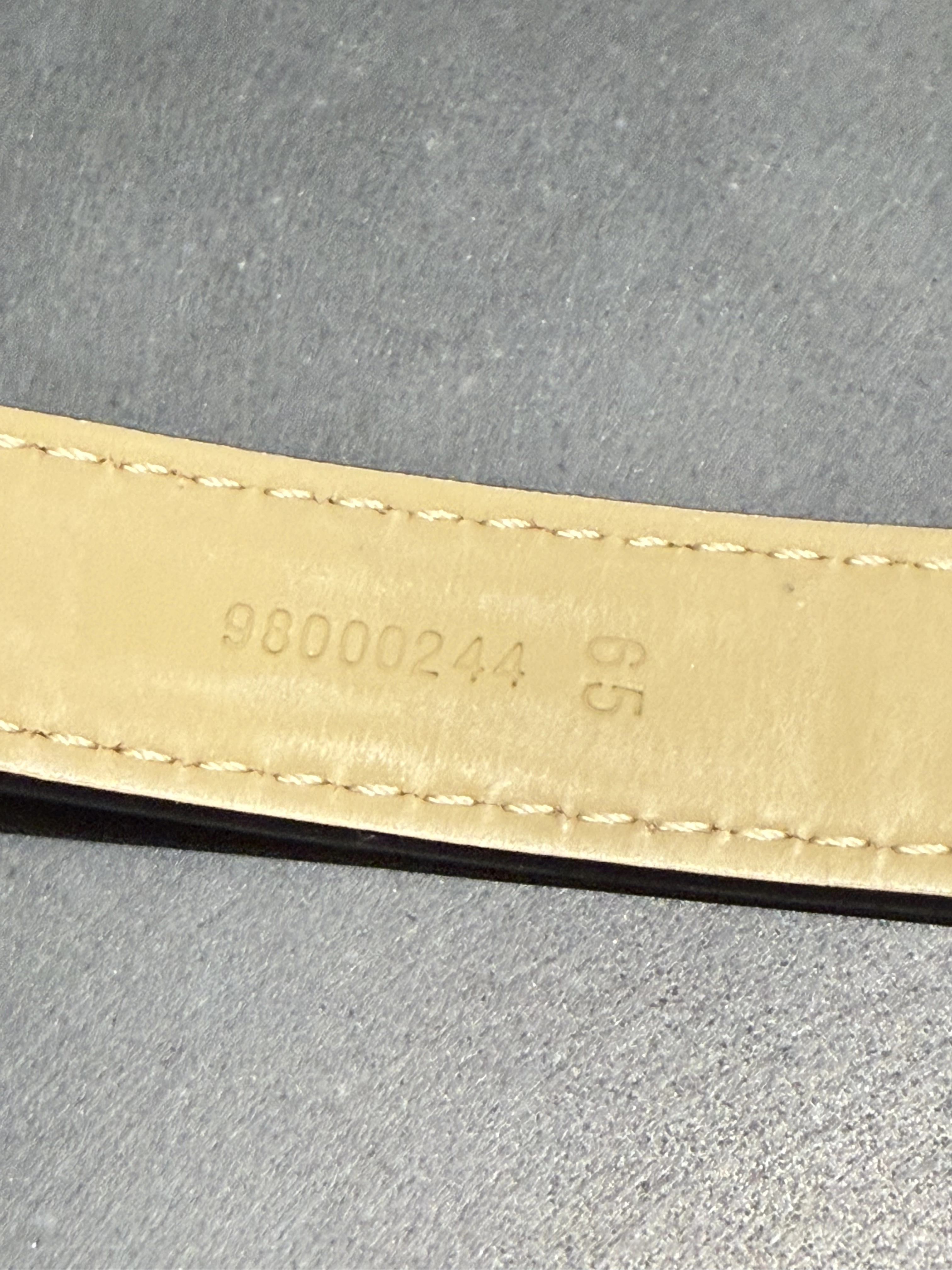

Is this a fake Omega alligator strap?

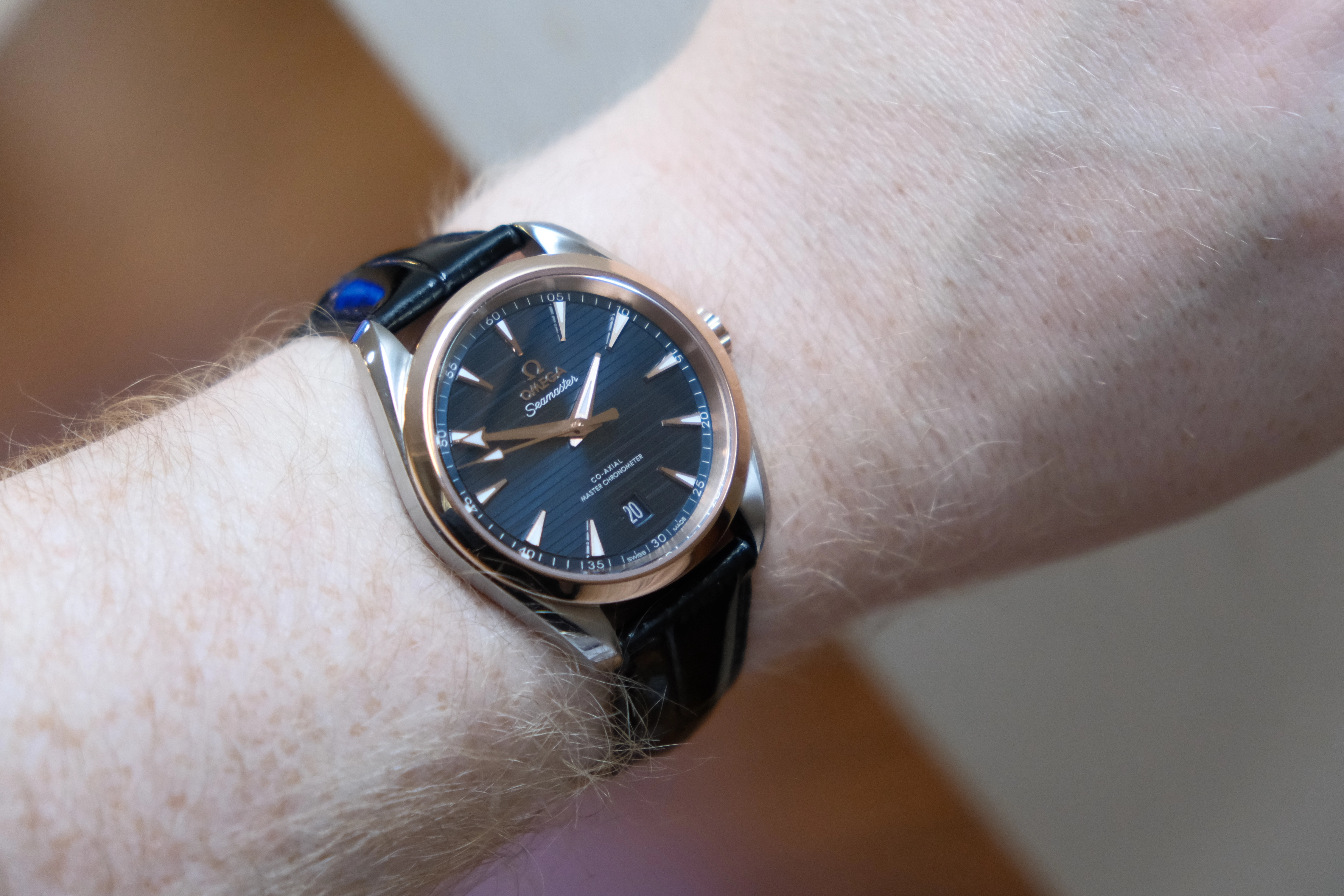

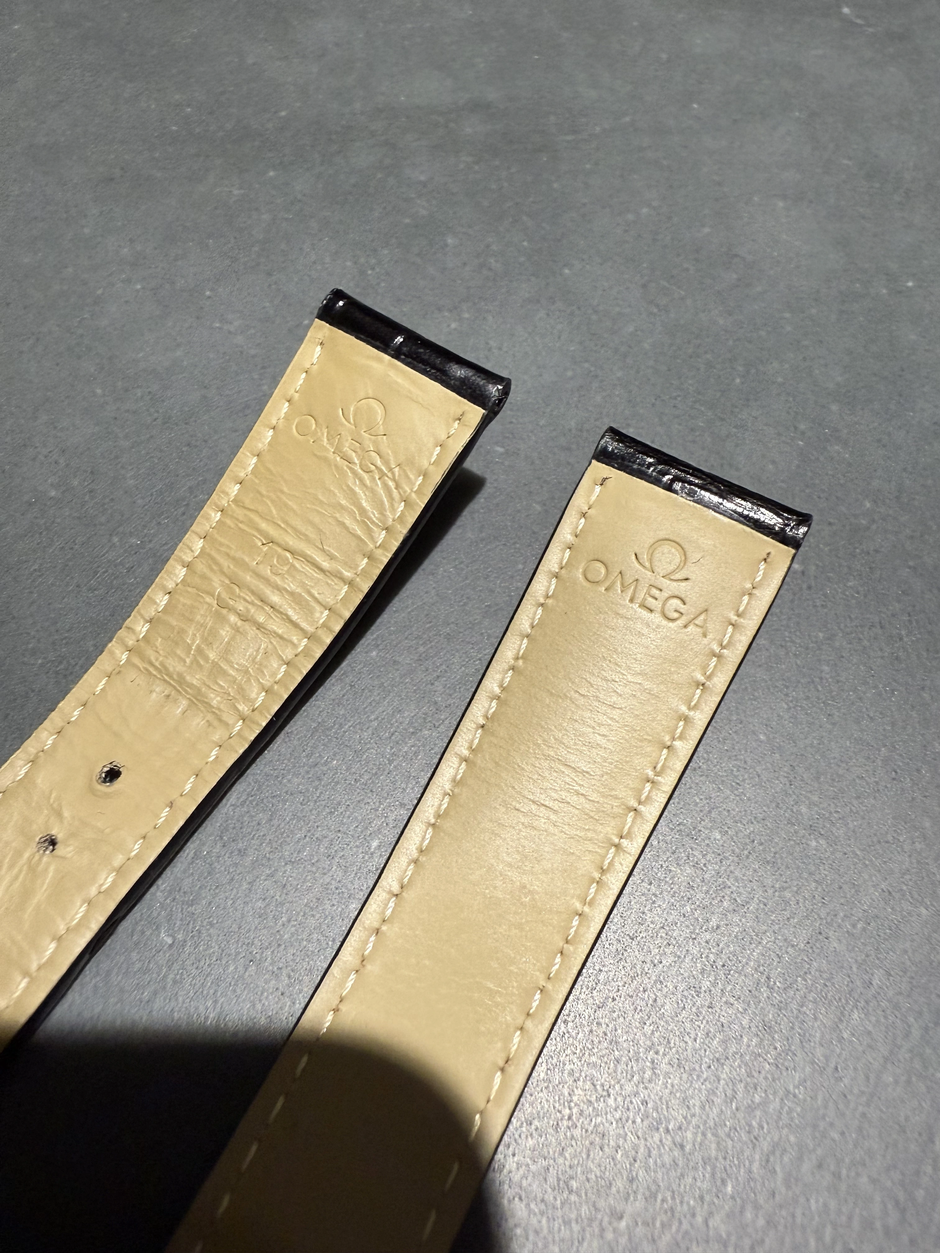

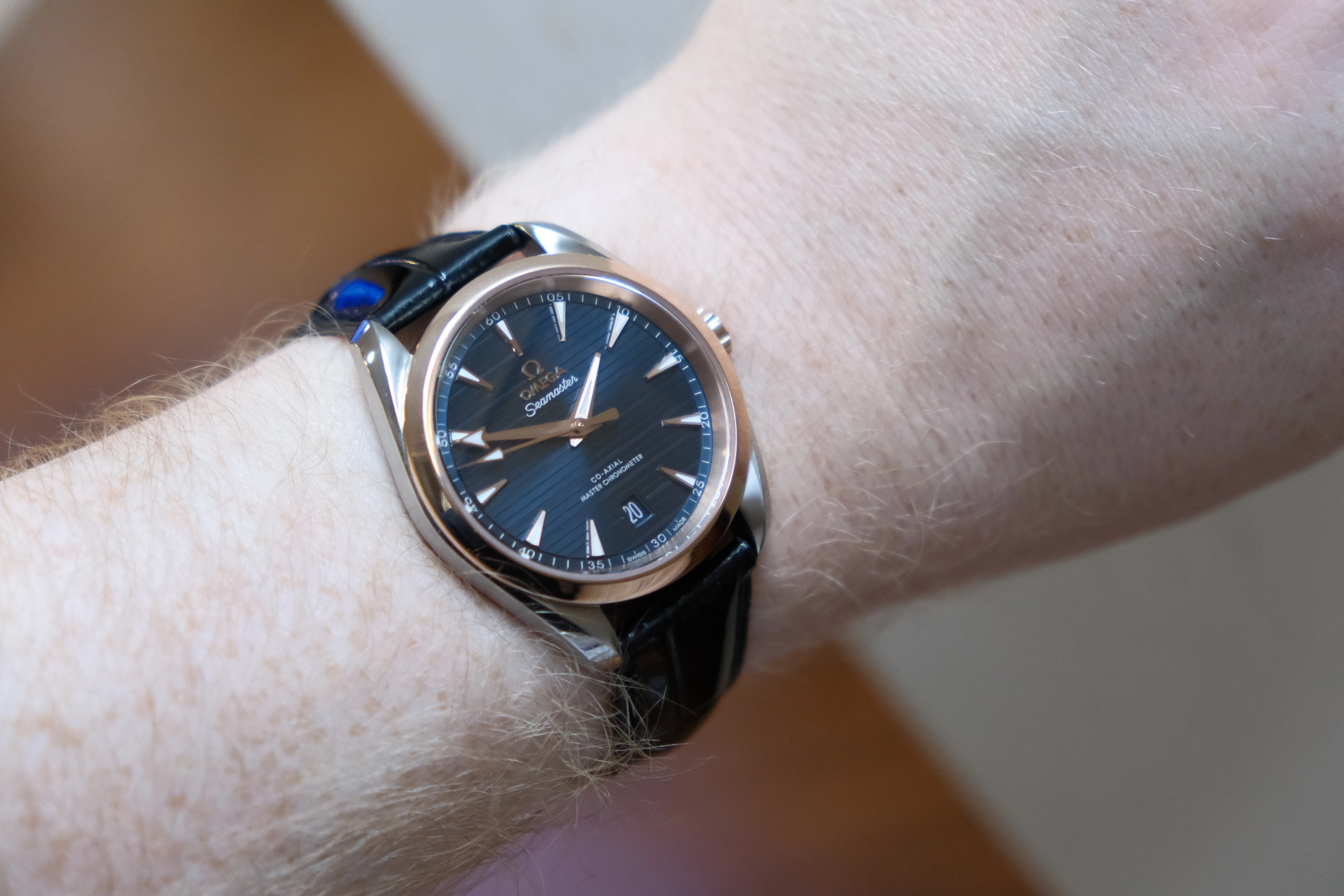

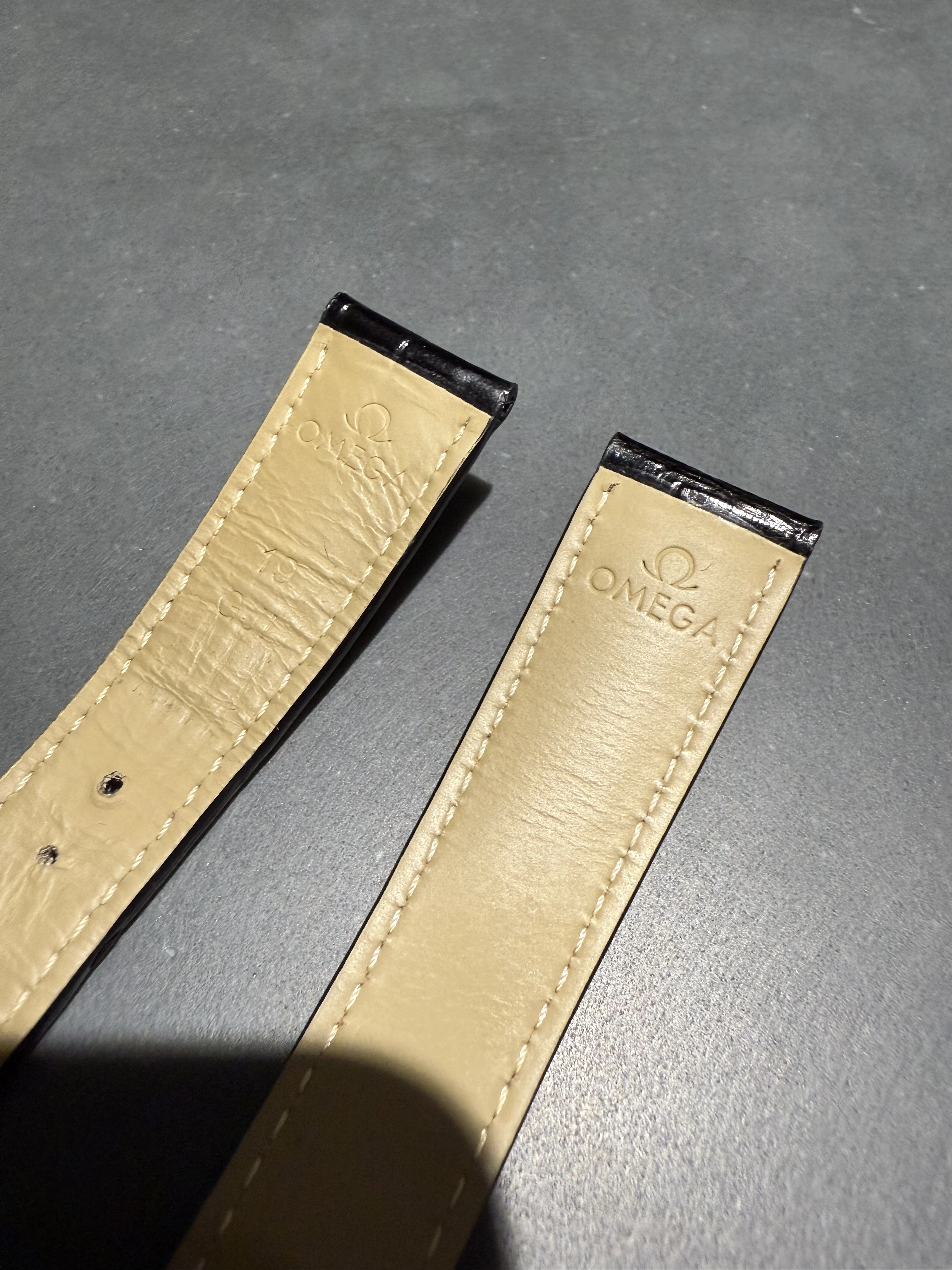

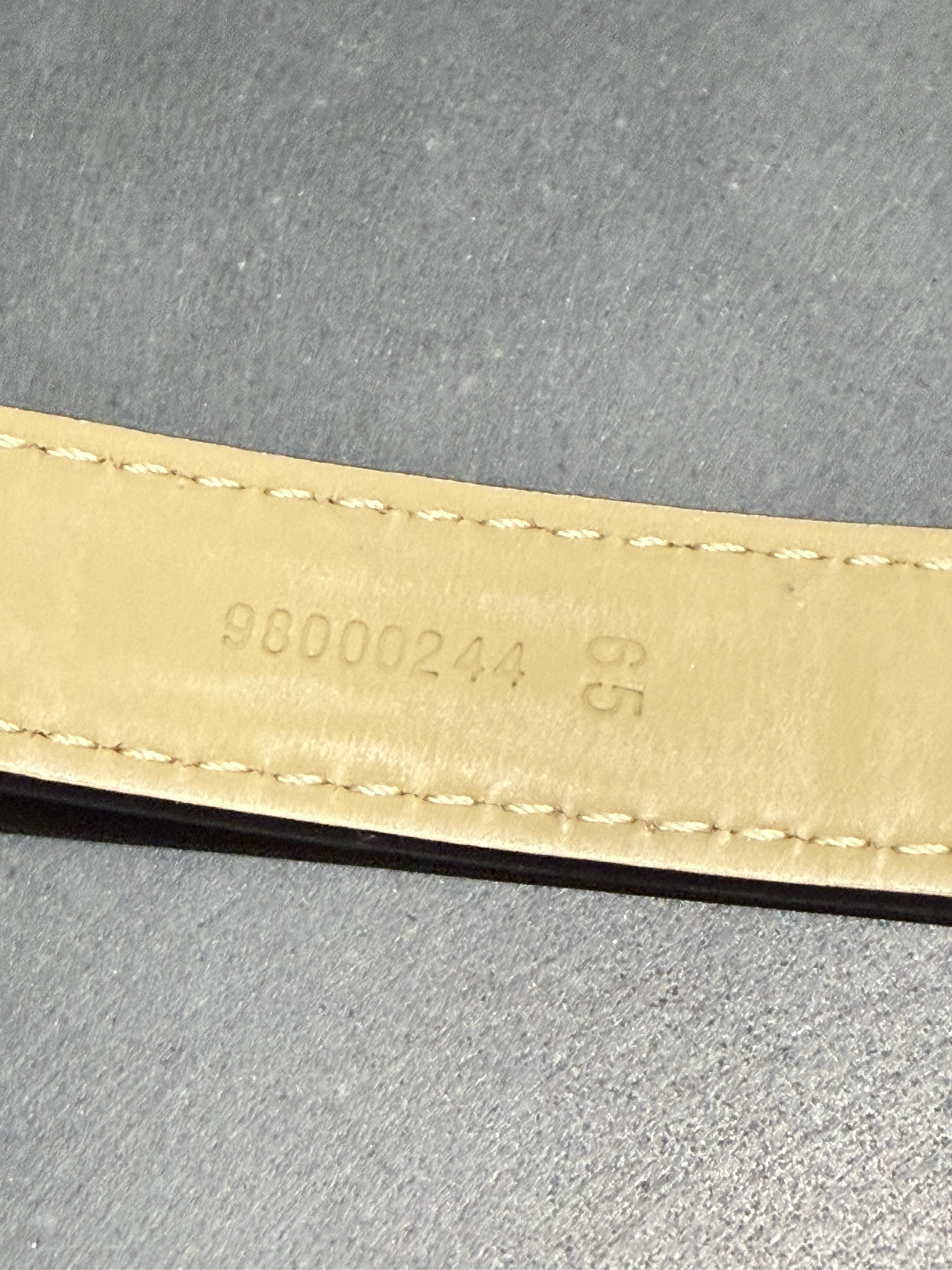

This black alligator strap came with my aqua terra that I bought from grey dealer. I noticed that the number on it does not appear to line up with a 19mm black alligator strap when I google it (98000244). The logo looks suspect to me. Thoughts?
The watch itself is fine—full box and papers with master chronometer card that scans properly on the app.

I'm going to agree with your assessment that it's not a genuine Omega strap. Ω logo is way too sassy. Reference number points to a dark brown strap. I'm guessing maybe it was a used watch with a heavily worn strap and the dealer was too cheap to plop down the $400 USD for the correct & genuine replacement strap.
Just make sure the watch itself is genuine. If it is, the strap replacement is an easy fix.

Thanks. Yeah, the watch is authentic. The serial on movement and case matches the cards included in the box, and the master chronometer card scanned by my phone brought up the test results for the watch with the same serial.

After more research, the inside of the strap is supposed to be the same dark blue as the outside where as yours is tan. You might want to check if the clasp is legit as well.
If you need the correct strap's part number, give me a week or two or call up an Omega Boutique. I lost my Omega dealer strap ordering guide/catalog with all the strap references during a move ☹️. Got a new one coming via snail mail.
