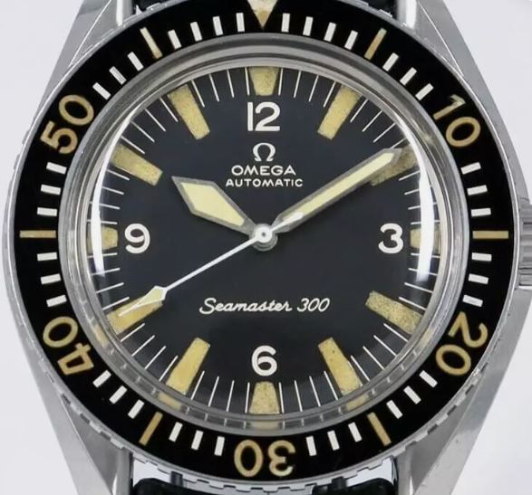

Is this a Fake Dial Omega Speedmaster 300
Hello
Does anyone know here online there might be a complete dial information for Omega Seamaster 300 ?
Some sites have some information but must are pretty incomplete
Dial in question attached, Number Font looks incorrect to me. 1969ish watch

I’m no expert, but I didn’t think the loop is closed on the “6” at six o’clock. Back in the day, that was a major tell of a fake dial.

Agreed. The 6 and 9 look a little suspicious to me. On all the real dials I have seen, there is a bigger gap.

Always nice to learn something new. And the picture the original poster posted does have the short middle stroke in the E. So it is looking real based on that - just uncommon.
