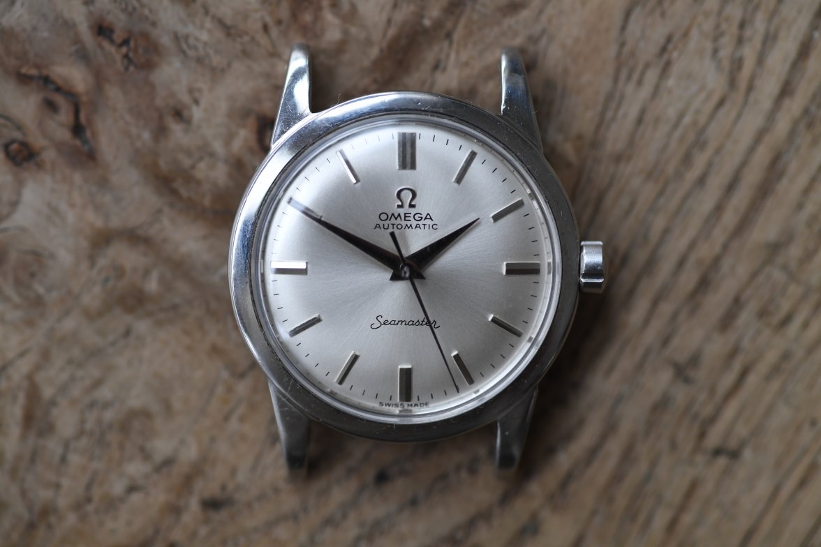

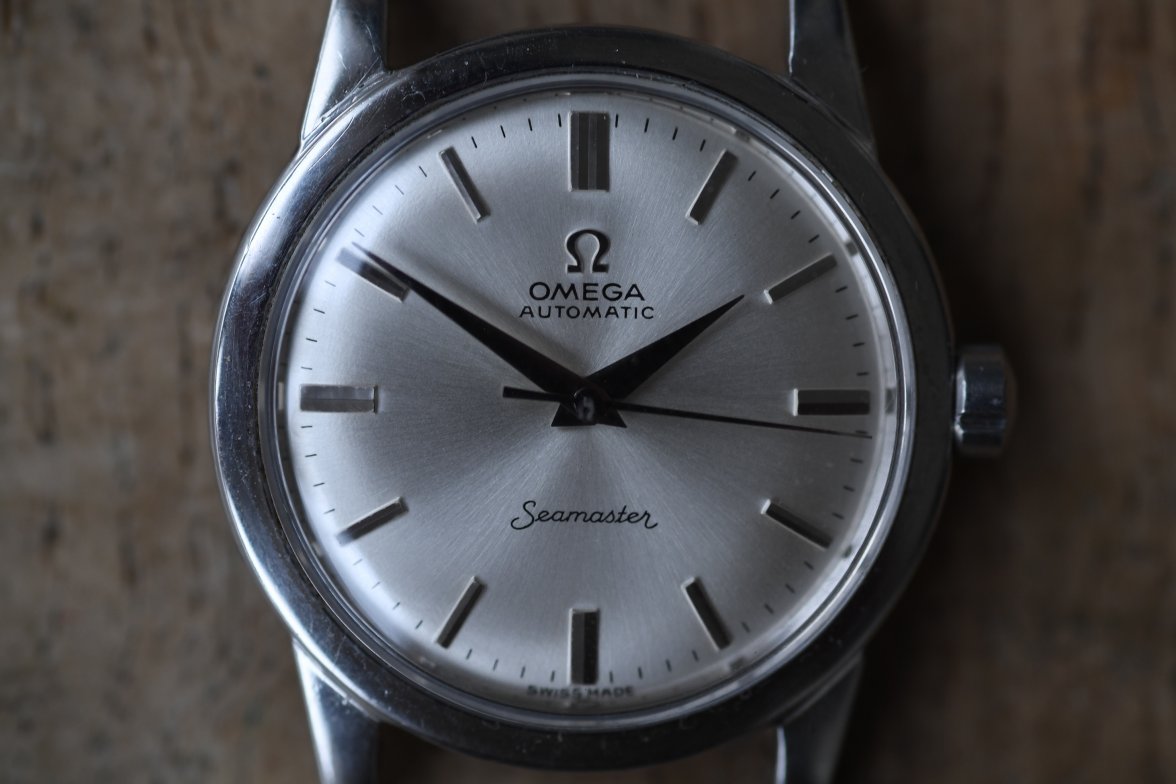

Hi all,
This is in regards to a watch posted in the FS section here. It's a 2577 with a 12.3mil serial dating it to early 1950's I have this feeling that the dial is a later replacement. I've never seen a sunburst dial like this. What does the community think?

Is there any difference between "service dial" and "later (factory) replacement dial", as long as it's genuine? For me it's the same thing.
I agree, for the purposes of this discussion service dial = later factory replacement dial. If the replacement dial was identical and indistinguishable from the original it would be a moot point and not be commented on but in this case and in others where service dials are discussed what is significant it that there is a difference. In the case of the 2577, the dial is completely different to any used in period.

I kind of think of it the same way .... if it was a period correct style dial ..... this is a service replacement with styling of the 60s not the 50s in my opinion . Nothing wrong with it ... Just depends on the style you prefer.

Okay so now there is consensus that the watch has a later dial. I've pm'd the seller as well.

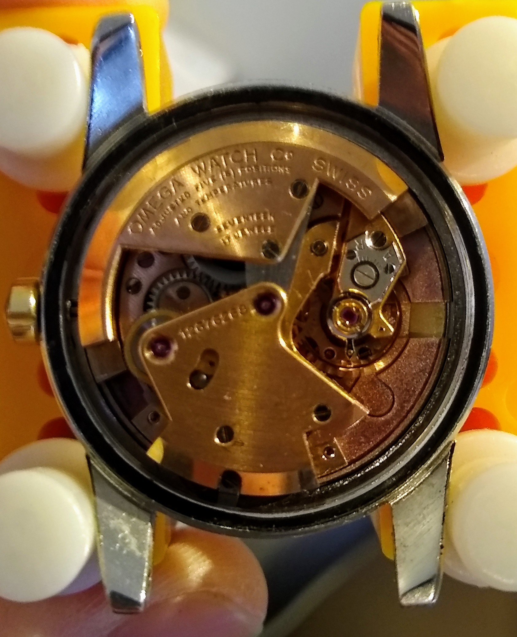

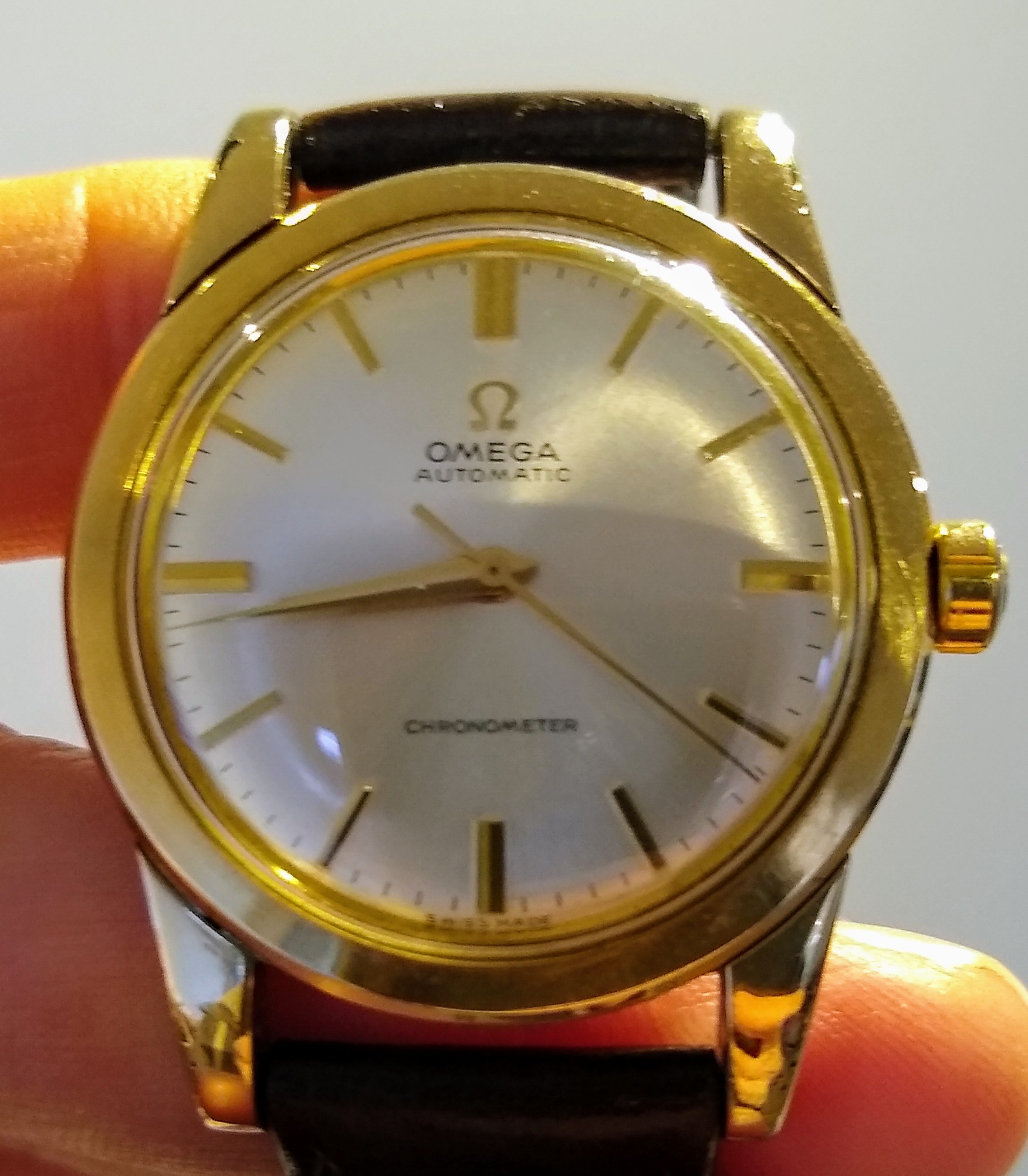

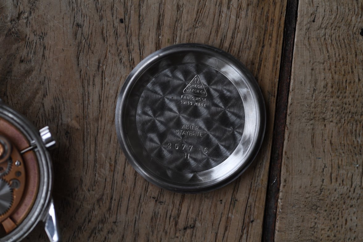

I was interested in the service dial discussions here as I have a 2577-10 with a 352 RG chronometer movement. I got it as a mixed lot of 5 watches without knowing a lot about it. Doing a bit if research, I quickly realised that the dial wasn't original to the watch. I've been looking for examples of similar dials and was struck by the similarities between my dial and the service dials in terms of the sunburst finish, the markers and the lettering style. So my thinking now, based on these examples, is that the dial was replaced during a service sometime in the 60s or 70s. Don't know if anyone with more experience would agree? Sorry for the quality of the photos.

Redial, not service dial IMO. I wouldn’t think Omega would have a service dial with text that never came on an original - ie just “chronometer” text and spelled “er” rather than “re”.
