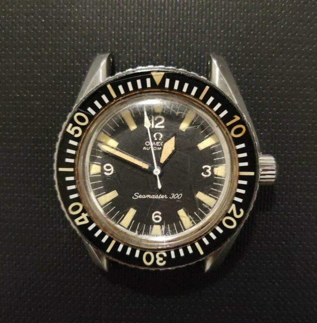

Is this 165.024 SM300 dial variant legit?
975
1,517
I was watching an Ebay auction tick down last night on an SM300 that--to my eye--looked correct overall. But I started to wonder about the dial, which has slightly "pinched" closed loop on the 6 and 9. I did a bunch of googling and forum perusing and found this type of 6 and 9 on just one or two examples of the many, many images out there of this reference. By far the vast majority had 6's and 9's with much more "open" loops on the 6 and 9. So is this a less common variant? Or some kind of service dial? Or...?
Here's the Ebay one:
https://www.ebay.com/itm/Working-Vi...83.l10137.c10&nordt=true&rt=nc&orig_cvip=true

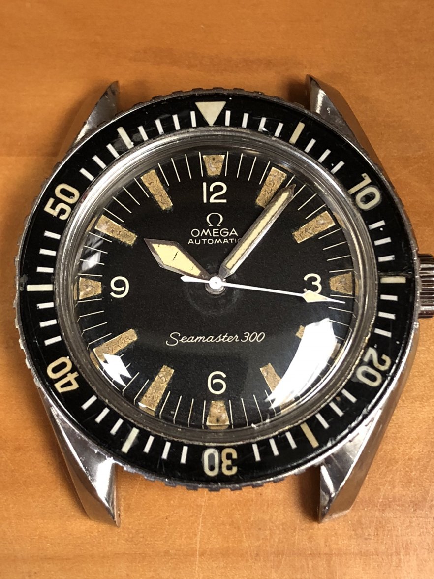

Here is the much more common "open loop" 6 and 9 dial:

Yeah pic isn't great and there were no pics outside the crystal, either. It's more a question of whether the "pinched" loop on the 6 and 9 is a typical style for these, as they seem to much less common, at least on casual survey...

No opinions on the pinched 6 and 9, though? Genuinely curious about this...

6 & 9 also look more rounded than other examples.

The "pinched" should be confirmed - a picture with a clean crystal, or a polarised lens, or better of the bare dial could show that is OK. With these images, the feeling is that is normal and not fake.

Was told that the closed 6 and 9 where Vietnamese dial fakes ? Wrong ?
975
1,517
They are not closed. They are open. But the shape of the loop is different...

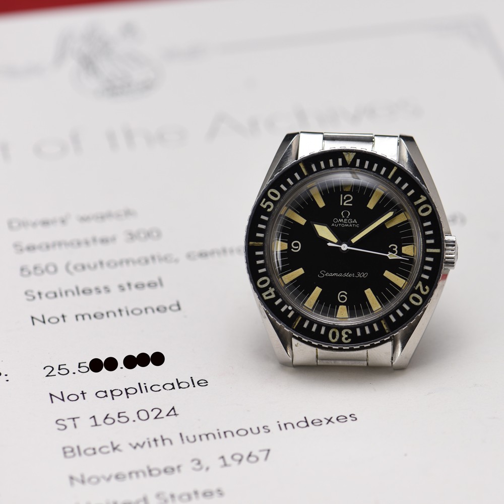

It's a legit dial - slightly bolder font with hooked serif on the 3, also look at the E in Omega, different to any normal 165.024 dial. Not common but also not rare, looks like it's in nice shape under that crystal.
2,318
5,713
Watch is legit, 550 is legit, "Pinched" 6 & 9 is legit, all is legit.
It's from the same batch as this one:

Is it signed T swiss made T? IMO the dial is OK.
