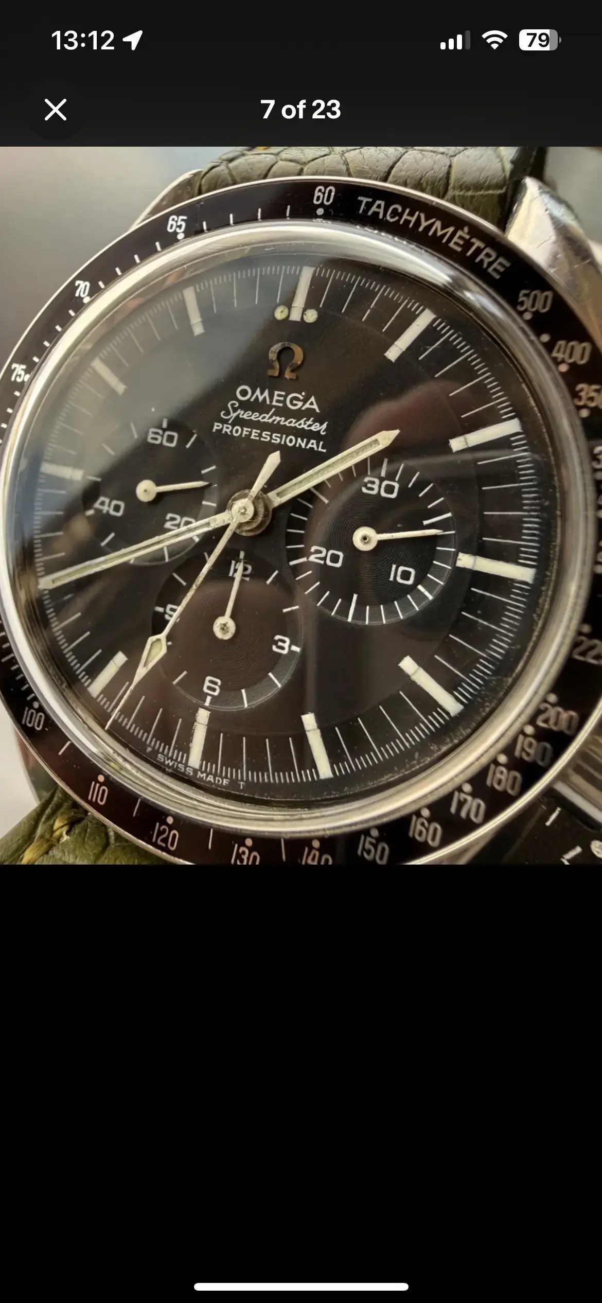

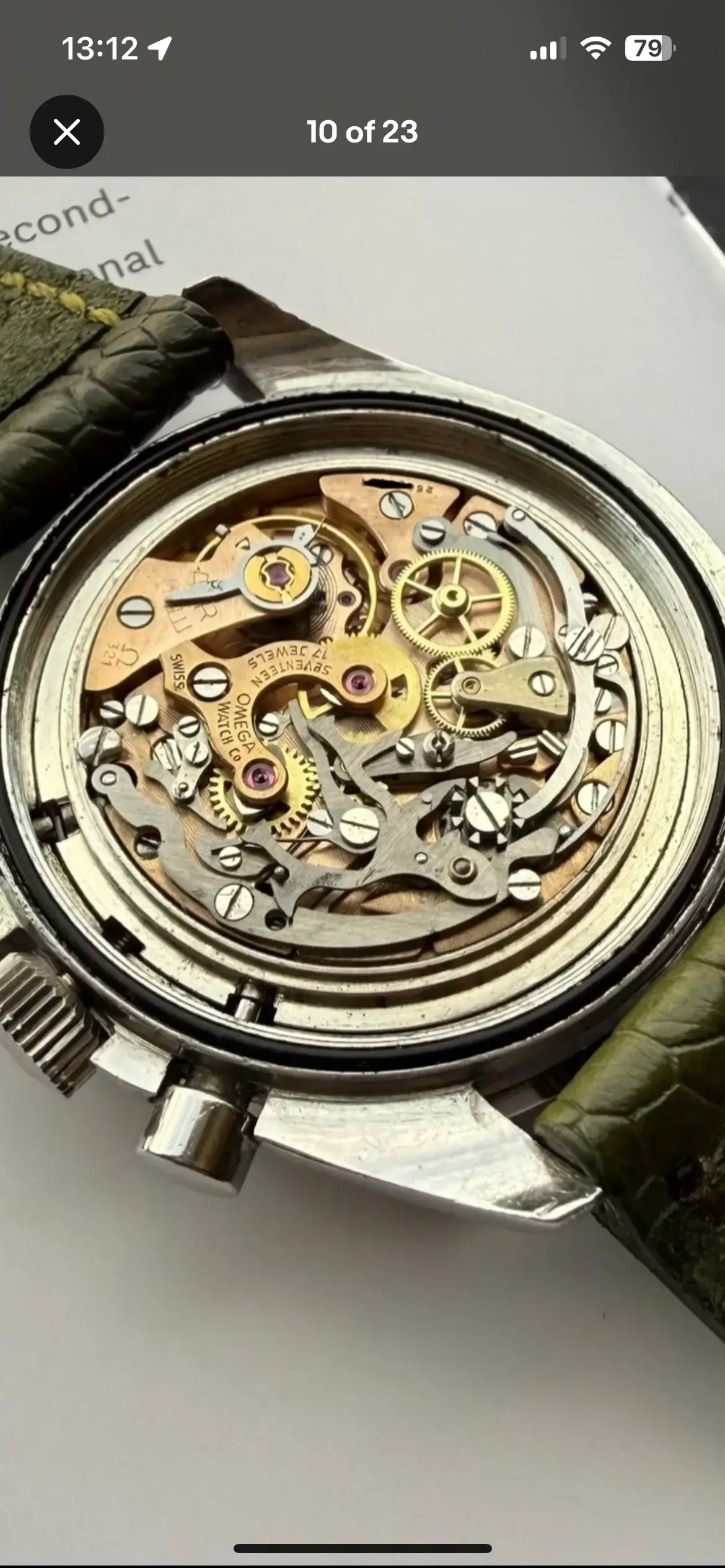

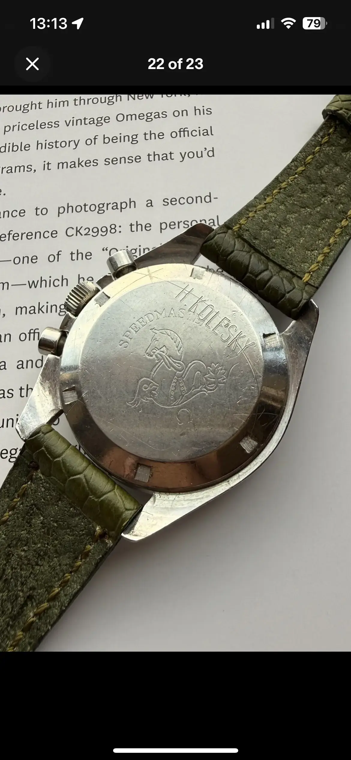

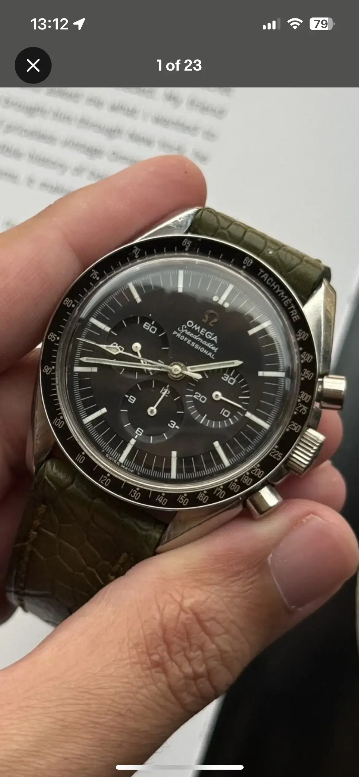

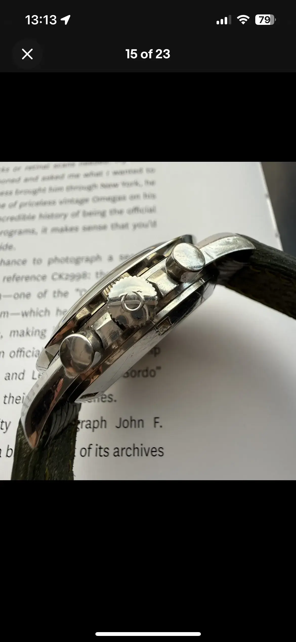

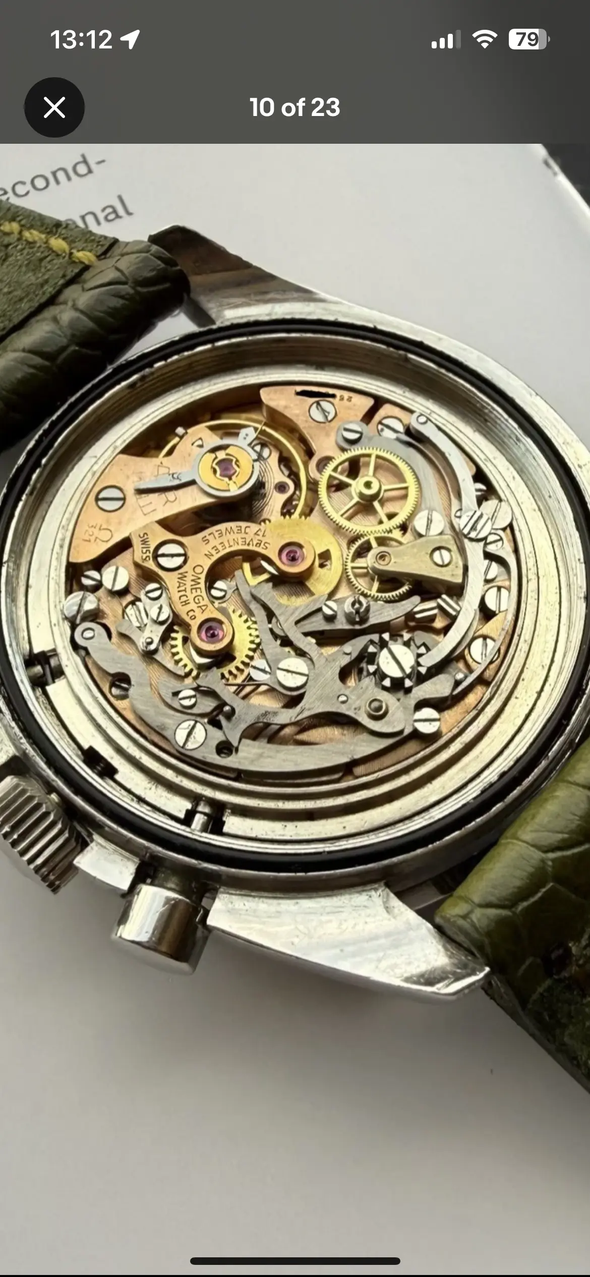

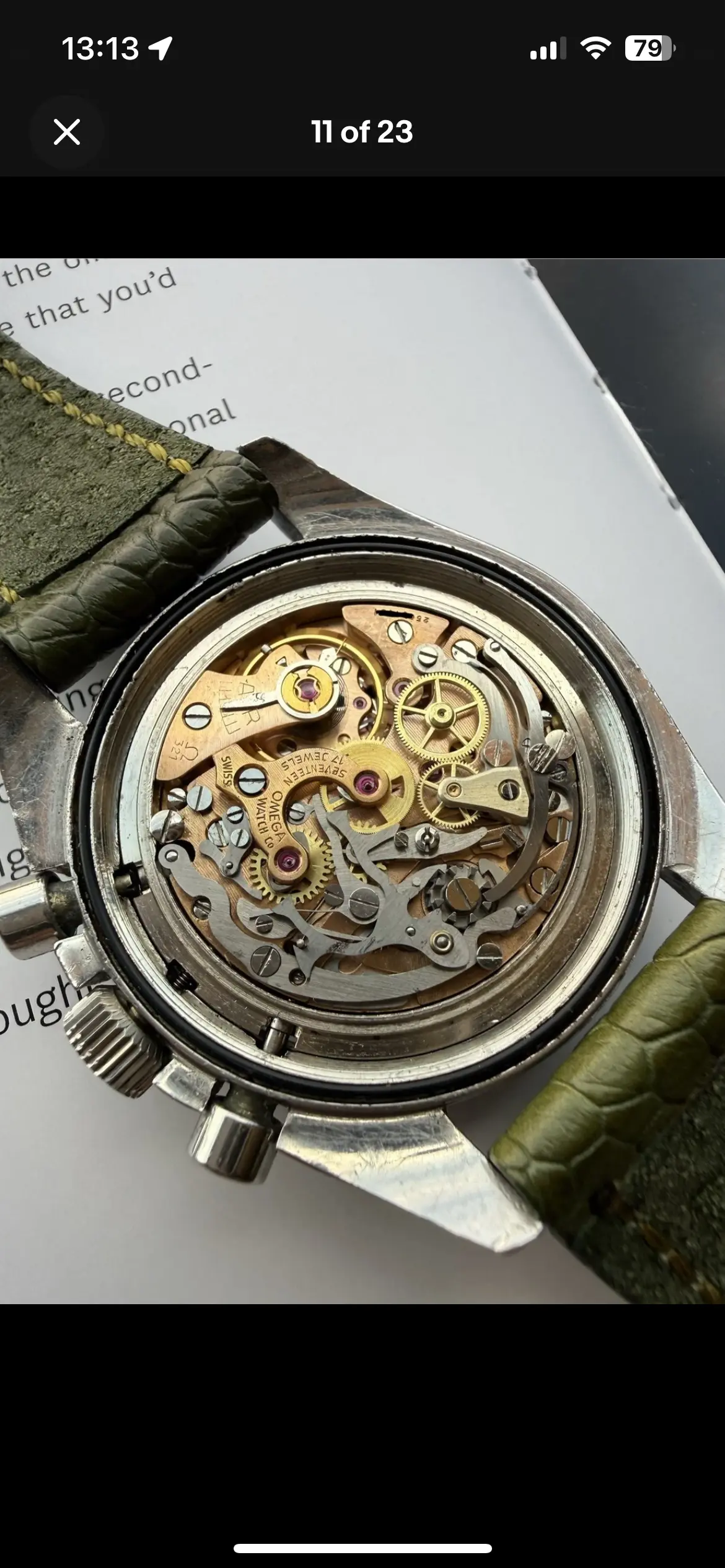

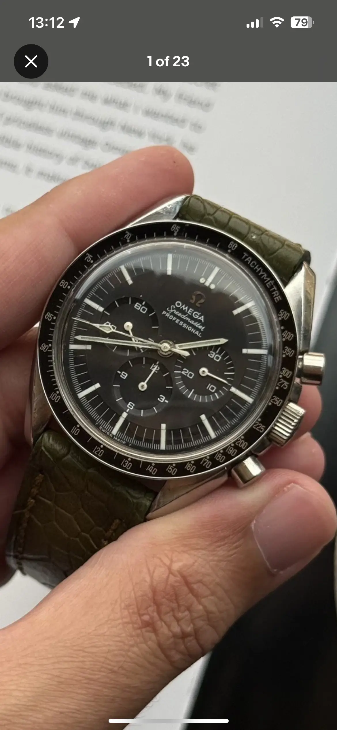

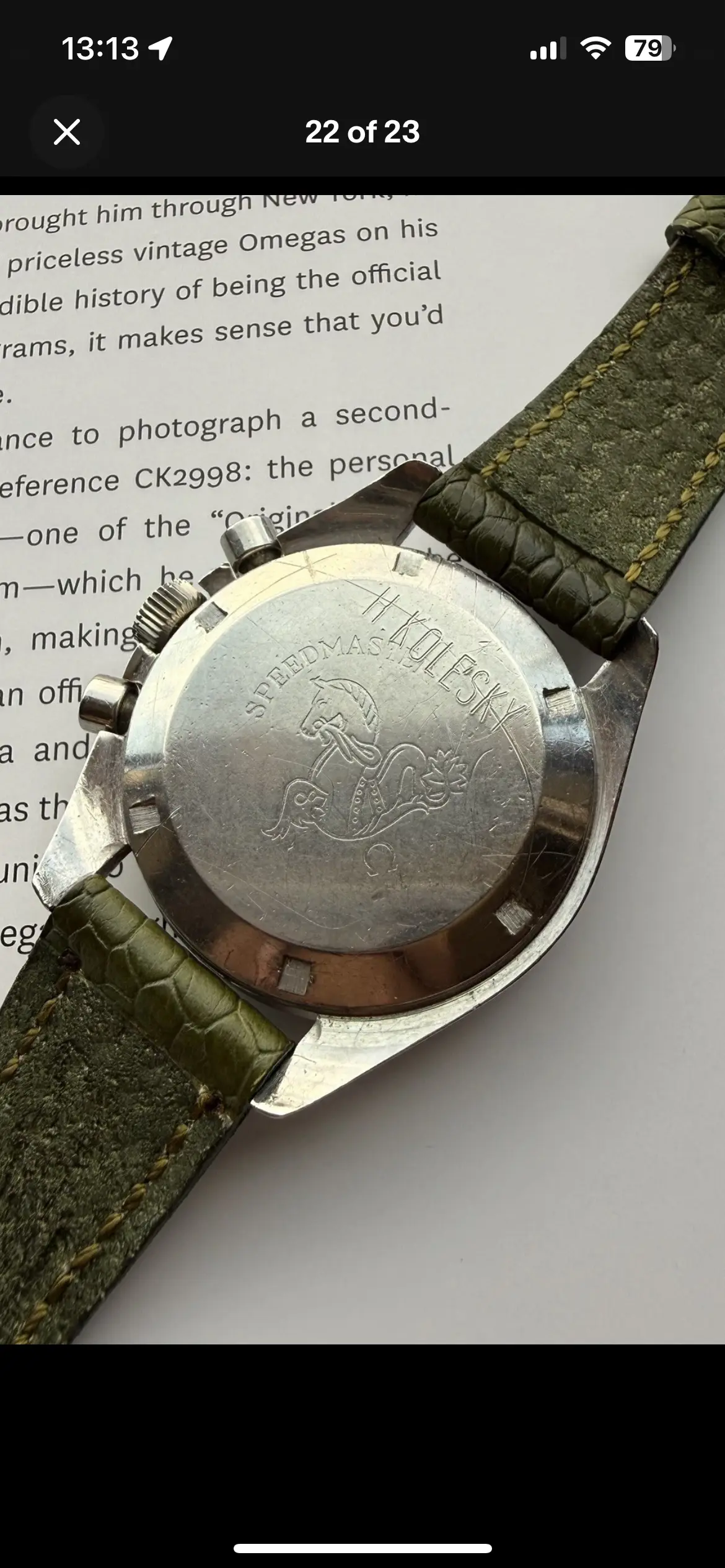

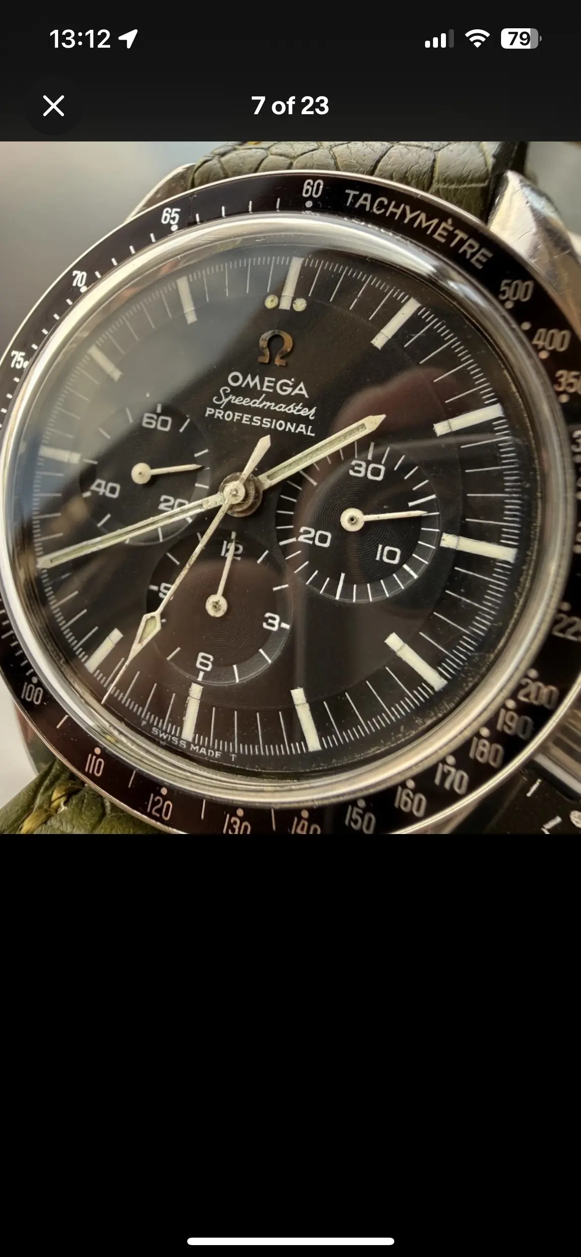

Hi all, I have been offered a 145.012-67 Speedmaster for £3800. It has aftermarket bezel, re-lumed hands, no original bracelet and no box or papers, plus there is a previous owner’s name engraved on the caseback. I suspect the crown and pushers are service parts and I’m guessing the hesalite crystal is too. It also looks to me that the case has been polished but I’m not totally sure about that. I think the dial is original and not relumed, but not sure about that either. The watch is apparently running with no issues.
I’m not a total purist, and I would personally rock this watch on a bulang & sons leather nato and enjoy it for what it is. But I don’t want to pay an amount of money that would mean if I need to sell it, nobody wants it or I can’t get a similar amount back for it. I would be interested to know if this is worth the money or if I should pass or offer less.

You're right to question this and your instincts are good. This isn't a watch for a collector, IMHO, which means a smaller pool of people who might want it.
You could get it relumed with a better color and that would make a nicer looking daily. Dial looks unscratched at a casual glance. Add an inexpensive Uncle Seiko bracelet and it could be a decent beater. If it needs a service then that'll be another chunk of change.
Hope this helps. Not a right answer, as everyone is different. If your finances are tight and you want a cheap 321, then maybe it's not the best way to spend your money. A nicer 861 145.022 would be a better buy and nicer to look at.

Thank you for the detailed take - that does make sense. My intention is a mix of watch I can enjoy + liquid asset that can easily be turned back into cash. Based on what you say, this watch is no good for the latter..

I think the movement is nice and the dial seems good. If the case is not polished it would have some things going for it. But it obviously has a lot of flaws too. I would have said around £3600-3800, but I’m not confident at all

The dial has been stripped of all its lume so it lacks the character of a vintage dial.
You could get a replacement bezel, relume the dial, relume the hands and get it serviced but you’re well over £1000 with that (£2000+ with a dot over ninety bezel), then you’re at £6k for a watch that has had a lot of work. Bear in mind the price for a good 145.012-67 is around £5-7k so no one’s going to pay that for a watch that is relumed etc.
These watches are good at a certain price point. For me that price point is somewhere where they can be bought and enjoyed as-is cheaply or restored to a degree that makes financial sense.
This is a very similar watch I sold a few months ago. It had replacement (but genuine bezel and hands) and like yours, no lume on the dial. However, I’d say the one I sold was more attractive and had been serviced in the last few years by one of the best watchmakers in the UK. I sold it for almost £1000 less.

I don't see any lume on the dial, case brushing is gone. A real hack has been working on the movement. Something weird is going on around the outside of the dial, maybe it's just a gap left because of the aftermarket crystal retaining ring, I don't know.
It's really an unappealing watch, and it would not be easy to find a buyer unless you offered it dirt cheap. I can't imagine paying real money for it.
