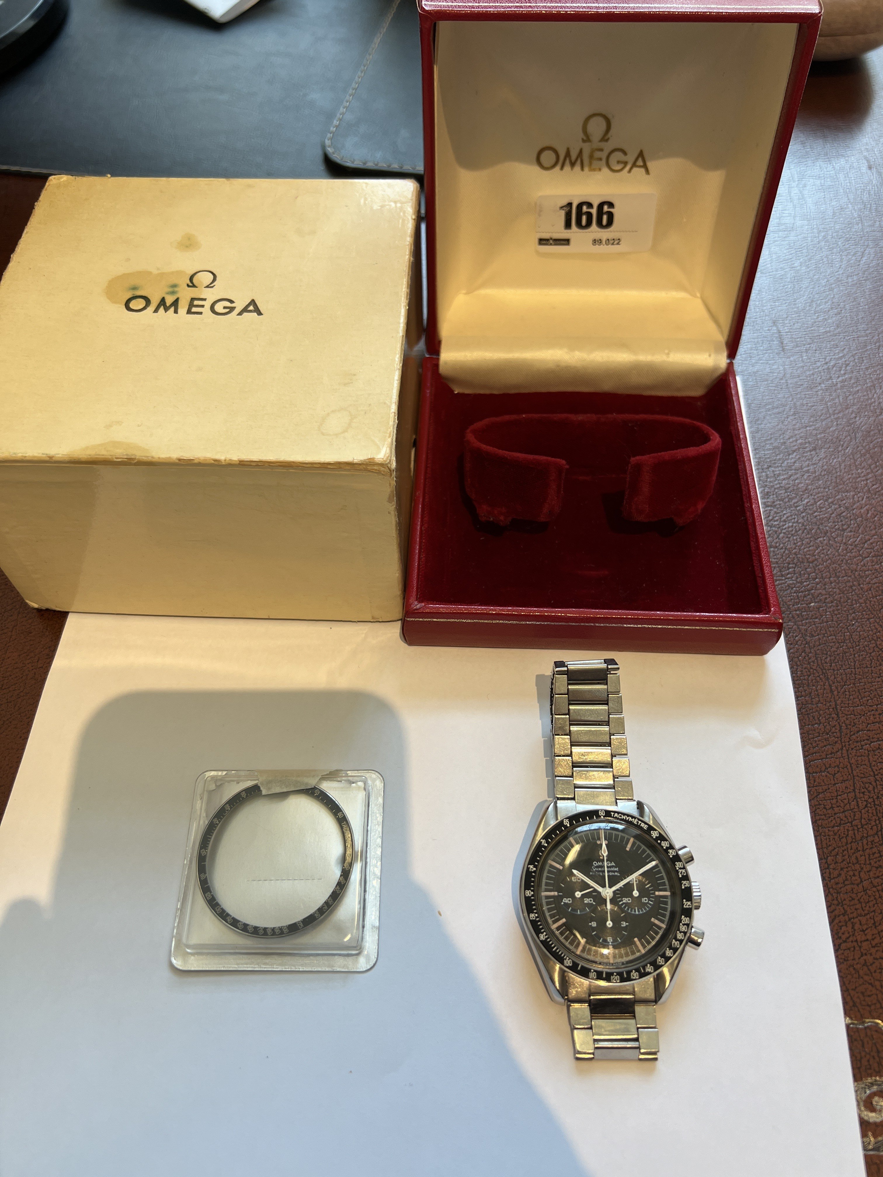

I followed an auction this week, and it was a Speedmaster (again…) that was the target.
This time a 145.012-??, no ref, so a 67 or 68 with a 321 movement.
Serial nr 26074836, maybe too early for a 68?
The watch had an extract (A Swedish watch!!), an Omega box and an extra DNN bezel.
Maybe a collector or a dealer watch??
I got a bunch of pictures from the auction house, and started looking at them.
There were a few details, the condition of the watch,
and also the estimate that made me not want to bid on this watch.
But this time I would like to test the Forum!
Why not try and asses the watch, point out the pros and cons,
and also guess the estimate that the auction house had?

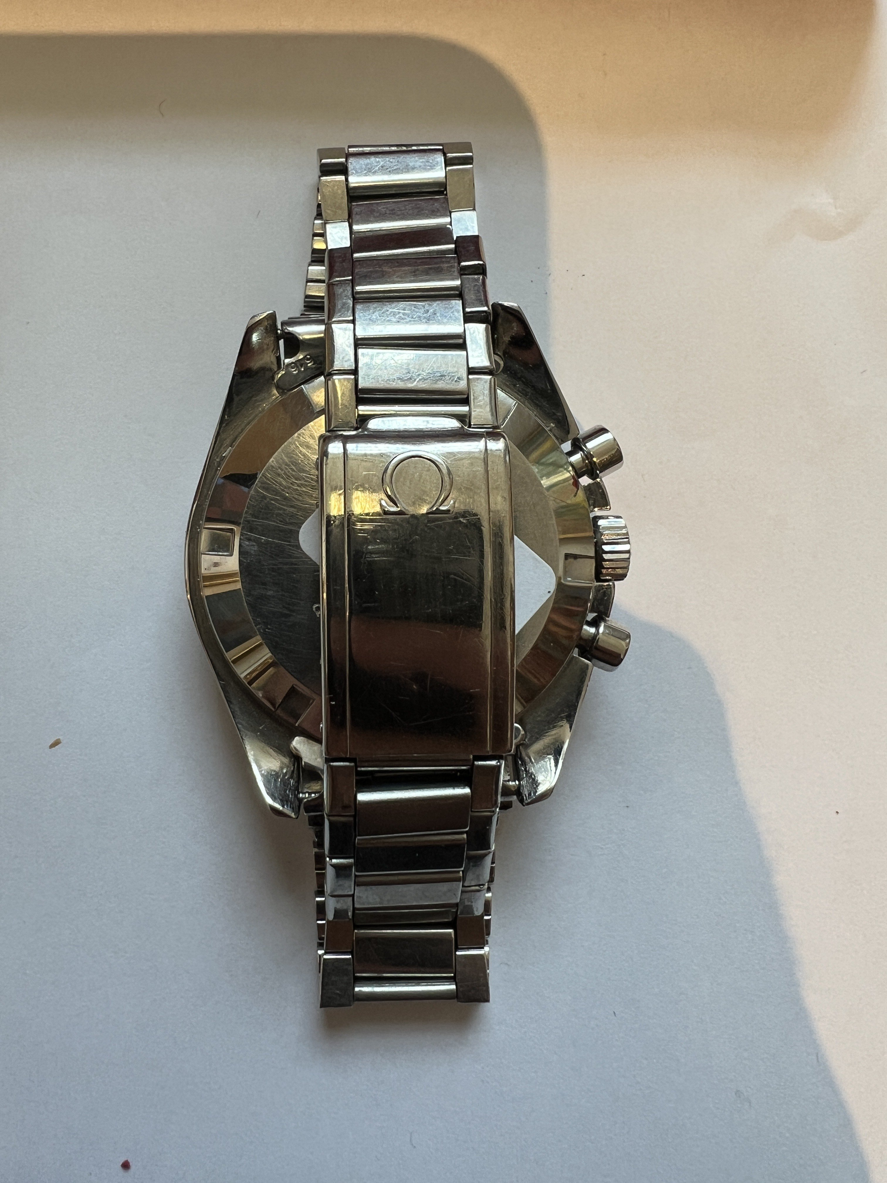

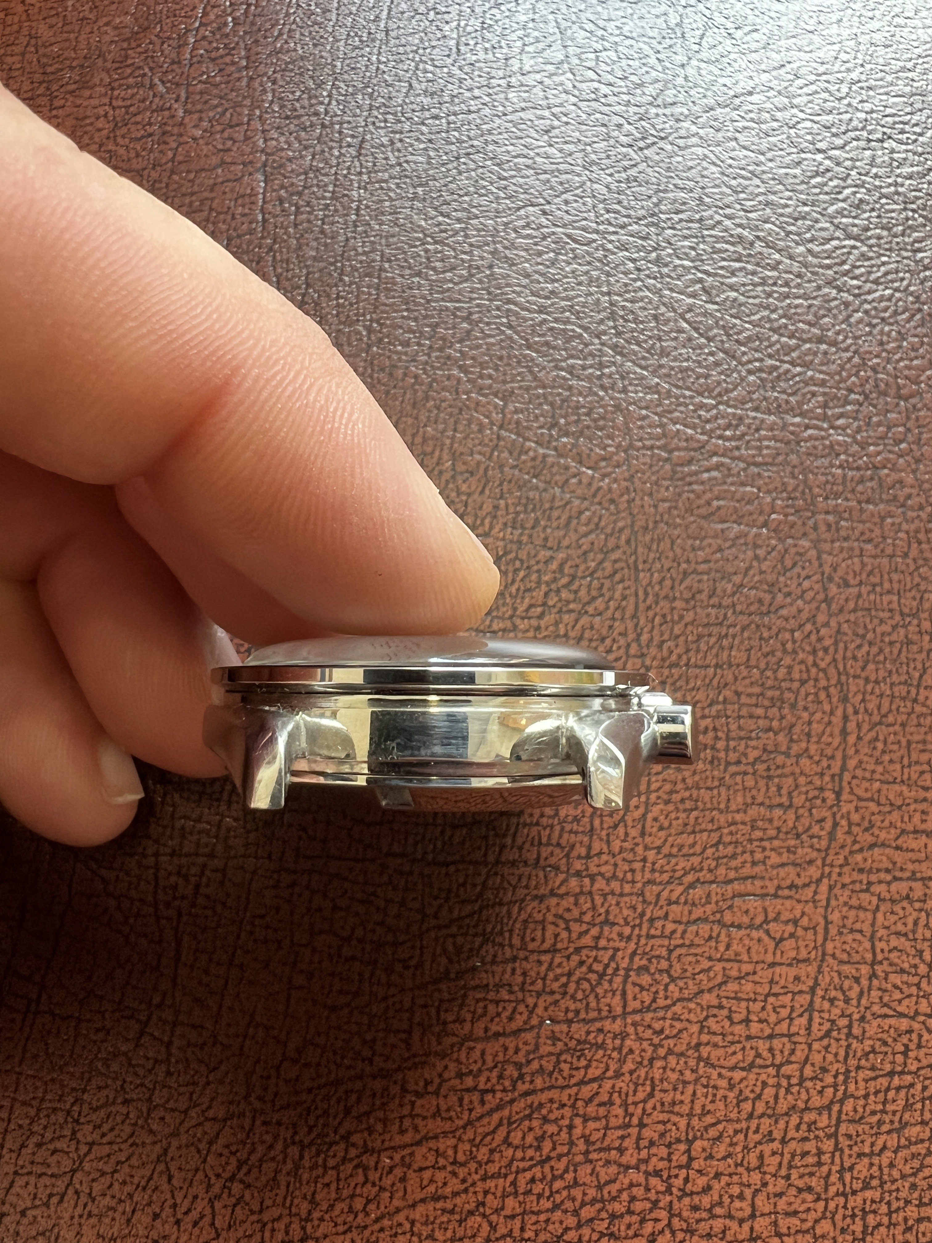

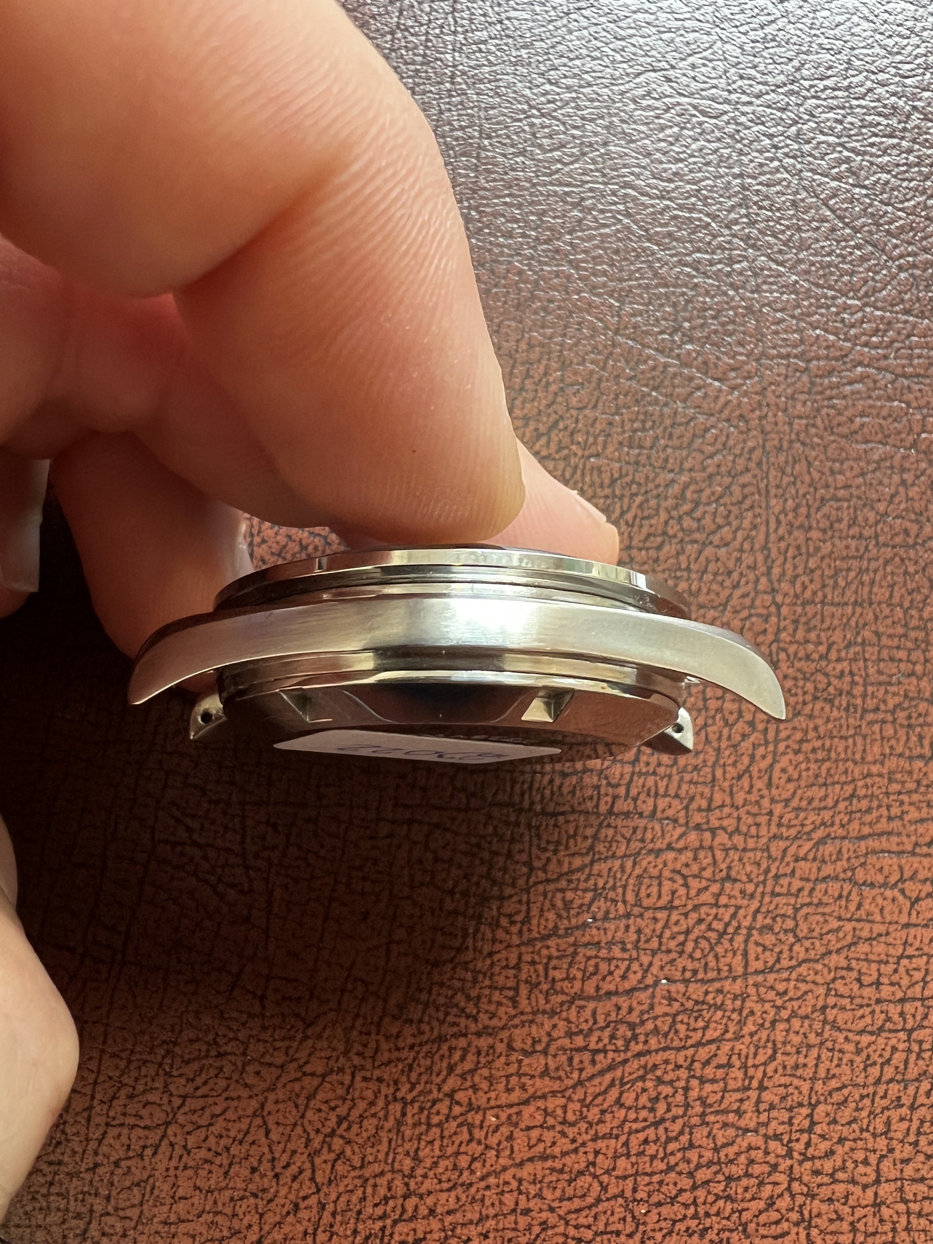

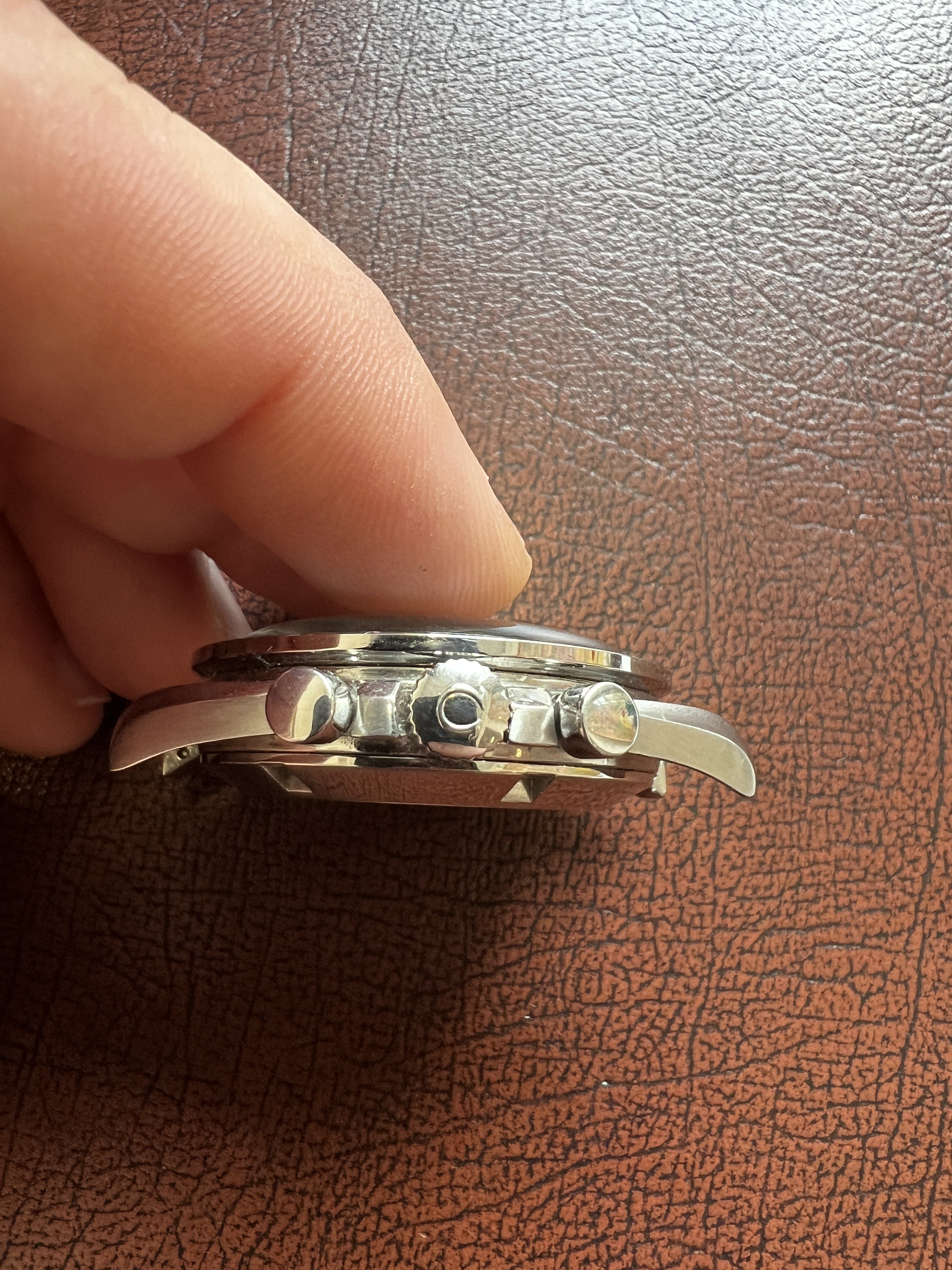

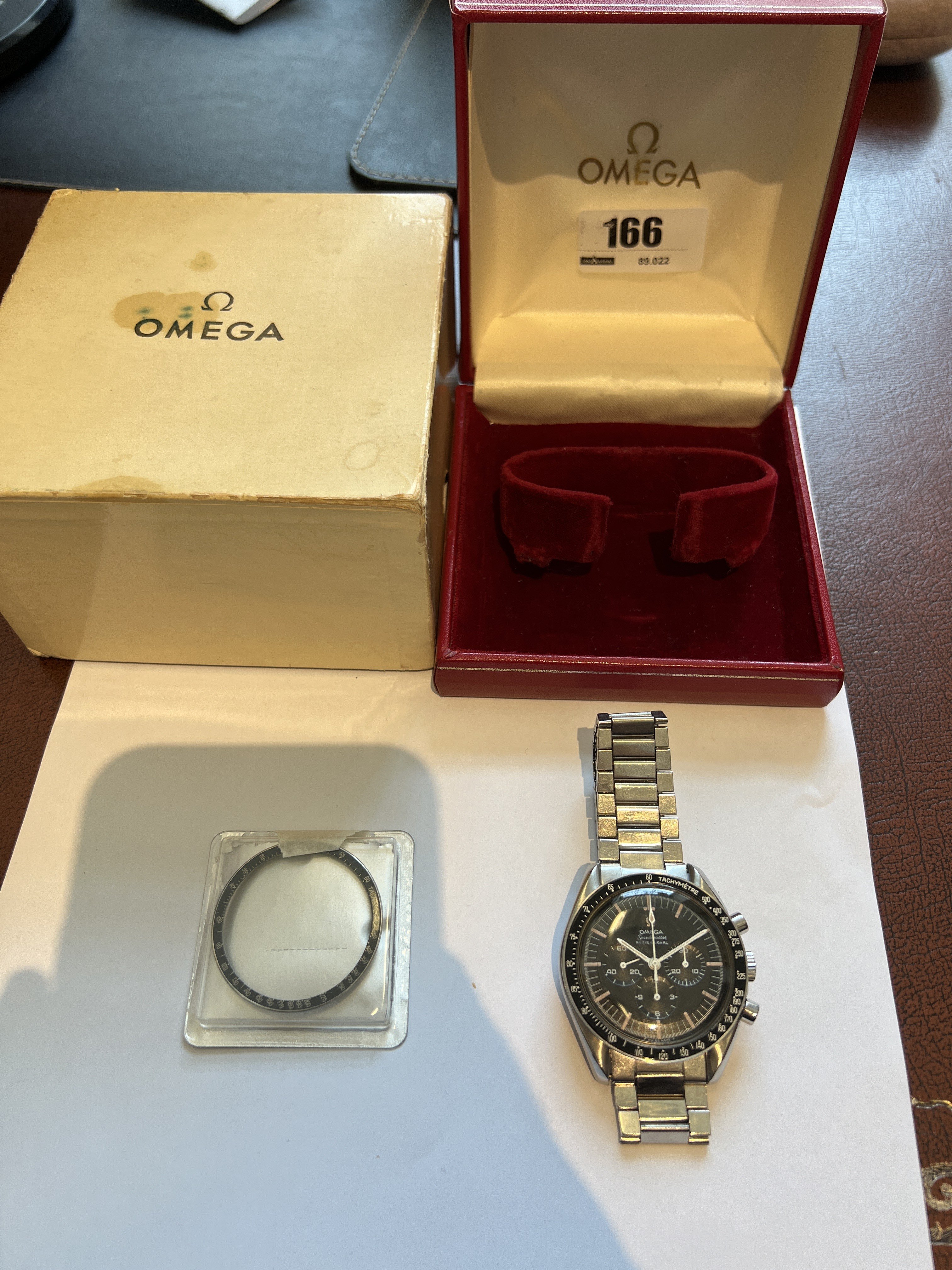

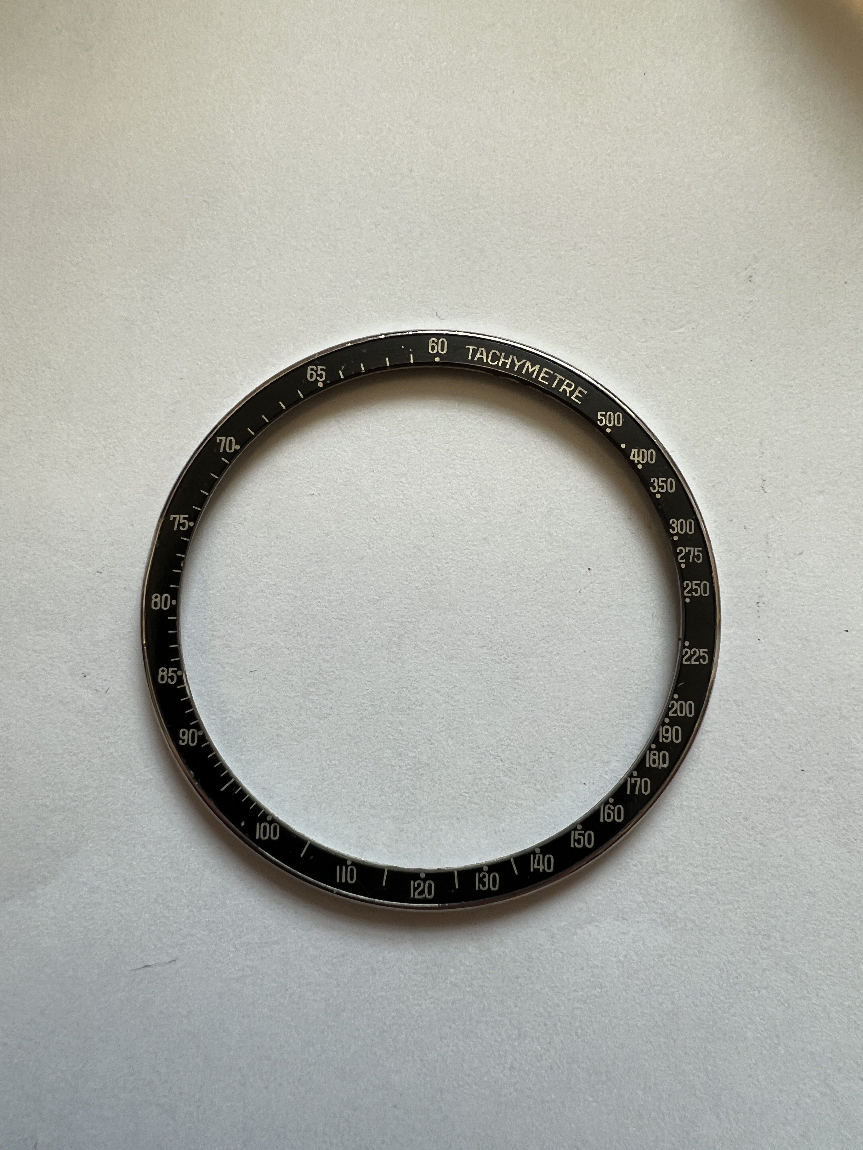

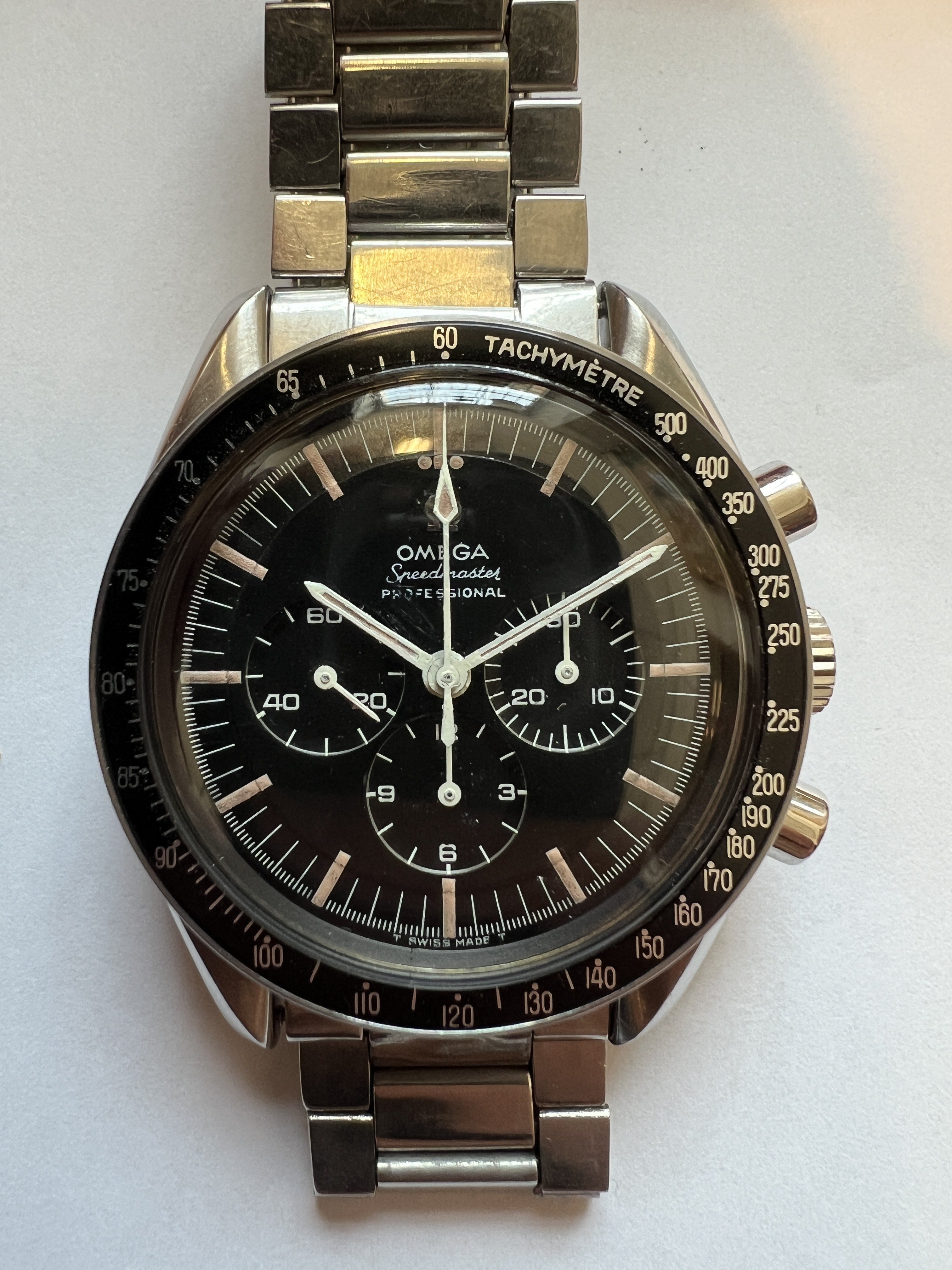

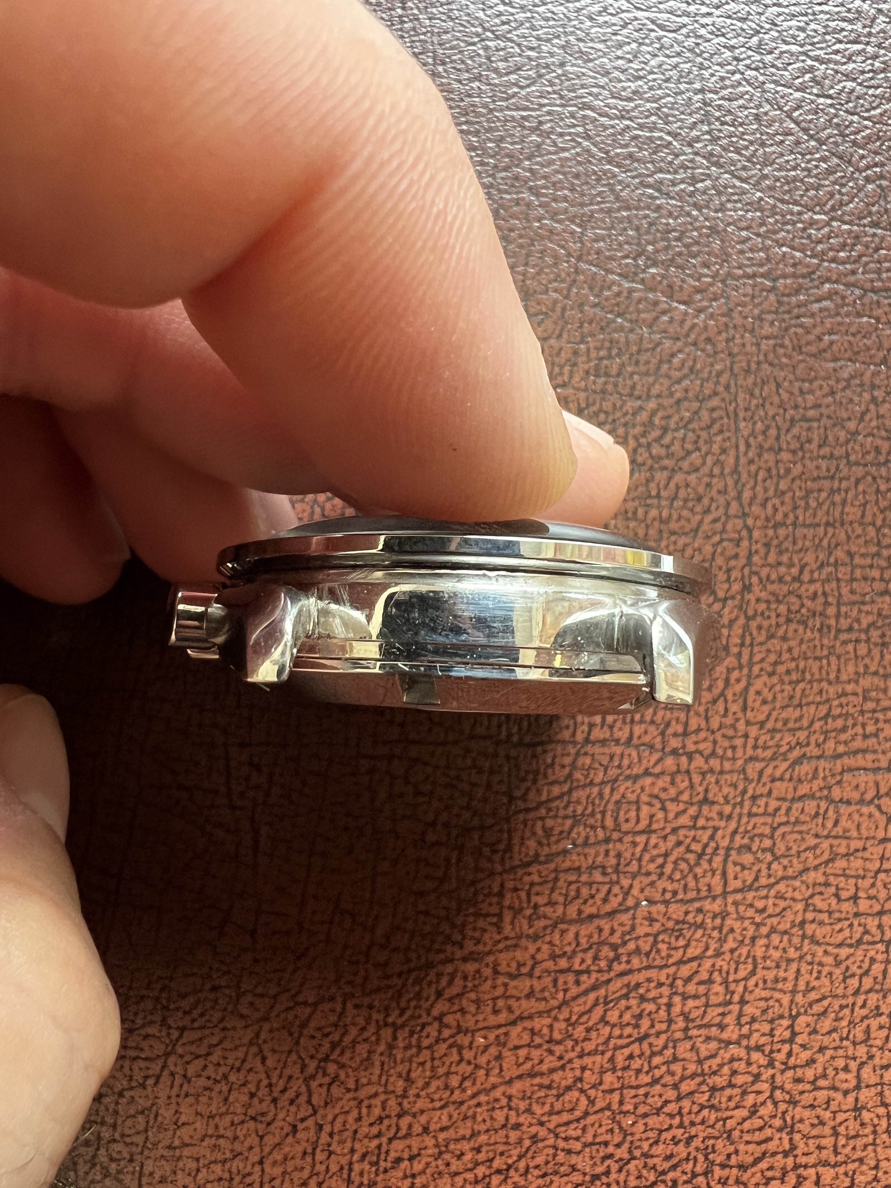

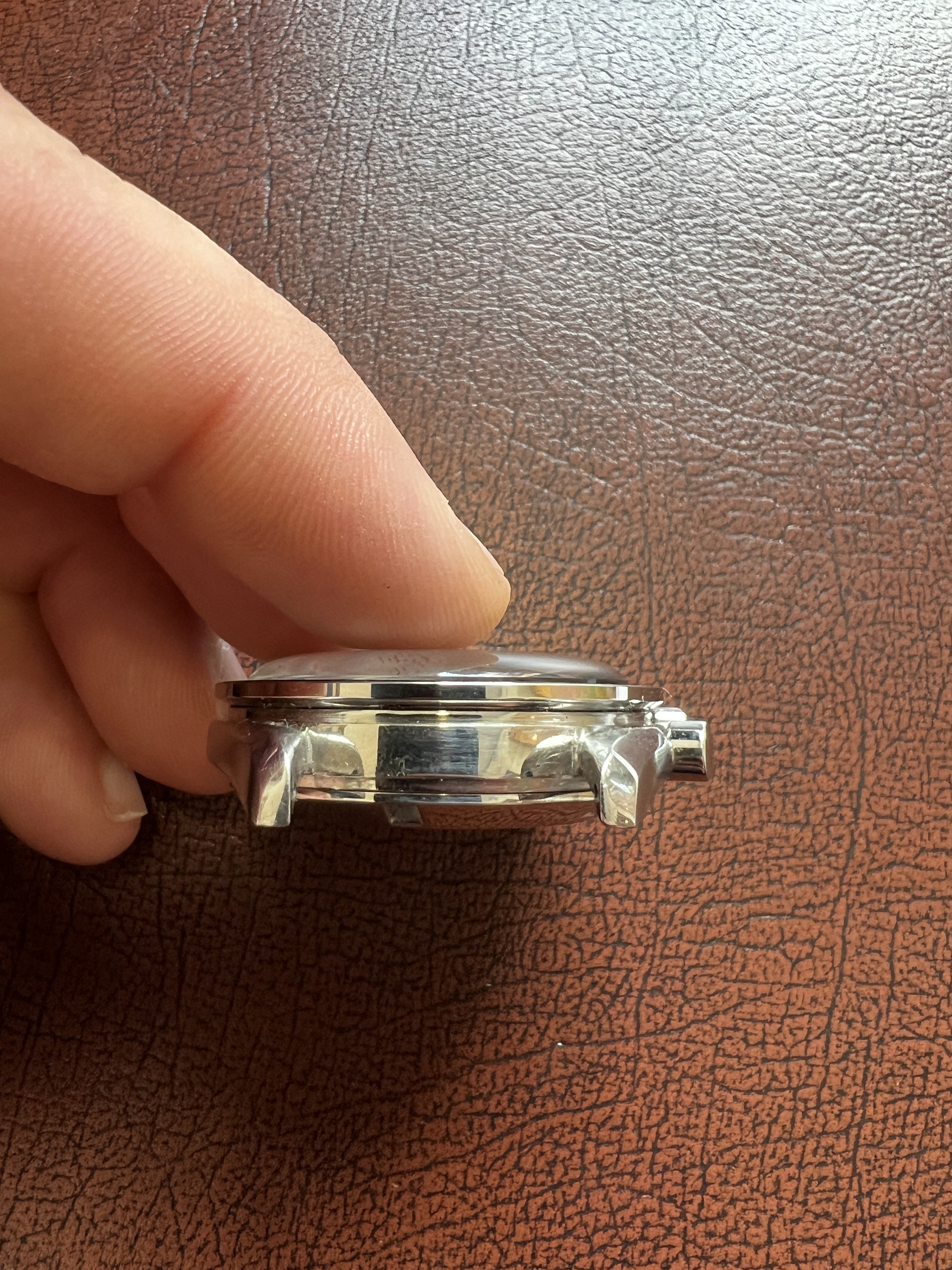

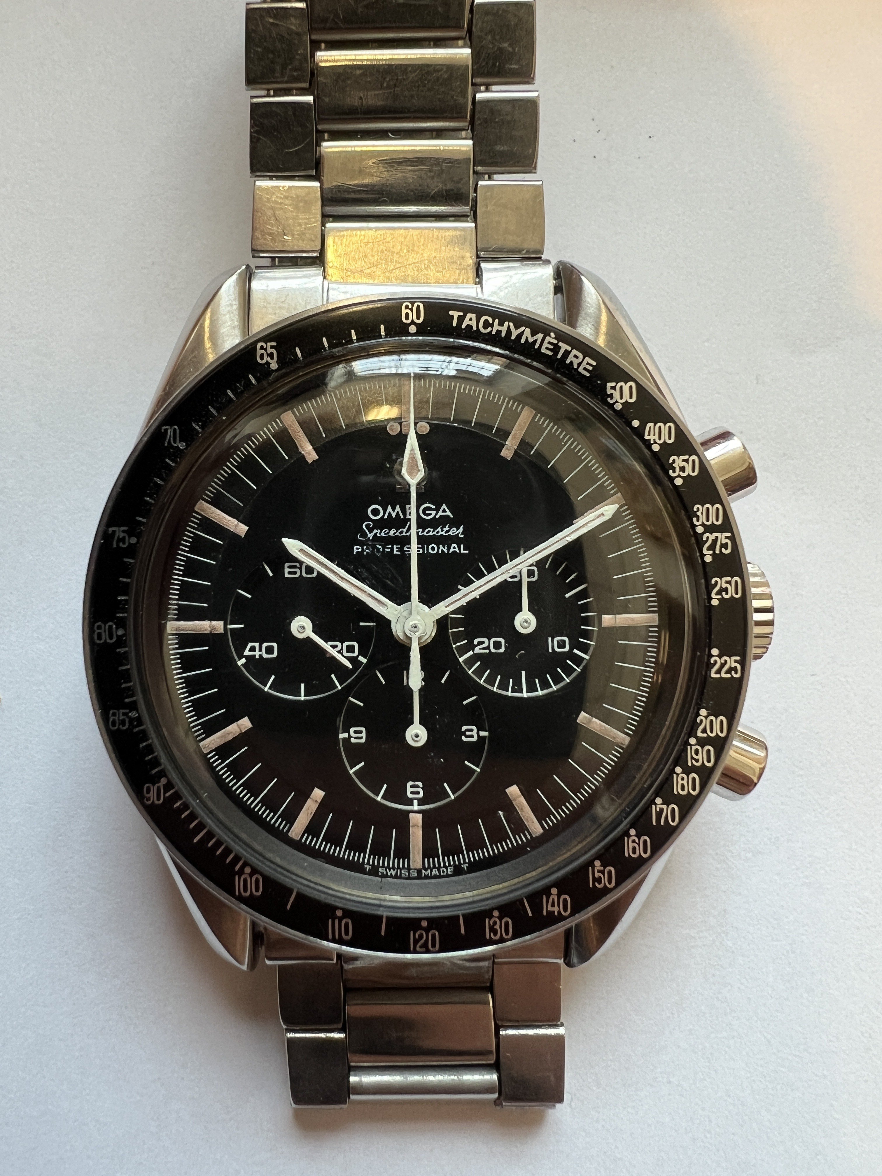

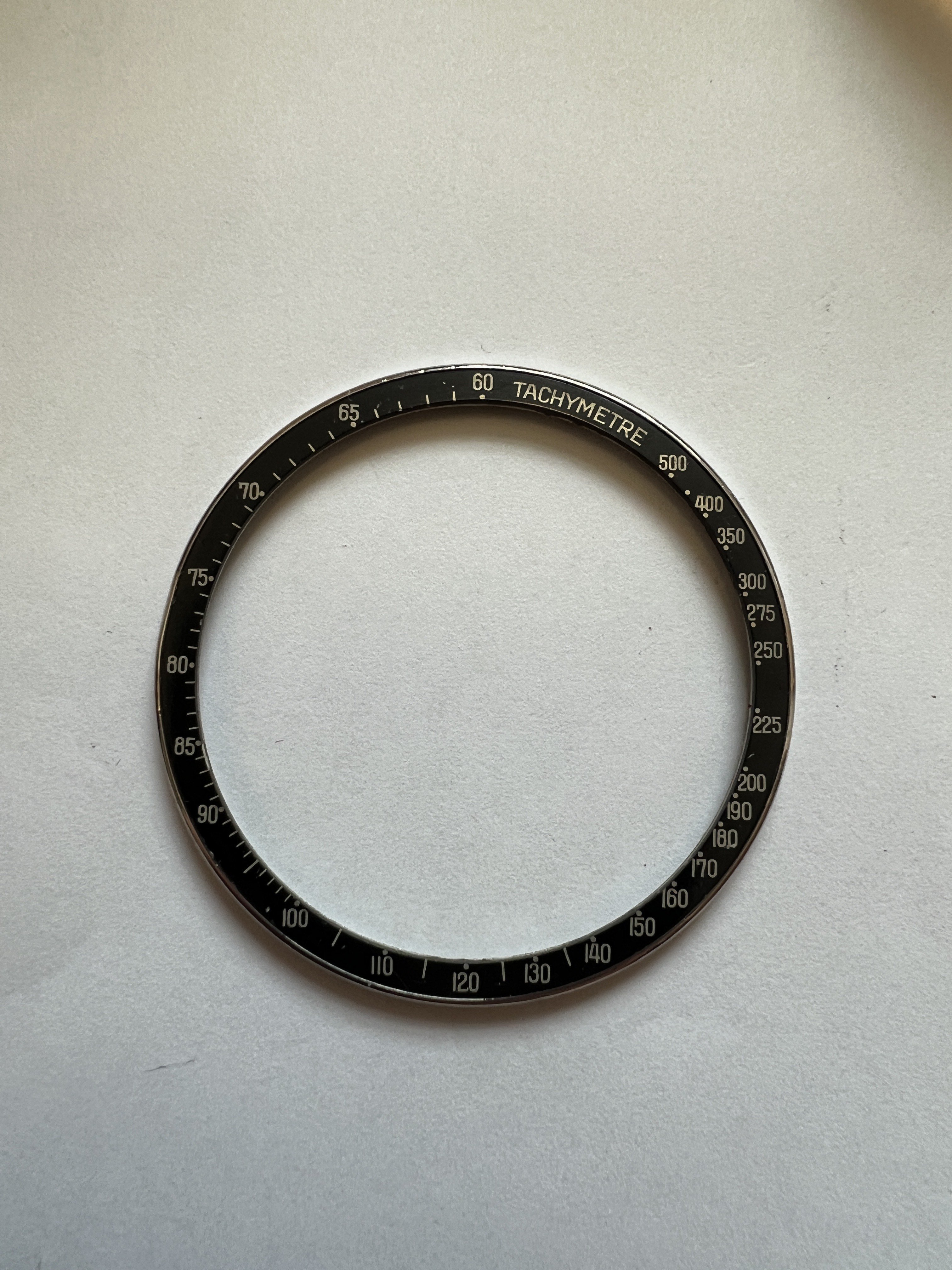

Those pictures aren't that great... but I wonder if the DO90 bezel is not a reproduction? The font seems a little off, look at the serif on the "3" in "130" and how fat the letters are in "TACHYMETRE". It's in near perfect shape, why would there be a replacement DNN bezel included?

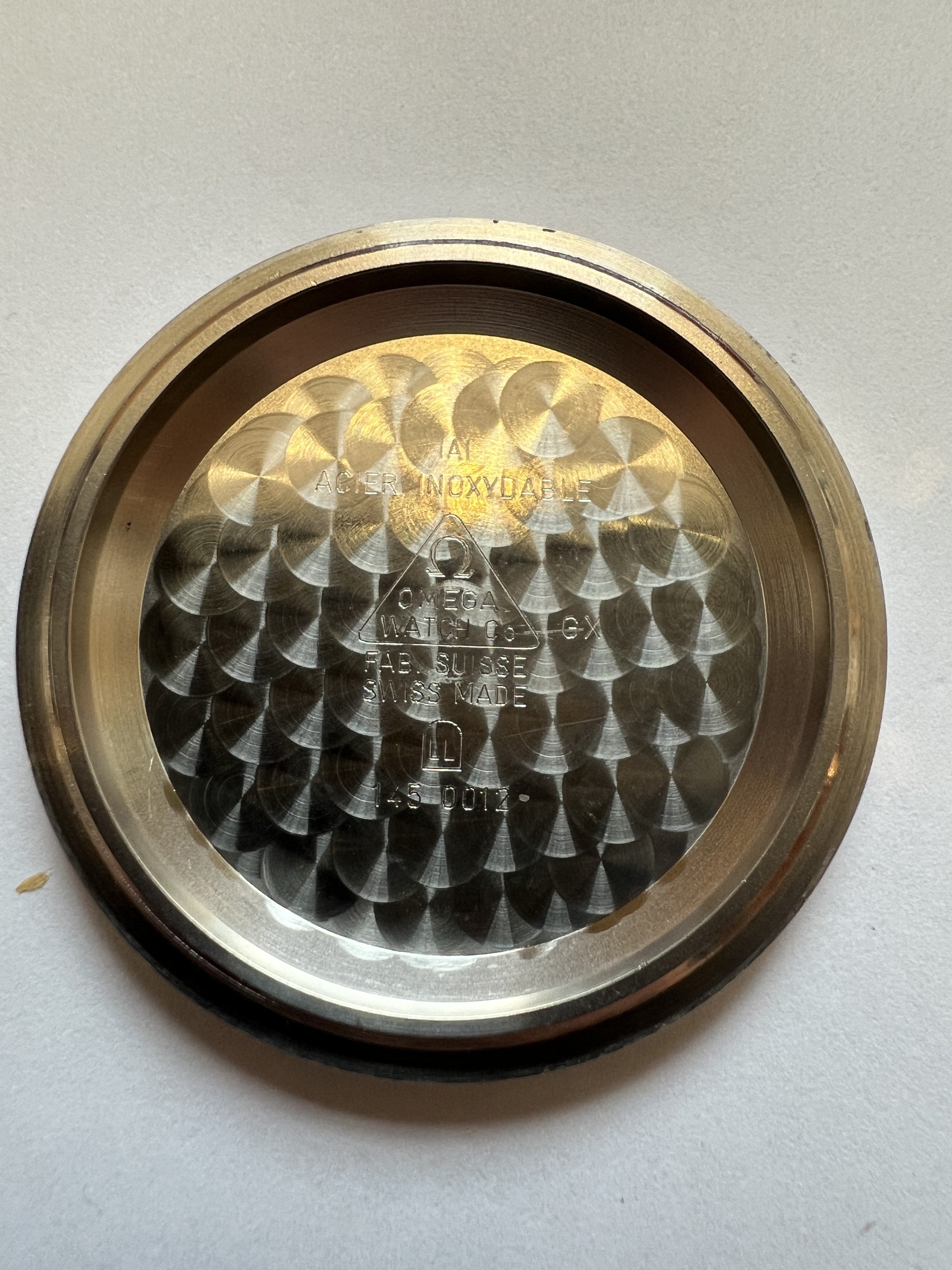

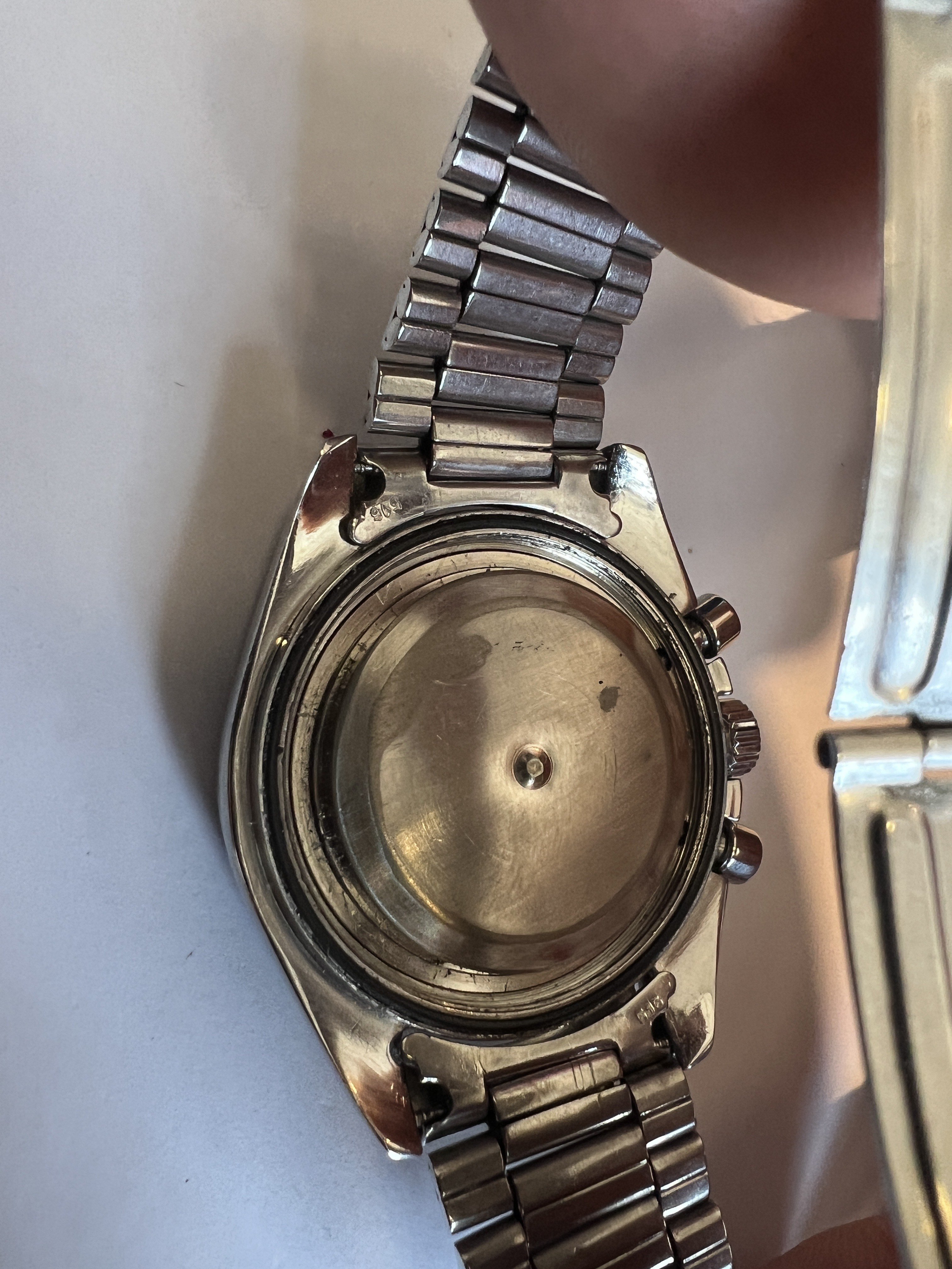

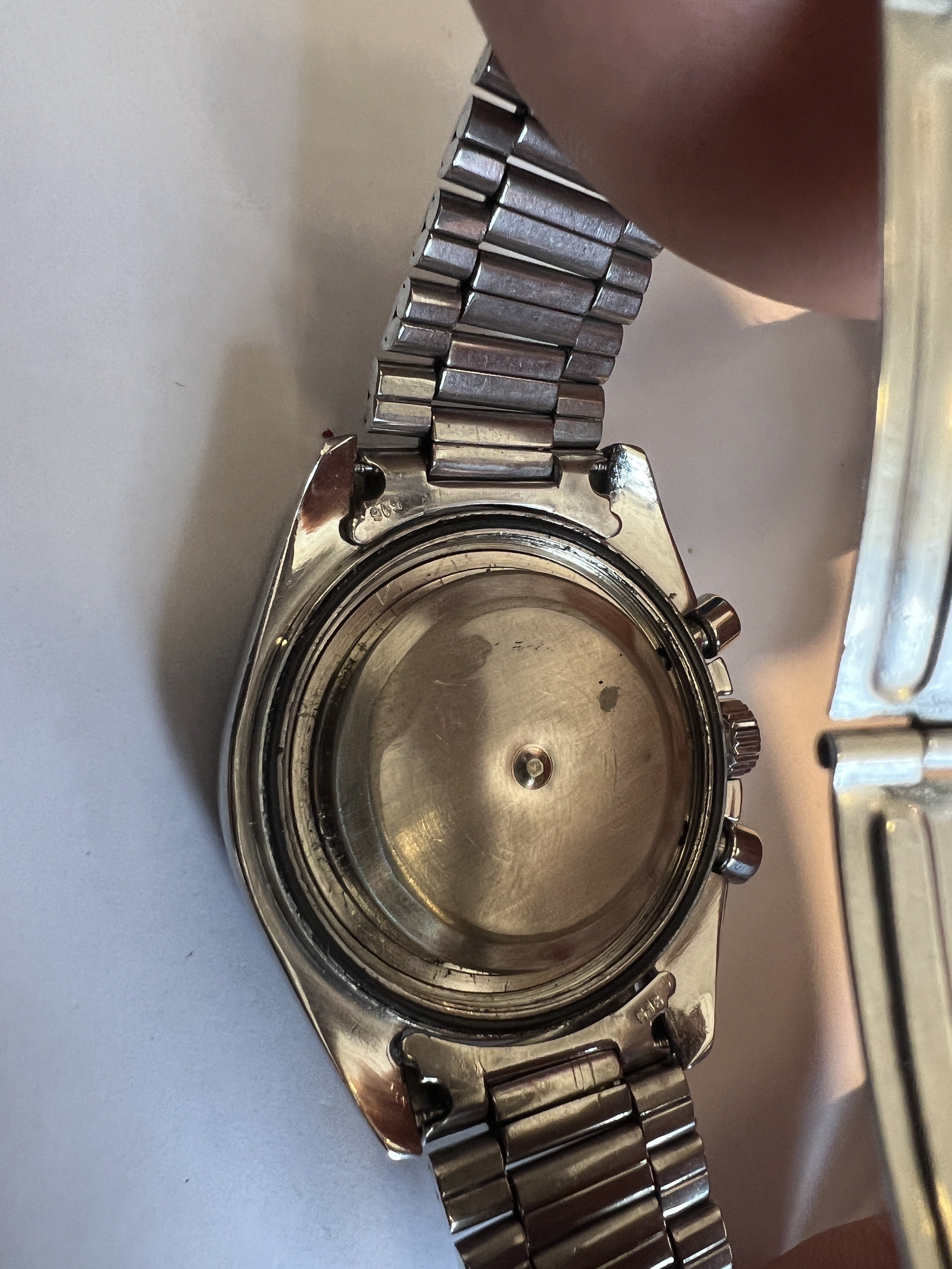

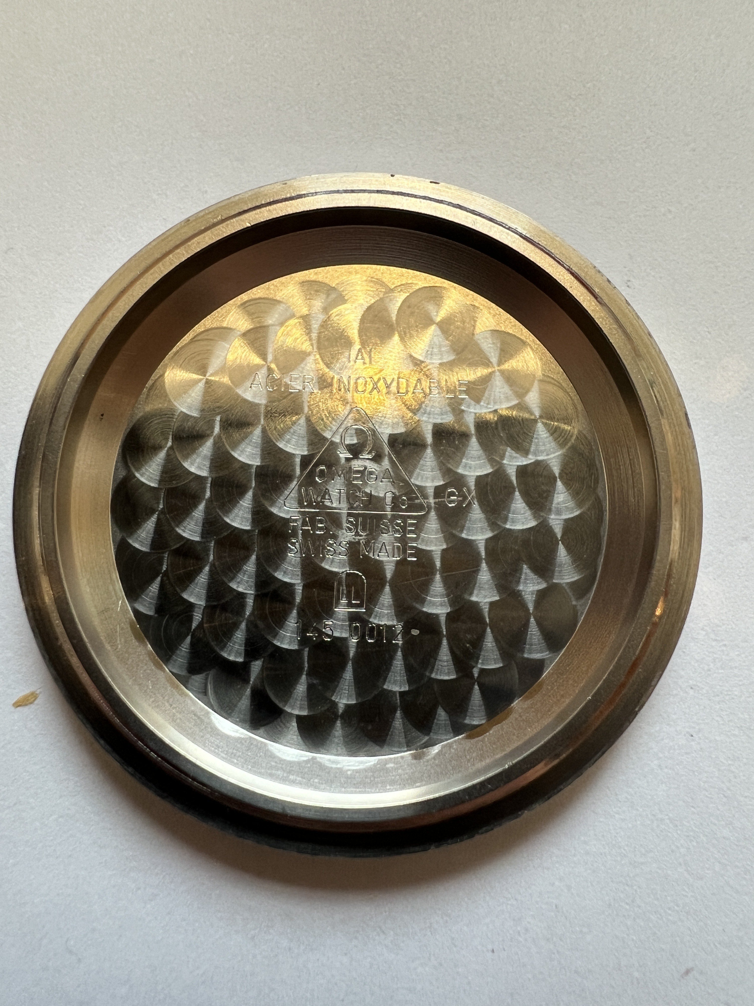

Also, the caseback could be a service replacement along with the pushers and crown. I thought that the original caseback should have a year indicated? But maybe I am wrong there.
Also wondering what the marks are on the crystal or dial across the "PRO" in "PROFESSIONAL," if that's not on the crystal, that's major dial damage.

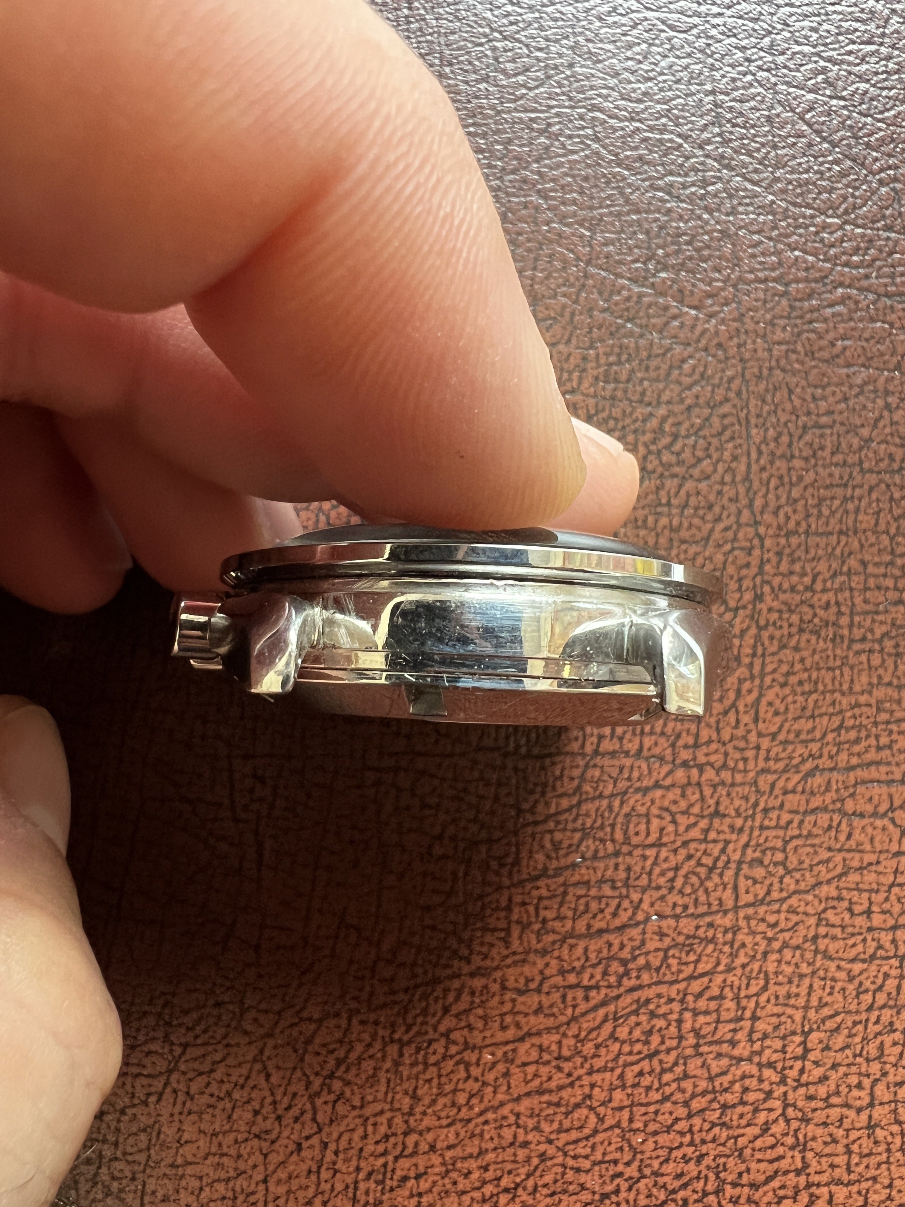

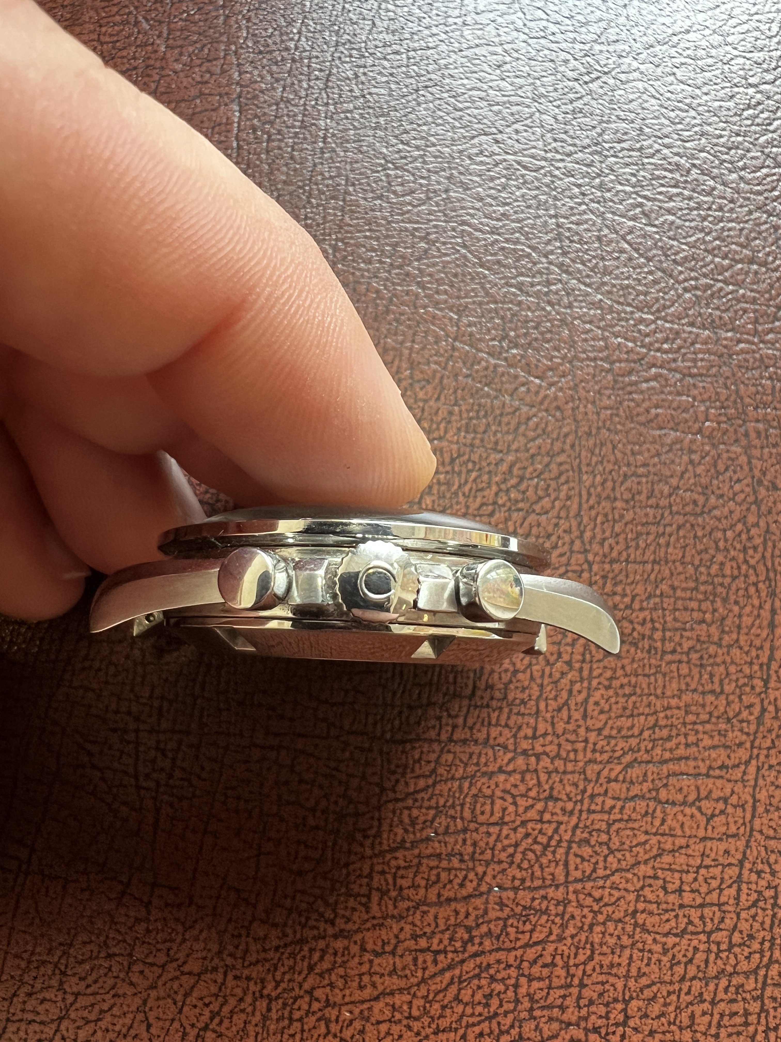

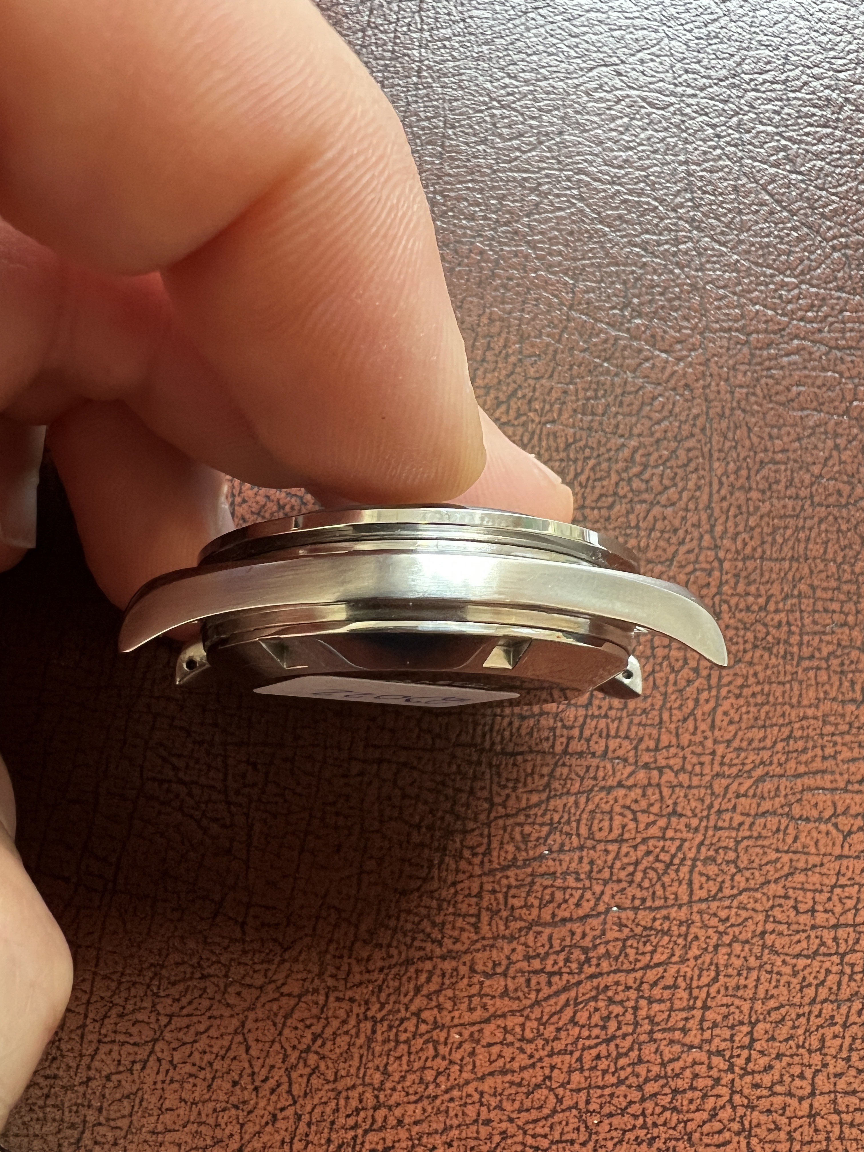

The case also seems polished and I wonder if the white parts of the hands have been repainted.... maybe this is all because of the poor quality photos, but seems very much like a dealer prepped watched.

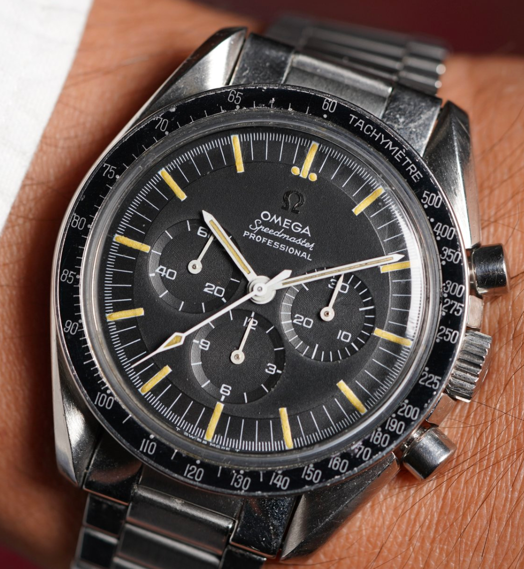

A really nice 145.012 from 1968 just popped up on Wind Vintage (with a similar serial number and an extract), a nice comparison and to me a vastly more desirable 321 from the same year:

The watch from Windvintage is listed at $12,000 USD which I think is fair from a dealer and a good benchmark.
Given the concerns I see from the photos, I wouldn't bid at all on that watch... but assuming that I saw it in real life and there was no dial damage and the bezel could be confirmed as authentic... I don't think I would pay more that around $8,000USD max. But even then, I probably still wouldn't be interested personally. Would rather go after a more honest 321 or a really nice 145.022-68 or -69.

The caseback on the original watch is deffo a later service replacement. Note the 4 digits after 145. They didn’t do that until the 1980s. This leads me to suspect the bezel also. This isn’t one I’d be chasing.
5,377
24,554
OP watch is poor.
Case back is a service replacement
Bezel is a repro
Case is polished
Dial is tired - might have "frost" on subdials

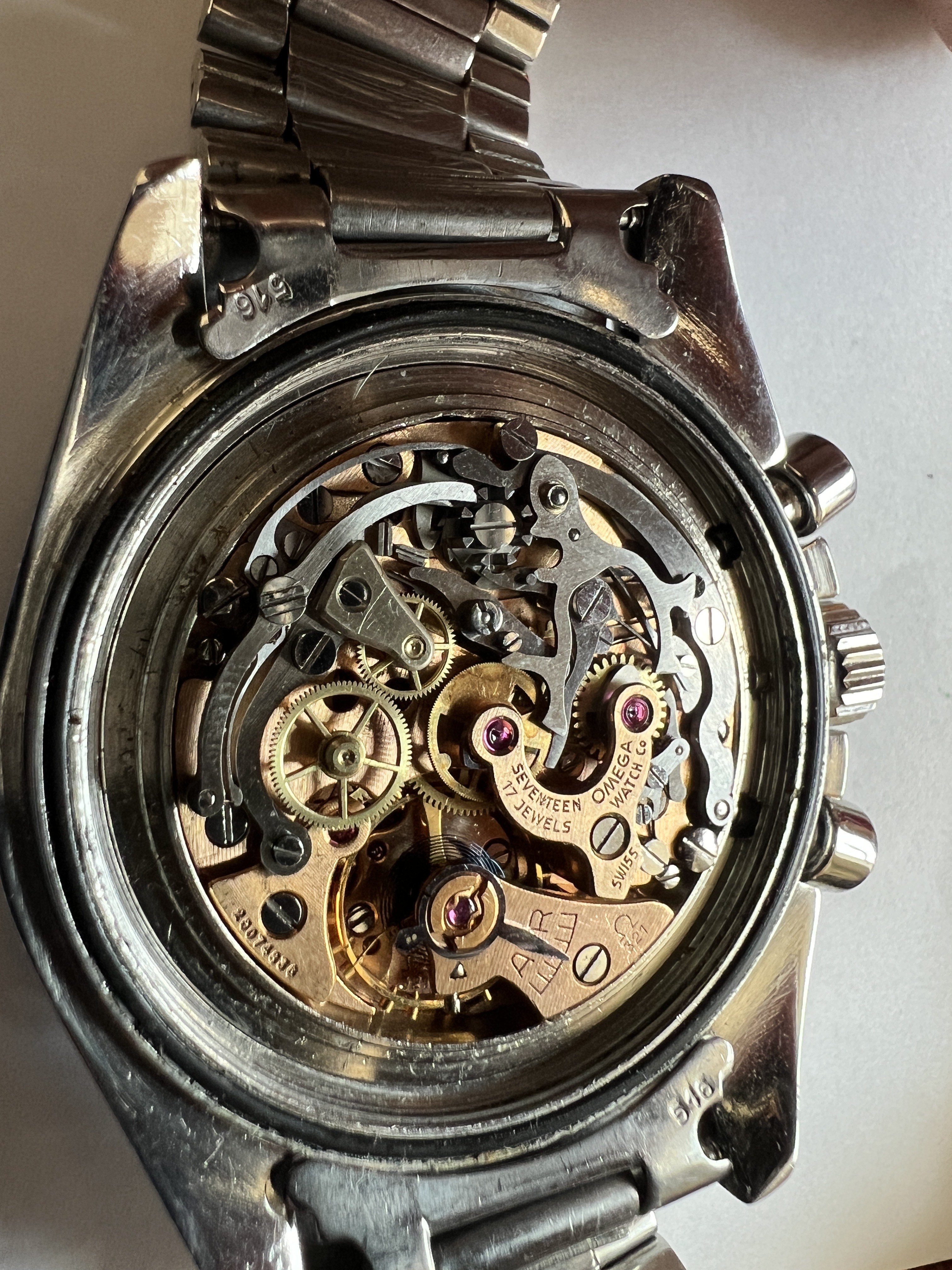

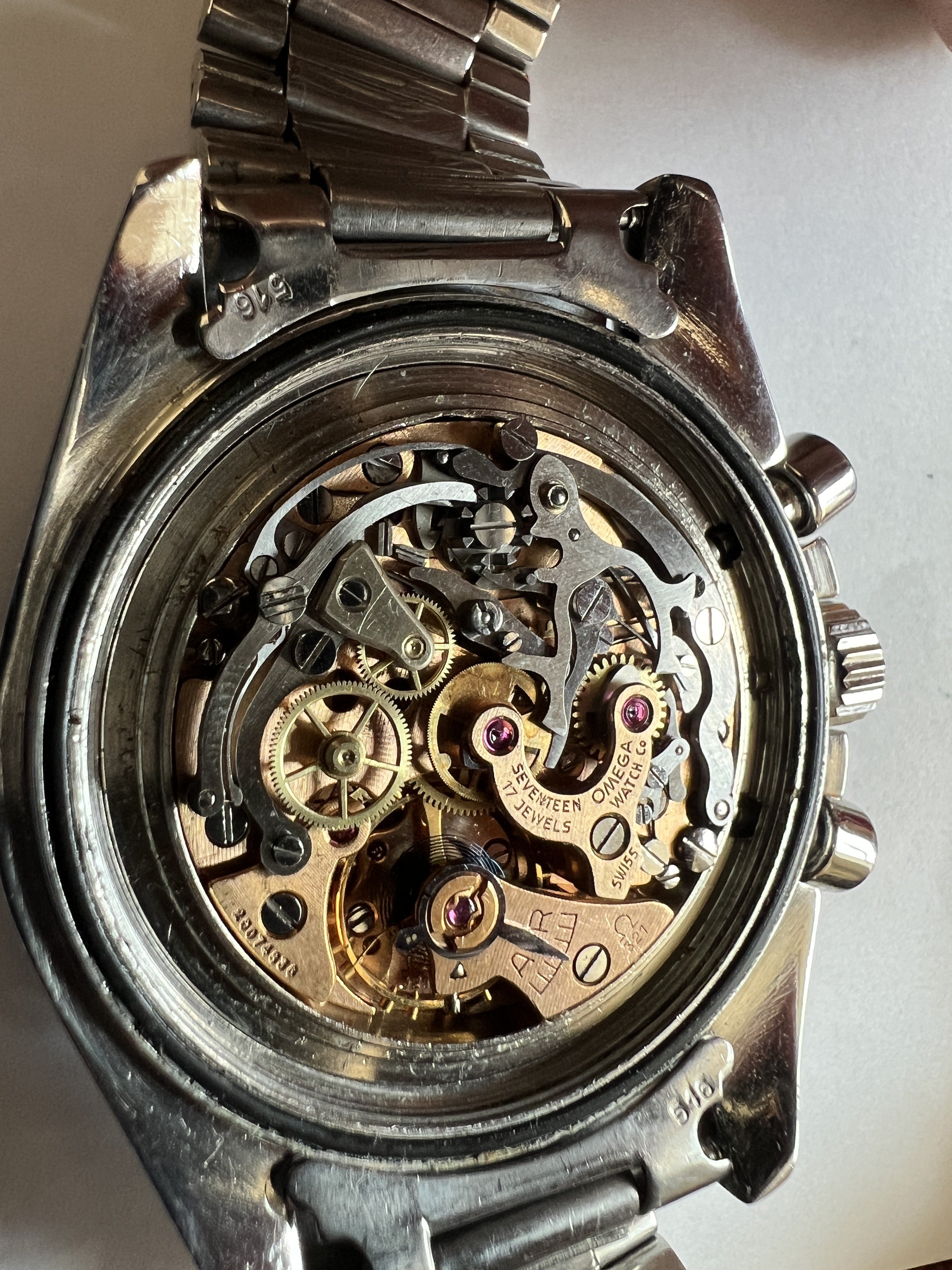

The movement has been attacked by a man who had only one screwdriver.

The fake bezel jumped right out at me, hopefully it was disclosed in the listing.
The fact that the DNN was included as part of the auction would lead me to believe that the auction house wasn't trying to intentionally mislead?
