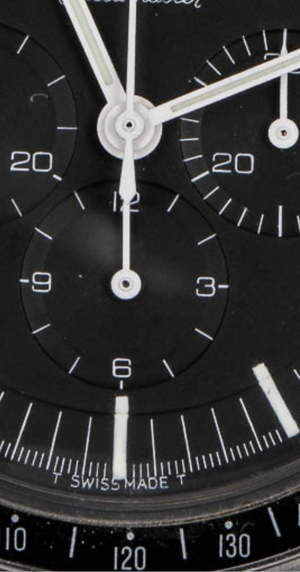

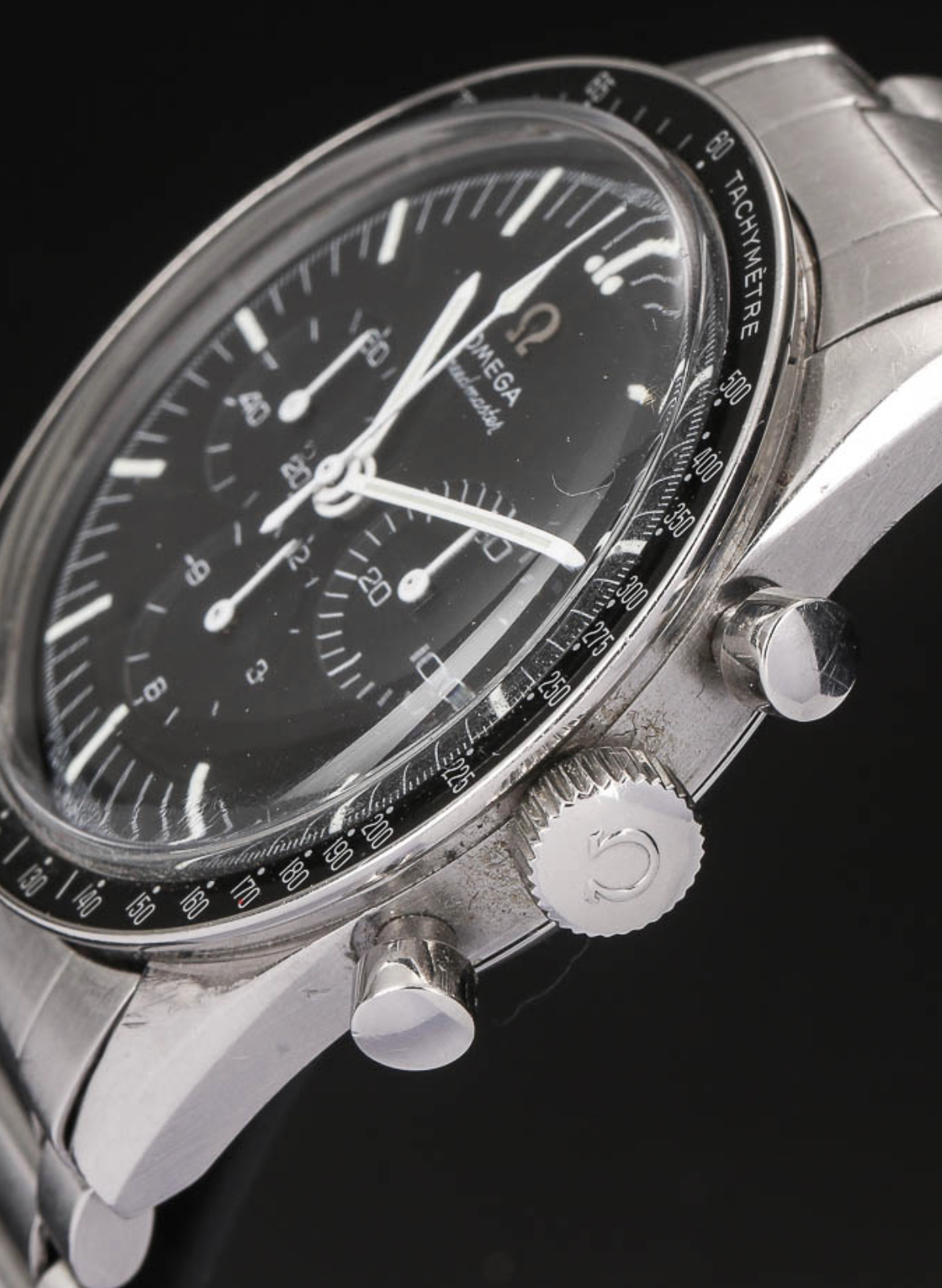

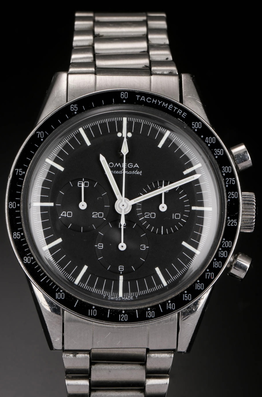

Is this 105.003 a bit too shiny?
8
4
Hello dear Omega friends! First of all i would like to thank all of you for the help you give!! Its amazing to know you all exist and are willing to share your knowledge! Thank you
So, ever since I got my first 861 pre moon I’ve been looking for a 321 105.003
now that I found one for sale (€10’700) With the obvious need of a correct bracelet and bezel my attention is now on the patina.. or the lack of it.. does this look like the lume has been reapplied to you guys? And what else do you see that makes you go “hmmm…”
In advance; thank you
Kind regards from
Torshov
13,556
23,504
Yeah that dial is extremely stark. No lume left and so there’s none of the warmth that a vintage model should give you
8
4
Where has the l
The case is the only thing good about it … it’s probably a -65.
Supposing the movement would be ok… hand set, bracelet, dial and bezel.. what would this set me back? And would it even be worth it? I mean, €11’000.. sell the bezel and the bracelet and the start?
10,805
16,814
If you need to replace all that, you'd need the watch at around €5K to come out ahead. Good luck with that.

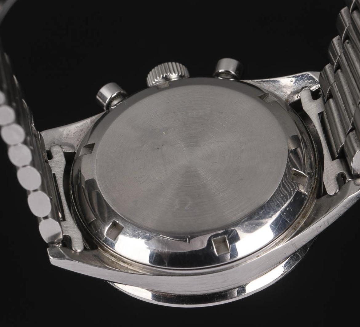

ps the 1171 is worth not a lot and these look like fake endlinks.
8
4
Won’t happen
