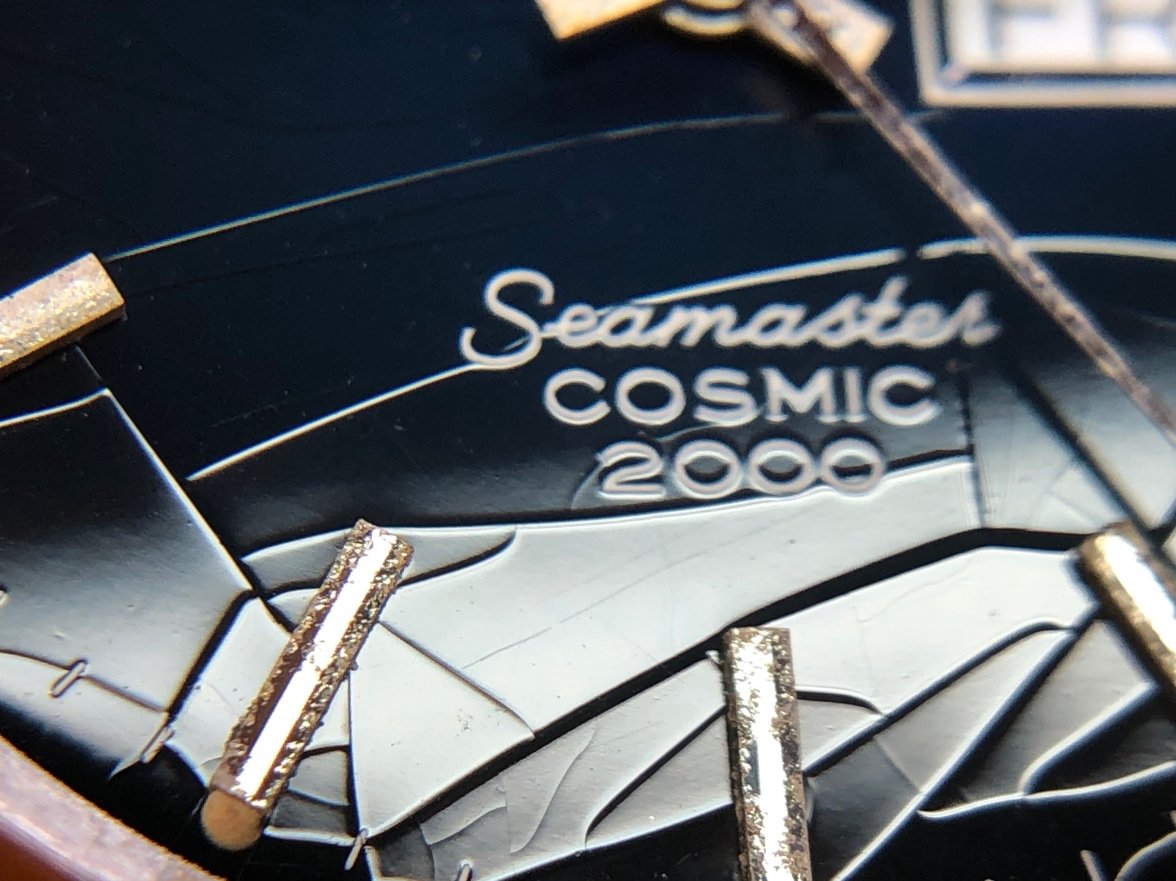

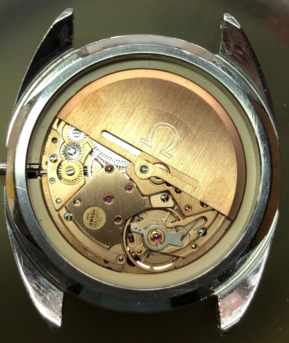

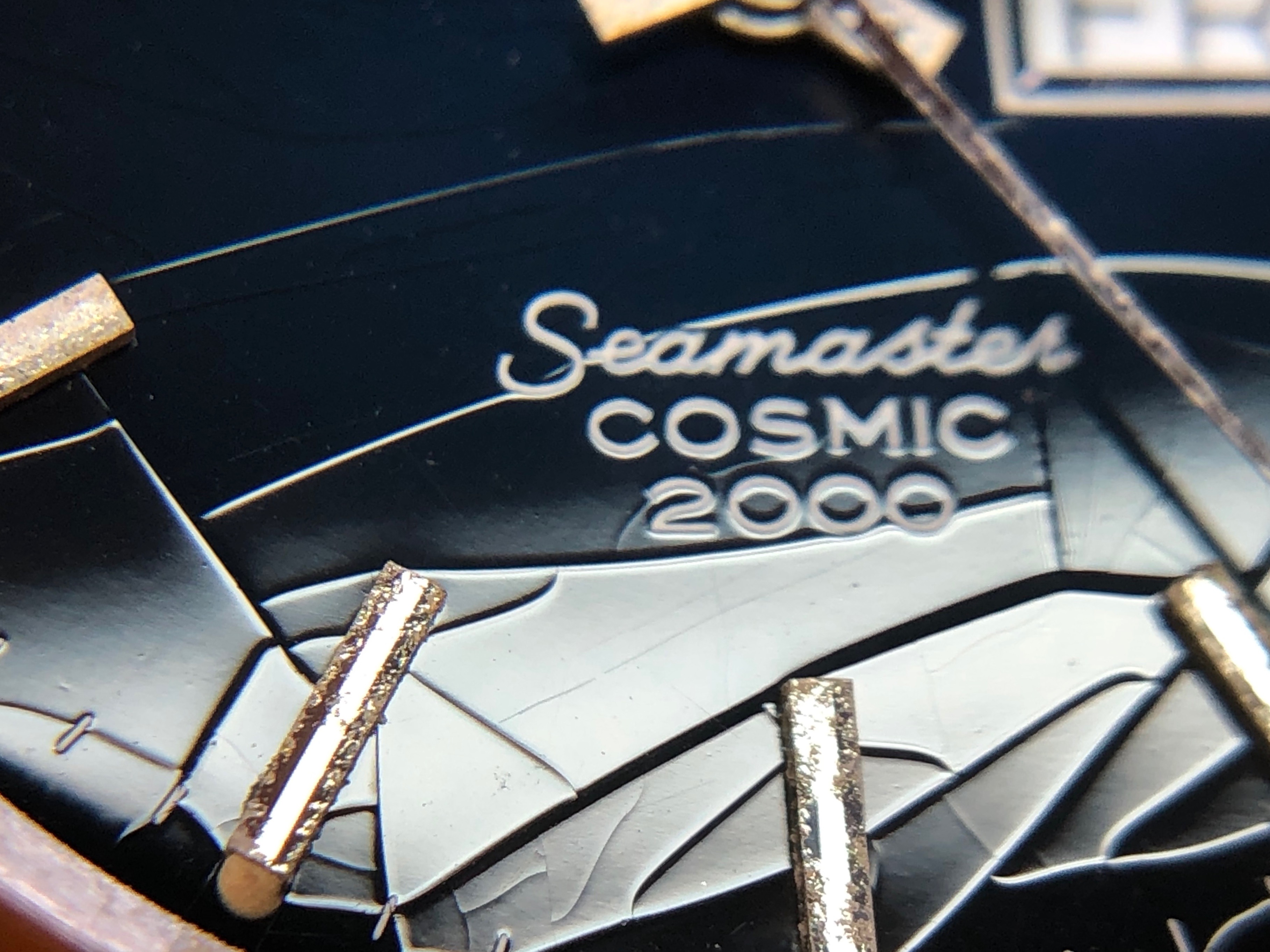

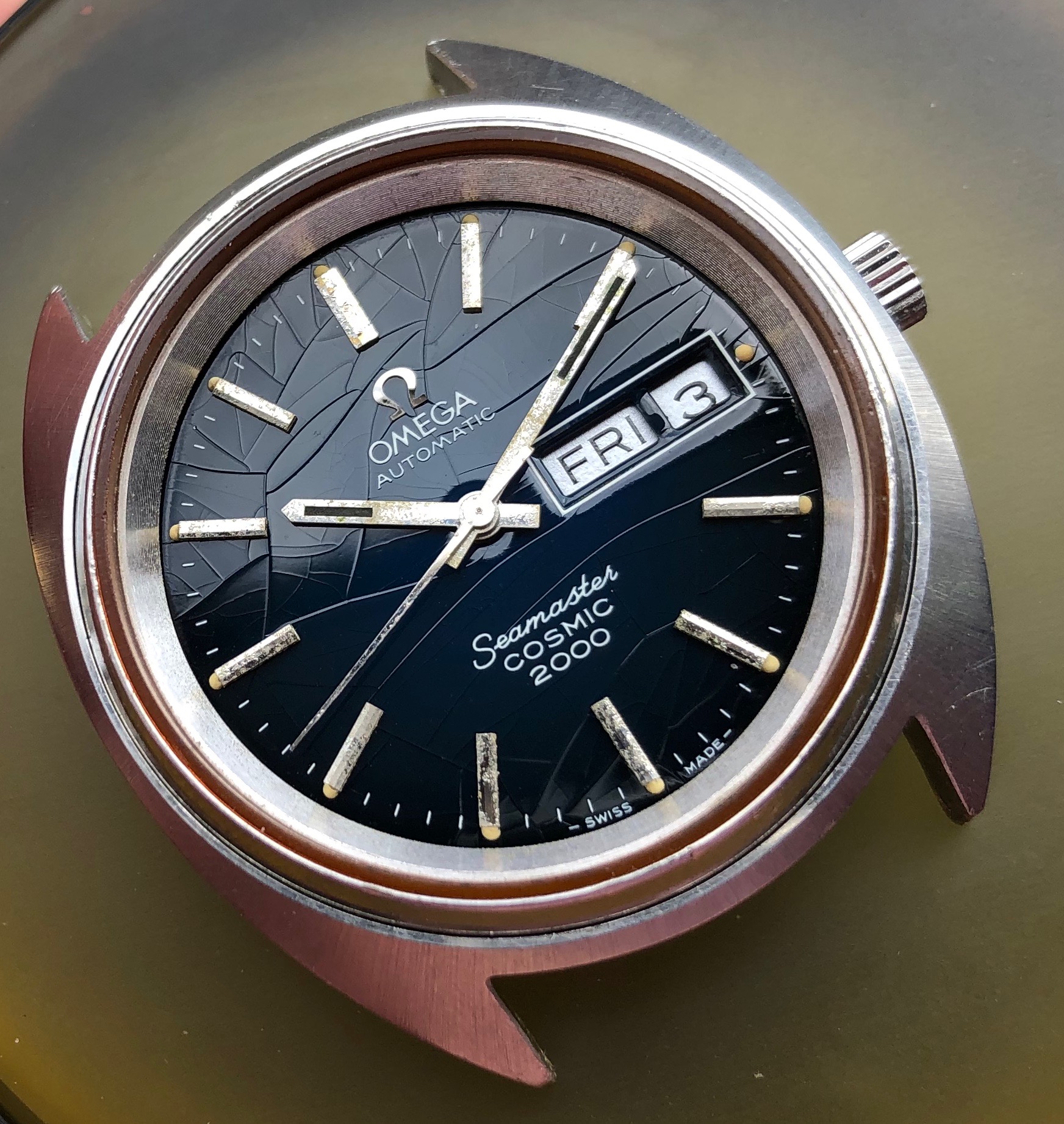

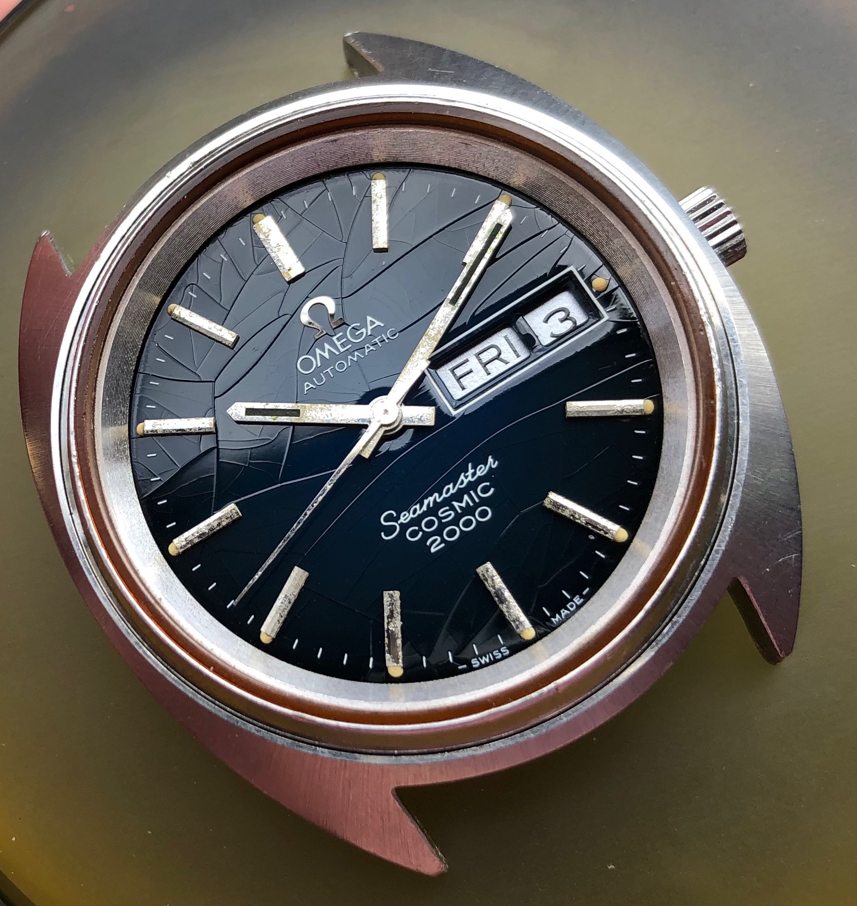

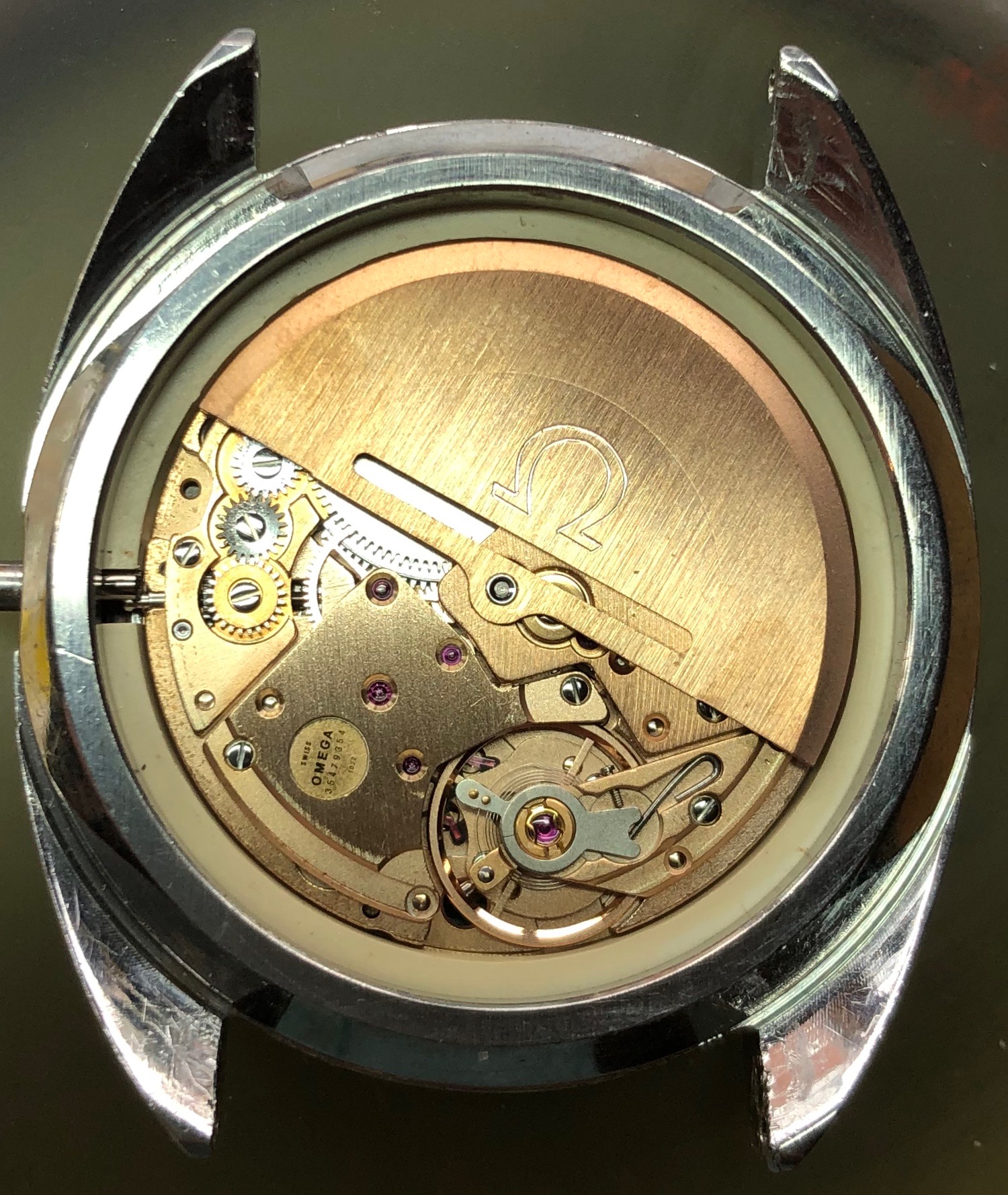

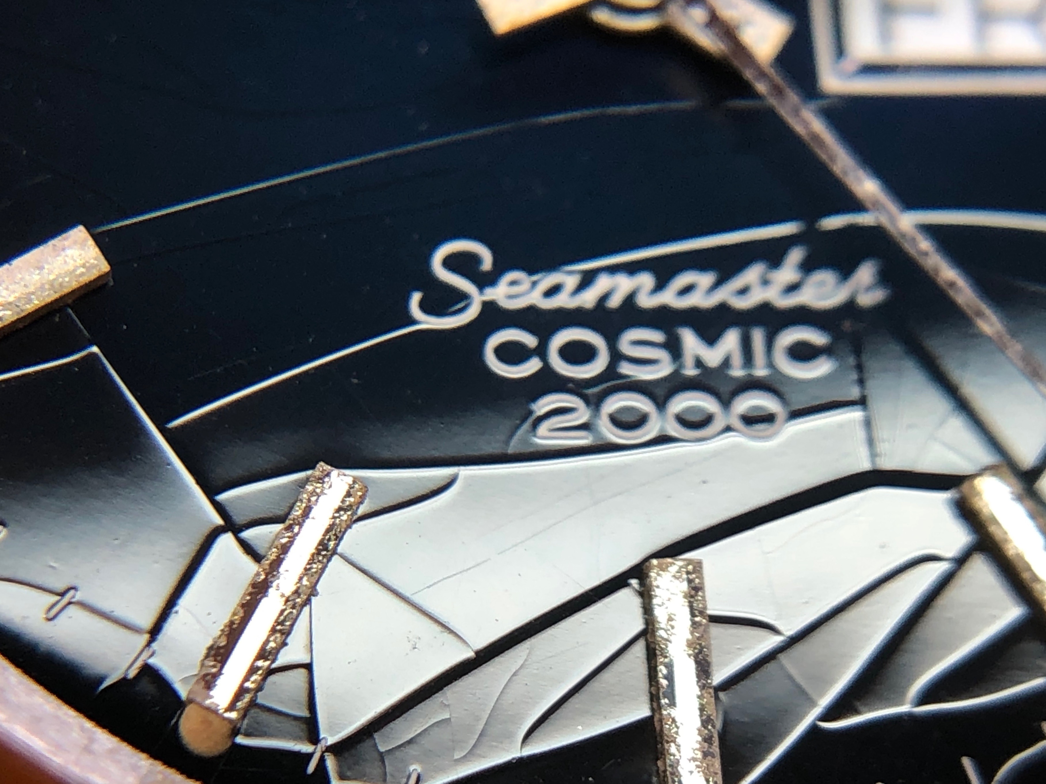

This thread is lacking photos, so here’s a movement, case and spiderweb closeup of my Cosmic 2000, cal1022.... which is due back from my watchmaker this week:
