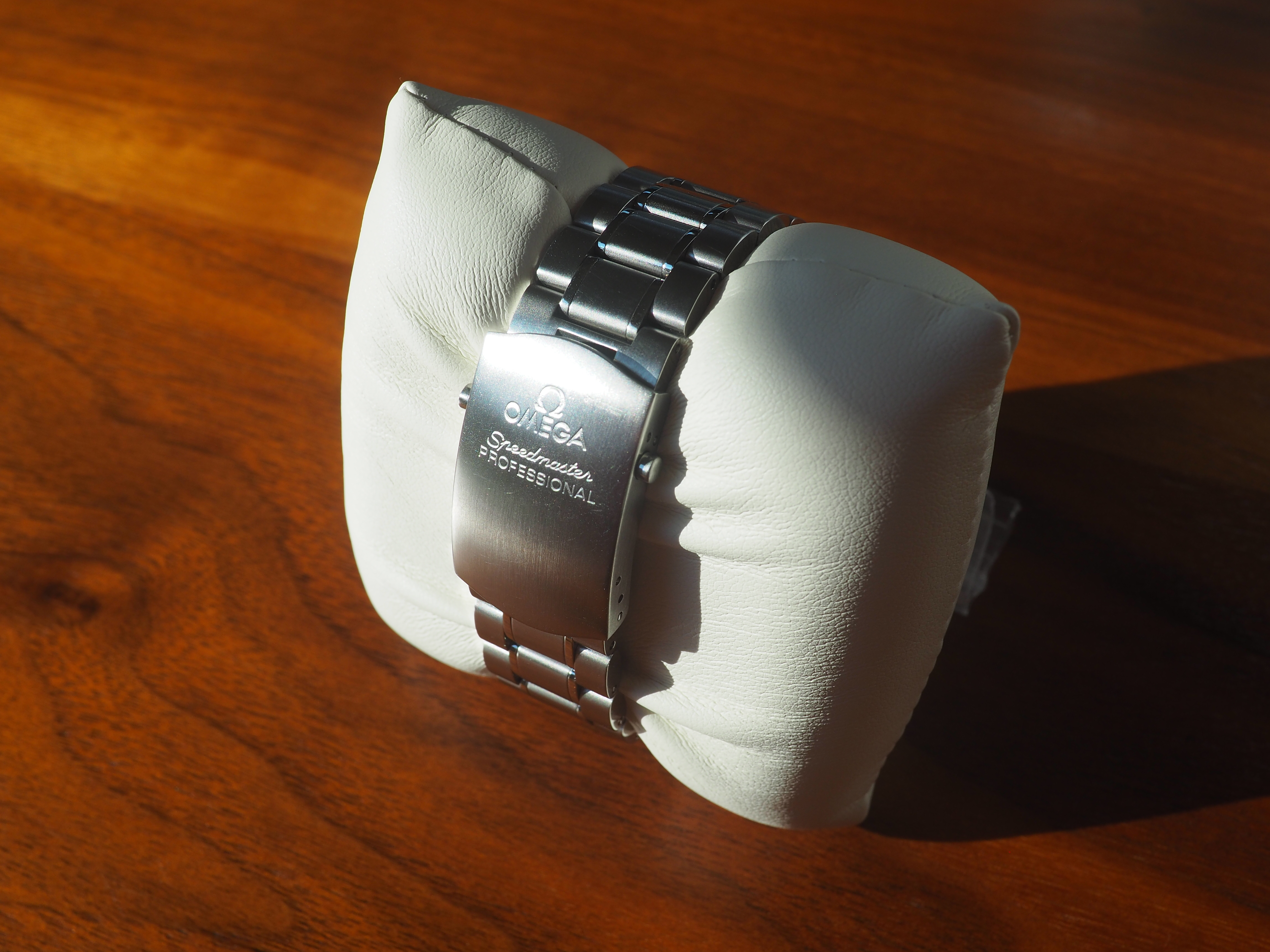

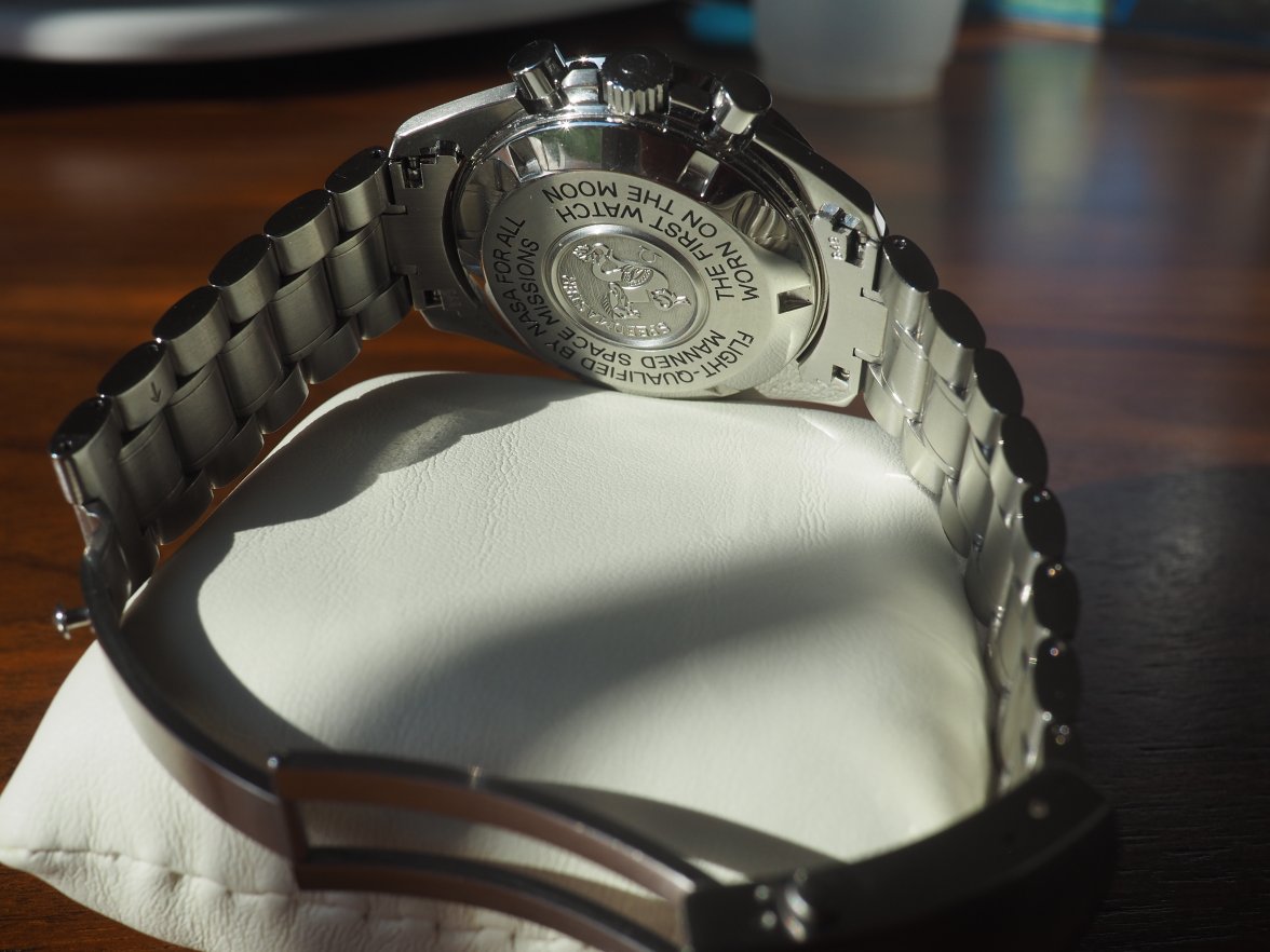

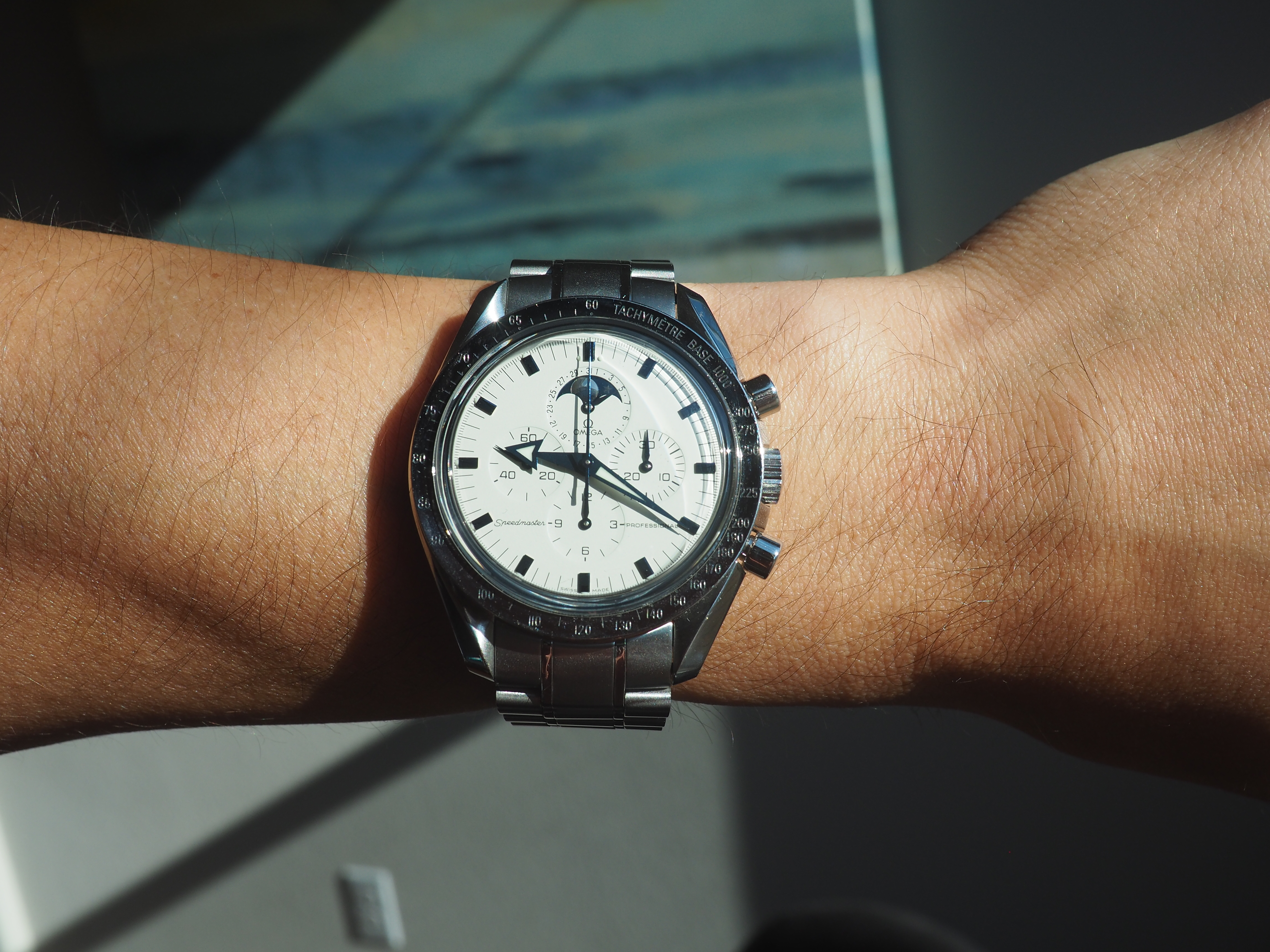

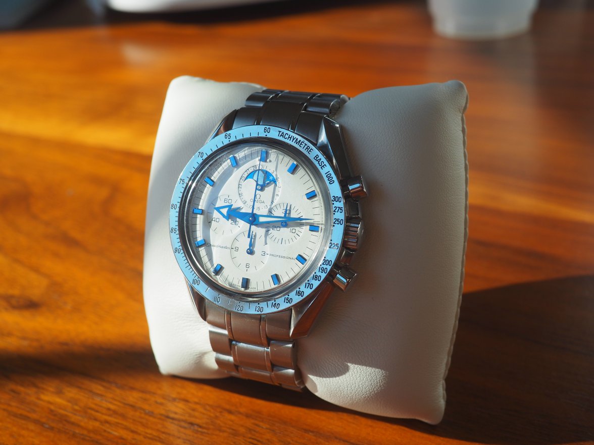

The day is finally here and I have received my beautiful Omega Speedmaster Professional Moon Phase Ref# 3575.20. Appreciate all the feedback and support in helping me make my decision!

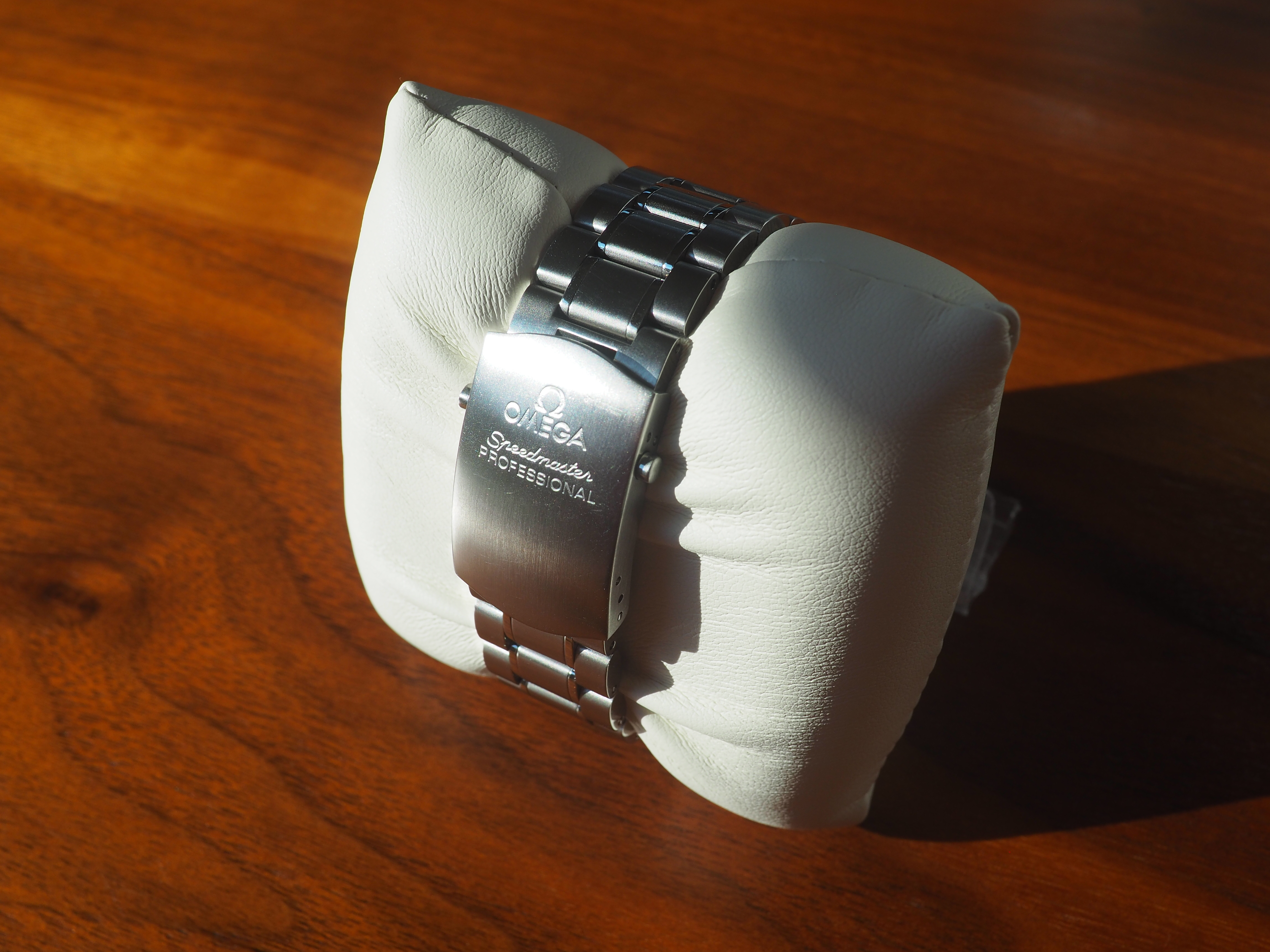

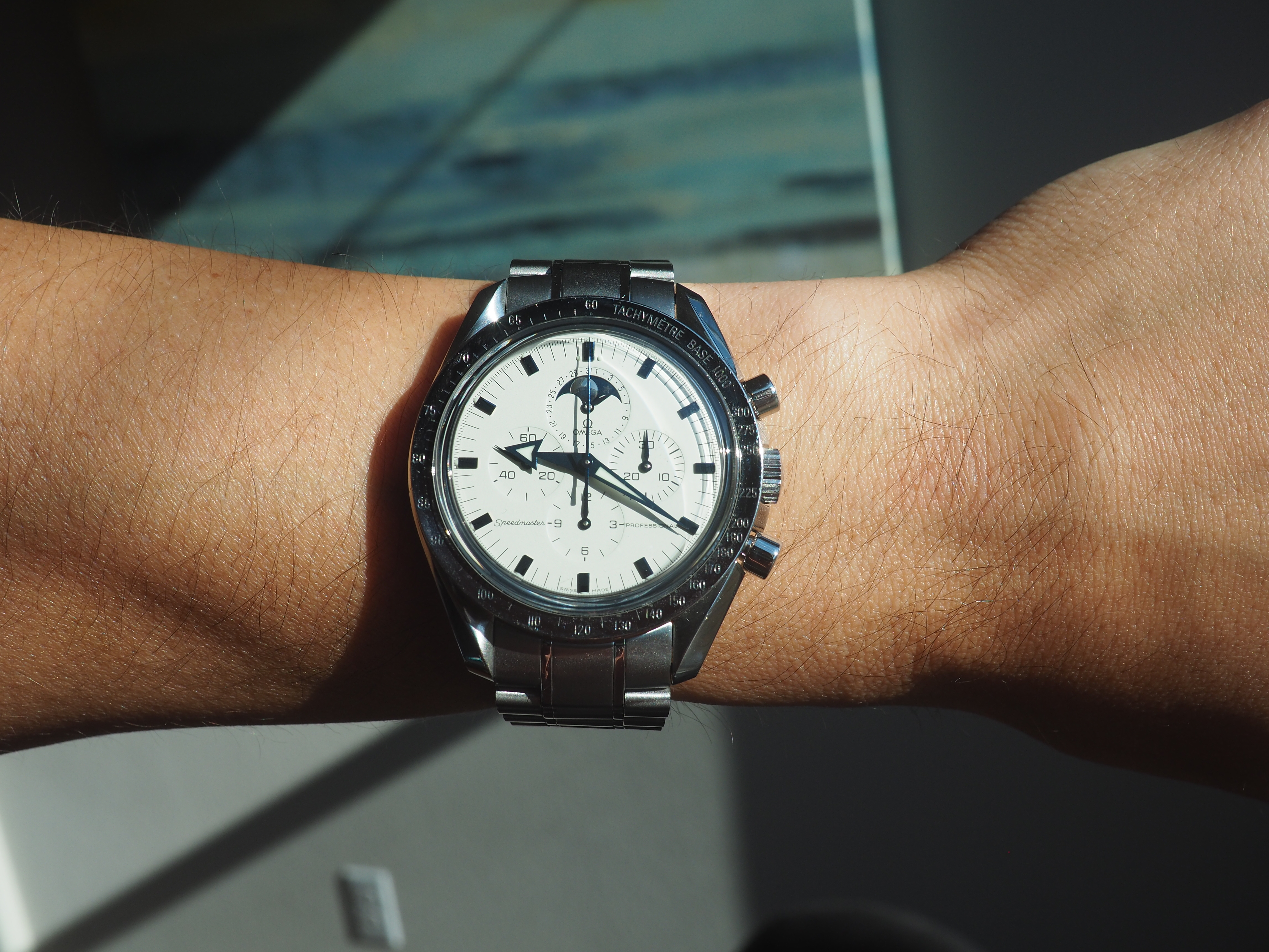

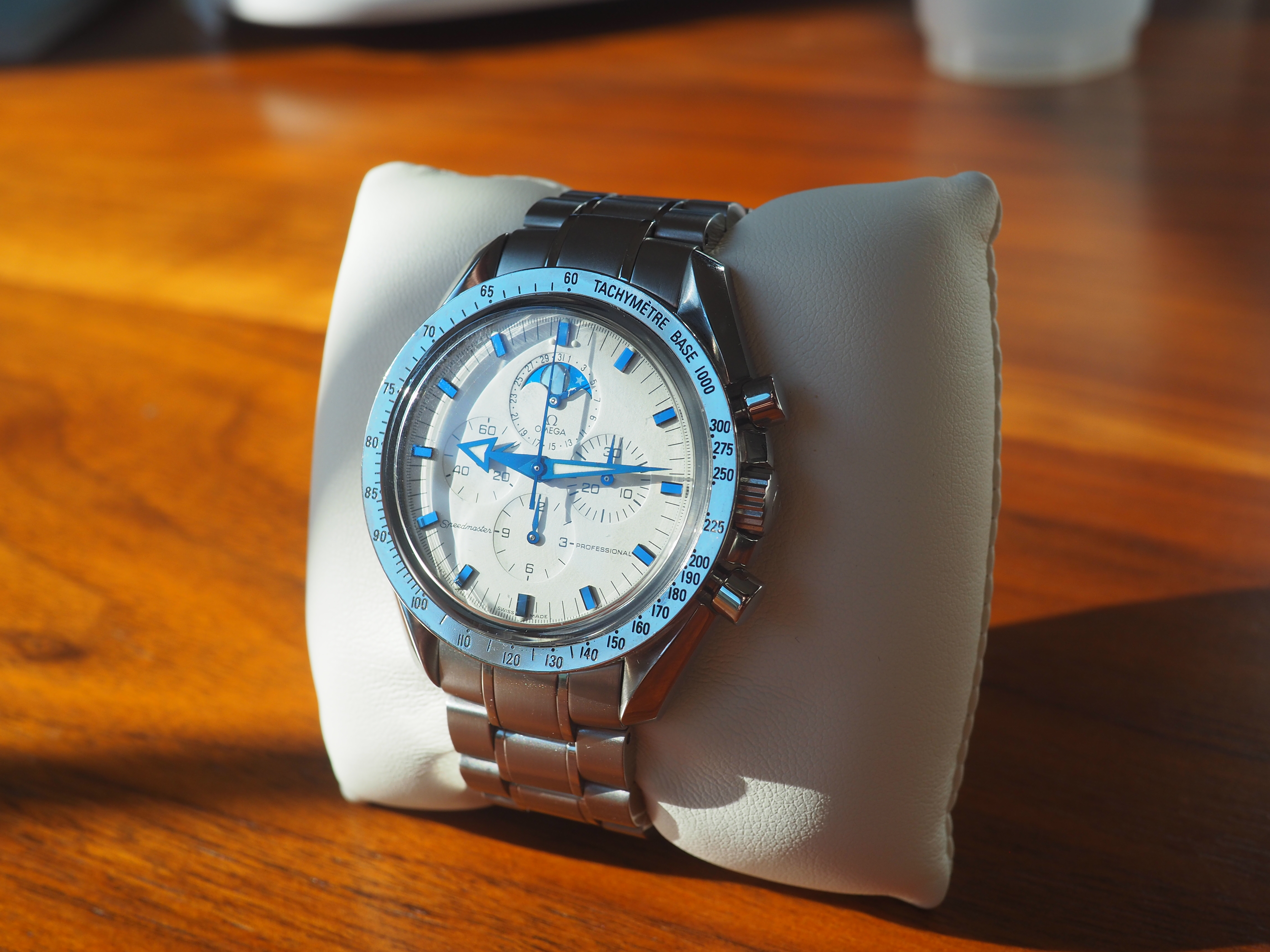

As I've quickly learned- no post is a post here on OF unless it has some high-resolution pictures with it so see below for some eye candy.
This watch was purchased from eLady Mall out of Japan. I did a lot of research and knew both the pros and cons to this so wanted to share my experience. First, even with the thought that it may need a service, the price point was hard to beat (be sure to grab their Coupon Codes- as much as 12% sometimes). Sure, it was not a complete set (although plenty of their other inventory does if that is your requirement) and it had been lightly polished but to each their own and I am happy with what I got and where I landed. Yes, shipping to the US did come with Import Fees from Customs, but no, I have no idea how they calculated it. I can tell you it was only $87.28 under the HTS code of 9102.11.1010 and it was shipped via DHL from start to finish (no transfer to USPS). I can also tell you that $26.22 alone was a processing fee and not even tied to the tax.
The first thing I did upon receiving was went to my local AD to take a link out (not in my case, but be aware that a lot of bracelets from Japan are small, eLady states the size on the listing) because the bracelet was slightly too big. I also was hoping that bringing it to them would help me confirm authenticity and/or give me a feel for the life left in the movement before a service might be needed. I have informally been running it for the past day and it looks like its definitely running fast- about +10 secs a day. Unfortunately no one there was familiar enough with the watch and didn't really offer up a case removal and review- simply said they can help me send it to Omega.
Here is where I need the community's help:
1. Is +10 seconds reasonable for it's age and with the assumption its never been serviced? I love the watch, but also have 14 days from yesterday to return if necessary. Curious if I should push back since they said they confirm prior to selling if its in an "acceptable range". I realize a service can help fix this, but would almost rather ride it out a little longer if I can. I have zero experience on the topic so appreciate your input.

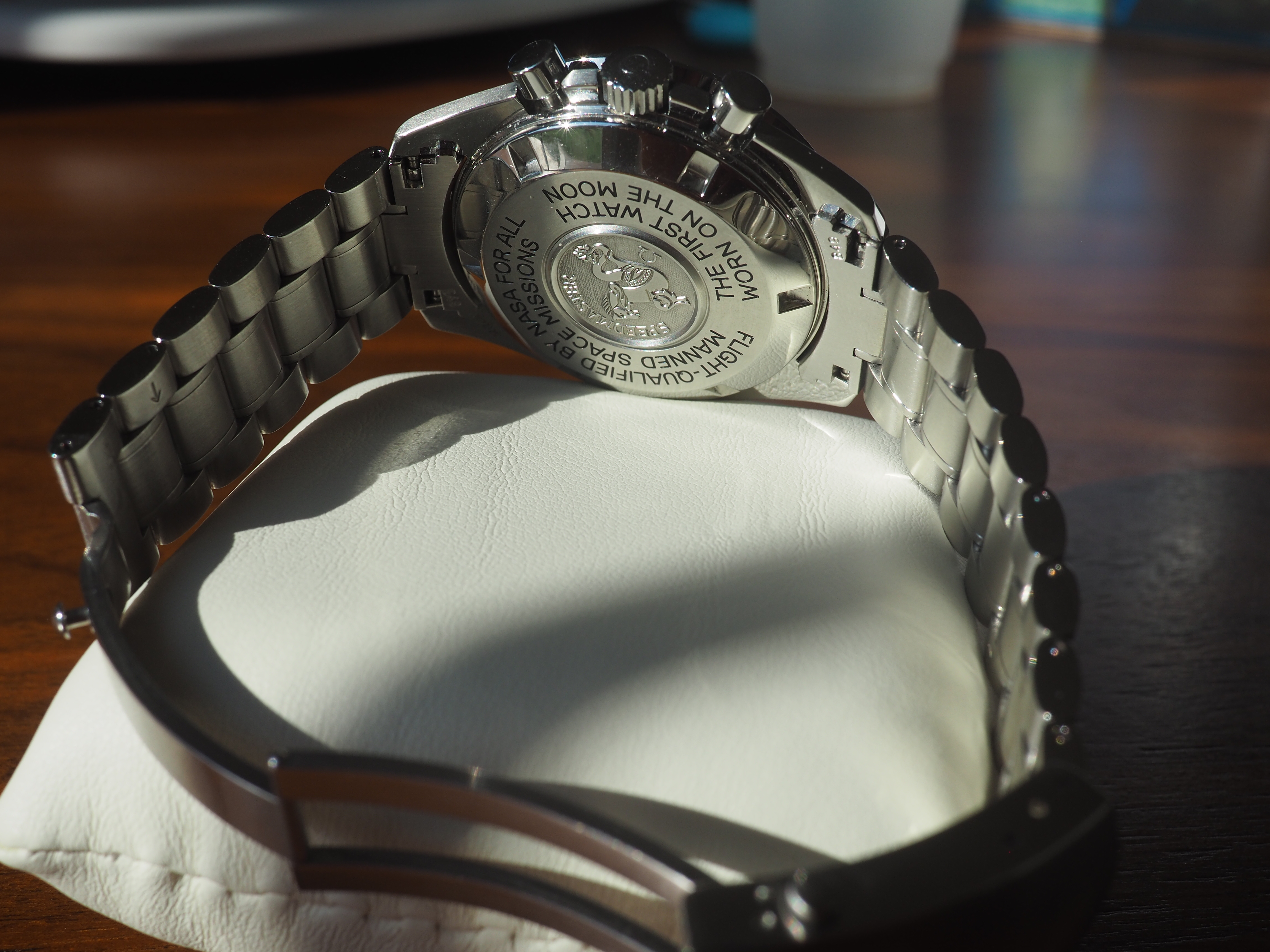

2. I could open the case back myself to snap a picture of the movement to share with you all, but I feel the CONs outweigh the PROs unless the community here believes something looks off based on the exterior pictures below. I do not want to scratch it nor mess up potential seals that exist unless I had to. My ask- is it necessary or does this look authentic enough to not worry and historically this isn't a piece people worry about with fakes?
3. Love the Speedmaster bracelet, but any suggestions on where to get a solid leather strap to go with it? This reference also had a leather strap option. Looking for best spots to get OEM Omega straps and best spots to get after-market straps.
TIA!

It's a used watch with unknown history (probably never been serviced) so +10 sec/day is not unreasonable. I always plan on a proper overhaul on any sort of used watch. Your watch looks good.
3,242
15,484
So to answer one of your questions. +10 isn't outrageous. Is that from wrist wearing or a timing device?
I have a timegrapher, which is the best watch tool I have in that it tells you whats really going on. But I do know that measuring in one static position, or even several positions, is not the same as dynamic wearing. But its close, and that's why it has value.
If it were me (with my jr watchmaker badge on), I'd open it up and regulate myself. Its not hard, but does require some basic skill and precision tools. Why would I do this? Because +10 is not in the realm of requiring service or overhaul....unless beat error and amplitude are also off significantly. The Timegrapher will tell you this information as well.

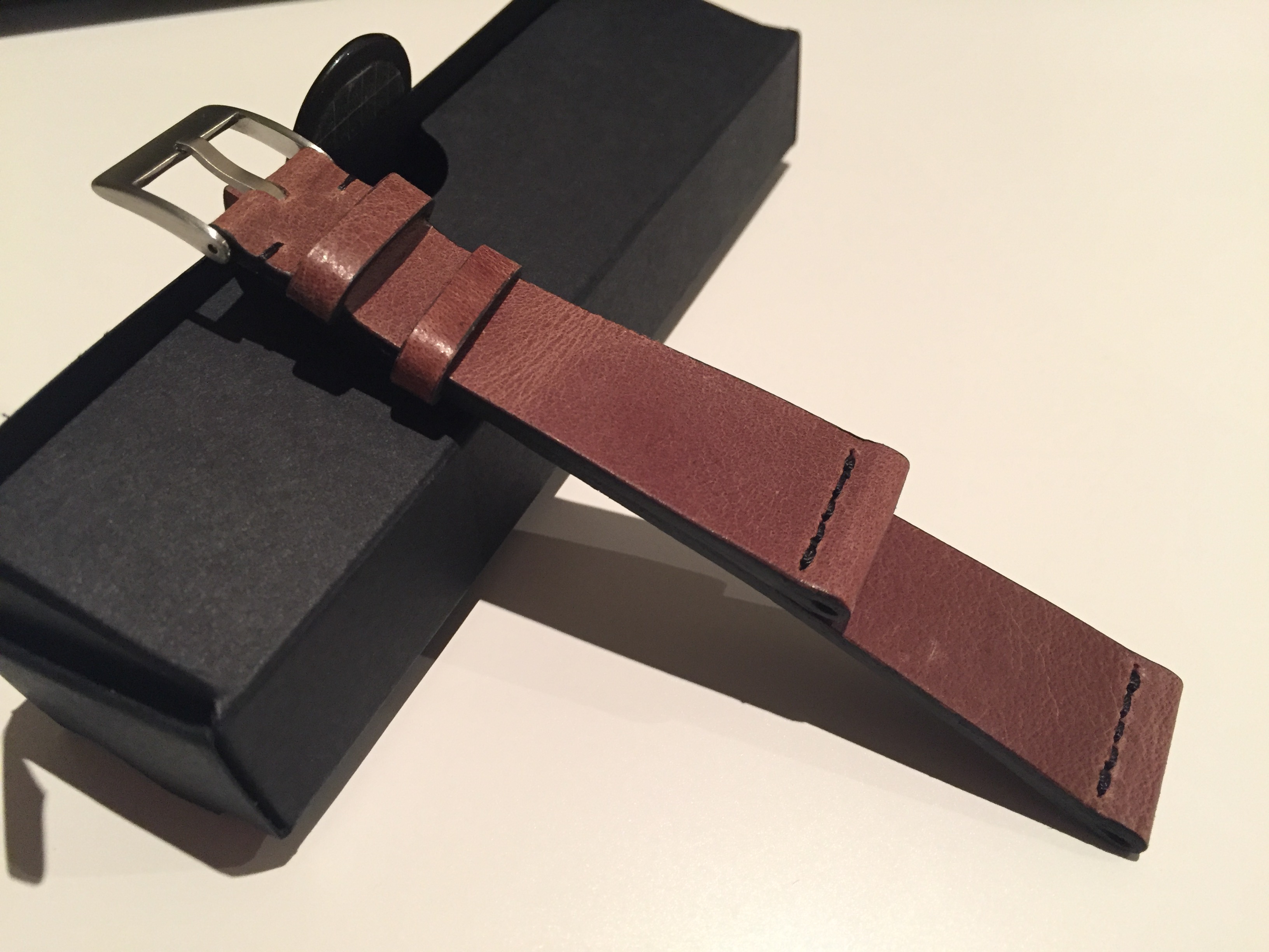

I just got my Crown and Buckle Black Label strap in for my incoming that I am just floored about. Excellent quality, I don鈥檛 think I would go another route in the future.

Timekeeping is within Omega specs for the Cal. 1866. They are that the average daily rate should fall between -1 and +11 seconds per day, measured over 3 positions. So the rates you are seeing are not any indication that the watch requires servicing - but timekeeping is not a reliable indicator of the need for servicing anyway.
I would full wind the watch, set the time, write it down, and let the watch run until it stops. Note how many hours it runs - this is a better (not perfect, but better) indicator of the condition of the movement. Watch should run for approx. 48 hours.
