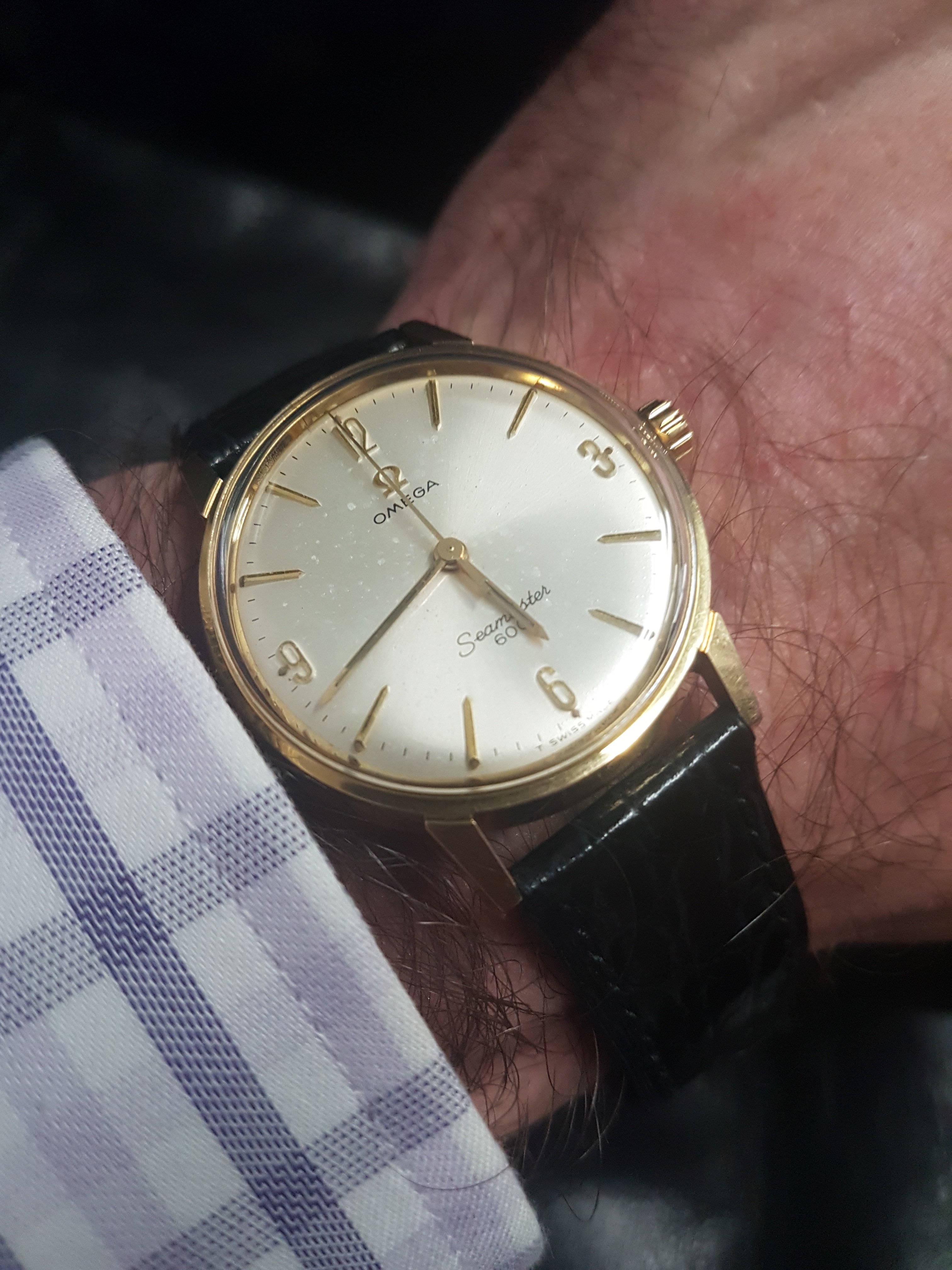

Thought I'd give a brief update - my grandfather's 135.011 was given a sympathetic service by a repairer with an omega parts account and since returned to me. Only needed a new hesalite and crown, and has kept perfect time since. It's my oldest, smallest, and only gold watch, but I'm wearing it right now and loving it.
Lovely watch and glad you did it right it’s got a lovely patina on the dial- and I normally hate “patina”, but just enough to give it a little character and not enough to make it ugly.
Next we need a wrist shot out in the world.

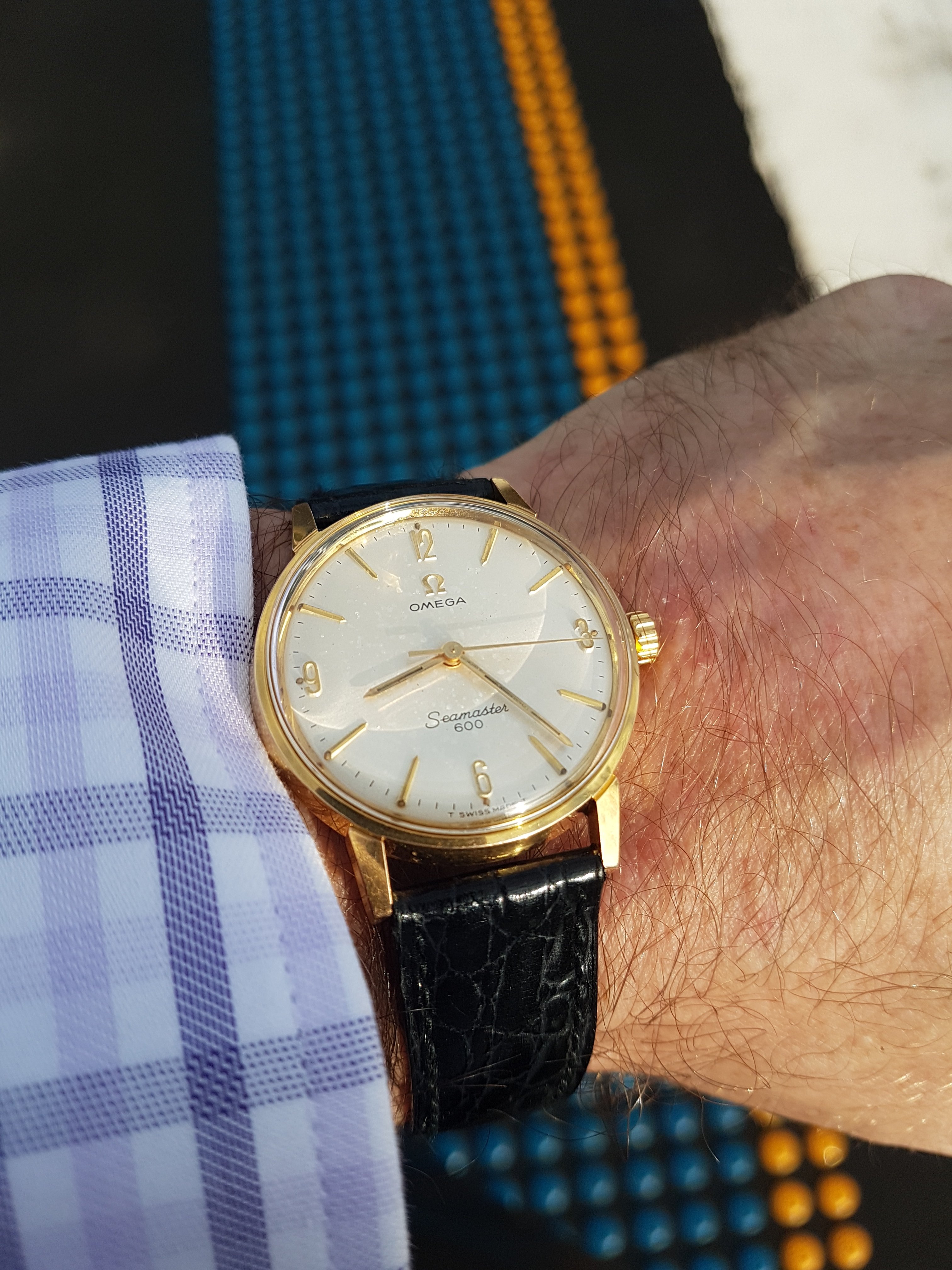

Ok here it is out in the real world - back in service after 50 years as everyday business attire.

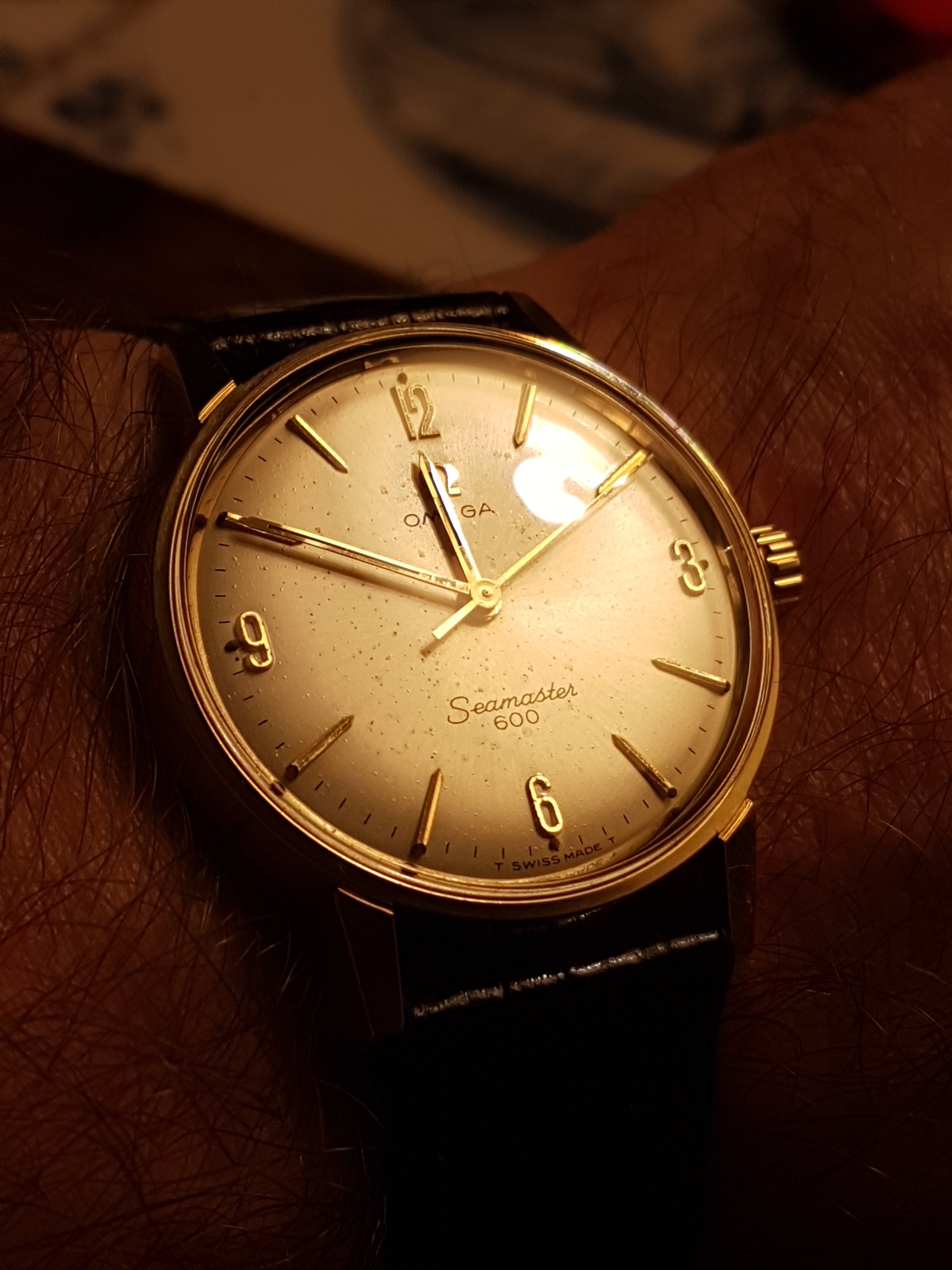

Speaking of patina - it only became apparent after replacing the crystal that the dial has a lot of spotting. I'm not bothered and happy to keep it relatively untouched, but just wondering what might cause this to develop? Mould? Moisture? Coronavirus?
Although Coronavirus can be blamed for many woes at the moment, your watch suffered from Gummiplague. Keeping the crown and back seal fresh (by having them replaced and pressure tested at a service) to make them water tight is the key to avoid Gummiplague.

Gummiplague
Thanks for your input @JwRosenthal, the crown was pretty knackered by the time I received it and it wouldn't surprise me if the seal had gone years ago.
But gummiplague??? Is that a technical term?
Lol! No, just made up the term (gummi in German means rubber) but seems to afflict all older water sealed watches when not maintained properly.
Hahaha I figured this was the case after I tried googling the term 🤦
It's a pretty fascinating form of 'patina' though, almost looks like a foreign body like mould sitting on the dial. Is it just raising / distortion of the dial itself? Or is it alive? Pretty interesting to think of wearing a watch that's grown a microbiome over the years...
Usually it’s just corrosion of the metal surface under the lacquer or damage to the lacquer itself. Moisture gets into the watch via the degraded seals (hand washing, sweat, humid rainy day with wet sleeves), and you get a little fog under the crystal...let that sit and don’t have it dried out by a watchmaker...and there ya go.
