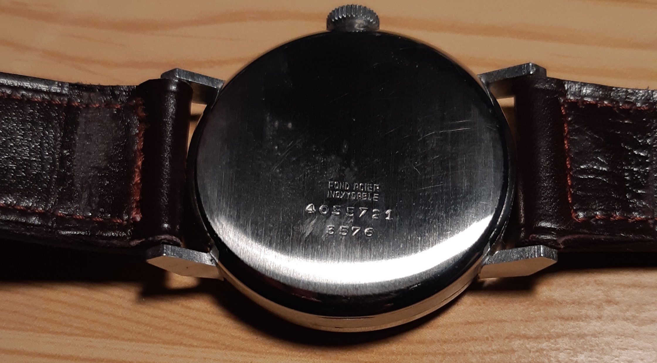

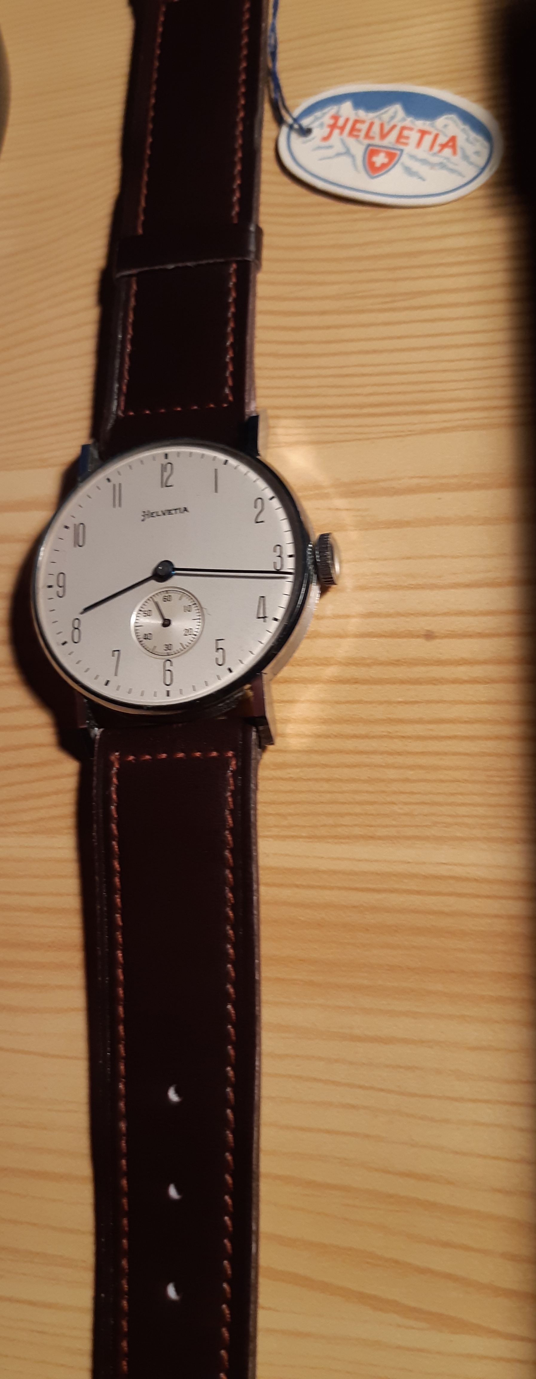

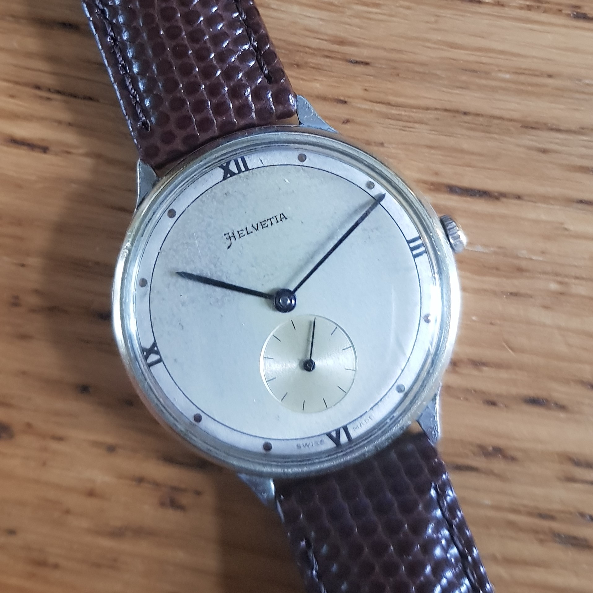

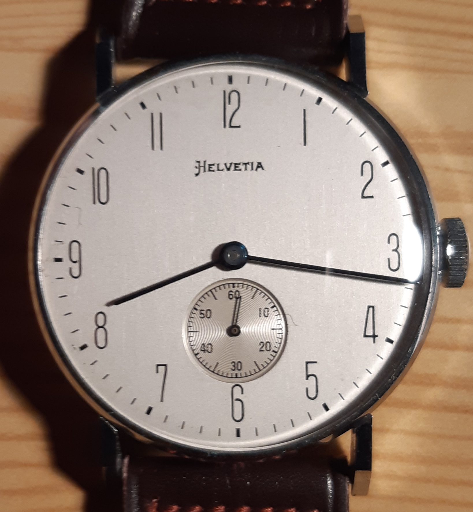

Hi, nice watch.
2021P is the case number. I have records of 10 watches in 2021 case from 1938 to 1950, I own 3. I think yours is late 40s. The design changed slightly over the years. If you have the serial number from inside the case back I can date it more accurately for you.
Normally these have a cal 81 or 82 in them but they could have an 80C. The 80C was used from the mid 40s to the mid 50s.
Have a look at my site for more info:
https://www.helvetiahistory.co.uk/
Here is a pic of my 1938 example.
Thanks. Carl.

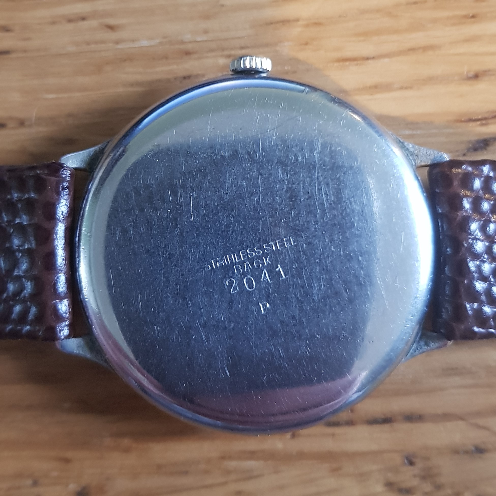

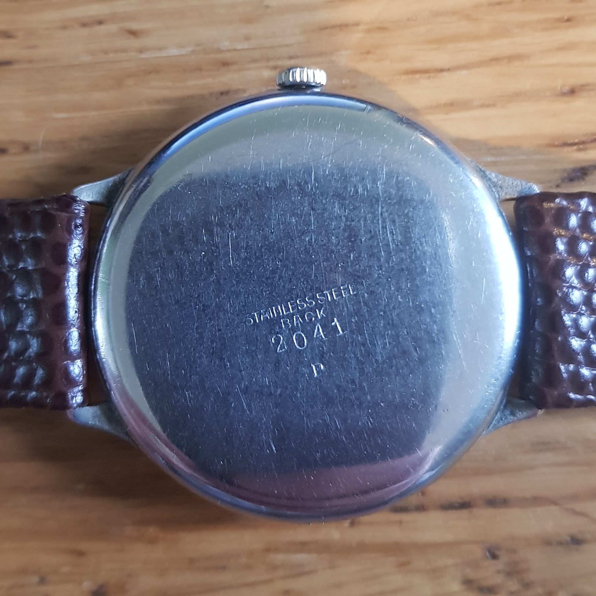

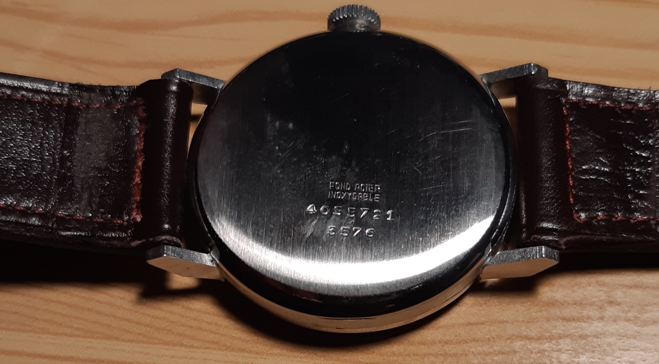

Ah cool, I'll try and take a look for the serial number. Are the case backs easy to get back on without tools? I don't have a press so I would be reattaching it with just my hands.

Is it a steel case?
The case back says stainless steel. I'll have to recheck the case body.
I haven't needed to use a press to replace the backs on any of mine. I would caution with regards to getting the back off. You should use a proper case opening tool and it's still easy to slip. Don't want to teach you to suck eggs but wouldn't want you to mark your lovely watch either!
The case is almost certainly chrome plated. They did use completely stainless steel cases in the 1930s but then not again until the late 50s/60s.

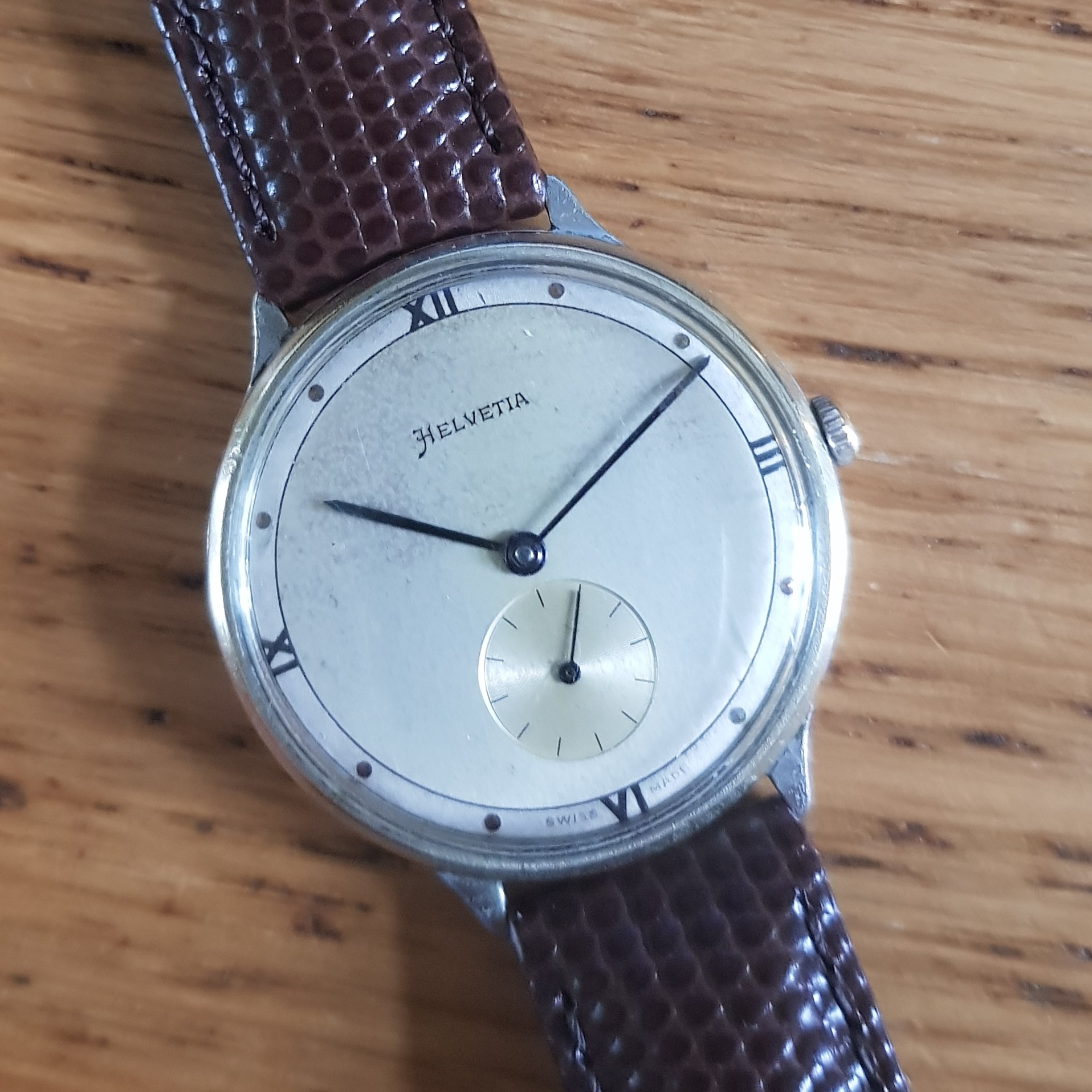

In terms of a purist piece, this one is pretty pure...lol
Get this: ~85 years old, appears to have never been serviced and still keeps bang-on time. A true draw / barn find. This was one of first vintage watches I purchased @ a vintage shop in the Berkshires. Must be 15 or 16 years gone by now. I paid $65 and felt like I got ripped off a bit (at the time).
Long story, boring: Turns out it's Platinum. But, possibly a re-case. But, maybe not. I took her on a trip to Miami with me a few years ago to ask Matt Bain if he knew anything about it. Right away, he offered to buy it so I knew there was something unique about such a ubiquitous watch.
I can put his watch head next to ANY watch head in the world and It holds its own. The dial is almost flawless and you never see me use such flowery rhetoric to describe any of my watches on this forum. Nope, not a re-dial.
Thanks for looking!

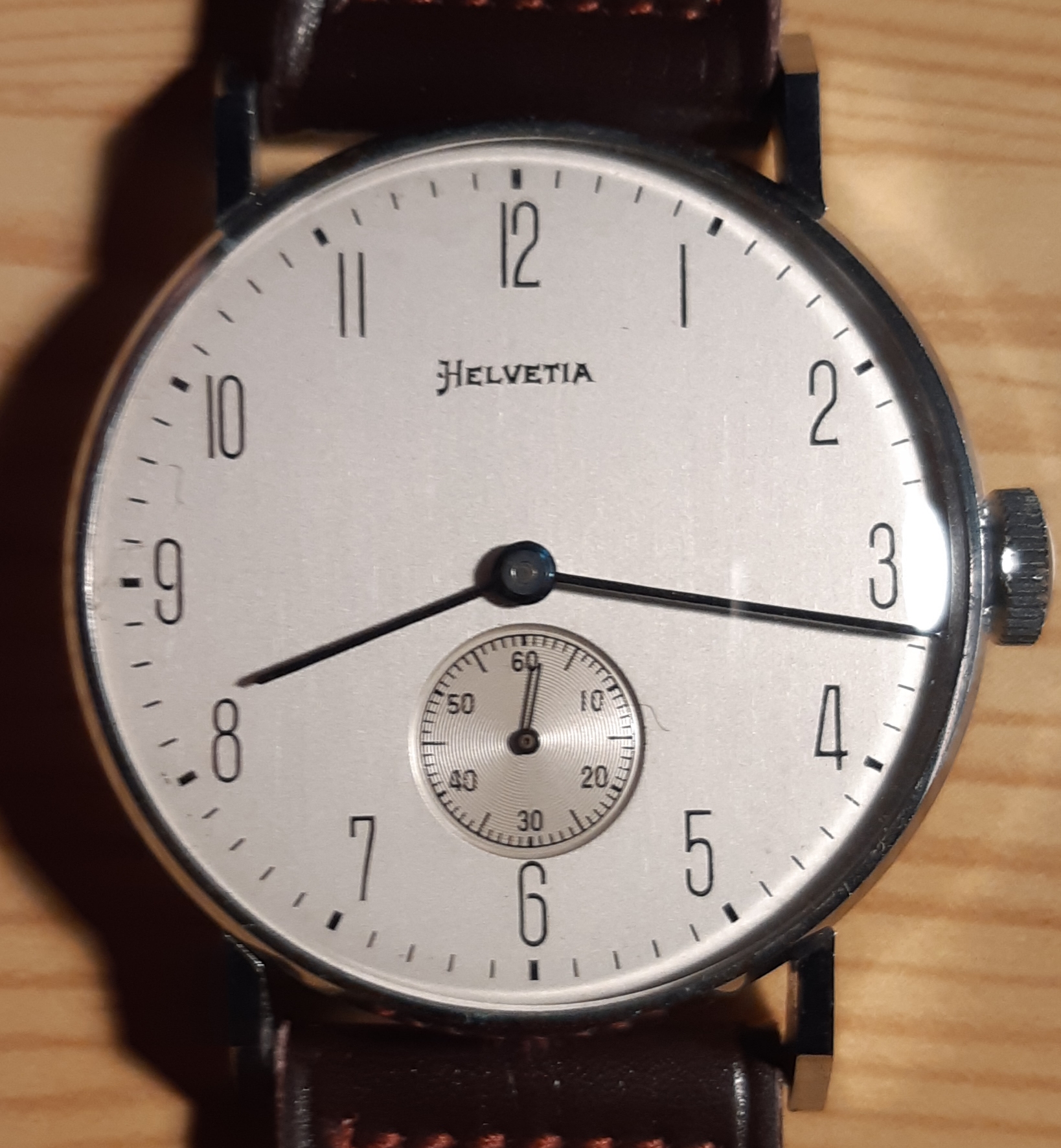

Hi all,
I have just picked up a watch with the same unusual case as @citizenrich. Very thin bezel and fixed lugs.
These watches initially look as if they belong in the 1920s or 1930s but the serial numbers put his at about 1945 and mine at 1948, the dials and movement also support these dates. Helvetia did have a habit of coming up with designs of watches that don't always seem to fit with the expected for the period.

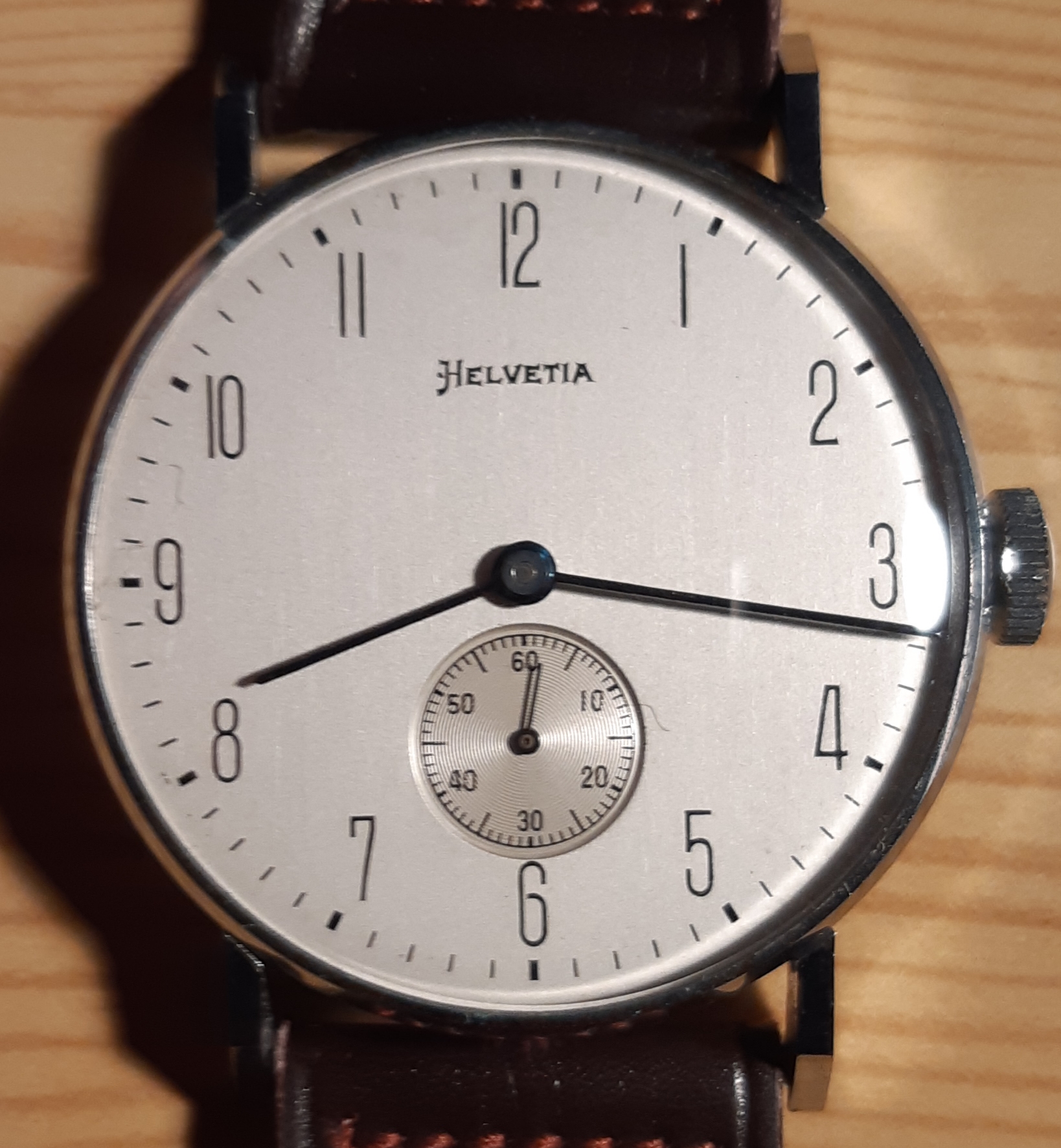

Hello, here is my example of Helvetia from 1941. Comments are welcome 😀

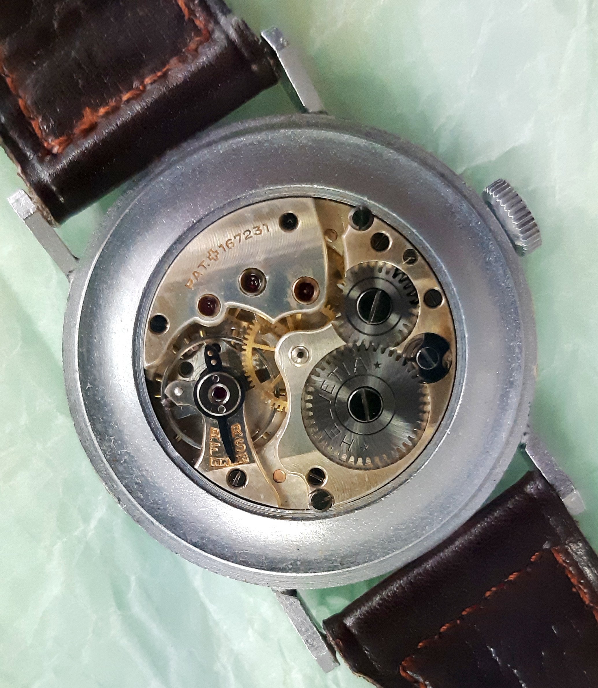

27
56

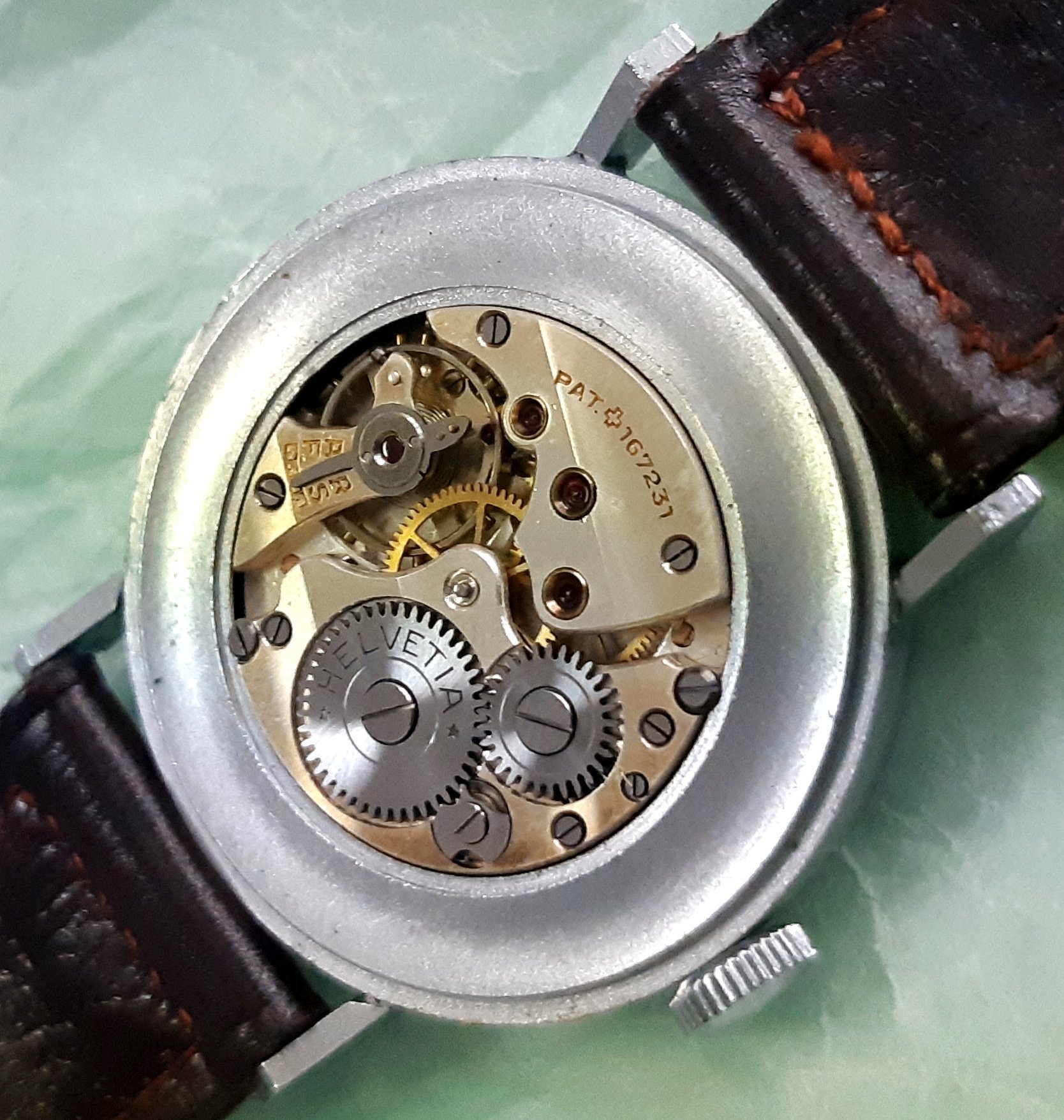

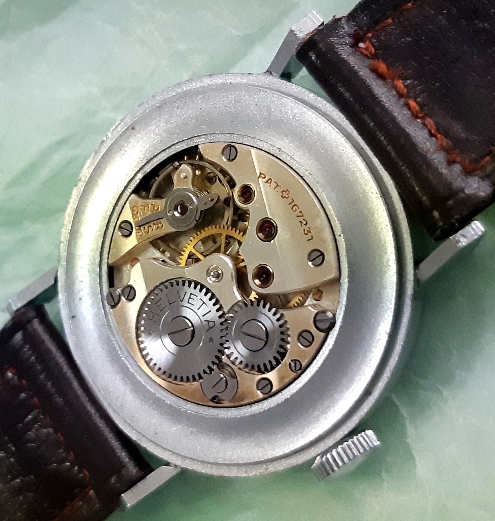

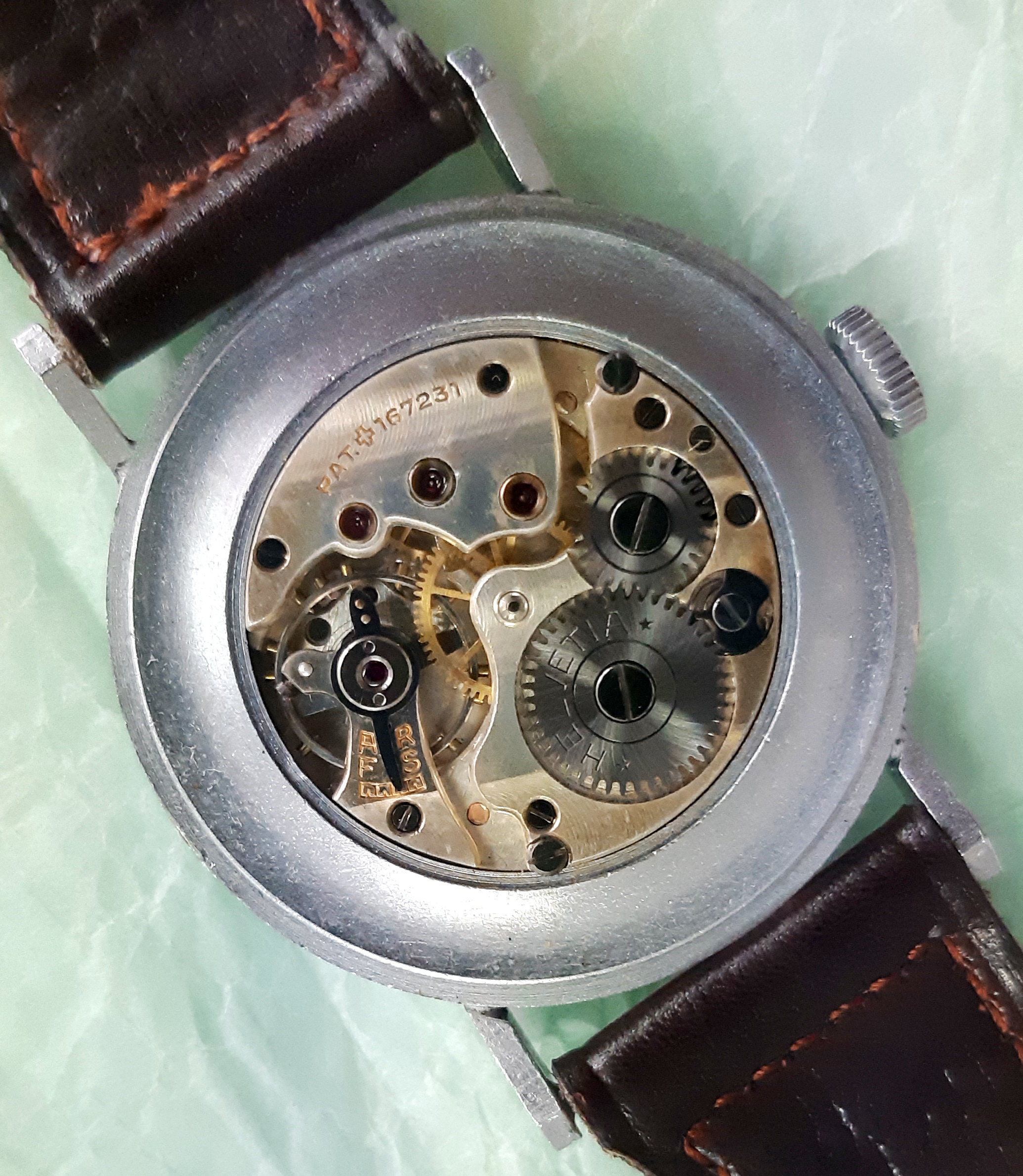

Hello, after a long time, here I am again with pictures of Helvetia, which I have already shown, but now also with a picture of the watch movement. Please, if possible, a detailed description of that watch. Thank you
