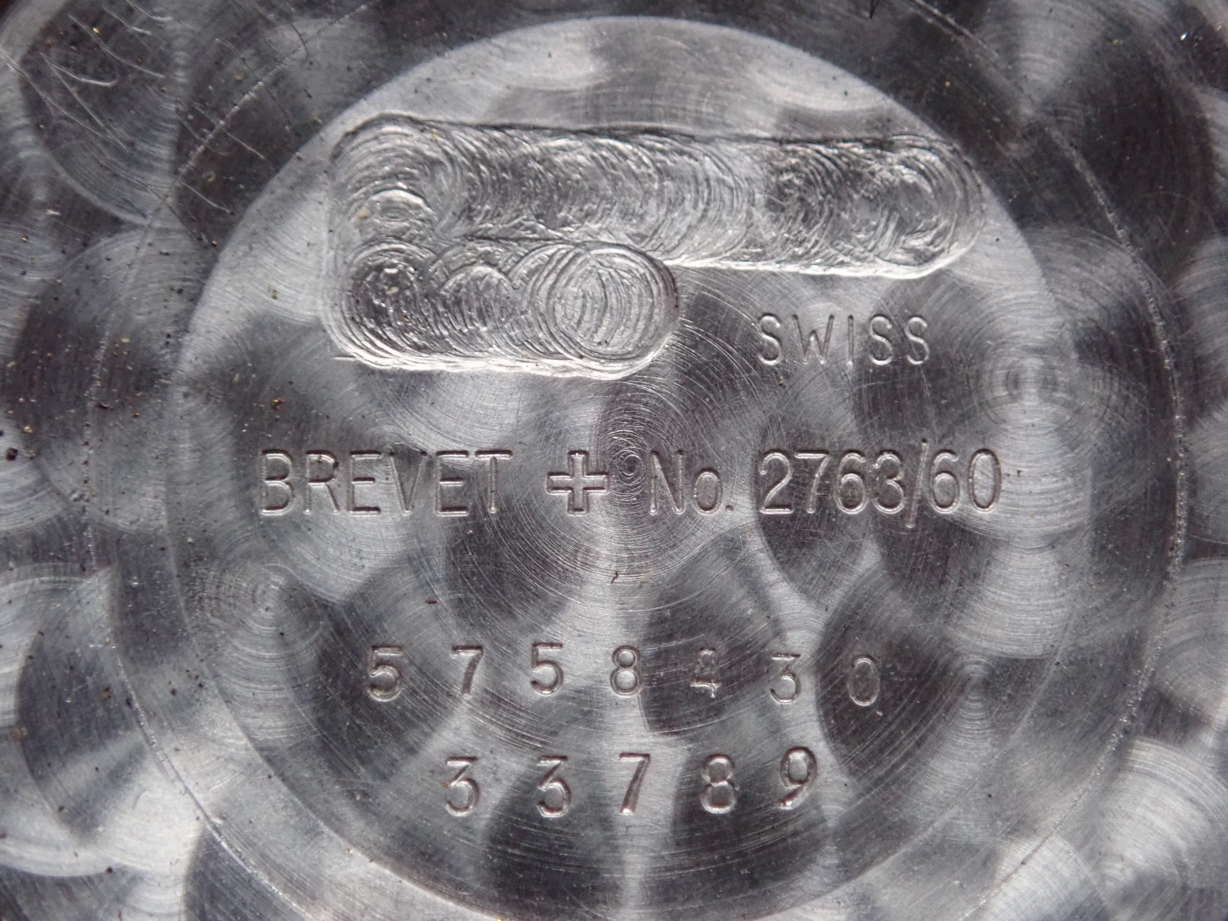

    As I am currently selling a Helvetia dive watch with a built-in depth gauge, I have been approached by a member questioning the authenticity of it. Apparently, all Helvetia divers had a different case construction than mine and that the case construction belongs to a different watch, a Nivada. This is from looking at the "brevet" number on the case back and the theory is further strengthened by the fact that a section of the case back has been drilled out. See photo underneath.
    [​IMG]
    The member, who has had a number of vintage divers with depth gauge through his hands, has never seen one like mine. On Nivadas, the drilled-out section had the Nivada name.
    My own explanation would be that the patent number (brevet) belongs to Nivada, thereby explaining the mix-up. Also, I have tried to do just a little research online and found at least one other marque using the same set-up as my Helvetia, namely a "Heiermann" sold on WUS some 7 years ago (!): http://forums.watchuseek.com/f29/fs-vintage-heiermann-diver-deepswim-depth-gauge-472928.html

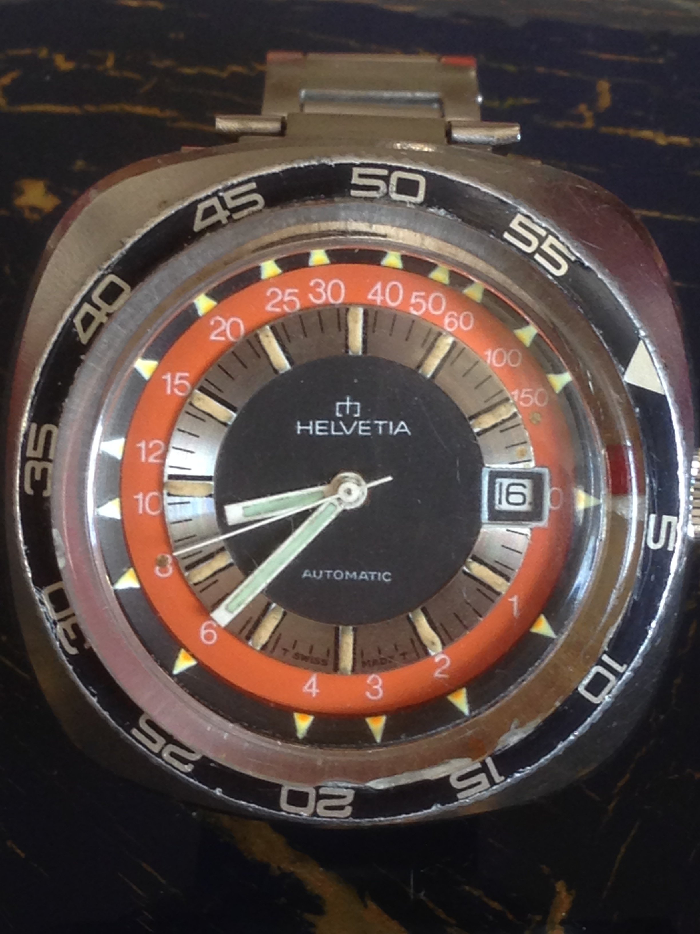

    I have a hard time accepting that mine should be a franken, as it doesn't really make any sense. The other Helvetia depth gauge watches I've seen have all been later, more funky 70's designs with date windows, making a transplant unlikely. Here's one:
    [​IMG]
    ( http://www.vintagewatchclassics.com/product/vintage-helvetia-depth-diver-auto-steel-a-mazing )

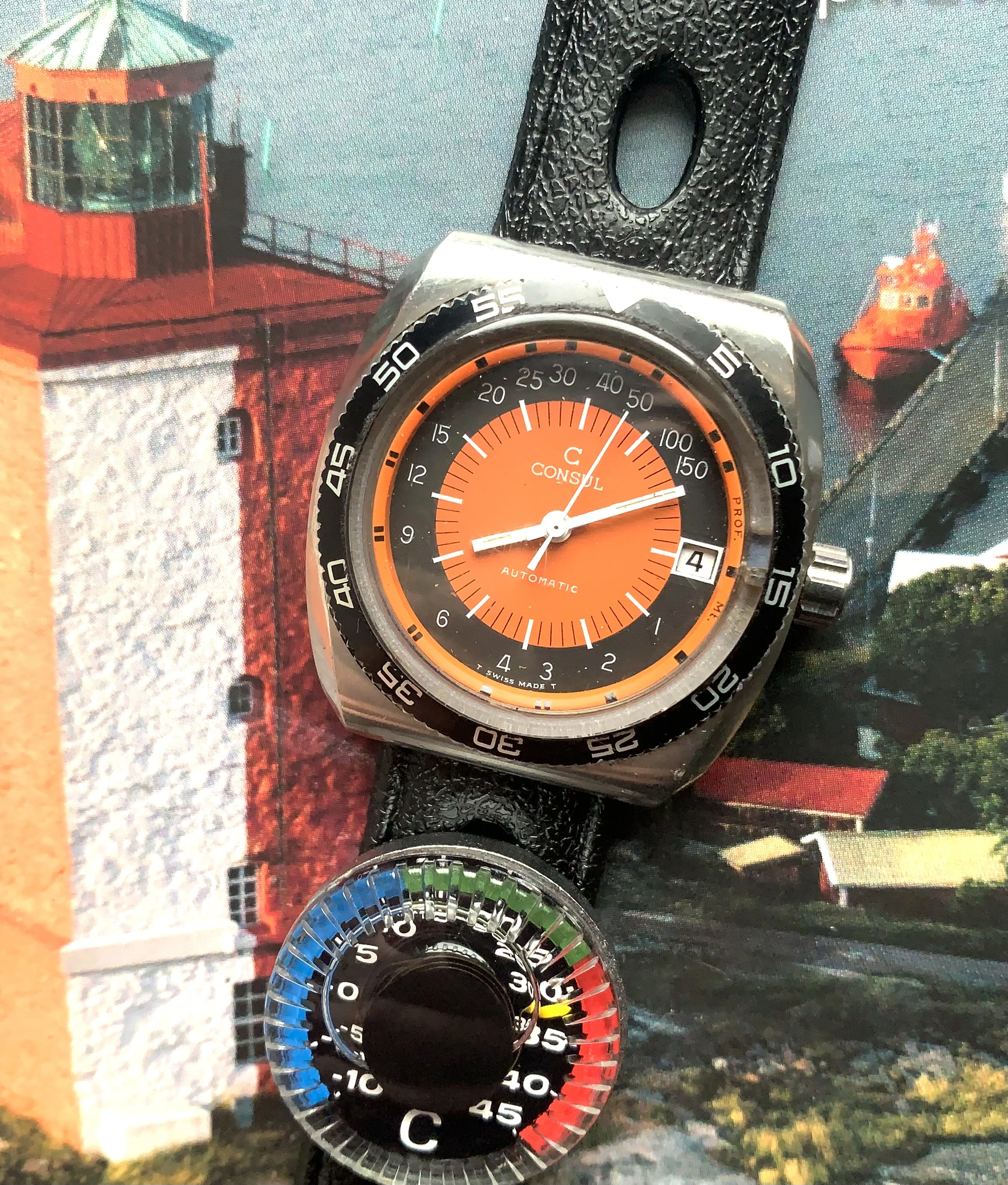

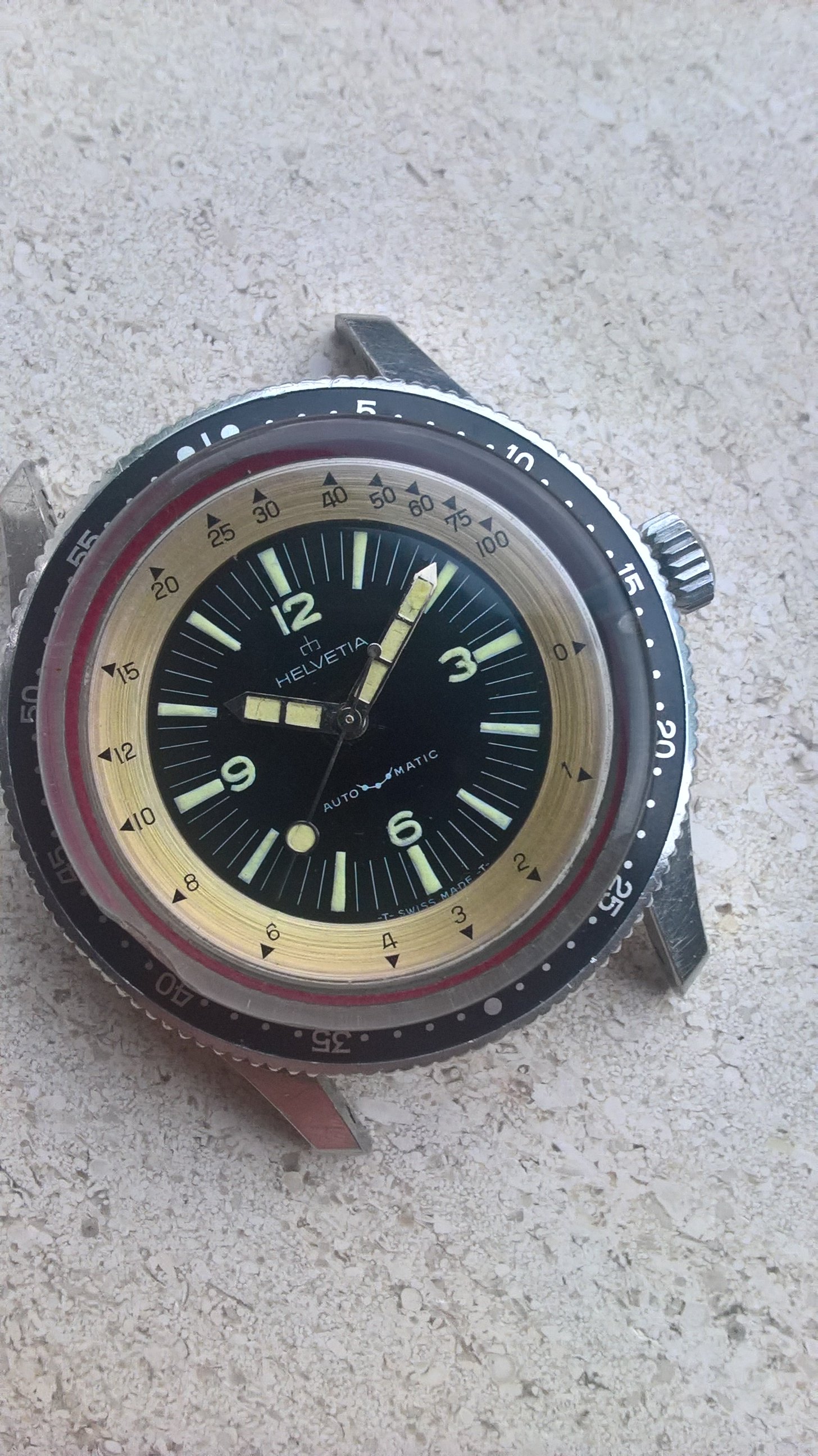

    My own:
    Any comments? Knowledge? Rumours? :)

    What I can tell you is that your Depthomatic is a damn fine looking watch.....IMHO the best looking from those above.
    Can the previous owner shed any light?
    All the best
    Nathan

    Using Hanlon's razor it's pretty easy to come up with a nice explanation for the milled out engraving:
    - Case manufacturer makes cases for anyone with the cash (including Nivada).
    - The guy engraving was working a 12 hour shift
    - Switches over from making Nivada cases to commodity ones
    - is on auto pilot and engraves Nivada
    - realises the mistake, figures no one will ever see/care so just machines away his error
    Fritz likes this.

    I'm not sure about the details, but I agree with @rahilb that the case is likely original.
    If someone wanted to created a watch like this in order to profit, they would have chosen a better known brand. If it weren't for the less professional engraving on the back of the case, I would have bought the watch without any worries about originality.

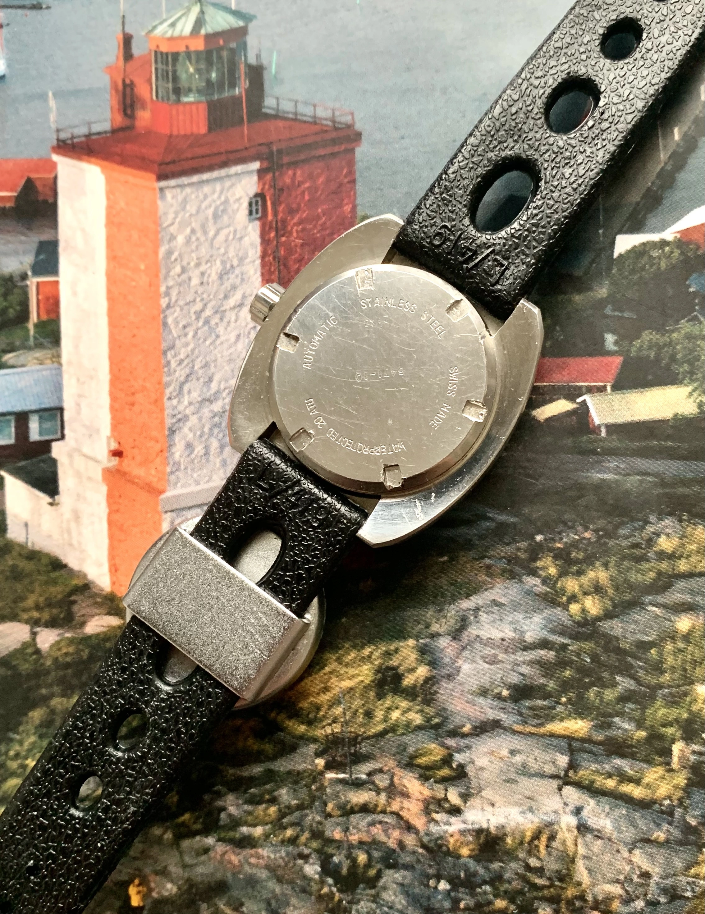

    Hi, you may be interested to know that I have an identical Helvetia Depthomatic. In fact the serial number is 5758430, only 49 away from the one posted by @conelpueblo . My caseback has the same erased section as well. Rather than a one off mistake by a tired casemaker, I suggest that a batch of cases and were sold to Helvetia by Nivada, and the names erased as part of the sale. Avia also made an identical version.
    My watch has had a much harder life than the OP’s and I am in the process of refurbishing it. I’ll post up some pictures when it is done.
    @conelpueblo, thanks for your original post as it really helped my initial research i to this watch.

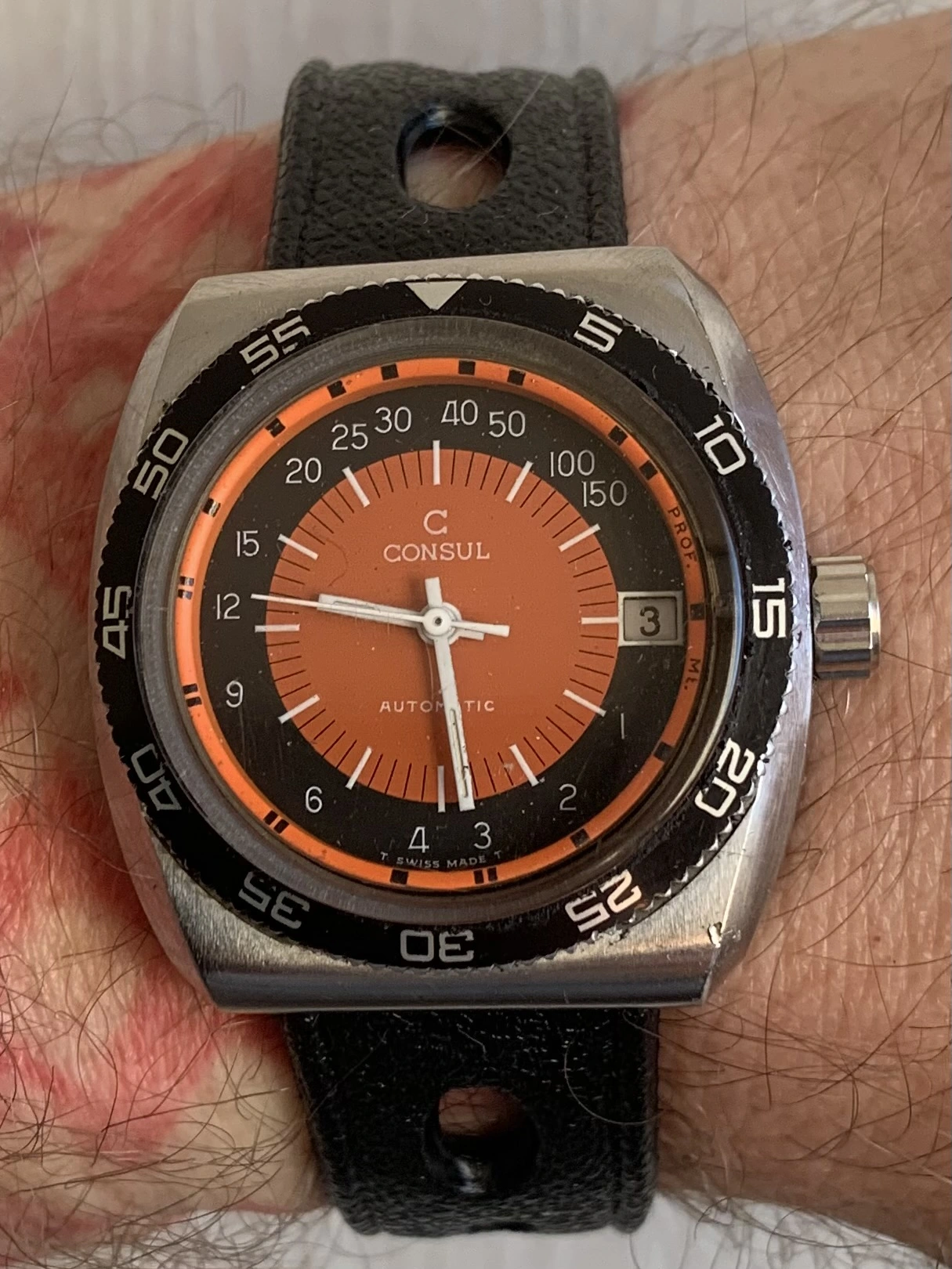

    Well it didn’t look so hot a few days ago when it arrived! [​IMG]
    It looks like this at the moment...
    [​IMG]
    But hopefully all back together soon and looking nearly as nice as yours. Do you still have it?

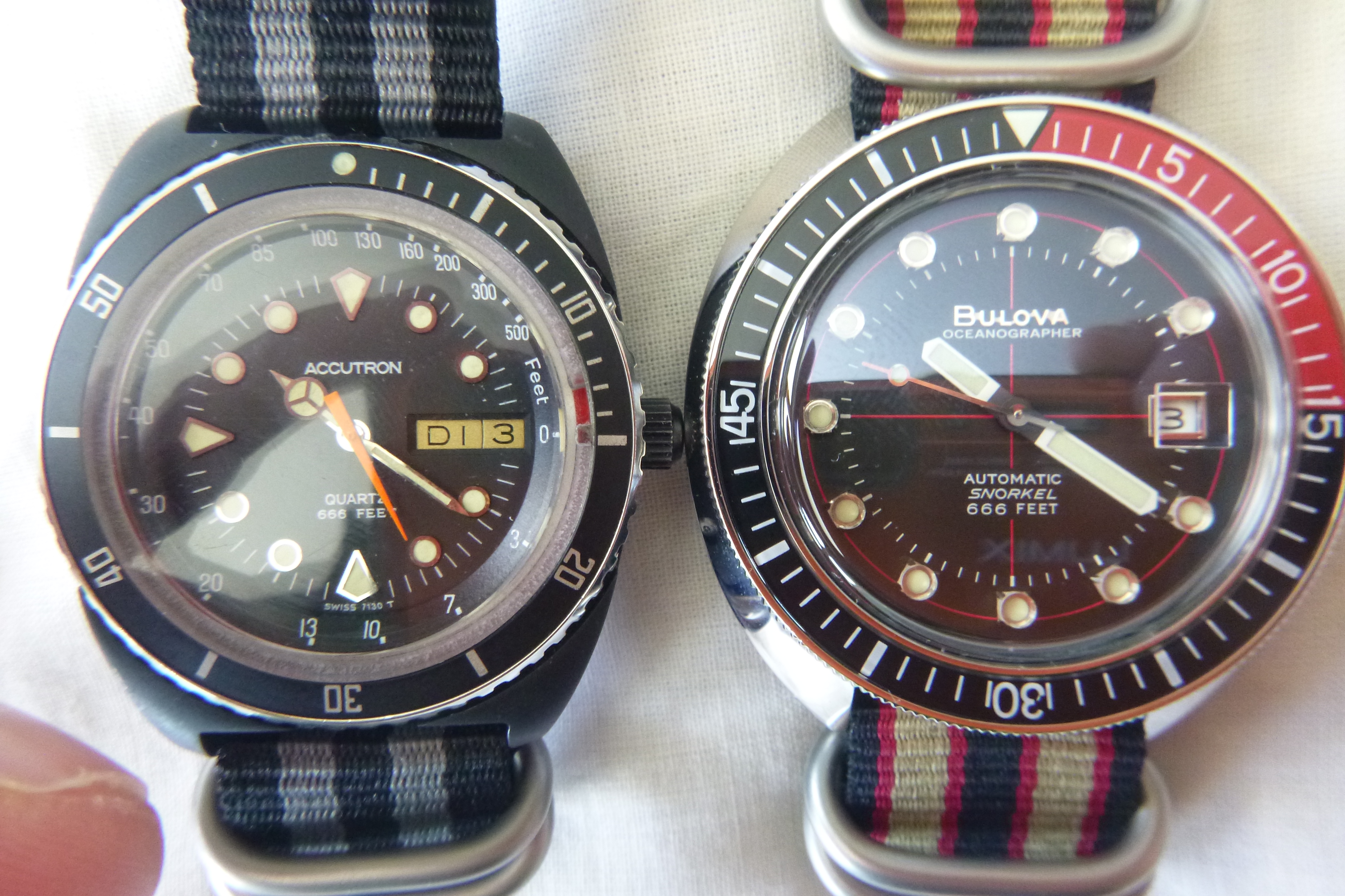

    just to stir the pot, check the lump on the left, from 1980...

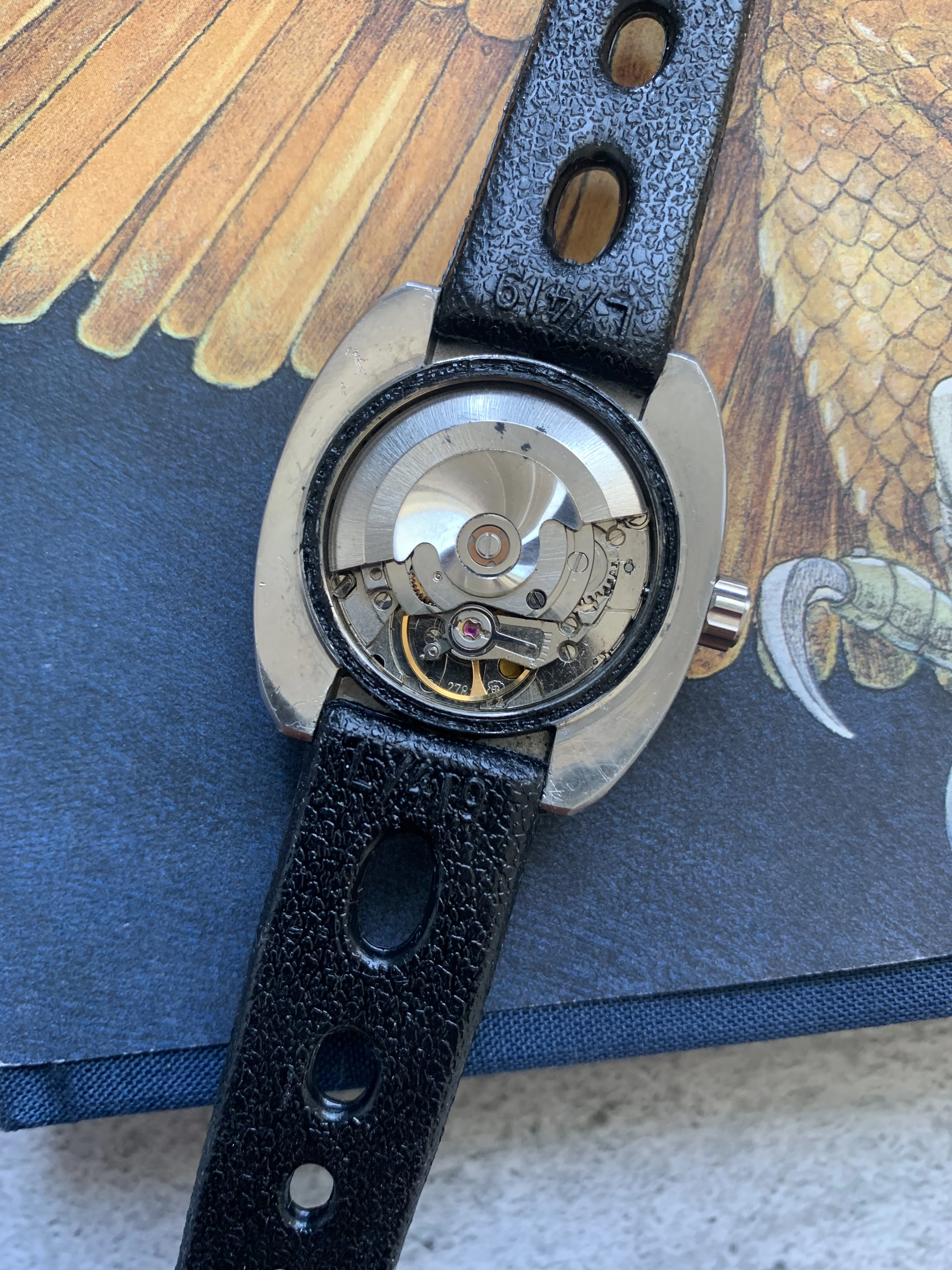

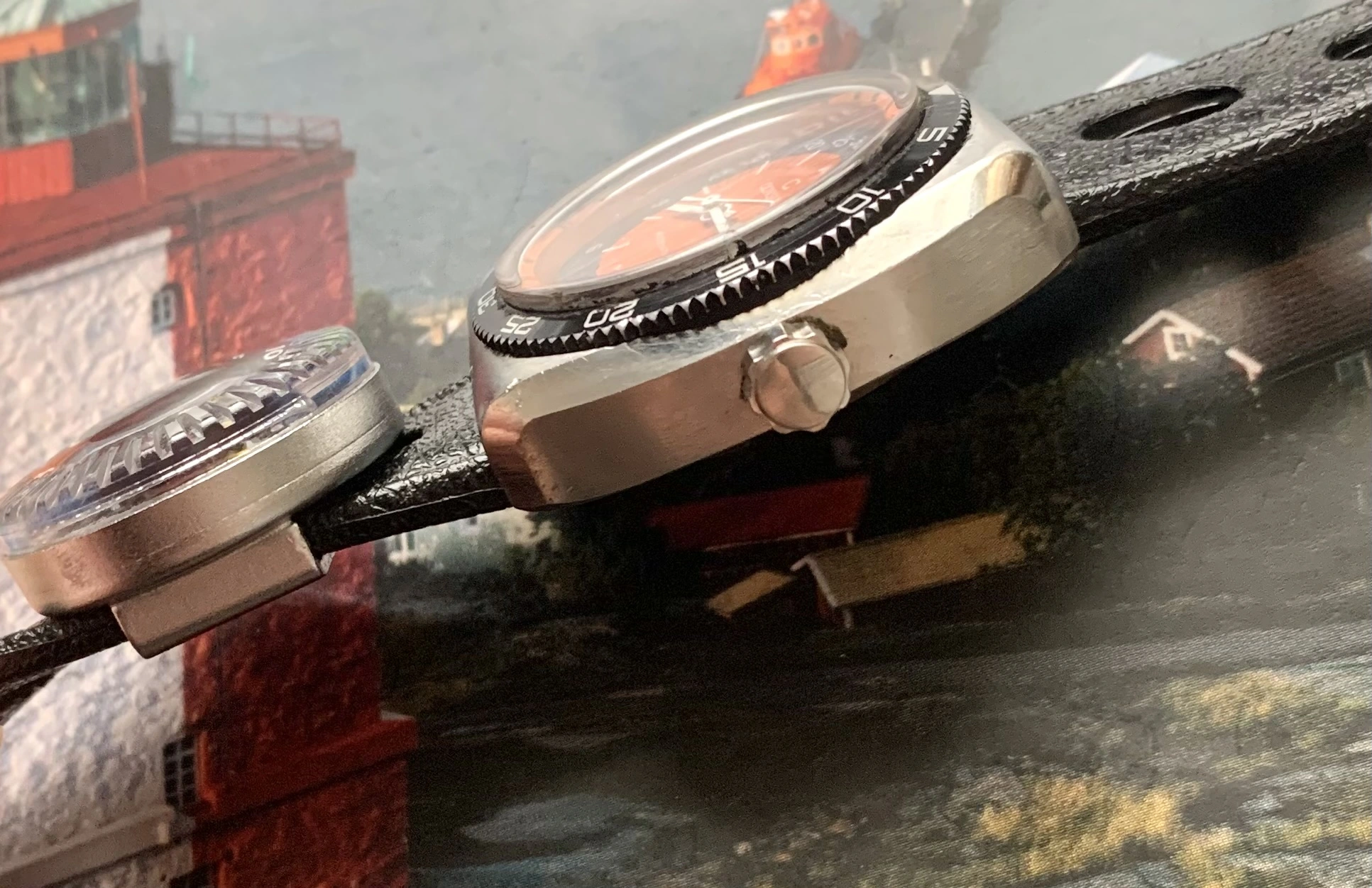

    Hi Carl, we keep meeting :). Yes, it’s the one that was on eBay with the box and guarantee. It didn’t sell there but I did a private deal with the seller via another channel. I had also checked the serial on your site and 1968 is bang on for this type of watch.
    My watch needed a fair bit of work as the bezel was stuck and the capillary tube in the crystal was blocked. This is it part way through cleaning; the original state is too gruesome to show
    [​IMG]
    It has clearly been heavily used, which I like, definitely not a safe queen. The dial has been heavily tropicalised.
    It runs OK, I just need to make the time to recase it. The crystal went back in with a satisfying snap so who knows, it may even have some water resistance if I can change the gaskets on the crown and caseback.

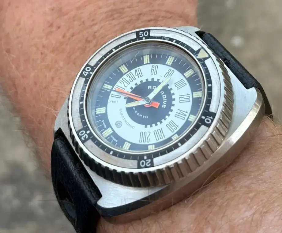

    My Helvetia Depth Gauge
    Helvetia History and alfat33 like this.
