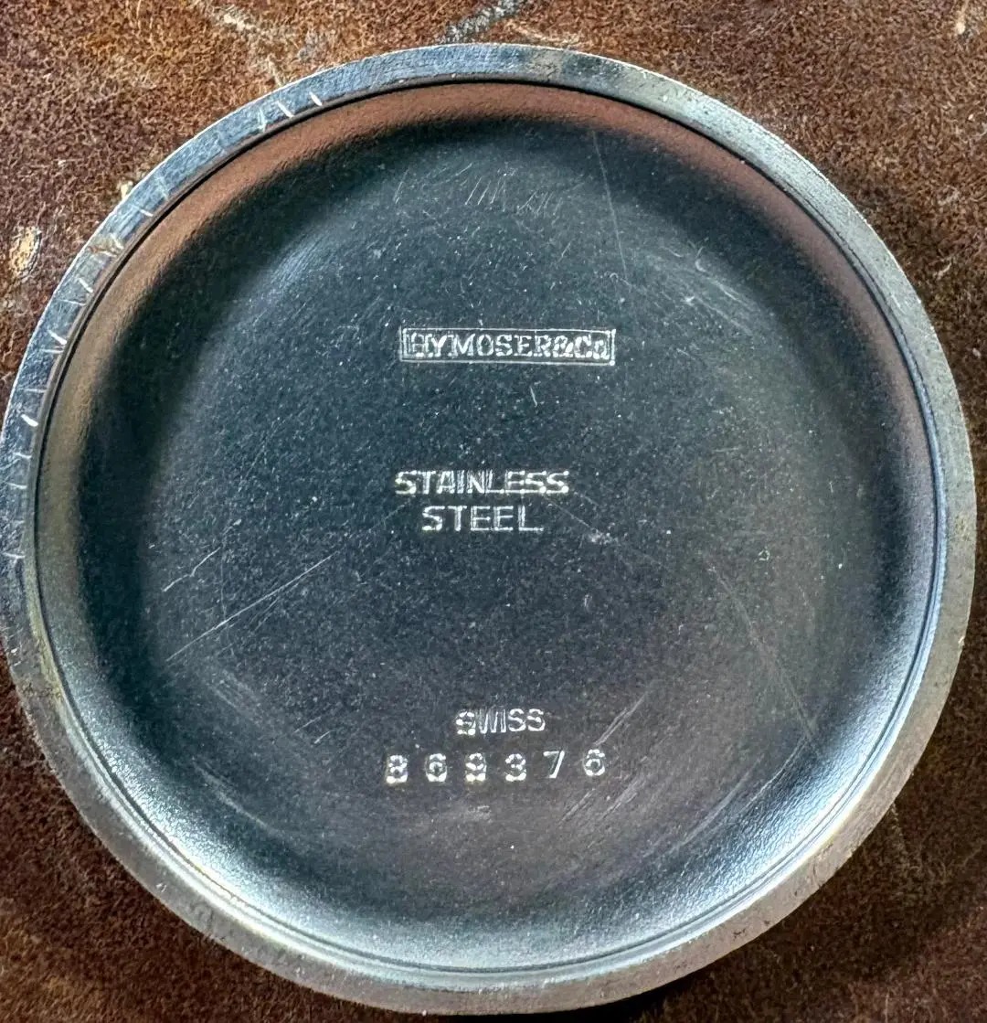

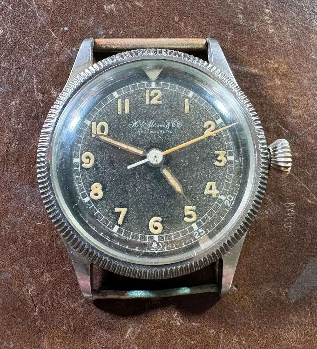

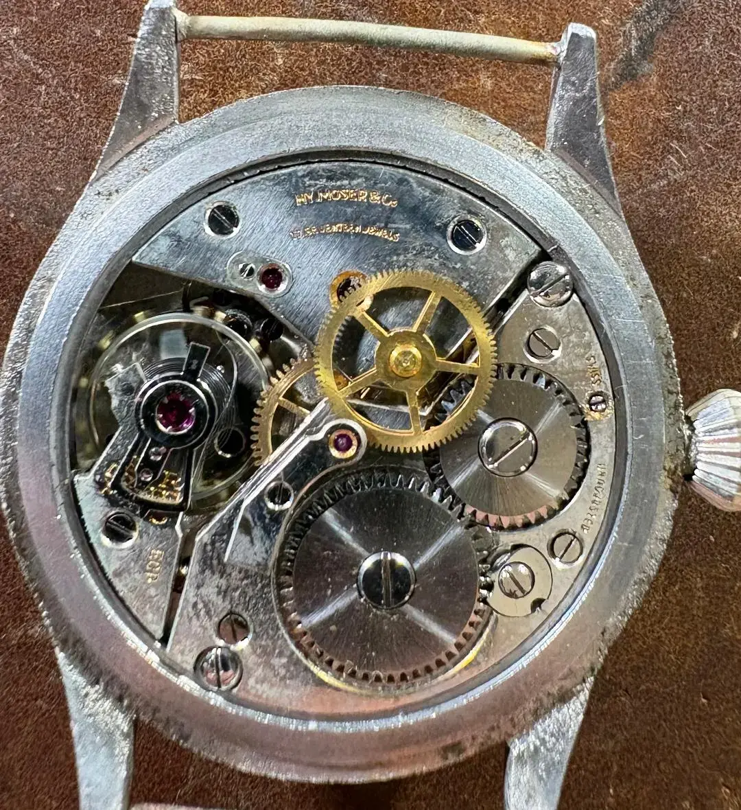

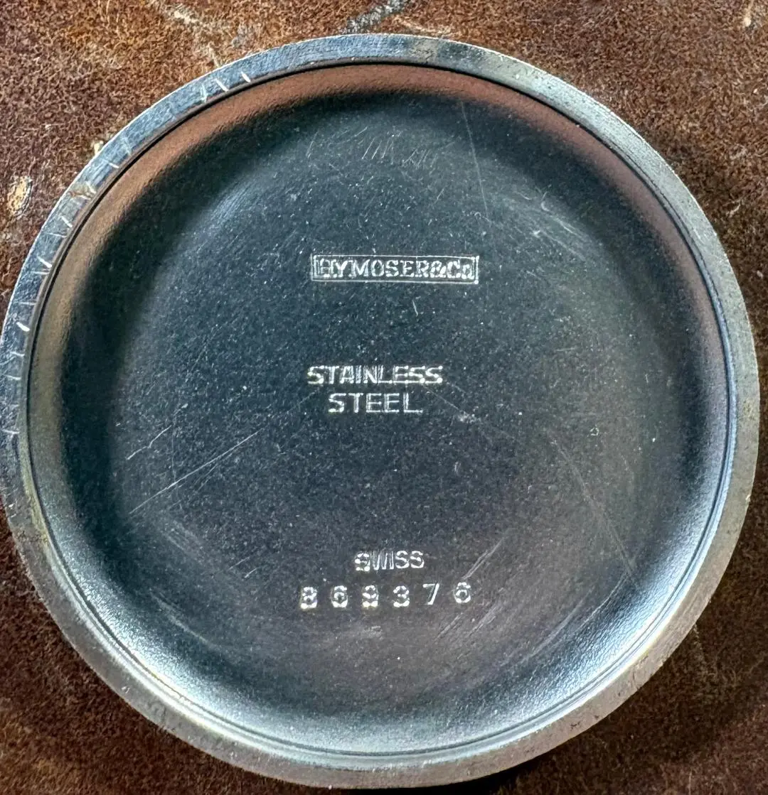

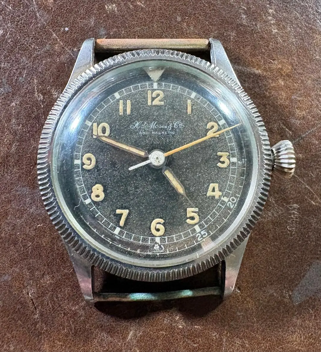

So the bi-annual Round Top Texas Flea Market just started. I picked up this Moser & Cie pilot. A quick search on the web turned up nothing. I thought, ok, someone added the name to the dial but then found the case back and movement also signed. Cool looking is why I bought it. I had suspicions of authenticity so I didn't pay much for it. The case is a little over 36mm. No question that the age is there. I cleaned up the case, crystal and added a crown. Looked very crappy when I bought it. I would appreciate any information / feedback from the collective 😀

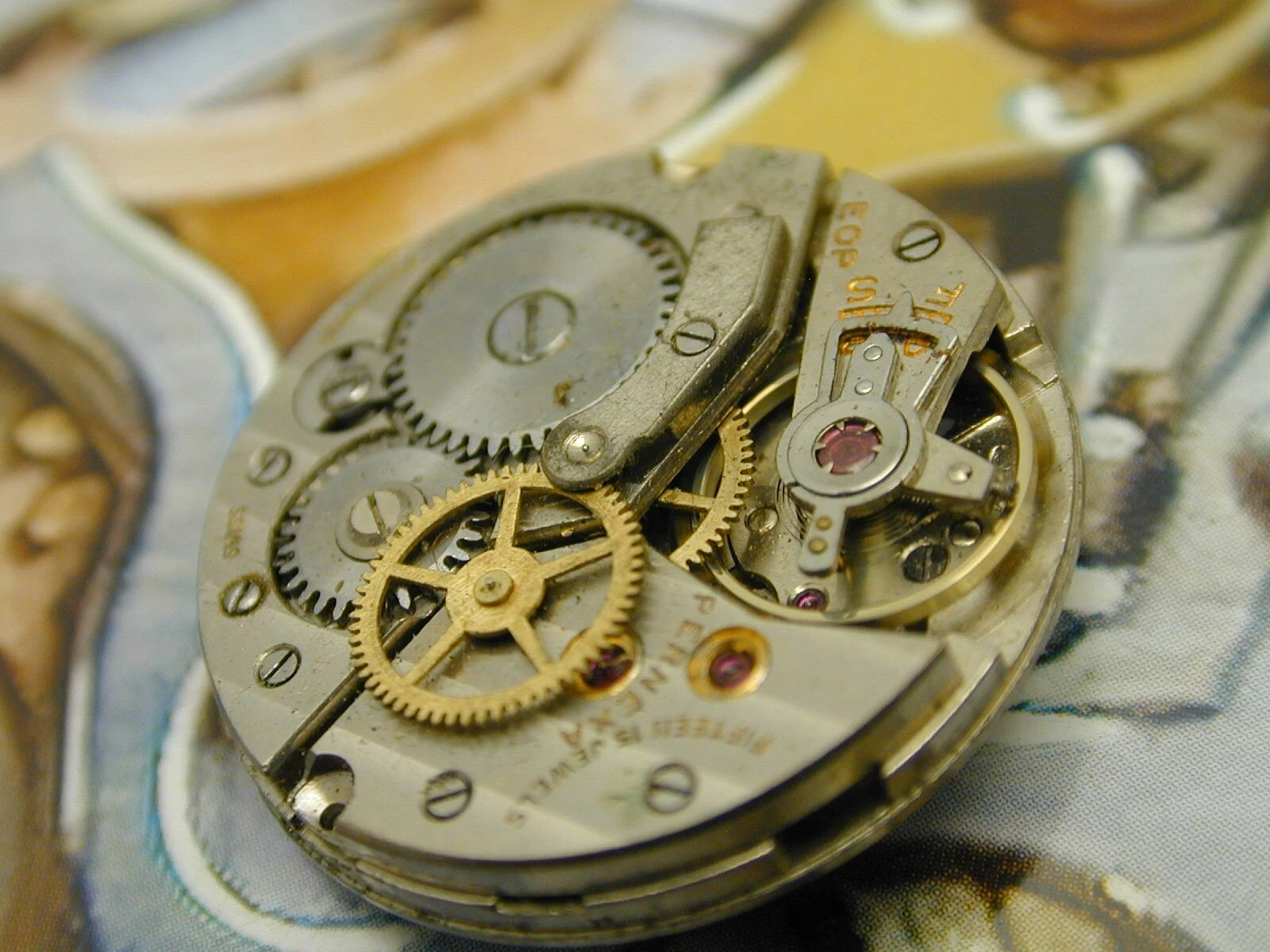

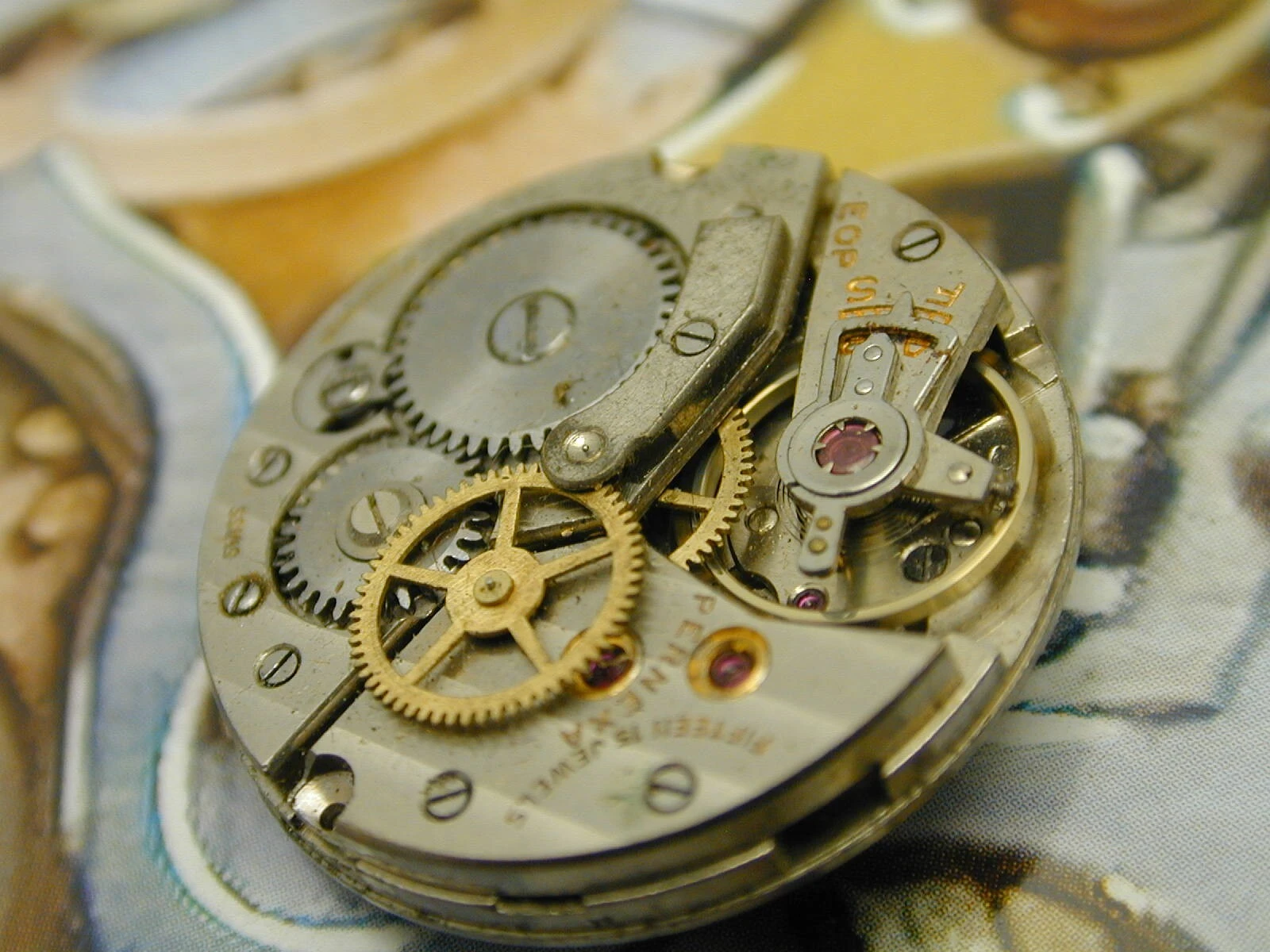

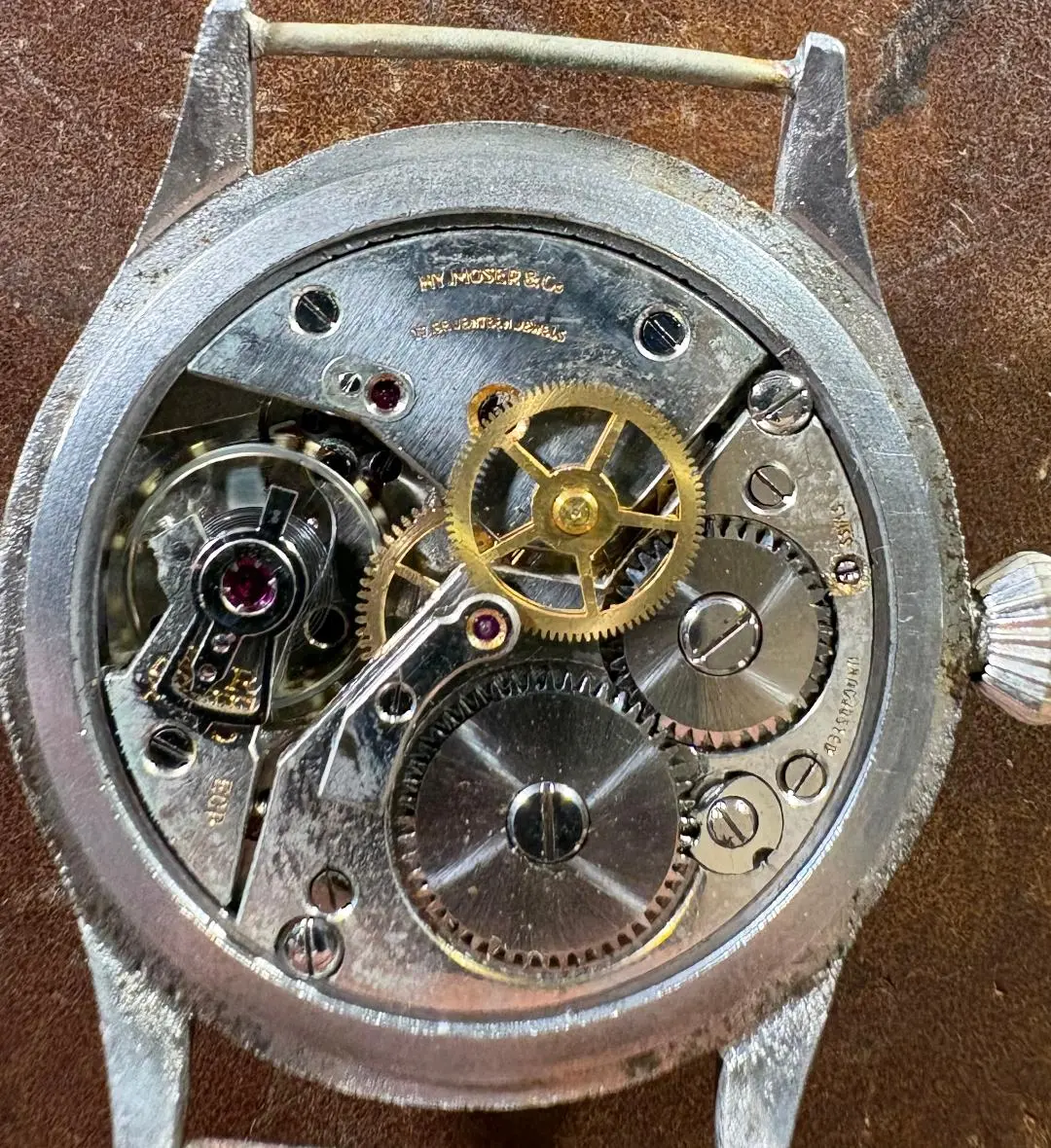

The import code on the balance looks like EOP which was Paul V. Eisner & Co - Adina, Alpina, Harvel, Rennsie.
Hy Moser & Co was DXZ, but there could have been other importers at the time besides whoever represented Moser.

PS: Looks to be a caliber 188 by Unitas.
Pic from eBay also with EOP import code.

Looks wonderful… great pick up. From what I’ve read the current co is a revival brand …
