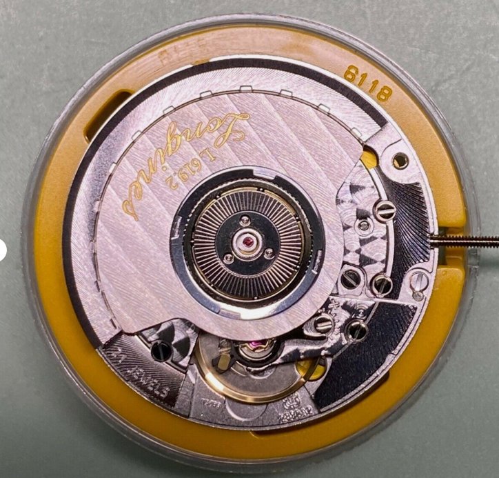

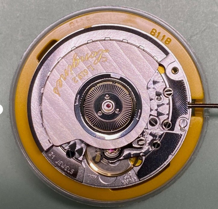

Here, in contrast, is a Longines, and the difference in finishing is striking:
https://www.ebay.ca/itm/293659850669
