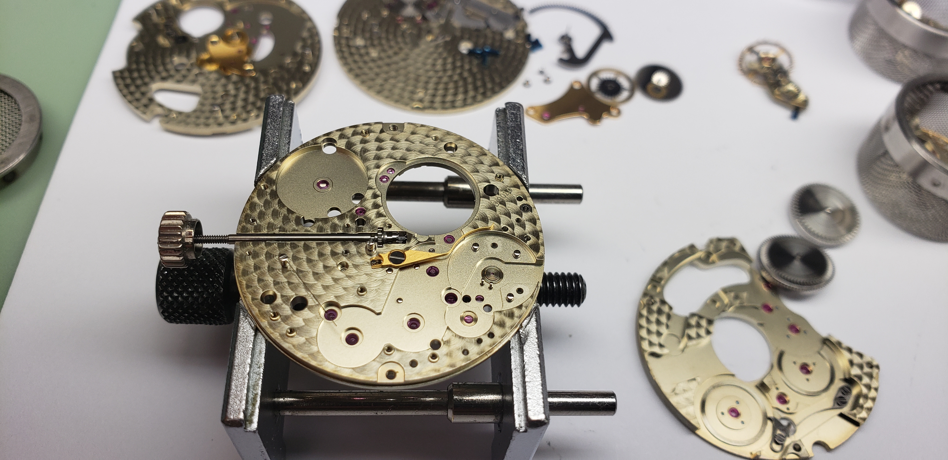

Surprising lack of decoration in some areas...
1,501
5,694
Can you point out which areas you find disappointing? Happy to learn.👍
30,353
78,310
Sure...

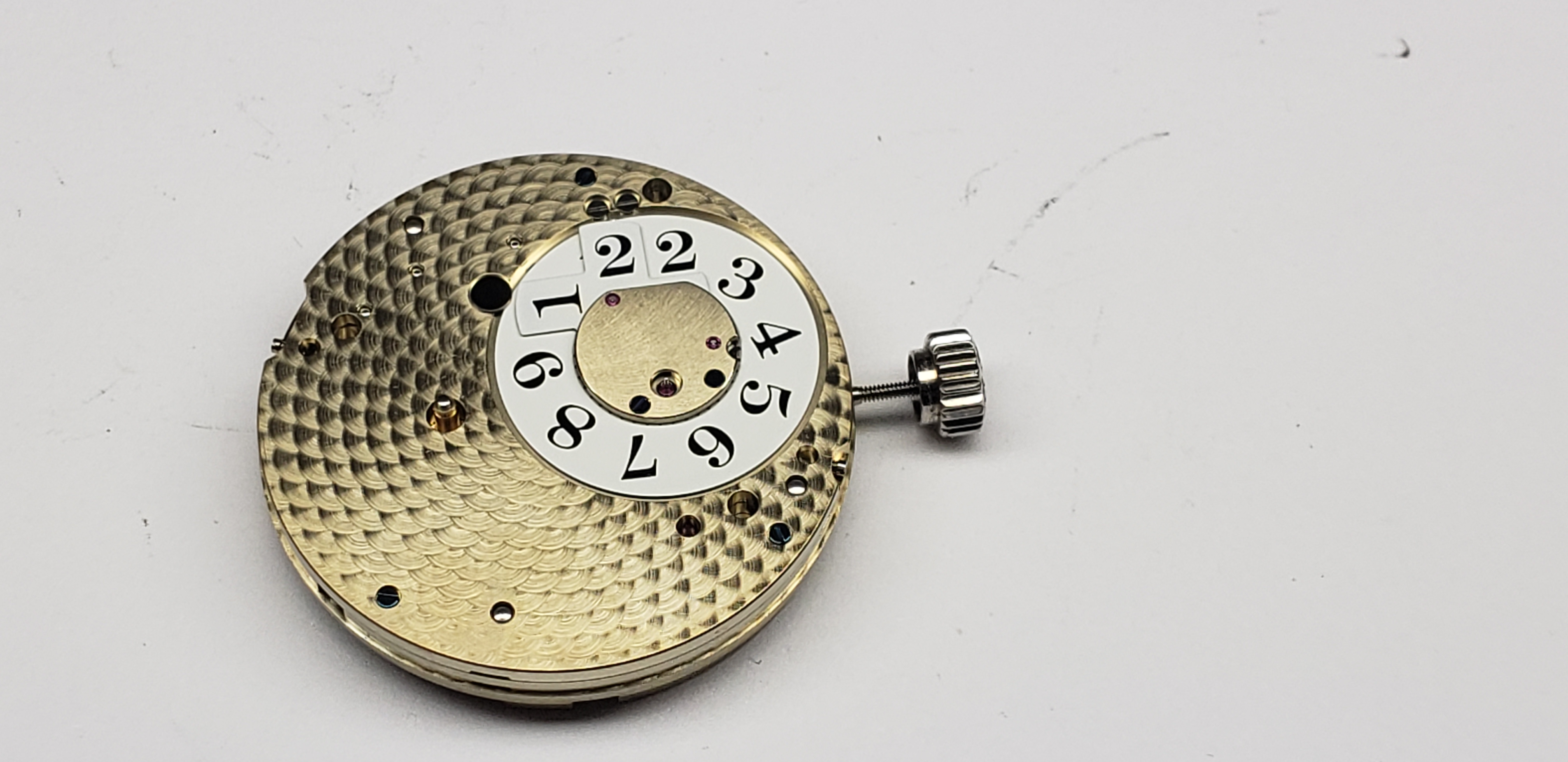

ALS is often considered to be as good or better than even Patek, however the extent of the perlage is lacking in these photos when compared to a Patek main plate:
Note these are not done yet - I took the photos just after the perlage station so additional steps are done after this. But this drawing gives you an idea of how completely the finishing is done in this operation:
Completeness is not the same as quality of course, but I was surprised to see significant areas that were left unfinished.
Cheers, Al
1,501
5,694
Sure...
Cheers, Al

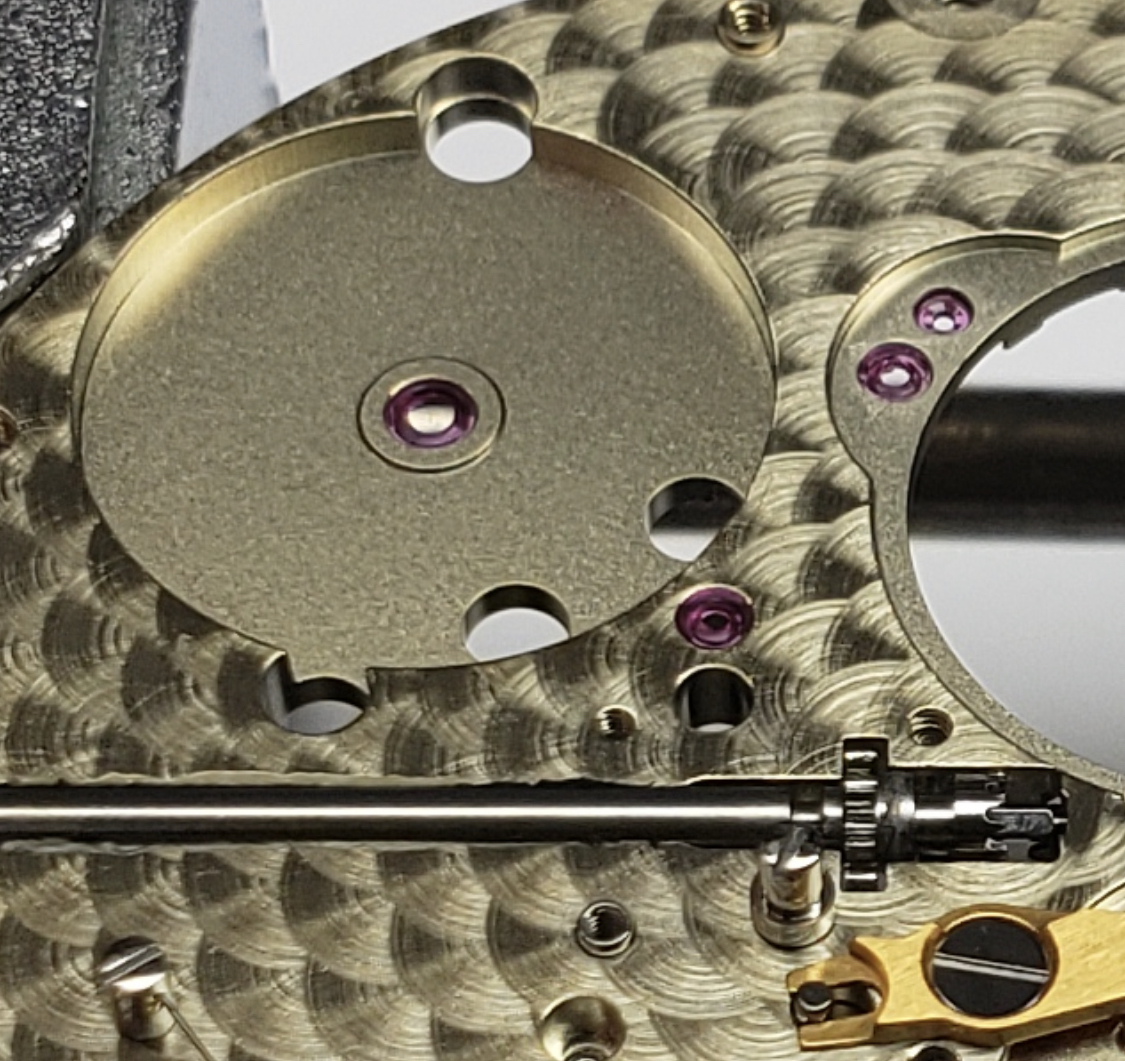

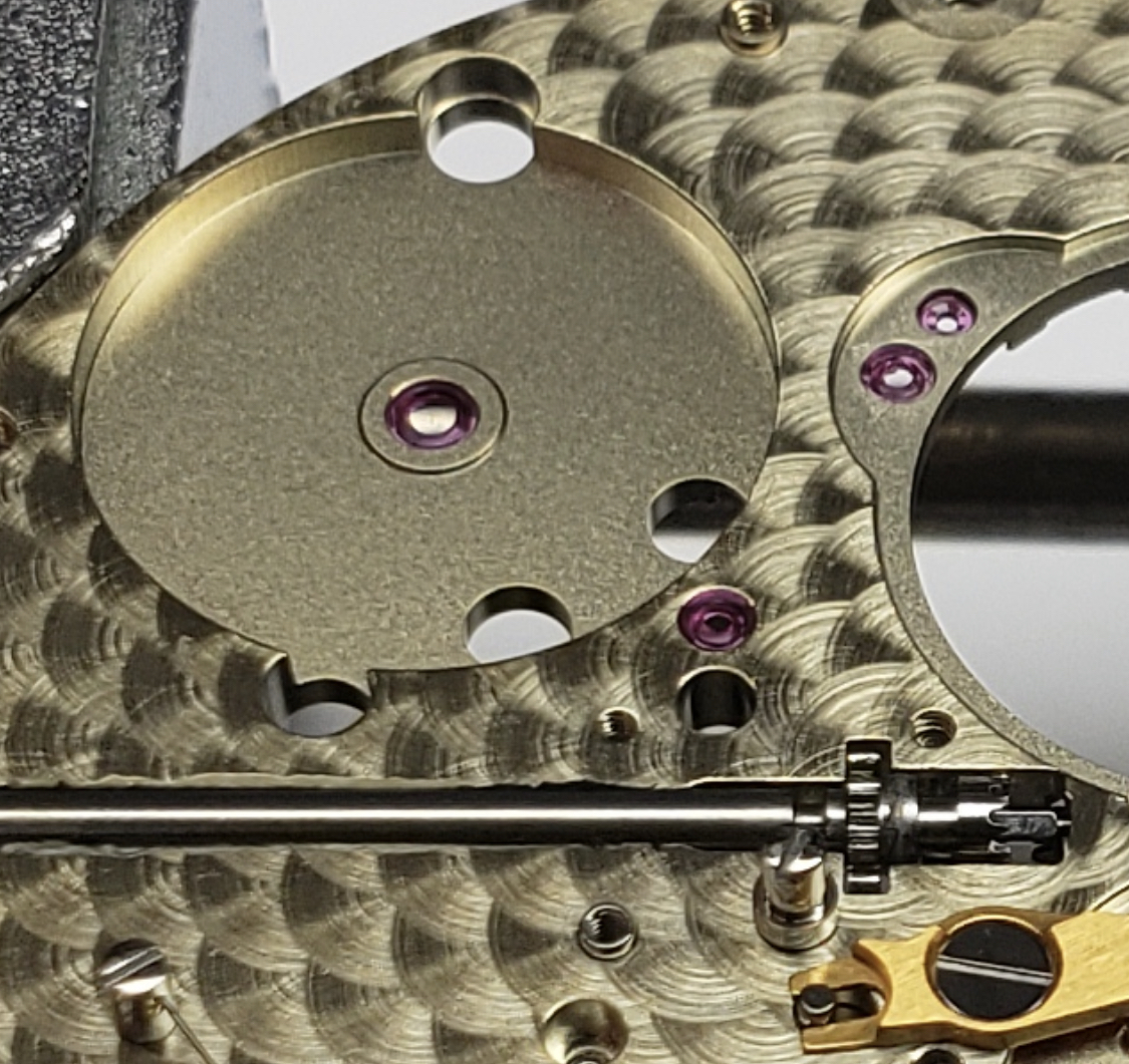

Is that not a frosted finish?

It sure looks like ALS did some kind of finish on these parts!
I’m not sure whether this “frosted” finish or perlage like om Patek is more special? The perlage does stand out more...

No, it's just cost cutting. The same as this is on a Panerai...
What people are calling a "frosted" finish is what the surfaces look like after preparation for finishing, after machining marks are removed.
One man's "frosted" is another man's "unfinished" I guess...
Cheers, Al

I don't know that I can tell you of a mass market brand that highly finishes every single watch in their line-up. As this thread shows, to some degree or another there is variation in the level of finishing between models. I showed the main plate being decorated fully at Patek, but I've serviced some Pateks that are not finished completely like that one is.
In all of the factories I've been through, there are areas where the high complications are worked on that are separate from the main workshops. For example at JLC the original farmhouse is where a couple of watchmakers work on the high complications that are apart from the regular production. Same thing at Blancpain when I was there. At the Patek factory, it was clear that the mass produced models used different finishing techniques than the more high end models. My assumption (I've not been through every manufacturer's shop obviously) is that most brands work this way.
Cheers, Al

It's up to each of us to decide what we find acceptable or not given the price of a specific model. If you are not used to seeing the inside of watch movements, then this certainly may look like some sort of high quality finish, but it's very common for plates to look this way after machining marks are removed. Are there watches with even less finishing? Yes, of course, but this is sort of the minimum step any respectable brand would do to remove the marks left behind by the end mill from the initial machining of the plate, and certainly isn't any sort of high end decoration.
If brands are doing this on mass produced movements that cost just a couple hundred dollars, I have a hard time considering this any sort of high end finish in those areas, but that's just me I guess.
