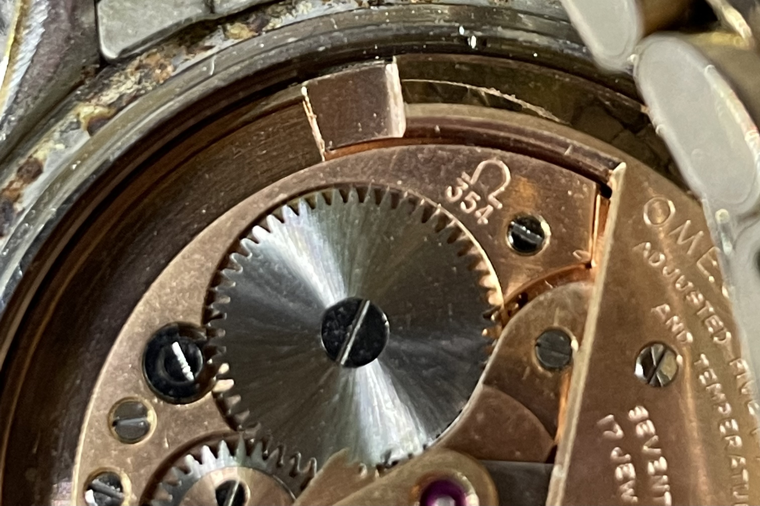

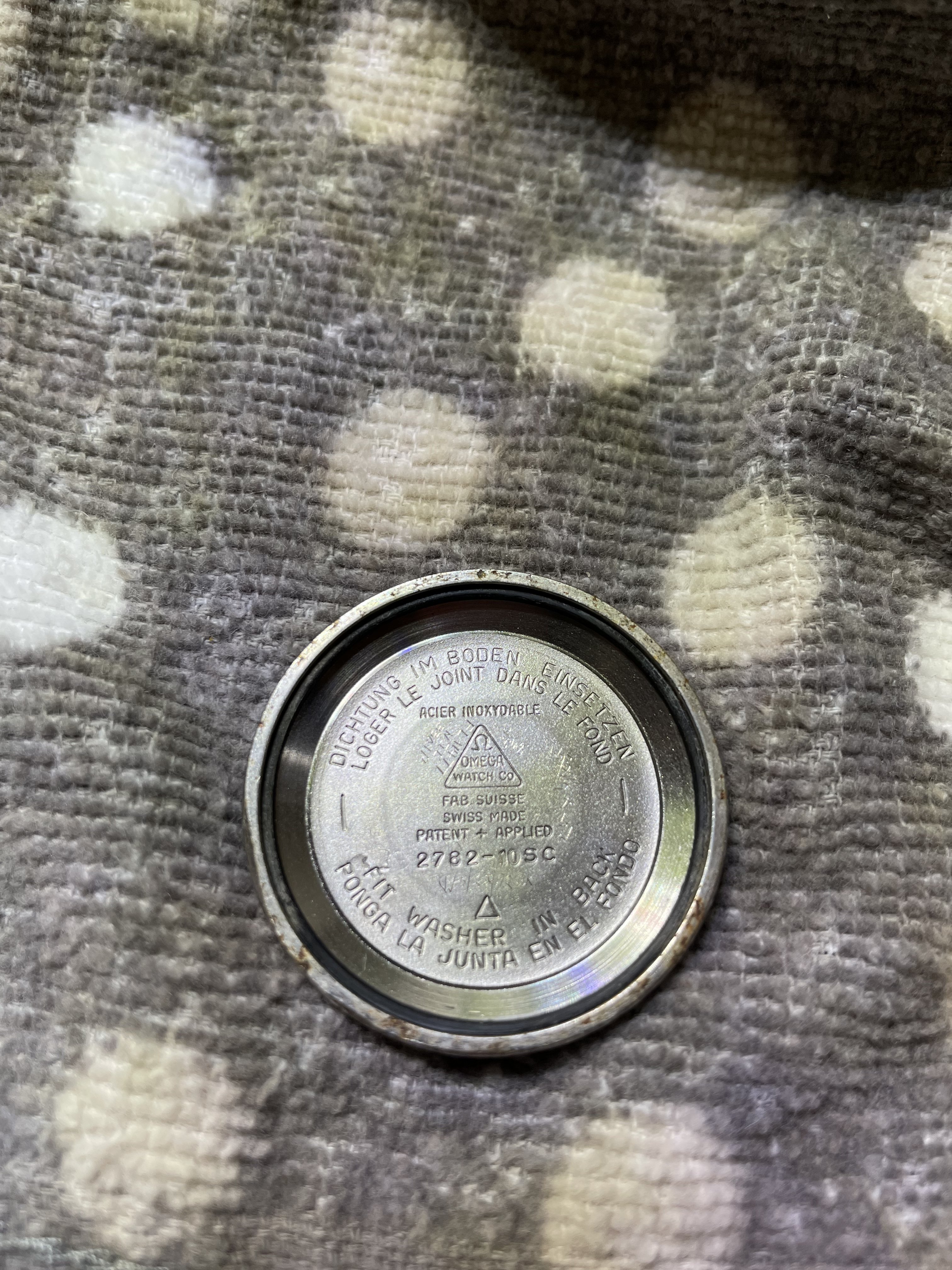

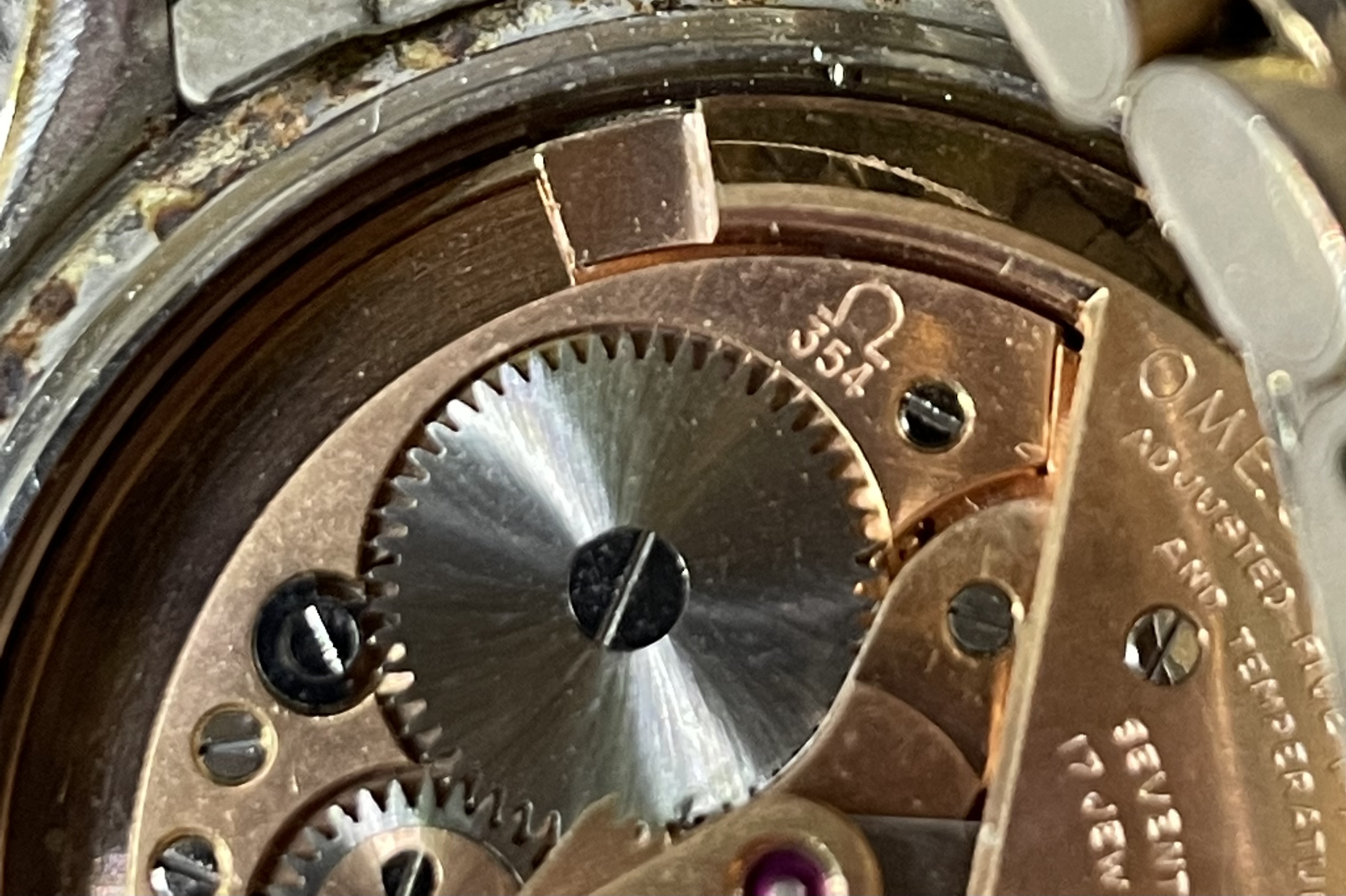

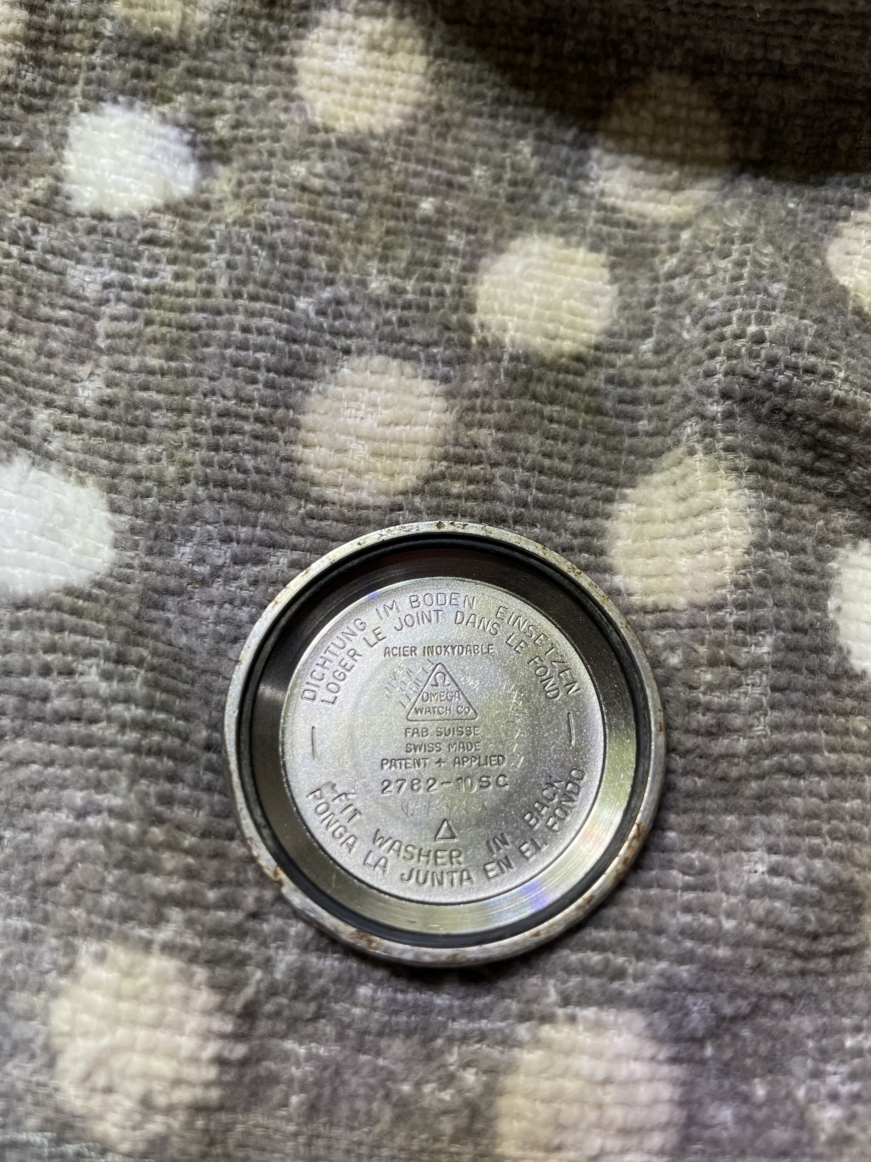

I recently inherited this omega constellation. It was my great grandfather’s who purchased it new. From what I can tell, it’s from the 50s and is the gold capped style.
The watch band was severely corroded and the watch itself wasn’t working. My father had it serviced to restore the functionality (no major damage was found) and the band was salvaged as best as it could be. Aside from the internal service and band cleaning, nothing else has been done to the watch. The bottom of the case has the numbers “51499” etched into it and there is a small scratch on the glass. Otherwise, most blemishes seem like they could be polished out.
Unfortunately, I don’t have a picture of the inside of the watch, but I plan on getting one as soon as I have a professional open it up.
I have no intentions of selling this watch as it’s sentimental value is far greater than its dollar value, but I’d love to know any information about the watch that you all might be able to provide (identification, dating, model numbers, servicing / maintenance / restoration advice and valuations). Thank you in advance!

It's presumably a ref 2852, almost certainly from the late 1950s; it looks to be in great shape. It'd have a cal 505 inside, and it looks to have had its crown replaced at some point.
For a service: please don't get it *restored*, as most watchmakers would take that as a sign they should polish the case and work on the hands and dial. This is a good example of a fairly highly regarded model, and should be left as original as possible. Request a crystal polish and a movement service, and that's it; the case, dial and hands should be left alone. If you tell us where you are, members here can likely recommend watchmakers near you.

It could also have a 19 jewel cal. 501 inside. Both movements were used by Omega for this reference.
I have seen so many older Constellations with the “clover” crown, I tend to think that it was original or at worst a service replacement. The 10-sided crowns should be available if you want to swap it out.
Otherwise, you have a nice original Omega watch. We all will be interested in seeing what is inside, so please bring a camera when you visit the watchmaker.
