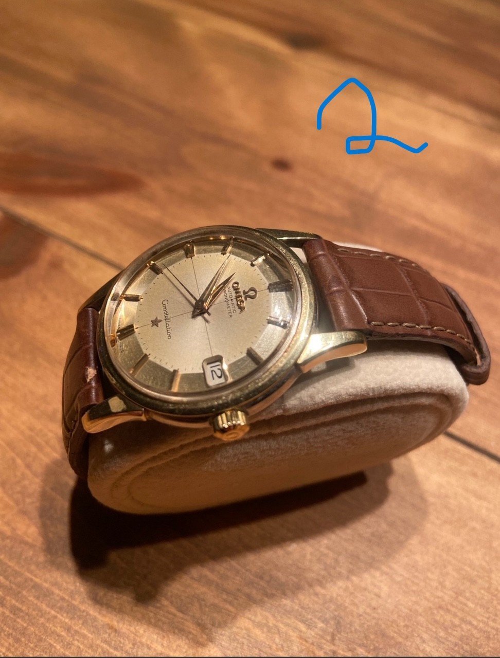

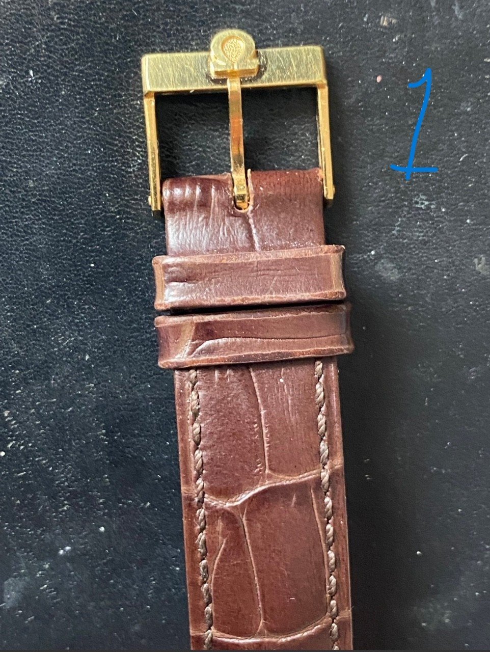

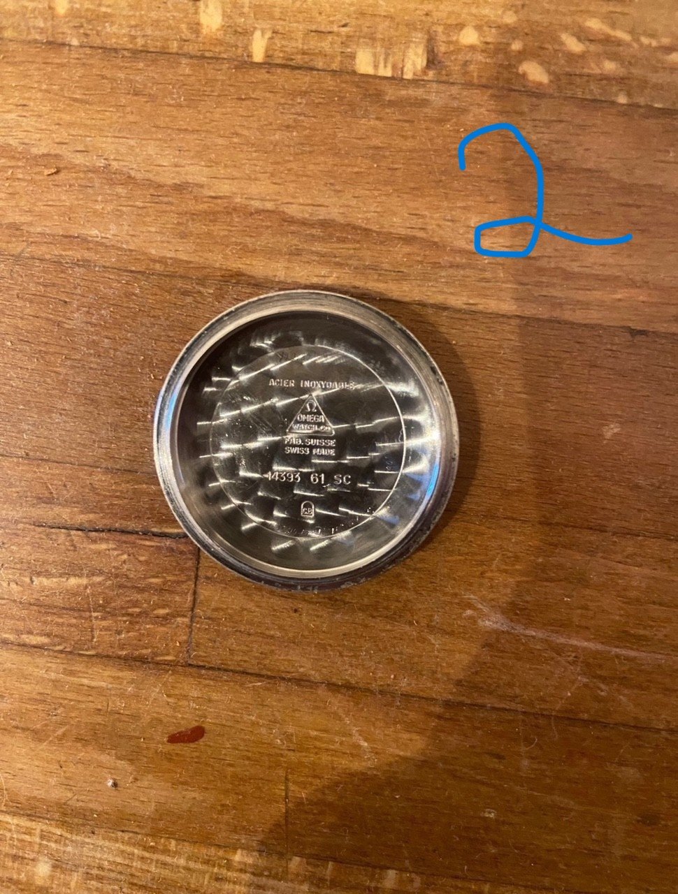

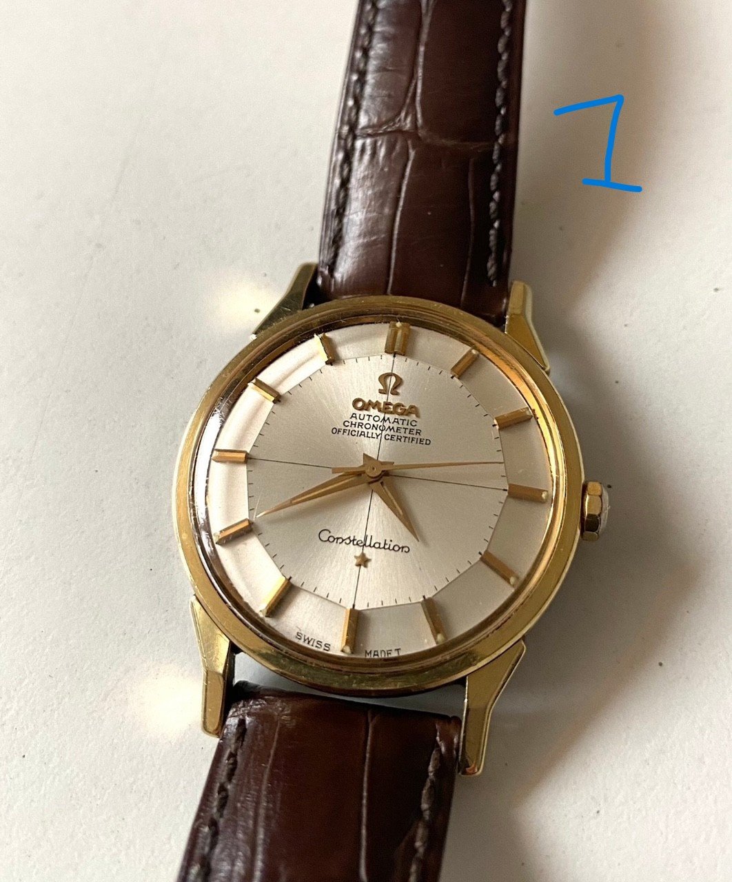

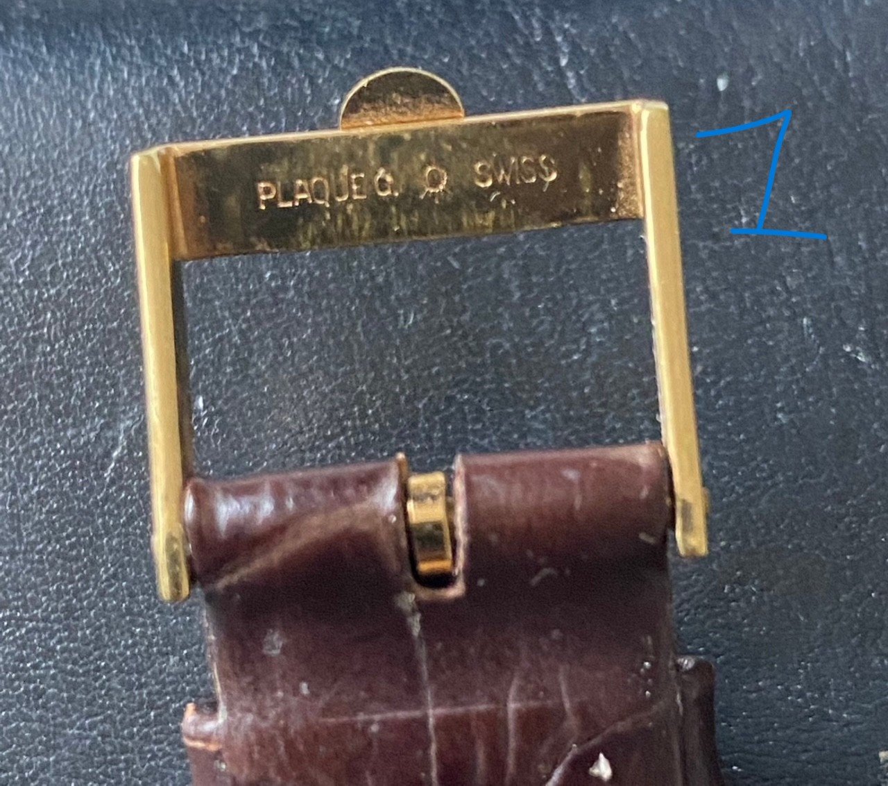

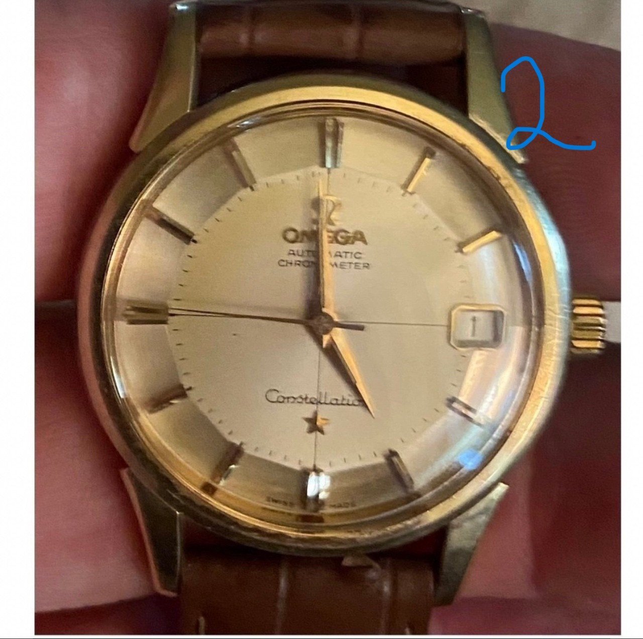

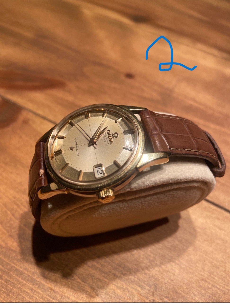

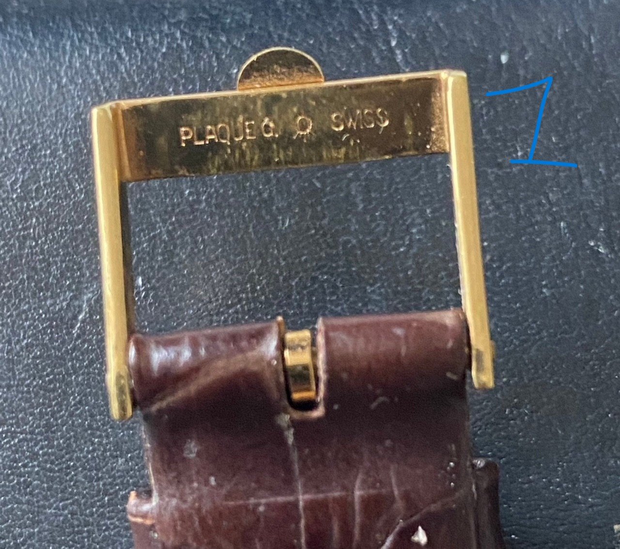

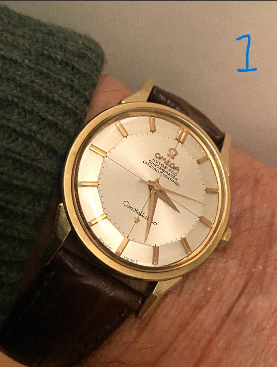

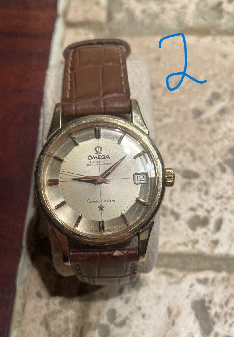

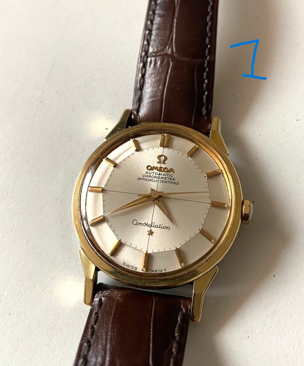

I'm looking for some advice on two auctions that i have looked at and tips for how to determine the value and if it's a good price or not. Will attach pictures marked with 1 or 2 depending on what auction it relates to.

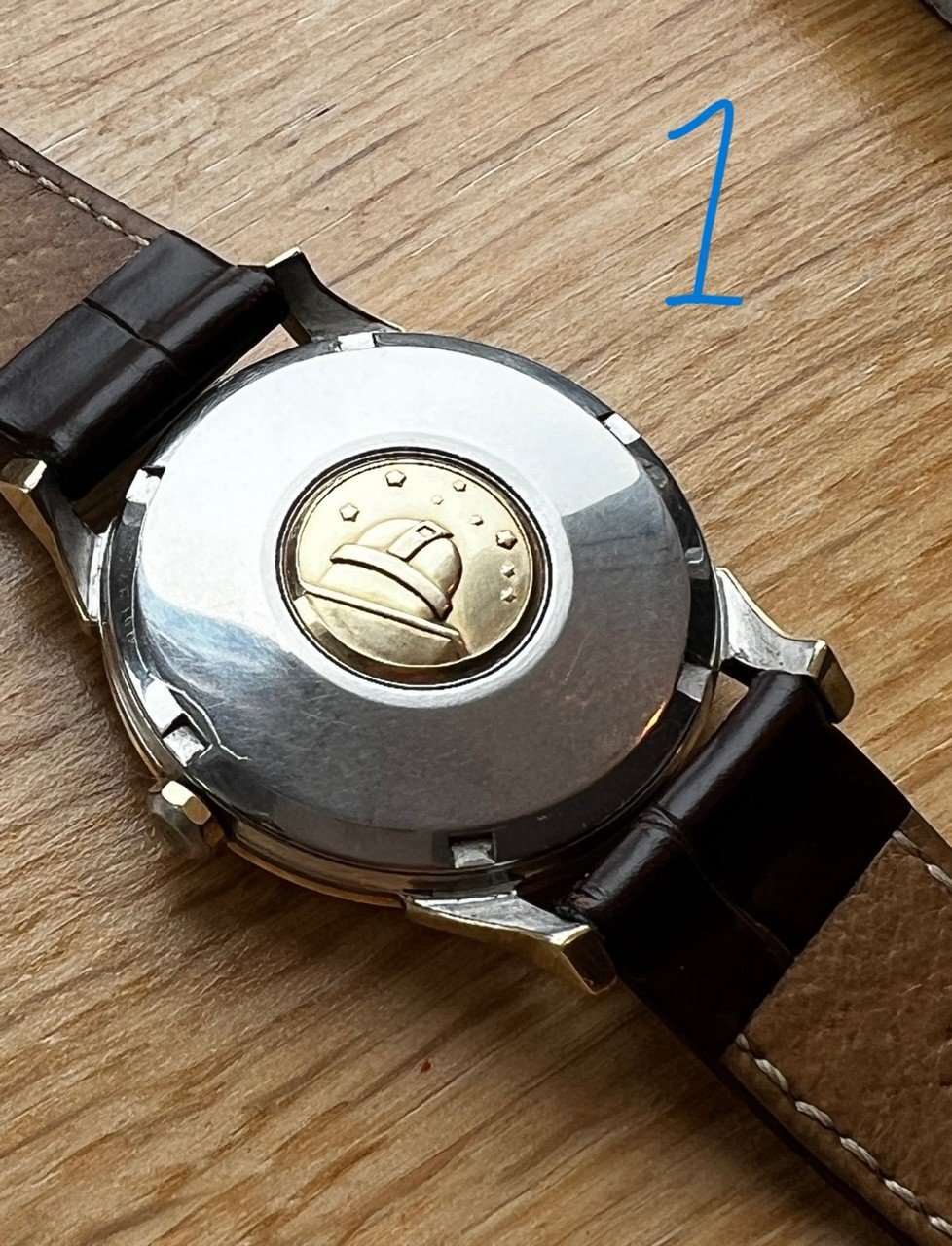

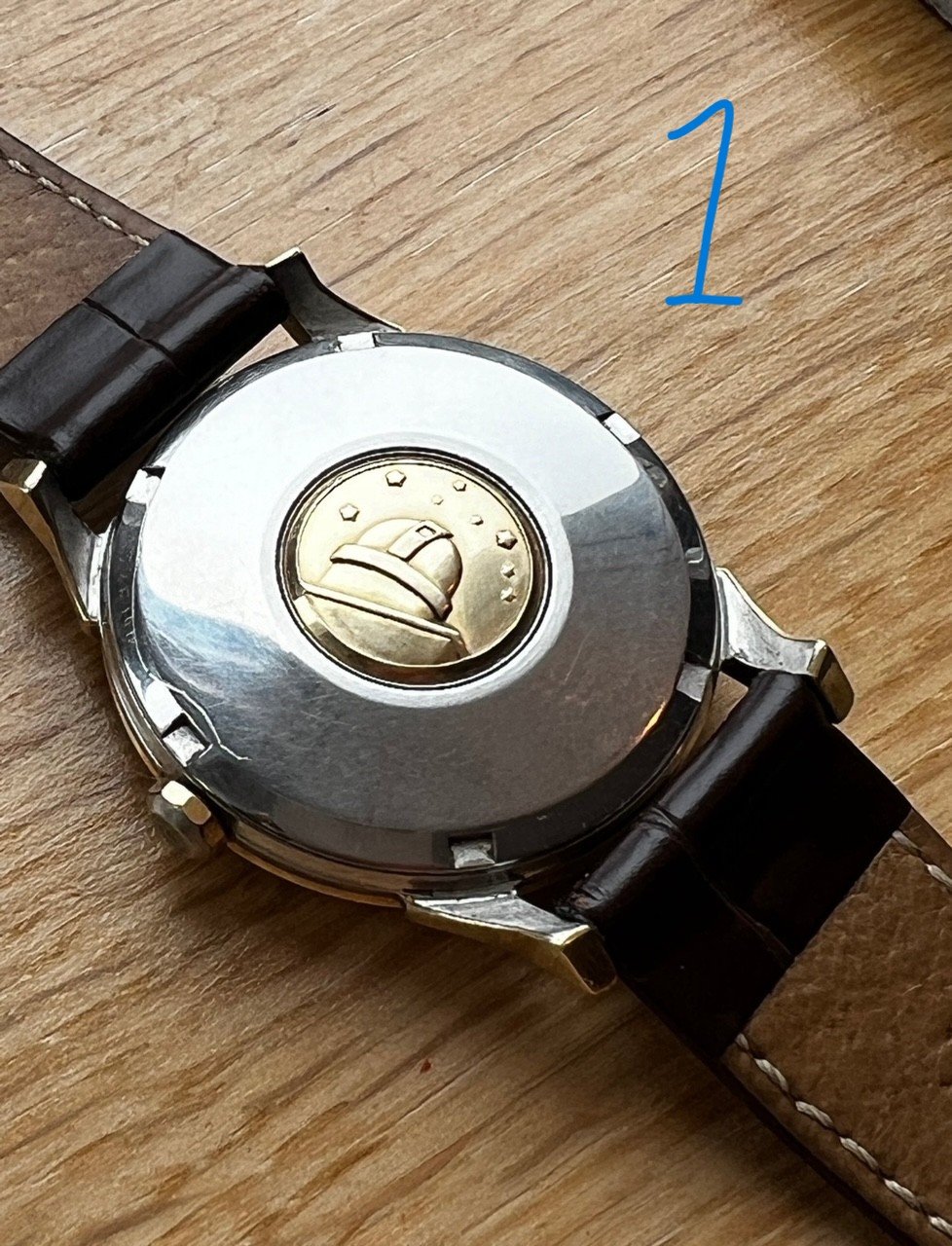

Auction 1 - Price 1158 Dollars
Description -

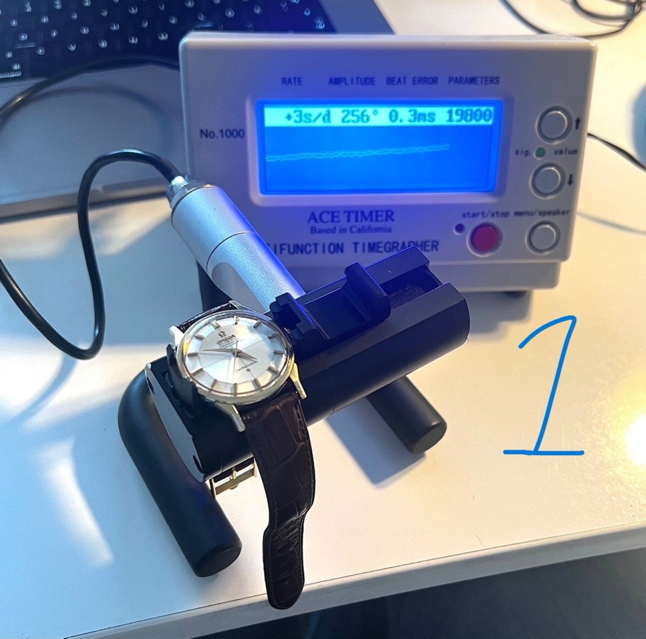

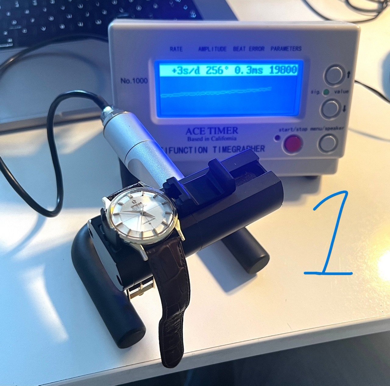

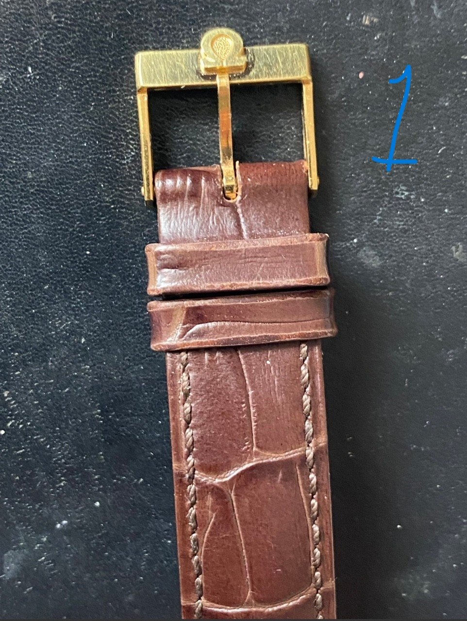

"For sale, one piece of Omega Constellation Pie Pan Gold/Steel. Cal. 561, 34 mm. Crosshair dial. Plexiglass with Omega logo. Comes on a brown Hirsch crocodile strap with Omega buckle. Tested today on Timegrapher. See pictures for condition."
The seller has also added later in the description -
"Caseback marked with Reference 167.005, the movement marked cal 551."
Which is not that same as it said above?

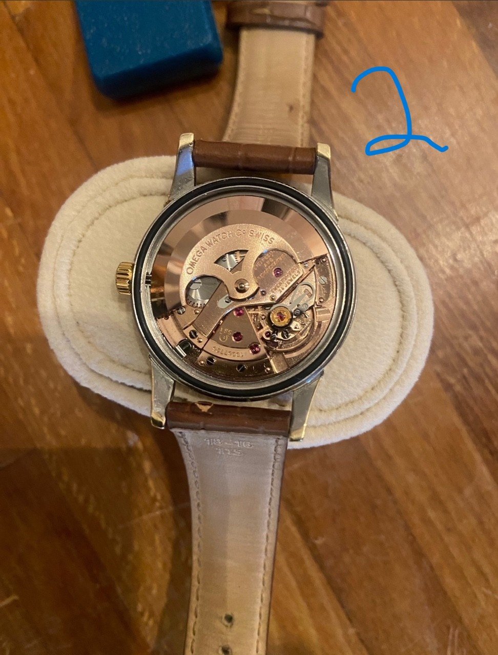

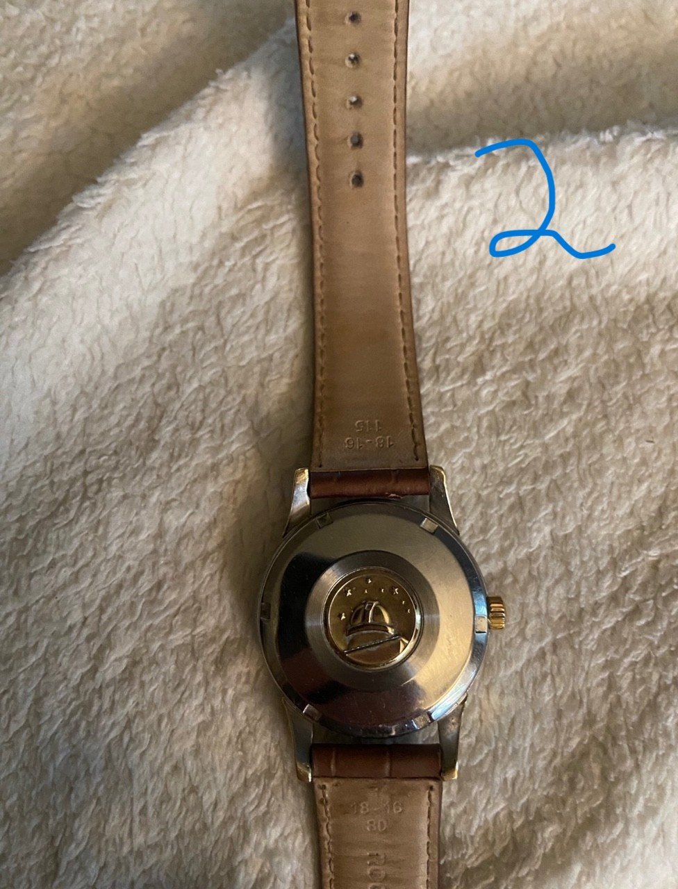

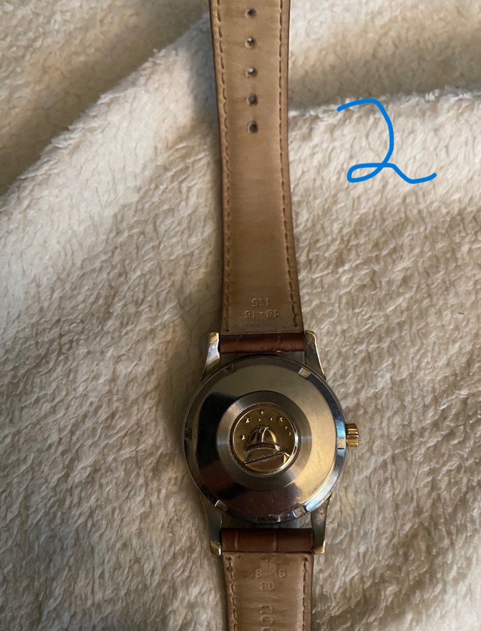

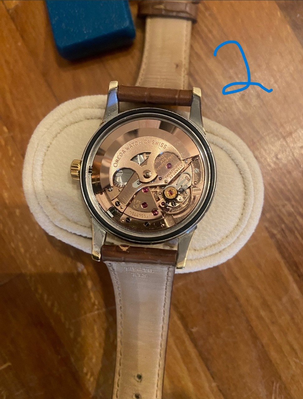

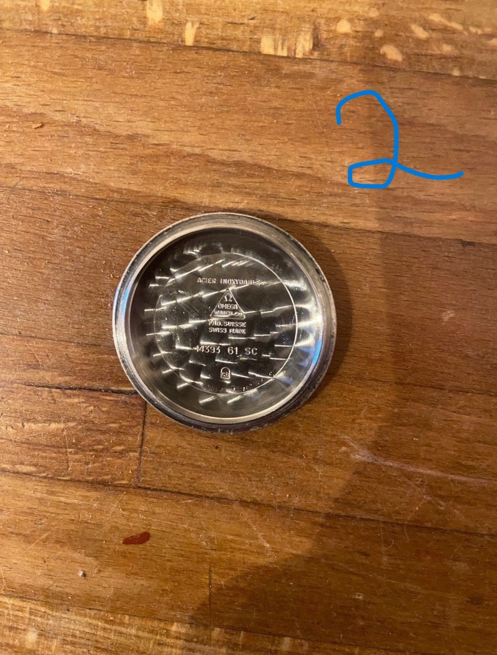

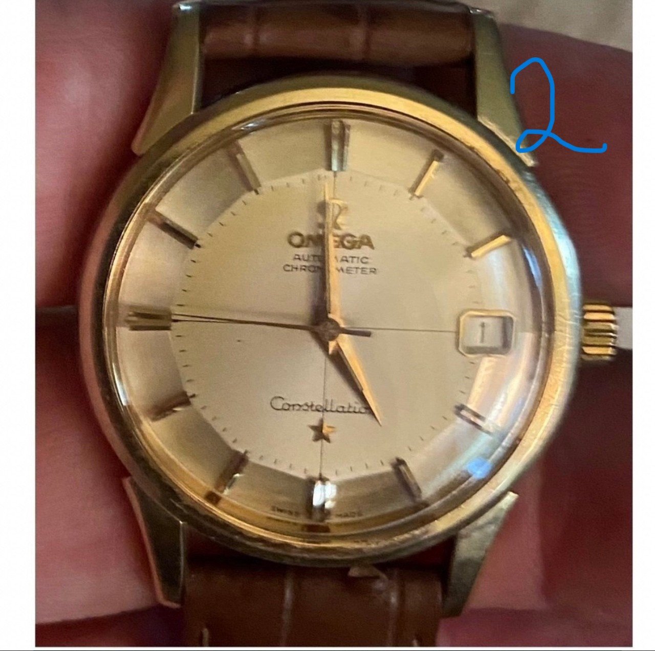

Action 2 - Price 1593 Dollars
Description -
"A fine watch from 1961, automatic. Diameter 34mm, the watch is in good condition. A service was done in 2020 for 473.00 Dollars, receipt available. The crown was replaced in 2020. Receipt for the watch is missing, but the bag with the box is available, see picture."

Correct description for option one is Ref 167.005 with caliber 551. The date version of this watch is a reference is a 168.005 with caliber 561.
Option 1: Ref 167.005 with caliber 551. Heavily polished case. Crown looks to have some of the gold worn off based on the one view. Appears to be keeping good time. Dial looks clean and original. Price is reasonable.
Option 2: Ref 14393. Caliber 561. Not a dog leg. Replacement crown that is the incorrect style. Polished case. Need better pictures to assess the dial. Either way I think the price is high for a gold capped example in this condition. Service history is only valuable if there is documented proof, though it rarely adds to the value of a watch unless there is a corresponding warranty associated with it.
Does that mean the Option 1 probably have had the back of the case replaced to one from Ref 168.005 since that is supposedly what is written on the back? Feels like that would effect value.
Yes it would -but they may have made a mistake as they also note a cal 561 movt.
Do you have pics of the inside case back?

Unfortunately no pictures of the back for option 1.. I have asked the seller just now.

Option 2 is "set price" auction, so i wrote the buy out price, but those auctions also have the option to bid with a lower price which the seller can accept/decline.

Just got a message back from the seller and it was written 167.005 on the back so everything seems to be in order.
The most recent bid is now up to 1205 dollars so i might just sit this one out until i get more comfortable with the models/conditions/price ranges.
