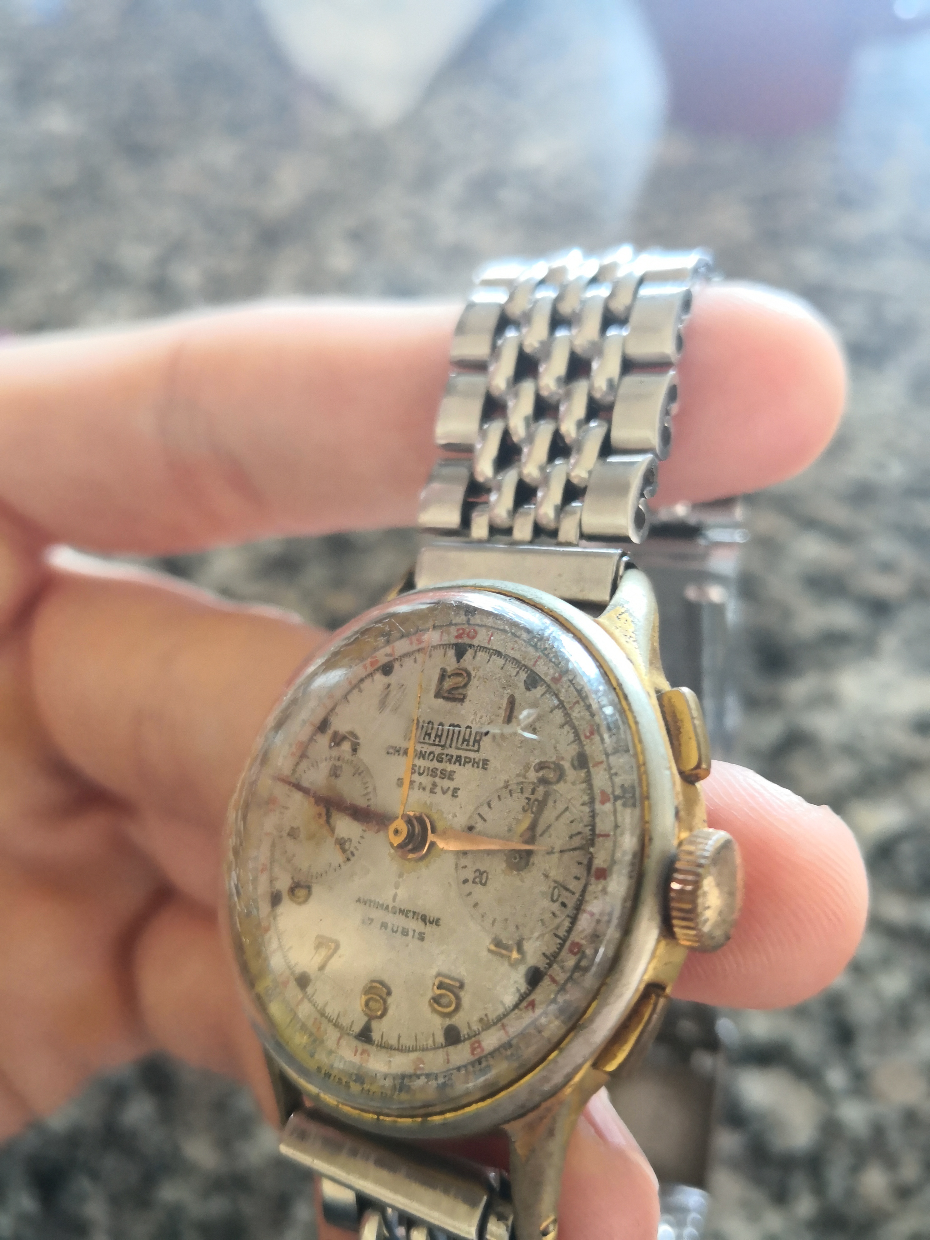

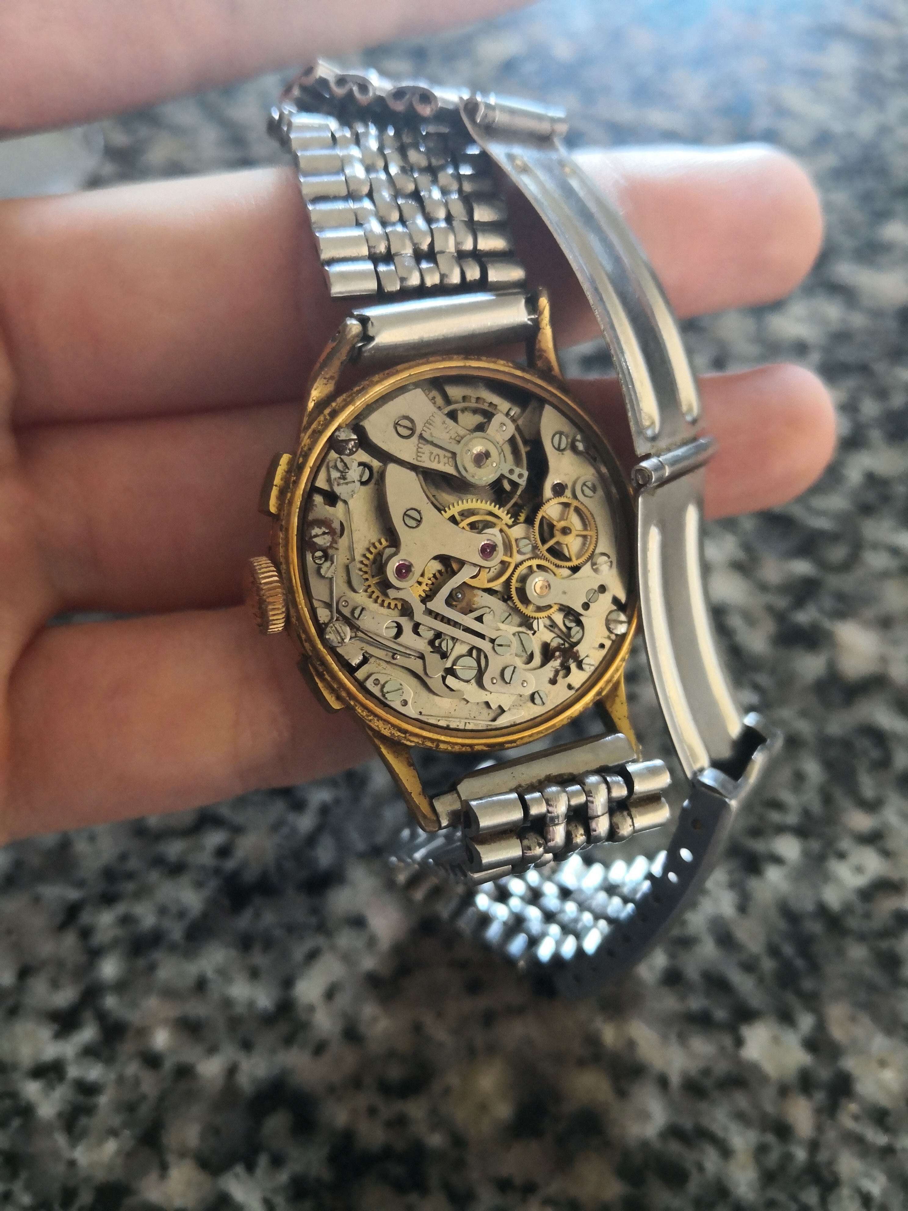

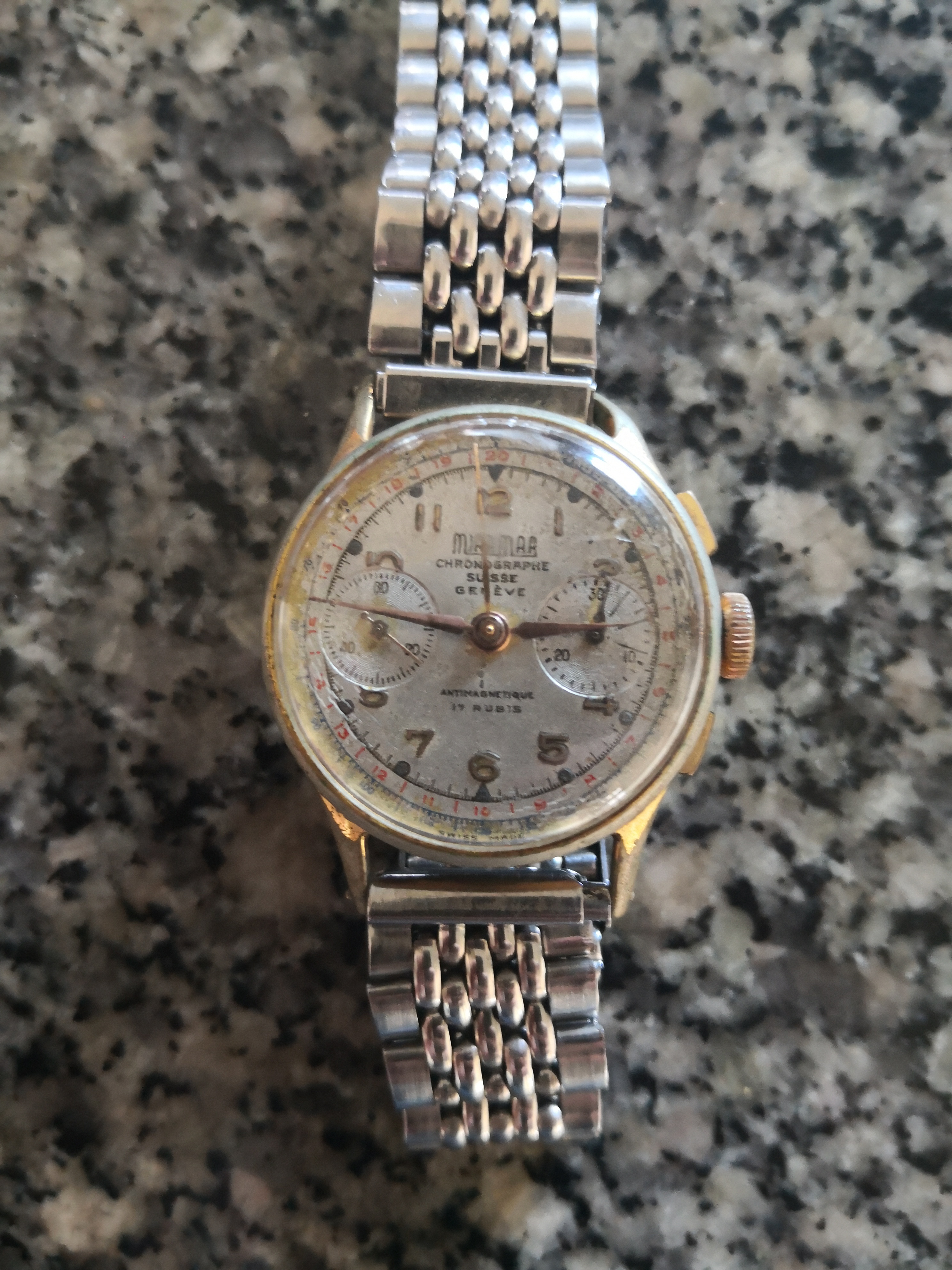

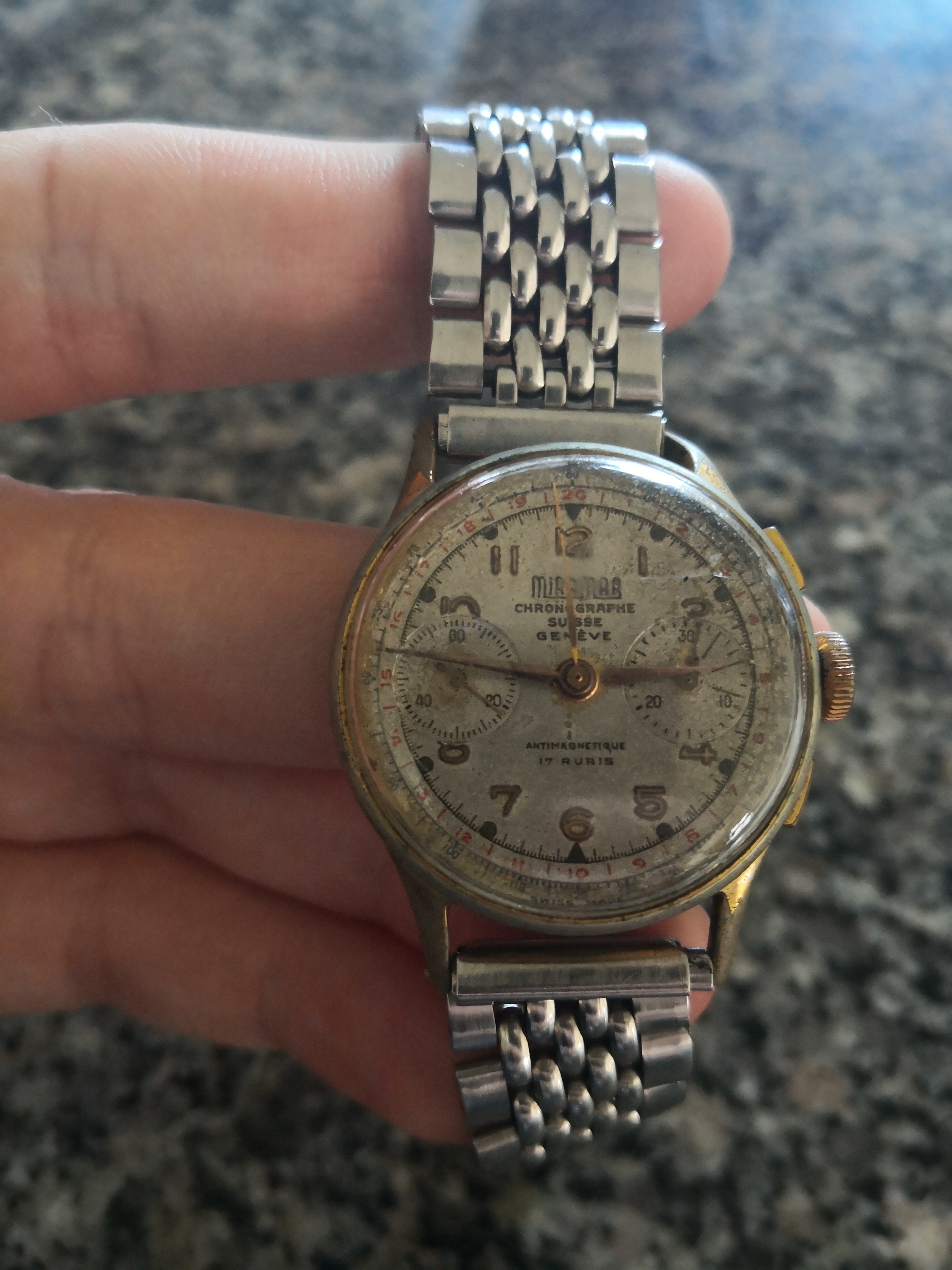

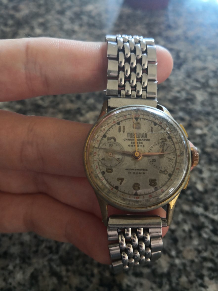

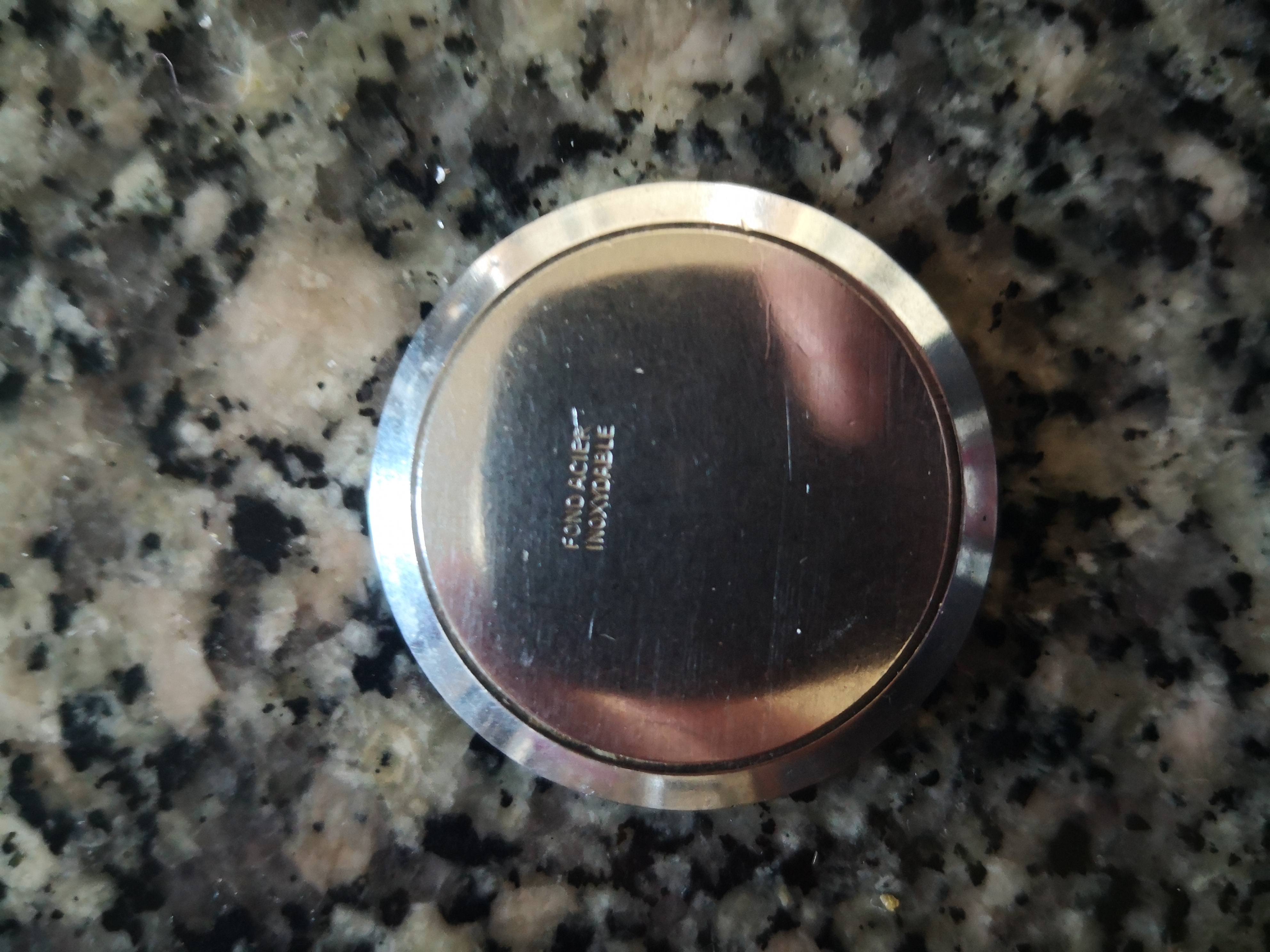

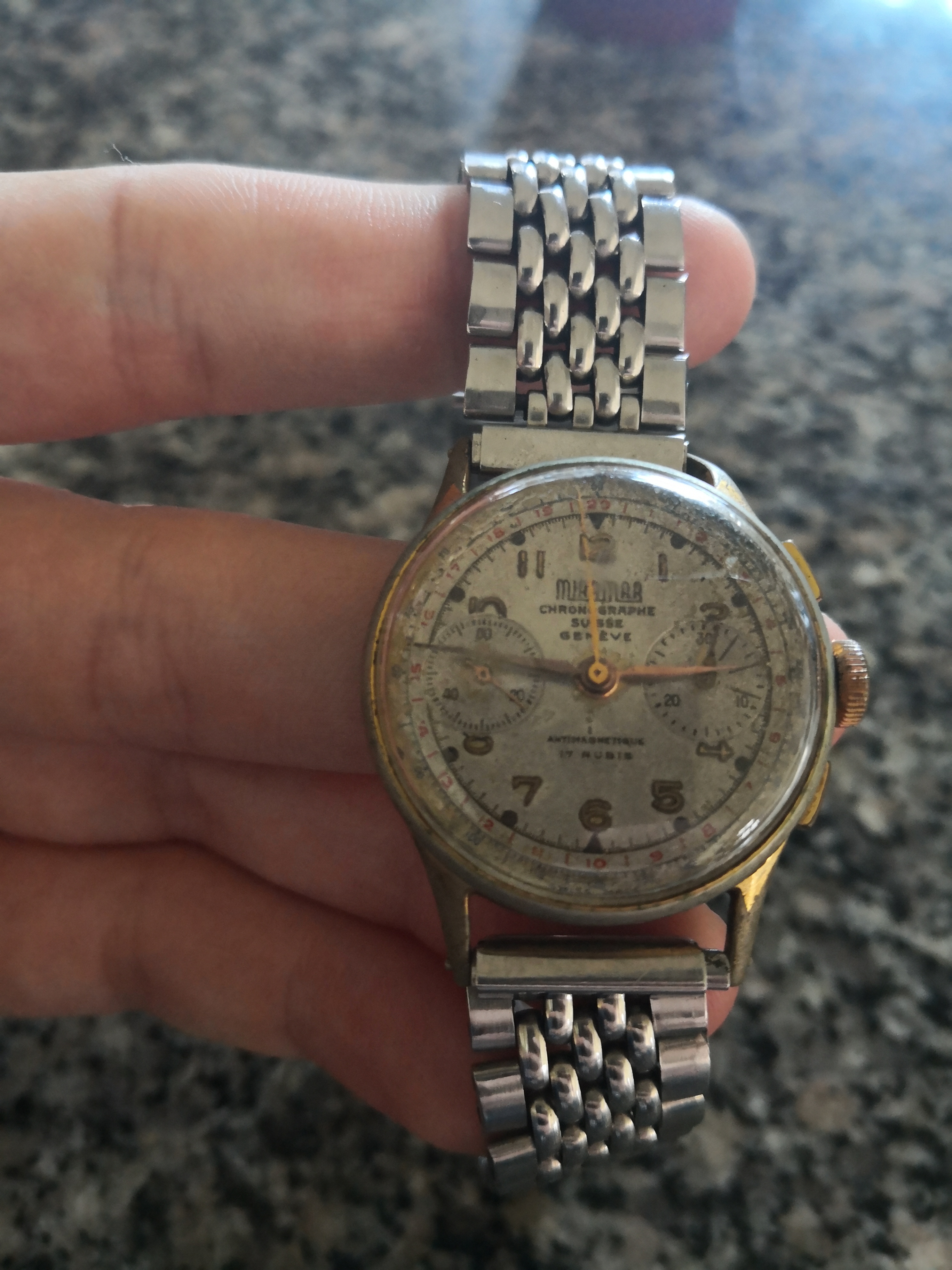

Hello everyone, I just found an old watch that my grandfather had bought long ago. I would be grateful if you could provide some information regarding the brand, the condition and the value of the watch. It does not work anymore so I am thinking to go a watchmaker in order to make it usable again.

What I can see from your pictures is a very worn watch in poor outer condition.
The brand "MIRAMAR GENEVE" is legit, they existed. I'm not knowing it exactly, but this watch should be from the late 1950s.
If the watch doesn't work, it is a good idea to have an experienced watchmaker have this fixed. There are some spots of corrosion on the movement and also damage on the dial. Most likely there has been some damage due to moisture ingress.

Appears to be a Landeron 148 movement. Entry-level, but very common (literally millions were used), and most decent watchmakers should be experienced with them.
One of the lugs appears to be badly bent, and the bracelet is hanging on by a thread. That will need to be addressed, probably by a jeweler.

Miramar was a trademark of Fabrique d'Horlogerie Miramar (Miramar SA) in Geneva, Switzerland circa 1950. One of many small Swiss watchmakers to pop up during the heyday of Swiss watchmaking. According to Mikrolisk, they registered several other brand names including Arbar, Chyllon, Jadran, Kores, Marlis and Varbar.

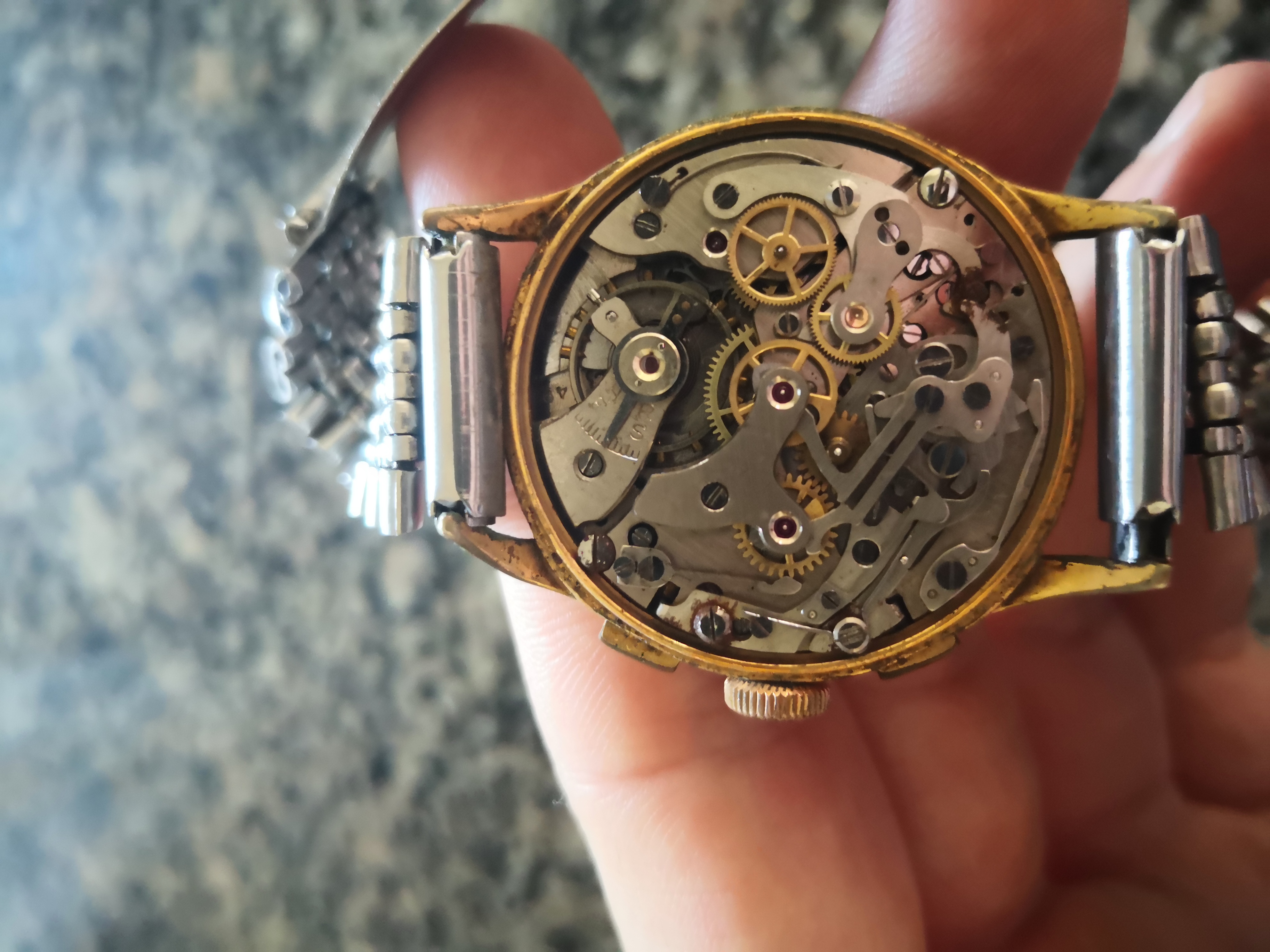

Got a close up view of the movement. Probably a Landeron cal. 148, could be a 248. There is very little difference. It needs a lot of work. Many of the parts are full of rust. It would likely cost several times the value of the watch to fix it properly. The case has been bent out of shape also.

The only hope for salvage that I see is to find another Landeron cal. 148/248 watch movement in the same size case in working condition, then have a watchmaker transplant the dial (which isn't in the best condition either). You need to be careful with the measurements, or the dial won't fit. You are also gambling that the movement is in good condition, because a proper chronograph service is going to cost about $300 minimum.
But at least you have a chance. Good luck,
