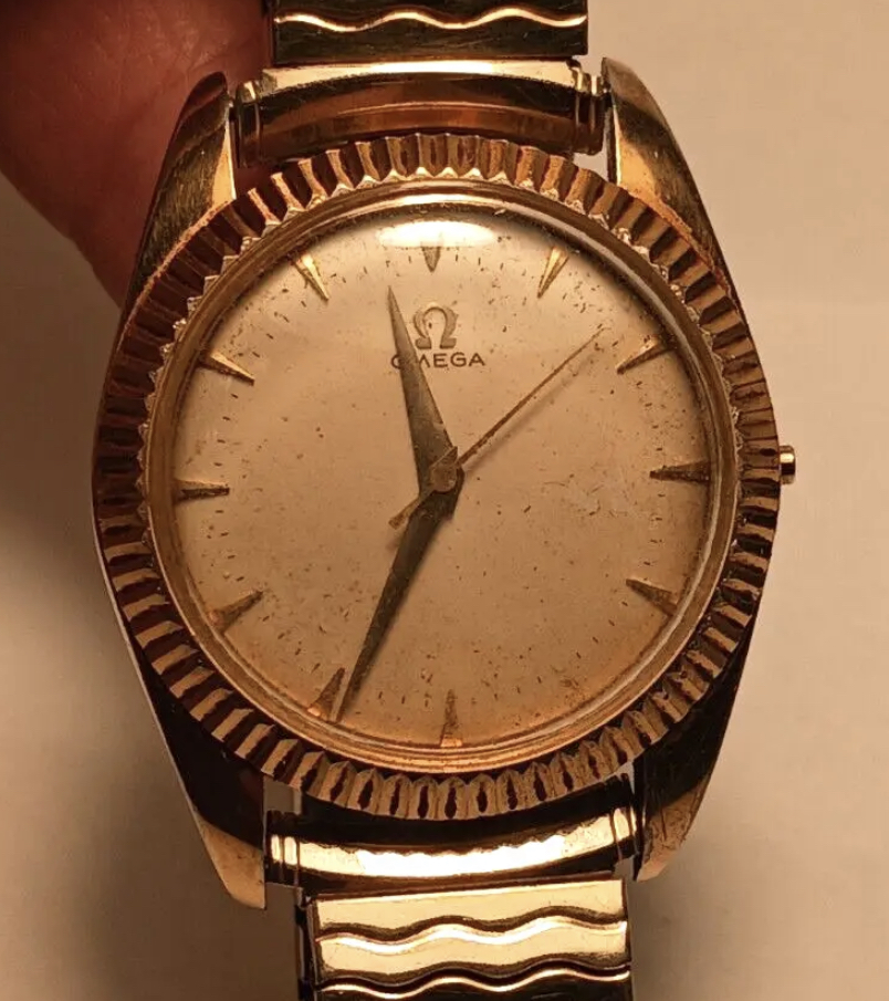

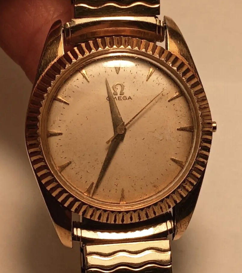

Info on this watch, please.
65
303
Watching this on the bay, mainly because I have wanted to dive deeper into tinkering with movements, and I think the caliber 420 in this might be good to learn on. I'm unfamiliar with this style though. The SN on the movement dates it to 1956 I think. The bezel is throwing me. Forgive me if I'm asking noob questions. What model is this?
2,338
1,459
Looks recased. Any inside back images?
3,617
7,838
Dial in poor condition very unattractive to me. And movement looks very worn and tired.
24,801
55,084
I'm skeptical of the case ... and the "G".

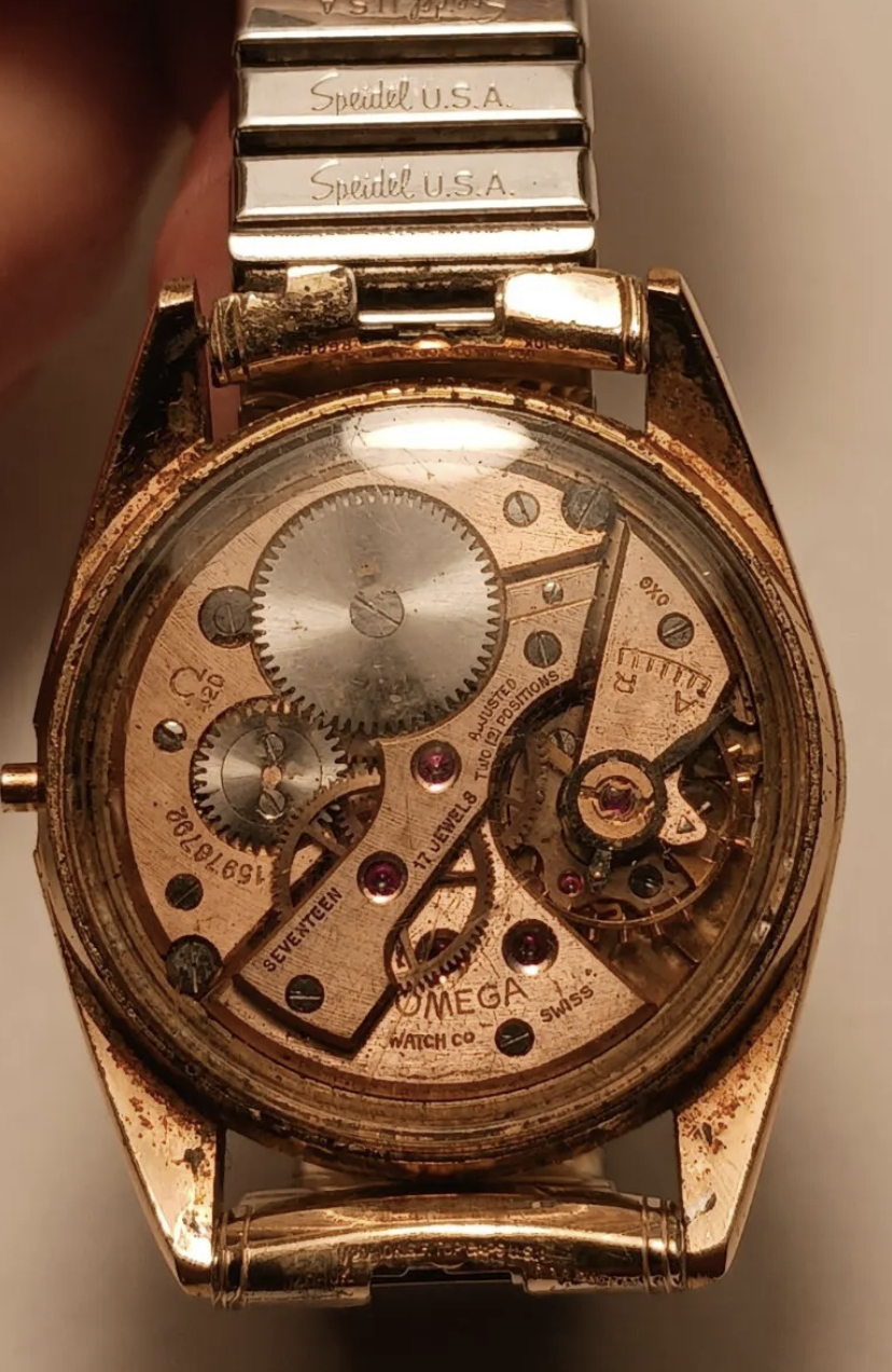

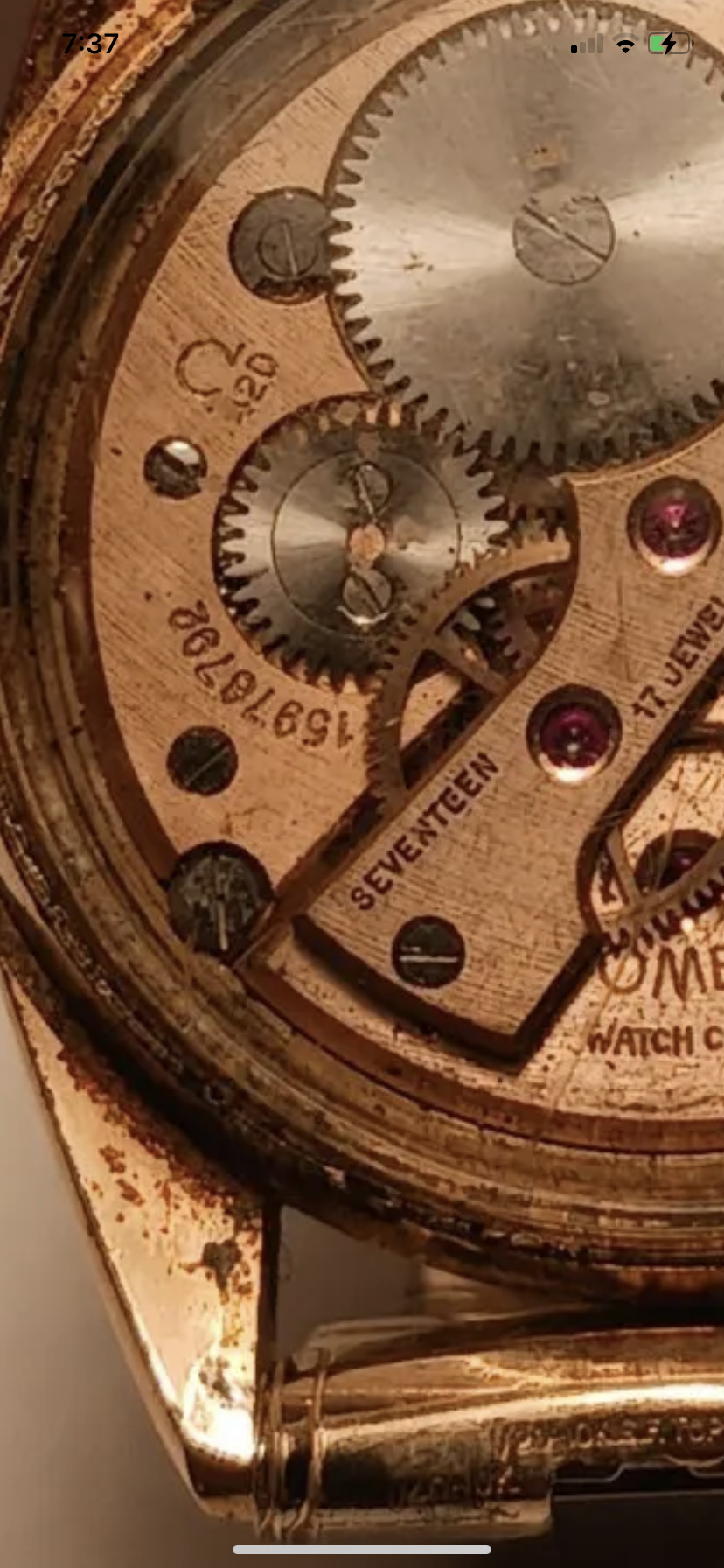

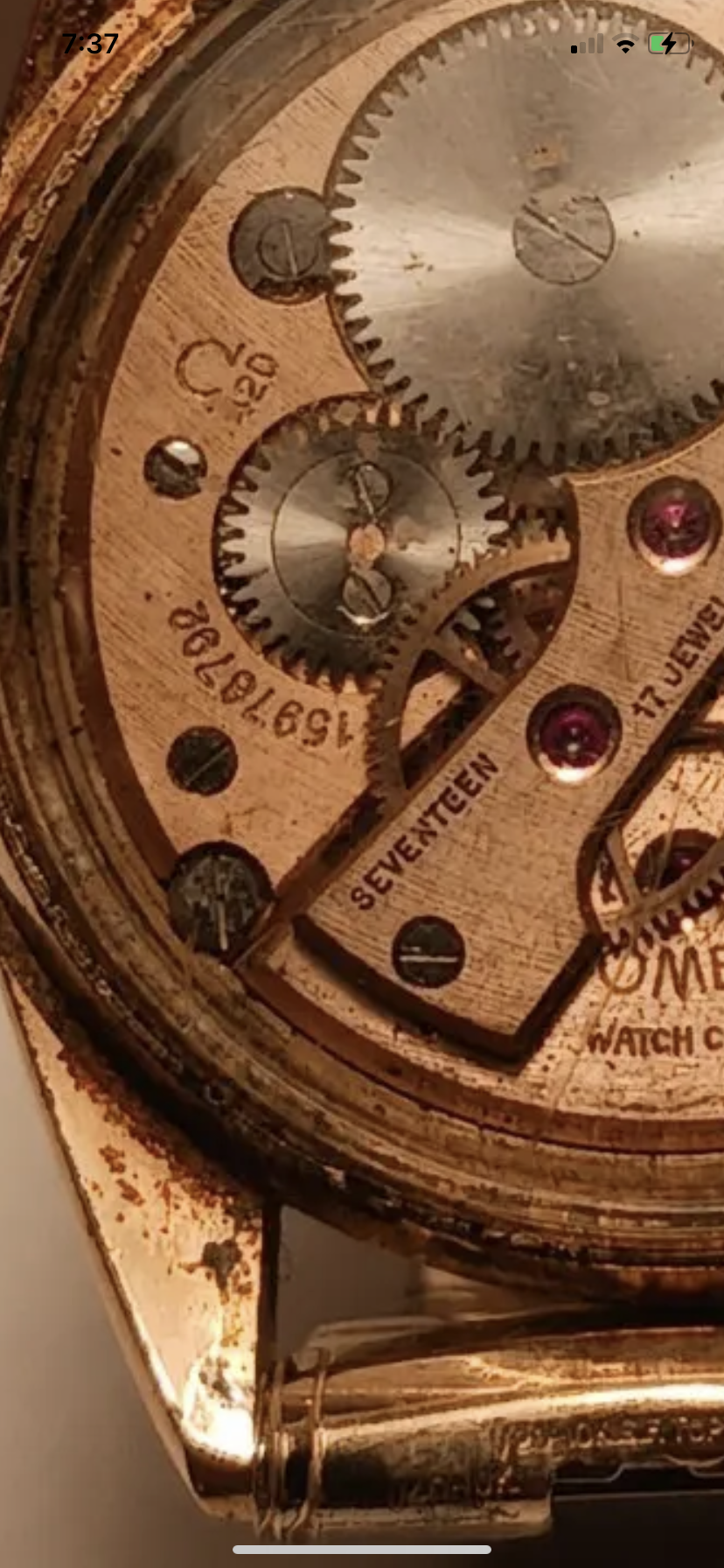

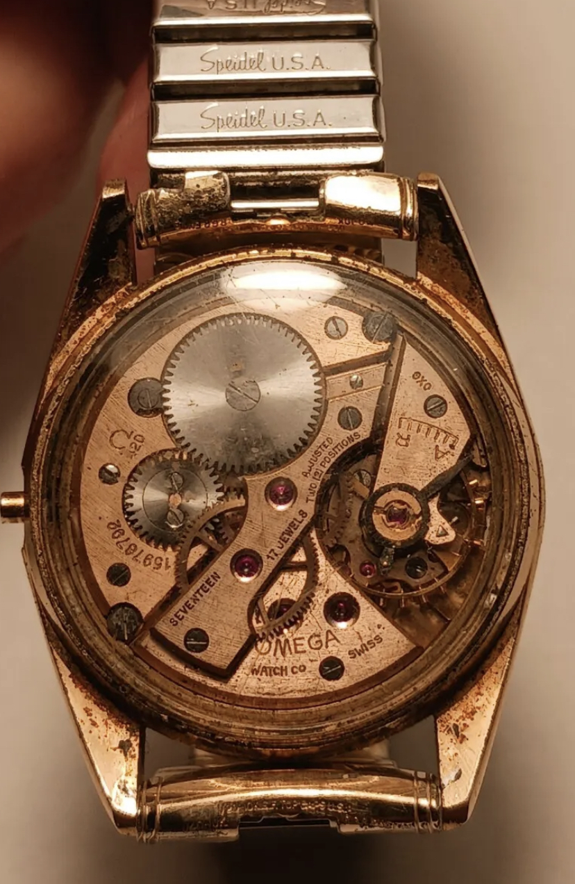

There is no case back, if that's what you're asking to see. There's a crystal covering the movement 🤦 The screw heads all look clean, including the case screws holding the movement in place. Doesn't look like the movement has seen a screwdriver in a very long time. Just to be clear, I didn't buy this. Just wanted to know what it was. Here's a complete movement pic;
18,749
38,911
It would take a very brave tinkerer to adopt that concoction, even as a "project".
I recently finished a 420 and while it wasn't all that difficult, parts were hard to find, took me about 6 months, start to finish.
65
303
So even at 199.00 U.S. it's not a worthy project movement?
16,900
48,108
There you have it. Thanks for the input. Mistake avoided!
Buy a cheap Seiko mechanical for $100 and use that.
2,994
4,750
As much as I like basket cases 200 bucks is borderline. Back in the day I did not like paying more than 120 for complete movements. Then and now I tend to only want to pay half of that amount for project watches.
I am still looking for a 351 case at a reasonable price. Something like a 2577 case. I suspect there are a lot more movements than cases. Especially for the export movements that were cased locally.
Cheap watches such as A Schild are probably better for learning. ETA movements are a bit more.
I have noticed that a lot of stuff seems to be trending up a bit. Last fall a top level eBay search returned 7 million, then it went to 7.5 and is now at 8 million. At the same time the quality seems to have gone down. Perhaps I have reached saturation. Or it is simply spring and I tends to spend less time on such things. Could be that I am getting more picky as the lack of a case makes the watch hard to wear.
I did re-start some case restoration projects. These got overwhelming in the 1990s. So I am a bit twice shy. Finding time to set up the lathe and such, is a lot different than basic disassembly and cleaning. Have access to a laser cutter. Never seem to find the time to program in the parts, even if such things are simply circles of fixed diameters. (Thinking about making some acrylic cases.)
Still I suspect someone will purchase the OP watch (eventually.) They will then find they paid to much. Or perhaps they need a part like the balance. I have noticed that parts for such junk is all over the place. Low if I do not need or want it. High if I do.
Mostly though I think it is about the chase and the anticipation. There was a stripped watch on Goodwill that had a decent case, but no balance or balance bridge. I was willing to go to 120, but it went for 175. Too bad I can not get Goodwill prices selling. People there seem to bit early. On the other hand the junk stuff is sold by the pound. I have noticed that the GW watches are usually in better shape than the eBay ones. Had I money to burn, 350 or scrap metal price probably makes sense which is what this junk does seem to sell for.

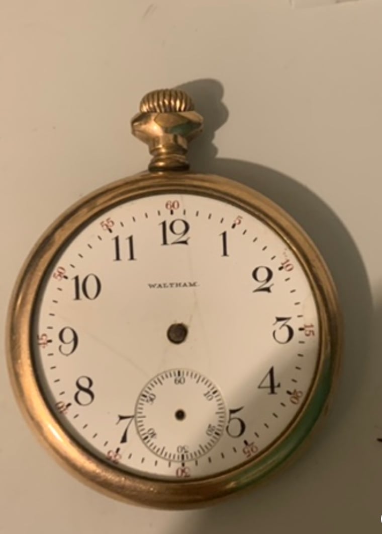

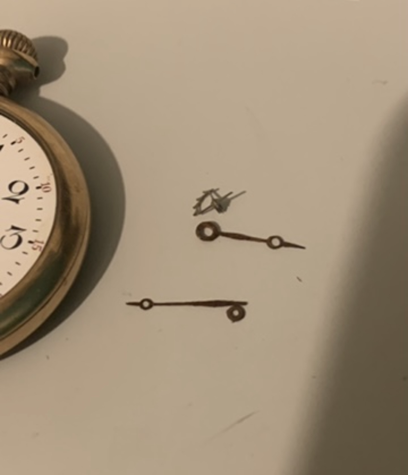

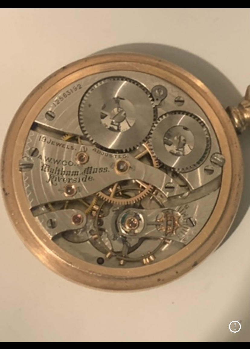

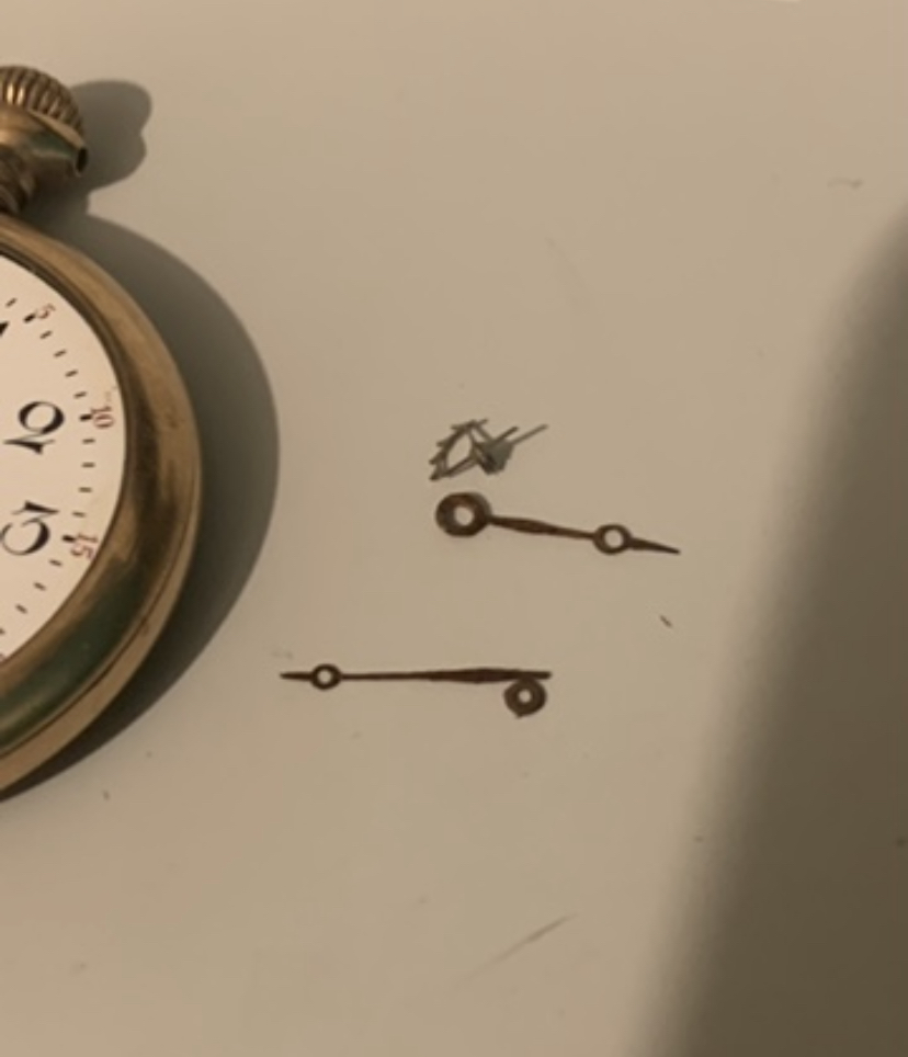

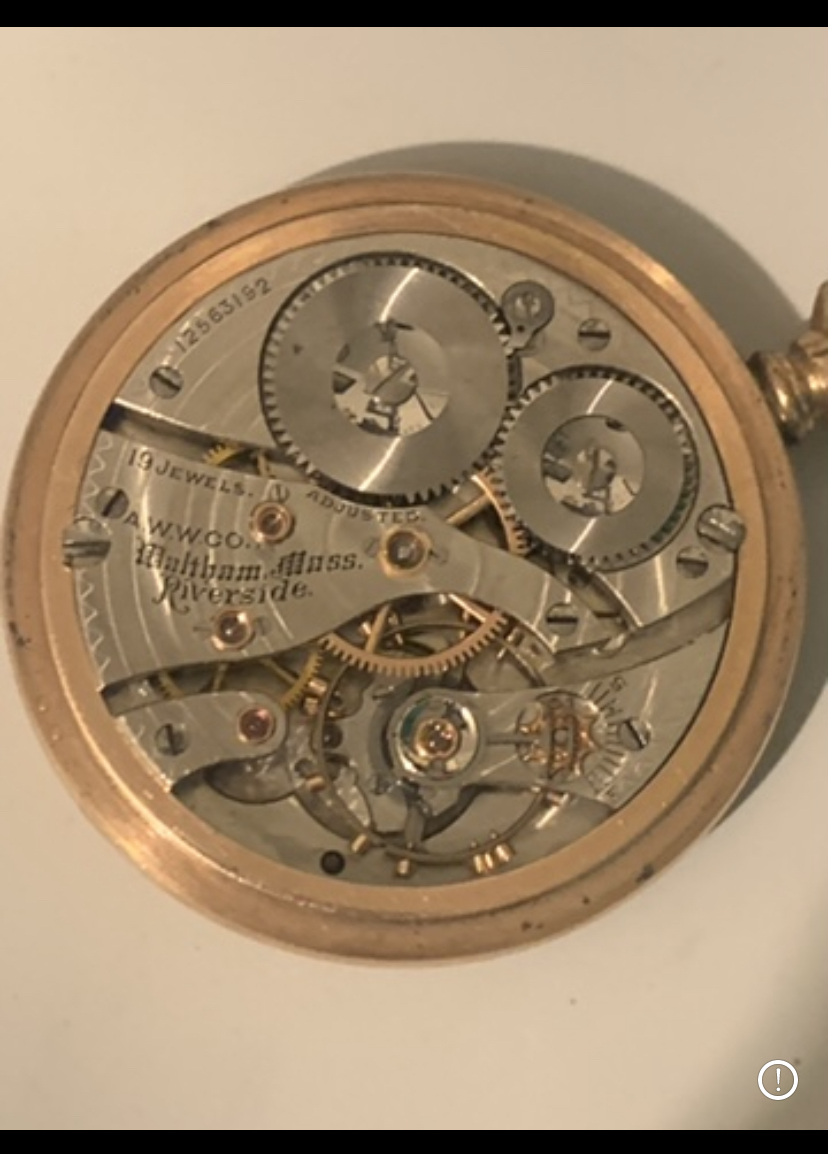

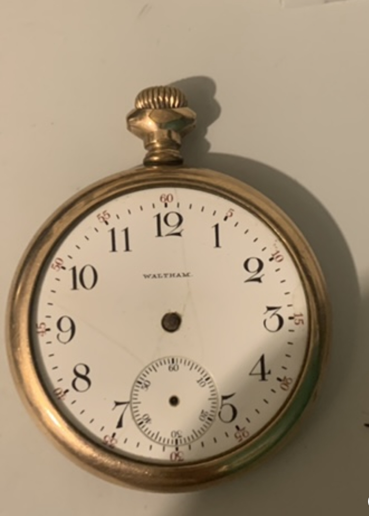

I have a Waltham 1895 pocket watch I might try starting on. Here's what I have;
