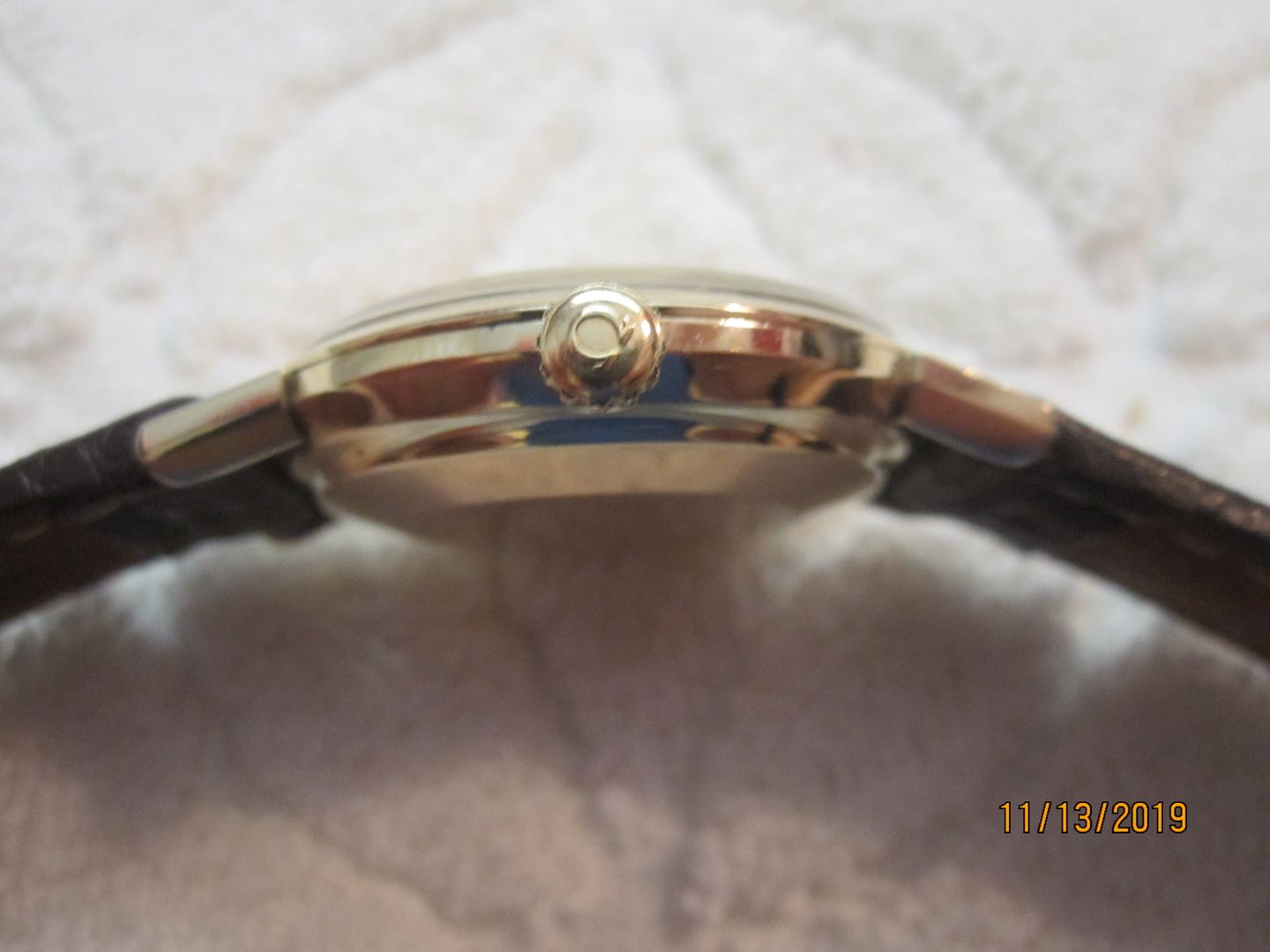

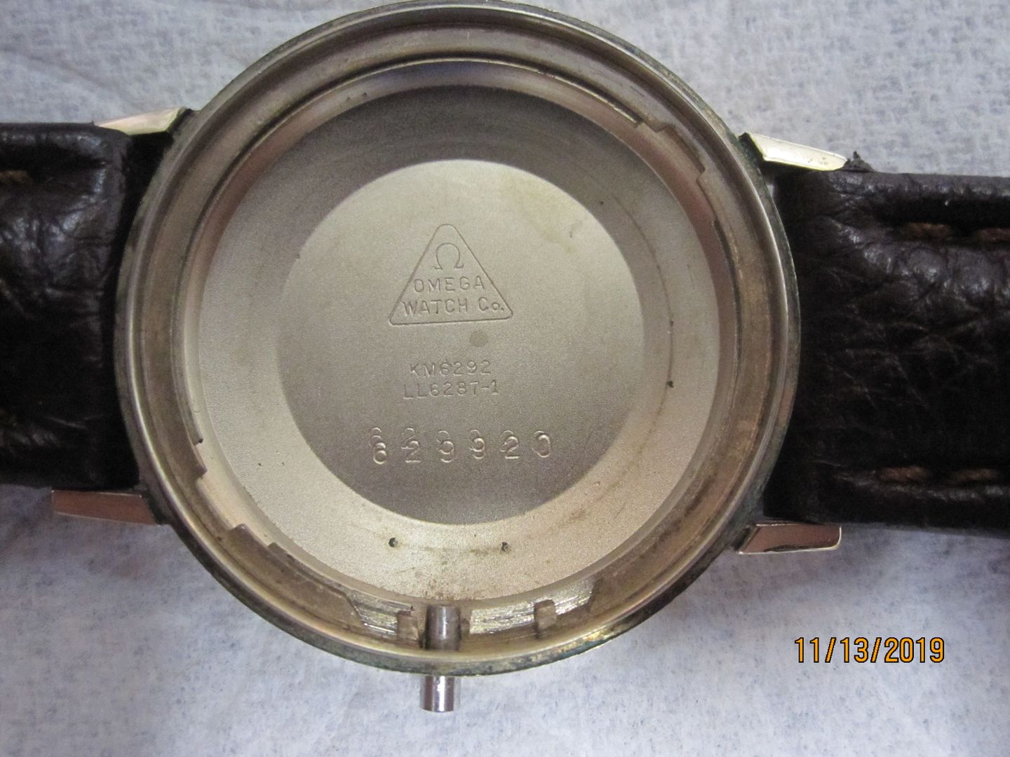

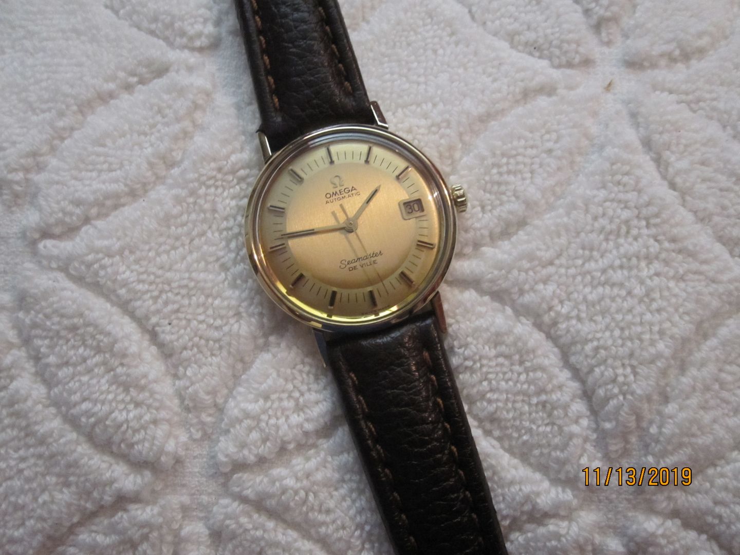

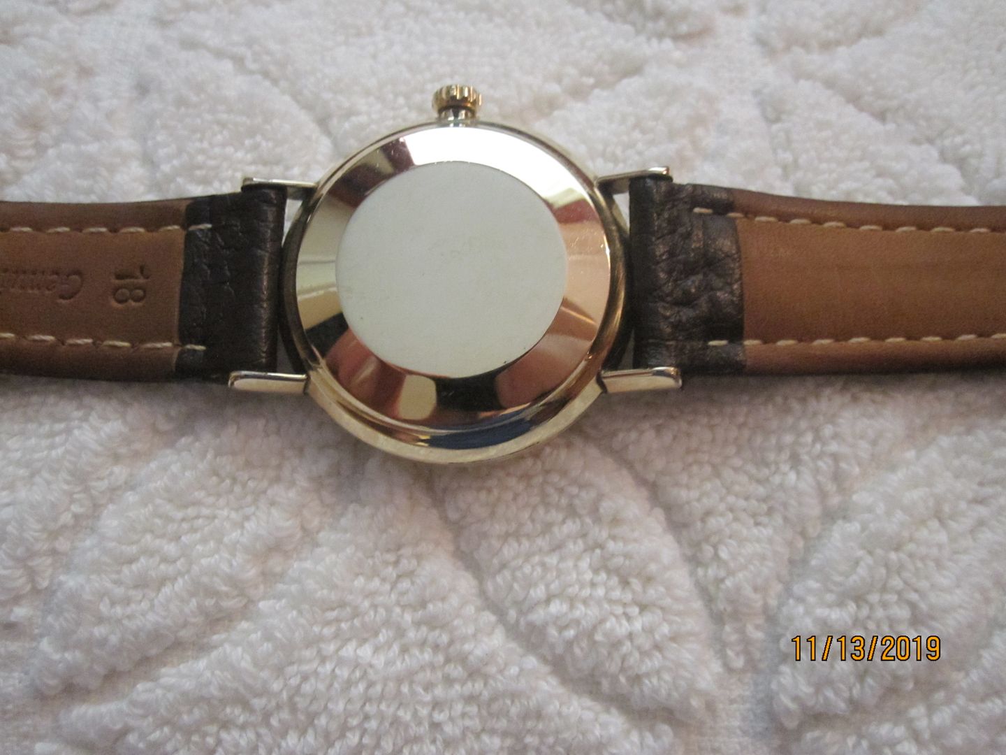

Like the title says I'm looking for some info. Wanting to buy a Deville and I ran across this. I searched the reference on the Omega site and the case checks out and has proper movement. I have never seen a dial like this one in a unishell. Seller has great feedback so no reason to doubt its authenticity. Any info would be appreciated.

Hi. Not familiar with the dial type either although the script on the dial looks original.

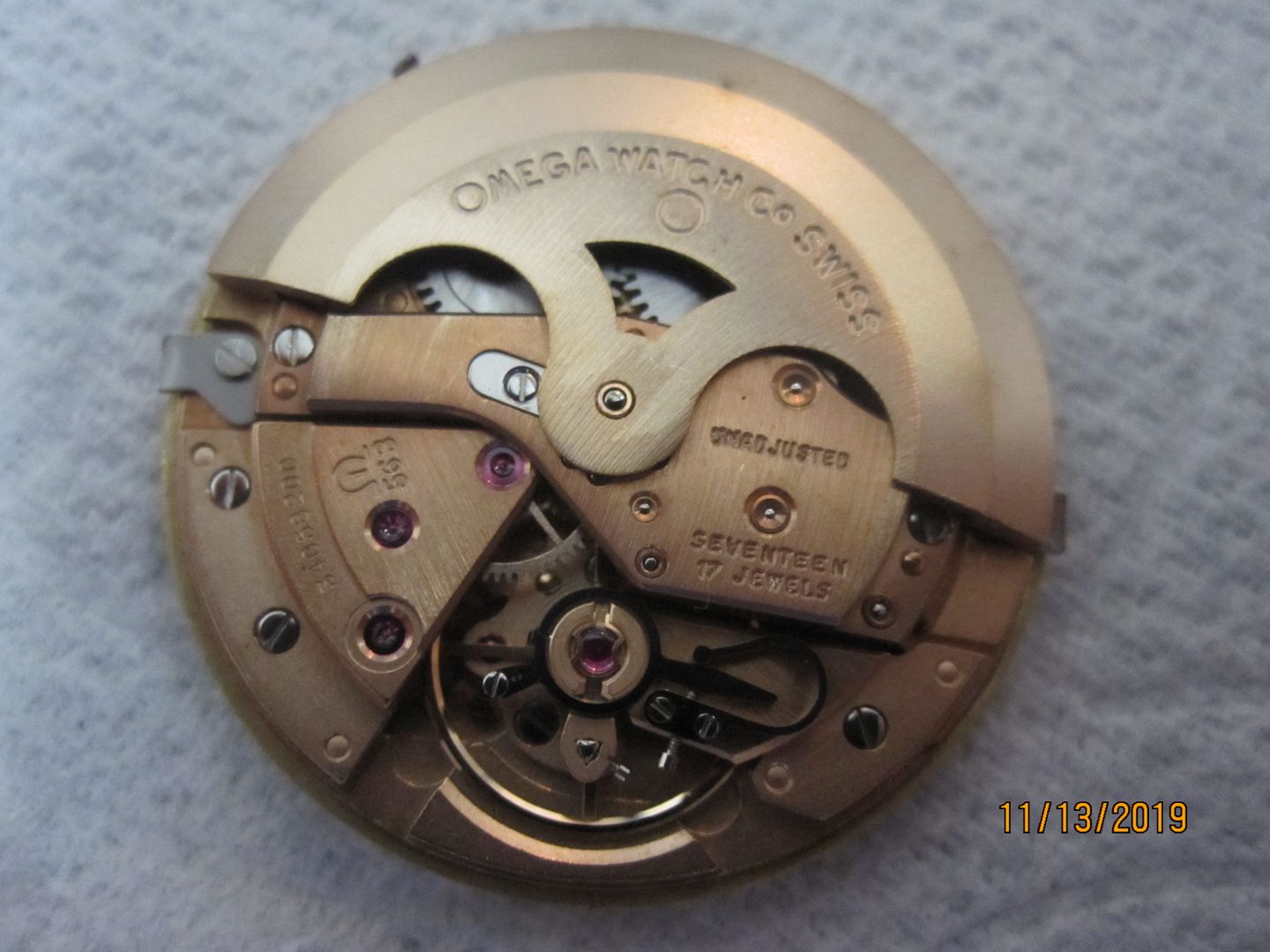

Serial number on the movement is 34xxxx? Dating it to 1972. I dont know if that date matches the ref or not?
The rotor is a different colour from the rest of the movement.
What is the price?

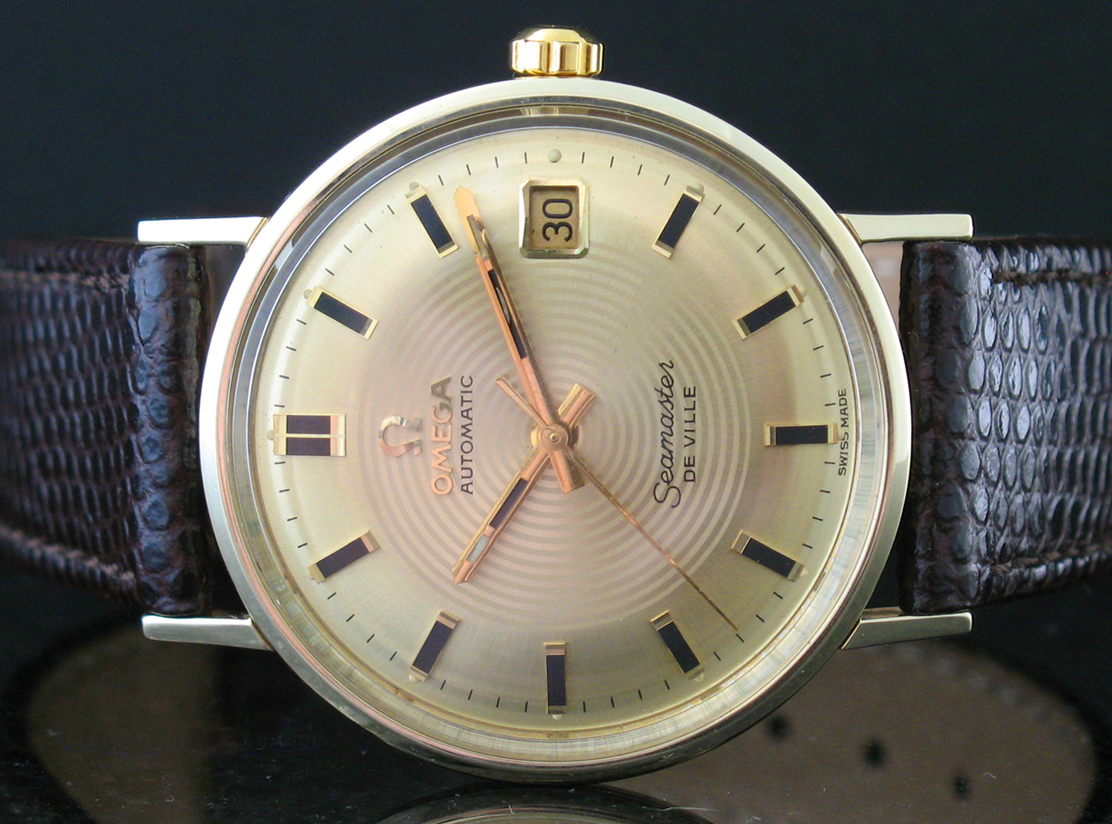

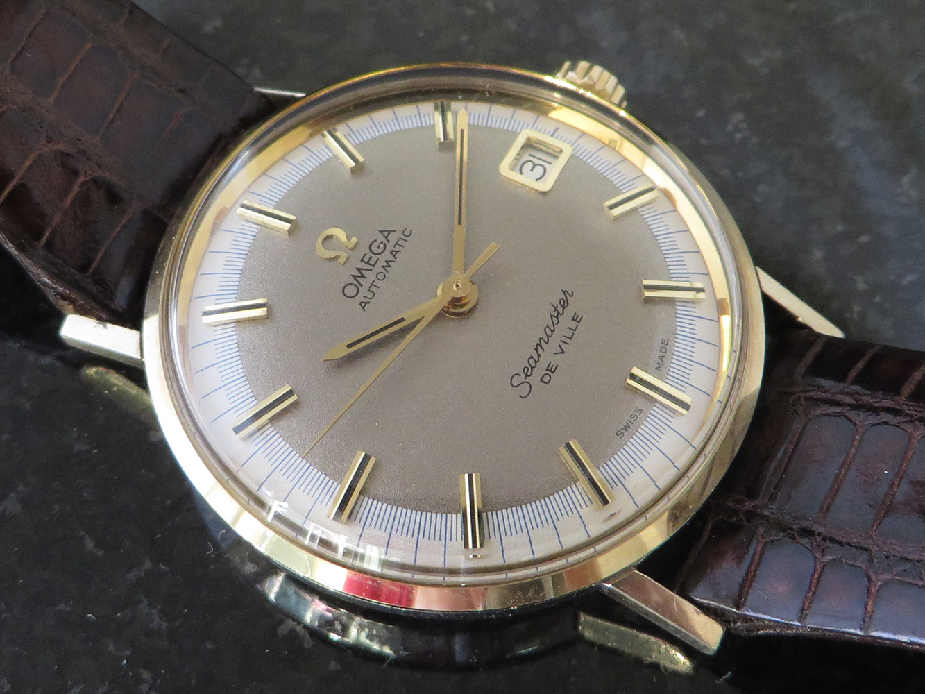

Dial looks fine. Omega did some very different (relative to what we were used to seeing) dials on these uni-shell Seamasters in their latter time in the collection trying to keep them fresh before they were replaced by the day/date 10xx series watches.
Here are a couple examples which have passed through my hands.
Movement looks fine too.
