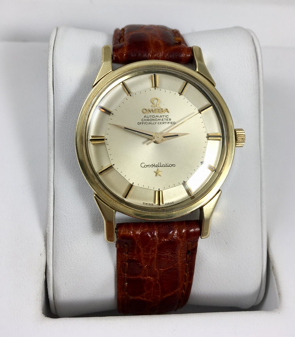

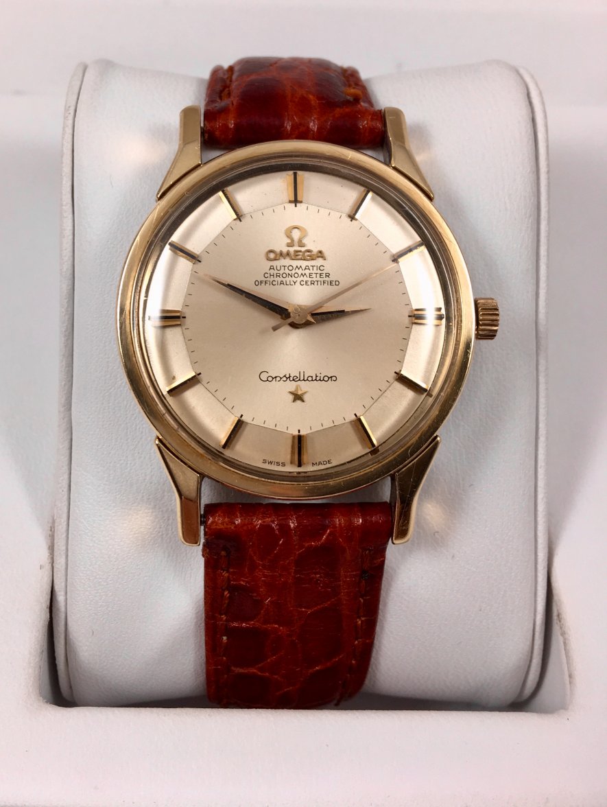

What are the indications of a repainted dial for 3 and 4? I'm very curious and want to learn to distinguish.
Luckily, you don't need years in this wonderful forum.

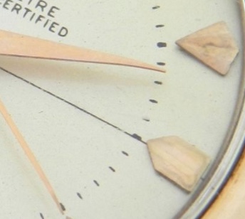

Look at your #2. Notice exactly where the vertical crosshair meets the letters:
1. On the first top of the "M" in "automatic"
2. Ever so slightly right of the centre of the second "O" in "chronometer"
3. Just right of the "Y" in "officially"
4. Just left of the first "L" in Constellation"
Some redials actually manage to get these things right. #3 and #4 didn't. Plus, the font on #4 is wrong.
Redials seldom have the sharp letter outlines seen in well-preserved originals. The printing "bleeds".

Brilliant, I see it now! Learning more and more. Thanks for the detailed response.

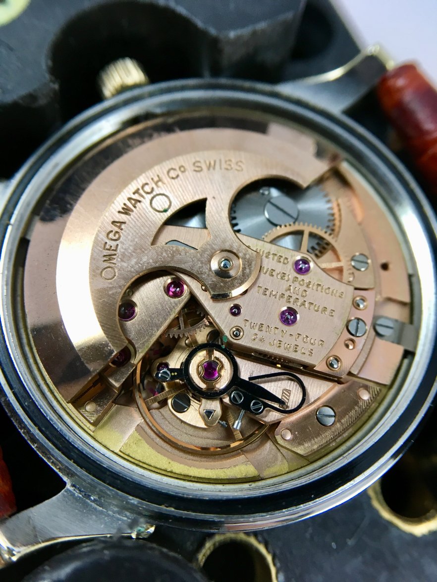

Some rotor rub.
But do you really think the movement should be green? 😒

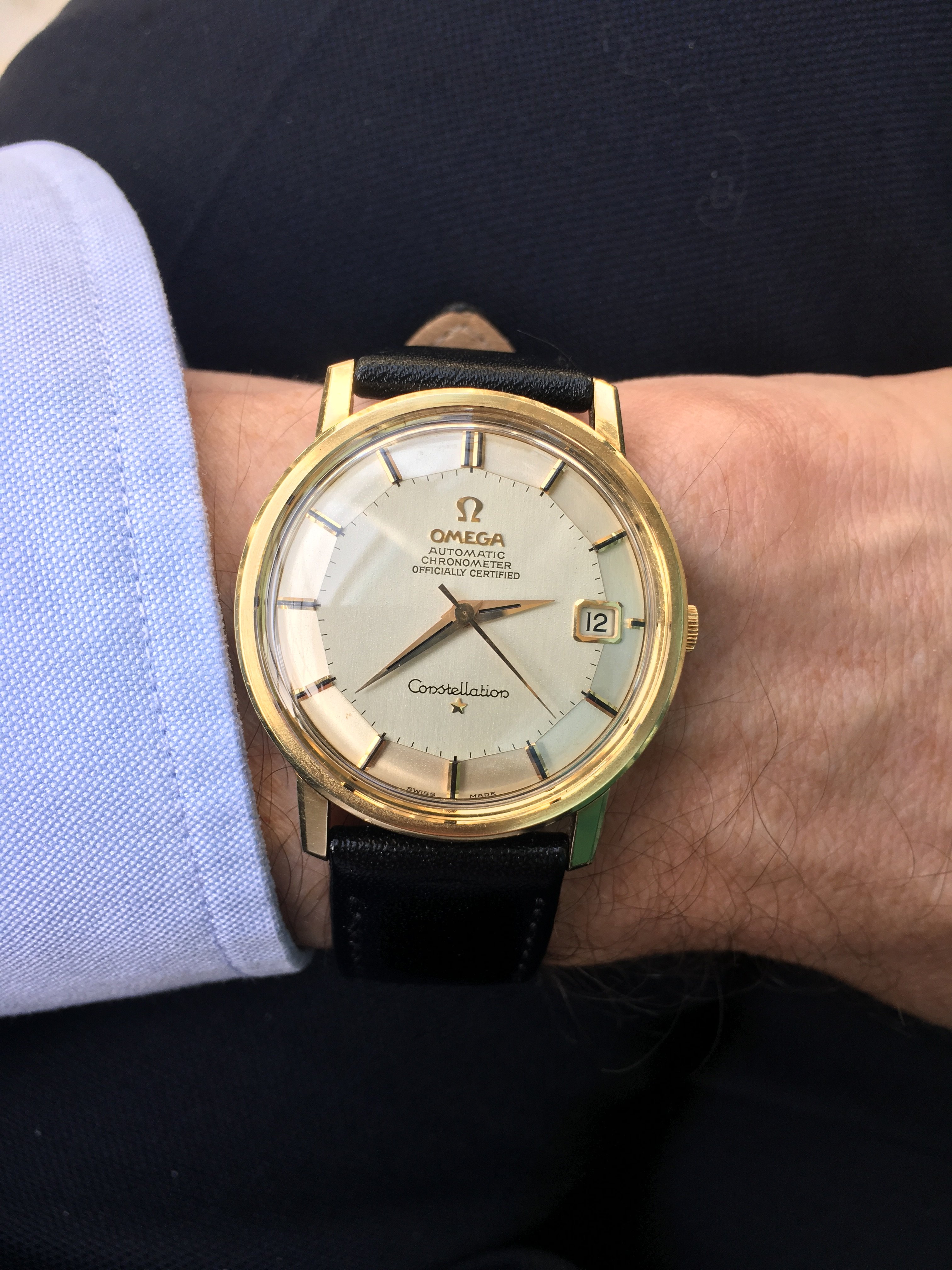

So for this watch, does it look totally legit? Is there variation in the star position? Seems to be a bit lower and bigger than other connies. I can't tell if the star has edges the other ones have. Plus there seems to be a broken line under the star.
Please let me know! I'm stuck between this one and the last one I posted.
6,071
9,398
There are large stars and small stars.
The ‘break’ is likely a scratch in the crystal - but you need better pictures to be sure.
