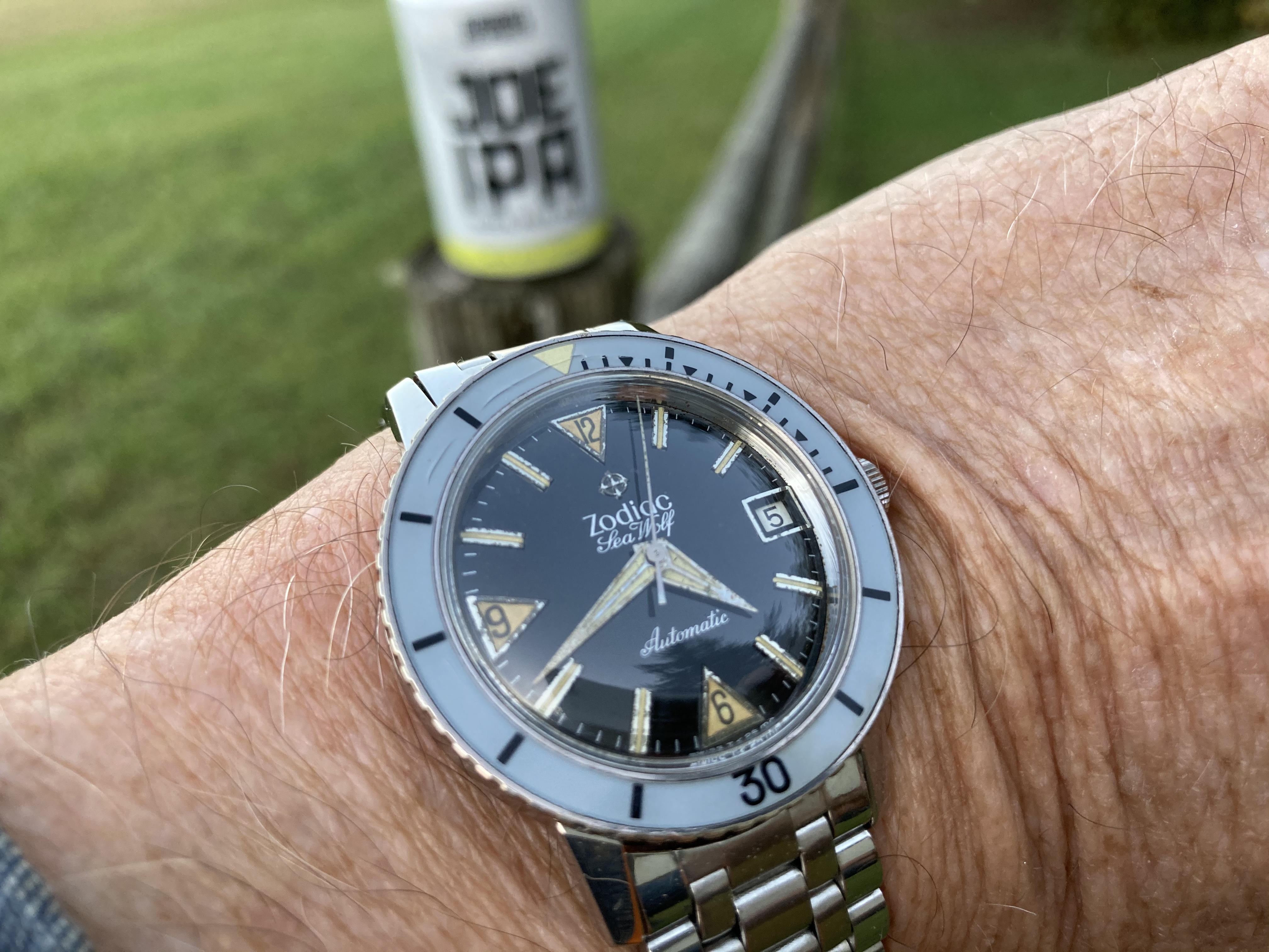

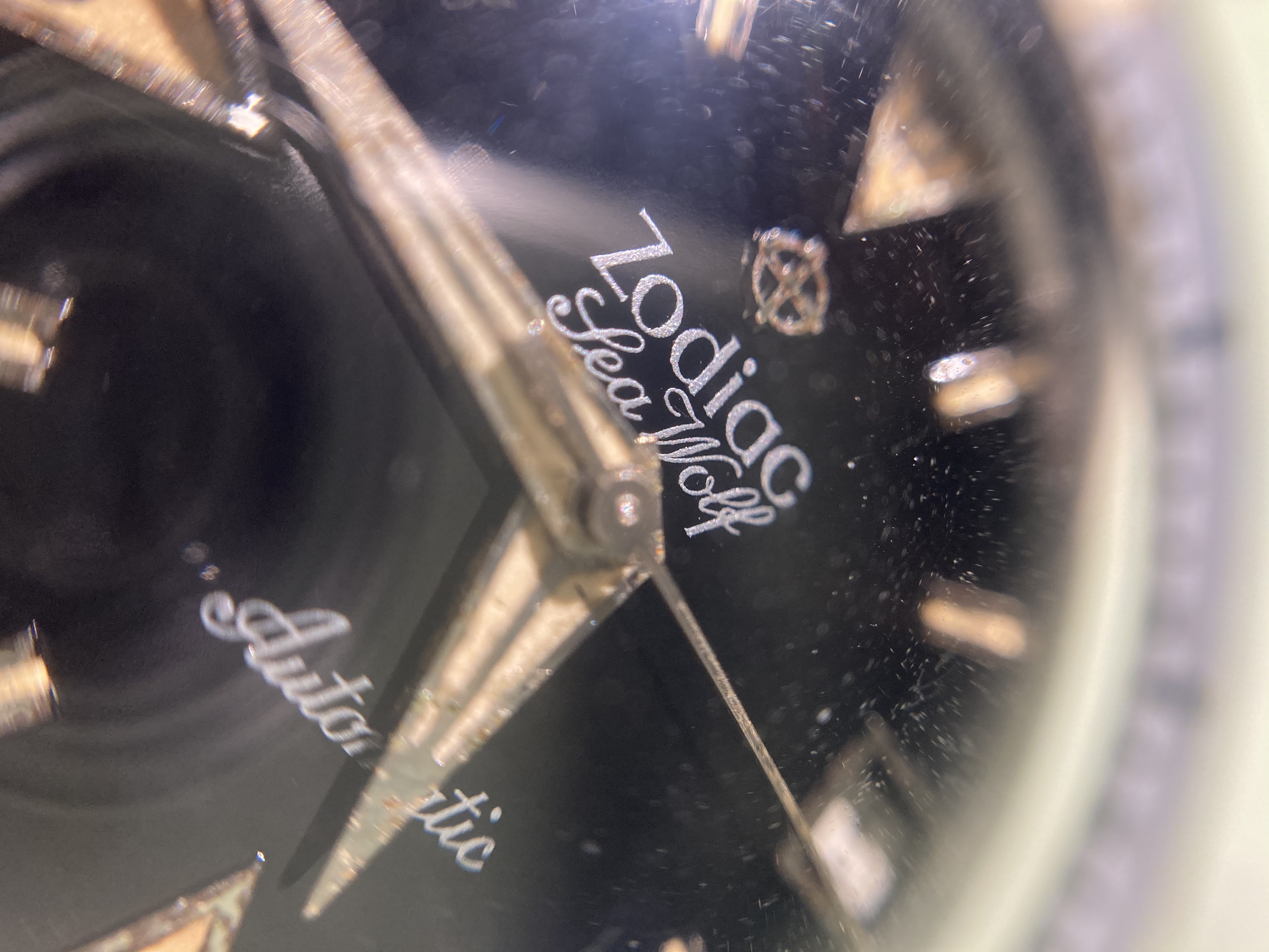

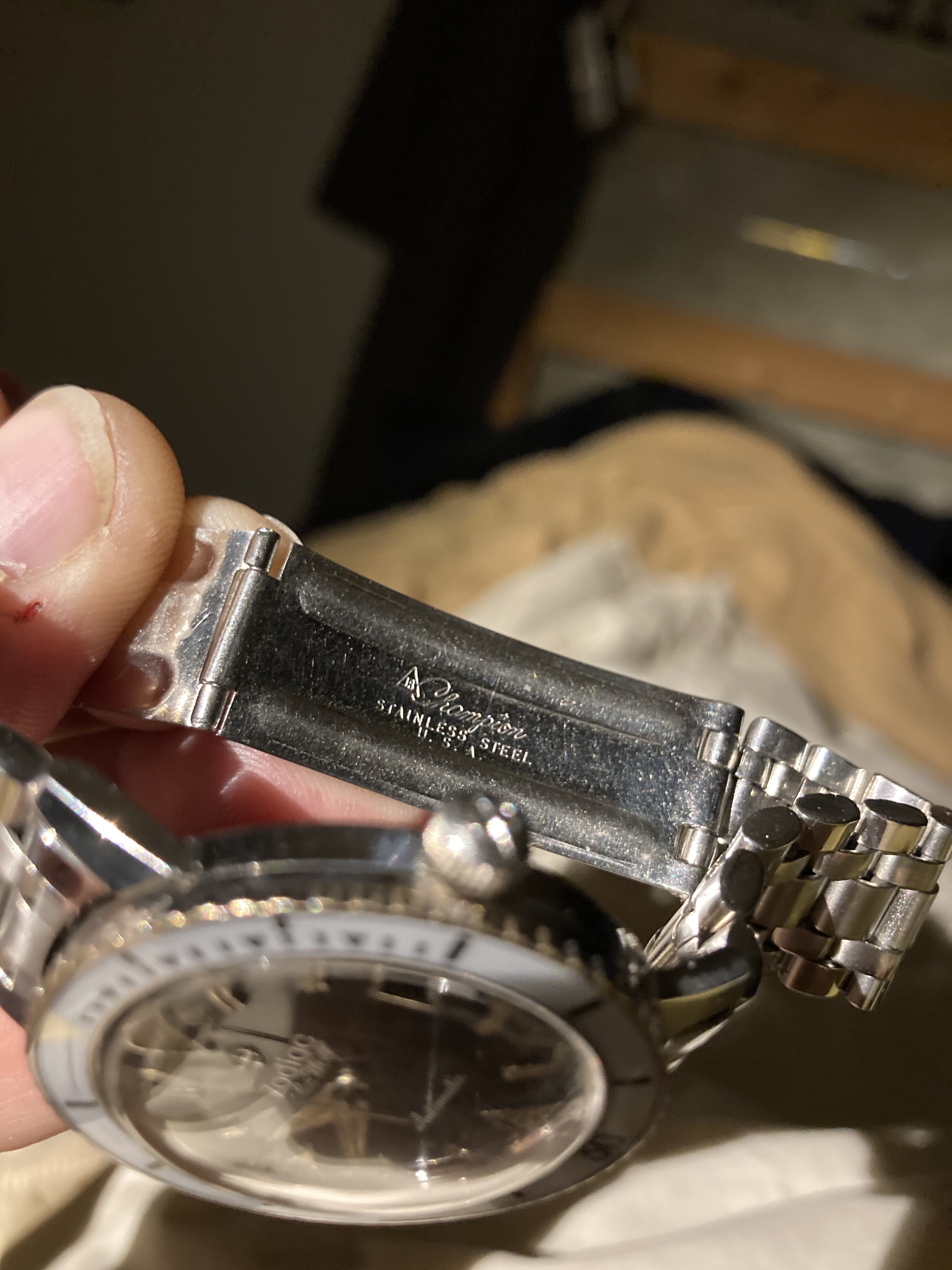

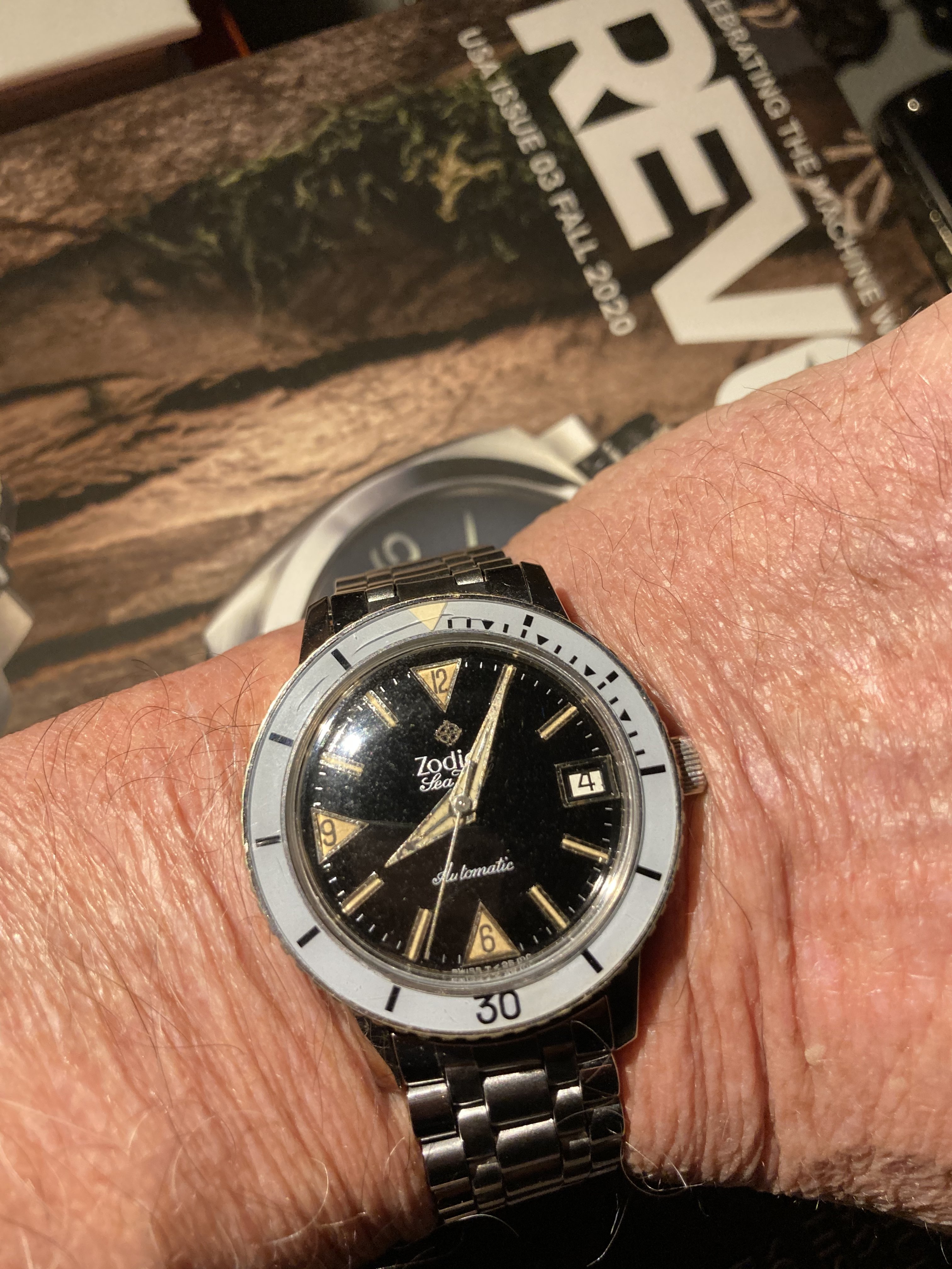

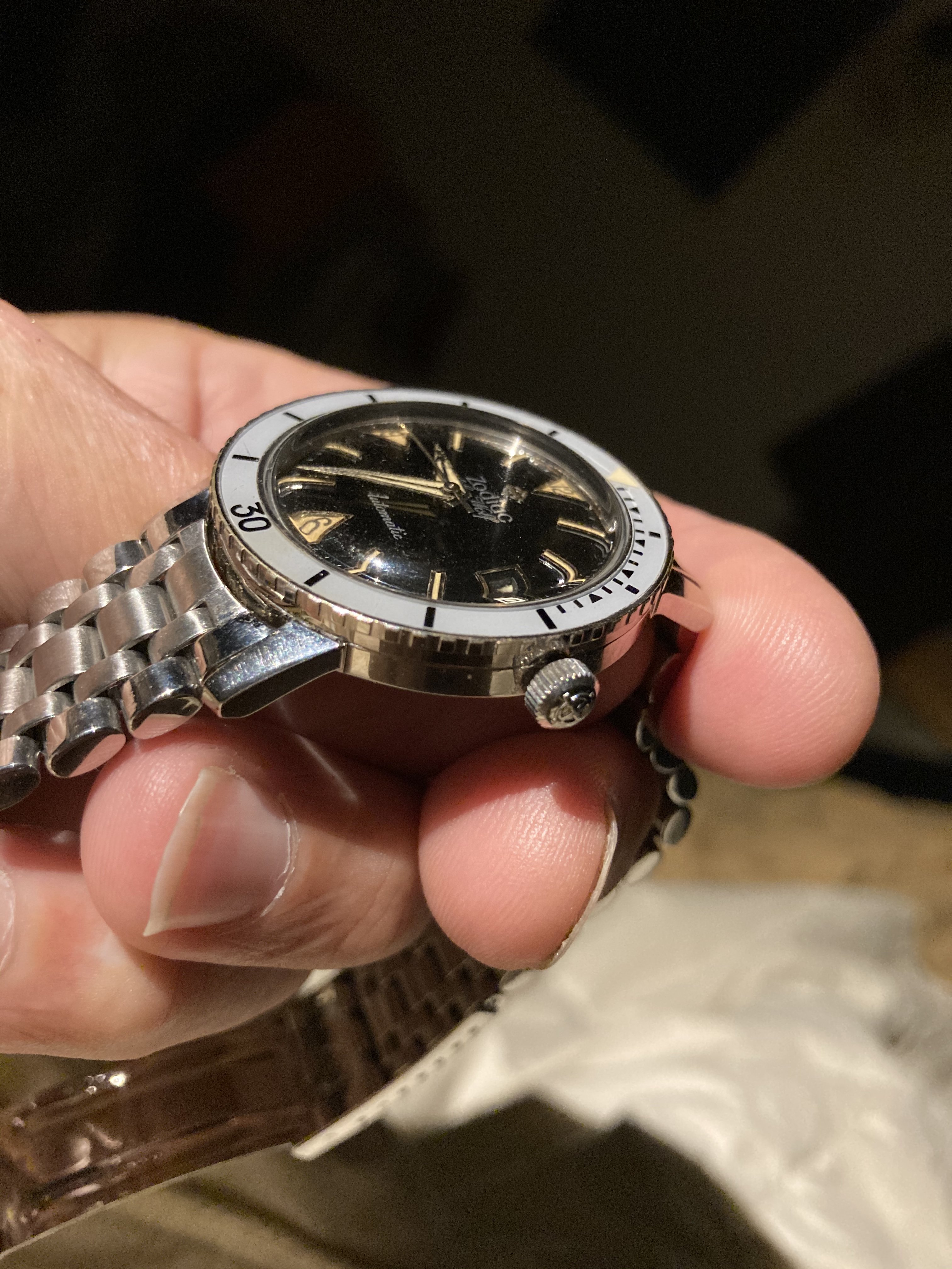

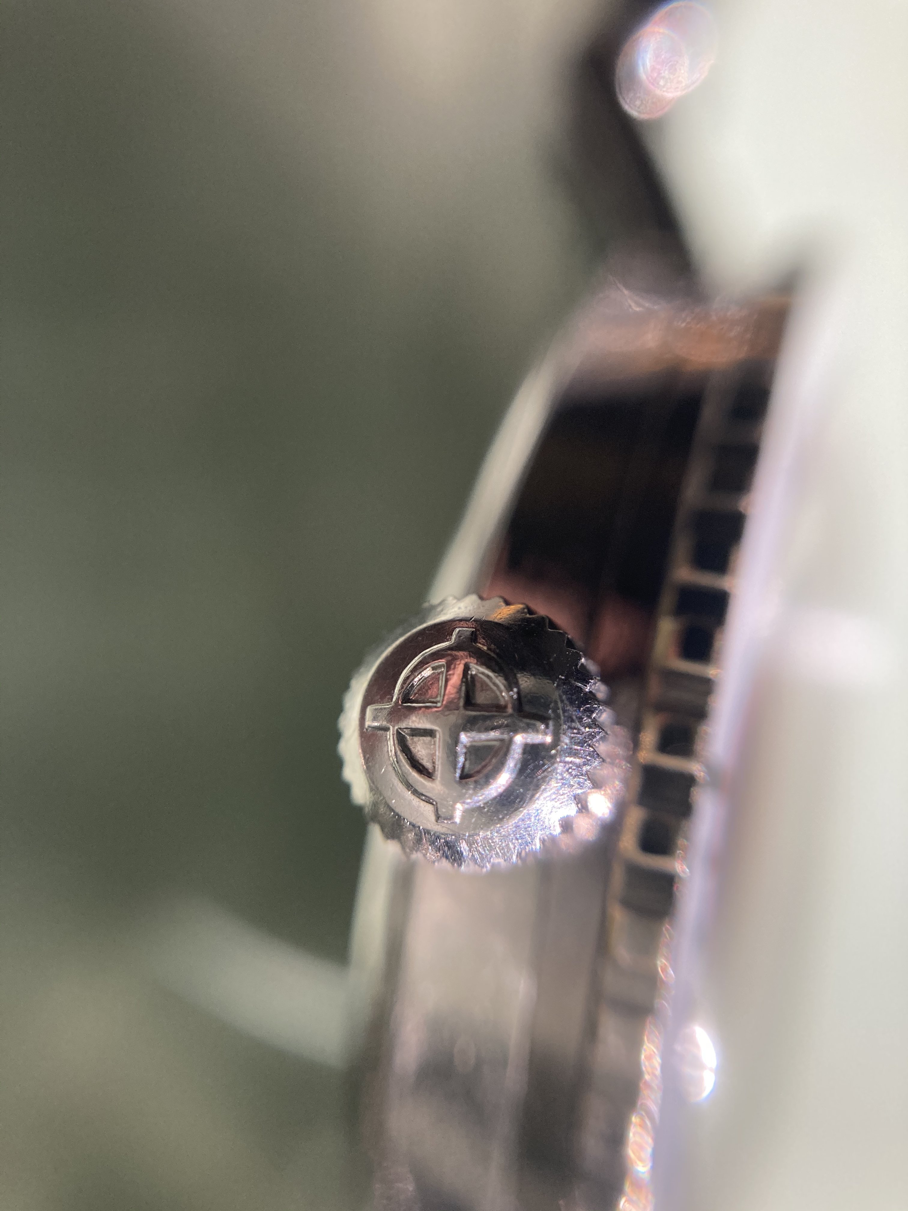

So I finally took possession of my Sea Wolf!
I'm totally stoked!! I have a question though that someone here probably knows the answer to:
I think this model with a 72B should have a quick set date feature but it doesn't seem to work. I'm pretty sure I read that that feature makes the crown sit proud of the case and in some instances the stem was cut short to make the crown sit against the case. However by cutting the stem the quick set feature is rendered inoperable. Am I dreaming this up?
Anyway...here are some pics. And I'm still stoked regardless of the quick set bit!
16,307
44,994
Great looking! Have you tried the 9/12 date change? My earlier one changes that way and they still called it “quick set” as it was faster than the slow set.
16,307
44,994
Ok, just checked my later shovel hand and that does have the push set. Yours is a transitional piece- MKII dial with MKIII bezel, so it is possible that yours may be a transitional movement- either the earlier or the later- not sure when the change happened, but it was around this time.
