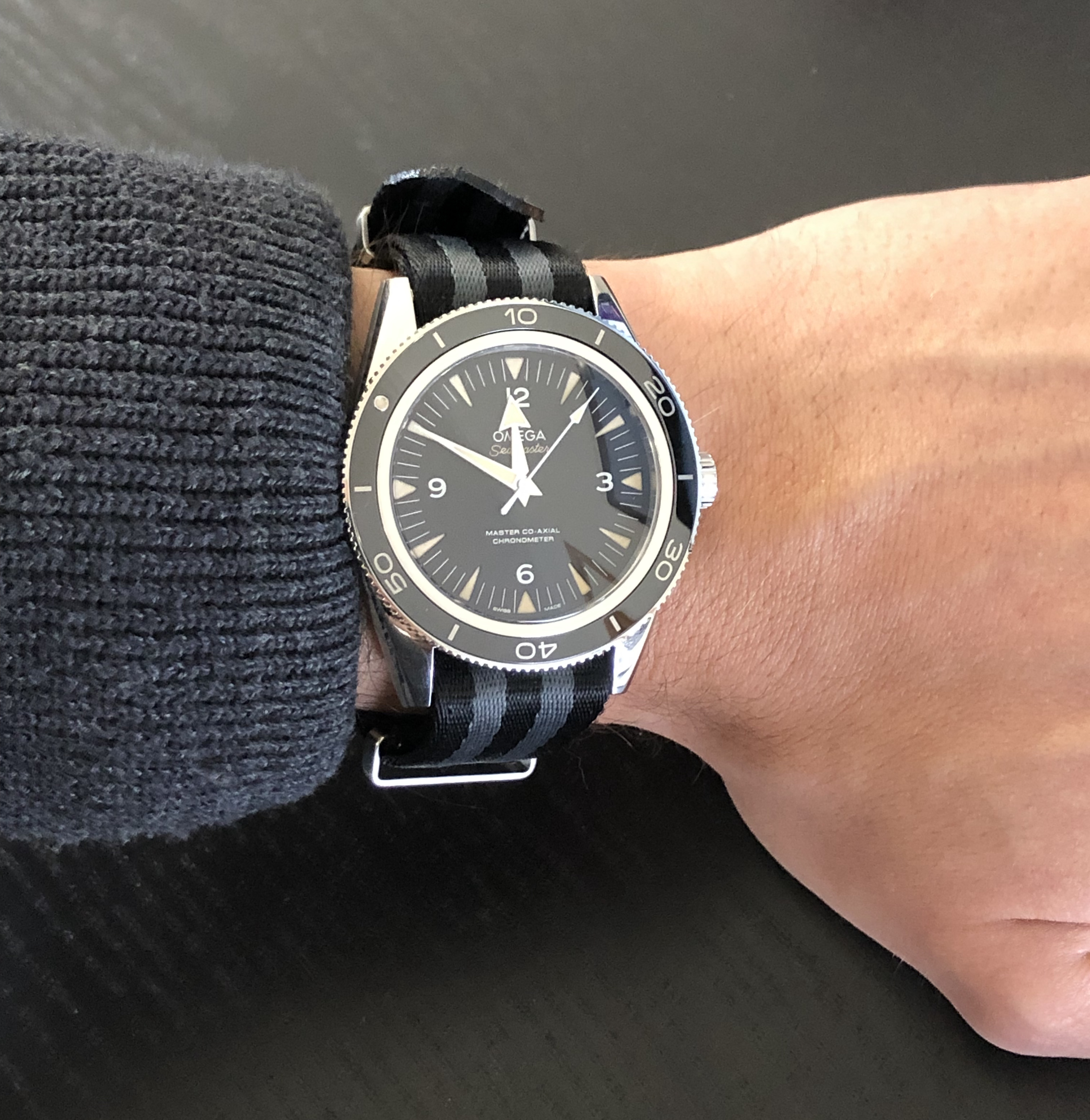

I'm having an issue that I never encountered before and I couldn't find any info on it on the forums. When unscrewing the crown completely it is impossible to wind the watch properly as the crown starts screwing back in. So there is no "neutral" position in which you can wind the watch freely. Only after I pull it into the first position (quick hour change) it doesn't catch the threads and can it be turned indefinitely.
Has anybody encountered such an issue before? And should I report this while the watch is under warranty or will it be fixed when servicing the watch? If it's at all repairable of course.
Since a thread is always more exciting when pictures are included, below the mandatory wristshot for new watch purchases 😀

Seems the stem might have been cut a tiny bit too short! How often do you plan on allowing it to run down? If often, then you should have the problem attended to under warranty, pronto.

Broken setting lever spring? Does the stem feel like it is latching into detents for winding position / setting position, or does it move in & out sort of indistinctly?
